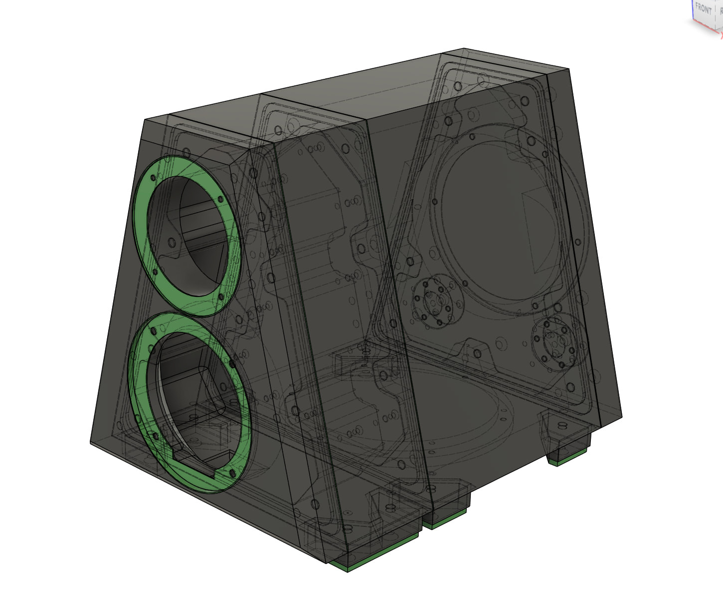

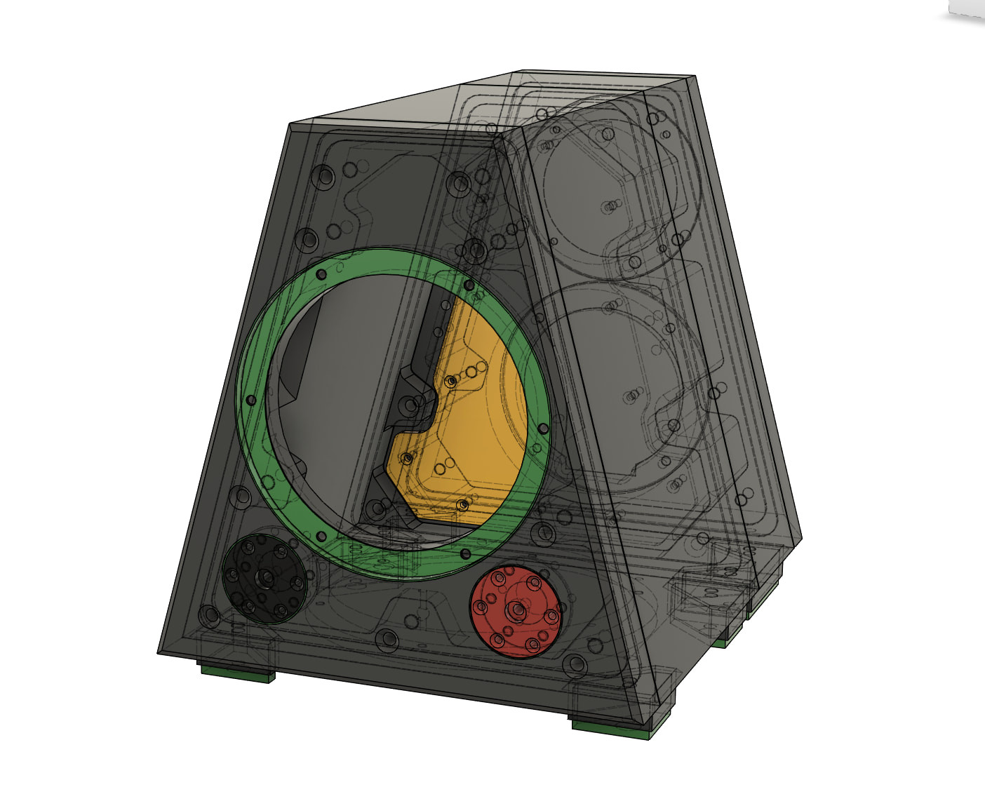

    This project is kind of a rush since I’m trying to get it done by IowaDIY in the middle of October. I’m waist deep in parts and it’s a struggle to move forward on everything but I spent some significant time working this out. On a phone right now so details are slim, but here goes. This will hopefully be a largish bookshelf that pushes my 3D printers to their capacity.
    Tweeter: Peerless DA25TX
    Midrange: TBD - FaitalPRO 5FE125, Anarchy 558, MAC-05, and Satori MW13TX are all contenders. Not sure I’ll have time or filament to make test baffles for all, but I’m definitely going to test the FaitalPRO and the Satori.
    Woofer (rear firing, separate chamber): Anarchy 708 with a Dayton Audio RSS210-PR in a downfiring situation.
    Lots of questions, very little time to get things done. CAD work and progress photos below. Essentially I’m making two trapezoidal enclosures. One shallow enclosure around 4-5 liters for the tweeter and mid. One ~10 liter enclosure for the woofer, PR, and hopefully the crossover.

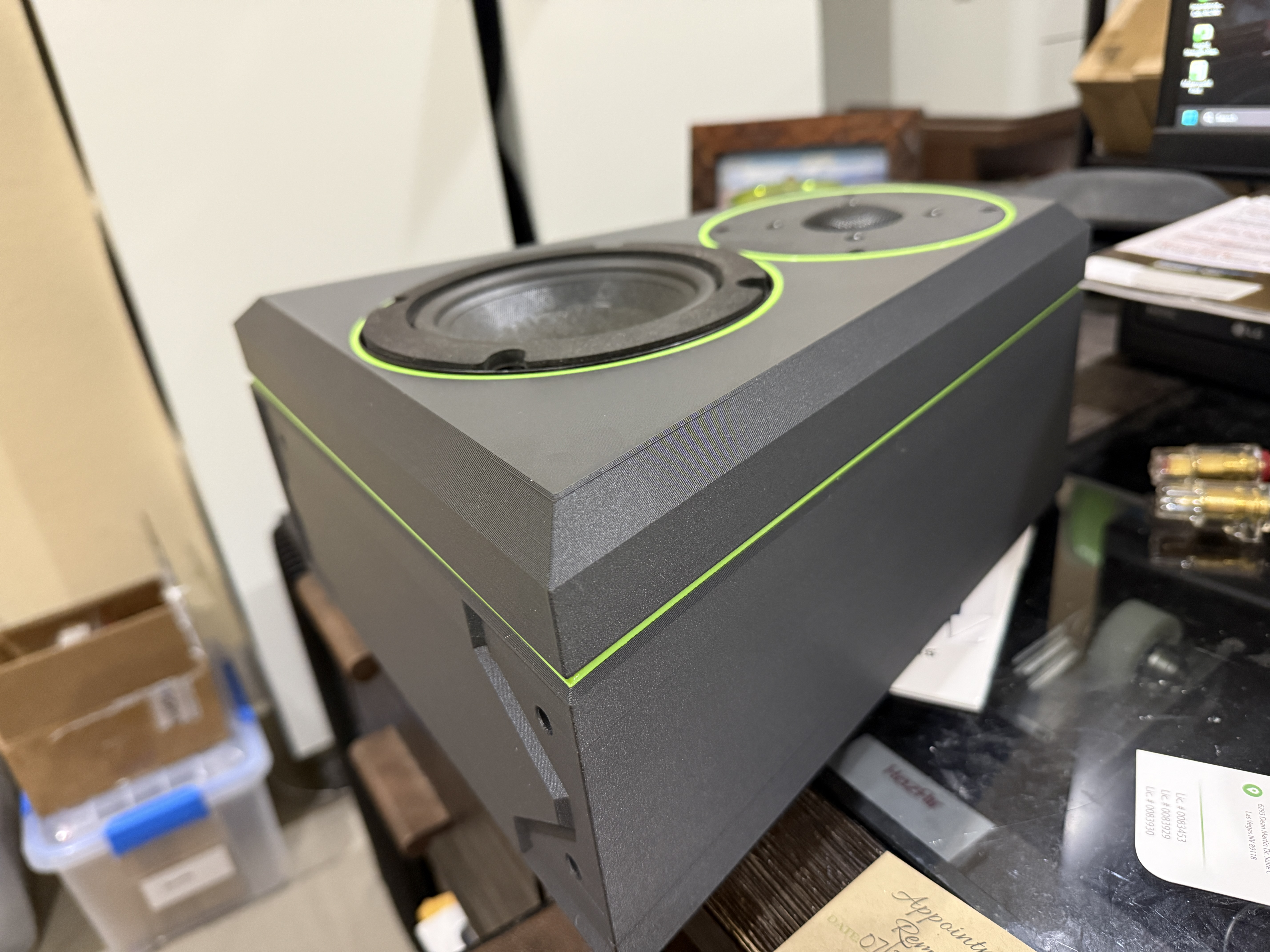

      The color of the Satori matches really well with the baffle, IMO. It's less black than the 5FE125 and is close to the shade of gray selected. Baffle for that one is printing now.
        • 1577
        Rear baffle is pretty good, minor improvements need to be made but this will work for testing I think. Printing the woofer cabinet now. It's a 3-day print on that one so hopefully I got it right the first time (and hopefully the print doesn't fail!).
        Edit: Not sure what color of bolts to use (black or silver stainless steel). I was planning on black for the 9 bolts that hold the baffle on and mirroring that for the little guys, but I think black would look weird against the red input plate.

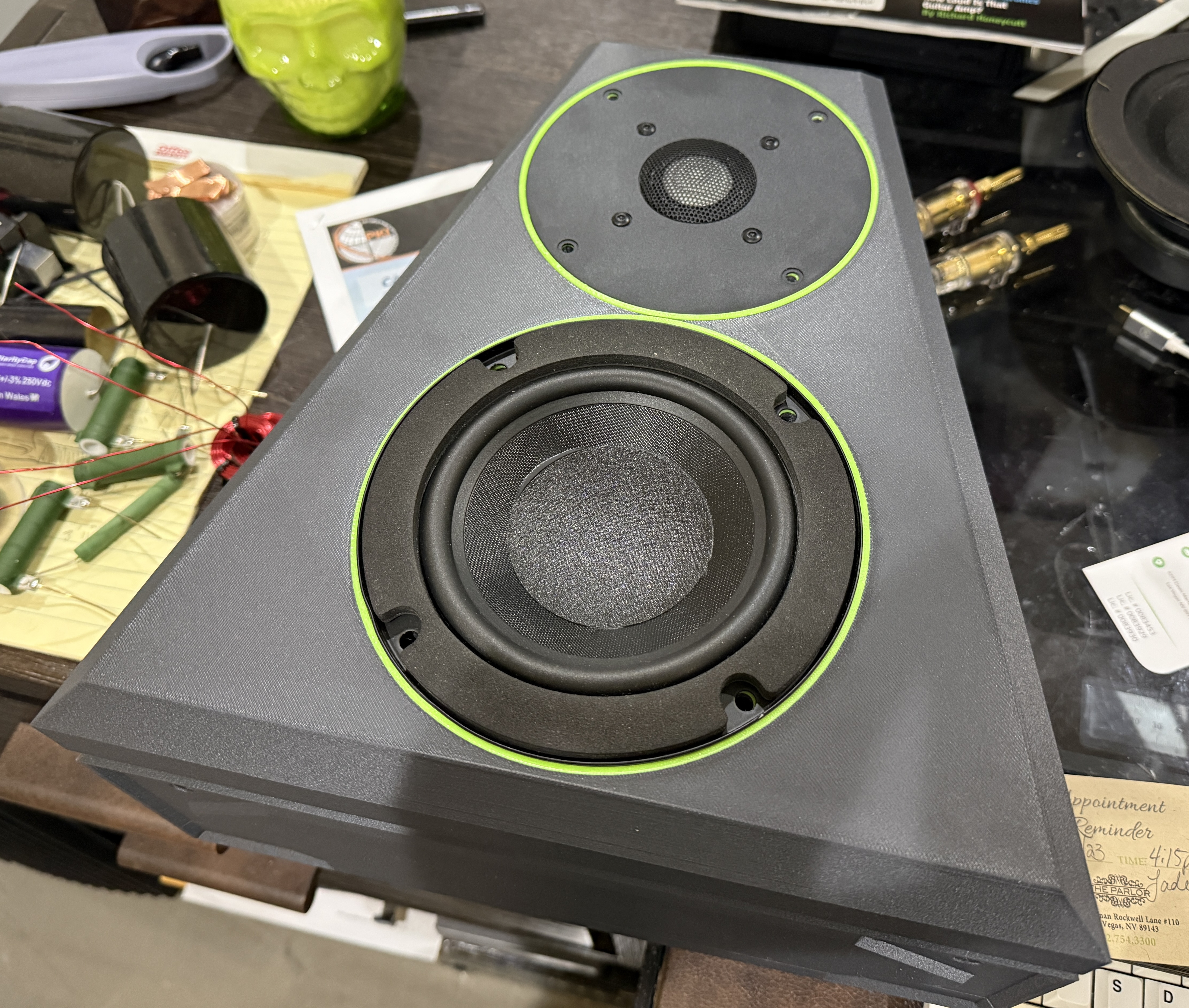

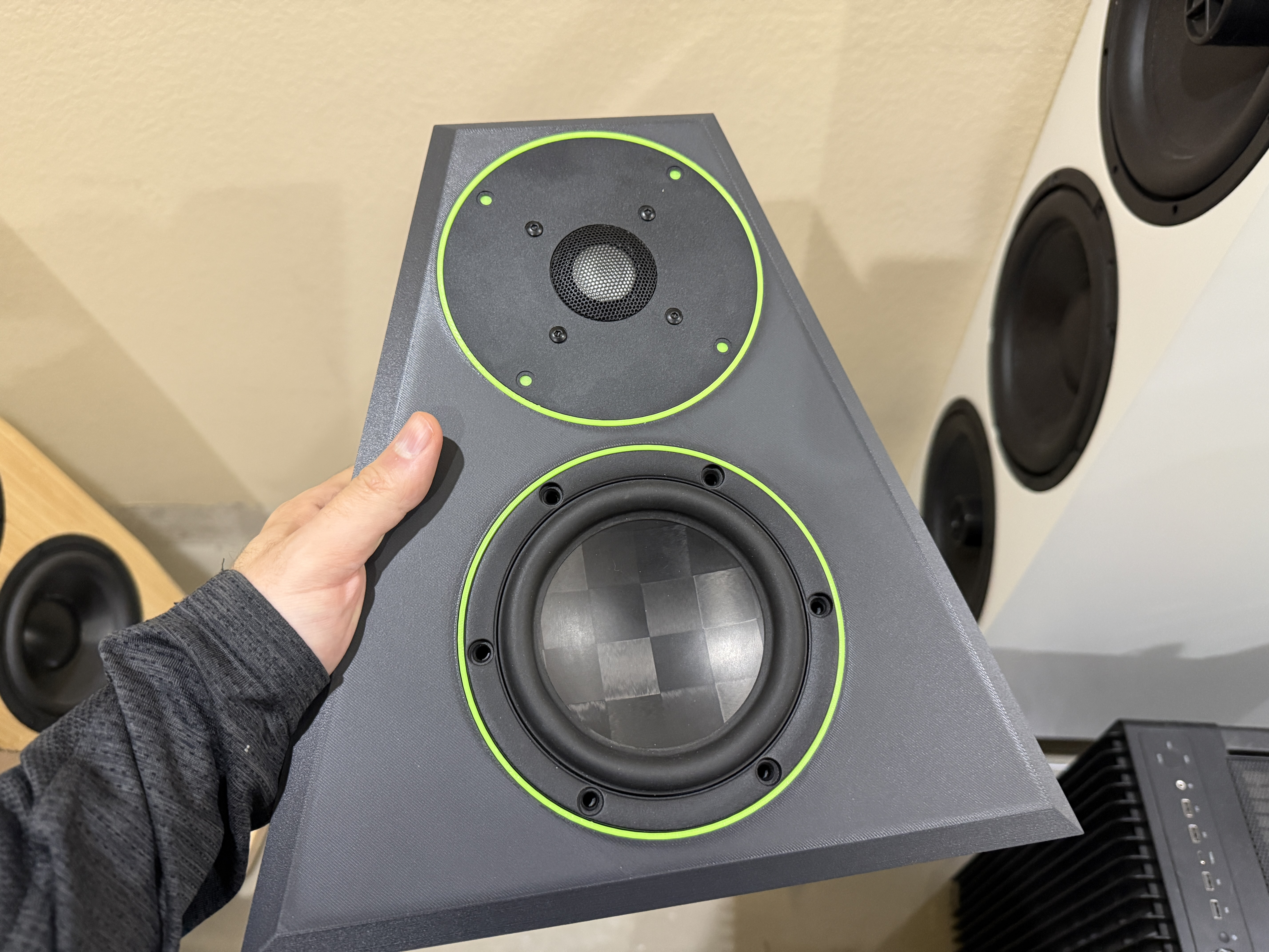

        Satori baffle and surround are complete as well. Big fan of the appearance.

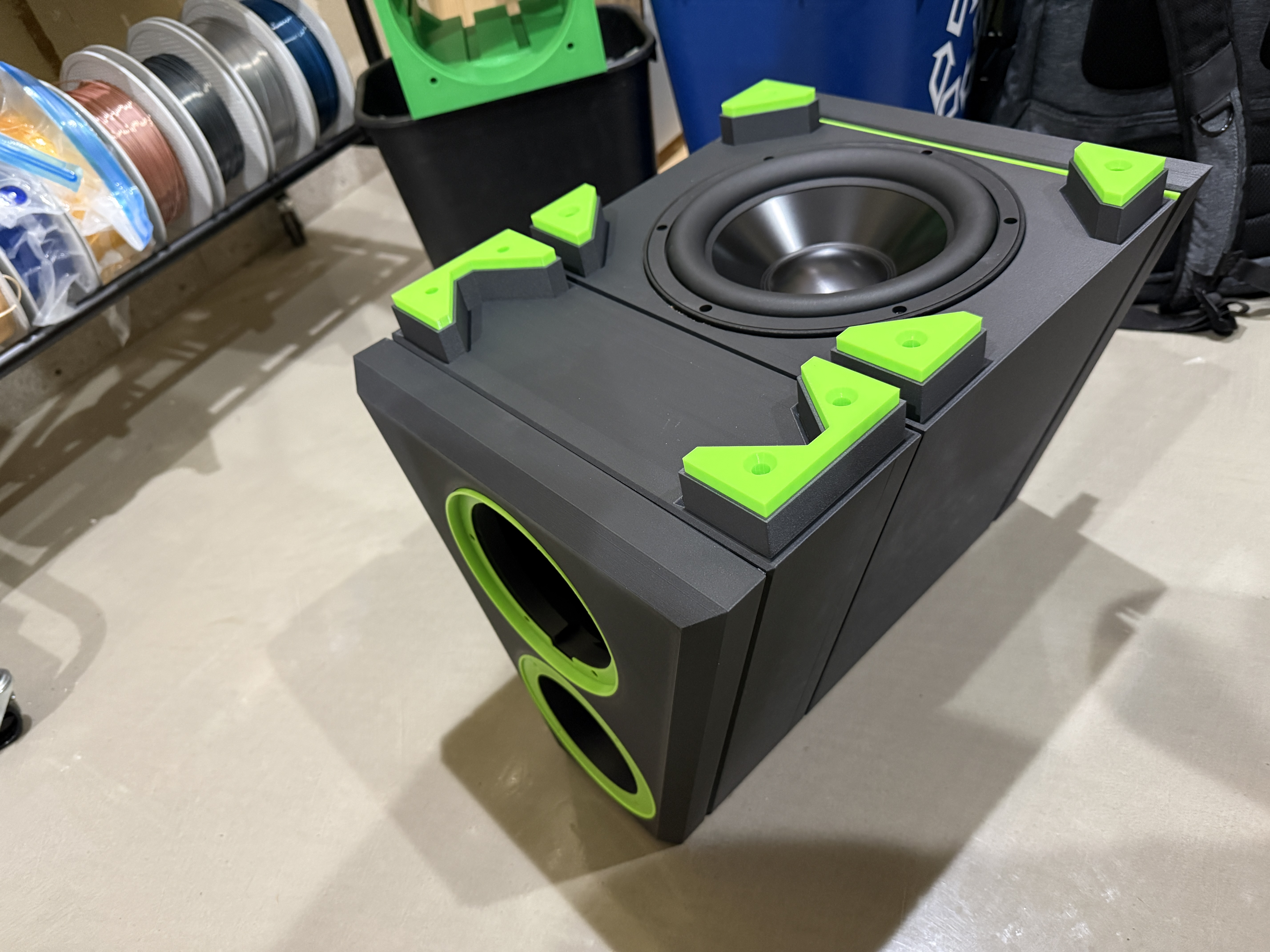

          • 1577

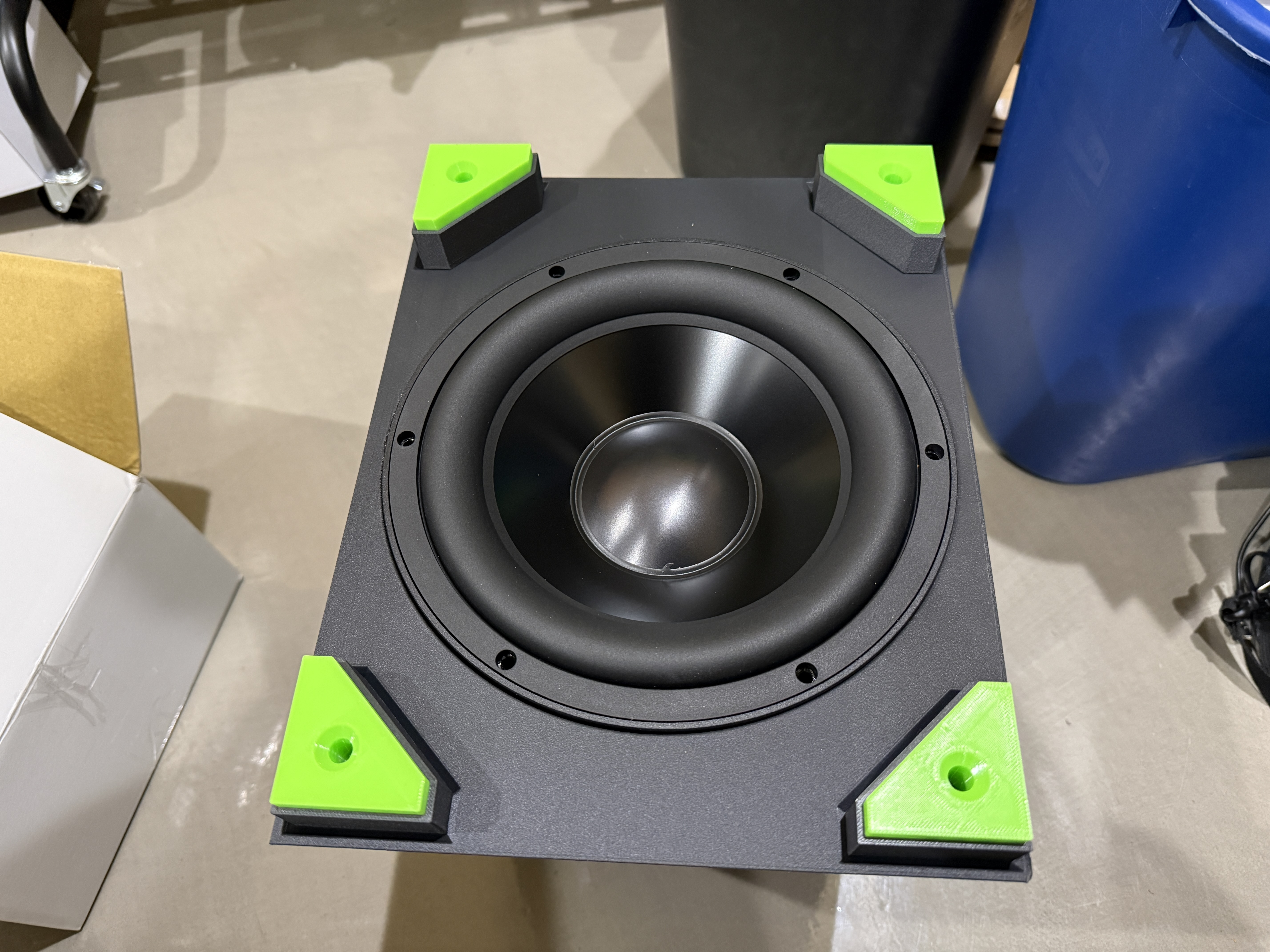

          The 3-day print that was the woofer cabinet sides turned out okay. Something is going on with my seals, for some reason they only fit one direction and I'm not sure if it's the seal or the cabinet. Seal is easy enough to modify but it shouldn't need to be. Very confusing. Anyway, the cabinet itself needs to be updated a bit so I may have two more very long prints to endure. I'll probably still use this for testing though as I need to get moving on that.
          This is not going to be a small speaker. However, with the PR resting there and nothing bolted together, the cabinet feels quite light compared to what I imagine a Baltic birch version of the same would weigh, so that's nice.

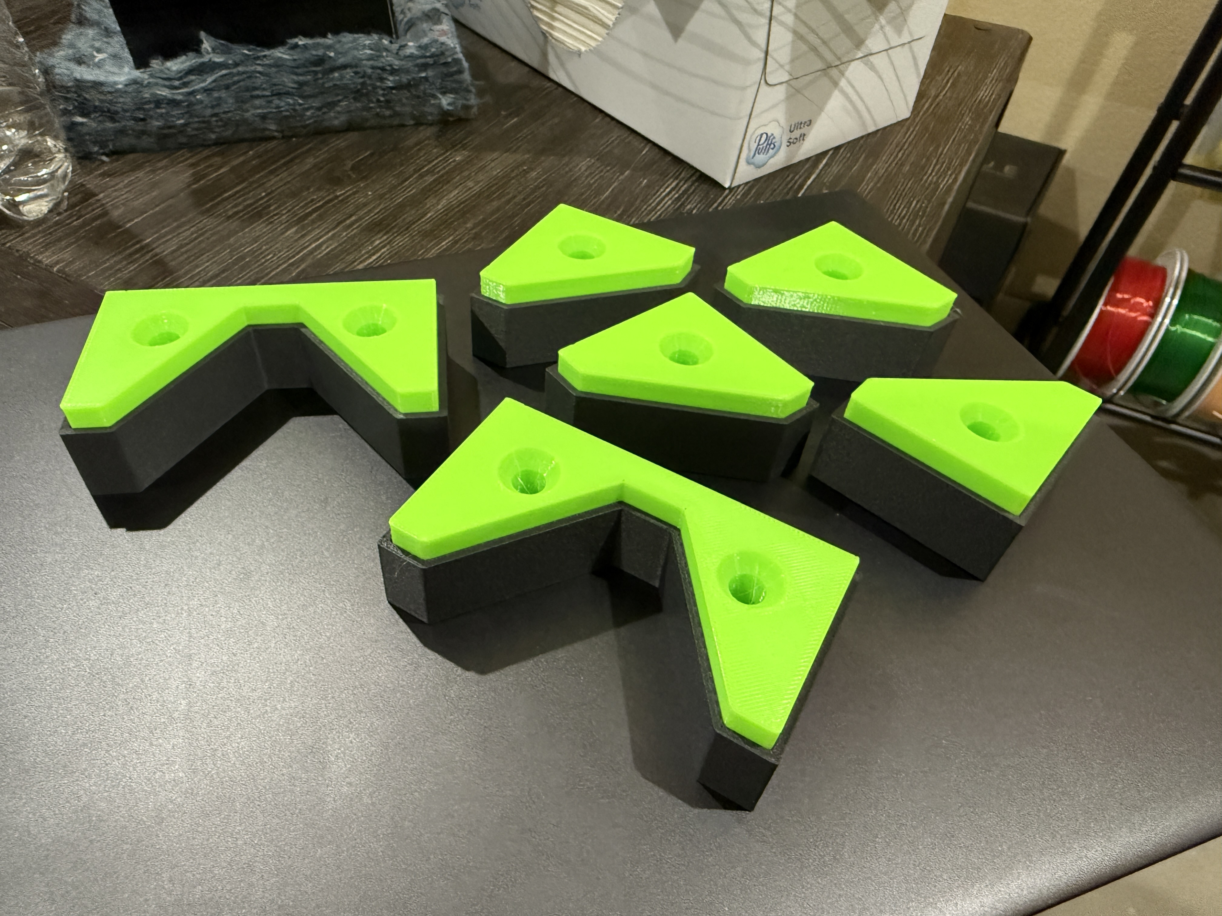

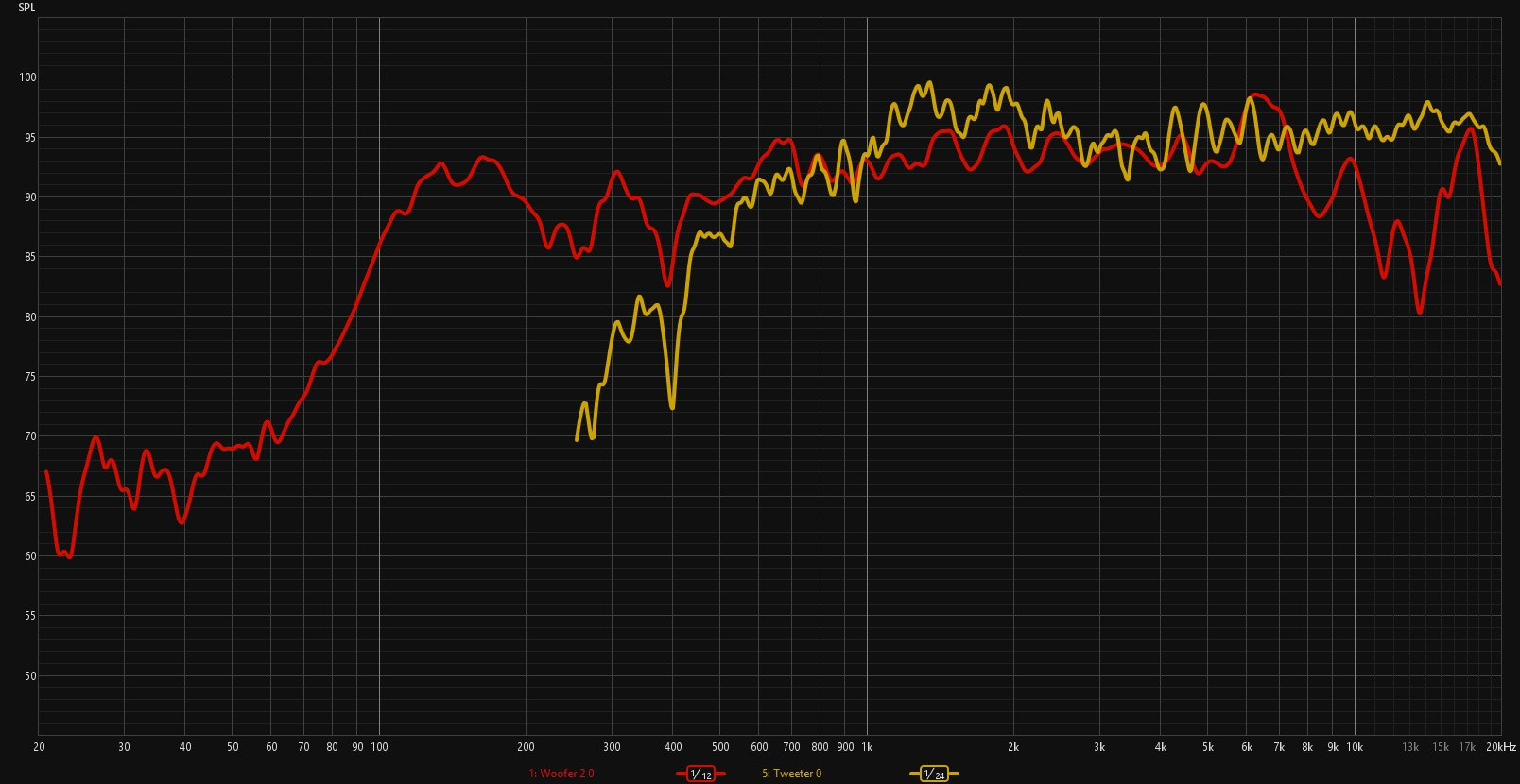

              I've started measuring a bit to get my head wrapped around what I have here. Turns out the 5" bolts I ordered to hold the front baffle, mid chamber, and woofer compartment together were about an inch too short for the job, but they were sufficient for the front baffle and mid chamber so I started there. The 6" bolts will be here before next weekend, so I probably can't test the woofer until then. My first test failed miserably and I was confused until I tried a second and third tweeter. Turns out that very last unpaired tweeter I got from PE a couple years ago was DOA, so that's kind of a bummer. Of course now I have a dead one to tear apart and (perhaps) think about waveguide development for the others.
              But that is a future project.
              Initial Satori and Peerless combination is shown below. Keep in mind this is a rudimentary setup in a pretty small room - I'm basically just proving my setup is working - and no gating has been applied here either. Clearly a room issue at ~400 Hz, I'm guessing it's the distance to the concrete floor (which I have no rug or anything placed upon. Probable room issue between 200-300 Hz as well, that would correlate roughly to the distance to the nearest wall. Input voltage was static (but not set specifically at 2.83v), but shows we won't need to attenuate the tweeter much to get it in line with the mid.
              I'm trying to determine how I could maybe get this setup outside.
              Click image for larger version  Name:	T+M.jpg Views:	0 Size:	255.3 KB ID:	961486
              After this, I got to thinking about how to measure the woofer since it is rear firing. My first thought is to leave the test setup the way it is - about a meter or so away from the speaker, and have the front baffle pointed at the mic. This would emulate how the speaker would actually be listened to, which seems appropriate?
              Now, I'm sure the combination of REW and VituixCAD would allow me to measure the woofer directly (woofer pointed at the mic) but I don't know how to do that being the novice that I am.
              Thoughts JonMarsh?

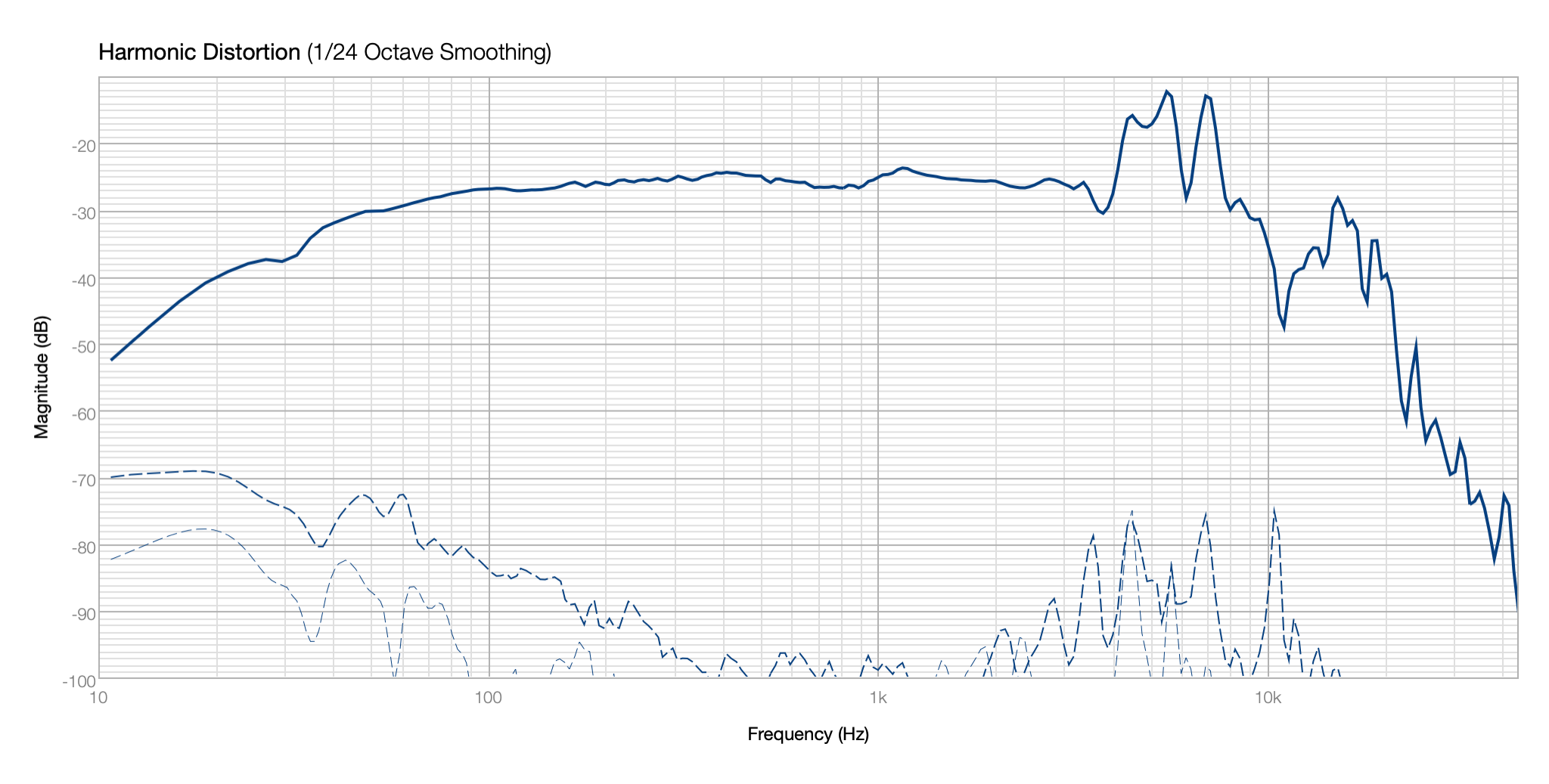

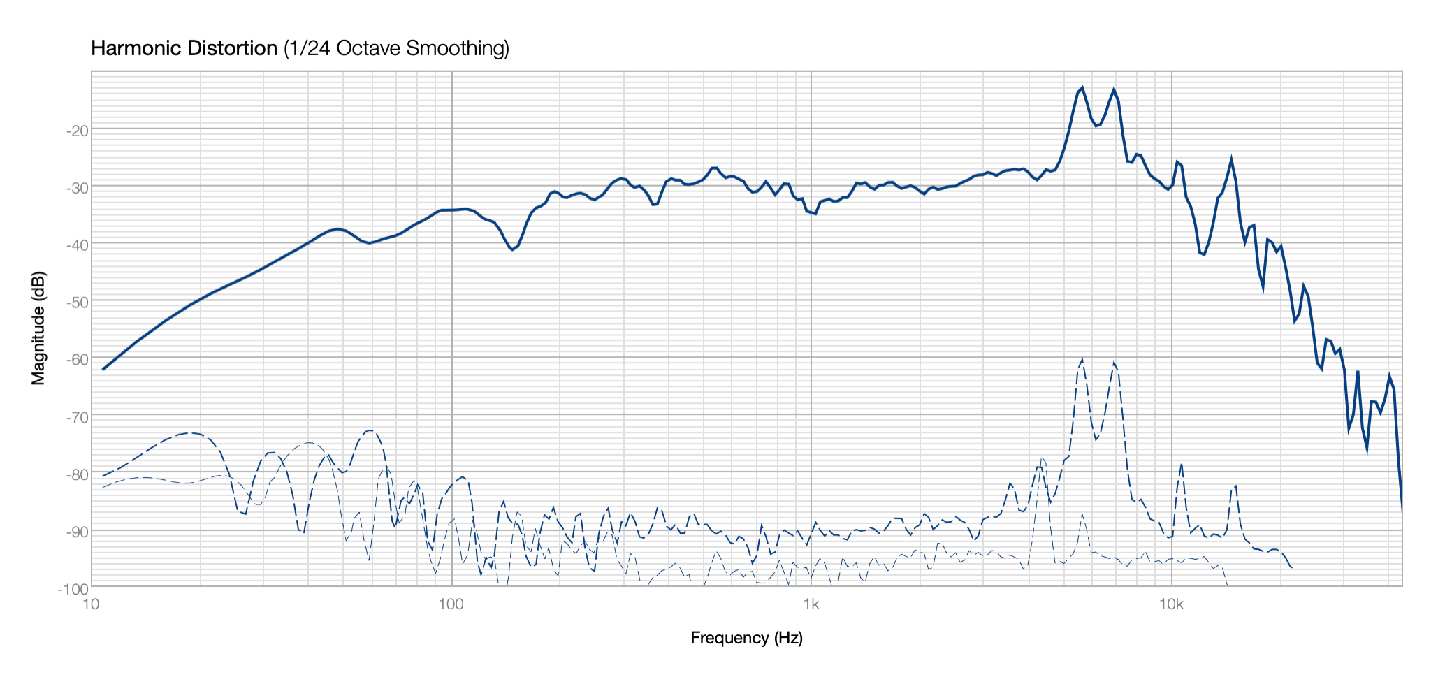

                Here is the QNF measurement, no change to the setup except for the microphone position and reducing the mic gain:
                Click image for larger version  Name:	PTT8.0 QNF.png Views:	49 Size:	207.7 KB ID:	961496
                These are with a newer microphone than I've been using in the past for a long time; it's an Audix TM1, which seems to have a lower noise floor and returns better results on distortion tests on high performance drivers like the PuriFi parts. My other microphone is an Earthworks M30. The test controller preamp is a MOTU M4. The system preamp is a 2nd generation Schitt Freya with the Nexus balanced current mode amplification; the current version of that is called a Kara, as Freyas now all have solid state plus vacuum tubes.
                Note, considering the sensitivity of the PuriFi PTT8.0, the output distortion for a speaker is VERY low...

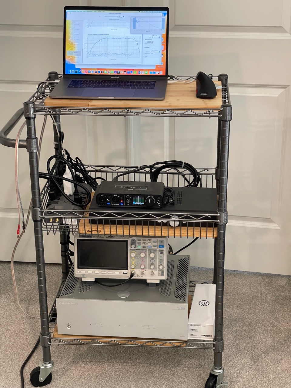

                  A little more info- this is what one of my test carts looks like, the one with the Schitt preamp and Cambridge Audio Azur 840W stereo power amp, which itself is very clean, and has a low noise floor. However, it currently has a Mac Studio desktop computer and LG monitor, instead of the 10 year old laptop.

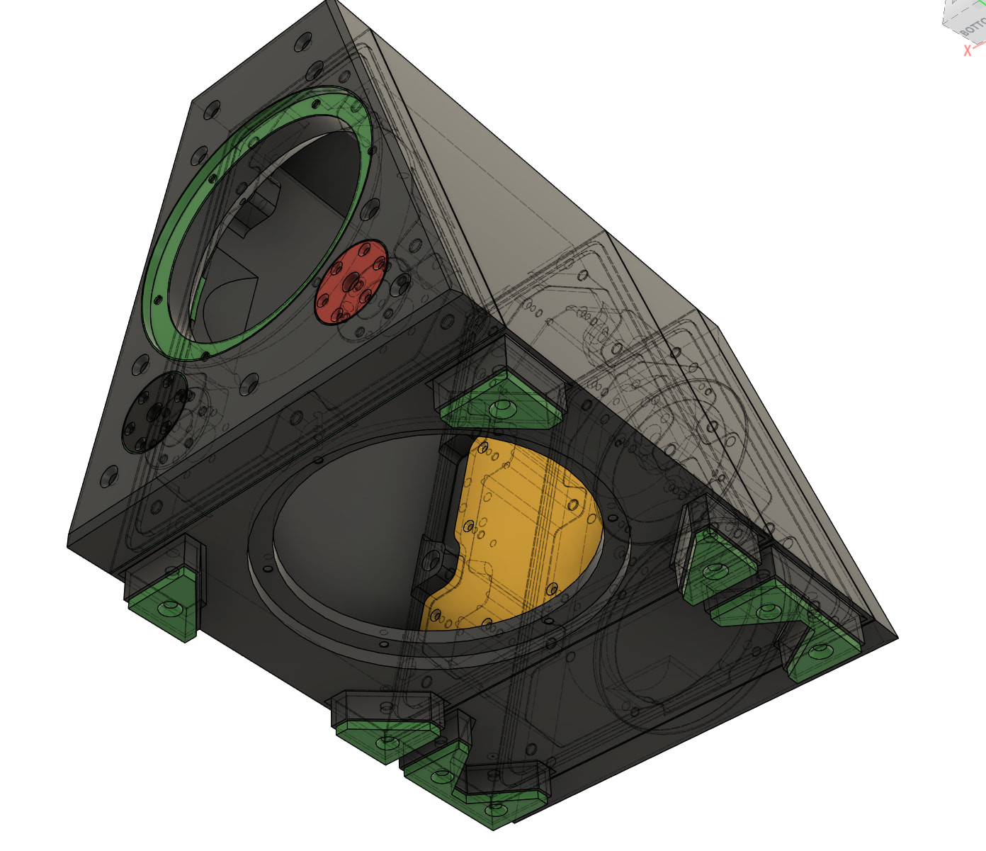

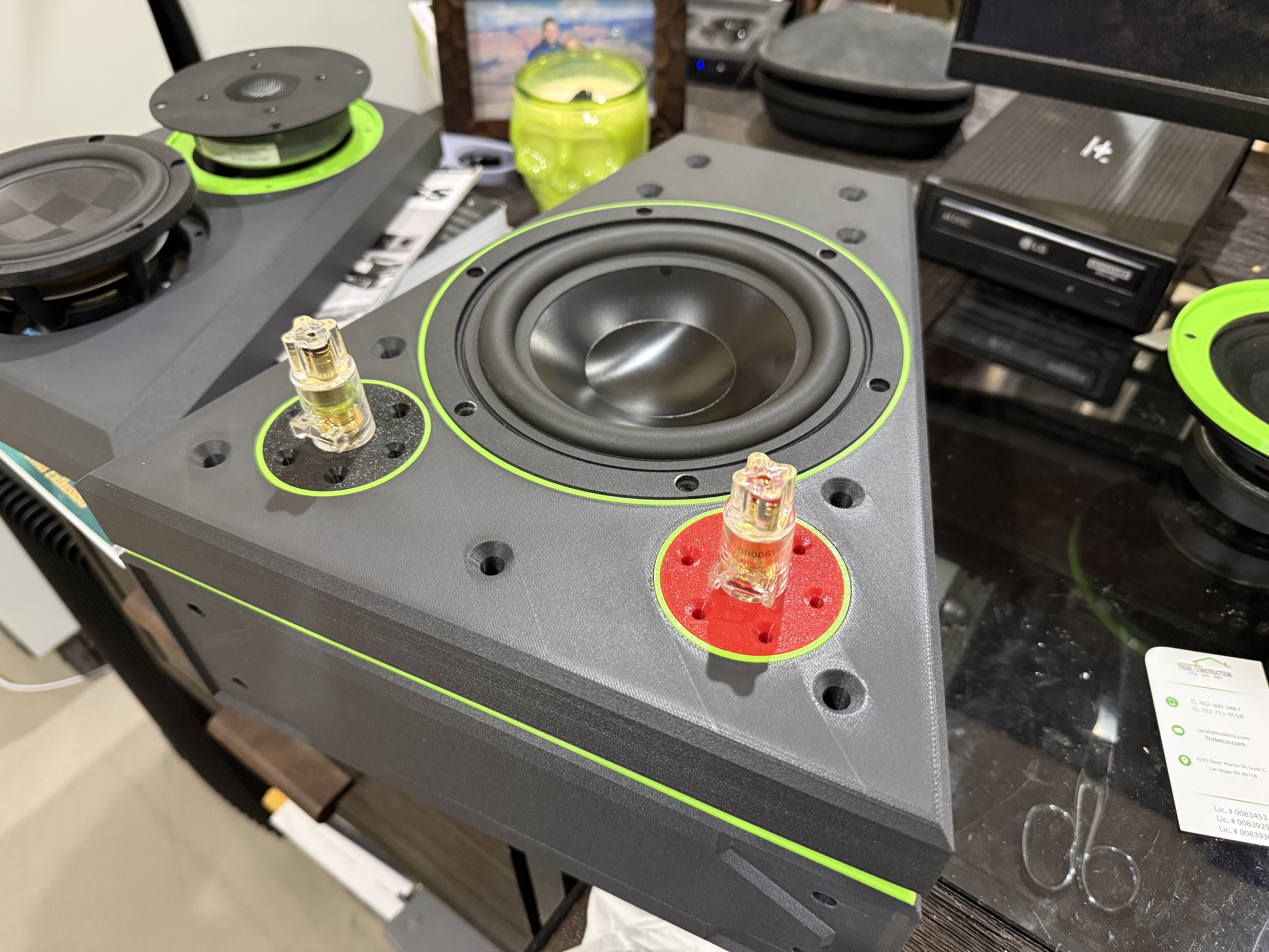

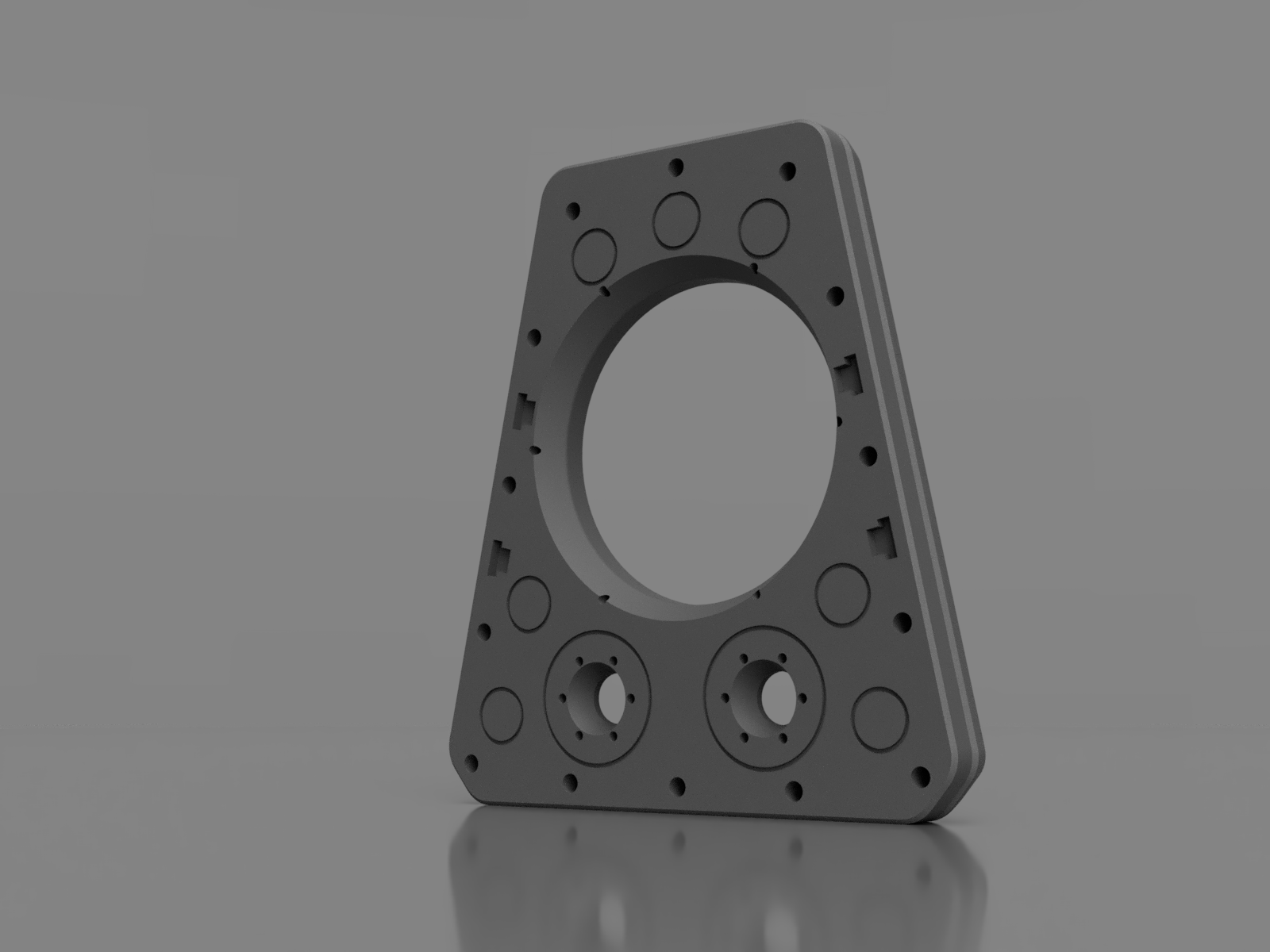

                          So I’ve mostly completed the new 3D model and have several parts printed. Before doing that I asked around on the Bambu forums to see what could be done about the warping I was getting on the corners of the larger parts. They were very helpful! I don’t know if any one of these changes did it, but the combination certainly helped significantly.
                          1. Dry the filament for 24 hours. This was a step I normally do for just 6-12 hours for the nicer projects I do with PETG (usually not at all for PLA given how dry it is here in southern NV). I skipped this step entirely for the prototype prints, but this time I gave it the full 24 hours.
                          2. Increase the bed temperature from the stock value of 70C. I chose 75C, no idea if it’s doing anything…but maybe?
                          3. Turn DOWN the fans to keep heat in the chamber relatively high. I could also choose to control the temperature directly but that didn’t seem to be necessary - usually that’s only for the advanced filaments that need very high temps.
                          4. Design fix #1 - Chamfer the entirety of the part that would otherwise make contact with the bed. I used a 2mm chamfer and made it a feature. This I had done before even asking at Bambu and it definitely helped a little. Someone here might have made this suggestion.
                          5. Design fix #2 - Hard, sharp corners (as those seen on the bottom of the picture) are subject to the worst warping due to high stress on small points. The fix is to usually just round off the corners. I did this on the top, but for the bottom I chopped off the corner then rounded the remaining edges.
                          6. Design fix #3 - Long, uninterrupted stretches that make contact with the bed are subject to the most stress. To alleviate this issue, you need to break up those stretches. I made some small, shallow circles on the backside of the part to do this. If the part were much more solid (i.e. greater than the 25% infill I used) It may be prudent to have the cylinder go nearly the whole way through the part and hide it with exterior skin on each side. This was unnecessary for my situation.
                          7. Design fix #4 (NOT IMPLEMENTED) - One could also ‘ridge’ the edges of the design with tiny curves. I didn’t care for how that looked so I did not do this.
                          Here’s how the back of the rear baffle looks. I haven’t actually printed this part yet but the front baffle and mid chamber printed flawlessly and used the same techniques.
Name:	ER2 Render 5 - Rear Baffle.png

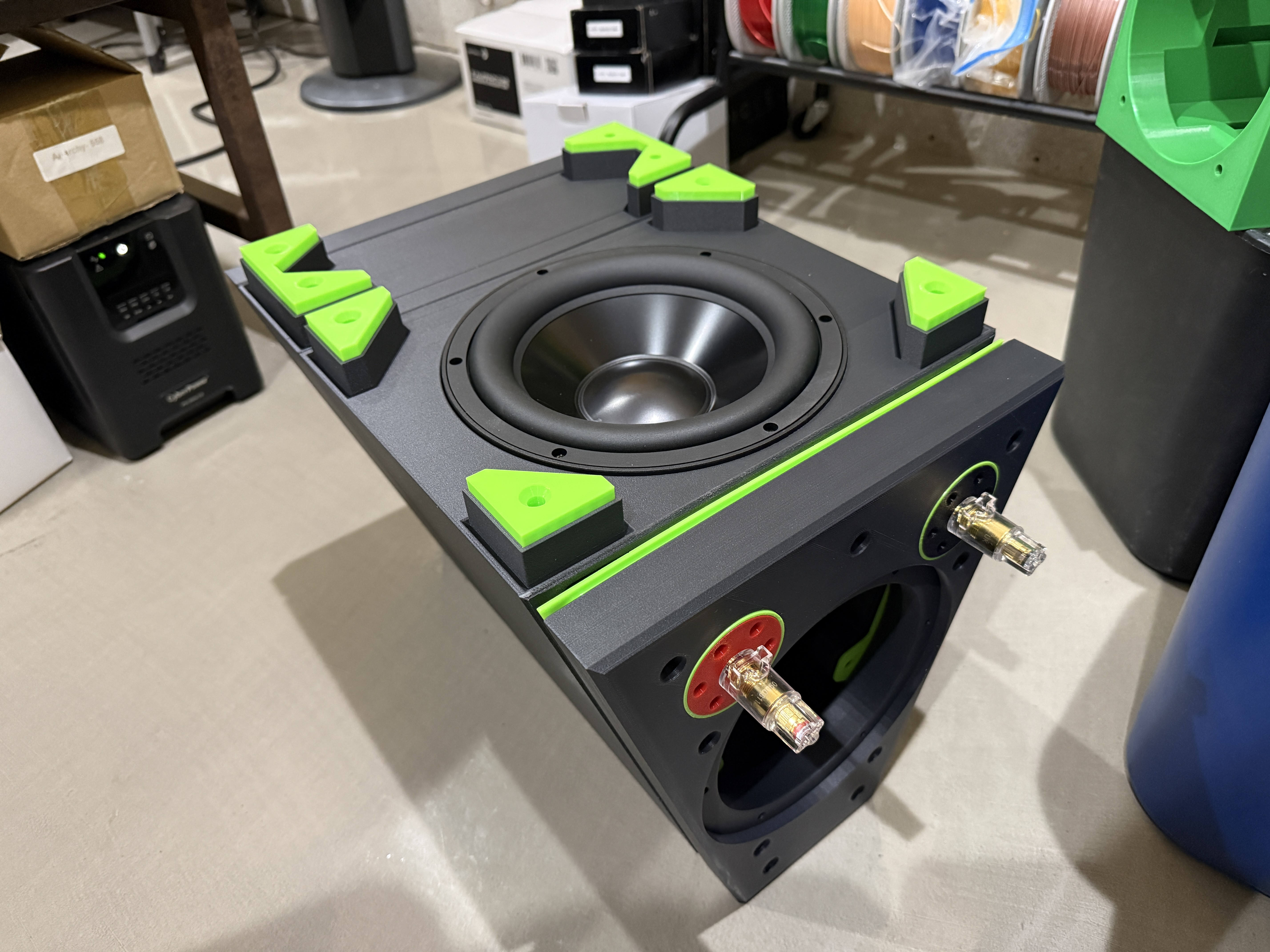

                          I also did a couple things differently on this build.
                          • Previously the bolt holes were inset by a least 12-16mm compared to how they are above, where they are relatively close to the outer edge. This was because they actually used bolts to hold everything together and you need to be able to access the bolt head. This time I’m using threaded rod that extends all the way through the speaker. I used M8 heat inserts on the back of the baffle (you can’t see them from the front), screwed M8 threaded rod into it, and on the backside there will be small steel thumbscrews (not like those phenolic ones shown below) that’ll cap everything off. There’s a little more to it on the bottom where you can’t use threaded rod due to the placement of the passive radiator, but in general this is the way forward. I have short threaded rod and temporary knobs holding together the mid cabinet for further testing. Once the new woofer compartment is done I’ll use the longer threaded rod in all positions.
                          • You can also see in both images four T-slot insets. This is to aid with alignment because I no longer have a groove for the gaskets. Gaskets are just flat now.The T-slots on the woofer compartment are for braces which will just extend past the cabinet a few millimeters through the gasket and into the baffle.

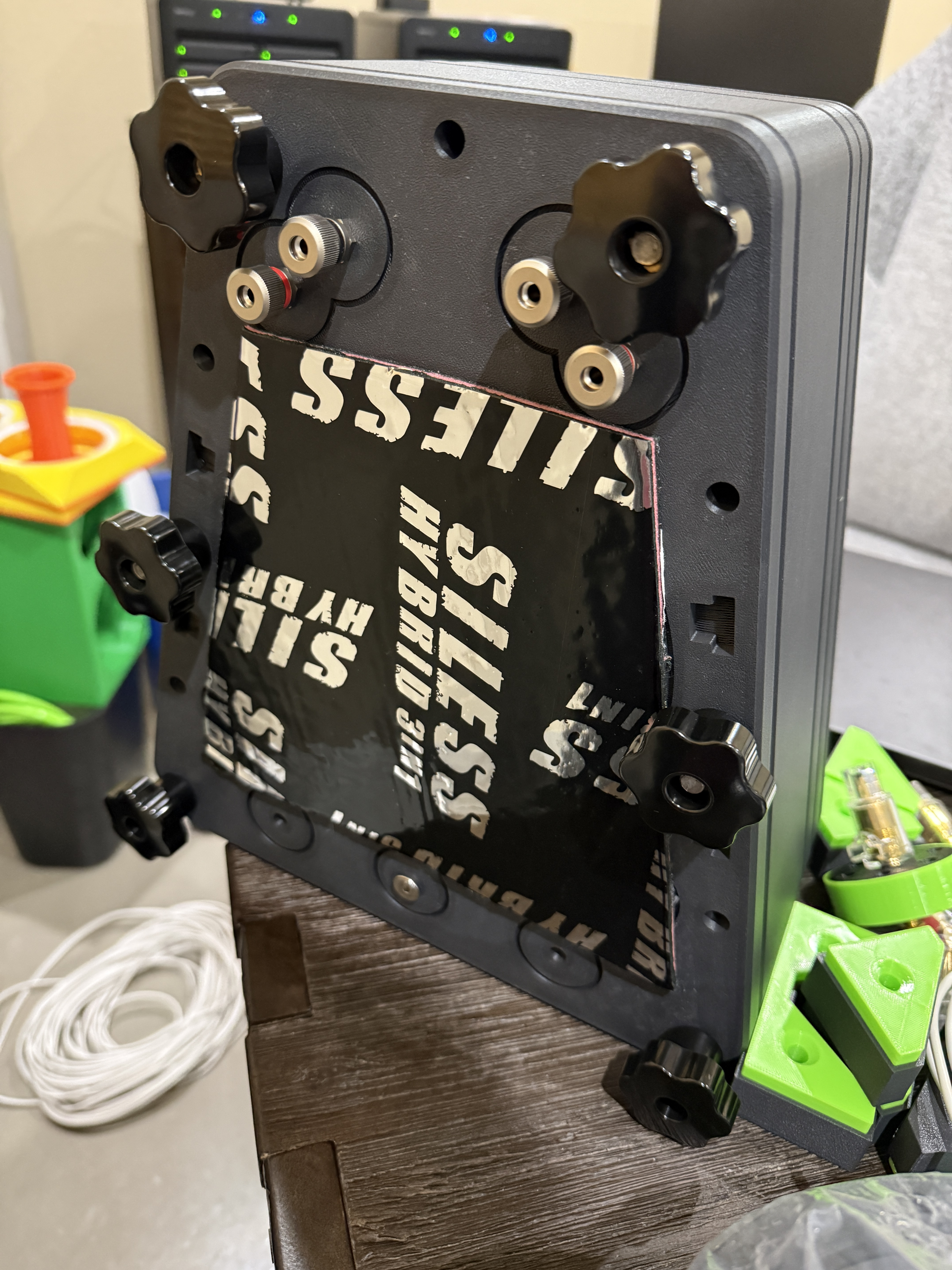

                          • Something that I should have noted in the first build is the audio from the woofer vibrated the panel ‘shared’ between the mid compartment and woofer compartment. The panel vibrates (and presumably makes some level of noise) and audio also passes through the panel itself. That’s obviously no good, so I’m taking a few steps to try and alleviate that issue. Hence the Siless-branded stuff shown below (it’s also inside the mid compartment). Because of this I’m not sure where exactly the crossover will now go, but we’ll see how big and complex it gets and go from there. It may be cool to create a whole ‘base’ for the speaker that the crossover fits in and the speaker rests upon. If time (and filament!) allows, of course.
                          Shown below is the back of the mid compartment with temporary ‘short’ (~6") threaded rod and knobs holding it together.
