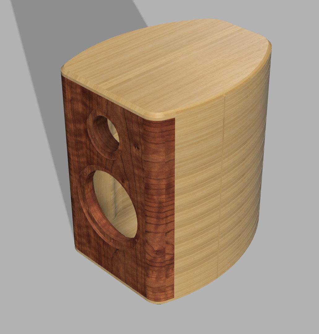

    I've started a build for a customer that is not a member of the forum, but I figured I'd share some pictures for the entertainment value.

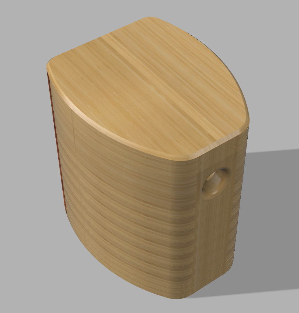

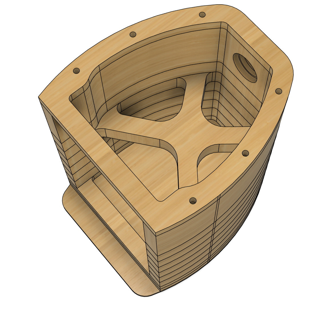

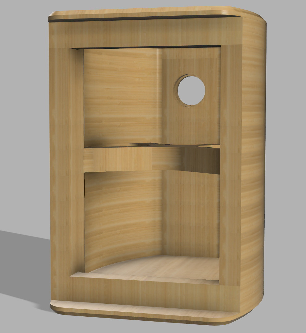

    It's going to be a 2 way design that's a little over .5 cu ft. He's requested a translam cabinet based on a build I did a number of years ago.
    Here are some renders that I did for him to reflect the general concept.

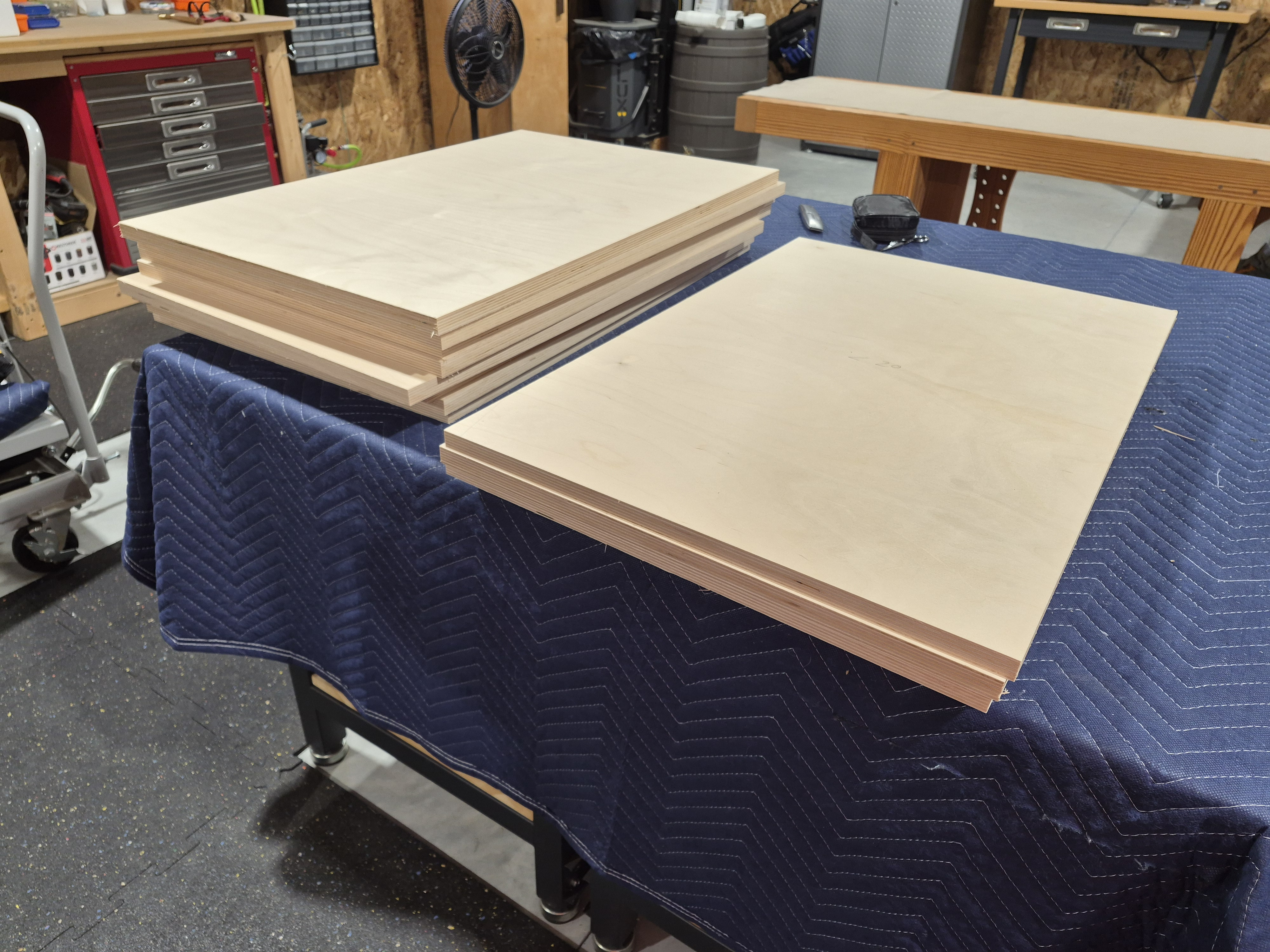

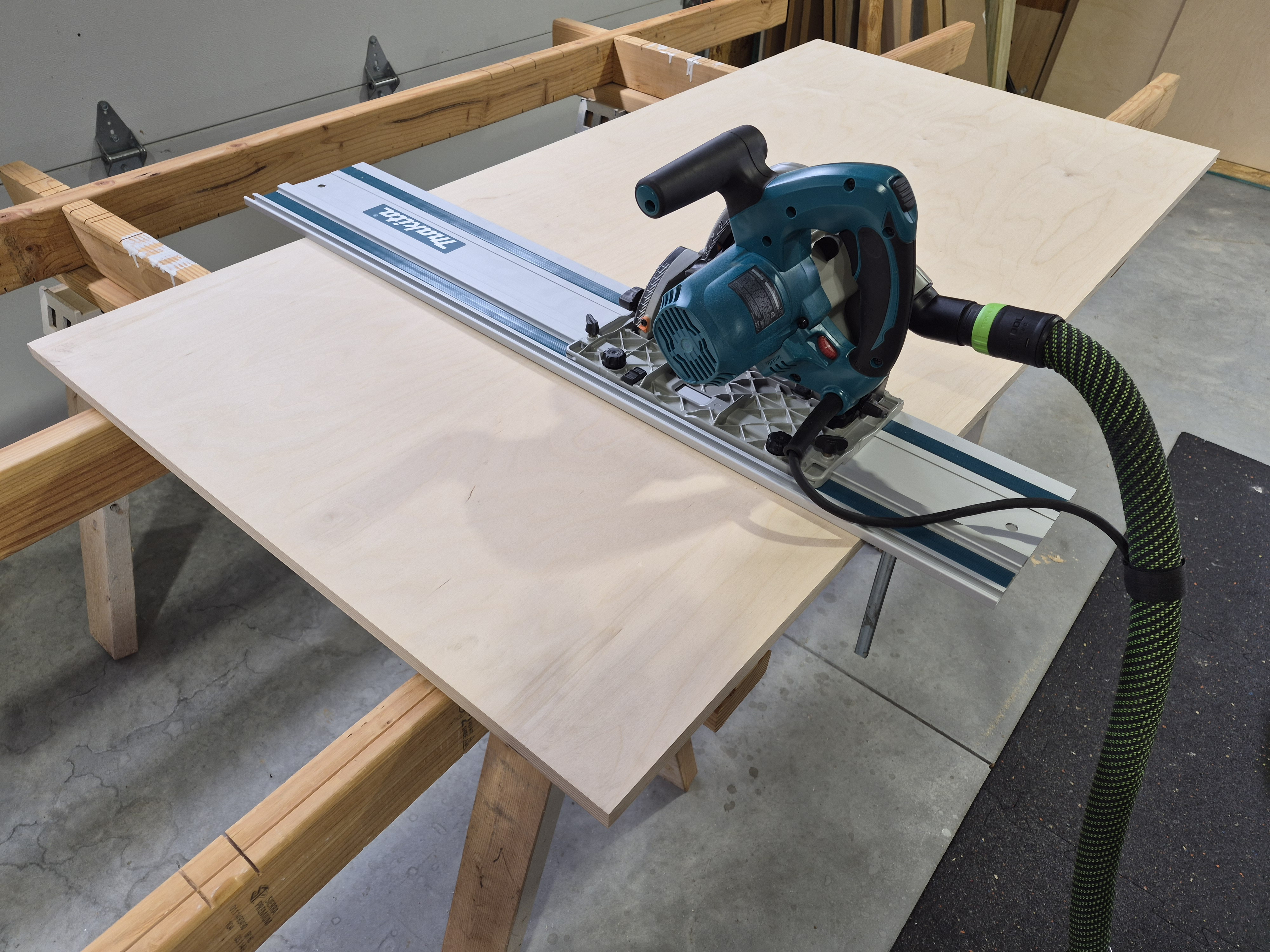

            The saw dust has started .....

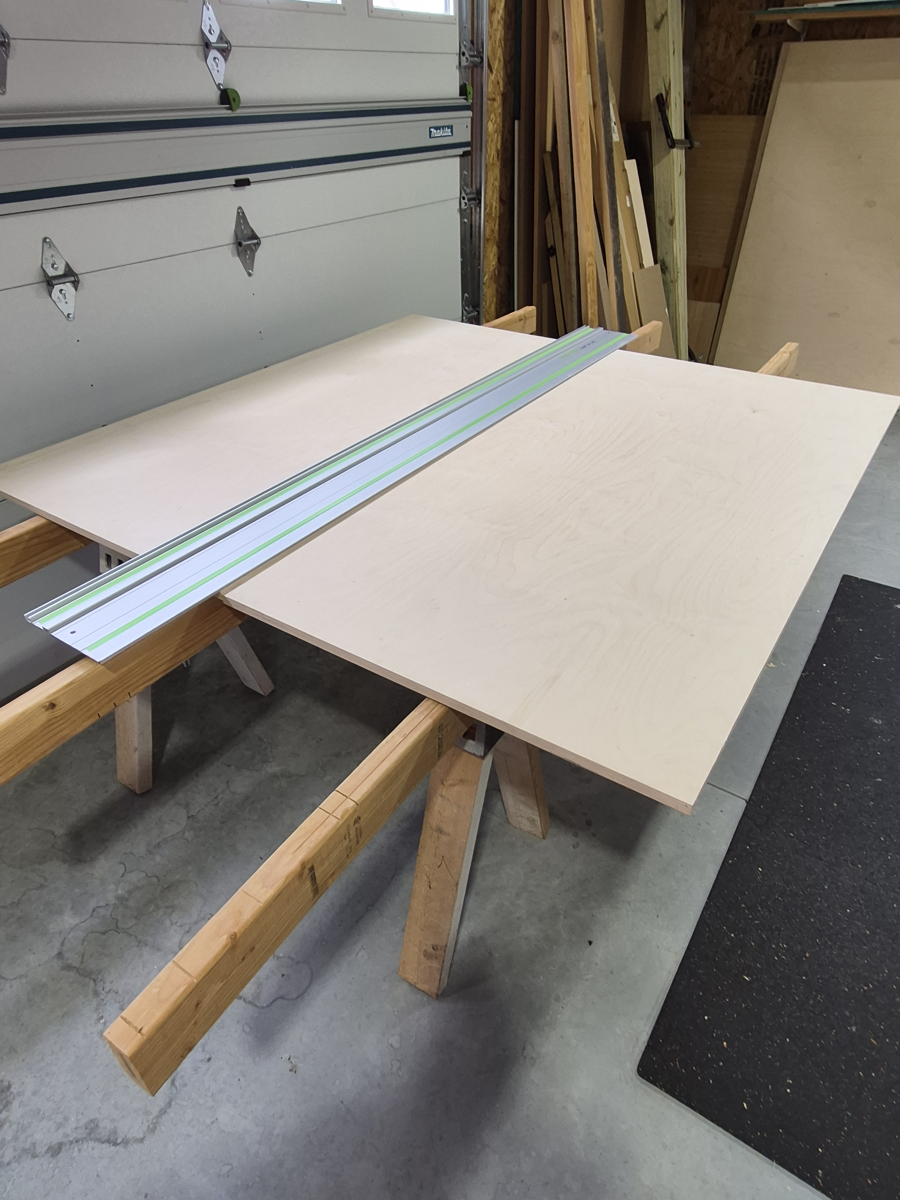

            Breaking down the full sheets of Baltic Birch for the CNC.

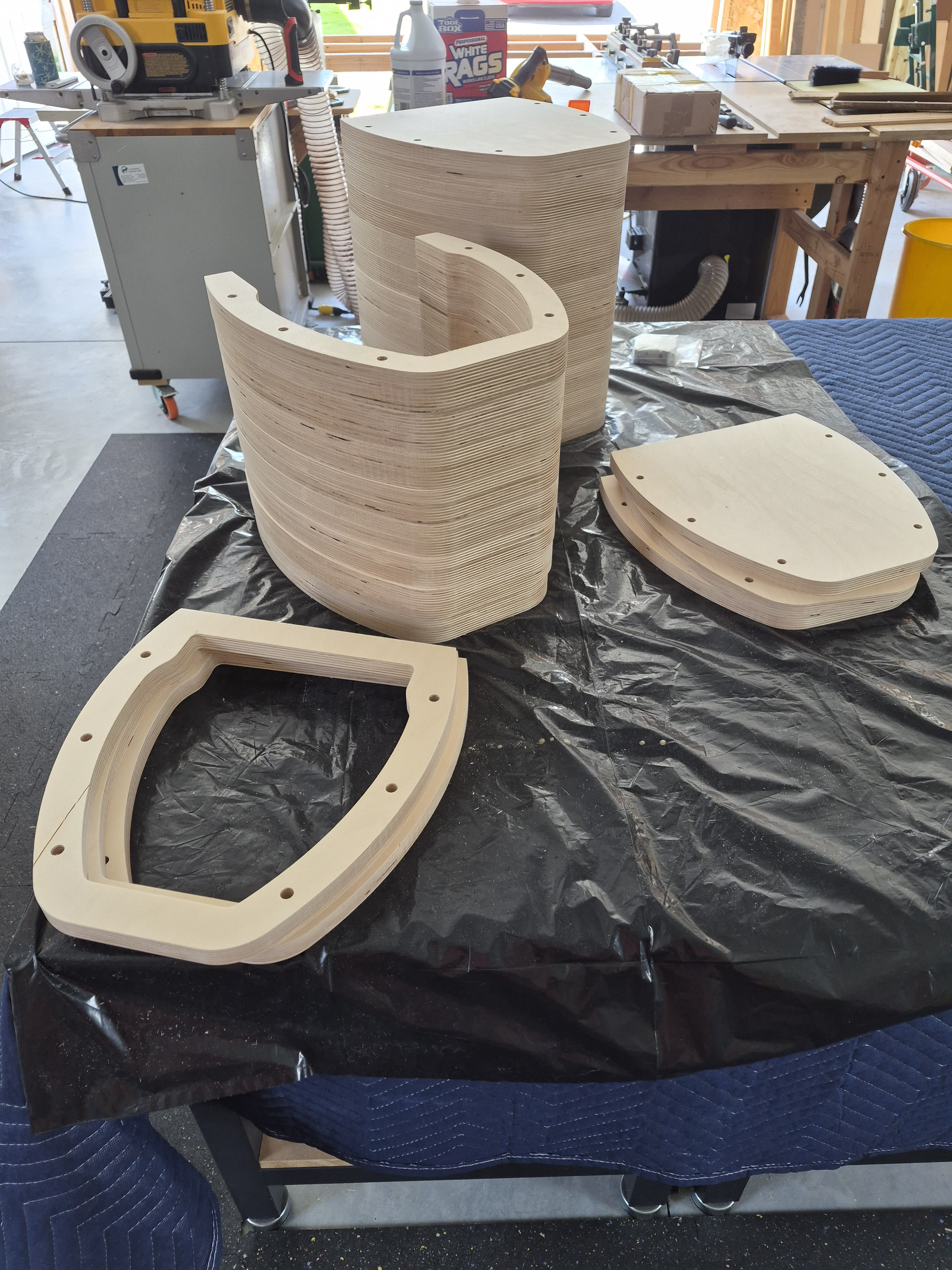

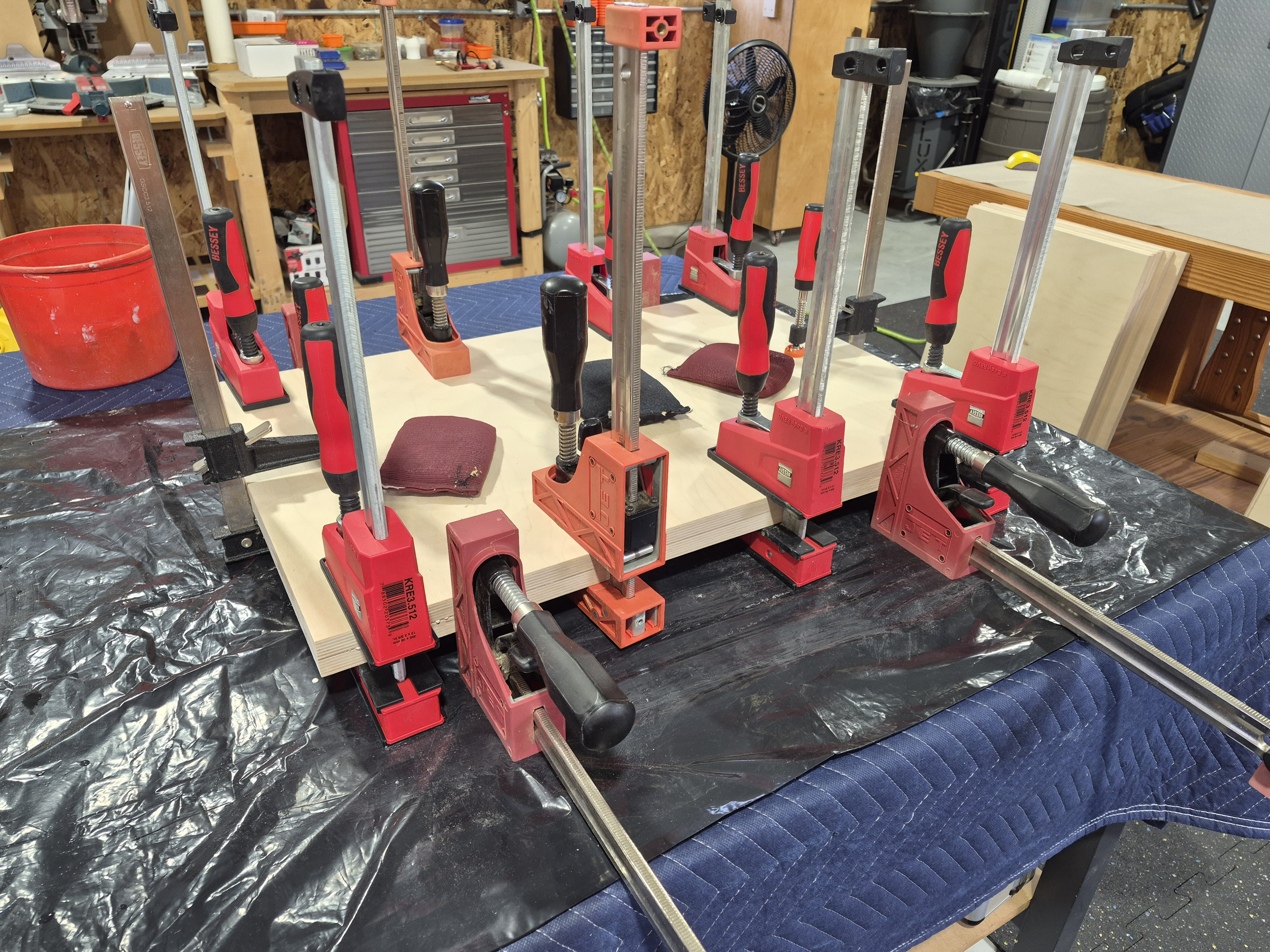

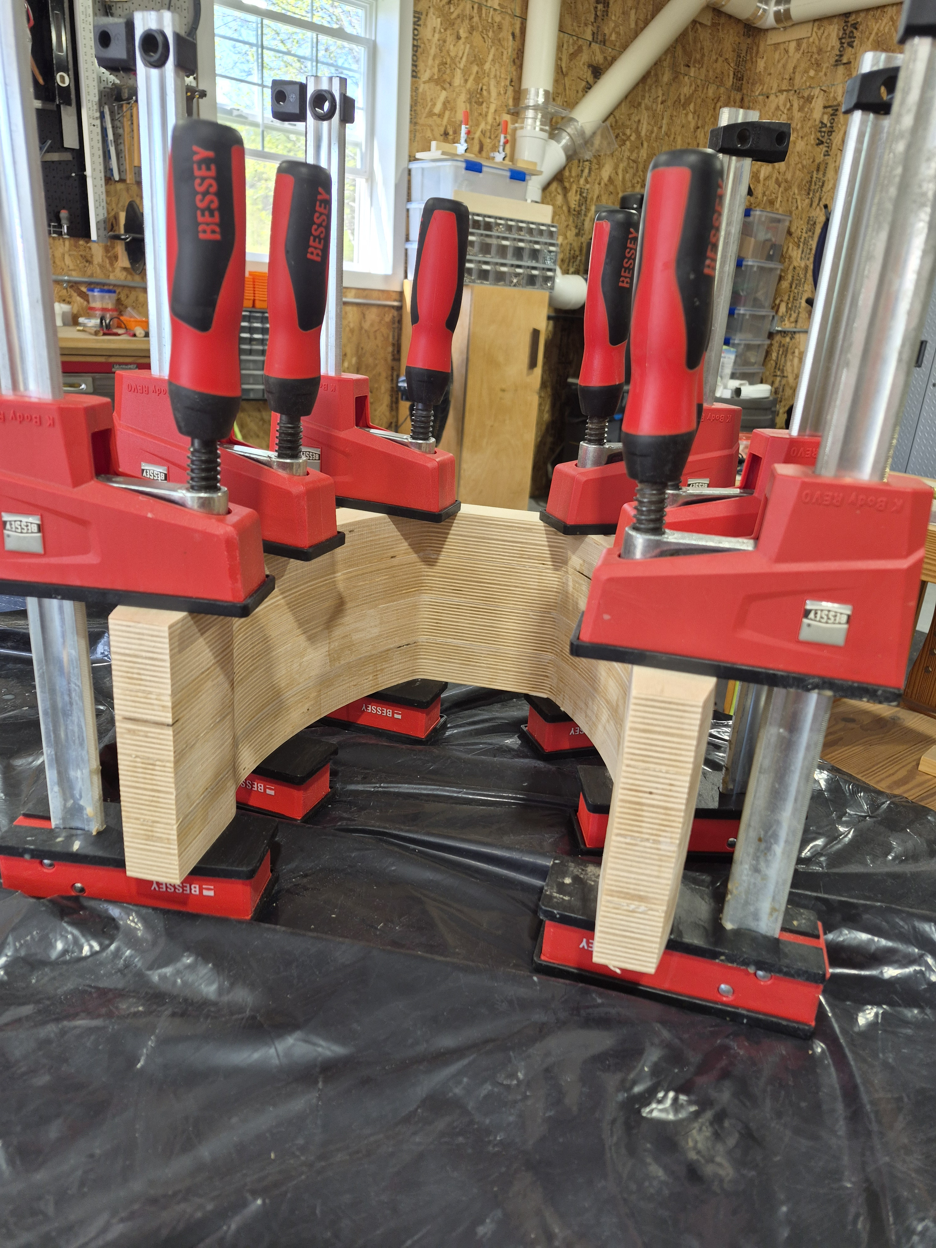

            Gluing up double thickness slabs for the ribs.

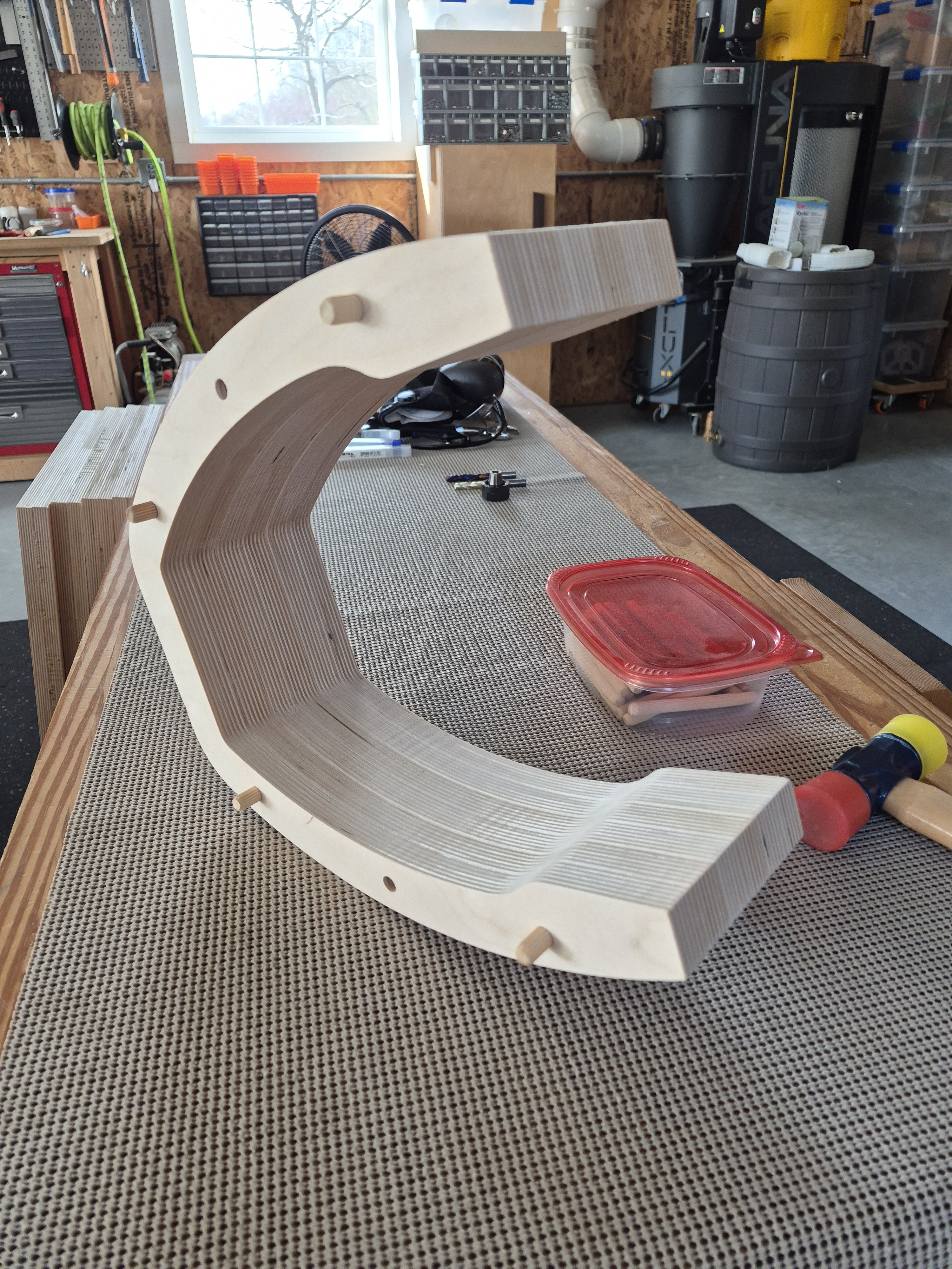

                • 2135

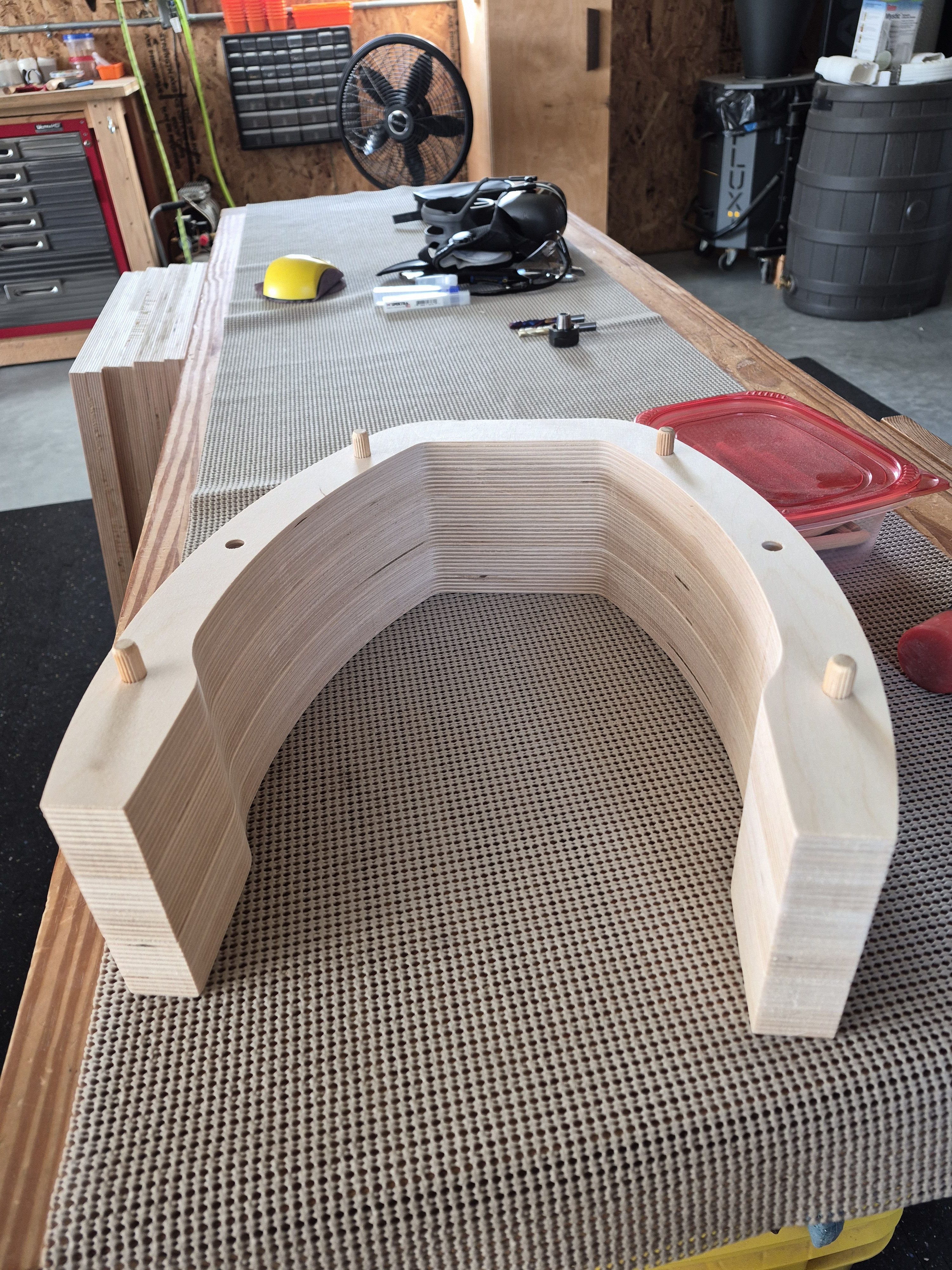

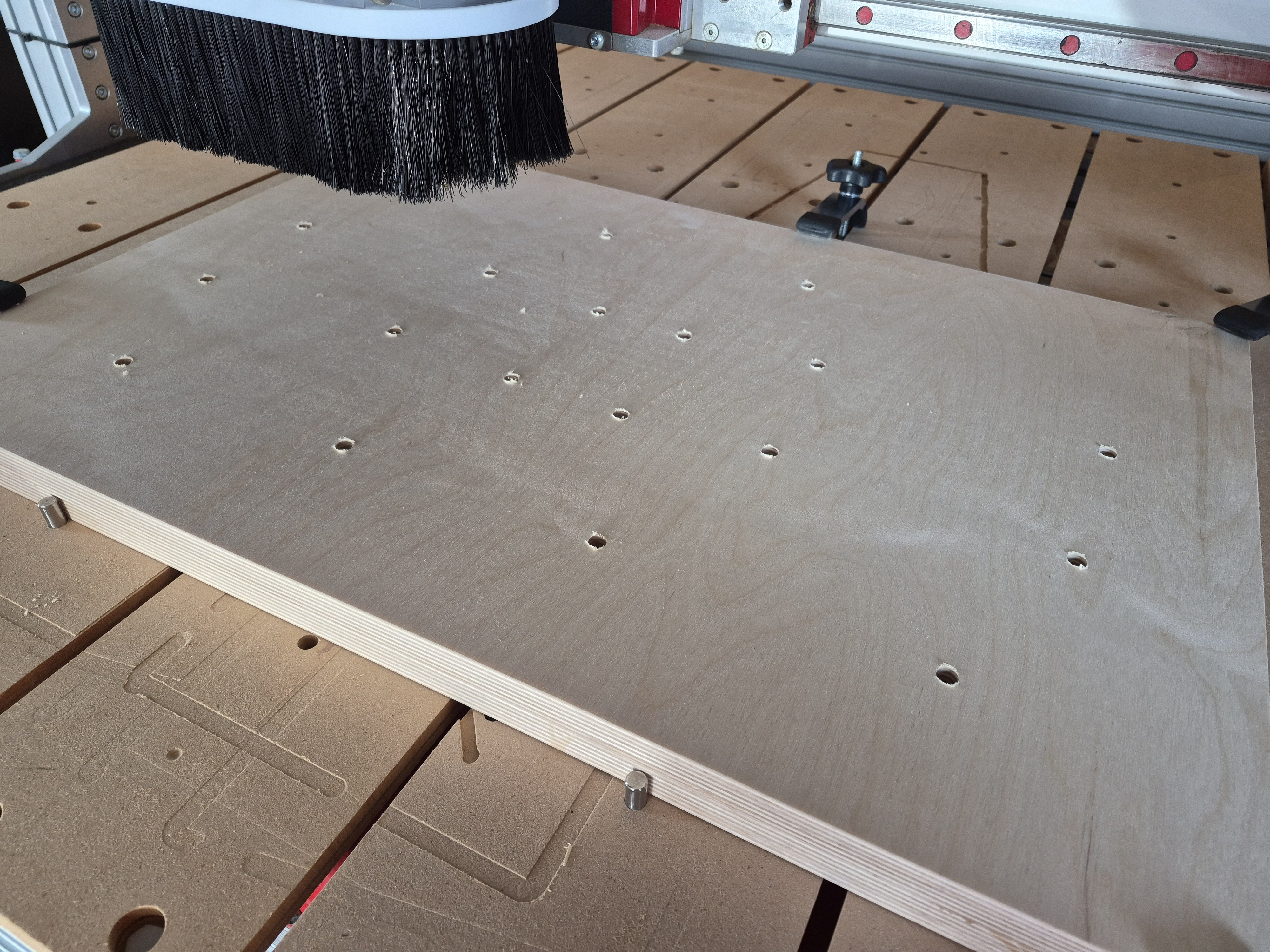

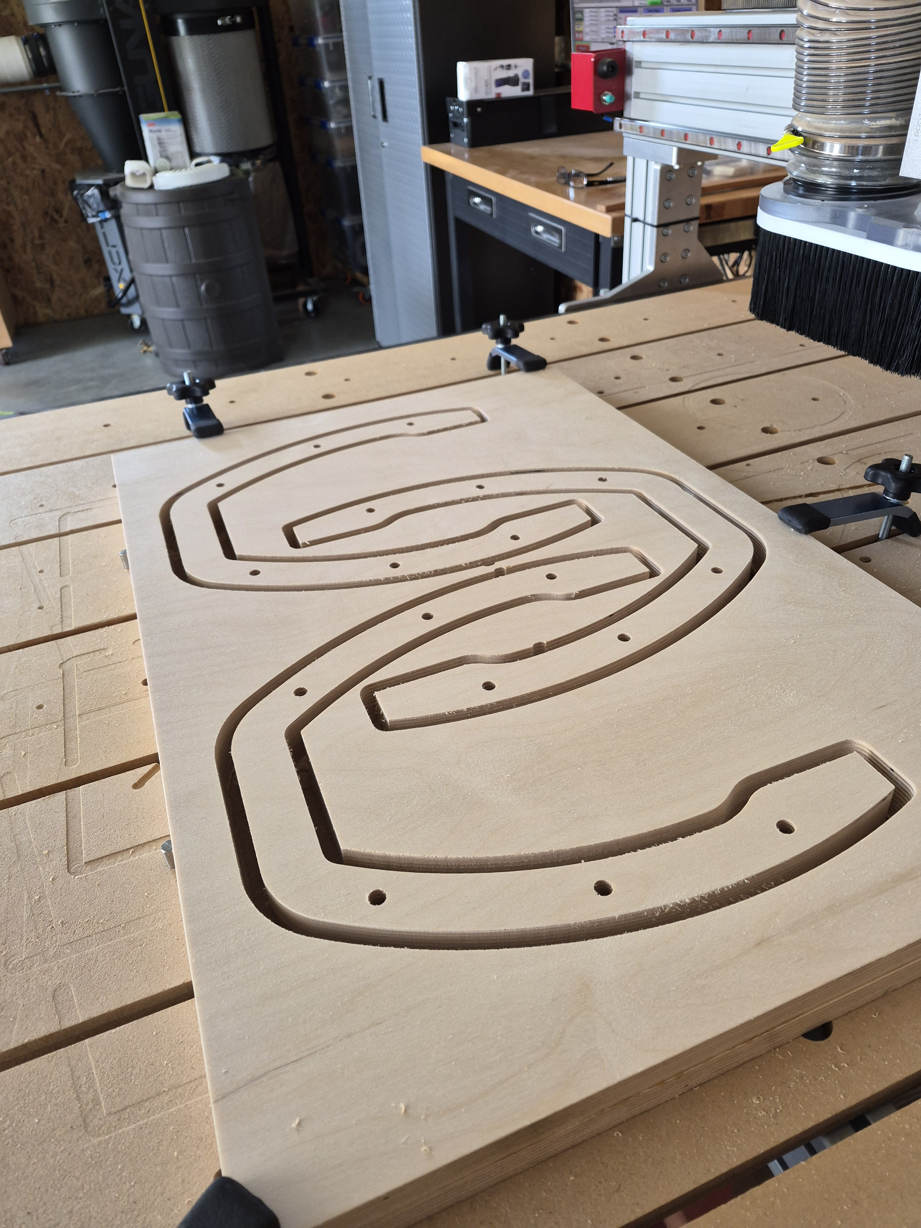

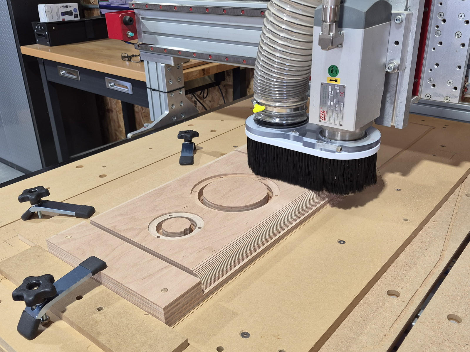

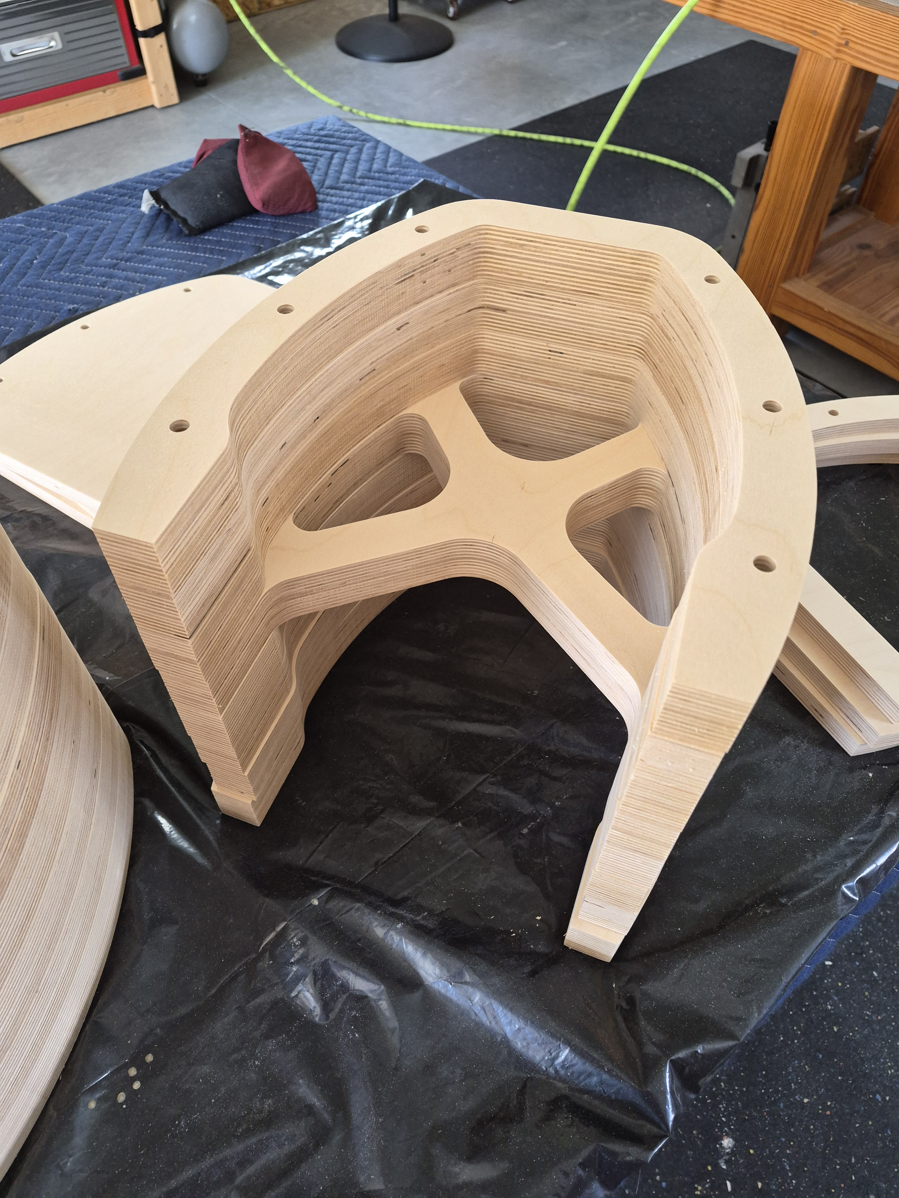

                Well speaking of Baltic Birch ..... I made some sawdust today with some.
                Got started on machining some ribs for the cabinets. First up were the dowel holes.
                Then the profiles.
                Prior to removing the tabs.

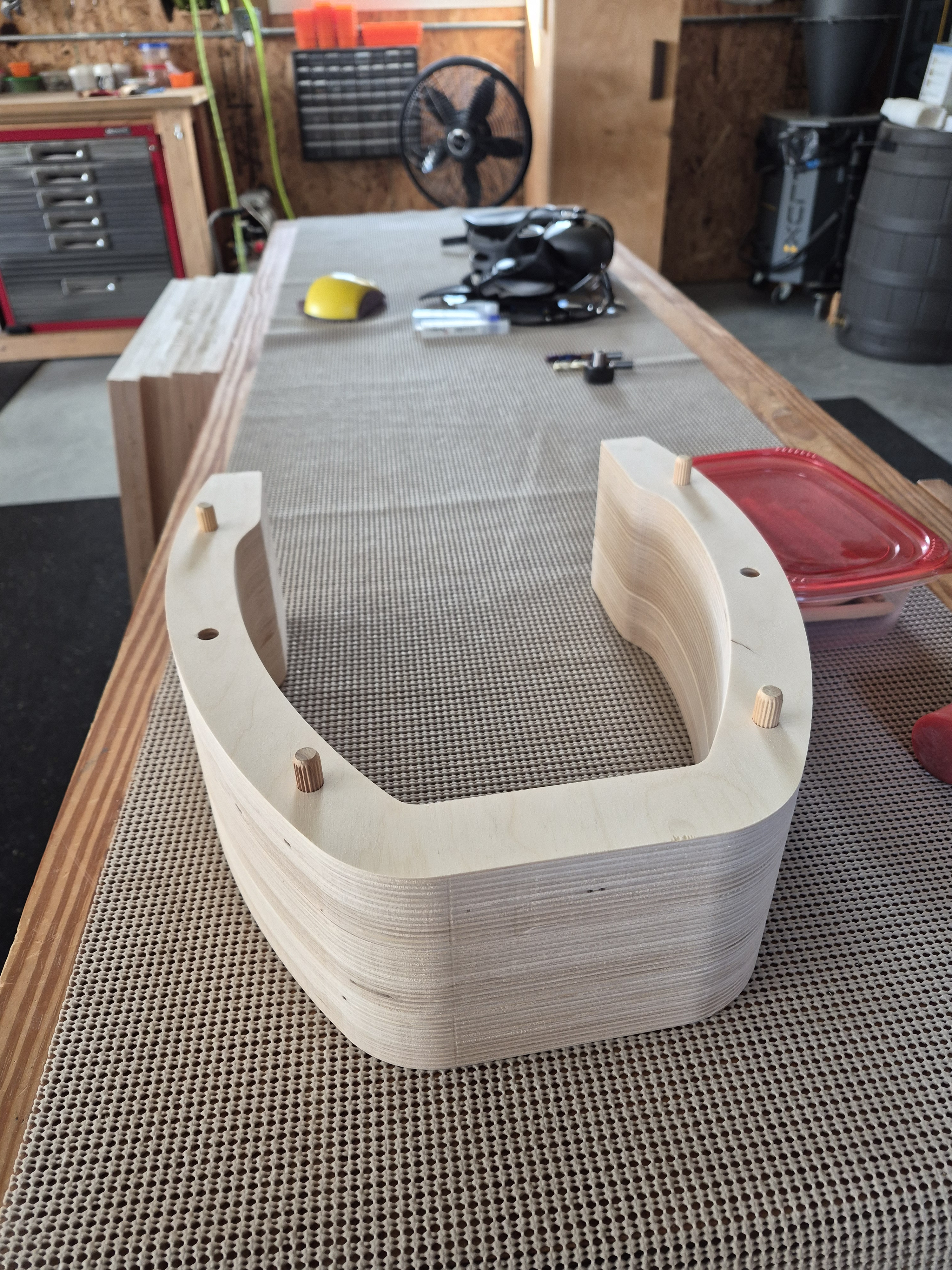

                Pinned the first batch together after some lite sanding.

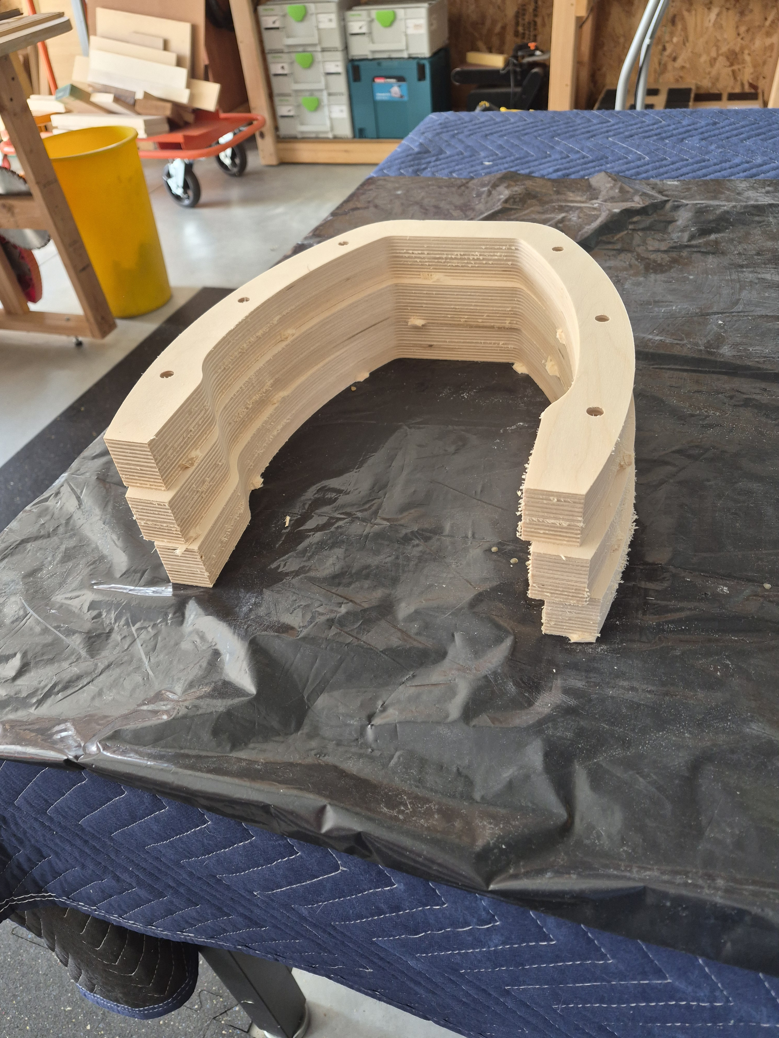

                  • 2135
                  Some progress to report. I have ~90% of the ribs cut at this point.

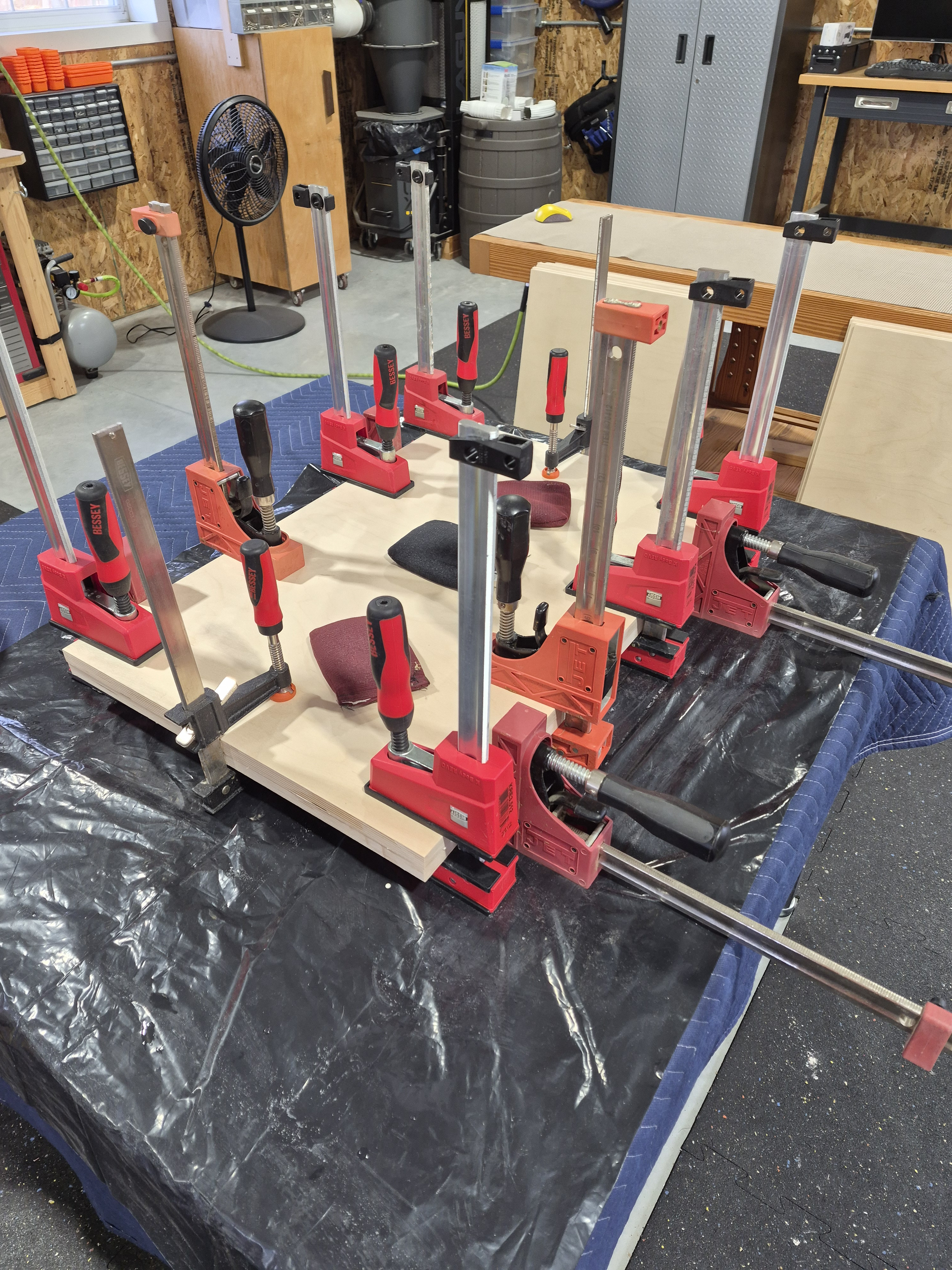

                  Even got started on gluing up the first batch of parts.

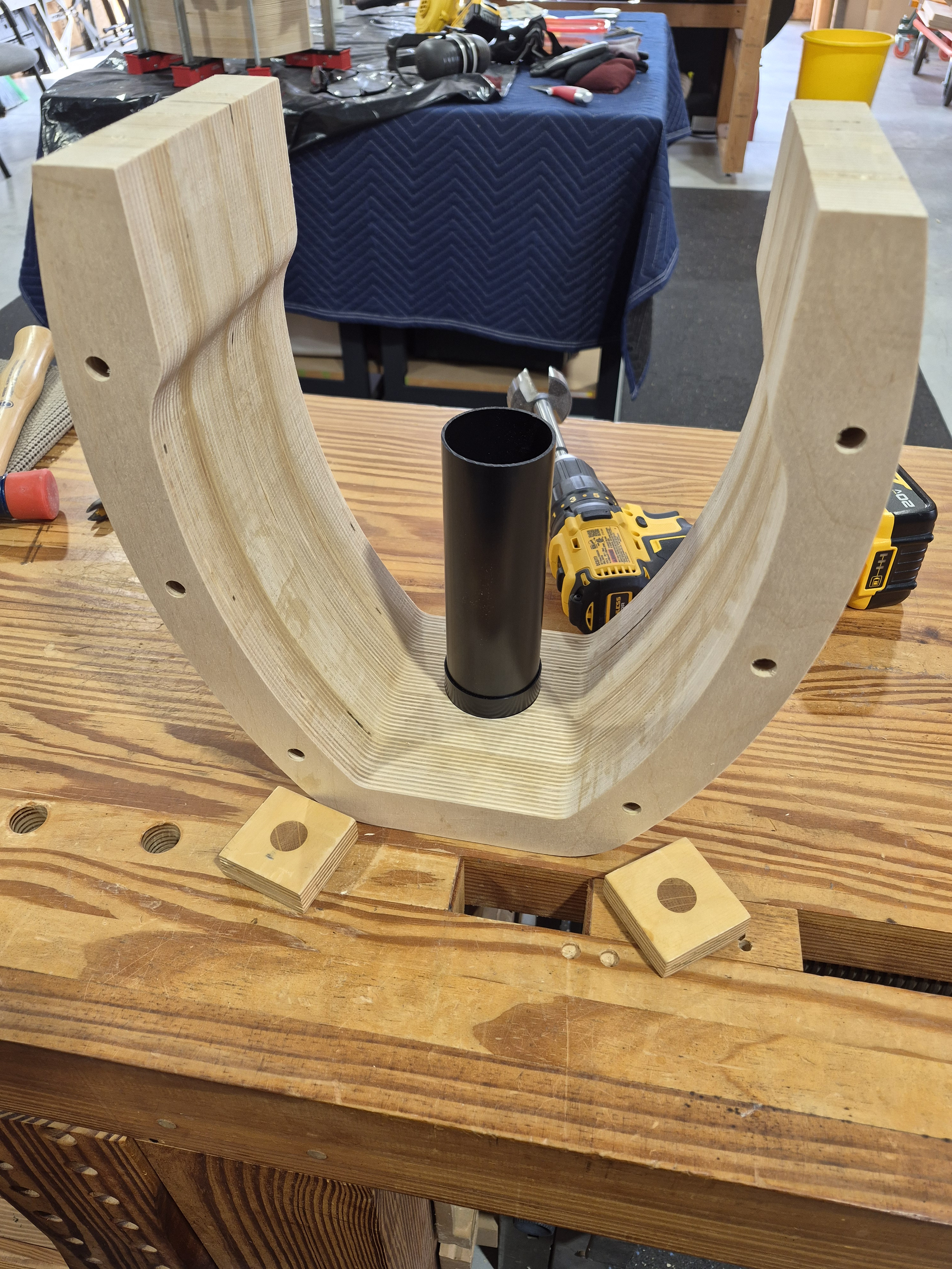

                        • 2135

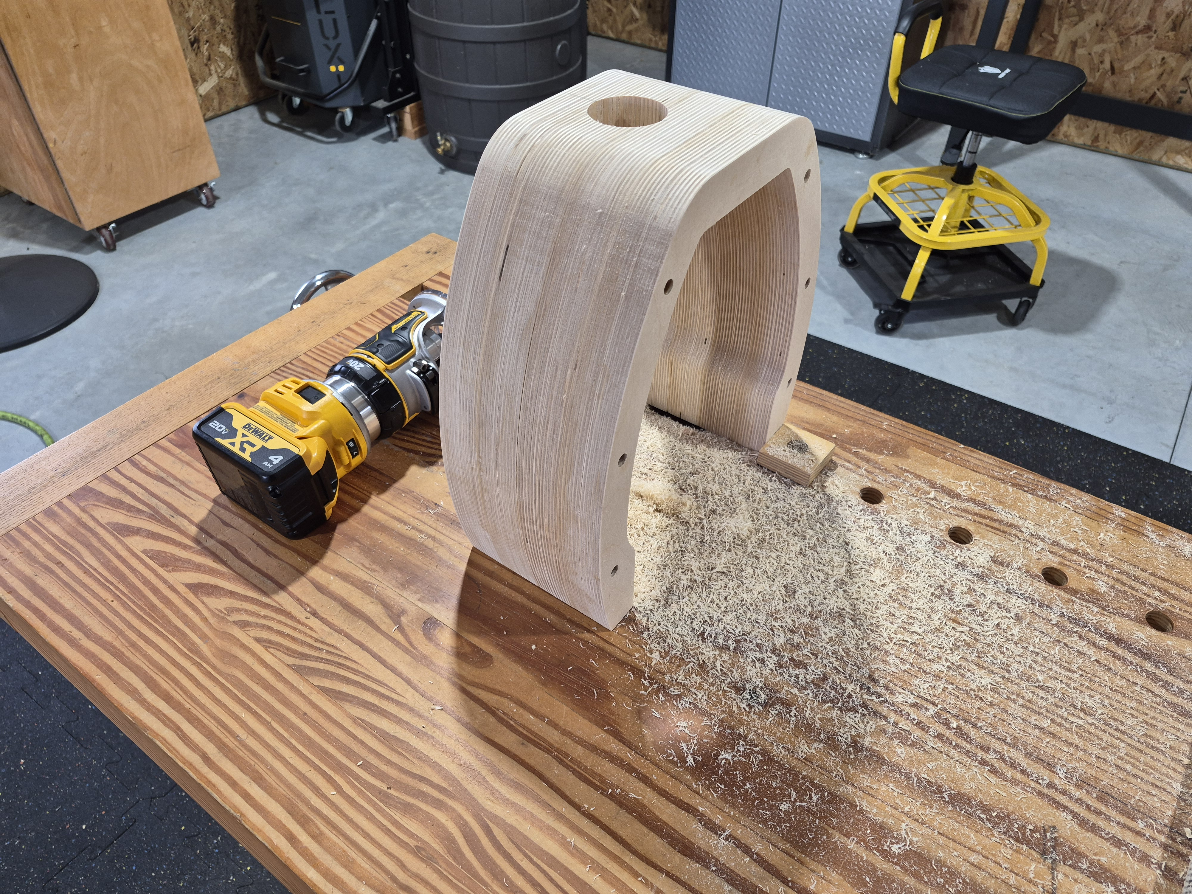

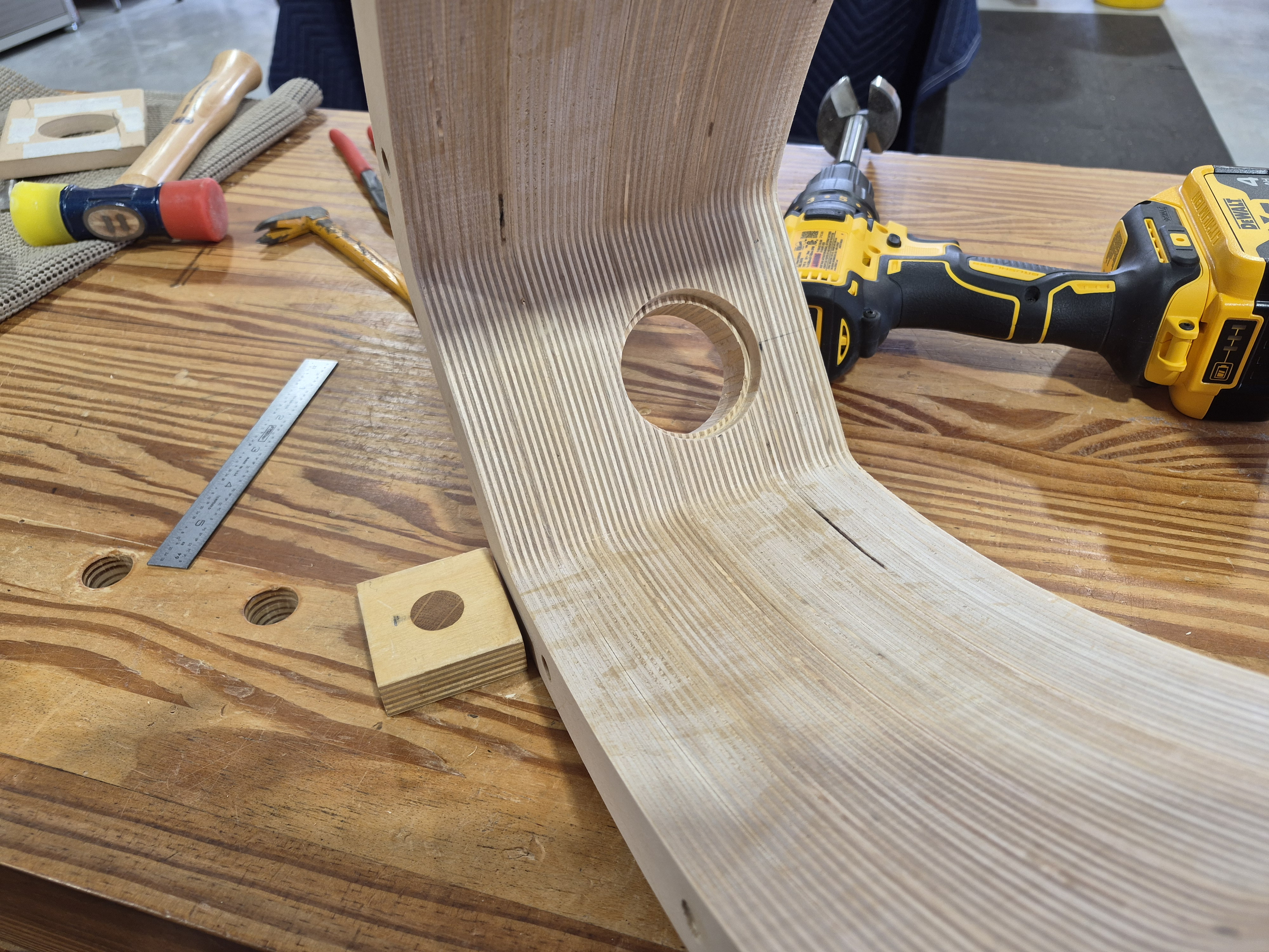

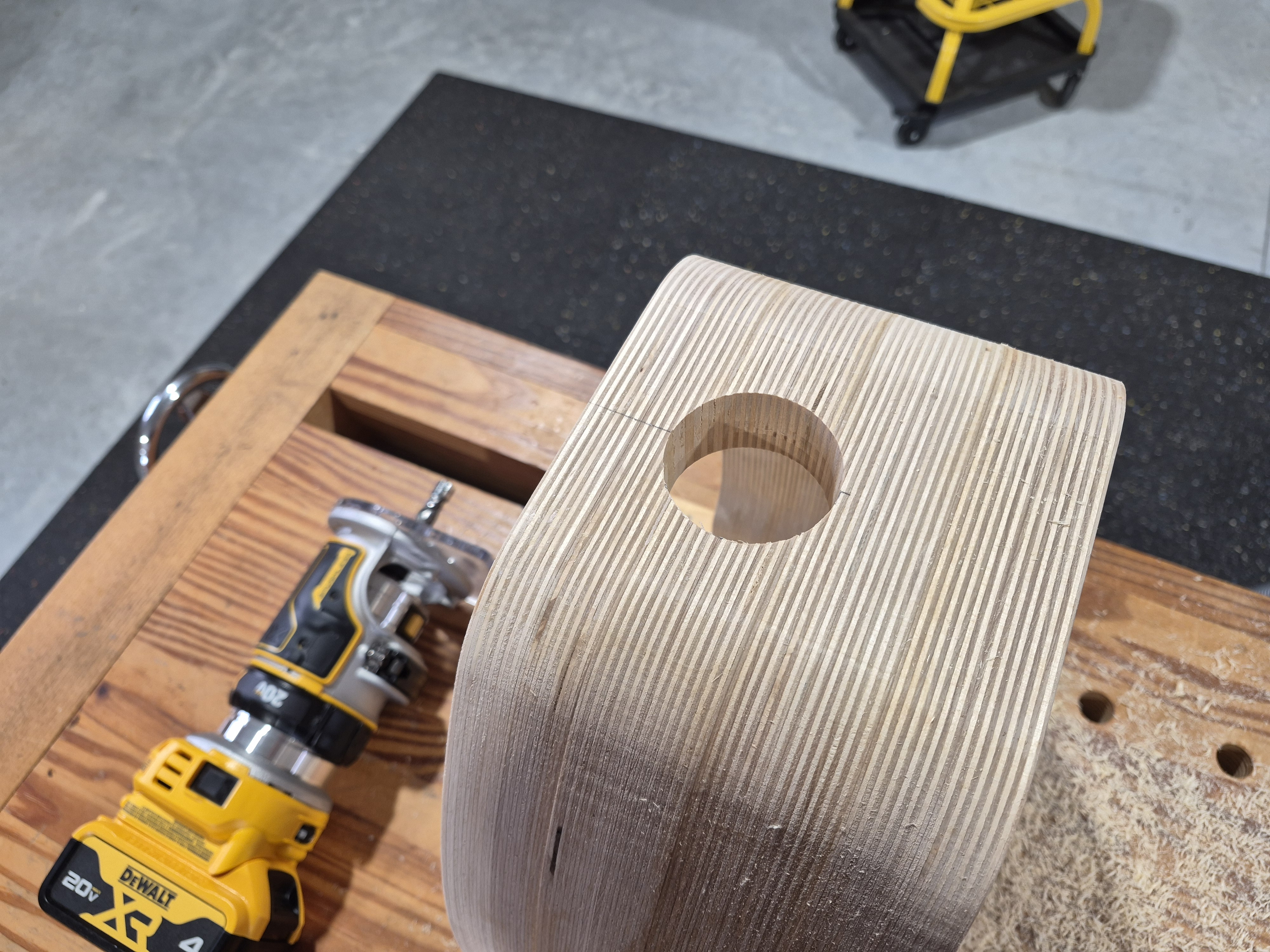

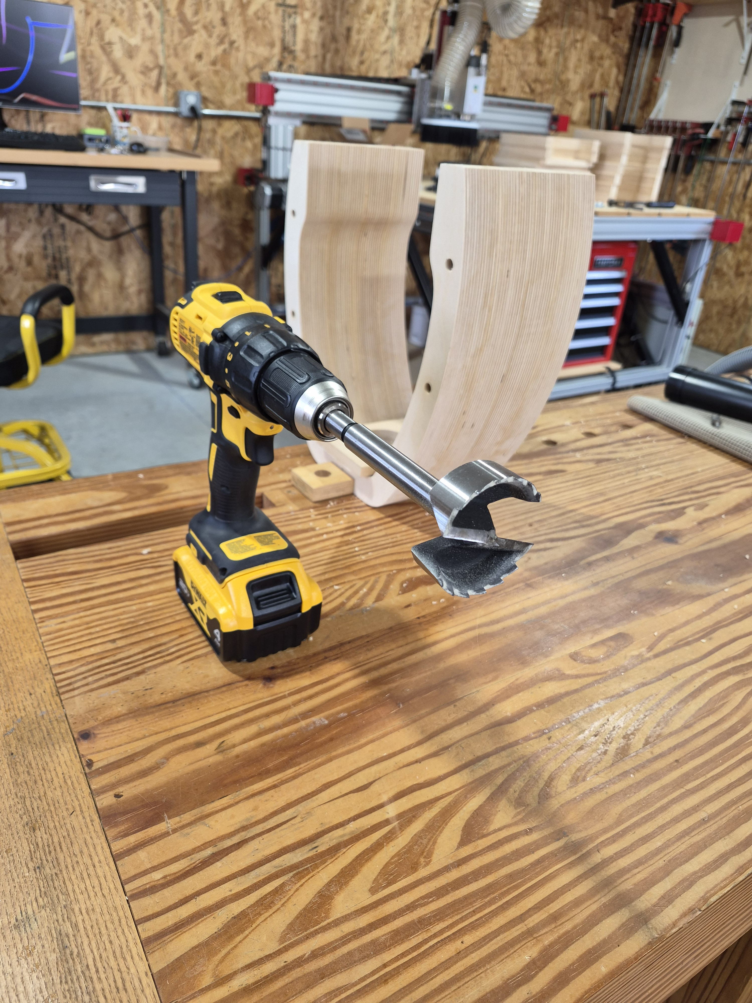

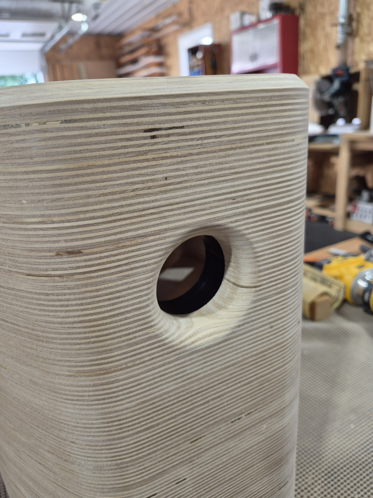

                        Speaking of ports, the one's for these cabinets have been requested on the rear of the cabinets.
                        I thought I could get this done with two different sized forstner bits. I quickly discovered end grain of Baltic Birch had something to say about that idea. More or less the middle finger! Even with a brand new bit it would barely cut the surface.
                        After much head scratching I went for a combination approach that required some templates and Jon's favorite toy, a router.

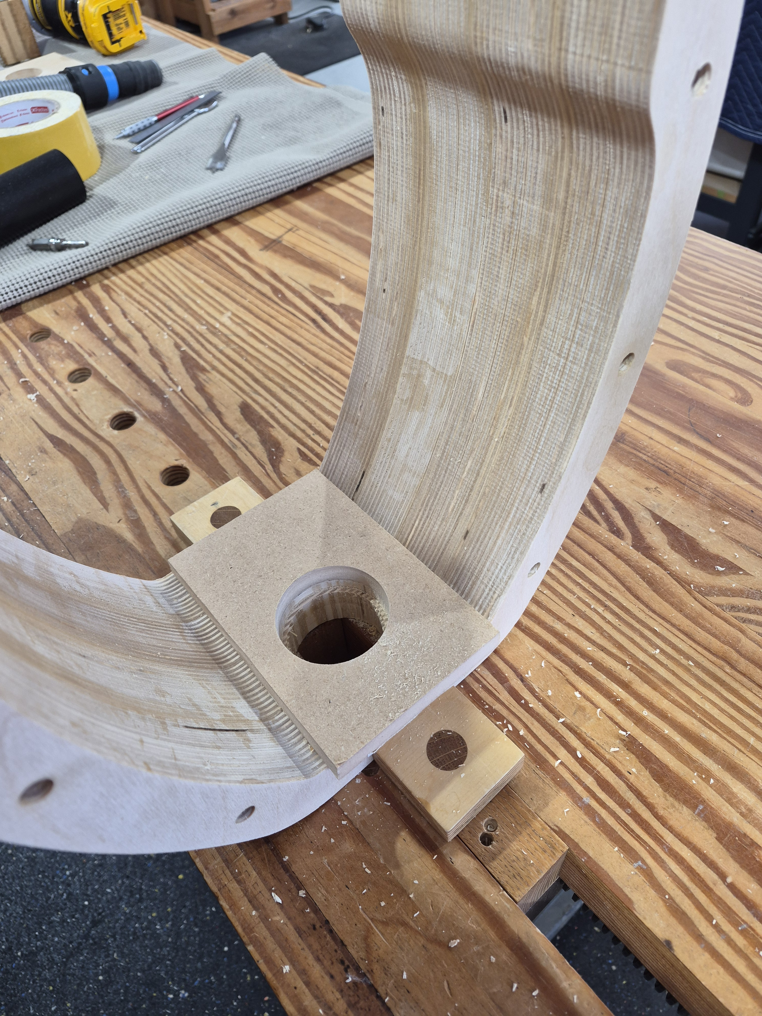

                        I had to increase the inside diameter by a 1/4" and used a template along with a forstner bit since the router would not fit.
                        Having removed most of the material allowed the forstner bit to handle the remaining material.

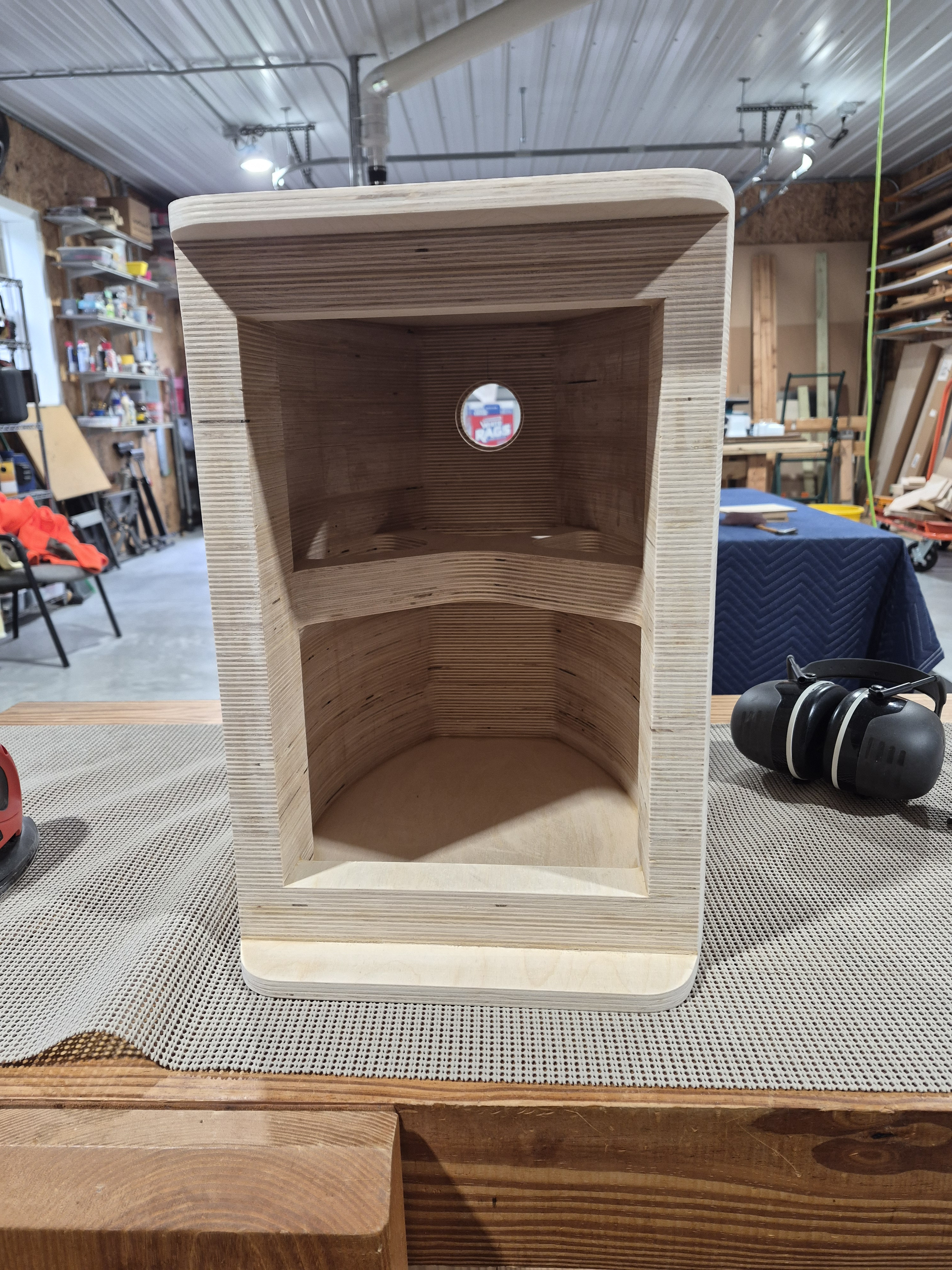

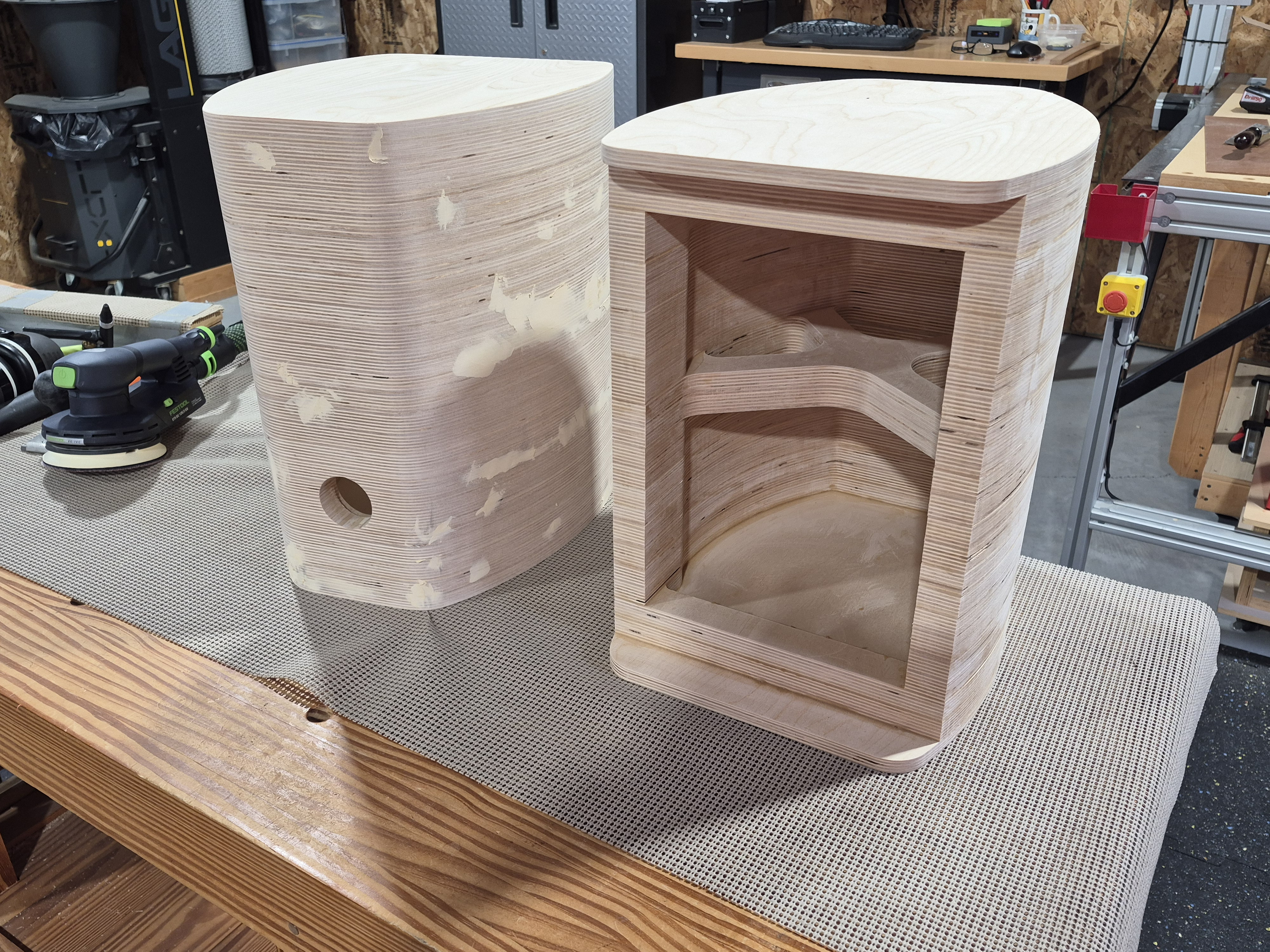

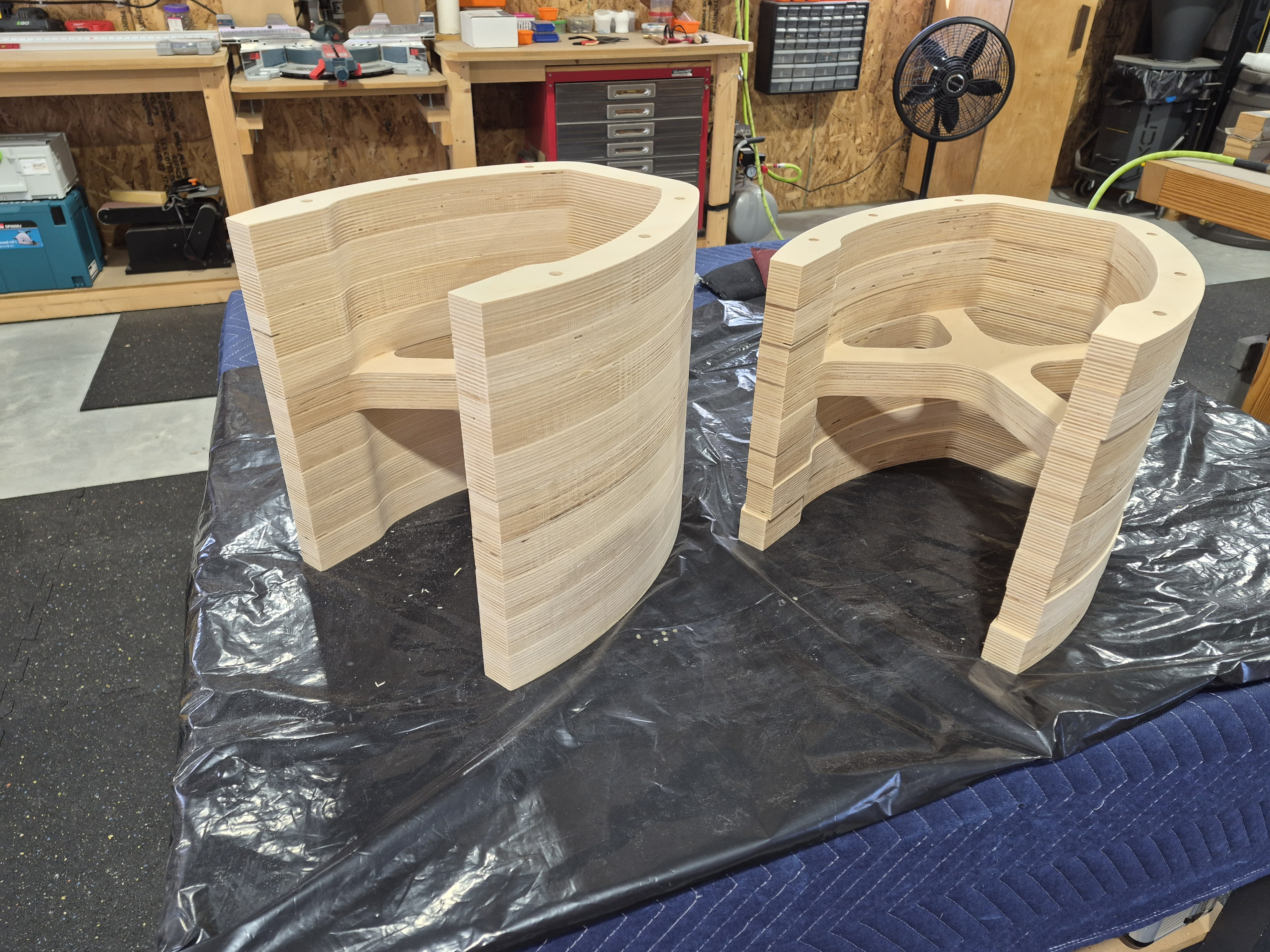

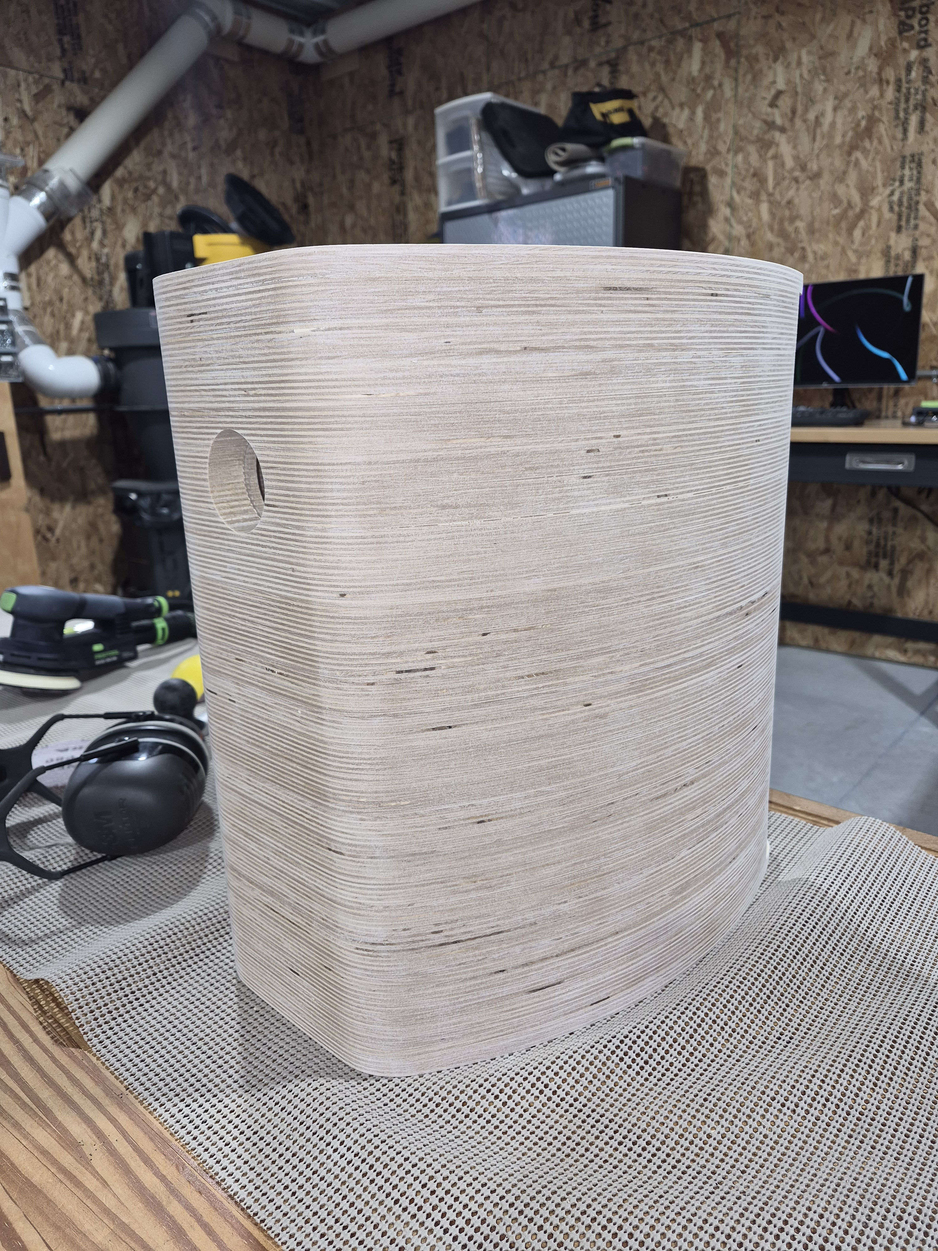

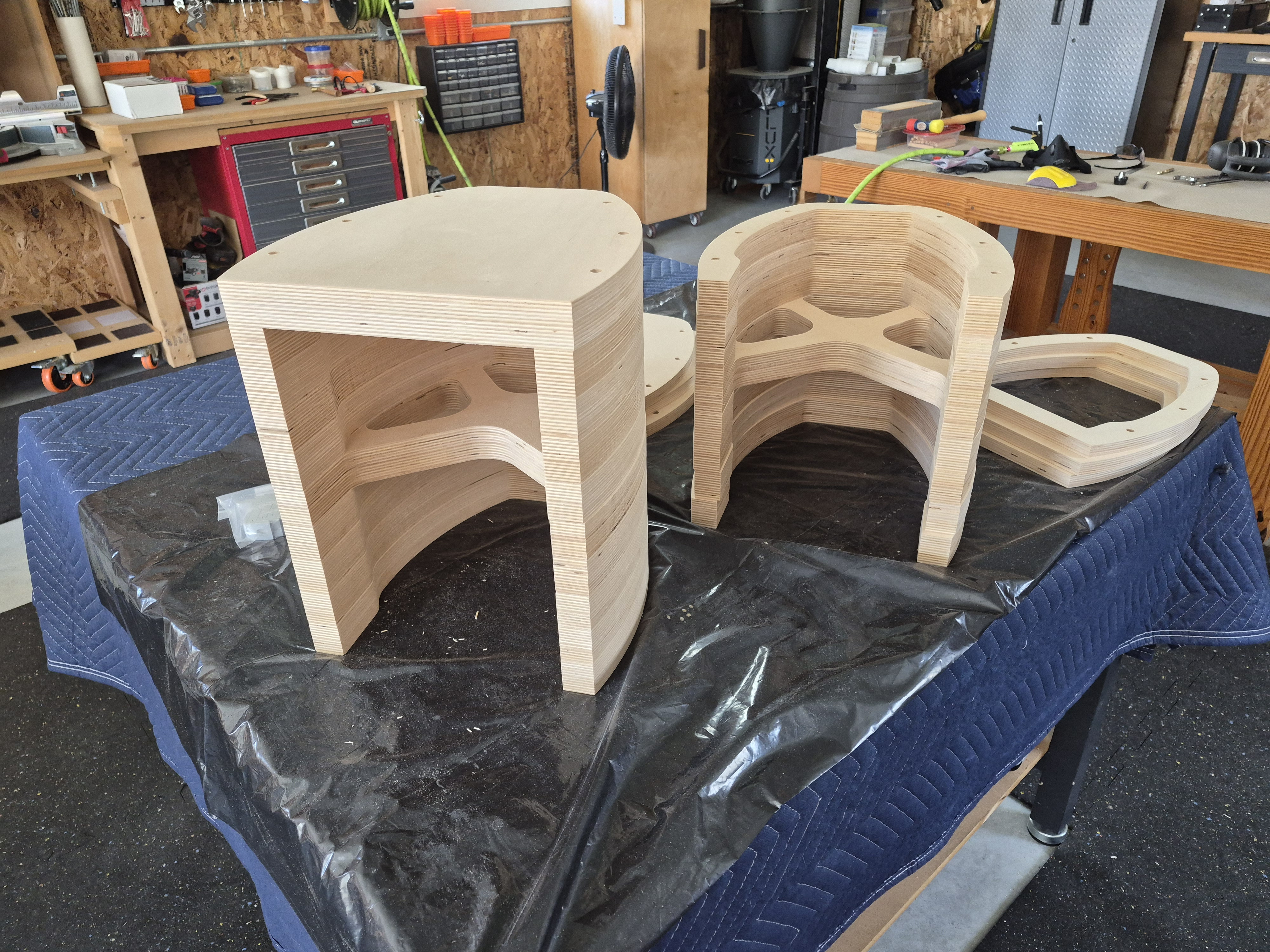

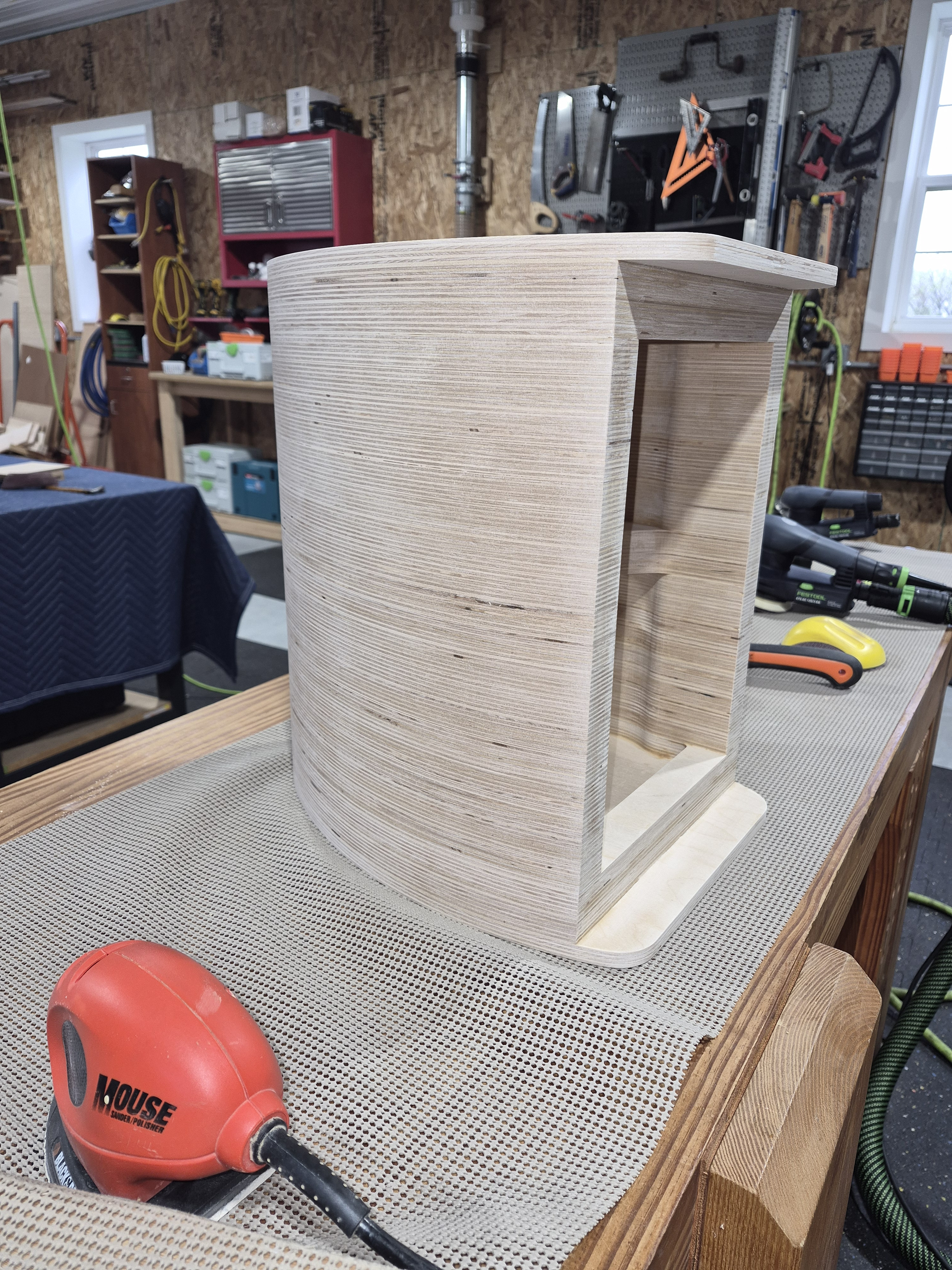

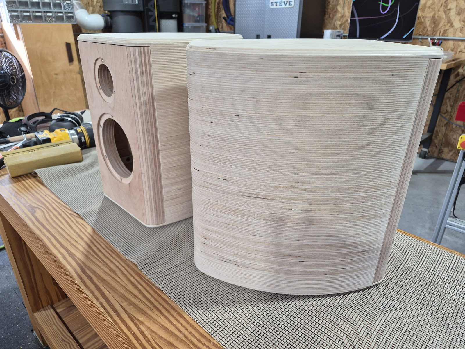

                          • 2135
                          Amongst other things, both cabinets have been glued up and some rough sanding has commenced.
                          First cabinet sanded to 120 grit
                          After the second cabinet is cleaned up, baffles will be next on the agenda.

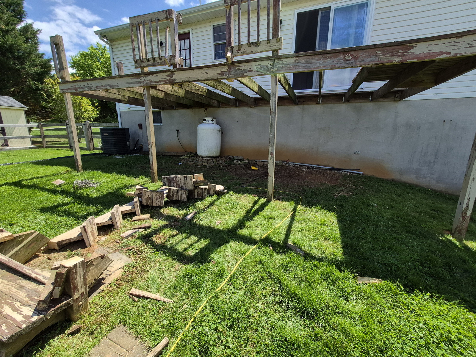

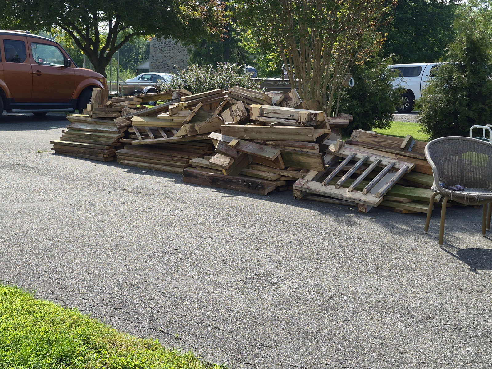

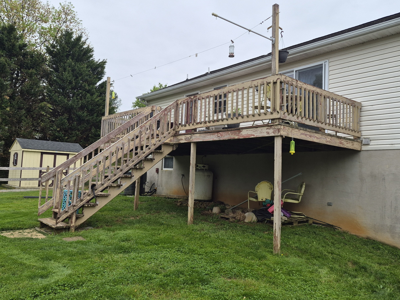

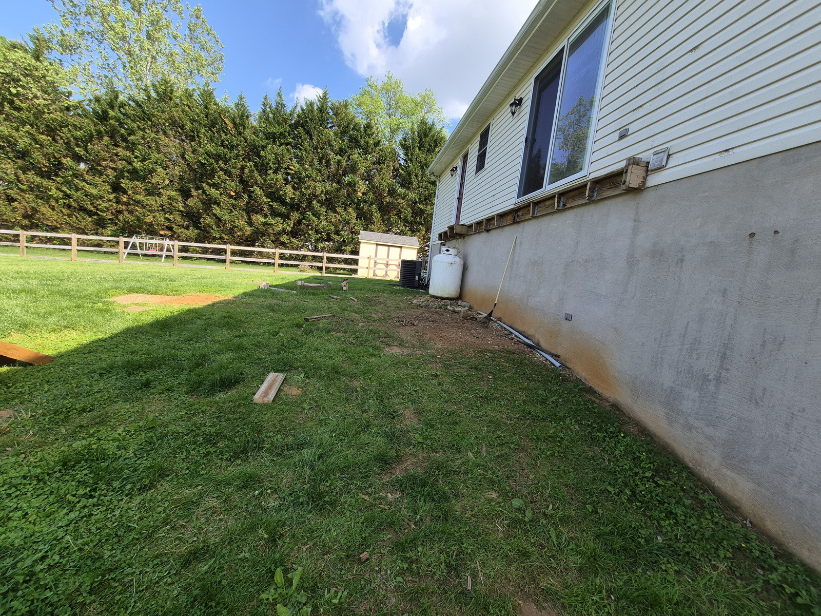

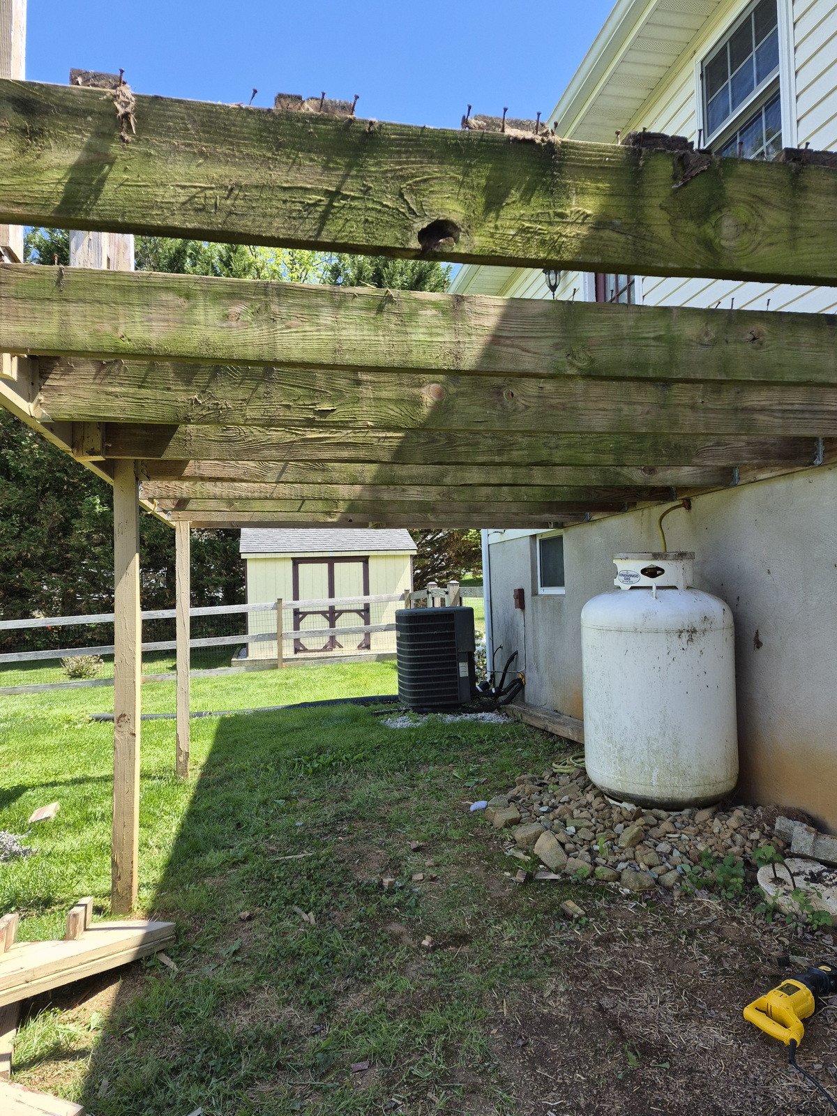

                              Well it's been a bit since I made an update. The why of it as Jon likes to say ..... life got in the way of plans!
                              First issue being having to replace a deteriorating deck. I don't know how long the deck has been around, but it was becoming unsafe.
                              Saved some money doing the demo myself though now the deck place is refusing to remove the material after implying they would. Customer service sucks these days!

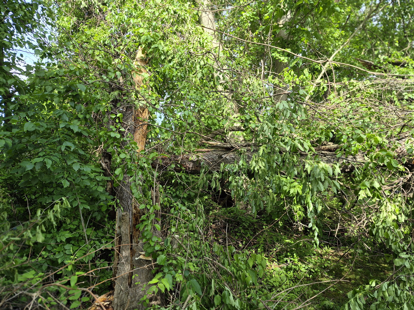

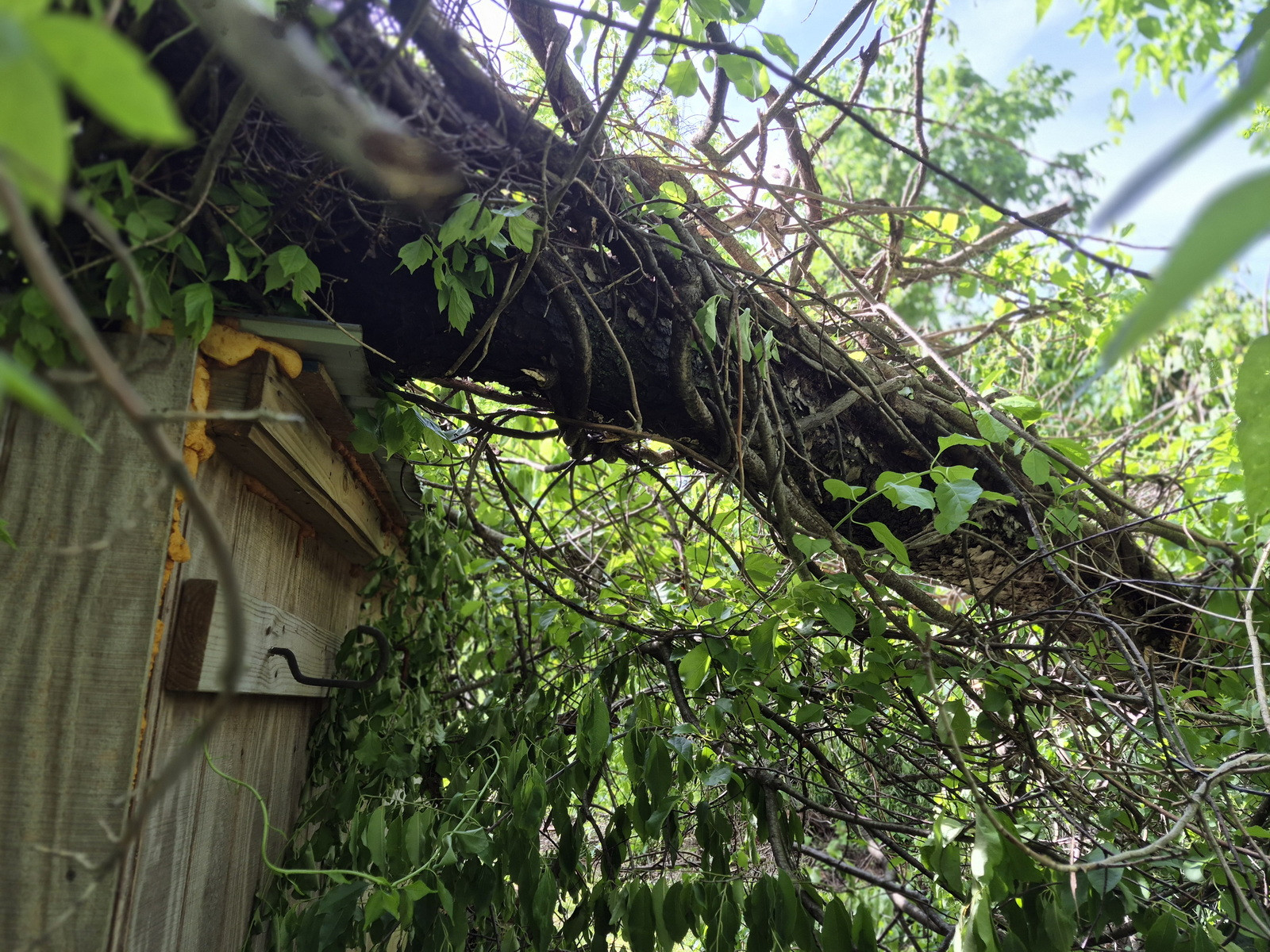

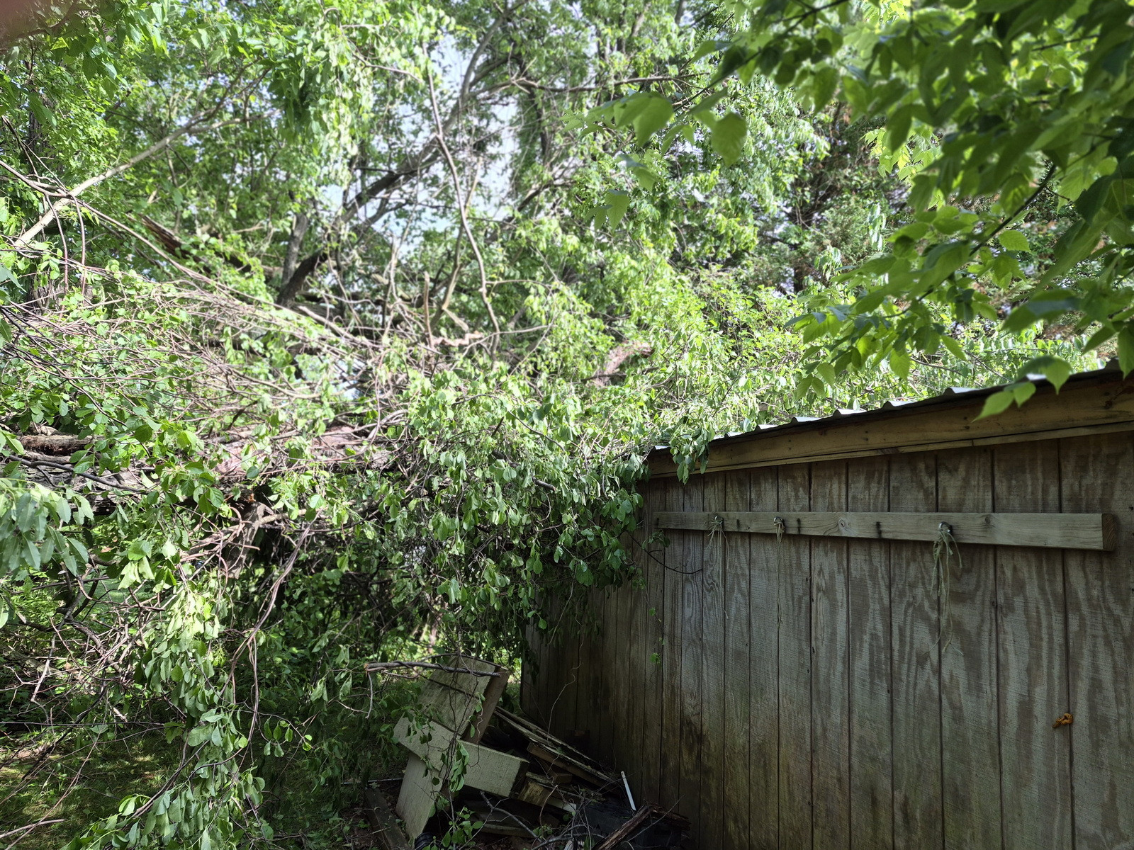

                              The next fun event in the queue was a mother nature special ......
                              This tree is ~12" in diameter and came down on top of our large shed punching a hole through the roof. Temporary repairs have been made to keep most of the water out until I can get the tree cut down.

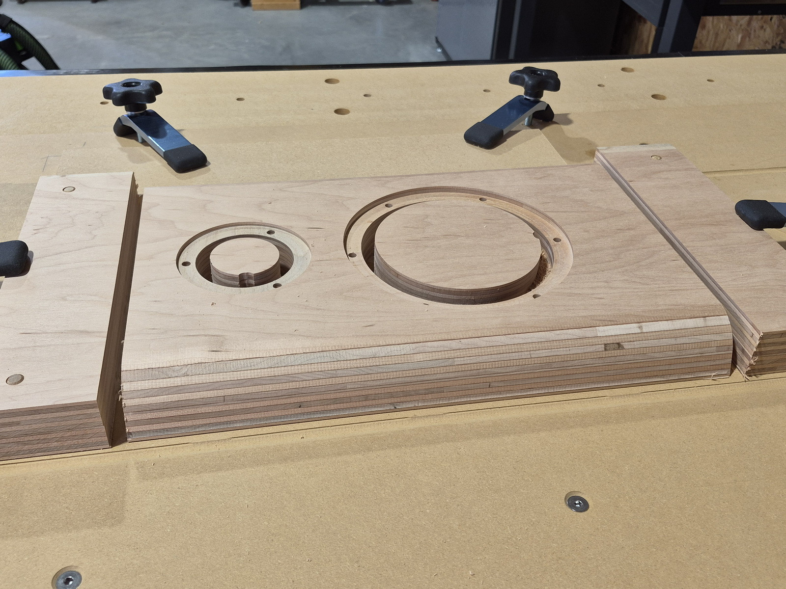

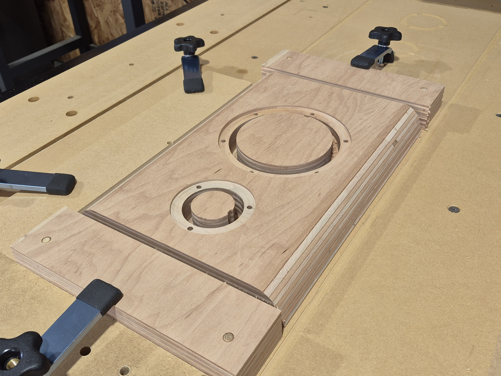

                                So, besides all that mess, I was able to get some shop time in over the last couple of days and have fabricated the speaker baffles.
                                This was an "interesting" exercise with the board being only 0.025" wider than the finished baffle needed to be. Though this rock maple is nice to machine I'm not a fan of the board sizes that it comes in.

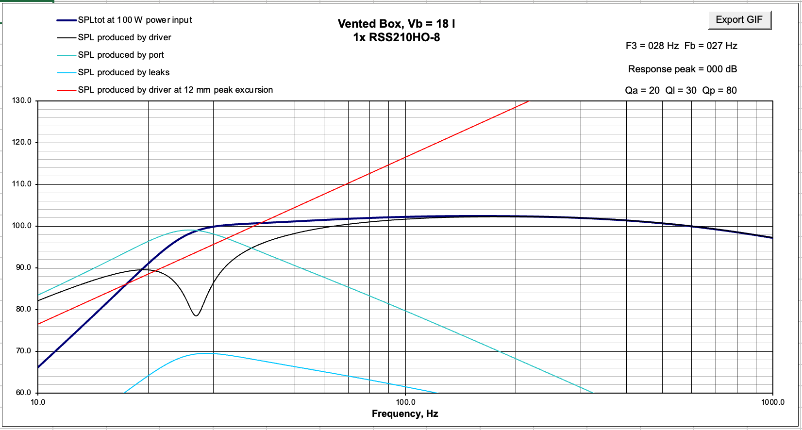

                                  I love the light scent of maple saw dust in the morning, in the afternoon, and just about any time of day!
                                  Of course, I'm thinking of PuriFi related things that could be done with enclosures like this...
                                  But then, ET just sent a mind probe, and pointed out that in this volume or just 2L more, an RSS210HO-8 with DA32TX-008 could produce 100 dB from 30 Hz on up... and implanted a UniBox example showing how...
Name:	Unibox 18L RSS210HO-8.png

                                    Only one minor issue with using the an 8" driver .... one would have to redesign the baffle and cabinet since the driver is too big to fit.
                                      • 1554
                                      Eh, that tree looks fine where it is. More speaker building please!
                                        • 16120
                                        How about a 7.5" driver then? I figured that might be the case... I'm just thinking in terms of things that would be relatively affordable. But given our "stock" of 6.5" PuriFi drivers, this is worth looking at.

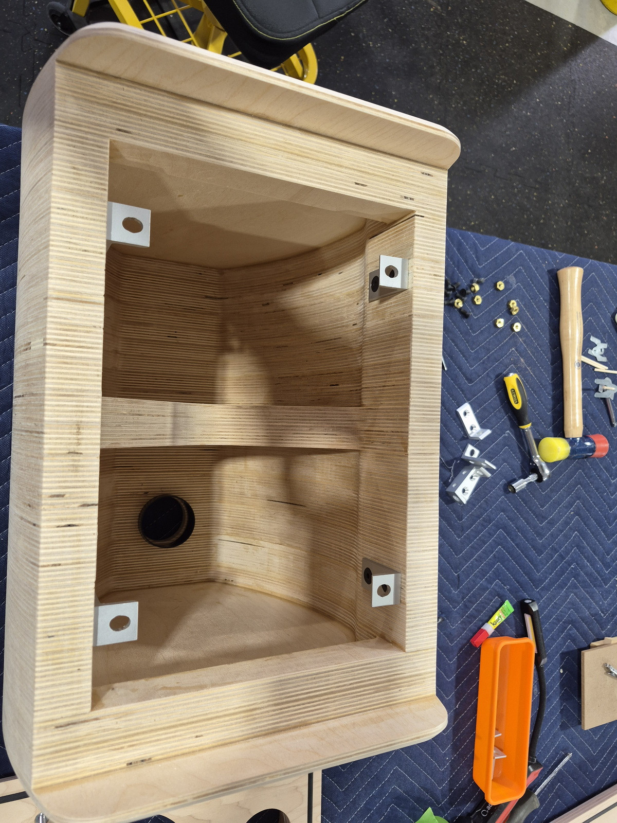

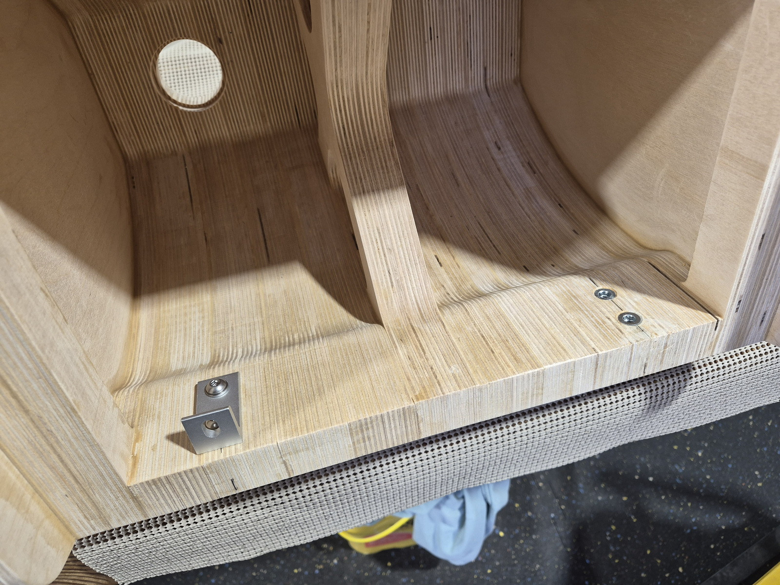

                                          Well it's been a minute ..... the rebuilding of our deck turned into a royal cluster &^%$##@#! As such I was not in a proper frame of mind to work on speakers. Now that is over work on speakers has resumed.
                                          Of course everyone's favorite, installing threaded inserts, along with angle brackets to attach the baffles.

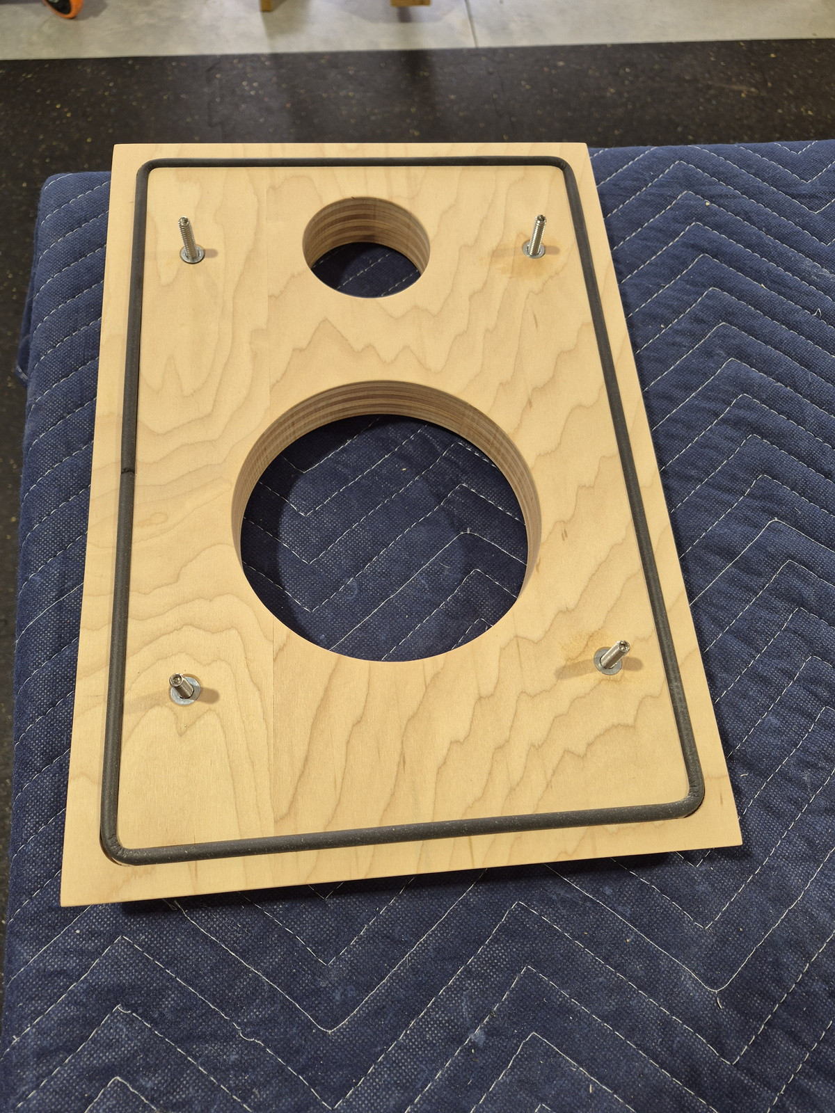

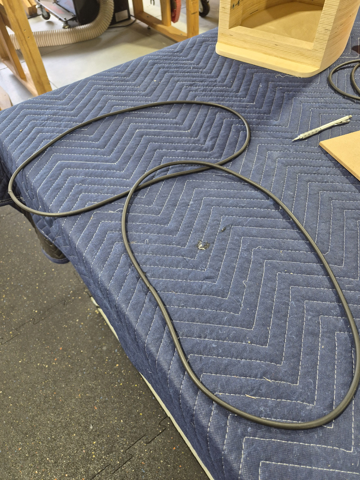

                                          To make a seal between the cabinet and baffle I made up some o-ring gaskets
                                          More threaded inserts on the back of the baffles for 1/4-20 set screws.

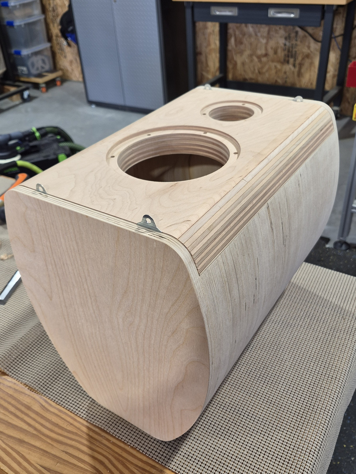

                                            • 2135

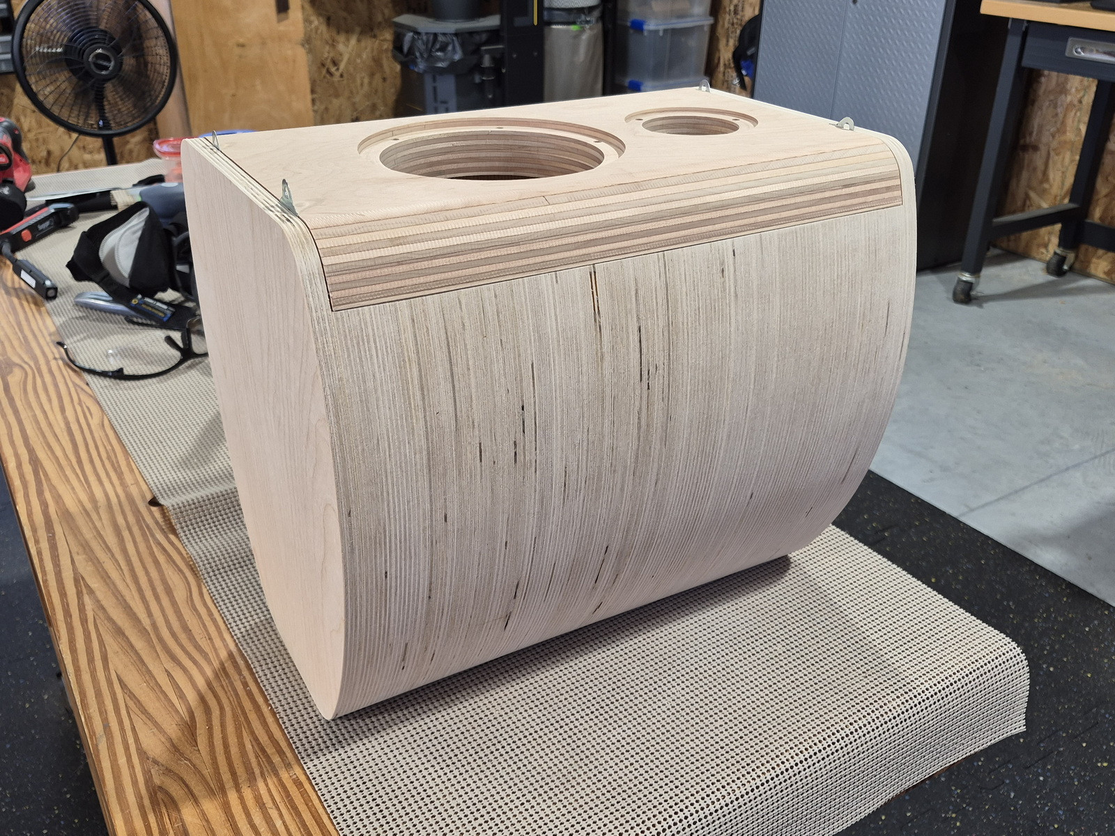

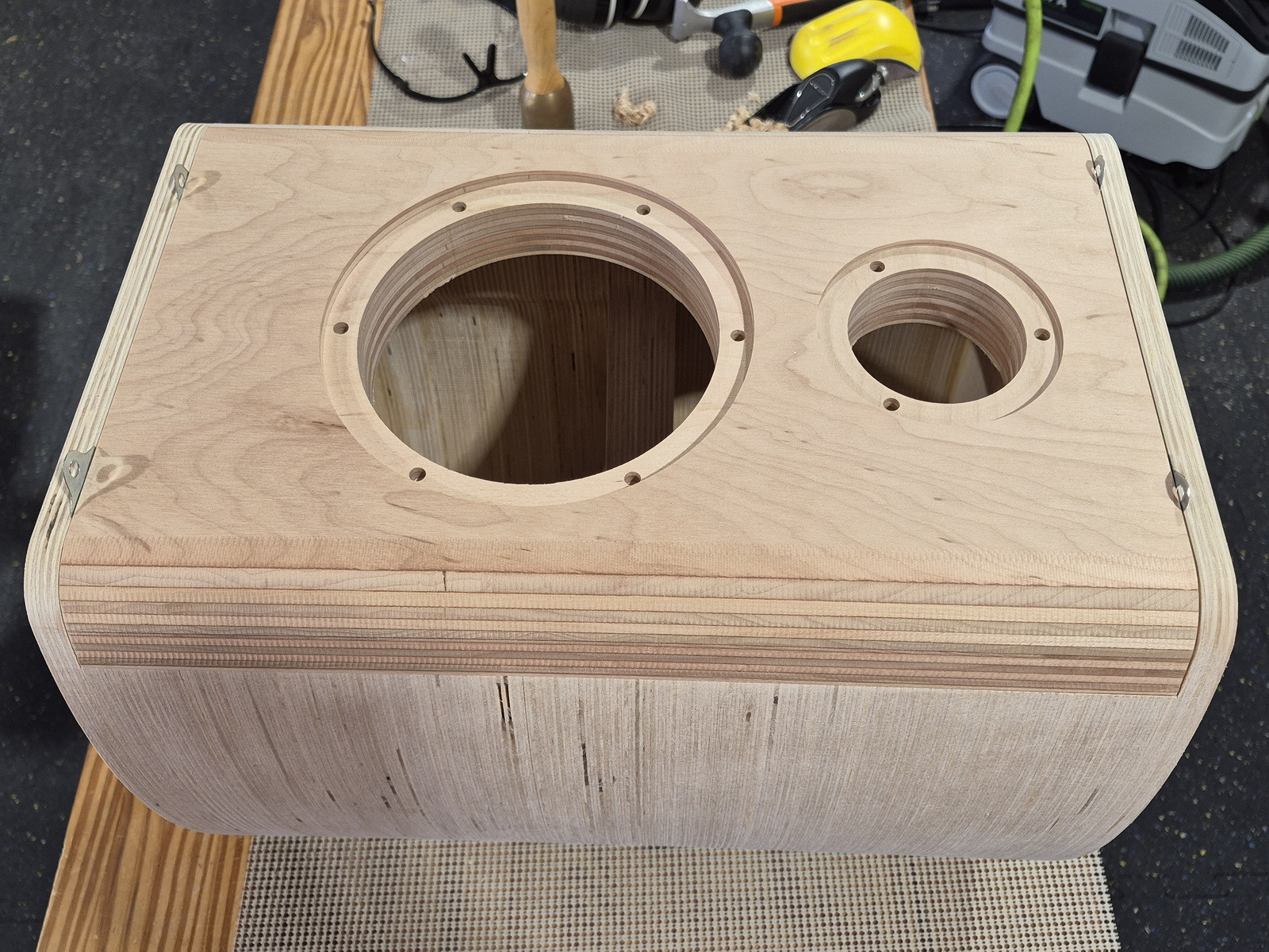

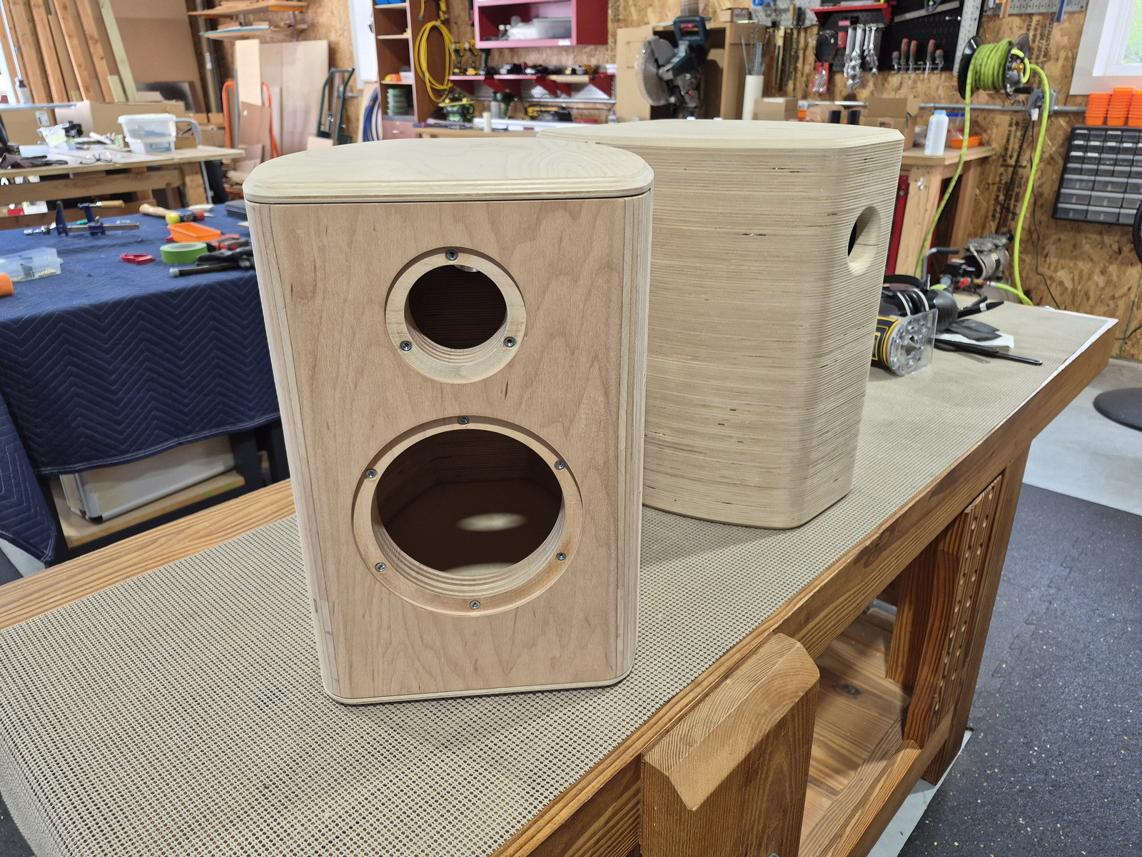

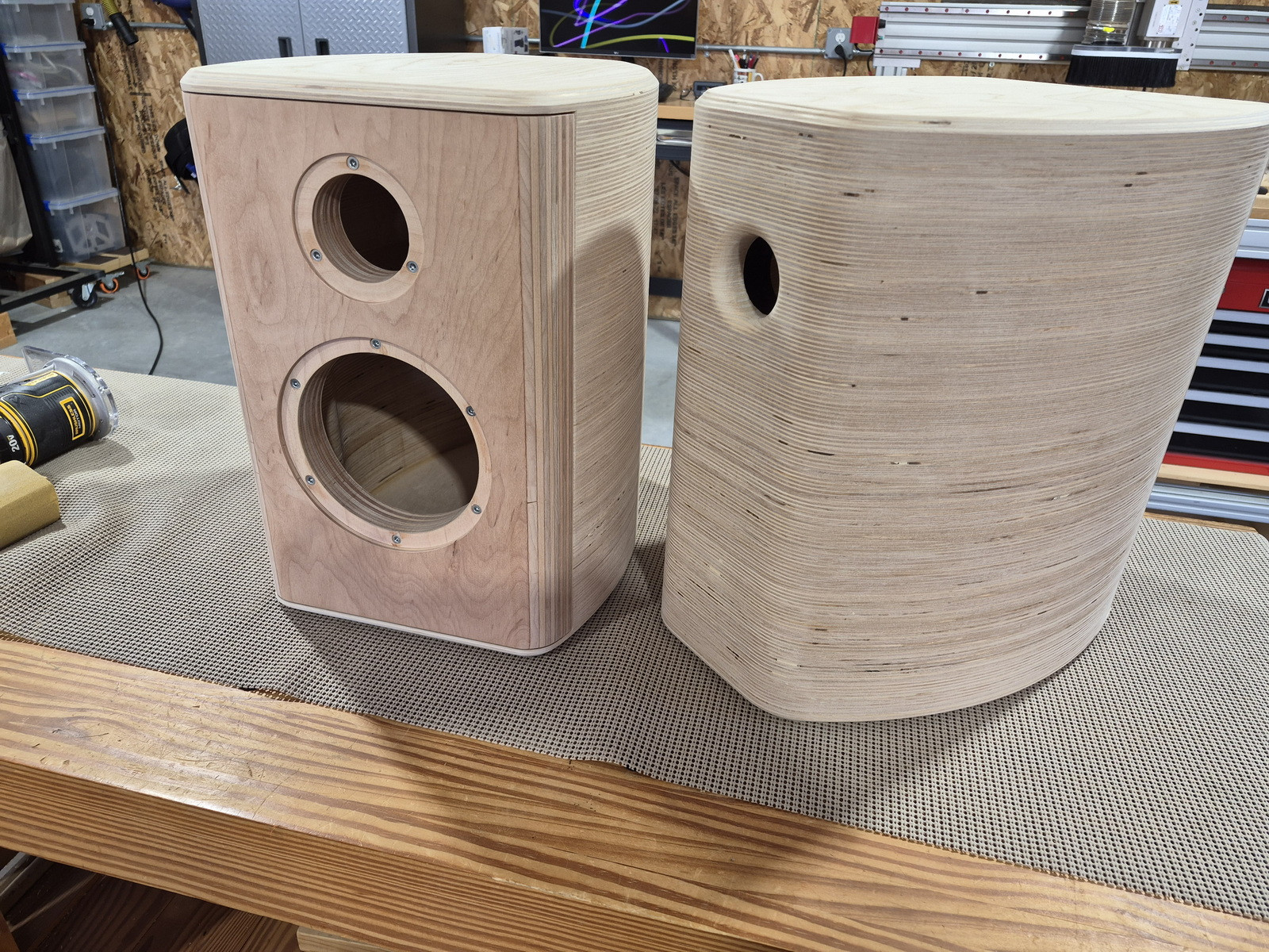

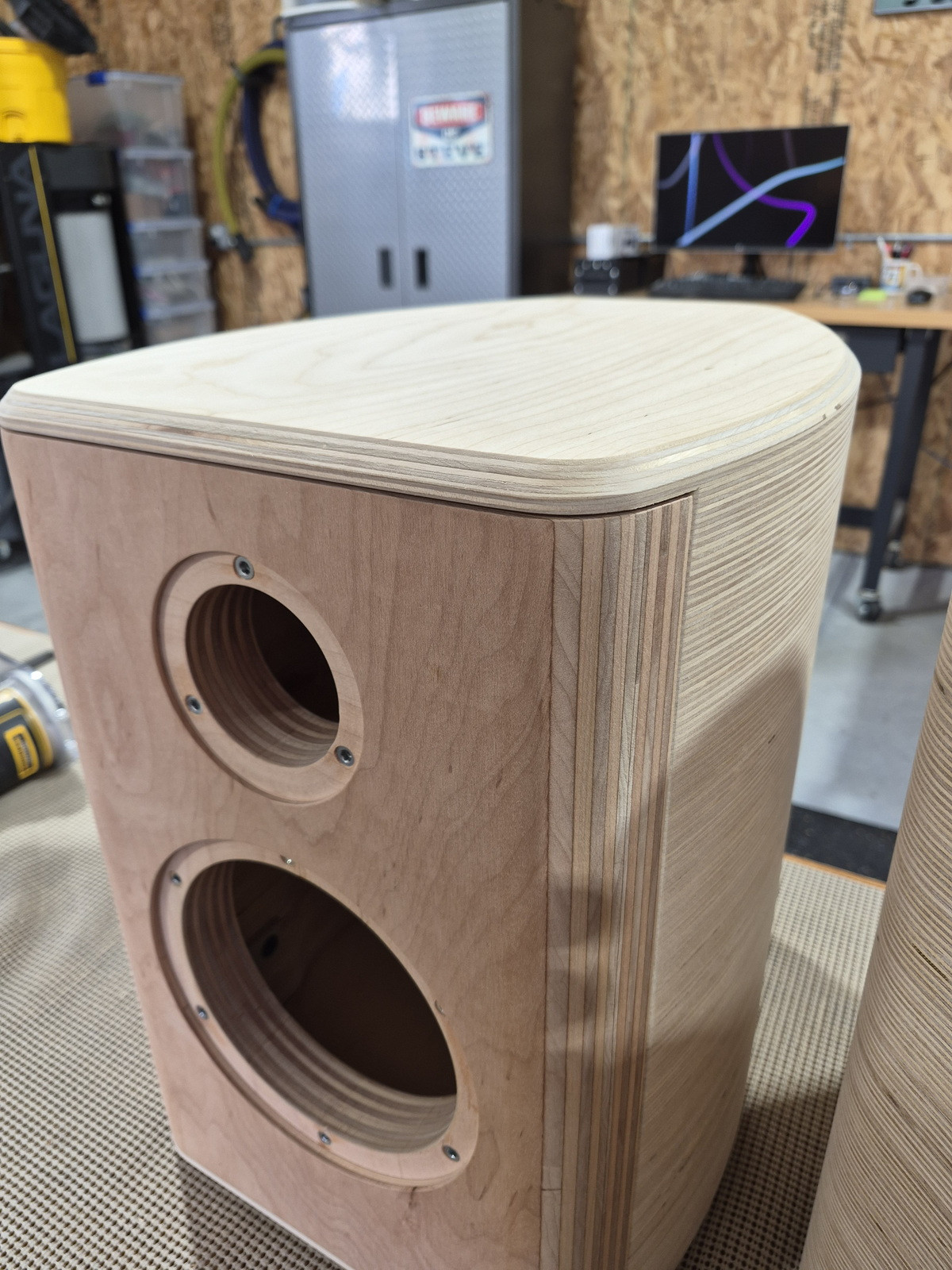

                                            I was about to claim that they were all done! Then looking at the pictures I realized I forgot to chamfer the inside of the woofer holes ..... 🙃Well I'll take care of that tomorrow!
                                            Baffles in place, ports rounded over and chamfers top and bottom.
