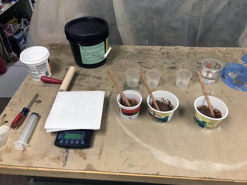

    One of the stressful parts of this build is making the curved panels. I always find it a little nerve-racking working with glue you actually have to mix up. When you start out you're not quite sure if you're making too much (which would be wasteful of the expensive glue), or not enough (which would be worse since it takes a fair bit of time to mix it up, all the while you're already mixed glue is sitting around either in the pot or on the panel drying out). And truth be told, I was nervous about whether this was actually going to work.
    If you've never worked with precatalyzed urea formaldehyde glue, it's weird stuff; it doesn't just dissolve into the water like you think it would. There is a lot of stirring involved and it takes a while for all the powder to hydrate. I sort of liken it to making pizza dough. Pizza dough doesn't have a nice smooth texture when you first mix it, but after you let it sit and hydrate for a bit and allow gluten to form, it becomes a lot smoother and more plastic. There's no gluten with the glue obviously, but the same sort of concept applies.
    I tried to estimate the amount I needed based on the coverage listed on the container, plus 10%. I mixed the first batch up all at once - that is, enough glue to cover the 3 layers needed for one panel. That proved to be a little too big of a batch. I had difficulty getting a nice creamy texture and had trouble with lumps of unhydrated powder. They were a big pain as I had to scrape them off the sticky panel when I was rolling out the glue. The other issue with doing a big batch of glue was I wasn't quite sure how much I could use on the first two layers. I was afraid I was going to run out, so I probably used less than I should have until the final layer. I ended up with enough, but I don't like being to uncertain if I'm going to have enough. There were some anxious moments while I was waiting for the panel to cure in the Curvomatic wondering if the glue would fail and the curve would completely spring back.
    So for the second panel I decided to make up three small batches in 3 separate cups - one for each layer. That way I would use an entire cup's worth of glue on each layer. And I made 20% extra instead of 10% (I have more glue than I need, and it doesn't have a long shelf life). Both the small batches and the 20% buffer were wise choices. Doing it in small batches, the mixtures ended up smooth with no lumps and I didn't need to guess about how much to put on each layer.
    Here's my setup:
    I weigh out enough powder for each layer in the panel in 3 separate cups. You add the water at two different times - 2/3 the first time, and 1/3 later, so I measure out the first dose of water into 3 other cups. I made a spreadsheet to calculate the weight of the powder, and first and second additions of water. I pour the water into the first cup and stir. And stir. And stir until it is smooth, and about the consistency of runny peanut butter. Then I let that sit while I do the same with the other two cups. By the time I'm done with those, the first batch is ready to stir again. Bubbles will have formed in the glue as the powder more fully hydrated and you want to stir those out. Then I measured out the second dose of water into each of the water cups. Then I add it to the first glue cup, and stir. And stir. And stir. Weird things happen when you added the second dose of water, but if you continue stirring, all will go well. Then I repeated the process with the other two cups. By this time they have all been sitting long enough that they are ready to go. With one more round of stirring.
    It does not spread particularly nicely. It thickens fairly quickly, though it doesn't set quickly - so you do have time. But after about 6-7 minutes with a 6" glue roller, you can get a nice consistent film of glue across the sheet. Then you place the next layer of plywood on top and repeat...after you've stirred the next cup again, of course. Lather, rinse, repeat and you're ready for the clamps. Or Curvomatic. I like to wrap the panel is stretch plastic (like they use for wrapping pallets) to prevent the squeeze out from getting on anything. You can see the rolls of it in the next picture. I also put down a layer of baking parchment on the Curvomatic just in case the plastic wrap leaked.

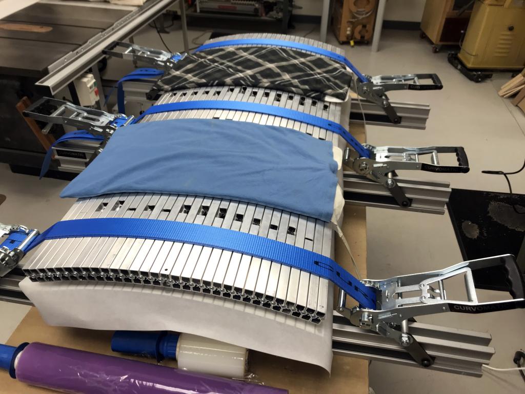

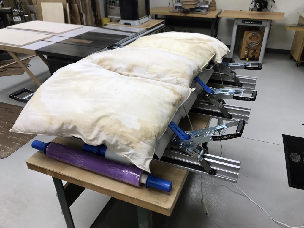

    The glue instructions are very clear that the temperature of the room and the parts must be above 70 degrees F for the glue to cure properly. My shop hovers right around 70 this time of year, so I took out a little extra insurance and use a couple heating pads with a few old pillows on top. I keep the heating pads and pillows around in my shop for exactly this sort of thing.

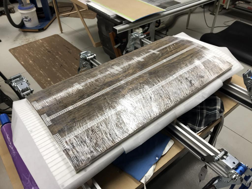

    I'm never sure exactly how long I should leave the panel in the clamps, so I always err on the side of caution. I left each panel in there for 24 hours. Which means it take a minimum of 4 days to do 4 panels. But it was nice having an excuse for not working on it the rest of the day (though I certainly could have worked on other parts of the build).

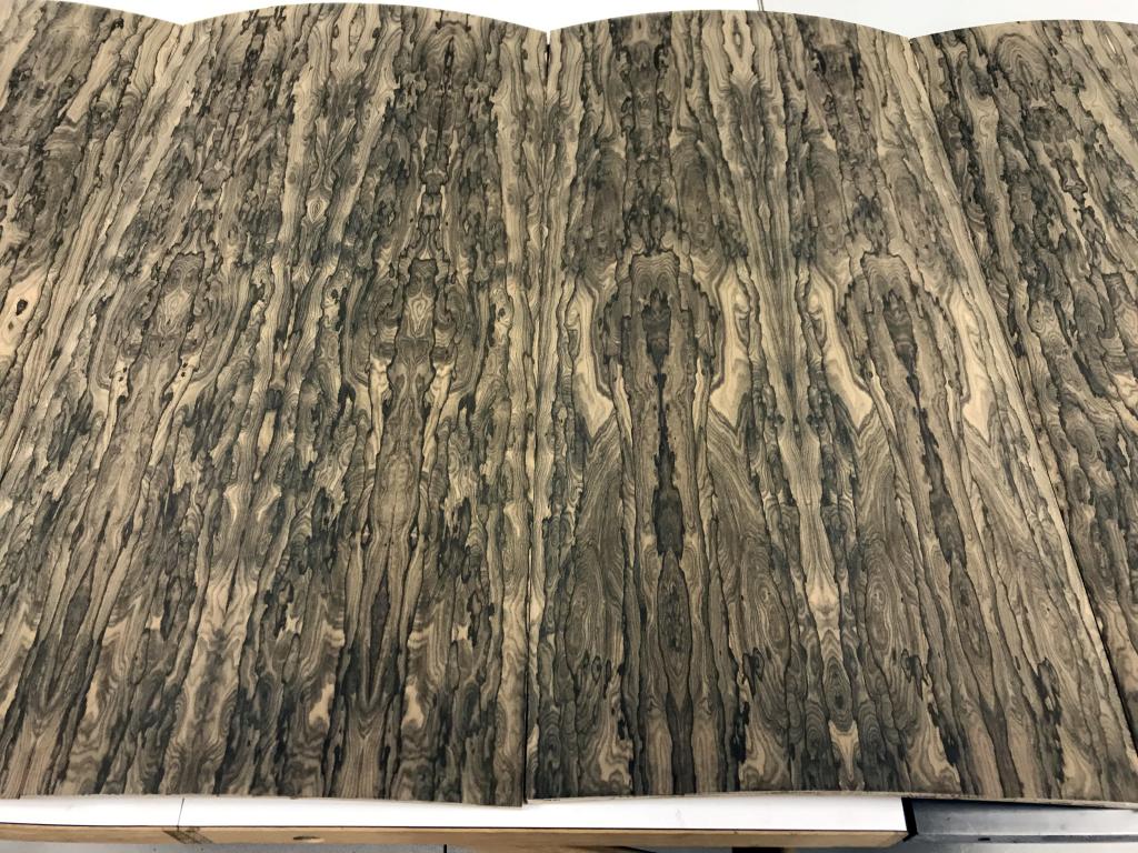

    When I took the first panel out of the Curvomatic the next day I was very pleased to see there was almost no spring back. Which was surprising - shocking even, given the incredible amount of force I had to apply to the panel to get all the layers to curve all the way. I was leaning on the ratchet straps with all my weight when tightening them up. Quarter inch Baltic birch plywood does not like to bend. But it turned out great. After they were all done, I removed the veneer tape and gave them a decent sanding.
    I said _almost_ no spring back. There was a tiny bit. So I am going to remake my brace template to include the new radius. I also recalculated all my volumes - they changed by a fracture of a percent. It probably isn't strictly necessary to remake the brace template, but I want the panels to fit/glue to the braces perfectly. That was why I hadn't yet milled the brace blanks to their final size.

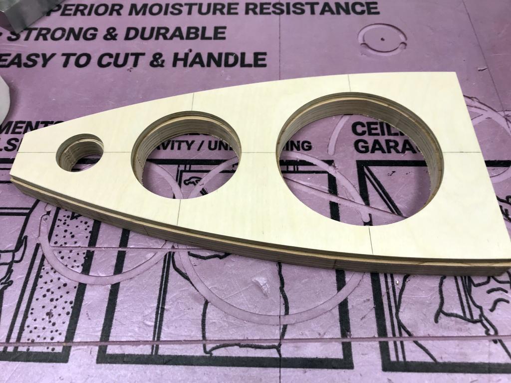

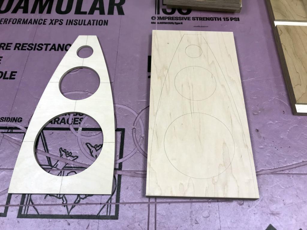

              I haven't had a ton of time in the shop lately, but I have gotten a few things done. Now that the curved panels are done I was able to determine with a fair degree of precision what the actual radius of curvature was (though it was barely perceptible, there was a tiny bit of spring-back). I traced the inside curvature of a panel on a piece of paper (a couple pieces taped together actually to get a longer length). I used a 24 inch center-finding ruler to draw a line (cord) between two points on the curve 20 inches from each other, then at the mid point of the cord I drew a perpendicular line up to the curve. I could then use the length of the cord and the distance from it to the curve to calculate the radius. I set my homemade router compass to that dimension (the Jasper jig doesn't go big enough) and cut a new radius template. I used the template to check the consistency of the 4 panels and they were all -- amazingly -- exactly the same. With such an incredible amount of force needed to bend the Baltic birch plywood I thought there would have been more spring-back and more variability. I used that new template to make brace template 2.0, just like I did for brace template 1.0. It sounds perhaps like quite a bit of work, but it wasn't so bad.
              I traced the brace template onto the blanks I had prepared earlier...

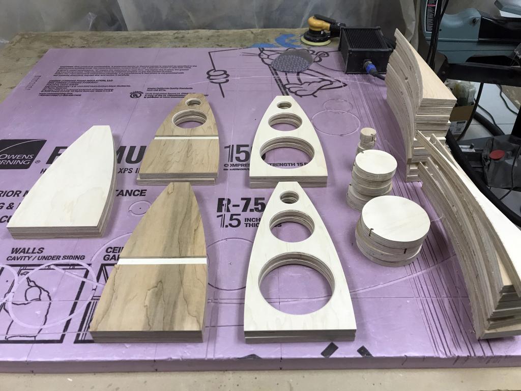

              ...and cut them to rough size on the bandsaw. Then I cut out the holes to rough size using the scroll saw. I could then double-stick tape the template to the rough-out blank, and template-route the piece to final dimension. I did a 1/4" radius roundover on all the holes.

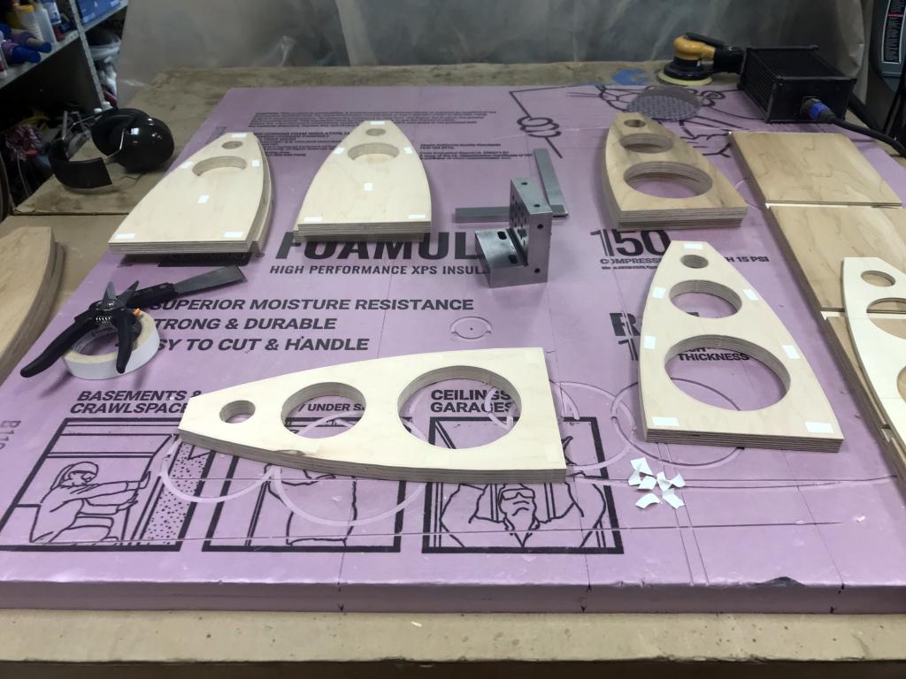

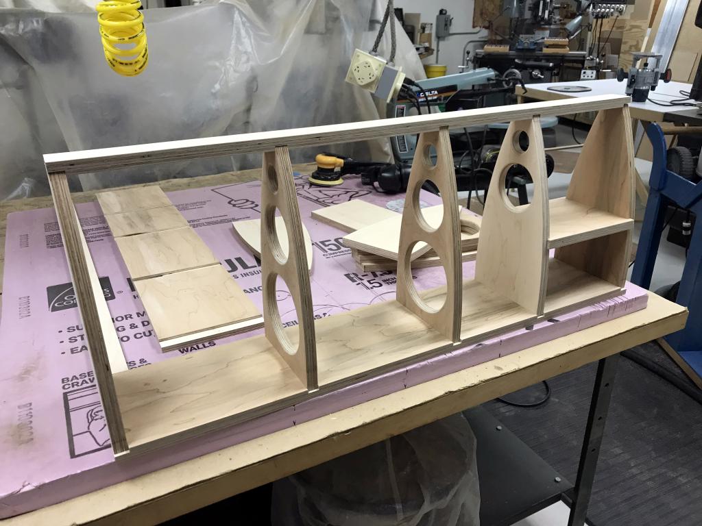

              After that was done, I did a quick test fit to see how they'd look assembled as the skeleton.

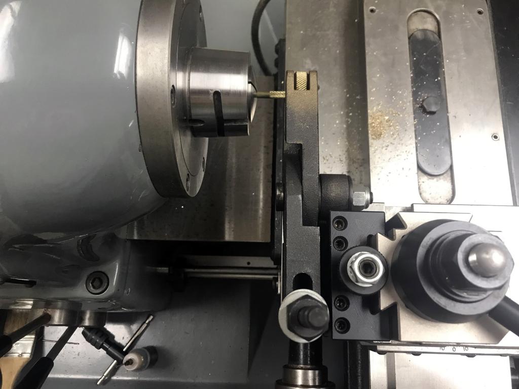

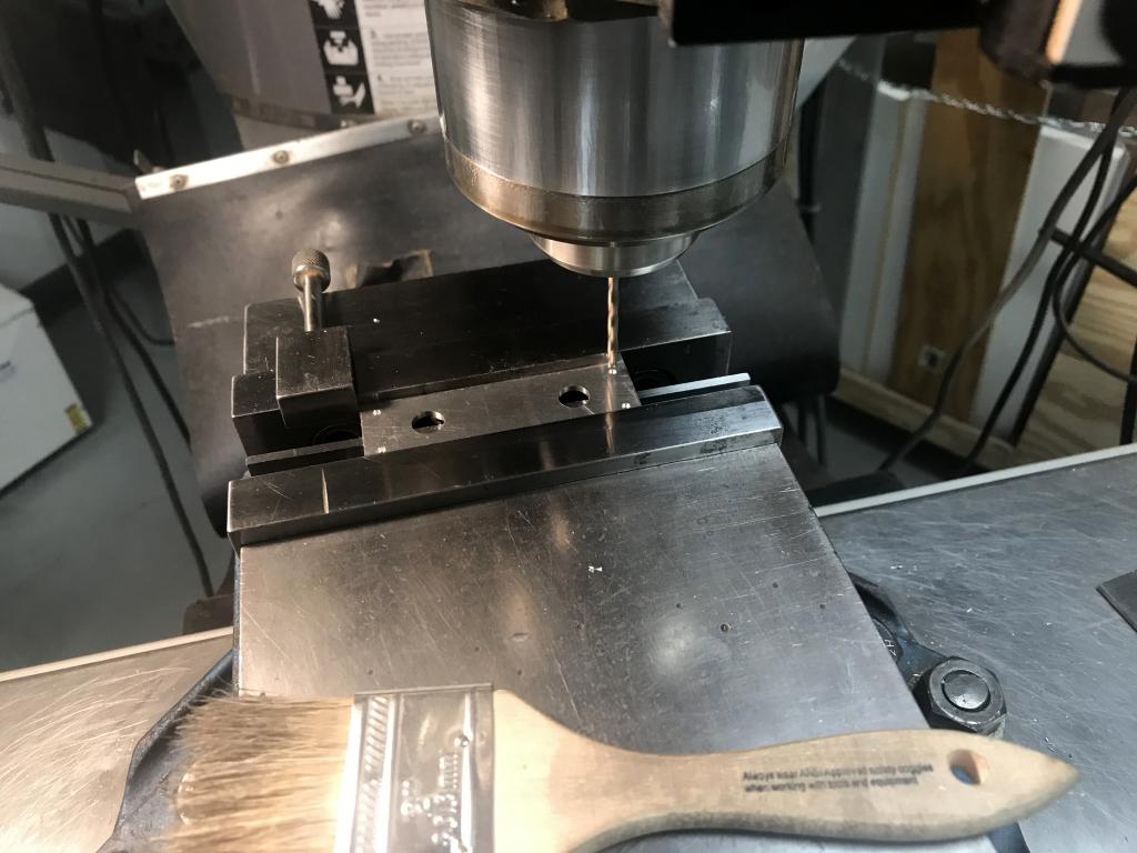

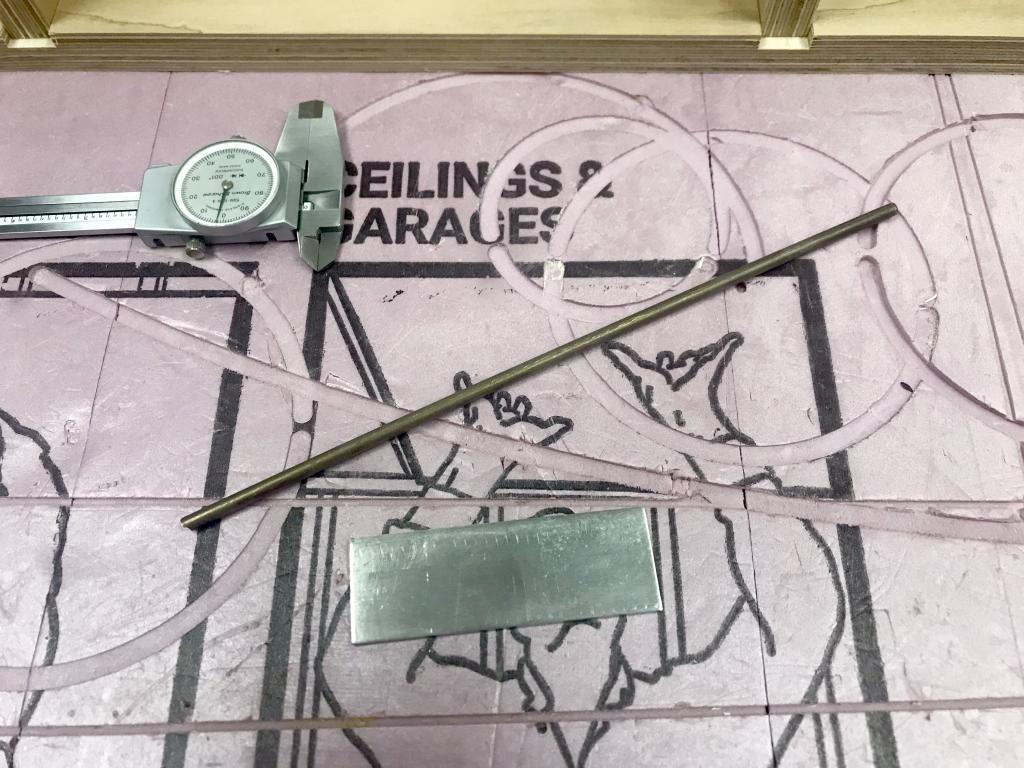

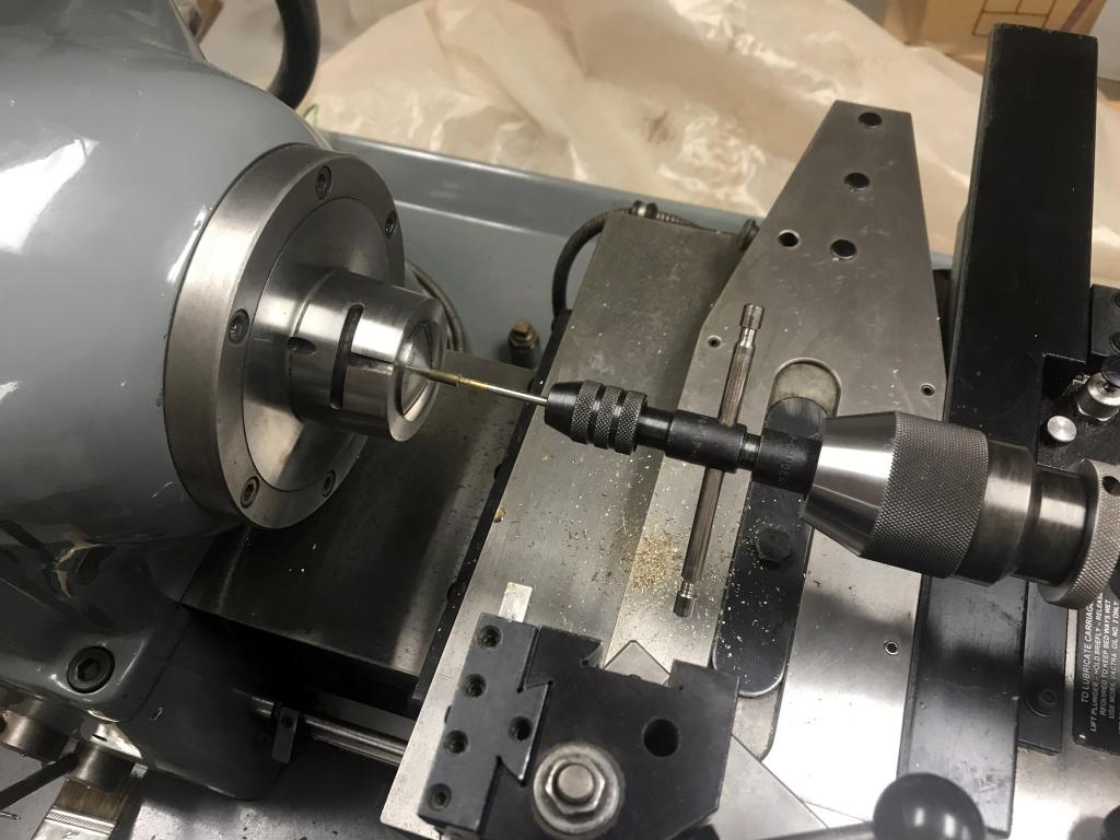

                  The terminal plates will mount to the cabinet with very small screws. While I'm sure small wood screws would be perfectly adequate for the task, I'd like to make something a bit more...time consuming (?). So I decided to make some very small threaded inserts. I've made that sort of thing on quite a few projects in the past. I started out with some 3/16 inch brass rod (and some aluminum sheet I'll use later for the terminal plates).
                  I drilled and tapped a hole for a 4-40 thread.

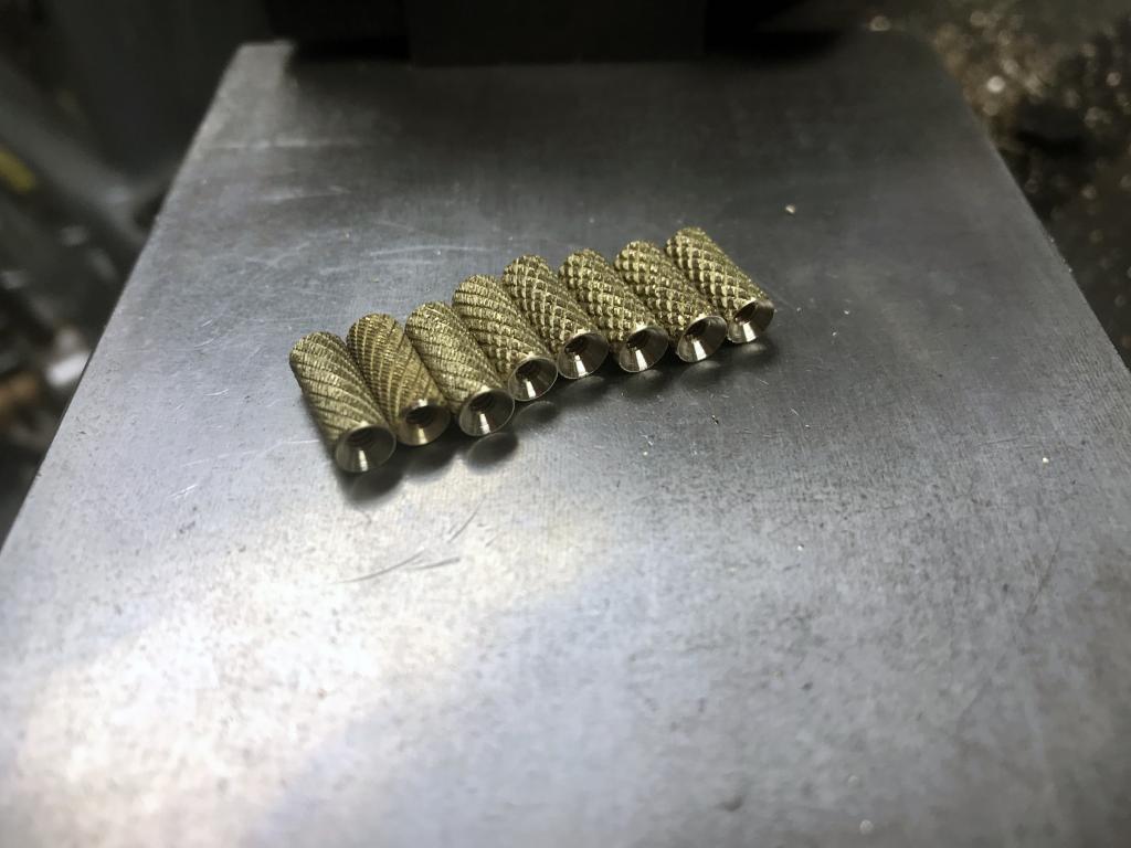

                  Then I lightly knurled the OD to make a secure fit when pressed into the plywood. If necessary you can add a drop of CA glue when pressing them in.
                  After doing it 8 times, I had these:
                  • bimmerguy
                    • Mar 2021
                    • 82

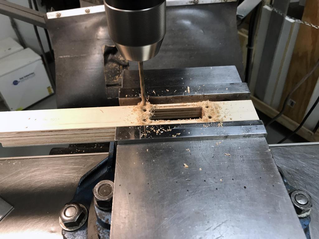

                    To make the terminal plate I started with the same 0.075 inch aluminum I used for the trim rings. I machined them to size and drilled the holes for the terminals and the mounting screws on the mill.

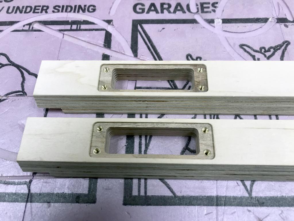

                    Then I milled out the recesses on the rear panel to accept the plate and the threaded inserts.

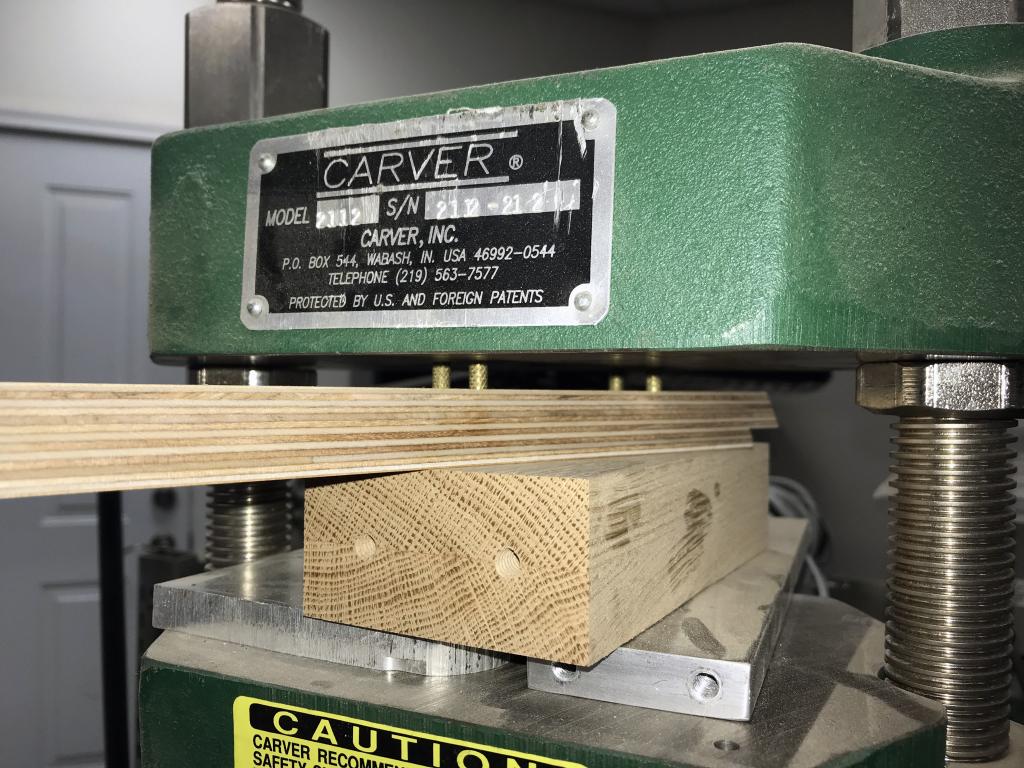

                    Next came pressing in the threaded inserts using the hydraulic press. I suppose I could have used a hammer, but this way prevented any damage to the soft brass and ensured the inserts went in perfectly straight. It takes a fair bit of force to push them in, surprisingly. I drilled the holes to be 3/16, the same as the original stock size, but with the knurling the diameter of the brass increased quite a bit. They are a very snug fit.

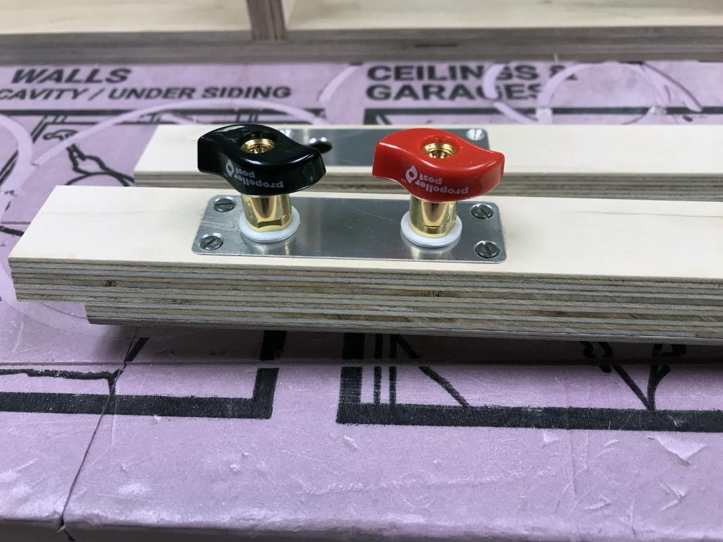

                    The plates sit just a little proud of the surface of the plywood. When the piece is veneered they will be flush.
                    I chose the Propeller posts for no other reason than I thought they looked cool. I might clean up the edge of the nylon isolation washers a bit on the lathe. They look a bit sloppy.

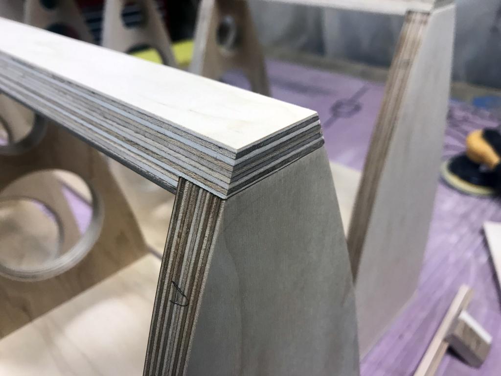

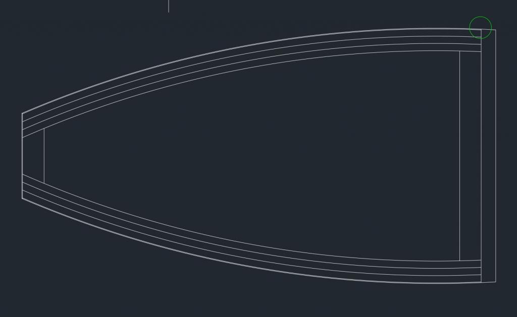

                        I have some questions for you experts.
                        One of the things causing my analysis paralysis is how to do the front baffle. As is typical, it will be made of two layers (3/4 inner, 1/2 outer) to form a final thickness of 1.25". I'll glue up the skeleton first - the braces, rear, and inner front baffle. Then glue on the curved side panels and trim those flush with the rear and inner front baffle. That leaves the outer front baffle. I plan on painting the front baffle gloss black. That's one of the reasons I veneered the curved sides when I did. The outer baffle will be black on its side (1/2 inch) dimension all the way around. It would probably have been easier (though taken longer) to hold off on veneering the sides until it was all assembled - that way the veneer could have covered the edge of the outer front baffle, too.
                        At any rate, now I have to decide how to merge the outer to the inner front baffle...and when to paint it, and when to route the holes for the drivers.
                        The transition from front baffle to side panel is what I'm concerned about. That's the area inside the green circle in this drawing.
Name:	cross section.jpg
                        Option 1: Alignment pins/paint the outer front baffle first. Install 4 alignment pins to allow the repeated and precise placing and removal of the outer baffle from the inner baffle. You could route all the driver holes and trim the perimeter to form a perfect edge with the side panels before you glue it, and then remove the piece for painting, and finally reinstall and glue it, already painted. I am assuming the pins would allow for enough precision that when placing the outer baffle back on it would align nearly perfectly. This has the benefit of allowing you to paint just the outer baffle by itself, which will result in a crisp painted edge when glued to the rest of the carcass.
                        Option 2: Glue everything first. After the side panels are trimmed flush with the inner front baffle, glue the outer front baffle in place, trim and shape the edges to fit with the sides, then route the driver holes. And finally, mask off all but the front outer baffle (and its 1/2" side edges) and paint it. This way is probably easier, but I am concerned there would be a thick/hard paint line where the outer baffle and side panel meet (that is, where the masking tape was). There will be several layers of paint (epoxy primer, sandable primer, color base coat) and the masked edge might be hard to deal with and ugly. And sanding the primer will be tough right next to the veneer.
                        Option 3: Is there another option?
                        In either case I will spray the clear coat after the entire speaker is assembled.
                        Are one of those two options (or a third) the way things are typically done? I'd like to do an inset aluminum strip to separate the inner and outer baffle, but I don't have any material long enough for that (I could get it, of course), but moreso I'd be worried about sanding through the veneer when trying to file the aluminum flush with the surface. And that still doesn't necessarily point me in the direction of option 1 or 2.
                        Any insight would be greatly appreciated.

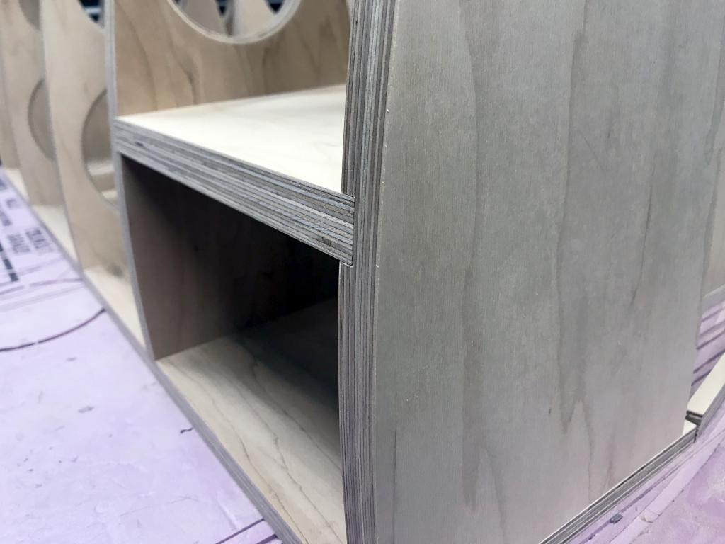

                                        Time to glue on one of the side panels. I thought quite a lot about how best to do this. I repeatedly tried clamps and ratchet straps, but I could never get good even force across the entire curve. Then in a monkey-touch-the-monolith moment of genius (not) I remembered the Curvomatic. All I'd have to do is make the new 'formers' that were the correct radius - this time concave instead of convex like before. To make the template I assembled the panel + a sheet of hardboard + the Curvomatic 'skin' to get the final curve radius and traced that onto a piece of hardboard. I cut it out fairly accurately on the band saw and sanded by hand to get exactly to the line. I didn't use a circle cutting jig since I was able to get a reasonably smooth curve this way, and match the needed radius very accurately. Then I just used the template and my router table to duplicate the shape onto some scrap particle board I had lying around.
                                        Click image for larger version  Name:	IMG_3831.jpg Views:	0 Size:	1.71 MB ID:	926896
                                        I really scratched my head about what angle to orient the formers. When I put downward pressure on the assembly I don't want it sliding down hill, but I don't want it tilted so far the other way or the top panel will slide off when I set it on top before I can get the straps tightened. In the end I ended up with a compromise between both extremes and I think it worked out pretty well.
                                        Click image for larger version  Name:	IMG_3832.jpg Views:	0 Size:	2.19 MB ID:	926897
                                        Click image for larger version  Name:	IMG_3833.jpg Views:	0 Size:	1.82 MB ID:	926898
                                        I clamped a couple pieces of scrap to hold the skeleton so it didn't slide down. After a few dry runs I was confident enough with the method to glue on the panel. I used the same urea formaldehyde glue as I did to glue the panels -- because it is super strong and doesn't allow for glue creep, but more so because it provides a longer working time and applying the glue carefully to all those edges takes a while.
                                        Click image for larger version  Name:	IMG_3838.jpg Views:	0 Size:	495.4 KB ID:	926899
                                        Click image for larger version  Name:	IMG_3840.jpg Views:	0 Size:	2.16 MB ID:	926900
                                        The bottom panel is there just as a place holder of sorts right now. When I go to glue on the second side, the panel will already be attached, so I needed to account for it now.

                                            I wasn't sure at first how I felt about using the track saw on an angle like that, but it when just fine. The track saw got me in the neighborhood, but to get really close I used a flat-bottom bit on the router. I've seen folks make a jig for the router that mounts to or replaces the router base. But I didn't want to take the time or material to do that, so I took the lazy way route. I just double-sticky taped some scrap MDT to the front baffle for the router to ride on, then the router bit could overhang the end and trim the extra panel overhang. This was a little precarious on the rears as there just wasn't much real estate on which to tape the MDF pieces. Here's what it looked like:
                                            This got me pretty close. The rest was done with sanding.

                                            The overhang on the top and bottom was trimmed off with the bandsaw. I was a little nervous about that part - more about possibly chipping out the veneer than anything else, but it went fine. But that brings me to the embarrassing part...

                                                The internal volume of the speakers as-built is slightly larger than my nominal ideal calculation. So I needed to take up some space. I happened to have some 1/4 inch Baltic birch cutoffs left over from making the panels that turned out to be exactly the right size. I decided to make some blocks from those cutoffs, to glue on the bottom of the interior, that fit shape-wise with the curved panels. This would have the double added benefit of providing a little more weight on the bottom end (they are a little top-heavy as-is with the extra structure for the sealed TM enclosure), and provide extra thickness into which I can screw the bases (although truth be told I am going to use threaded inserts so the extra thickness isn't really needed).
                                                I started by making a new template. To define my outer edge I used a cutoff from trimming up the panel I'd already glued on. I couldn't just use my original template since there was just the slightest bit of springback in the panels. All that accuracy is probably unnecessary, but if you haven't figured it out yet, I'm a little anal retentive when it comes to building stuff. Anywho, I then used a compass to draw a line a bit inside my outer dimension.
                                                Then I transferred my paper template to an obsolete template I had laying around from the braces, cut it out and sanded the edge smooth. I needed to laminate the 4 pieces of Baltic birch together to make one thick block. I did that with my vacuum press.
                                                Then I cut them out and template-routed them to the final size.

                                                      I needed a way to mount the flat crossover boards to the curved panel surface. I suppose I could have just screwed them in at the corners, but that wouldn't be in keeping with my needlessly complex approach. So I decided to make some mounting pieces that are flat on one side for the crossover boards and curved on the other to match with the panel. I started with a scrap piece of the Appleply. I was careful to mark the center and edges for laying out the arc. You can see how I used a parallel and angle plate to do that. With those three points marked I could ensure that, after the arc is cut and I run it through the table saw, the piece will be perfectly symmetrical about the center point - that is one side won't be thicker than the other. I might be going into too much detail about how I laid it out, but those are the types of things I think about constantly when making a project like this.
                                                      After that I could rough cut the arc on the bandsaw, and template route it to the final curve. I used the template I made for the braces since that had been made to perfectly fit the panel curve.

                                                        I didn't want to just use wood screws to mount the crossover boards (I will refer you back to the previous 'needlessly complex' statement). So I made threaded brass inserts into which I could install a No. 8 machine screw. The first thing was to drill the holes to accept the inserts.
                                                        Then I turned down some brass rod to the right diameter and knurled it. The knurling gives a good mechanical bite in the wood and gives the superglue recesses to hold on to.
                                                        Then I cut them to length, and drilled and tapped them.

                                                        And here they are all done.

                                                            So that brings us to gluing the second panel in place. I made new formers for the Curvomatic out of some scrap particleboard. That wasn't the best choice of material - it really wants to crumble under the pressure of the straps. But it worked...barely. If I had to do more than two speakers I would have needed something a little stronger like MDF or plywood. At least now I have a little less scrap particleboard lying around.
                                                            Next comes the worse part of the entire build for me. Trimming the panels to final size. The cabinets by this point are quite heavy and hard to move around through a router table; and they are now about 3/4 inch too tall to fit threw my big bandsaw. The way I trimmed the first panel wasn't the best, but at least then they were significantly lighter and easier to manipulate. I'll do some head scratching about how to do it easier. Maybe a router jig of some sort...

                                                                              I sorted through the remaining veneer to find a piece that would work with the bookmatch. It's not flawless since the original bookmatch pieces were sequential and this one was several (maybe 4 or 5) layers down. But it's good enough that I don't think it will be too bad. I did the iron-on thing since there was really no good way to clamp the narrow piece in place. I wasn't sure how ironing would work on a curved surface. I spread a layer of glue (Xpress veneer glue - no need to buy the glue specific for ironing) on the veneer and the cabinet and let it dry thoroughly. Then I spread another layer of glue for good measure and let it dry, too, about a hour or so.
                                                                              Overall I am pleased with how it turned out. Not an absolutely perfect bookmatch, but it is a good repair and the seam is good. There was a high potential for this repair turning out to be a complete catastrophic nightmare, even worse than the original issue. But in the end, I am pleased with it.

                                                                                    With the veneer snafu fixed, I could move on to veneering the backs. This was a more straight-forward affair. Since I couldn't put the whole speaker in the vacuum bag, I did the iron-on thing again. I put a coat of glue on both the case and the veneer and let them dry for about an hour. The veneer wants to curl a fair bit when there is wet glue on one side, but with a piece this narrow it is manageable.

                                                                                    The next challenge was cutting out the holes/ports where the speaker wire connections will be. I started by using a sharp knife to cut a rough hole. It was fairly easy to tell where the hole under the veneer was.
                                                                                    I then used my little router to free-hand cut out a close as I dared to the edge. I made sure to expose the threaded inserts I'd made to screw in the panel.
                                                                                    Then I could screw on the panel - just setting on top of the veneer, and scribe to the exact edge. I then removed the panel and used a sharp chisel to cut away the remaining overhang. There was no margin for error - if I cut over too far or if it chipped out there would be a noticeable gap between the panel and the veneer in which it is inset. Definitely not a design for manufacturability (a bezel to cover the gap would allow for more slop), but I like the look and this is a one-off so I can afford to do little things like that.
                                                                                    It's not pristinely perfect, but from more than 6 inches away it looks pretty good.

                                                                                      Changing gears a little bit (for variety), I decided to tackle the fit of the aluminum trim rings I'd made earlier for the drivers. The rings for the tweeters were a bit too tight of a fit in the recess in the outer baffle, so I modified the OD jig I'd made for the router so I could mount it on the lathe. That was the only way I could think of to take off just a few thousandths evenly from around the entire circumference. I cut a groove slightly thinner than the thickness of the aluminum and the same ID. That way I could mount the ring on the wooden block/disk, and it would ensure the ring is perfectly concentric. Then it was an easy task to just turn off the needed amount.
                                                                                      the tweeter and mid rings are close enough together that they interfere with each other, so I needed to modify each of them so they'd fit in their places. I could have cut a arc out of the mid ring for the tweeter ring to nest in it. I'd then not have to alter the tweeter ring. But I decided it would look better (not sure if that's true) and a fair bit easier to have them meet at a flat line not an arc. I set the tweeter in place and then the mid ring resting on top of it and scribed a line where the two met.

                                                                                            Well, on to the top veneer saga! Or shall I call it disaster #2? Getting all sorts of cocky about using the iron-on veneering method I decided to use that technique to glue the veneer on the tops of the speakers. So I cut some nice pieces of veneer and did the bookmatch thing like I've done a million times. Like this - x2:
                                                                                            Then I proceeded to apply the glue to the veneer and to the cabinet as I've done before. And that's where I ran into my first problem. You'll recall how on the back pieces the veneer curled a bit when the wet glue was applied. Well when the glue dried those pieces straightened out a bit - enough that I could easily iron them down. With the top pieces...not so much. Here's how they looked after a couple minutes with the glue on. I set a can inside the curl to keep it from doubling over on itself.

                                                                                            After the glue had dried they went full-on cinnamon sick on me. Check this out:
                                                                                            That one was the worst of the two. It cracked in half when I tried to straighten it out to iron it on (the heat does make it more flexible). So....back to the stack of veneer I went to make another bookmatched piece. Why I thought the new one wouldn't curly up I don't know. I put weights on the corners as it was drying and that did help enough so that I could at least lay it out on top of the speaker. So I went about ironing them on. The first one went on seemingly pretty well. But I had trouble getting the second one to stick down properly. Maybe that veneer glue isn't so great for ironing after all...
                                                                                            The problem wasn't that the veneer wouldn't stick at all, it's that it _nearly_ stuck. Bubbles everywhere. I worked for hours fighting those things. I've gotten pretty good at making a tiny (barely perceptible) slit in the veneer with a very sharp blade and using some thin CA glue to get through the slit and pressing it down to get the bubble to stick. That works to a point. But not for larger areas and not when there are a thousand of them. After all that time and frustration, it turned out to be a total disaster.
                                                                                            It looks even worse in person and it's not salvageable. I had no choice but to completely sand off the offending veneer and its glue and start over. Ugh. So much time and material wasted - mostly time. At first I tried using a router with my flush trimming jig, but that wasn't working well, so I switched over to course sandpaper. Sanding through the glue was tough, but I got it to a manageable state.

                                                                                            Well I wasn't going to make that mistake again. I don't have a good way of clamping the veneer to the top, but I needed to figure something out. I decided that all I could really do was to place a heavy weight on top. So to help distribute the weight evenly, I made a caul on which I would place heavy things. I made it out of the wrong material for every application, particleboard. I traced the brace template I'd made earlier, using a compass to give me a little extra area.

                                                                                            I went back to the veneer pile again and made two more bookmatched pieces. I actually like these better than the first batch. They match either other more closely since they came from adjacent sheets in the flitch. Now I could glue them in the more traditional way. I used my granite surface plate, a large steel cube, and a large bronze cylinder for weight. It's all very heavy, but I weighed all the bits and calculated out the pressure and it wasn't very high - only about 2.5 PSI. Which sounds small, but I'm happy to report it worked a treat. The veneer is dead flat and strongly adhered to the tops.
