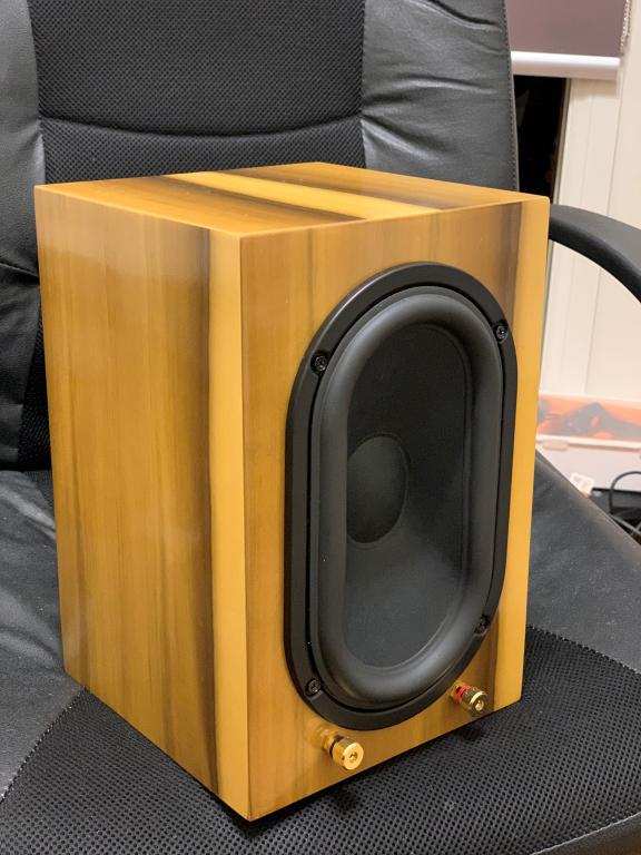

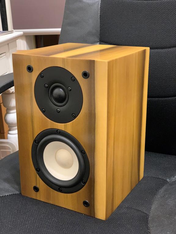

    Here is my iteration of the late Jeff Bagby's amazing SB Acoustics Revolution Mini speaker.
    For those uninitiated, the Revolution Mini was designed by Jeff Bagby in late 2018. It follows the familiar 1/4 cu. ft. mini monitor size. But don't let the size fool you. This does everything from acapella to classical to jazz to rock. I’ve been in this game over 20 years, and it’s just phenomenal.
    All the kit components can be purchased in one convenient package, who ships to North America, Oceania and elsewhere:
    I opted for the Soft Dome SB29SDAC variant, instead of the beryllium dome SB29SBAC, and the white MW13 for aesthetic reasons, and used blackheart sassafras, an evergreen tree native to south eastern Australia where I'm currently living.
    I never met Jeff, but corresponded with him from the days of Madisound BBS forums over 15 years. Always kind, generous, and shared his knowledge. RIP.

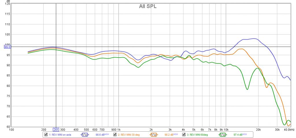

    When I look at the measurements, sure, the first thing that sticks out is the top octave (10-20Khz) on-axis.
    If that bothers you then build the one with the beryllium dome- it's a drop in replacement and doesn't have that failing/feature.
    But the other thing that the visual measurements between 100Hz to 10Khz aren't telling me ~7ms gating, so it's good down to about 150Hz, but in- room there's bass to around 50Hz. For music, it's all there.

    Good pictures of a well executed classic design... of course, the PR gives it "legs". And your choice of blackheart sassafrass was a very good one...
    Imaging and engagement are key "success factors" for any design or build, and it sounds like this one pleases you well...

      Very nice build! Beautiful job on the cabinets.
      Why the dip between 1-2k?

        That’s a characteristic of the MW13P midwoofer.
        Jeff took that into account for his design.
        It’s visual but not audible and IMHO generally causes a lot of concern.
        Tools and Olive did decades of research, and I paraphrase, but essentially
        show that dips are generally not audible, whereas peaks or resonances are problematic and discernible.

          I can understand how a lack of amplitude at a given frequency isn't audible because it's a lack of sound at a given frequency but that's a -6dB hole centered at 1.8k that goes from 1.2-2.2k and I can't help but speculate it's audible. On axis the scoop seems to go from 100Hz to 10kHz with a huge bump/peak between 10kHz and 20kHz of +8dB. I guess these are just the characteristics of the drivers used and in-room response. I'm sure with correction via AVR DSP these can be flattened out and I'm sure the resulting sound is beautiful as Jeff voiced them.

            Thanks for your comments.
            First off a few thing about my measurements:
            My measurements were taken to satisfy myself that
            1) I do not have defective drivers
            2) I wired up my crossover correctly.
            That is all.
            I posted those 3 lines here, along with the cabinet photos as a proof of DIY Mission Possible; in anticipation of the "if you didn't take a picture it didn't really happen" commentary. :-)
            They were done with what I would call "good-enough equipment" for a hobby grade DIY builder.
            (Sonarworks XRef20 48V XLR microphone, Focusrite Scarlett 2i2 mk3 USB audio interface, Windows 10 laptop, REW Software, and VituixCAD's Measurements Preparation with REW help guide.
            They were done in the far field, (x2 significant dimension of the cabinet) and are ungated, so accuracy is lost below 150Hz or so. It is on axis with the tweeter (eyeballing) and off axis, again is by eye balling.
            There is 1/12 smoothing applied for visual clarity.
            They do not take into the bass response a) the driver b) the passive radiator, c) the room, which generally affects everything below the Schroeder frequency of ~200Hz.
            Please do not interpret too much into my measurements ;
            What constitutes USEFUL measurements for a bookshelf speaker, that may be correlated with listener preferences, would be something like the CTA-2034-A, or "Spinorama"
            In the Olive Experiments- for in 12 bookshelf sized speakers were studied; what matters is:
            Smoothness of sound power (30%)
            Bass performance: (25%) (LFX: -6 dB down point relative to listening window (LW) sensitivity in the range 300 Hz to 10 kHz; and LFQ: absolute average deviation (dB) in bass frequency response from LFX to 300 Hz.
            On axis smoothness in amplitude response based on a linear regression line through 100 Hz to 16 kHz. (26%)
            On-axis absolute average deviation relative to the mean sound level between 200 and 400 Hz, in 1/20-octave bands from 100 Hz to 16 kHz. (19%)
            None of my 3 wobbly lines are sufficient to provide this information.

              That dip may be reinforced by baffle diffraction. I'm a little surprised to see square edges, but there's no doubt that Jeff knew what he was doing.

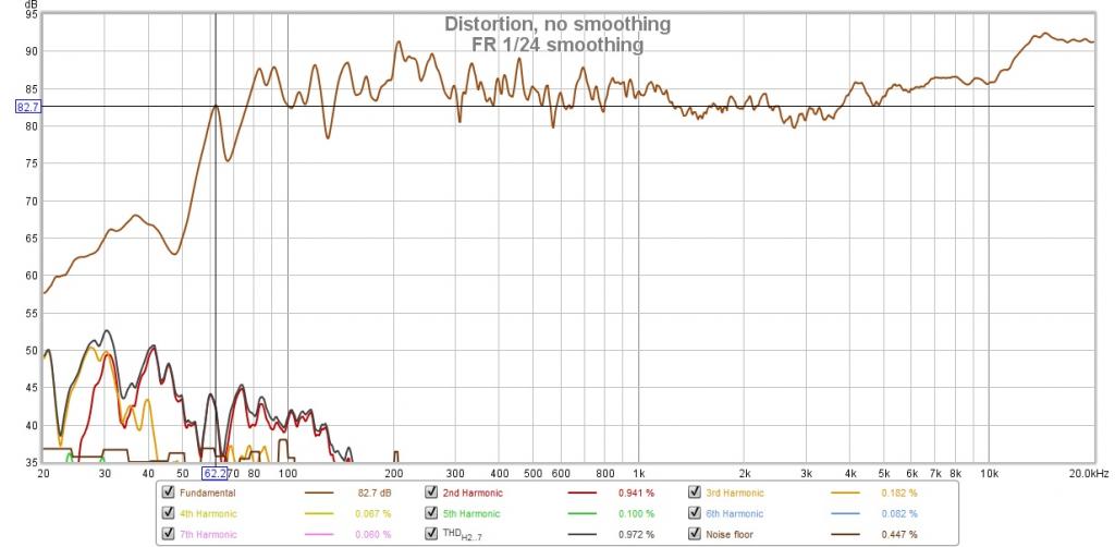

                        Here is the actual on-axis response, and distortion, measured at 0.5m, on the design axis (tweeter).
                        (the irregularities below 300Hz are due to room reflections)
