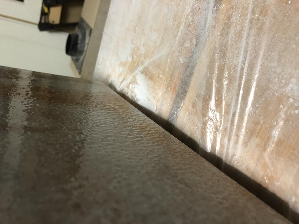

        I’m trying to cover the speaker in epoxy to make a solif and even foundation before I’m starting to paint it.
        I’m using Westsystem epoxy 105/206 mixed according to specification.
        However, the result is really crappy, pure shit! I’m getting absurd orange skin and uneven results.
        The epoxy was applied with a foam roll. I also experienced that even if I used a small foam roll - it sucked up a lot of the epoxy, leaving less to the speaker surface
        So, two questions for me:
        1) how do I get a better result
        2) what should I use to apply the epoxy with so that I do not have to use a lot just to fill the roller

            I have used a plastic putty knife and that works pretty well, and the next best thing would be a foam brush. That looks normal though for a seal coat though. The flood coat is the one that you want to come out smooth. Otherwise you can knock it down with sanding, or add another coat and then sand. The nice thing about epoxy is that you can always sand and add more. I used to order a lot of material when I did glass work from this place: https://www.fibreglast.com/ They also had some really good training DVD's too.
            Painter in training

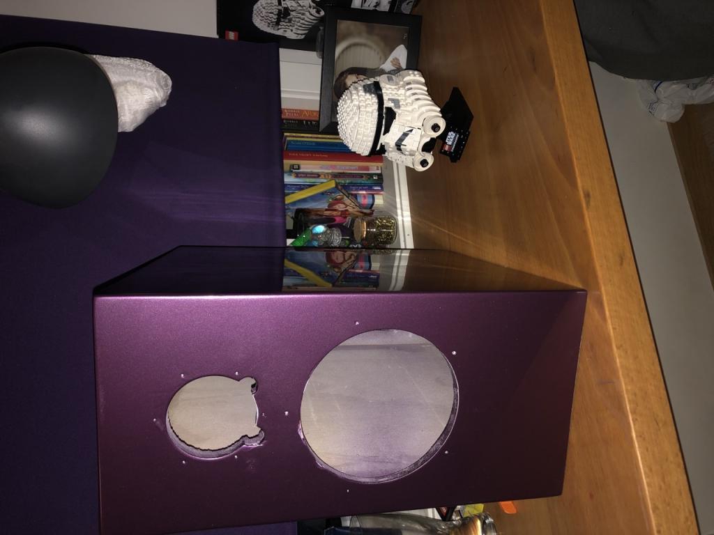

              This is one of the slowest build ever - that’s for sure!
              First, some experiences on the epoxy.
              My very subjective and personal thought is that the extreme orange skin I got was caused by some kind of reaction, most likely between the epoxy and the wood potty I used.
              When sanding the speakers before epoxying this was spread out and then mixed into the epoxy when it was applied. But just my subjective idea - may be correct or wrong.
              Anyway, I switched from the quite expensive epoxy I was using to cheap Biltema epoxy that also could be applied with a cheap spray gun. After quite some layers and sanding (main issue with thise was some bad ground work and issues with the mdf causing the need for quite some work to get everything even enough for a decent paint job.
              I found that process to go quite OK. The Biltema epoxy was quite easy to sand.
              Then I applied a couple of wet-in-wet layers of Glasurit gray filler and sanded it until I had a nice even finish.
              Added two and 1/3 layer of Glasurit wayer based metallic base coat in one go.
              Right after that I applied two wet-in-wet layers of clear coat.
              Got some light orange peal, and today I sanded in down, starting with 600 paper and worked me up to 4000 trough 1000 and 3000. Finished it off with polish.

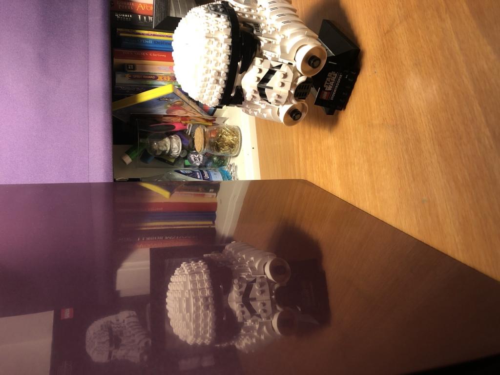

              No, just the electrical part left 😊
              Result...

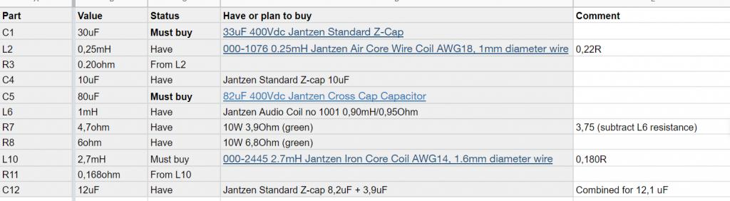

                      I have gone over the parts I have already and made up a overview of what I have and what I need to buy, as well as what I think I should buy.
                      But I do not know if what I have and what I'm planning to buy is right quality level for this speaker. I'm targeting "good enought" and "value" as principles for the selections here.
                      Overview of parts I have and are planning to order:
                      Any input on changes I should or must do are very welcome!
                        • 1044
                        For a small speaker, the Clarity CSAs are much smaller than the Jantzen Superior if you are going with an internal crossover. That will save you a bit of board area.
                        I don't have any of the Cross Caps or Standard Z for comparison, though.
                          Thanks bear!
                          I actually have quite OK with space for the crossover - and as this crossover has quite few components - I do not see that I will have any space issue with the selected caps.
                          Those that I already have is fairly small, and the other ones I have checked the size of and they are OK as well.
                          I'm more unsure if the Iron coil for L10 is OK to use or if there are some of these I should exchange due to quality issues - aka they are not "worthy" for the speaker elements, even given a hight focus on value vs. performance.
                            • 1044
                            Originally posted by TEK
                            Thanks bear!
                            A 15ga pCore might be worth the upgrade if it's available in that size. I've got a pair of 2mH ones on my Helios speakers that are almost complete. Hot glue doesn't seem to work too well with them, so a supplementary restraint (e.g., nylon cable ties aka "zip ties") are a good idea to keep them in place.

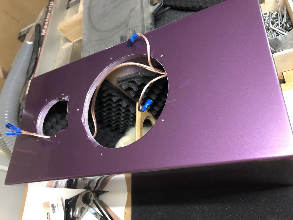

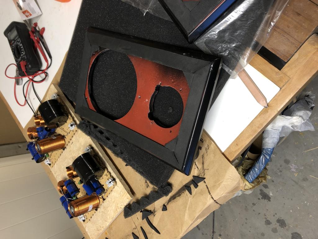

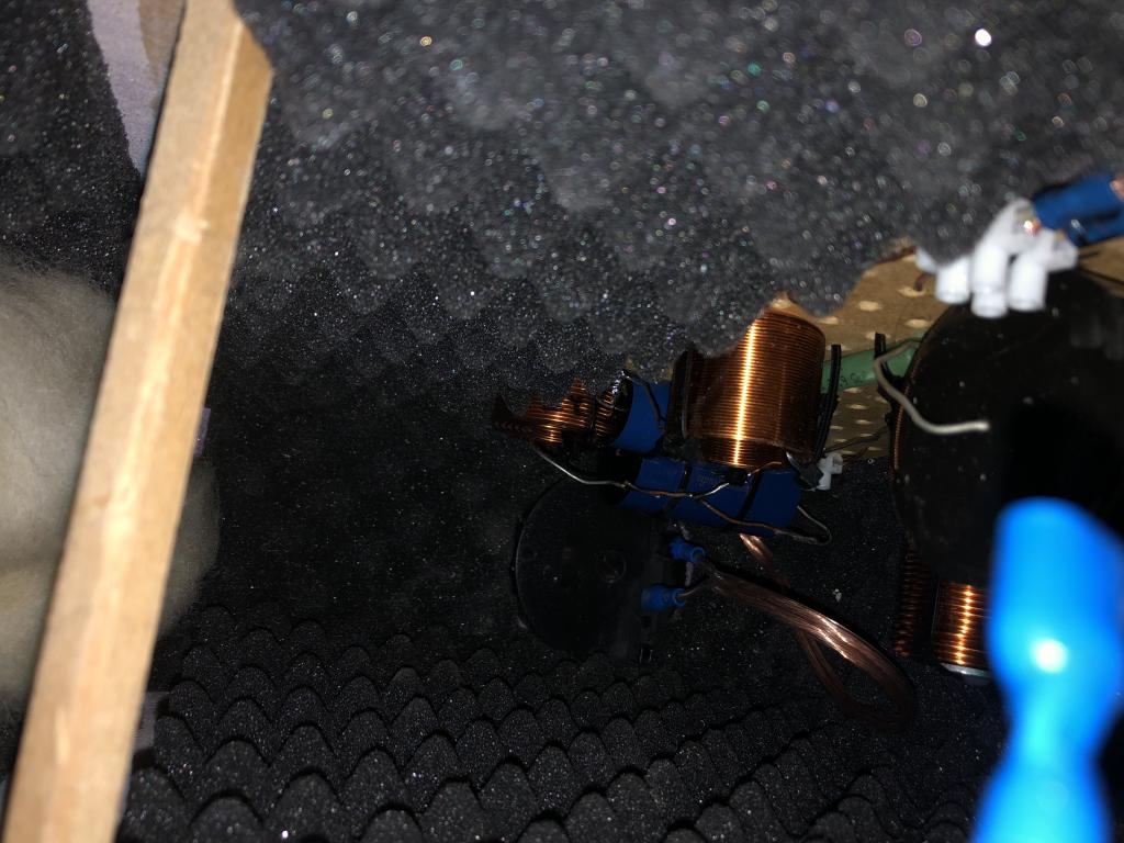

                              Ahh, and there is sound!
                              Just finished them tonight.
                              Both speakers was laster tested and verified to be working
                              Need to hook up the amp on her room as well as some speaker cabels, but getting there now!
                              Will get a picture of the completed speakers later, but for now, the last build pictures.

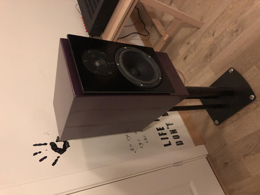

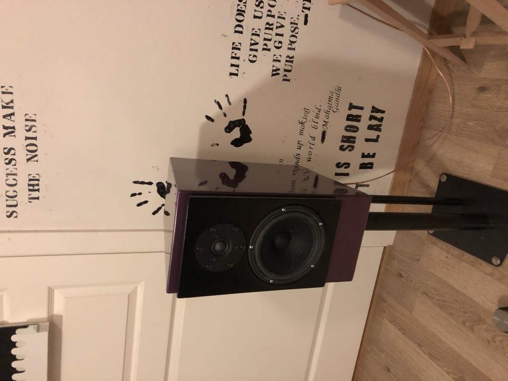

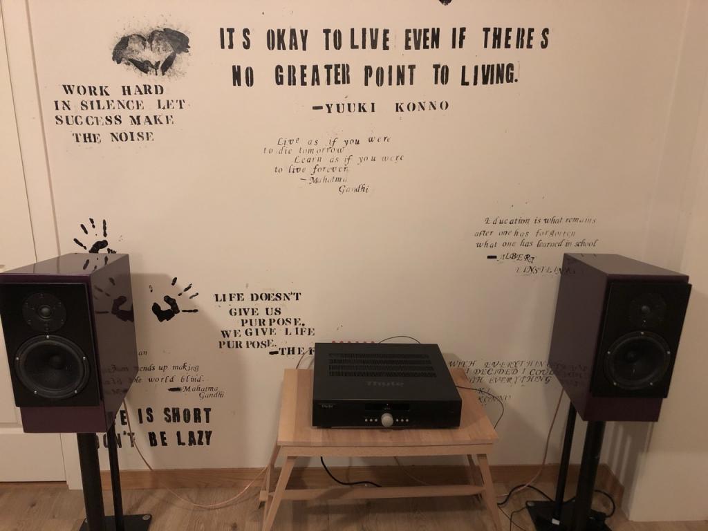

                                        Finished speakers...
                                          Very nice :T Love the stand off front baffle. How do they sound?
                                            Actually quite well!
                                            The placement is quite close to the wall/corner, but that does not seem to be a problem.
                                            The imaging is very good, and the singer is nicely placed in the middel as it should be.
                                            In the beginning I was wondering if they were a bit on the lean side, but after let them play for a day the have loosen up and seem to have developed to a nice and full sound.
                                            I will have to sit down for bit longer periode of time to do get a full impression, but so far I like what I hear.
