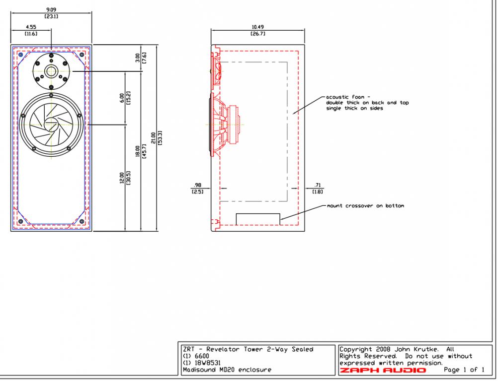

              I found The Zaph ZRT here:
              Guess this is the option that might be relevant for me: http://zaphaudio.com/ZRT-2way-sealed.pdf
              I'm afraid that the enclosure might be a bit to big - I have to look more into it.

                      Note that Zaph's cabinet is only 267mm deep. You can trade height for depth and maintain the same volume. If you keep the woofer and tweeter in relative position to the top and sides of the baffle, the changes to height shouldn't affect diffraction too much. Also, the ScanSpeak factory data would indicate a 16 - 17L cabinet, rather than a 20L cabinet. I think that there may be some flexibility with cabinet size and Qts without seriously compromising Zaph's crossover.
                        That is an ecellent point!
                        It’s high on the list!

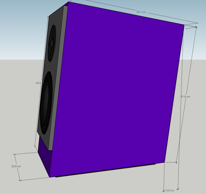

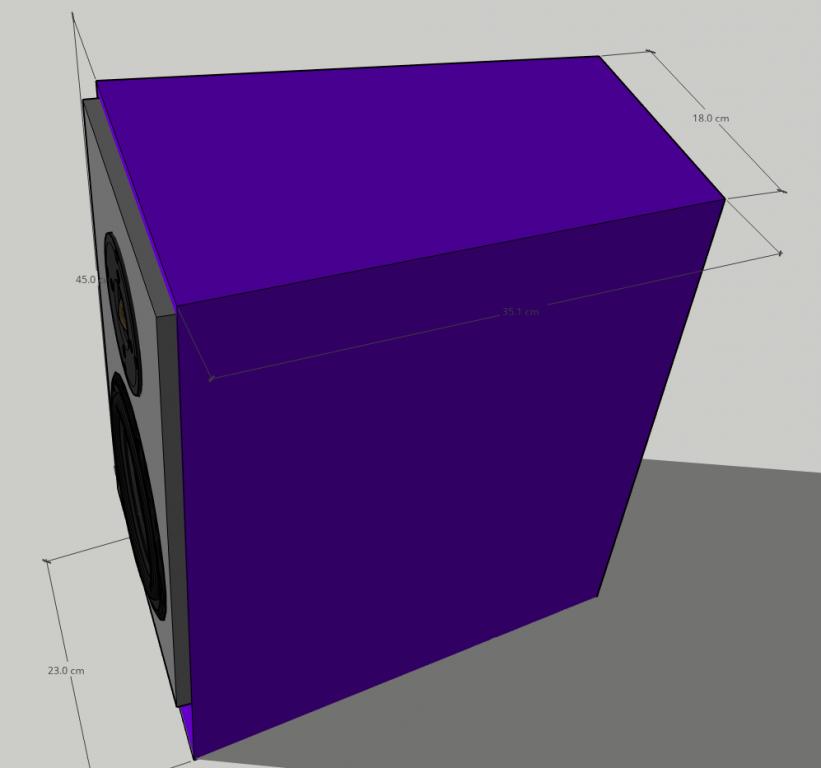

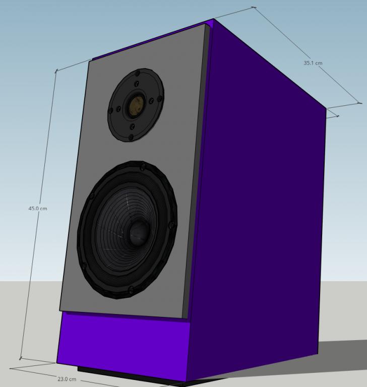

                                          I think we should start out saying that the max size is 23cm x 45cm x 35cm (w/h/d), and then adjust when we know what the best tradeoff between size and quality is.
                                            • 698
                                            I assume you more or less know the intended placement already too? Probably placed close to back wall? Whats the size of her room?
                                            Original Modula MT has the port to back. I used these on stands with front panel about 55cm from back wall in family room. There the bass response was ok, but depending on track one could sometimes wish for more. I had miniDSP Dirac DSP attached most of time and that helped to push the low end a bit.
                                            Now after finishing Ardents my kid has those speakers in his room which is approx 3m*5m. Speakers are on the long wall pushed quite close to back wall. In that scenario they have a lot of bass. Sometimes perhaps too much. So if your placement would be similar then putting the port to front or maybe even making them sealed is ok as it would result in better balance.
                                              Her room is approx 12-14 m2, 2.4m from floor to roof (norwegian standard).
                                              Placement is expected to vary, but it will likely be close to wall anyway. Freedom of placement is the main reason to go for a waveguide design instead of for example the ZRT.
                                              So I think that either a front port or perhaps a closed box construction is the way to go.

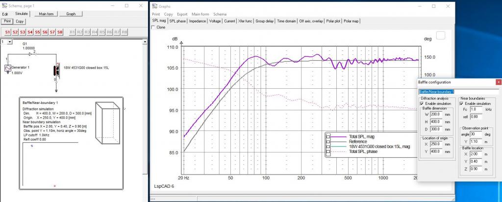

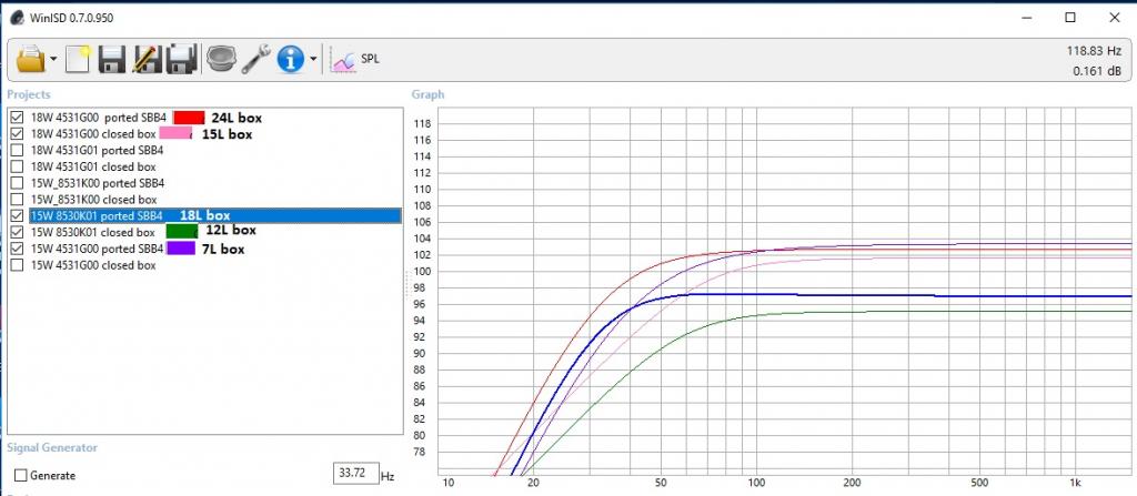

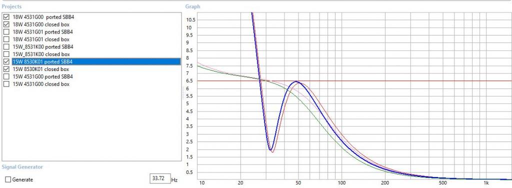

                                                Revelator 6'' vs 5'' options
                                                Hi TEK,
                                                I put some Revelators into WinISD for comparison. The most interesting option seems to be a 15W/8530K01. Putting that one in 18L ported box achieves a very good low end extension. The max SPL is a bit more limited of course compared to 18'' options, but for a room of this size I would think this is quite ok. Also these SPL curves are by adjusting the cone excursion to 6.5mm while the max is 9mm for 15W units and 11mm for 18W units. So there would be some reserve still to crank it louder with some distortion increase.
                                                15W/8530K01 does relatively well also in sealed box... I'd need to port these curves to LspCAD to analyze the room impact, but not today. Maybe the closed box would prove to be a good player too.
                                                I shared these WinISD project files here. If you install WinISD 0.7 you could play around with comparing those options

                                                PS. It appears Troels has done a design with these also but long time ago here
                                                  Thanks Ergo, that's great. Installing WinISD as we speak and will look into this a bit.
                                                  All the drivers in question is approximate the same price point, so cost is not an issue in the selection. I must admit that my first tought about going with 15W in a 19l box is that the tiny driver will look strange in that box ;-)
                                                  Maybe you or some of the others may explain this to me.
                                                  If we look at the 18W in a 15l closed box it has a max spl around 102db. It's -3db is already around 80hz and -6db (96db) around 55hz.
                                                  Is it possible to use the crossover to boost the lower end (and then of course at the same time lower the sensitivity of the speaker) to get a flatter respons? Doing so would give you the same sensitivity as with the 15W, almost the same falloff curve but in a closed design and a smaller box.
                                                  Is that like
                                                  a) yeah -sure, that's a good idea
                                                  or
                                                  b) hell no, that will degrate the whole sonic design of the speaker and is a really bad idea
                                                  As mentioned before, I do not know anything about crossover design - I just build tested and proven design that other has created...
                                                    OK, I have been playing around a bit with WinISD. I have also been checking a bit around. One of the things I find is that it is not many that is using the 18W/4531 in small speakers...

                                                    I also came across this thread that is discussing the volume required for the 18W/4531: http://www.htguide.com/forum/showthr...l=1#post479537
                                                    It seems that several has tested this driver - and that the result seems to be that it does not peform to good in a smaller box.
                                                    It's a bit interesting to see that jkrutke has commented. The signatur indicates that he is the one behind zaph-audio. Given he is the designer for the ZRT this quote is interesting,
                                                    what kind of real data or measurements would it take to prove to you that 22 liters vented is too small for a 18W/8531G00? Chances are I have that data and could post it here.
                                                    ref. post 19 in the previous referred thread.
                                                    So, what I take from this is that the 18W8531GOO needs a larger cabinet (likely 38l) for a vented design.
                                                    But then Zap has this on the site for the ZRT:
                                                    The sealed bass extension of the 18W8531 woofer is surprisingly satisfying in 19 liters
                                                    So, it seems to be working well in a relative small sealed design (19L) but not in a small vented design.
                                                    If I take this into consideration my real-life options now seems to be more in this direction:
                                                    1) Go for the W18 driver in a closed design
                                                    2) Go for the W15 driver in a vented design
                                                    For 2) there are several designs out there, both with and without waveguides.
                                                    For 1) there is no know designs with waveguide, so if that is to happend it will have to be a Modula MkIII design...
                                                    So, I guess the real question is if we expect a W18 driver in a closed cabinet to give a good result (better than a W15 in a ported cabinet).
                                                    So maybe focusing on pros and cons of a W18 in a sealed box vs. W15 in an open box is what has to be done to come to a conclution!
                                                    Last edited by TEK; 06 January 2019, 16:46 Sunday. Reason: I think I mixed conclutions between 19l sealed and vented cabinets. It seems like small closed is OK, but not small wented...

                                                        TEK, this is a simulation of 18W 4531G00 15L closed box placed in a room. Not bad at all with -6dB point at approx 50Hz.
                                                        You see from image what type of data I need to enter. If you have ideas for box size and how far it is from side wall / back wall then I could run few more such scenarios. (the "baffle location" is the bottom left corner of the baffle)

                                                          Nice ergo!
                                                          Her current room is 3.5m x 3.5m.
                                                          The most likely placement in the room is that the front baffel is 40cm from the back wall (on a bench 40cm wide) and 100cm from the side wall. Another possible option is that they will be placed on stands, and then probably 50-80cm from the back wall.
                                                          When looking at the 18W4531G00 in this configuration it becomes interesting to evaluate the pros vs a 15W driver in a vented design (possible with the option to plug the vent) of the same cabinet size. As we now seems to be down to almost the same cabinet size this becomes an interesting question I think...
                                                            One thing to keep in mind about a sealed configuration is that it automatically provides a layer of protection from woofer over-excursion. I don't know what your daughters listening habits are like but this might be worth some consideration?

                                                                        After some dialog with my daugheter we have agreed upon a design that should give me some challanges to execute - hope I'm up for it
                                                                        As you might recall, due to a lot of fact - real life insident beeing a major player - the design I'm going with is a quite small closed box Zaph ZRT 2-way design.
                                                                        Quite like this one, but a little bit smaller: http://zaphaudio.com/ZRT-2way-sealed.pdf
                                                                        All about the ZRT design: http://zaphaudio.com/ZRT.html
                                                                        This is our current sketcup model of the to-be speaker:
Name:	HT til Susanne (1).jpg
Name:	HT til Susanne (2).jpg
Name:	HT til Susanne (3).jpg
                                                                        The purple part will be metallic purple and the gray will be metallic gray.
                                                                        The plan is to spray paint the part separated - and then mount them togheter afterwards.

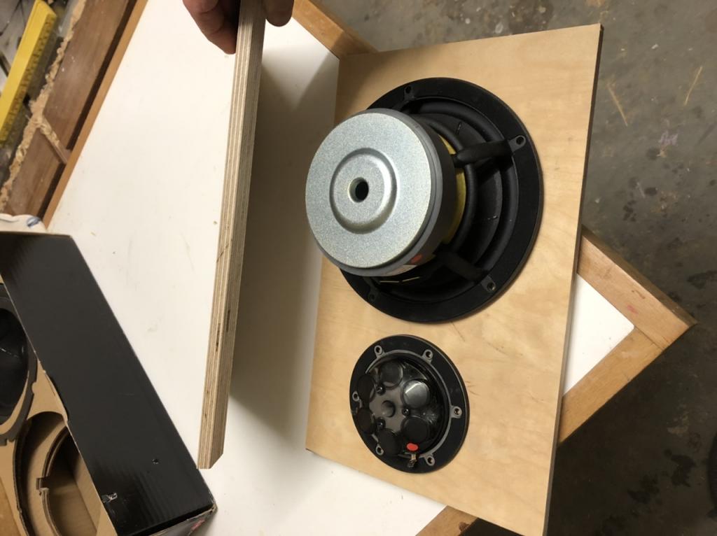

                                                                        If anyone has any good ideas about how to mount the baffel to the box - after it has been painted - please share.
                                                                        Right now I'm not to sure about that. I did do something like this one time before - that time I glued it on, but I did get some bad experiences on adding pressure after the paint job (I got marks in the paint).
                                                                        Drive placement may not be accurate on my drawings. I will follow the original drawing for placment of the tweeter according to the top of the cabinet as well as the distance between the tweeter and the mid-bass.
Name:	HT til Susanne (4).jpg

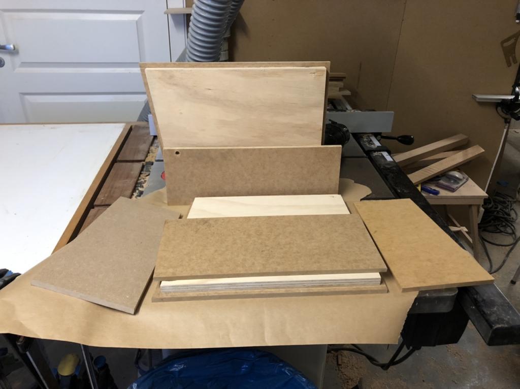

                                                                          Test fitting the box after figuring out the angels.
                                                                          Now to make top and bottoms as well as inner walls.
                                                                            • 698
                                                                            Nice design.
                                                                            I used threaded rods cut to right length and then put the washers and nuts on through the woofer opening and tightened with the small wrench. But hexagon headed bolts might be even better into the wood nuts in front panel. If lengths are calculated right there should be no problem
                                                                            Your front panels seems thinner though, so maybe not the best strategy here.
                                                                              Thanks for the advice ergo.
                                                                              Not sure what I will make the baffel plate from yet - if it’s thick enough I will probably go with your suggestion.
                                                                              I think I have some insets I may use as well, maybe some gasket material as well.

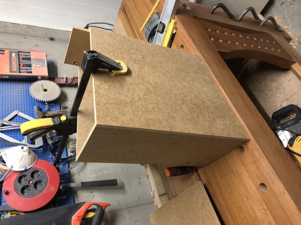

                                                                                Hmm, ok - have some parts, and after a lot of adjusting I think they go together resonable well.

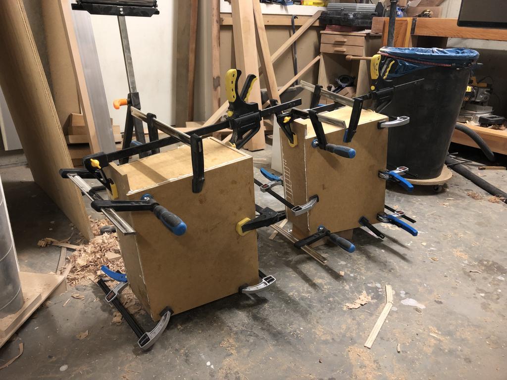

                                                                                Now, let se if it’s possible to glue this together 8O
                                                                                  And now we wait...

                                                                                        The outer front baffels will ve made from 18mm good quality plywood, with chamfered edges to make it look floating (as well as thinner).
                                                                                        No decition on how to fasten the baffel yet. I’m wondering about adding a hardwood backing behind the mdf and maybe screw the front baffel on by just using long screws for the elements, so that the elements screws both fasten the elements as well as the outer baffel.Click image for larger version
