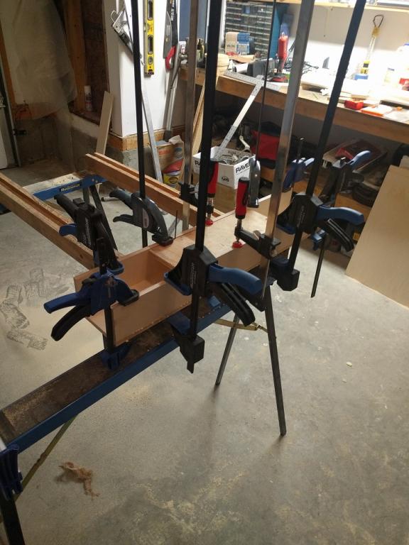

    Clamps!
Name:	IMG_20170826_153429 - Copy.jpg

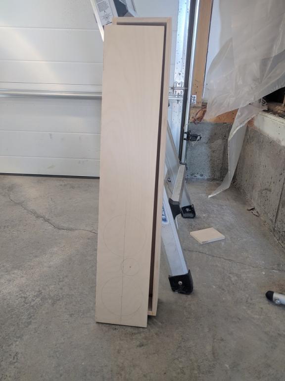

    Taking shape, tall, shallow, and skinny...
Name:	IMG_20170828_201749 - Copy.jpg

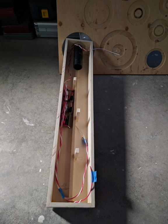

    Crossover mounted
Name:	IMG_20170902_172519 - Copy.jpg

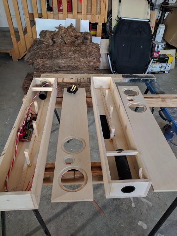

    Almost ready to glue the baffle
  • RookieBuilder
    • Feb 2017
    • 41
Name:	IMG_20170904_140024 - Copy.jpg

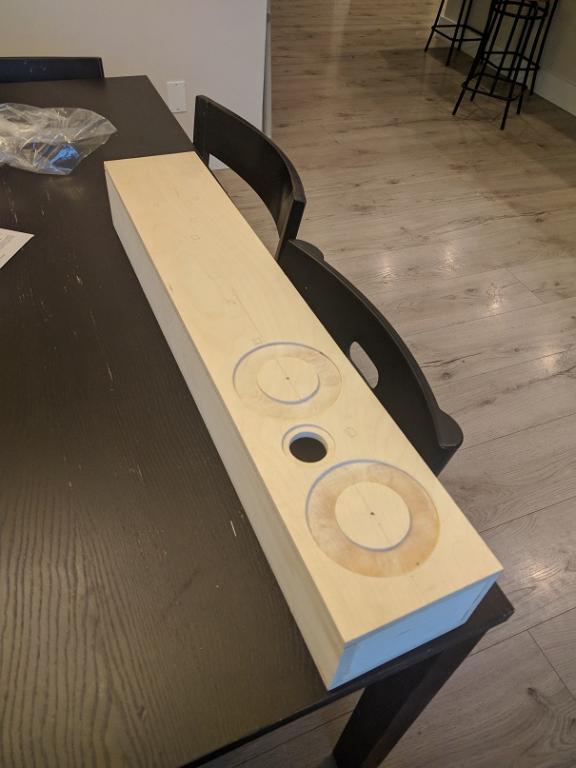

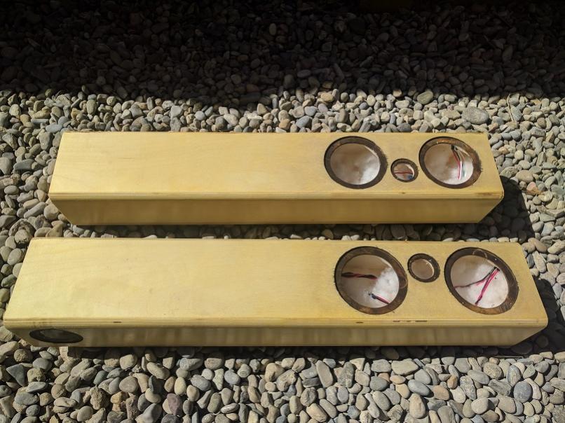

    Glued and ready for veneer
Name:	IMG_20170904_202139 - Copy.jpg

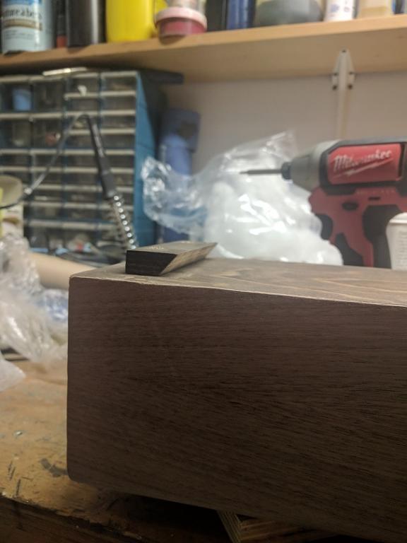

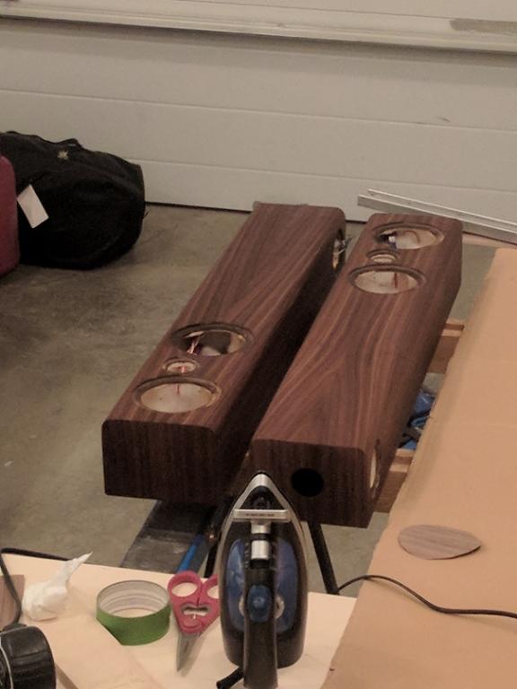

    Walnut veneer, cutting holes with a utility knife. I understand why people veneer first and cut holes second
Name:	IMG_20170904_205351 - Copy.jpg

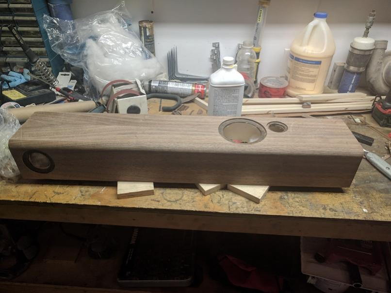

    Letting the oil cure
Name:	IMG_20170906_180654 - Copy.jpg

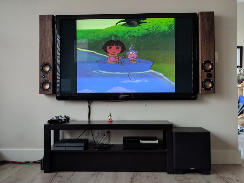

    Finished! There are some flaws but I'll never tell
    • Bill Schneider
      • 158
      Those look nice. Good craftsmanship!

                      I am happy to say the project turned out as hoped, they give me a significant improvement in sound quality and volume over the sound bar and have a sleek mounting option that the towers didn't have.
                      A bit about my setup before I give my 'review'. I built the box at a slightly smaller volume than spec, I think about half a liter less. The boxes are about half the depth as specified and I wall mounted them, I believe the design has full baffle step compensation. The ports fire up and I have stuffed them with open cell foam to try and combat bloat in the lower end due to my mounting situation. I have a sealed 12" sub crossed at 80hz. I have them powered by an AV receiver and in this case use the room correction.
                      Perhaps less of a review and more my rambling thoughts; From a sonics standpoint they have a relaxed mid range by design, I EQ'd this out with the AV receiver. They are excellent when paired with a sub for my uses, background music, TV, and some moderate volume use (usually combined with 2-3 zones for this). They are a relatively easy project, very small, and cost effective speakers and as such they are fantastic. While not as good as either pair of towers they replaced they are no slouch. Compared to the towers they give up imaging/soundstage, sound 'boxier', and loose some presence in the room. Having said that remember the compromises cost, size and mounting location. By comparison the towers were substantially bigger and cost 3 and 5 times the total price. Over the soundbar they gained imaging/soundstage, sound much less boxy, and gain presence in the room, while costing 1/3 less and looking considerably better. The Overnight Sensations are something I actually want to listen to whereas the soundbar was utilitarian and never got turned on for music.
                      For me the intent was never critical listening, if it was I would look much closer at Bagby's Sopranos or a larger design. There is no escaping physics and despite being high value low cost parts, they are still low cost parts. They are an easy to listen to speaker that are a very good performer for the cost.
