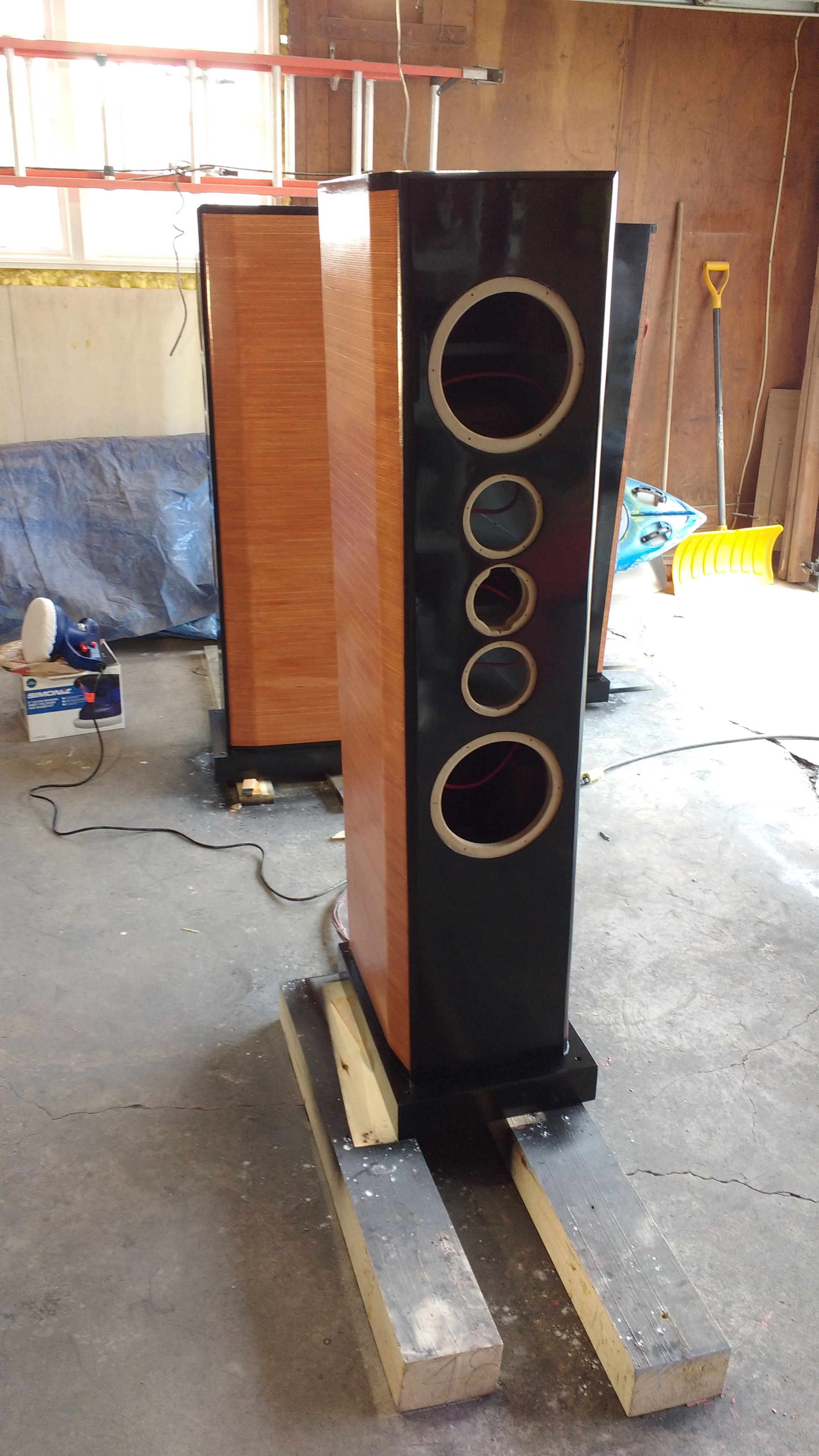

    Here are the cabinets completed.
    Image not available​

        Very nice. What is the finish on your Statements?
        • Hellcommute
          • May 2017
          • 9
          Baltic birch on sides stained with terracotta water based minwax then shellac. The rest is MDF primed and painted with tremclad high gloss black, then high glossclear. Sanded to 1500 grit. Then cut and polished with meguiars componds.
          Lot of sanding. And cursing. . They arent perfect.... If I could do it again I would skip the clear coat and polish out the high gloss black. The clear coat didnt dry glossy enough. Too humid.

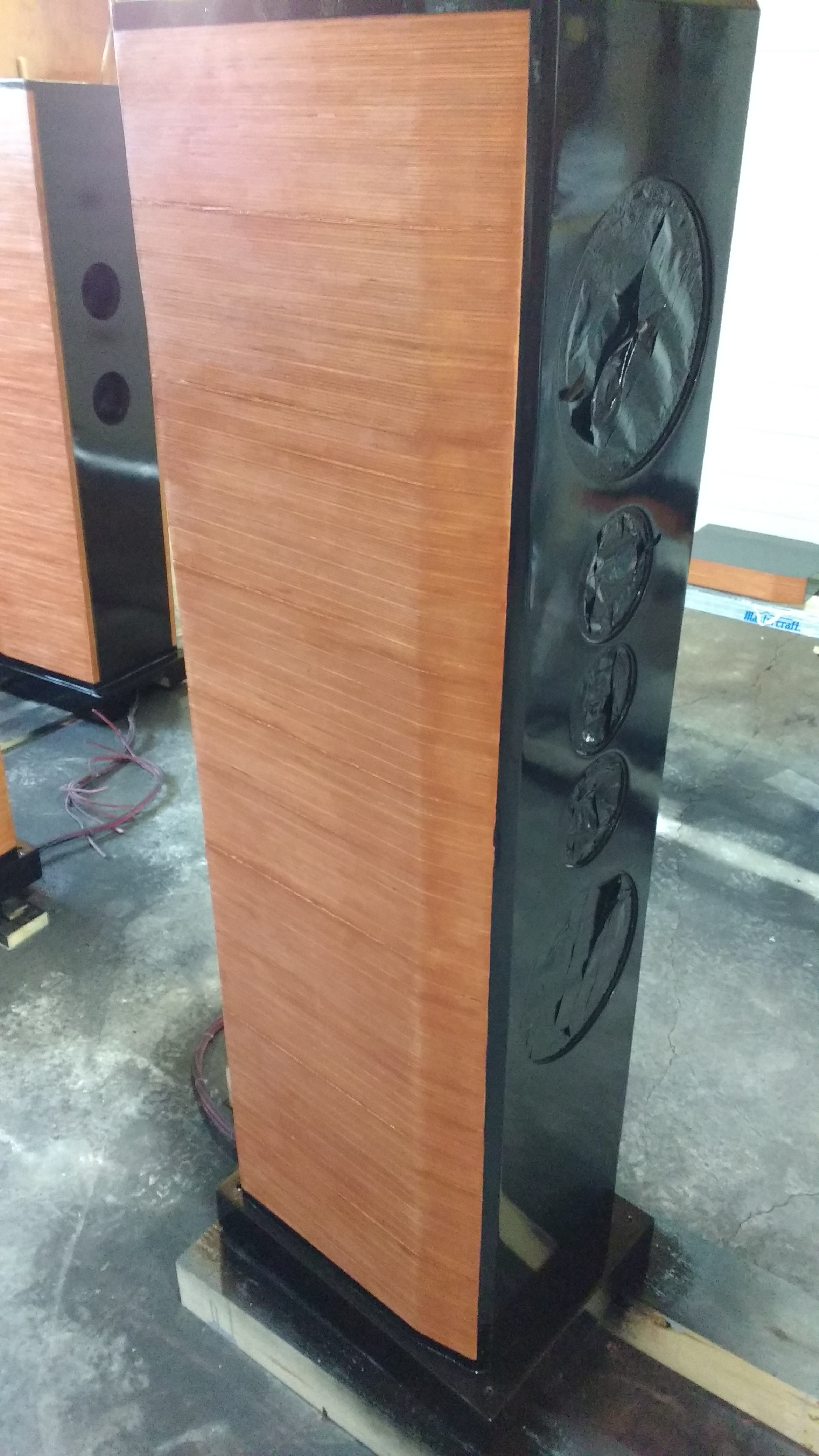

                Very awesome review and great work on the finish. How did you get the Russian Baltic Birch plywood sides to look that good? Can you explain and/or do you have more pictures of the finish process? Thanks!
                • Hellcommute
                  • May 2017
                  • 9
                  I ripped sheets into 3/4 strips then glued and toe nailed with brads to the sides of the cabinets. Then sanded with a belt sander, an orbital, by hand and finally polished them out after shellac. A bit of a process, but worth it. Was fun.
                  Last edited by theSven; 05 July 2023, 15:23 Wednesday. Reason: Update image location

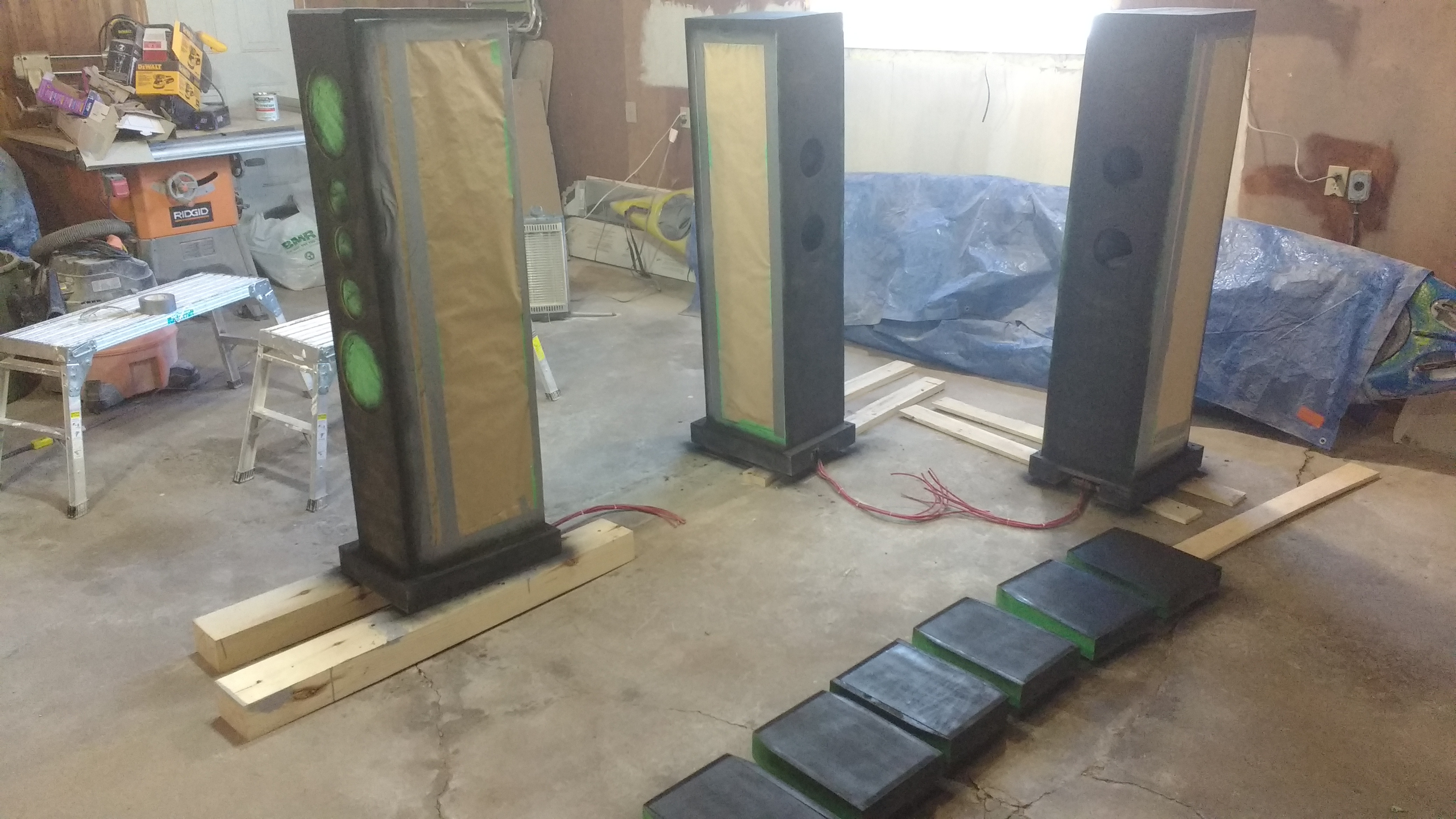

                      • Hellcommute
                        • May 2017
                        • 9
                        After a coat of stain they were masked before blacking out the top cap, front and back. Taking time to mask sharp lines is important. I reinforced the mask with duct tape over the green painters tape. Using green painters tape is best when applying solvent based spray paint.

                            • Hellcommute
                              • May 2017
                              • 9
                              And finally after two coats of shellac on the sides and then two coats of high gloss clear over everything. Wet sanded with 1500 everywhere lightly and cut and polished with a car buffer. Pretty neat to see them gloss up in this step.
                              Ready for drivers. They look nice in sunlight and deep and dramatic is the dimly lit theater. Cool stuff. Good luck with yours!!
