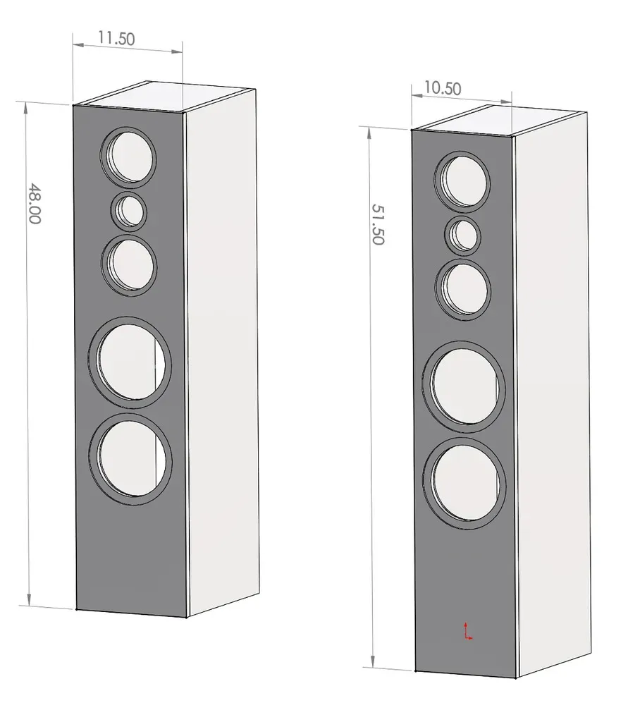

    I would like to build the anthologies and had a few questions before I start…I have attached a few images showing my modification ideas.
    For aesthetic reasons I want to skinny the front baffle up. I have modeled the speaker with a 10.5in vs 11.5in width. I have made the cabinet 3.5in taller and .5in deeper which makes it the exact same internal volume as the design calls for.
    My question is how this will affect sound? Is it a deal breaker or can I get away with this change.

    • 16175
    Making the front baffle narrower is not a good idea- the baffle width controls the shape of the baffle step curve of the enclosure, i.e. the frequency response from 1kHz down to about 200 Hz, and modifying this will impact the design performance in that frequency range, and necessitate crossover changes if you want to keep the same on axis response. Use the original design width if at all possible. A half inch might not be very noticeable- 1" will be. Jim Holz might advise you further on that.

      hey Jon,
      thanks a lot for your input! maybe I can reduce the baffle .25in on each side instead of .5in? the wife likes tall skinny towers so I'm trying to obviously make her happy as she seems to be getting more into quality speakers lately...

        Hi Michael,
        As Jon clearly stated, any design changes on a speaker result in compromises. The easy answer is build it as designed for best sound quality. We don't recommend changes to our designs but you can do it. Curt has determined that most designs can tolerate up to 10% deviation in width and depth with out adverse effects that would be audible. The height difference won't matter as long as the tweeter is at ear height and driver spacing is maintained. This is the "Y" part of DIY.

            So I compromised and made the width 10.75 instead of 11.5...so less than 10% deviation.

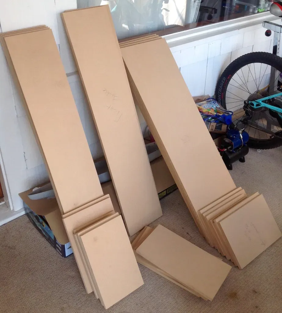

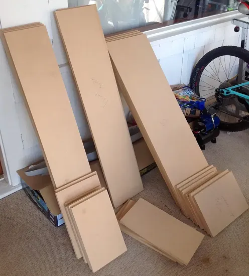

            Cut the parts today with my dad's help.

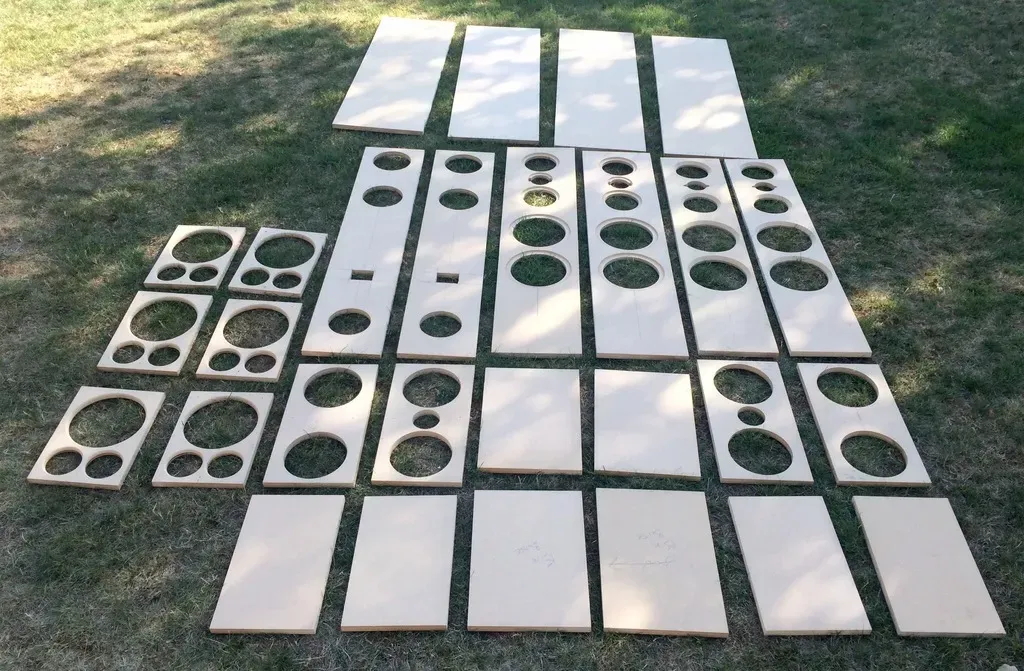

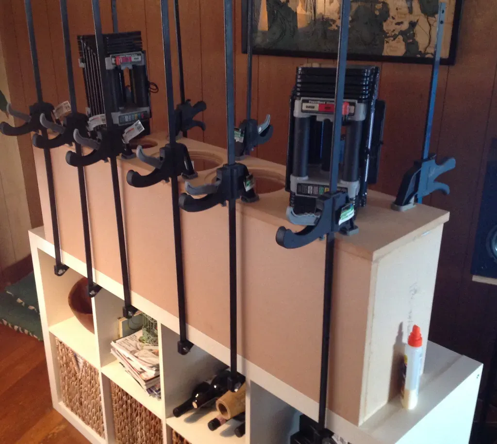

                ok, lots of progress made with a only few hiccups...
                got some help cutting all the holes

                finished parts!

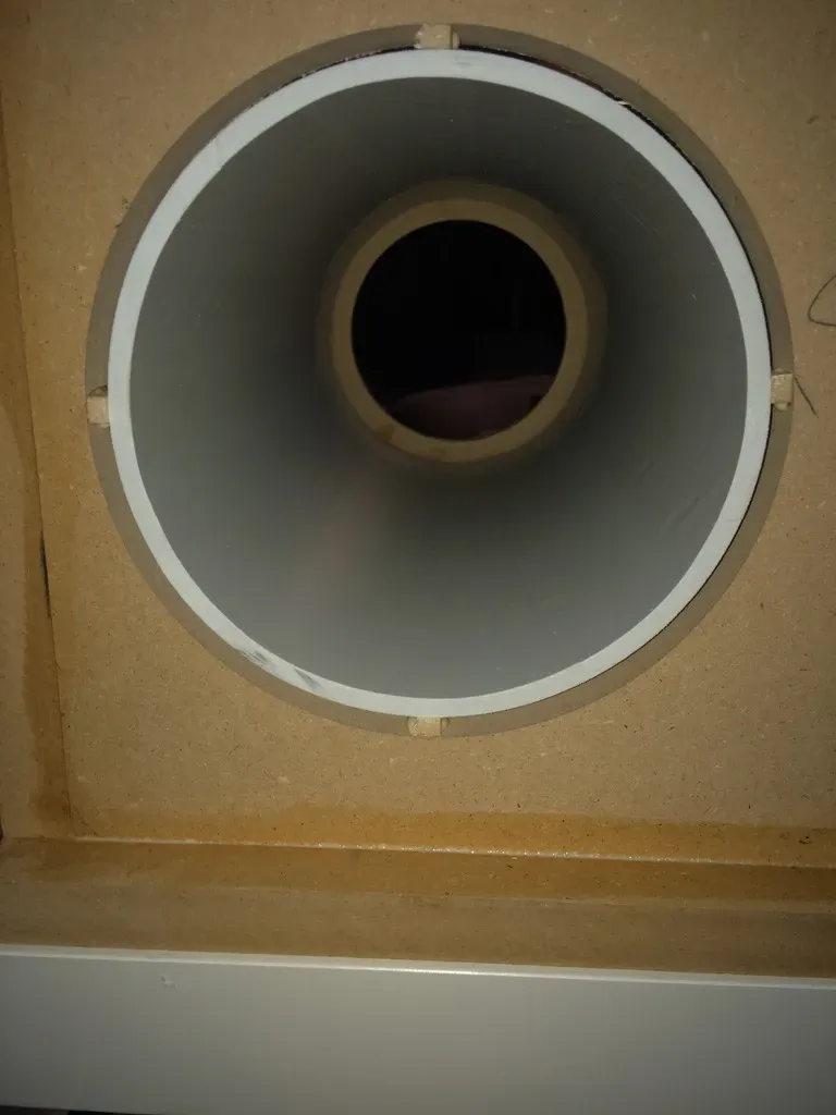

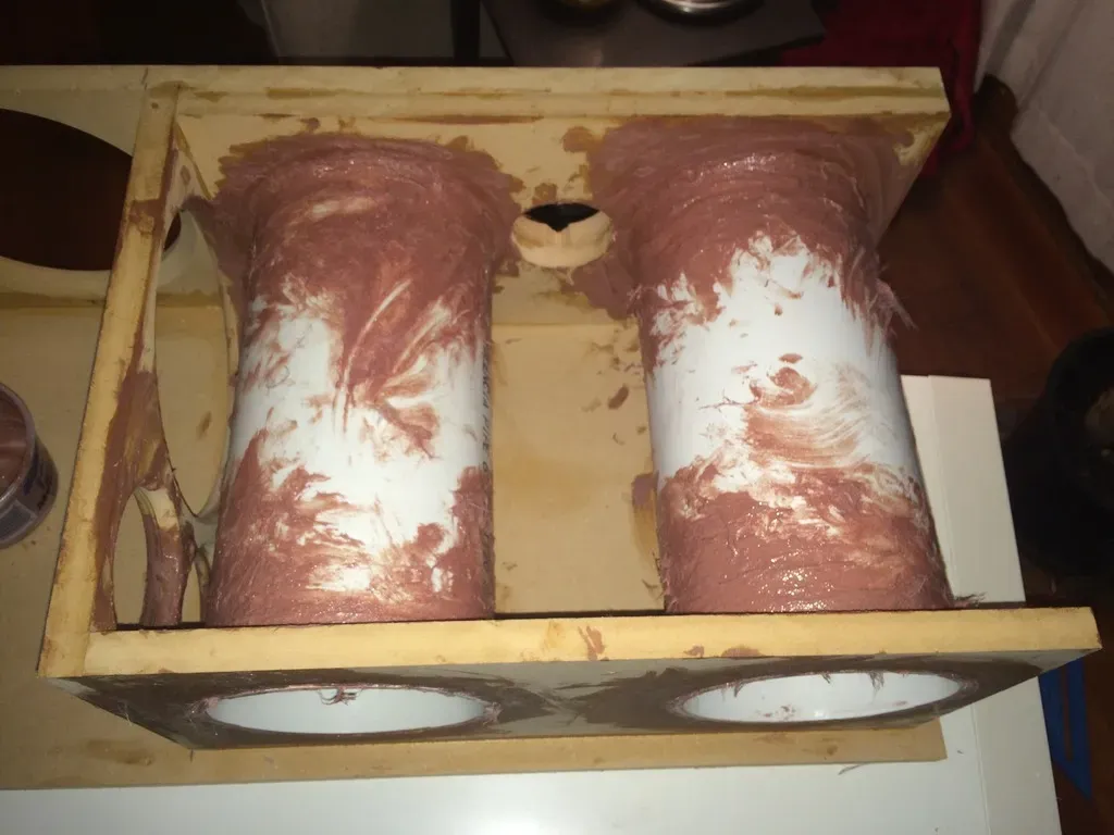

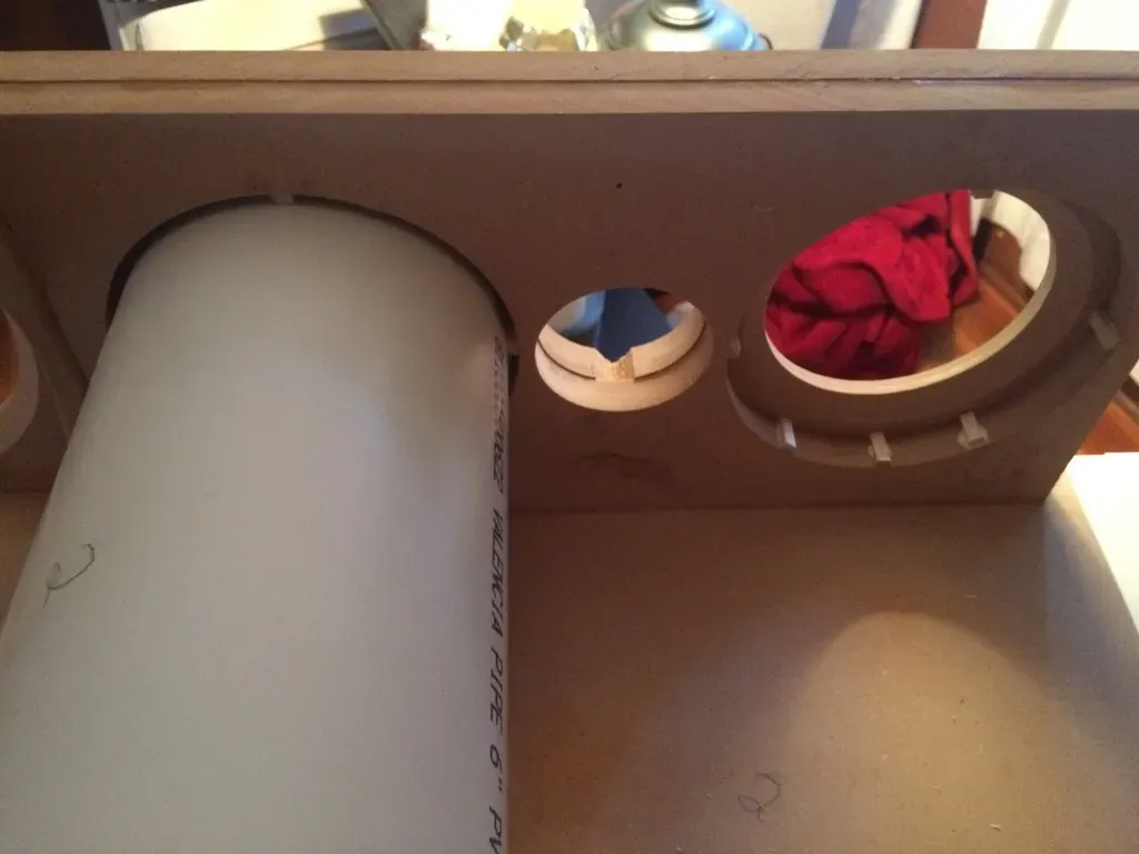

                so hit a snag involving the PVC pipe...I could NOT find the thick walled stuff. home depot and lowes would not order it in. plumbing stores wanted to sell me 20ft at a crazy price.
                I found thinner wall PVC, however I had already cut out the holes...I just made up a bunch of 3/16 blocks to center the new pipes in the hole...they still have a 6in inner diameter. I then made a epoxy putty with west systems and a filler compound I use on boat jobs.
                this got lathered up and forced into the space between the pipe and wood. also sanded the pvc and washed to help it get mechanical grip with the epoxy putty. was messy but seemed to solve the whole problem.

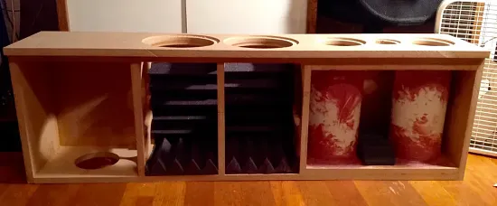

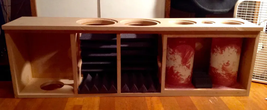

                rest of the cabinet has gone together easily.
                working with the foam...

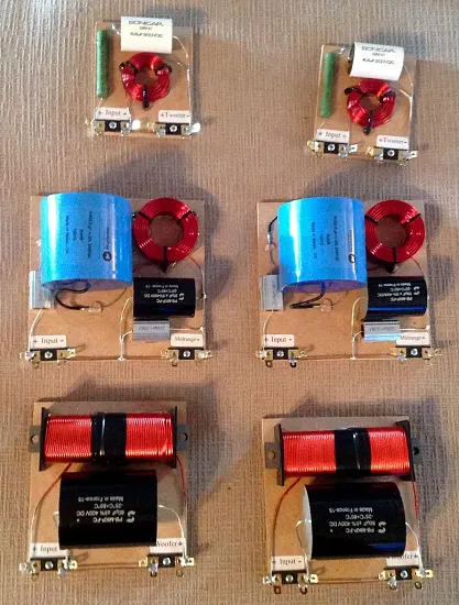

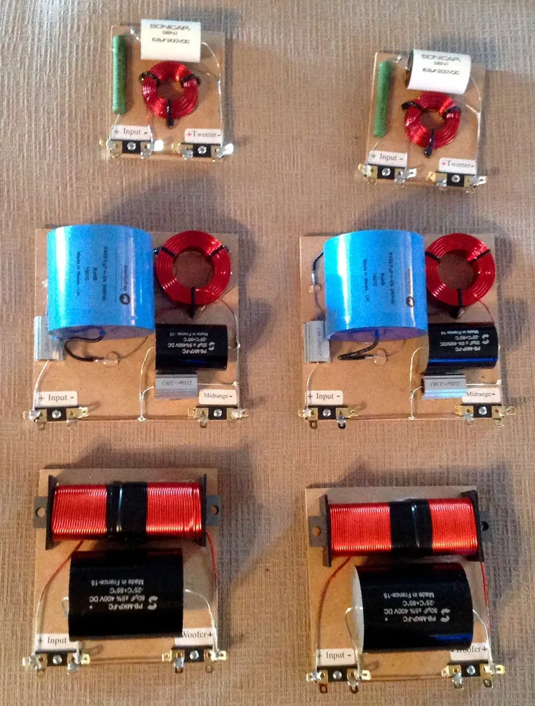

                finally onto the crossovers from meniscus. Chad did a great job assembling them and I cant image NOT spending the money to have him do it.

                  So what the heck OD is the PVC you can get locally and does it have a "schedule" number? The home stores all stock schedule 40 & some 80 here in the Midwest. The schedule 40 measures 6 5/8". The PVC you used looks more than strong enough to work as bracing and the mid tunnels. Nice save, BTW!

                    this is what I used, it feels VERY strong at these short lengths so I wasn't too worried. its 6.25 od http://www.homedepot.com/p/VPC-6-in-...06-2/202564459
                    I have a question on a few things, I know on other threads that you said there is no need to put foam in the port area...would any help at all down there? maybe some 1in flat is some places? I was going to put 8 oz of poly in the area around he PVC compartment, hopefully this is enough
                    also is it ok to hard attach the crossovers to the cabinet or would isolating it wish rubber or something help? thanks a ton, finally beginning to see the finish line with these and cant wait to listen!

                      And agreed on the nice save on the PVC pipe. Very reasonable solution. But, and not to kick you, but I am wondering if your holes accidentally got cut bigger. Schedule 40 is universal pvc pipe and according to google is 6-5/8" OD x 6" ID.

                        Hi Michael,
                        Adding foam below the bottom brace in the port area won't do anything. The sound waves can't reflect back in the bottom of the cabinet. It won't hurt anything but you won't add any benefit either. The purpose of the foam is to kill reflected back waves from the driver which cause distortion when they're reflected back into the rear of the driver. The poly in the top 1/2 is optional. I stuffed mine with poly just because i could but all it does is make the cabinet look slightly larger to the RS225's. The cabinet is sized correctly to start with so little value is gained.
                        I have always screwed the crossover mount securely to a brace or side of the cabinet (carefully) to secure them. No worried attaching them securely.
                        As always, I look forward to hearing builder feedback. Let them burn in about 20 hours playing back ground music and then set down to seriously listen to them playing well recorded CD's. Let us know what you think.
