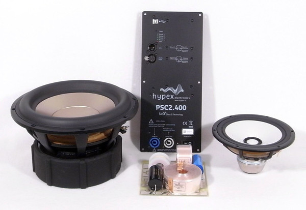

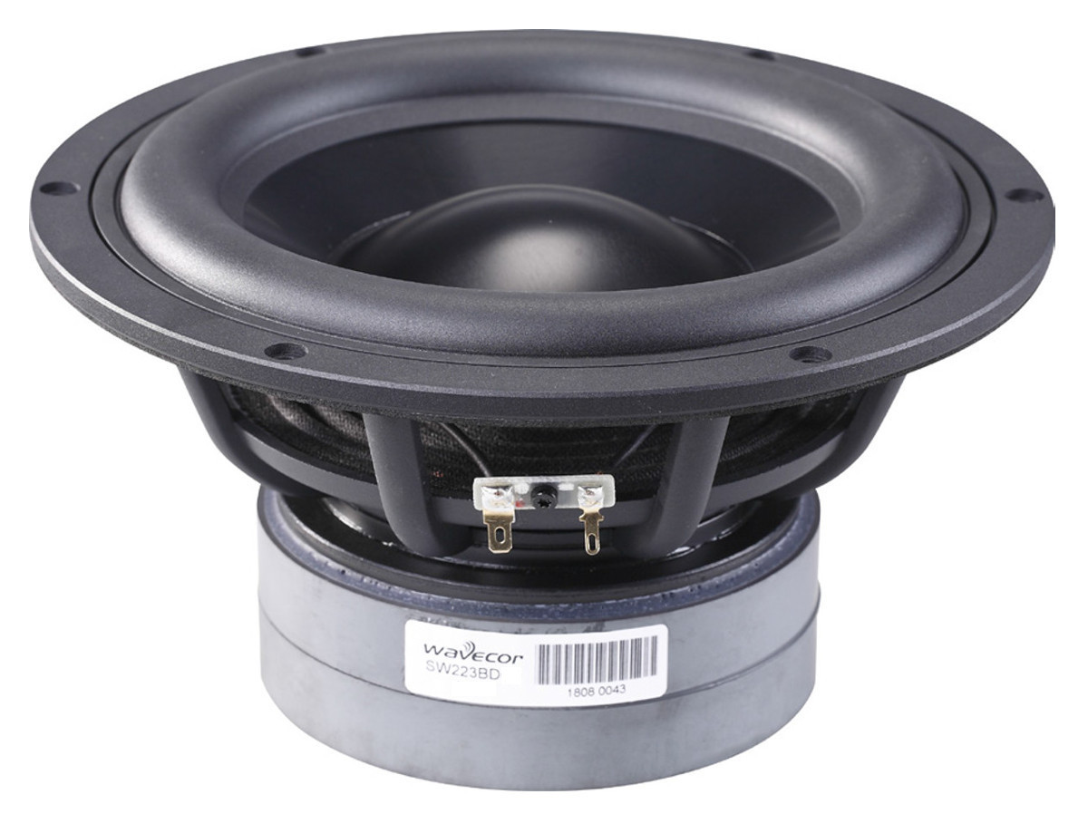

    So- back to the Minerva Monitor.

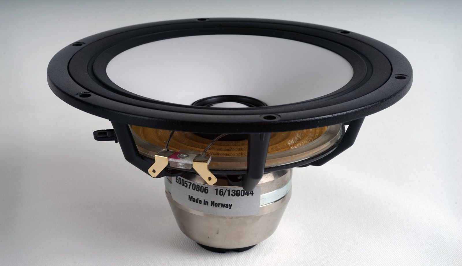

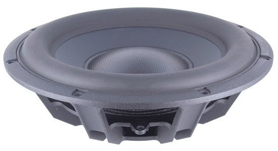

    This is a TAD inspired design (think Compact Evolution One) "stand mount" design using the Seas C18EN001 concentric Midrange/tweeter driver, with low frequencies handled by the combination of Wavecor SW223BD02 and ScanSpeak Discovery 26W/0-00 10" Passive Radiator. yeah, it's not hardly fair putting that LF combo up against the 6-1/2" ported woofer used in the Compact Evolution One, but then it wasn't fair putting the SW223BD01/2 up against the Eton 7" woofers used in the Indra either. Some would say, if you're not cheating, you're not trying hard enough.

    And if the electronics in the Hypex plate amp (A/D; DSP; D/A, UcD modules) are up to the quality standard you want, this might be a system to take a close look at. OTOH, for me, I can't bear the thought of running any of my DAC's into this for music. It might be really killer for HT, though- think a 2.1 system without the 0.1!

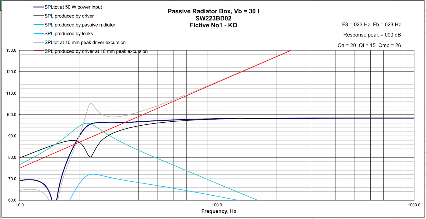

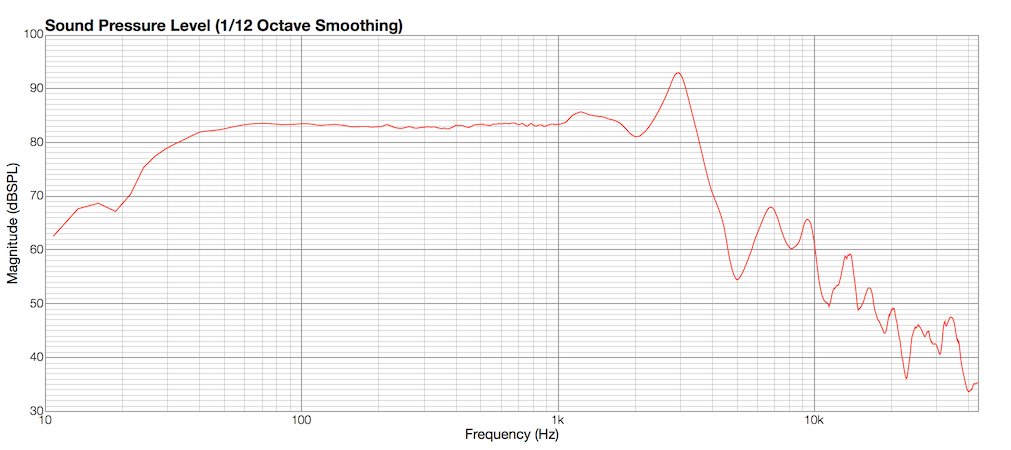

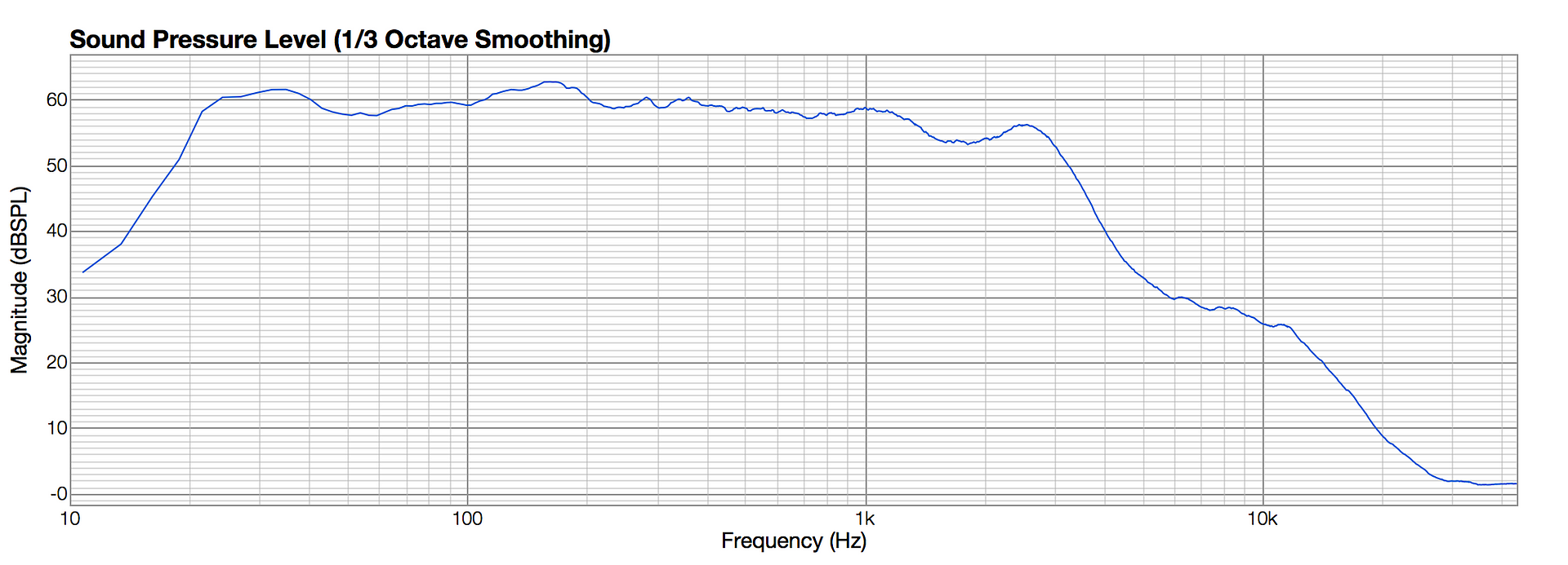

          Well, you know what they say- it's all about trade-offs. In this case, I wondered how close I could come to making a stand mounted box that would do something close to 20-20K. Originally I was thinking in terms of the PR223BD02, and I have a couple of those on hand, but the SS PR in the bone stock configuration just models better.
          Initial testing confirmed the validity of this approach, at least at a first cut.
          Near field output of SW223BD02
          "summed" output (mic directly to the side, half way between woofer and PR)

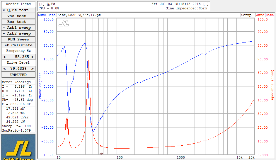

          Also, for this design, being a bit of a b@ll-buster for load impedance was not deemed so much of an issue, because one of the original intents was to make a challenging load for testing Class D amplifiers, both things I'm working on an the IR Class D stuff developed by the "new" Infineon Americas since we bought International Rectifier. So, in this case a nominal 4 ohm load that looks a bit like 3 ohms at times wasn't going to scare me off. OTOH, the impedance of the SW223BD02 reveals a well designed motor with lots of copper in the gap, and a very easy impedance curve to work with for a three way. Notice the impedance curve shows the box tuning on the money from prediction, just a bit over 20Hz.

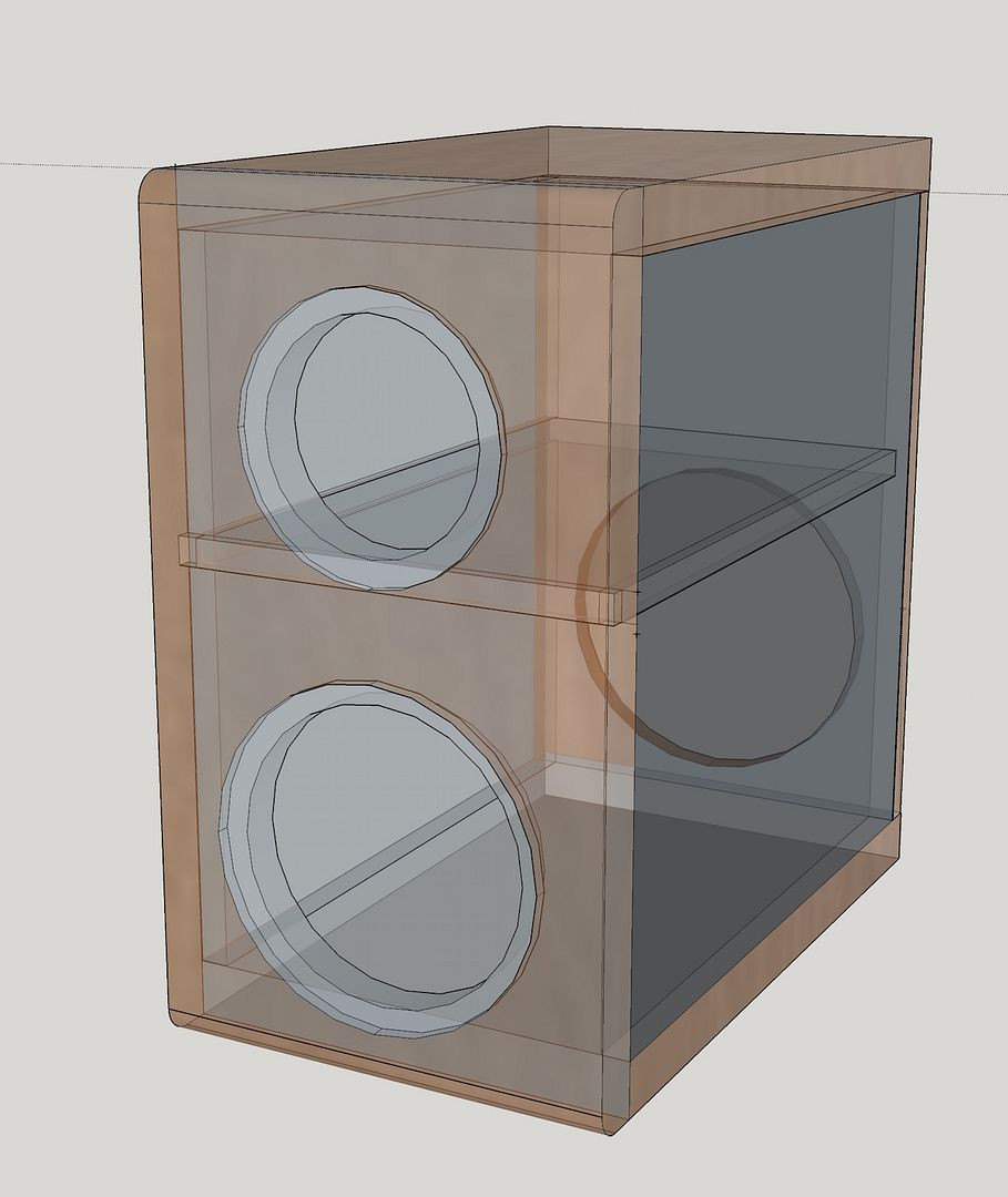

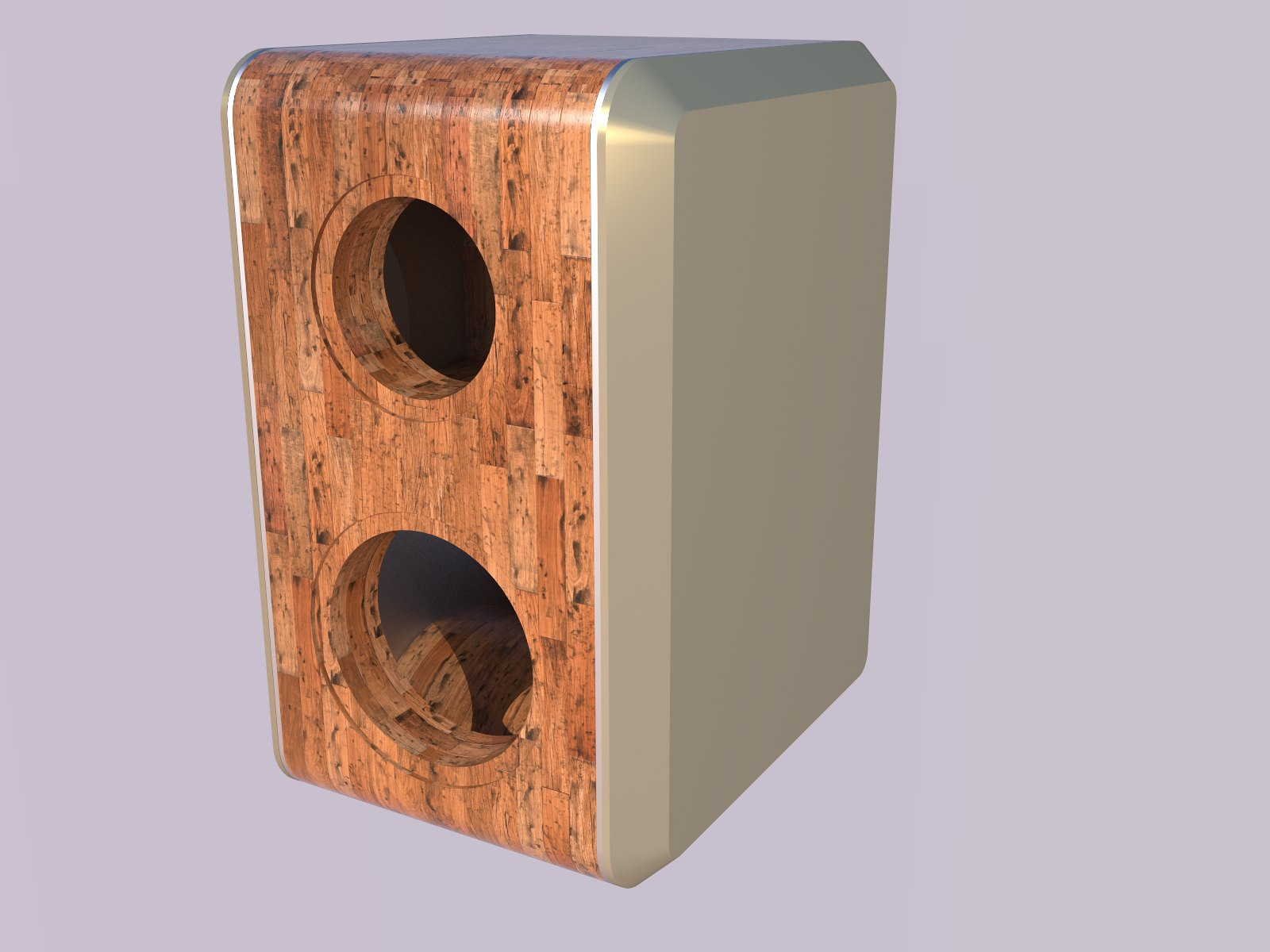

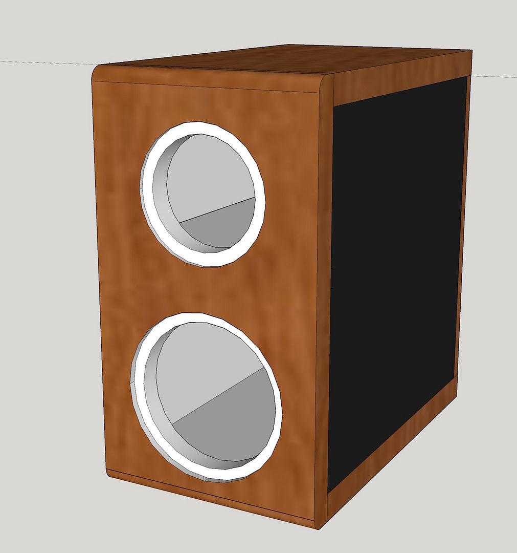

              Table Saw Minerva Monitor concept
              OK- for quick reference for the new thread- the table saw concept version of the Minerva Monitor, with built in crossover, maple stools for speaker stands are optional extras.
              This is included so folks won't have to go bouncing around between threads to pick up the key points.

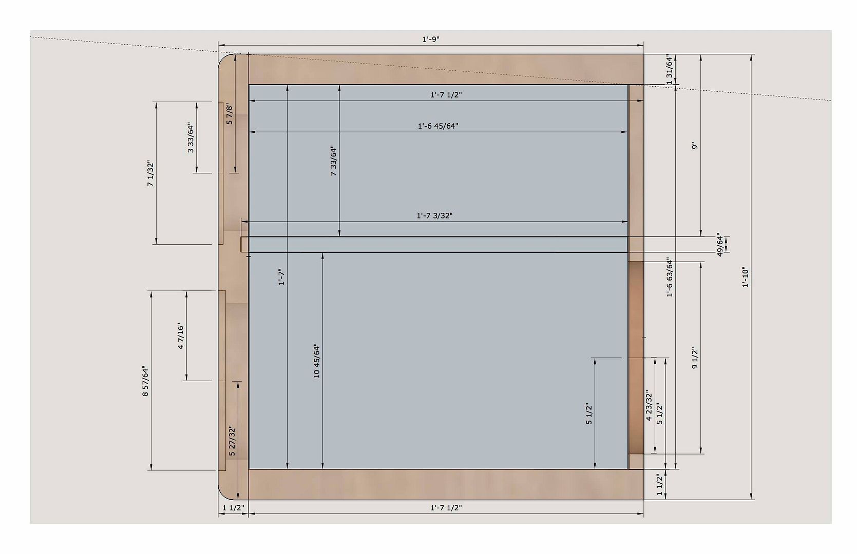

              Most of the material is a LBL, with some BB ply on some inner walls.

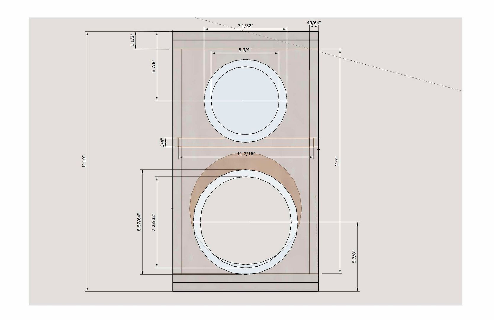

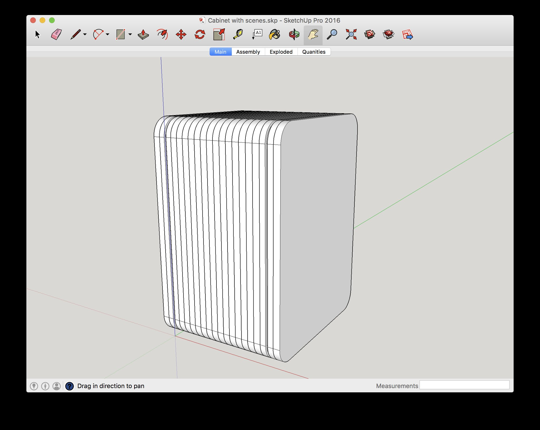

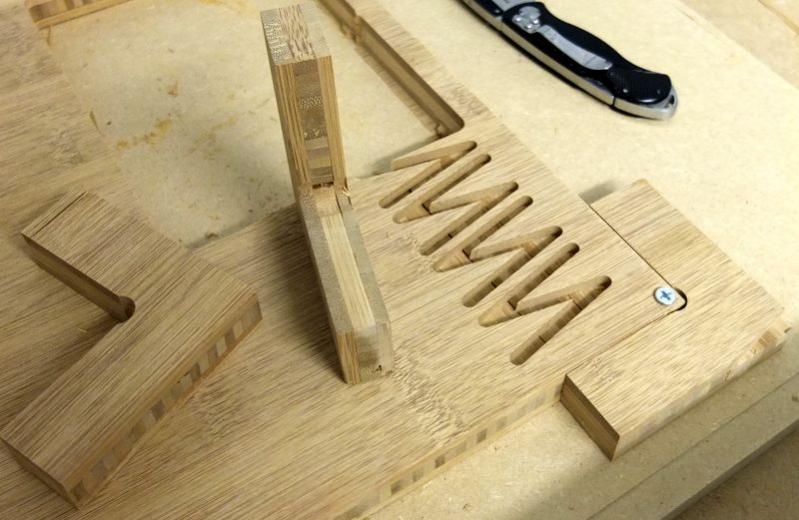

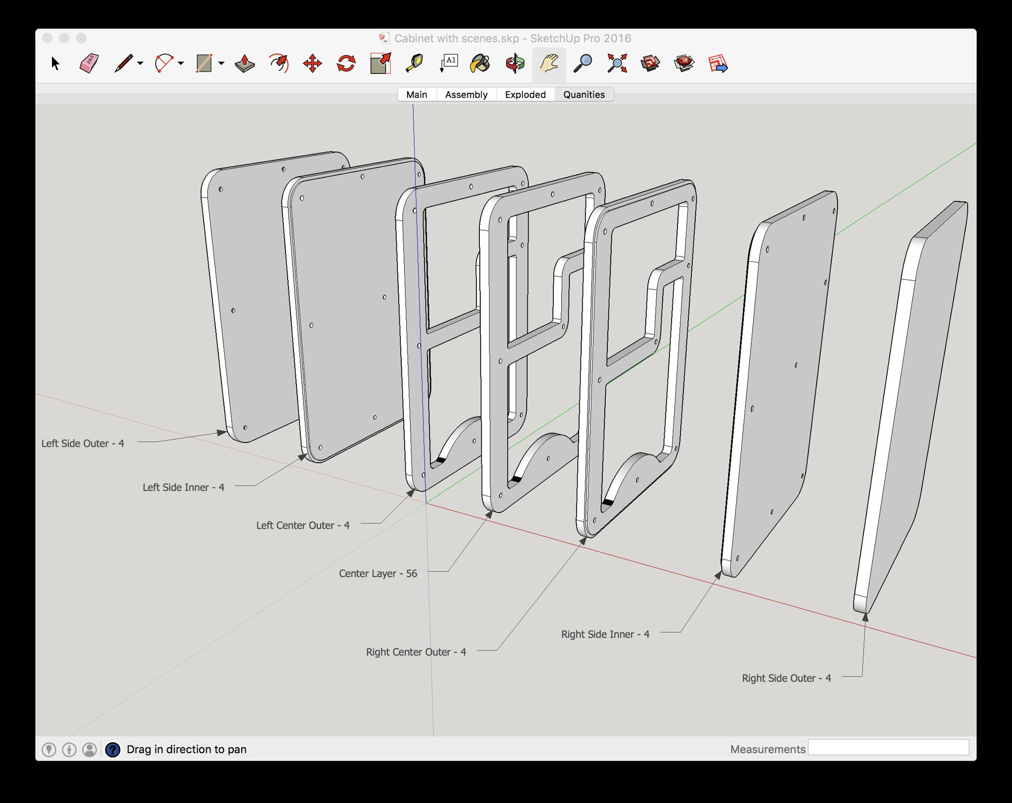

                  Translam version
                  Now, a view to some of the work Steve has been doing, planning out the translate version of the cabinet and stands. This is an experiment, trying Flick-r as the image library source- otherwise I'm going to load up the HT Guide server!
                  The primary work Steve has been doing is to prepare part pieces in the form from which they can be cut out using a vendor's CNC setup. These pieces will be further worked on to produce the final design.
                  So, in this case, while the pieces for the main cabinet, if arrayed as they will be built, show the outline of the basic pieces that will be cut out.
                  Click image for larger version  Name:	23676318354_10c56cc5ef_k.jpg Views:	179 Size:	272.3 KB ID:	943475
                  With the holes cut, all the bevels and other work done, including finishing, the final result is intended to be something like this:
                  Click image for larger version  Name:	24008984950_0d435eb8fc_h.jpg Views:	177 Size:	215.0 KB ID:	943476
                  Getting to that point will be a lot of work- note the different pieces required for each section, and how many- that's why there's 1300 lb of LBL sitting in the vendor's warehouse that Steve picked.
                  Click image for larger version  Name:	23936699359_b54cc34d6b_k.jpg Views:	180 Size:	321.5 KB ID:	943477

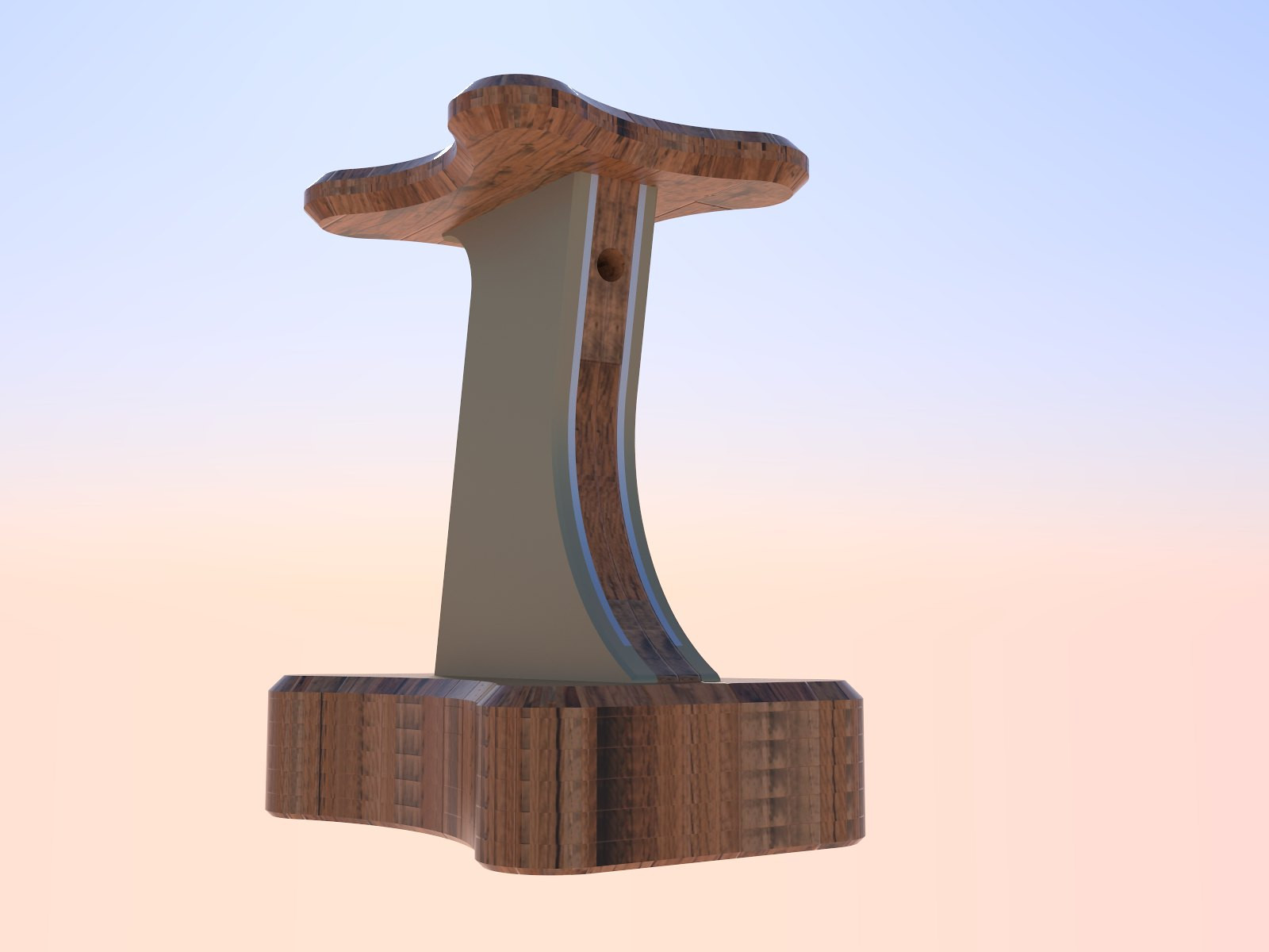

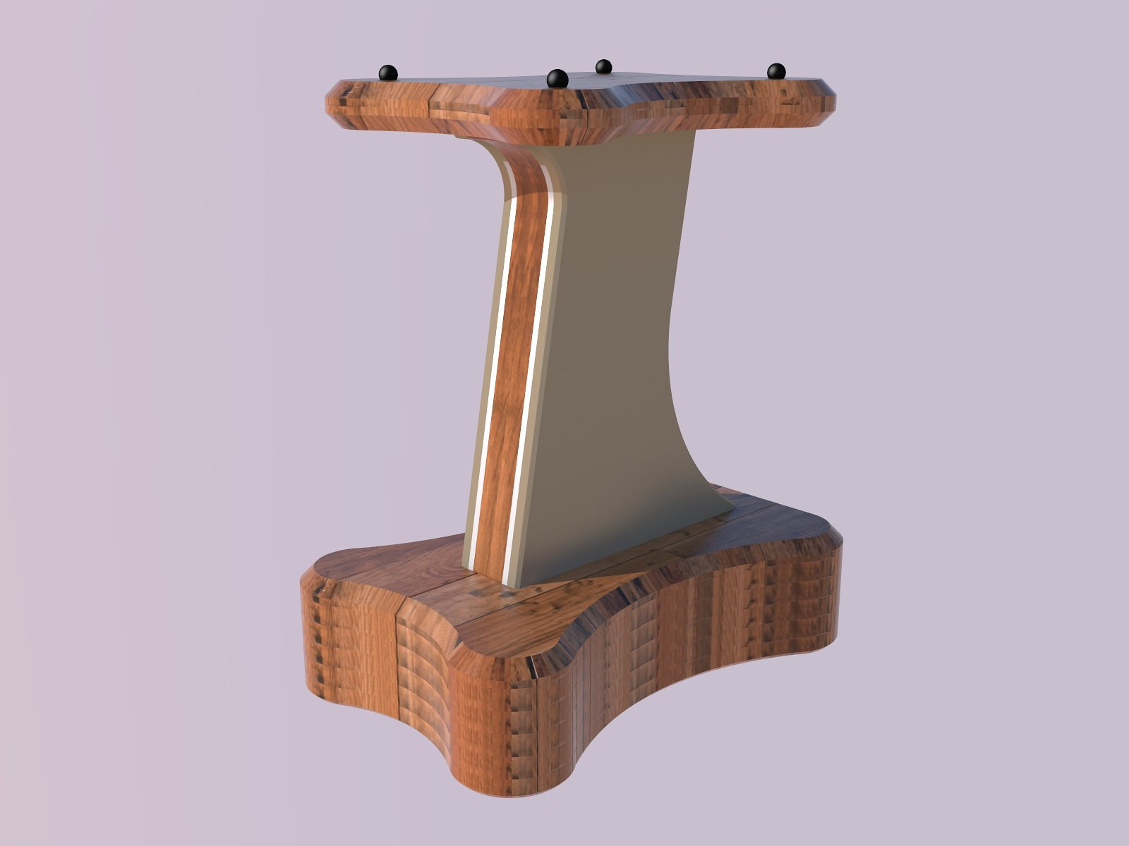

                  It's a very similar if somewhat less arduous process for the stands:
                  Click image for larger version  Name:	24008948080_d65db7a524_k.jpg Views:	176 Size:	335.7 KB ID:	943478
                  Click image for larger version  Name:	24222019481_702df1ab2d_k.jpg Views:	178 Size:	322.7 KB ID:	943479
                  Click image for larger version  Name:	24304558985_629eec8003_h.jpg Views:	182 Size:	136.4 KB ID:	943480
                  Click image for larger version  Name:	24278409306_f0a01dc549_h.jpg Views:	182 Size:	134.1 KB ID:	943481
                  We even did a 3D evaluation of whether the crossover could actually fit in the base- Steve made the component part models, and I did my best to put the puzzle together....
                  Something to always keep in mind, as Willie the Shake would say, there's many a slip twixt the cup and the lip, so I expect we may have some "interesting" challenges and perhaps some unpleasant surprises ahead.
                  But I've got a feeling about this... and it's not that something wrong with the earth's gravitational pull!

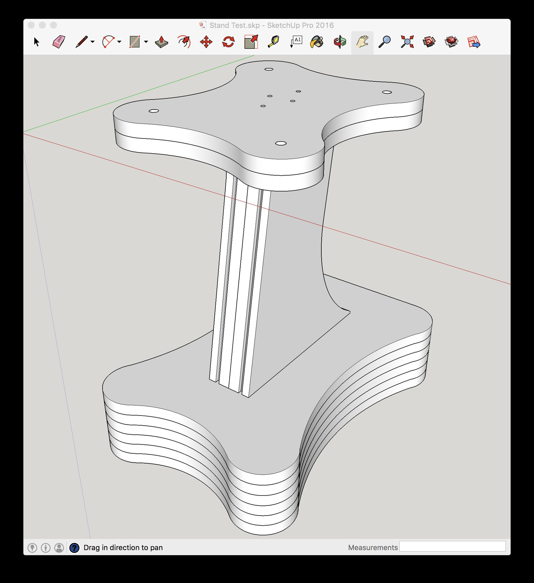

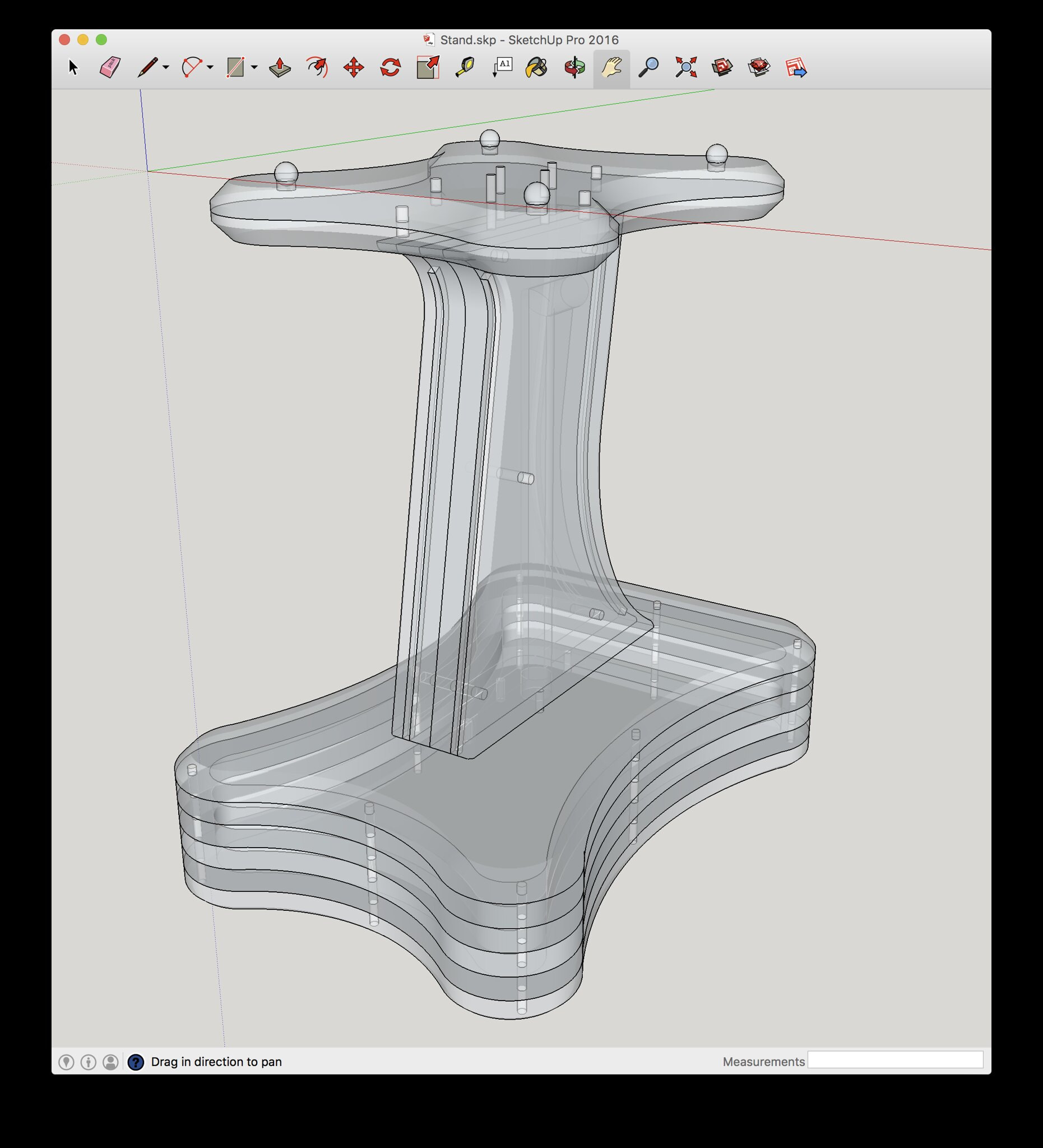

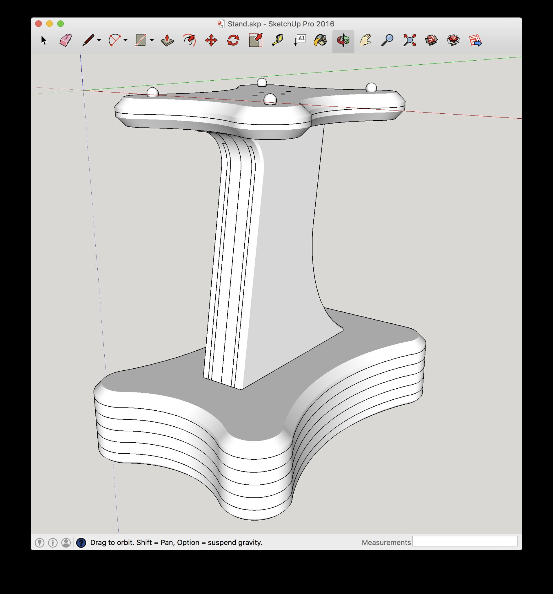

                      One last post this evening, at Steve's suggestion, to show an X-RAY view of the stand so you can appreciate the way this will be going together if all goes according to plan:
                      The X-RAY view in SketcUp does work rather nicely. Note how dowling is used in the stand (as well as the main cabinet) to locate the components precisely for gluing operations.
                      BTW, this moderate size PNG file is fairly high resolution- the larger you can stretch you window, the more fine detail you'll see. Download for the best effect, unless you're already running a 4K or 5K monitor.
                      • CADman_ks
                        • Jan 2012
                        • 497
                        I don't know about be a wizard with Sketchup, especially looking at this guy today, https://www.youtube.com/watch?v=uTtB...8aATrh&index=1. ....
                        WOW!!!
                        That dude is off the chain!!
                        That's incredible what he's doing with the software!
                        Having spent my whole professional career in the CAD field, it's easy for me to appreciate what he's doing there. He's actually leveraging the model to do all of his work, and if you're good, that's the end game. While that sounds simple, and makes logical sense, it's not necessarily the easiest thing to do. It takes a LOT of planning and forethought to get everything to work together. He's obviously developed a powerful system that works well. The trick would be teaching that system to others. I've been there done that, and most of the time it's hard to get your system out of your head, and into someone else's...
                        CADman_ks
                        - Stentorian build...
                        - Ochocinco build...
                        - BT speaker / sub build...
                          Steve, will be fun assembling these and hopefully your around for the machining process? As the xovers are in the bottom of the stand and I see a hole on the back of the stand at the top and 4 holes on the top plate of the the stand, are you planning a quick disconnect to separate the speak for moving purpose as I would think these would be a bear to slide around together? Only asking as I park my monitors against a wall and move them out some times.

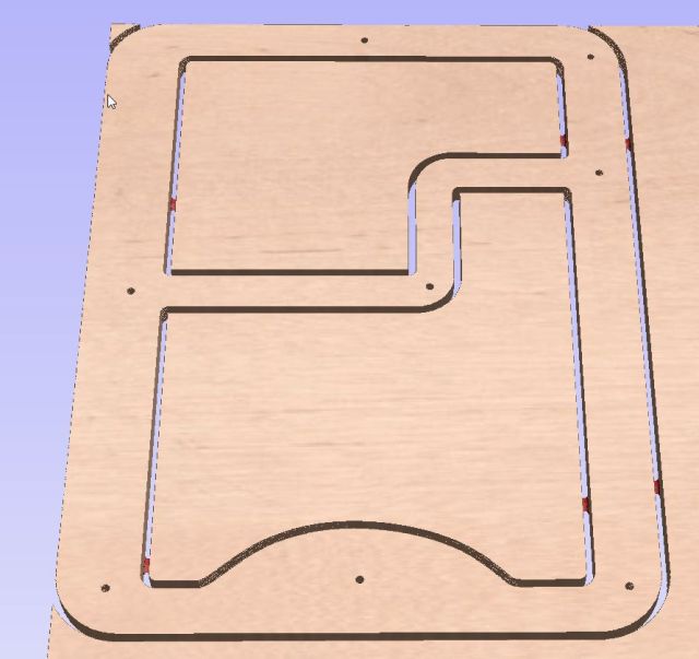

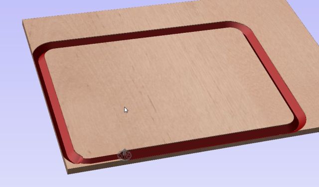

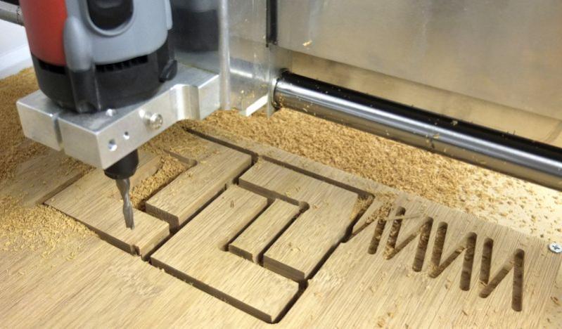

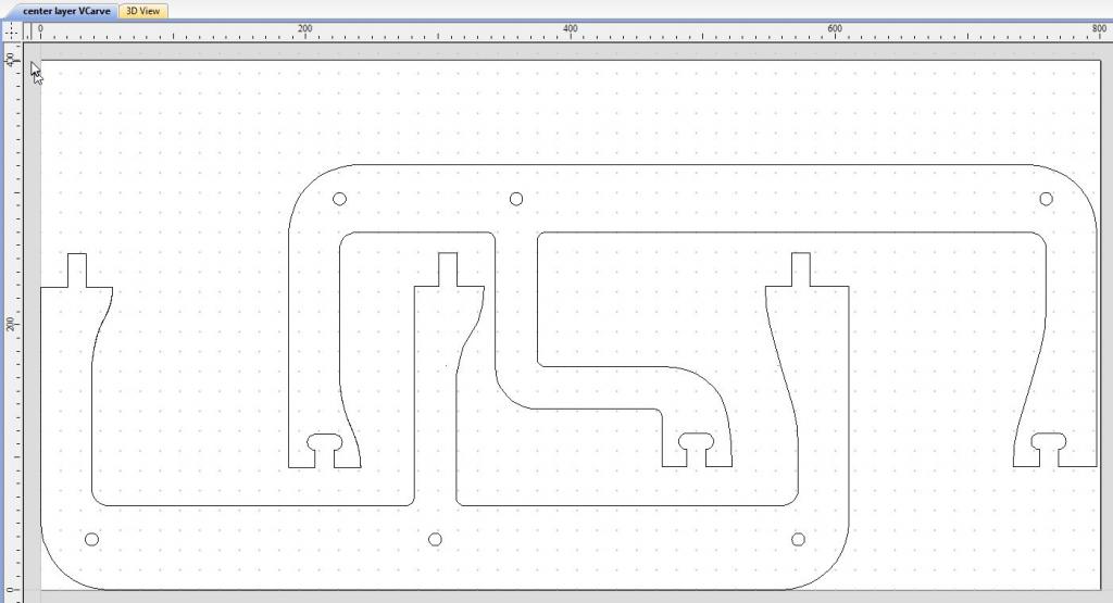

                                          I am planning to follow this design with CNC methods on EU side as well.
                                          I have VCarve Pro as a CAM for my CNC and even though it should import *.skp as well it does not seem to go too fluently from this project. I don't have the SketchUp Pro with DXF export, but going Sketchup skp file -> Rhino3D -> DXF -> Vcarve works well.
                                          Due to the machine bed size I will have to cut 1 piece at a time. But I will be attempting to also produce the 45 deg chamfer for the two sides.
                                          Toolpath trials look like this.
Name:	inner piece.jpg
Name:	outer piece chamfer.jpg
                                            • 16104
                                            That's one thing about being "vertically integrated" that's going to give you a bit of an advantage! Looking nice, Ergo! :T

                                                              I'm a bit curious on how it sound/performs compared to SW223BD01. Is it a upgrade or mostly the same/same?
                                                                • 16104
                                                                The SW223BD02 is what's in this project. But making a comparison between the Minerva acoustic demonstrator and built/finished Ardents with the SW223BD01 is sort of an Apples and Oranges thing, especially as I've only got one acoustic demonstrator setup, and the LF is just in an MDF test enclosure.
                                                                The SW223BD02 seems to have about the same small signal distortion, but it has a somewhat longer throw (by about 2mm) due to redesigned VC and changes in the driver suspension. This results in about 2 dB less sensitivity, too. All of these changes seem focused on making it more of a sub driver, yet because it uses the same very stiff cone and plenty of copper in the gap and has a nice flat impedance curve, doing the Wavecor Ardents with it shouldn't be a problem, just requires reducing the mid and tweeter level by about 2 dB. I need to do a crossover check and update on that, but I don't know of a set in progress right now using the BD02, so this hasn't been a scalding hot priority.
                                                                  My Ardents will use the -02s, but no rush, it's too cold here to get the veneer applied. There's a good chance mine will at least start as active at the low crossover, so I'll be starting with the relative level of mid and tweet for my padding.

                                                                    I did some progress today. As I had not cut anything from bamboo ply before on CNC I did some feed and speed tests to see what works for this material.
                                                                    ZigZags were all cut with each one getting a bit more feed rate to find whats optimum.
                                                                    18000RPM and approx 95 inch per minute with 6mm 2 flute upcut cutter was what I settled on for now.
                                                                    I did cut out 4 corner holders that will be the holding raw panels when I start to cut all the 40 layers of box

                                                                      • 16104
                                                                      Well, you're making some progress! how much does the LBL panel cost you in Estonia? Just curious...

                                                                        It does not come cheap unfortunately.
                                                                        https://www.bauhaus.info/suche/produ...platten+bambus
                                                                        and in Estonia it's even a bit more
                                                                        600 x 800mm (23.6 x 31.5 inch) 21.8EUR per piece - so some 870 EUR per 2 boxes
                                                                        400 x 800mm (15.7 x 31.5 inch) 15.7EUR per piece - so some 650 EUR if I use these for inner layers and 600x800 only for sides
                                                                        So I'm contemplating an idea to do this kind of 'tweak' - would save me some 250EUR as from 600x800mm board I can still get only 1 cutout per piece.

                                                                              Are you sure you cannot make them a little bit closer, so that you get less than 300mm height? That would let you have 4 pieces on a 600 x 800 board. If you make the taps on the lower one just a tiny bit lower that might work.
                                                                              Or if you make the speaker 1 cm lower you could raise them up on a 600 x 800 shett and then easly get 4 on a 800 wide sheet. Maybe more for all I know...
                                                                                • 698
                                                                                Thanks TEK.
                                                                                Those are the options I'm thinking of yes. I also thought about making the middle separation wall as a separate piece and have some sort of interlock type dadoes on it. Might help keep things better together at glue-up phase and give more freedom to get parts placed for better material use. Have to continue learning the CAD and drawing the options up as I go along.

                                                                                        A few things I have learned, programming and tool path can be time consuming. Test your path on junk first, it my look nice on the screen but does it work as planned? Once that is down actual machine run time is not long and taking extra care with this expensive material should be the top priority. If it's a single sheet and flat the vacuum should work well. If your doing small pieces don't rely on vacuum. If your not cutting right through the material vacuum is nice, example driver recesses. If you are it's okay to take a couple passes and the onion skin thing on Bamboo works well, we did this with the Ardent baffles, Ben had this thin like paper. If your cutting glued up sheets and the sheet is not completely flat just put a sacrificial sheet under and level it with the machine using a big bit, then screw the material that's being cut down. Takes longer but then there will be no issues. It can be nerve racking handing this over to someone who is just learning their machine so if he not going to replace what he screws up I would watch the process and yes Steve be tough and go straight to screw down before you muck any Bamboo. Start cutting slow then increase speed it's time but it goes pretty fast. We cut full sheets in 12 to 15mins. With 2 sets of hands with 2 drills at work changing sheets that were screwed down goes fast too. You get a couple sheets cut right then you will be flying.
                                                                                          • 2129
                                                                                          Thanks Darrell .... all very good advise. This has already become a bit nerve racking and we have not even started cutting wood yet. I would certainly feel better if it were just me doing all the work on a machine of my own, it would take 5 times longer but it would just be me to worry about. The biggest issue for the guy doing this is that the bigger machine start up, has has not gone smoothly as was the case with his smaller machine.
                                                                                          Fortunately we won't be cutting pieces that are small and no glued up pieces. Driver cutouts will be done by hand later on once the cabinets are glued up. Screw down will be an easy option with most of the parts as well since they have a bunch of alignment holes being cut for dowels later on.
                                                                                          We are also going to cut some test samples of each different piece with some other plywood to verify files and what not prior to using the bamboo.
                                                                                          You are certainly right about not blindly trusting the vacuum, the whole process is like trying to make a sail boat out of a kitchen colander. As I said earlier, if you got a few good vacuum tech's, (not engineers) together, they could come up with a system that worked considerably better.
