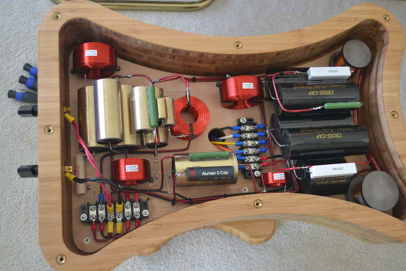

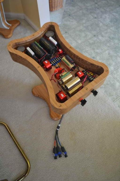

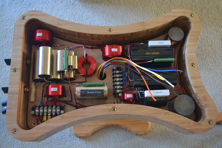

                      Since we are here in this thread, here's a few updated pictures of things.
                      Both crossover boards are complete and starting to go in the stands.

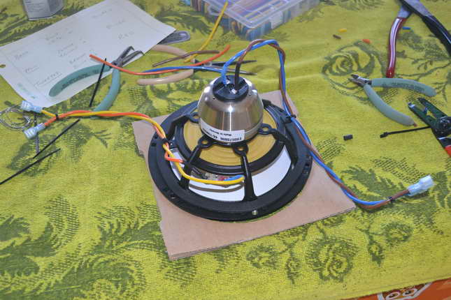

                      Cabinet wiring is also going on with the first cabinet. I did some additional work with the the fit up of the aluminum trim, since I was not completely happy with it. This required some additional painting and top coat rework as a result. The second cabinet is still in the middle of that rework.

                        After hanging around the 'Guide for a smidge over 10 years I've seen a lot of crossover pictures. Yours are outstanding. I've seen some that looked like a Radio Shack blew up. LOL

                          Thanks Lee, hopefully mine don't blow up when I turn on the power.
                            • 698
                            #823
                            These look very neat indeed. Nice job.

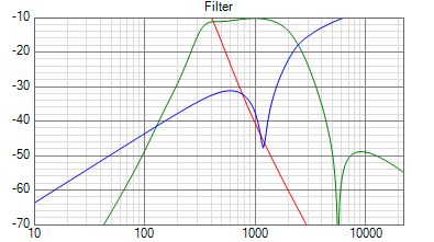

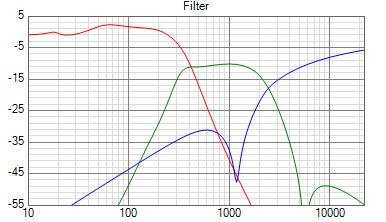

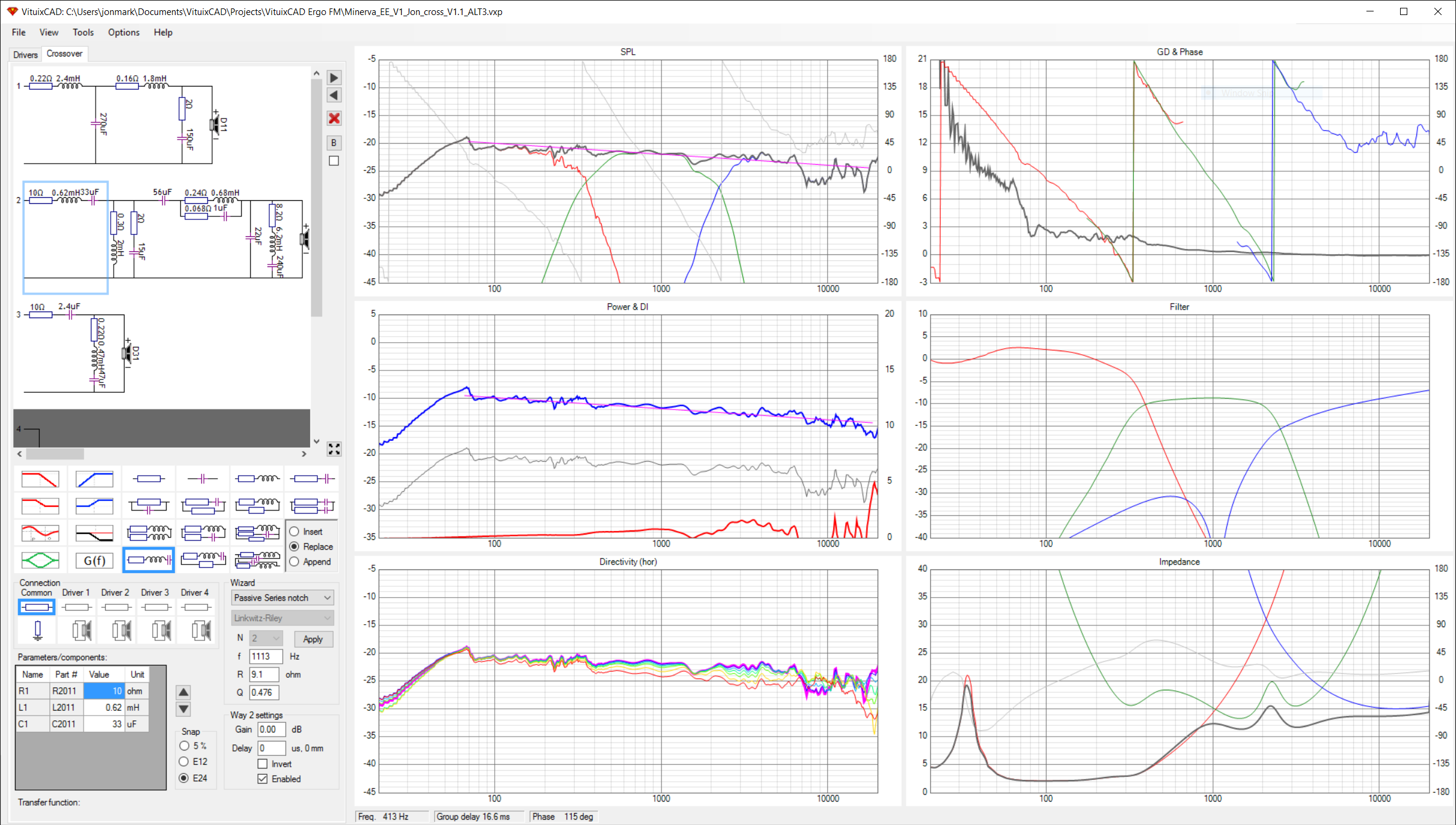

                            Crossovers and PCB design is interesting. People will usually prefer nice tidy parallel lines / components etc. but in this case technically it is often much better to put coils at different angles by purpose. Not run parallel wires and so on. So sometimes a ratnest type of 3D wire and component mesh works well while a nice and tidy PCB will oscillate as hell. Makes this hobby that much more interesting.
                            In theory one can replicate the passive xover also in DSP - I copied the 'transfer responses' of the Minerva filter below (VituixCAD limits the range so I sort of zoomed in on second one to capture the mid range notch).
                            If the DSP you are planning might allow this type of transfer curves then it is doable.
ID:	863240Click image for larger version

                              Ergo, the transfer function you posted is the whole circuit incl. the band limiting circuits (highpass, lowpass) if the drivers right? Can you help identifing the parts if the whole crossover which are not responsible for high or lowpass but for the EQ to glatten the overall response?

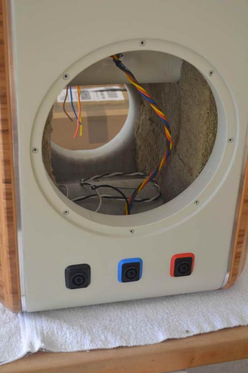

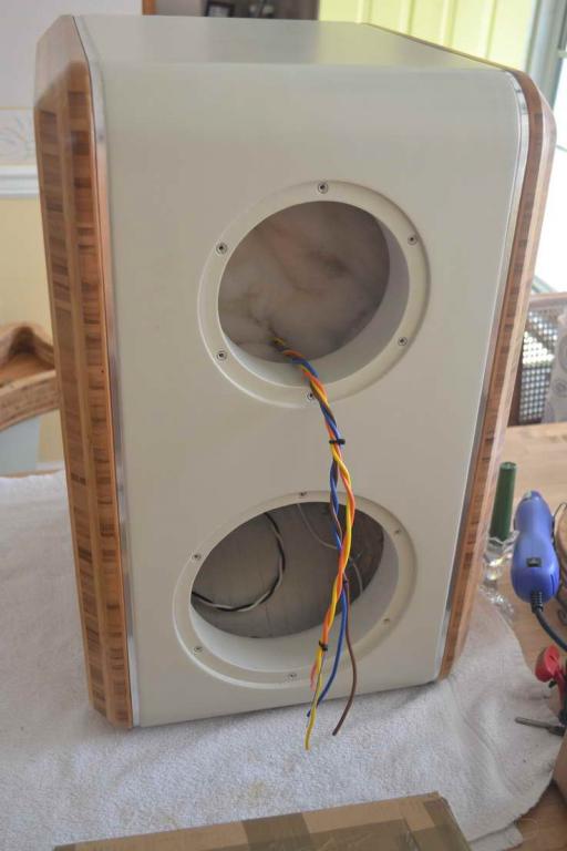

                                            #831
                                            The end of the road .....

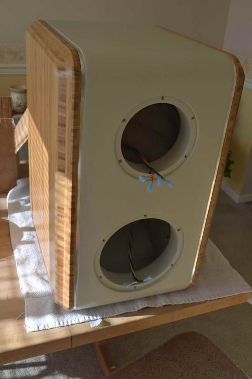

                                            Well I finally made it to the end of the road ...... both cabinets are finished and making music. Here are a few pictures of the finishing steps.
                                            Wiring pig tails for drivers.
                                            Cabinets wired and waiting for drivers.

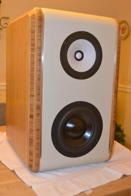

                                            Drivers installed.
                                            PR and connectors.
                                            First cabinet done waiting for move into listen room.

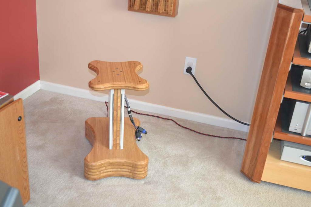

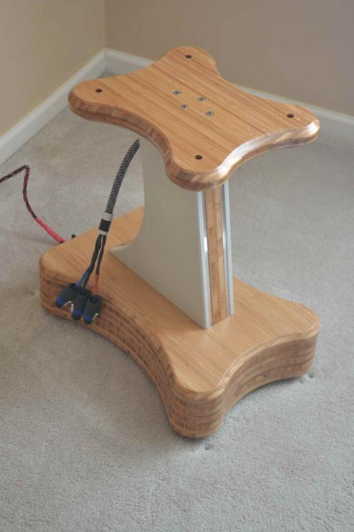

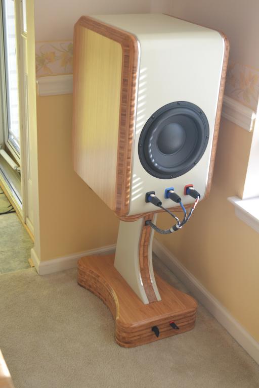

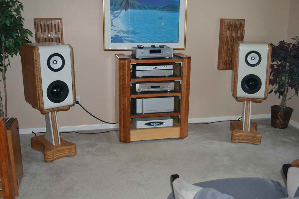

                                              Moving everything into place ......
                                              Getting stands set into position. Starting with the same location as my 1071's and go from there.
                                              Cabinets and stands together.

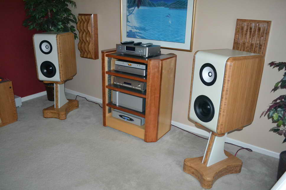

                                                      OK Carl, here's a bone for ya. :W
                                                      Now that I have them in a reasonable location in the room and had a little time to listen, it's safe to say in typical Jon fashion, another killer design. These have very tight deep base and a nice detailed presentation, everything blends very well together. Like Ergo said, it takes a little while to come to terms with what the differences are over what came before. One thing to note, these things like power, little flea watt amps will not cut it. I can imagine a pair Hypex mono blocks making these things sing.
                                                      Joaquim as for the the perceived recess, I think it's the low res picture, at least to the finger the drivers are pretty flush. Not something I worried about enough to pull out a set of calipers on anyway. By the way the business thing is under investigation, thanks for thinking they are worth selling.
                                                      All in all, it's certainly a design that is well worth building as it can certainly be done without doing all of the translam work that we did for this version which would reduce time and cost.

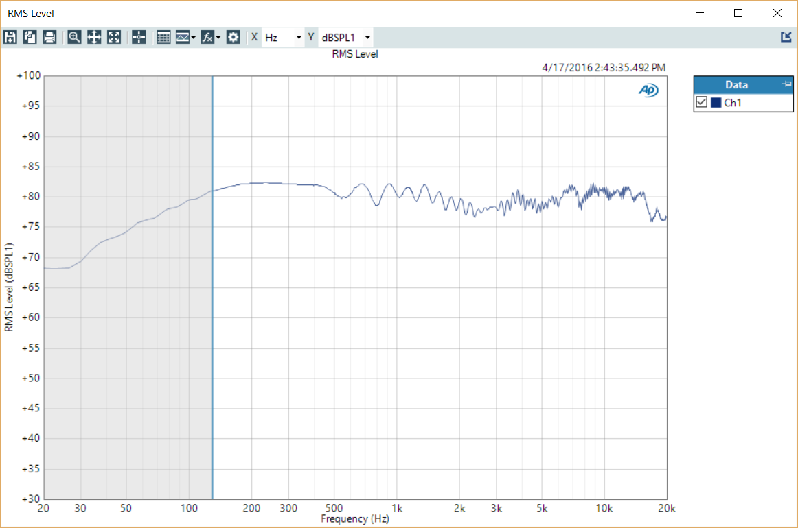

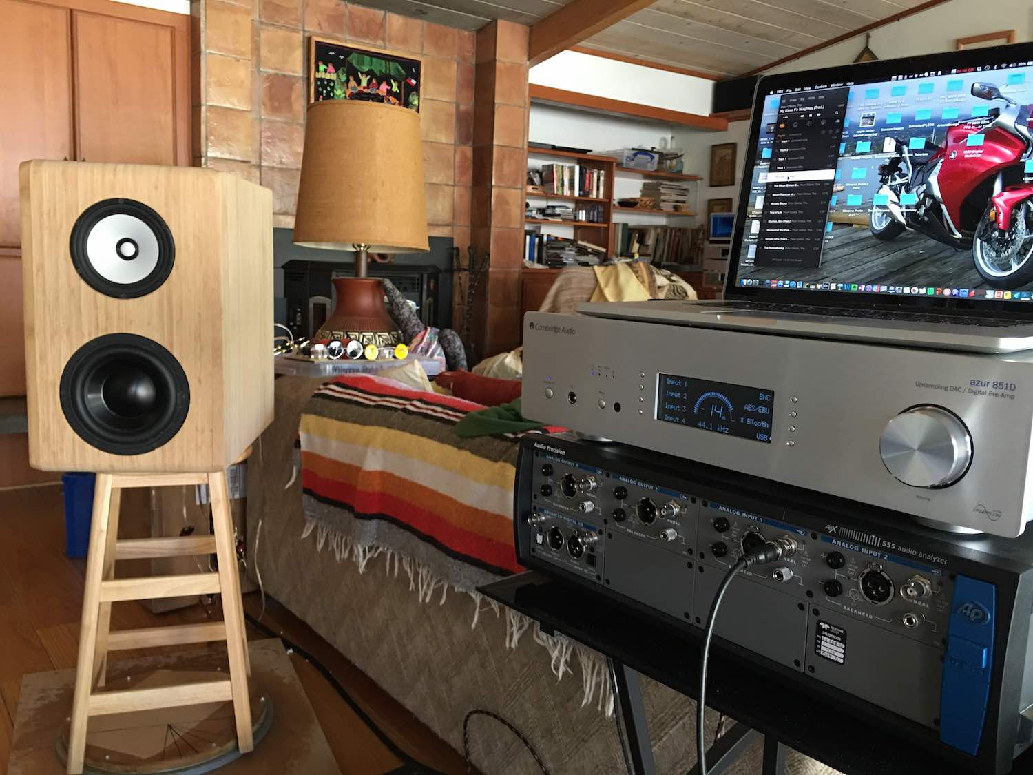

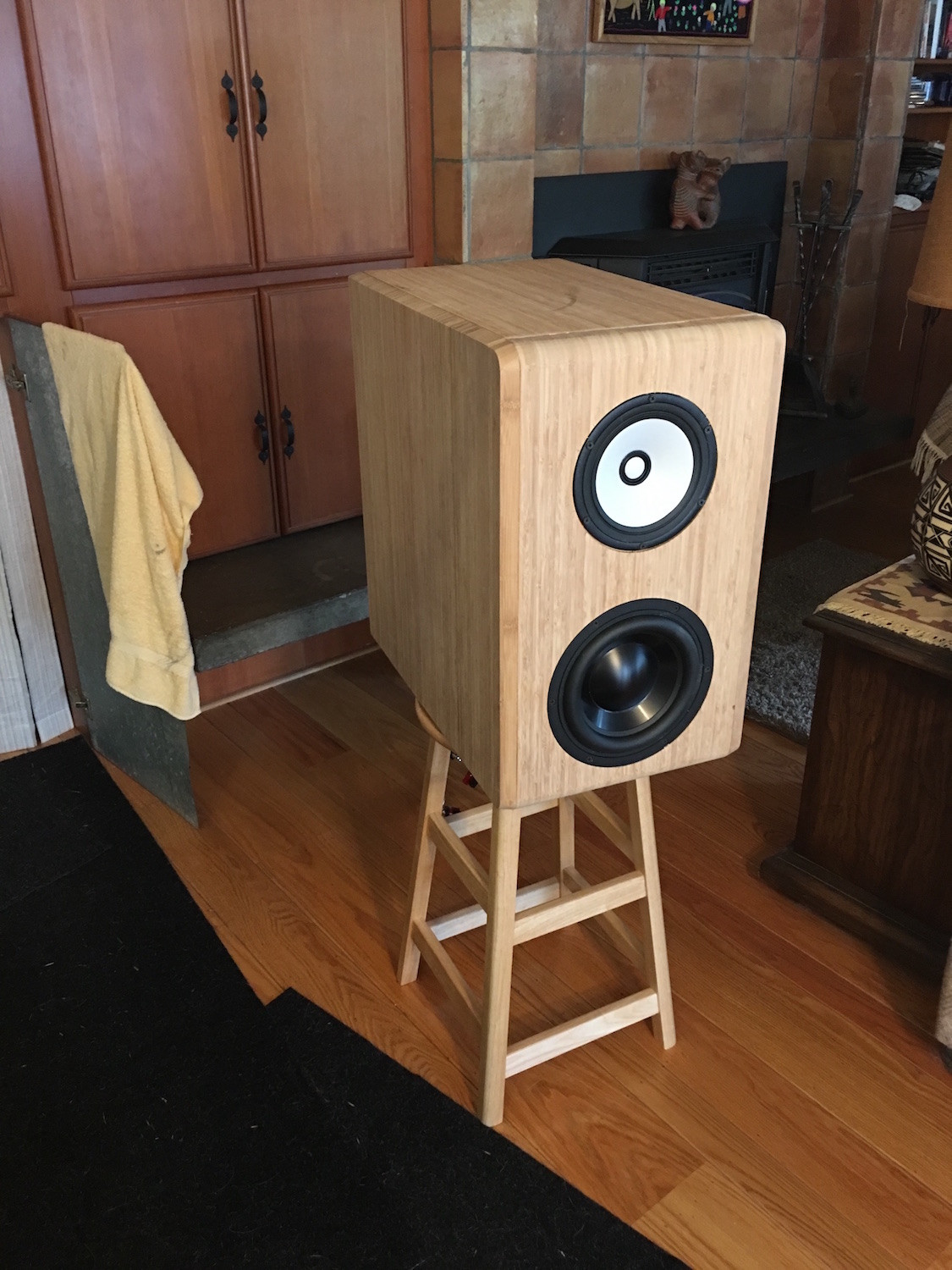

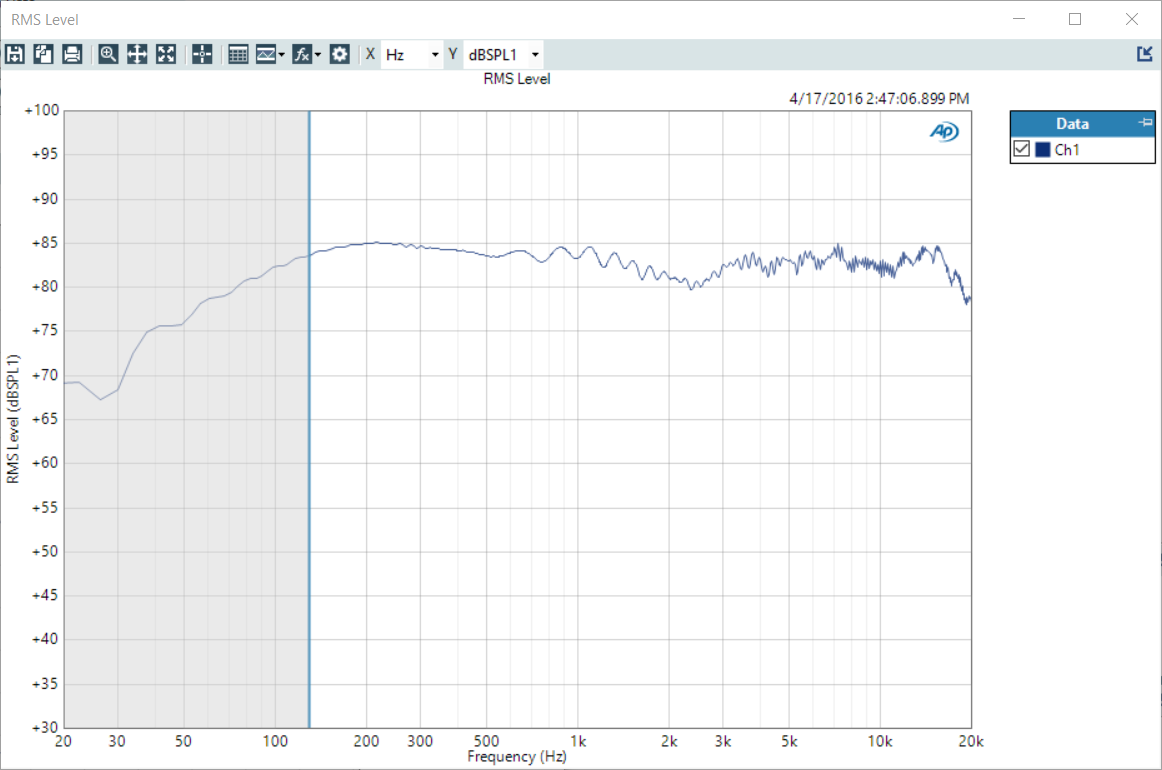

                                                                Hello Guys,
                                                                Steve has been updating me regularly with his progress and a few questions now and then; it's really great to see his pictures of the final assembly and installed in his listening room.
                                                                I've got all the pieces on hand to finish my pair, but I swear, the last year+ feels more like the phrase "Life Interrupted", which has been used by both a book and a TV comedy movie, both with very different topics, but the basic concept is pretty clear to anyone...
                                                                Mine are going to be the "monitors" for my eventual music playing and recording area, probably part of a family room in the future. I'm having to play a long game here, as realization of this is now probably at least two years away. (I guess long game is a relative term- I'm still a bit of an instant gratification guy normally, but these days I have a lot of banked deferred gratification).
                                                                This has been a rewarding project, especially with the three way collaboration with Steve and Ergo. I've been trying to encourage a similar approach at work, and that is working very well for me and one of my colleagues based in Toronto, but unfortunately others have yet to pick up on that...
                                                                I've only heard the one table saw prototype, with an initial build test crossover, which is brighter and not quite as well integrated, but it did seem to do what I expected,
                                                                30 degree off axis
                                                                45 degree off axis
                                                                And the final version of the crossover with the last set of measurement data sims very well, I think, incorporating the voicing concepts we've discussed else where on the forum.
                                                                Interesting side note, yes, this crossover uses a partial elliptic filter, and this last week I interviewed Jason Caudra for a potential AE manager position at our company- he is one of the earliest experimenters I know of using that approach for speaker crossovers, and pre-dates the AES paper on the topic.
                                                                Jason is a nice guy, and unlike most of the candidates I've interviewed, even fairly knowledgeable about the real dope for LLC multi-resonant converters. (one of my acid tests in interviews...)
                                                                So, yeah, as one of my colleagues in Boston would say, in his texting vernacular, "ANTICIPASHUN!"
                                                                But this holiday is going to be spent working on a crash project for work, another collaboration with my colleague in Toronto for a short fuse commercial opportunity we just can't pass up, and then next Monday on the 27 I go in early in the AM for a replacement hip joint surgery on the right side. It's been bothering me since 2010 and has been bone on bone for a number of years. OTOH, the left one looks practically factory fresh on the films, so this should be a big quality of life/functionality improvement. I'll be off on medical leave of absence for three weeks, so I can catch up with some stuff here and in the audio world... possibly. We'll see... :W
