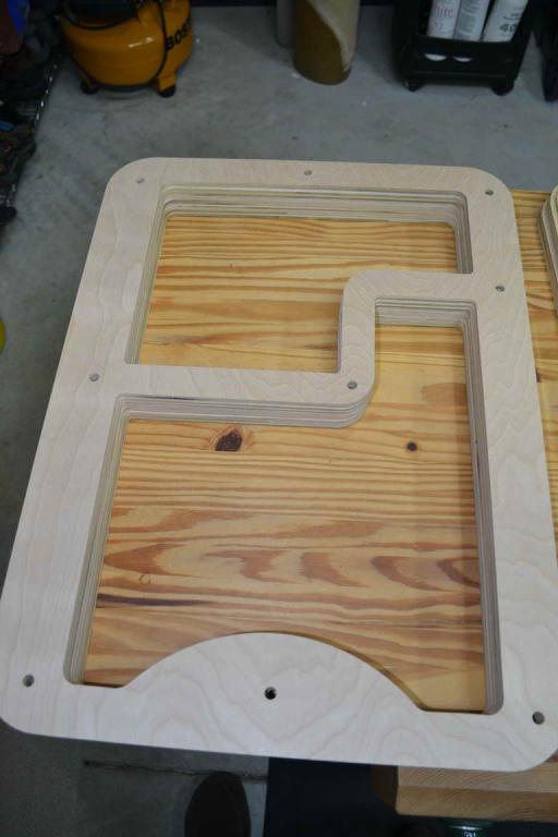

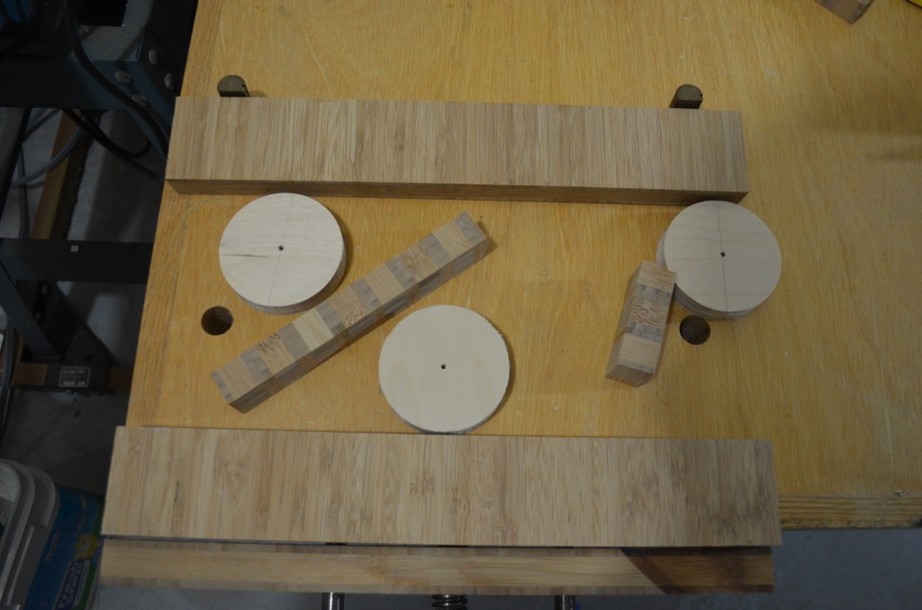

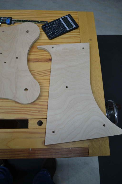

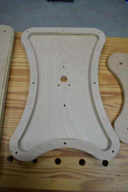

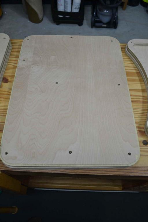

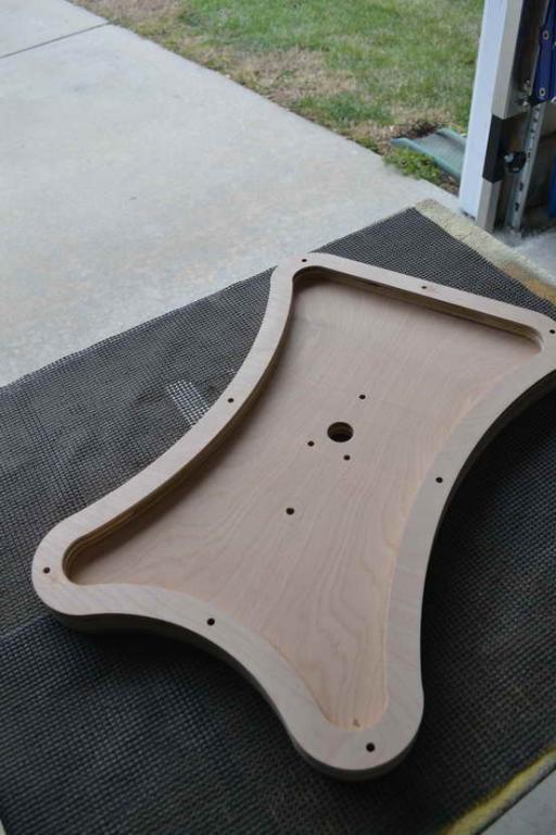

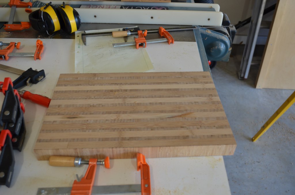

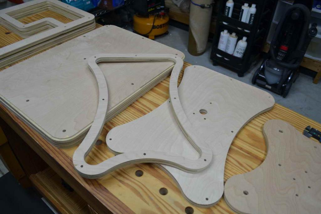

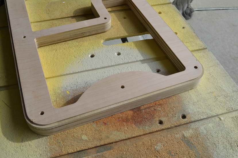

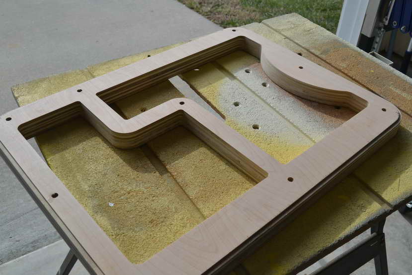

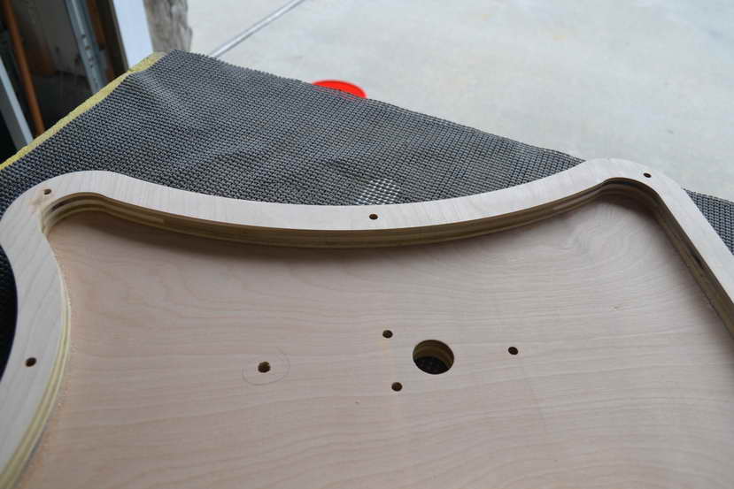

              Made some saw dust ....
              Got some test pieces cut today, of course pictures below. These used shop maple and not the good stuff. This was more an exercise to check parts holding and files. We discovered a few quirks going from Sketchup to Aspire for the tool paths. We already have a couple of options to resolve those issues, some more test cuts to follow. Also waiting for the "good" bits for the machine, (hoping by weeks end) these parts were machined with what was on hand and had a little chipping as a result. Overall a good test run.

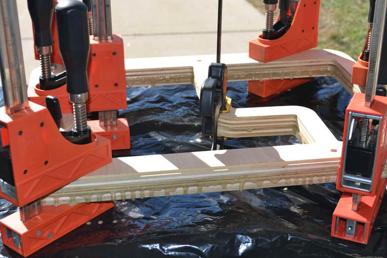

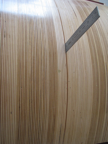

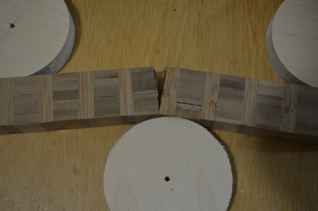

                  Hey, Graig had the idea of using maple bread boards for fronts on my Modula MK2's and CNC'ed the wave guided fronts but the breadboards failed along a glue joint. I ended up redoing the cabs but this time I bought 3/4" x 1 1/2" finished maple mill work and glued my own slabs with epoxy and they never failed after that. Don't want to poopoo the idea but make sure their of high quality.
                  Bread board version that cracked.

                  Look similar but this is the new version epoxied,
                  Steve lots of test pieces looking good.:T

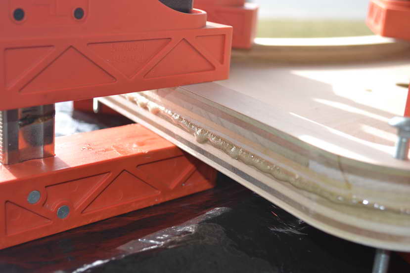

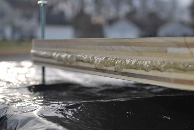

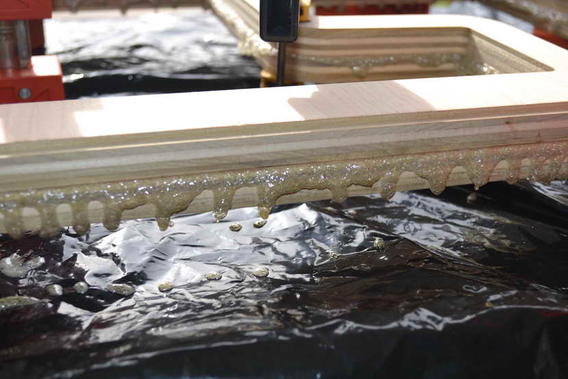

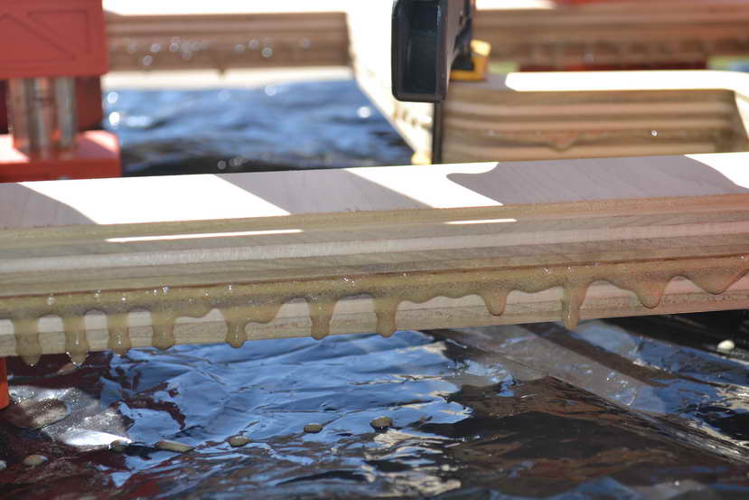

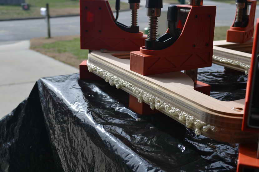

                    What kind of glue were you using on the original version? And did it crack on the glue joint, or the wood? (You mentioned glue joint, but I'm just double checking).
                    I've been researching glue a bit more- our current plan is Urethane glue (Steve's got Titebond, I have a new bottle of Gorilla Glue) and I know it's super on end grain, out performing yellow glue there, but just matches yellow glue in some other modes. Of course, I'm the long time epoxy guy, but with this much stuff to glue, two part epoxy would be both expensive and time consuming.
                    Thoughts?
                    It could be that we'll just have to spring for a few cans of West System with the 200 series hardener- been there, done that before. Feedback appreciated, even better if backed with hard data from anywhere.
                      • 2129
                      The stuff I picked up http://www.woodcraft.com/product/143...-glue-4oz.aspx was recommenced at Woodcraft for this type of application. They recommended urea formaldehyde as being a little better http://www.highlandwoodworking.com/u...ystgallon.aspx, but it's a royal pain to use, very messy and the recommendations were not to use under 70 degrees, which my garage certainly is not this time of year, even with the heaters going. Both can be used for bent wood lamination's which put's a lot of stress on the glue joints, so I figured it would be a good option.

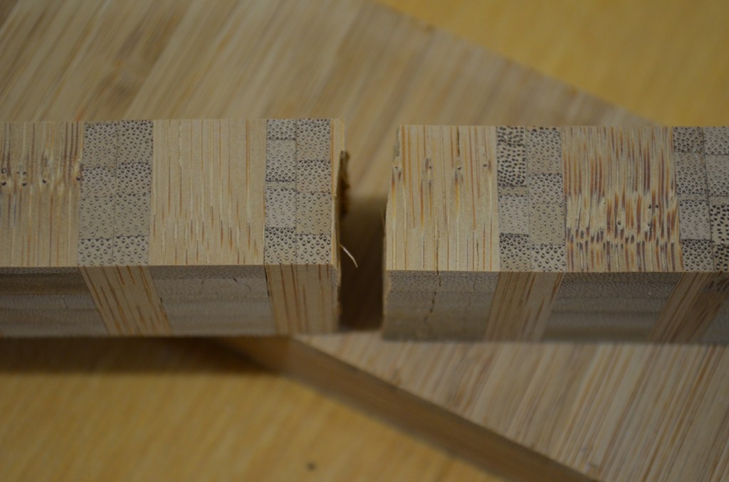

                          Nothing wrong with poopooing an idea if you've already tried it and it didn't work. You actually got me to run to storage and look at my 1 1/2 maple and here is what I found; :jawdrop:
                          Looks like the glue failed on the end grain. Thanks for the tip and your MK2's are one of my favorite stand mounted speakers.

                              I have had good luck with plastic urethane glue for the laminations on my ansonica build (DAP Weldwood - just mixes with water). I did have some issues with the wood plys splitting, but not any glue seams (goes back to the glue being stronger than wood), and not since I've finished it. It's used for bending laminations because it won't creep under load/stress. Most brands have a long open time and yes, they can be very temperature sensitive. I looked for indications of others using it in speaker building and could not find any examples. I stuck with it based on what l found recommended for other similar wood working (e.g. bent laminations). I did my crack repairs/filling with epoxy. I would consider using epoxy for the laminations but I always seem to make a mess with it! Clean up with the urethane glue I used was water. Also consider that different glues will will have different color glue lines. That poly urethane glue photo is pretty dark. Epoxy is clear and makes a good surface prep (e.g. grain/surface filling) for other finishes. All of these traits are going to matter at some point during finishing. Hello decision paralysis!

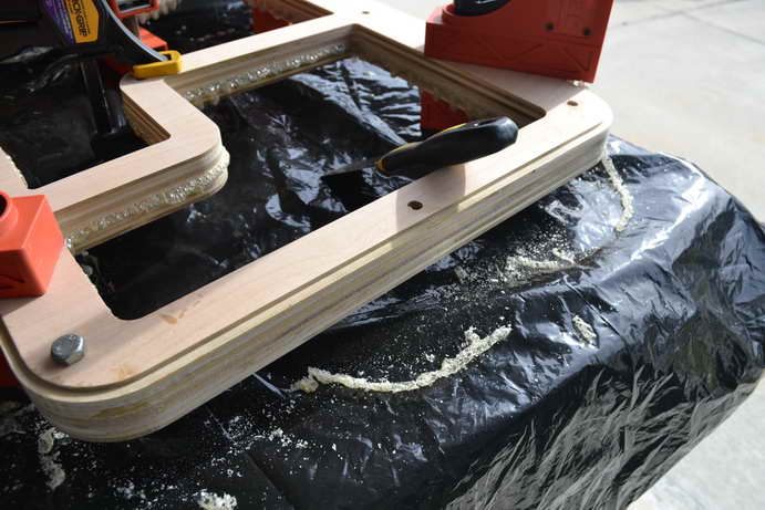

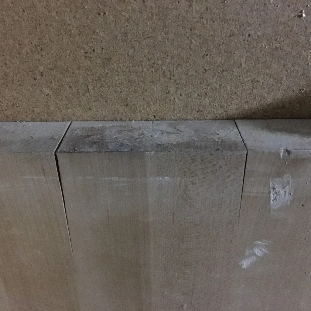

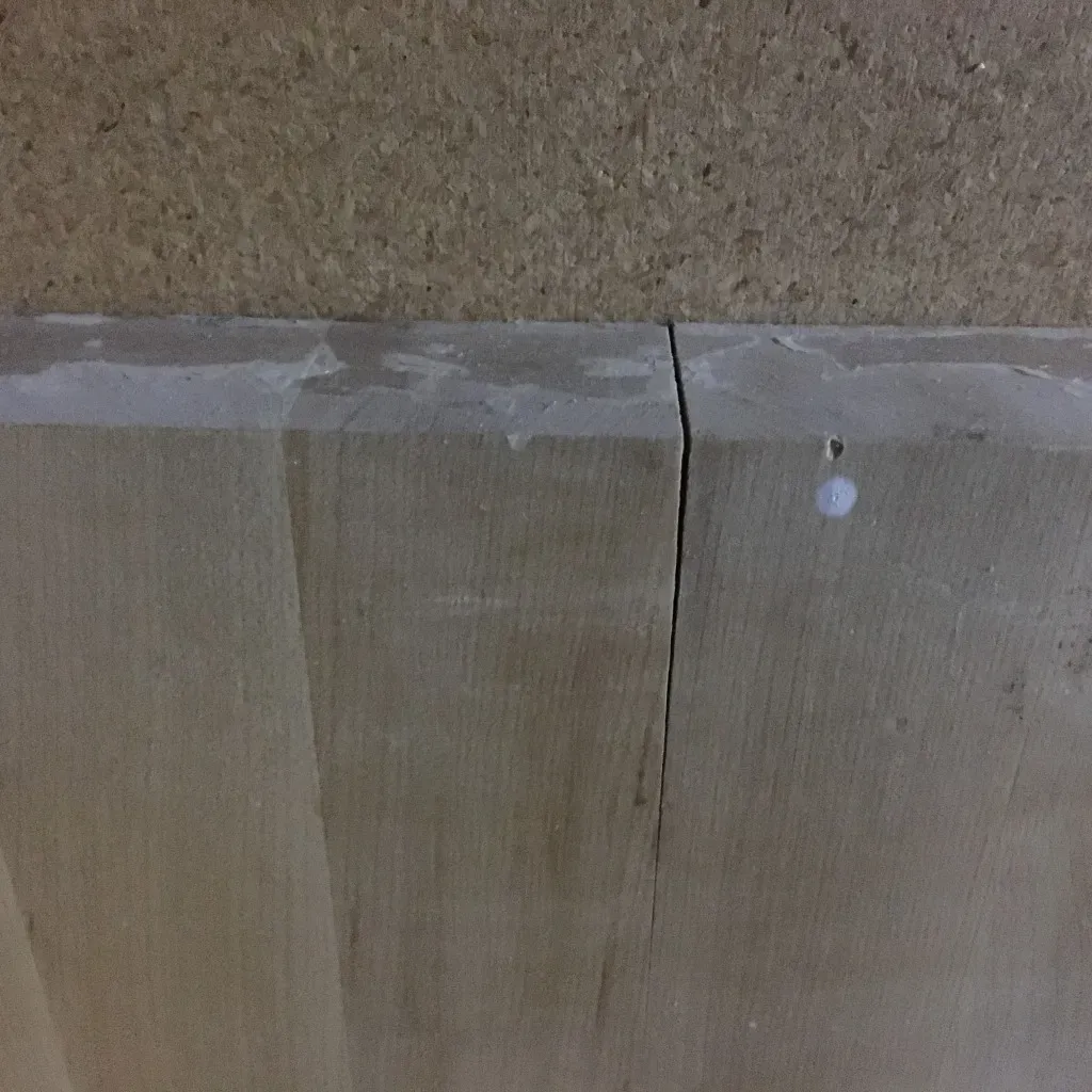

                                Hey Scott .... I typically use Titebond III for most everything, the only issue with a project like this, is it only has about a 10 minute open time, which when you stacking the layers with dowels having to go in place, that's not much time and rushing is never a good thing. When I built my Modula's I used Titebond Extended which has an open time of ~ 15 - 20 minutes as I recall ....... I ended up having this happen ......
                                I was not amused to say the least. I did use epoxy to fix this and it's been happy since.
                                This was using BB, and I've seen some others have similar issues with BB, both at the glue joints and between plys. That's one of the reasons for going with the LBL and looking at a different glue. The stuff I picked also has an open time of up to 45 minutes which also takes some of the pressure off as well.

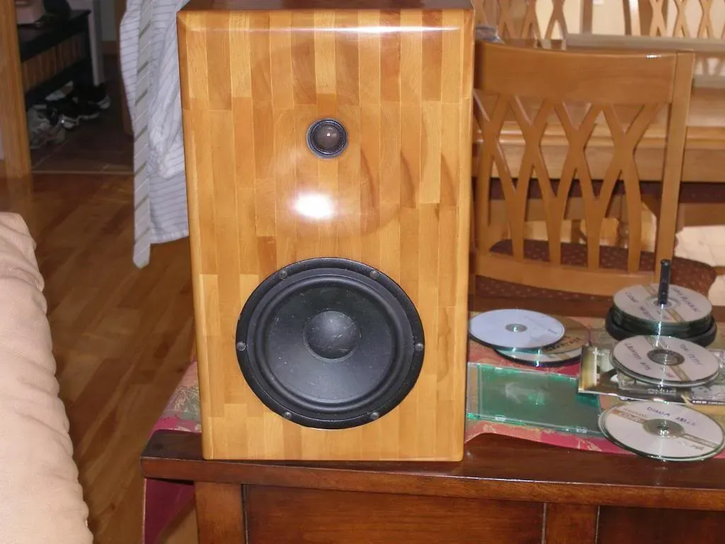

                                  • Norm
                                    • Mar 2011
                                    • 62
                                    CNC Notes

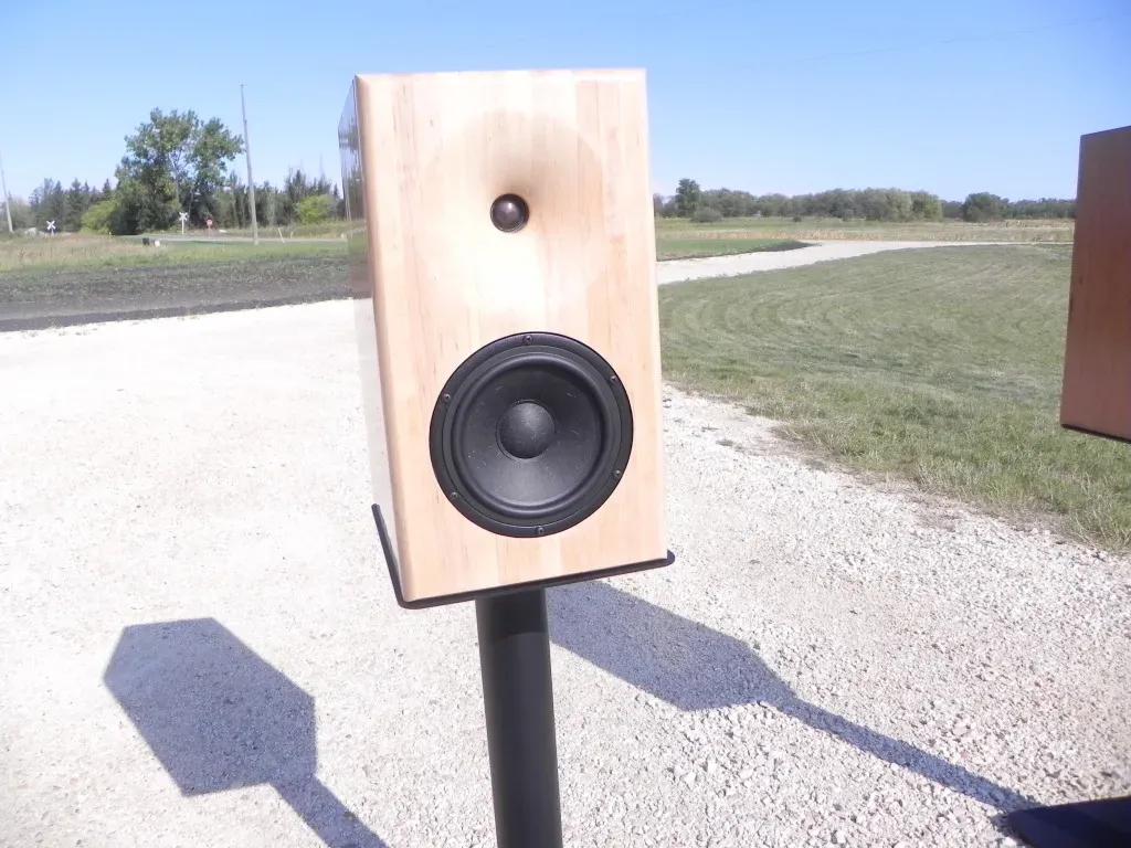

                                    Steve appears to have most of the following well in hand. Here is an overview of my experiences in case it will help.
                                    For a few years now on and off I have been using CNC to build speakers enclosures. Here is an example using Fostex F120A from my days enamored with full range drivers.

                                    1. This vertically layered relatively simple design is a good one for an initial use of CNC milling. Fewer larger parts will speed cutting. When I see designs adding complications like wave patterns inside the box or details like ergo’s above I think hours added on the mill. These mills are like Jon on his Yamaha, you can go faster in a straight line compared to twisting left and right. Also the plan to revert to manually cutting the driver holes & rebates nicely sidesteps the Z-axis calibration issue.
                                    2. We see Steve already following this next advice. Test cuts are your friend. I am guessing this is the first time this shop will be cutting bamboo plywood (or as I call it ā€œepoxy phenolic with some grass thrown inā€). The chip load tables and formula will get you started on spindle RPM and feed rates but they yield a range to test within. For example the from Asia to the big box store sort-of birch plywood I used for my last project yielded a cleaner cut with less inner layer tear out at faster feed rates, quite counter intuitive. Setting aside how anxious one is to produce the project parts and running controlled tests pays off in cut quality and allowing as fast a feed rate as possible. Once that feed rate and RPM setting is chosen given the investment in materials I would be sorely tempted to get a couple of sheets of less expensive material and practice cut examples of all components as Steve is. This to verify the design with prototype pieces, test hold down/tabbing scheme and to check the run times against the tool path software estimates. In my Shopbot + Vcarve system the estimated run times are always low, sometimes by 100%!
                                    3. Regarding the glue discussion I have used Titebond II for all my laminated cabinets and have never suffered a failure. I pour some into a dish and use a disposable foam brush to apply a thin coat across the entire mating area. With a little practice this yields minimal squeeze out compared to previous method of applying from original bottle and spreading. Of course bamboo plywood is so full of the phenolic like materiel binding it together I would be reaching out to both the material’s manufacturer and the adhesive companies tech support for advice based on the chemistries involved. Steve on your Modula's I that suffered the crack I am curious if those had a long dowel or something like all-thread rod running embedded in the length of the stack-up? I am wondering if that crack was due to adhesive failure or differential expansion of materials within the item.

                                      As I noted earlier, we discovered a couple of minor issues with our test cuts that has some rework underway with drawings. The machine cuts what you tell it to cut, if the programming is off so will the part. If we had to go with screws or clamps that would certainly have to be taken into account, bits running into screw heads would get expensive considering the price of the specialty bits that are coming to cut the bamboo. Better to spend the time up front with the coding than with sand paper later.
                                      There was no issues with parts moving during the cutting, though more test pieces are going to be run and if needed tabs will be added for holding parts in place if it's deemed necessary. The shop owner does not like screws and feels that between skinning and tabs there should be no problems. At this point I don't see a reason to argue his opinion, but will if things look iffy.
                                      I have also spoken with some other board members that have cnc'd bamboo and have discussed their lessons learned with the shop owner. Types of bits, feed speeds etc, We will take it slow and go from there.

                                      To answer your question on the Modula cracking, no bolts or dowels were used to hold the lamination's. Though I do expect that differential expansion of materials did come into play some with the baffle being glued in place. What it does say though, is that BB moves, as does any wood, though I was not expecting to see as much as it did. This is one of the main reasons for going with the lbl, it is far better in the stability department.

                                                  I was also thinking of performing some test pieces from the drop out when the parts are machined. Let it setup overnight and do a little destructive testing. :twisted:

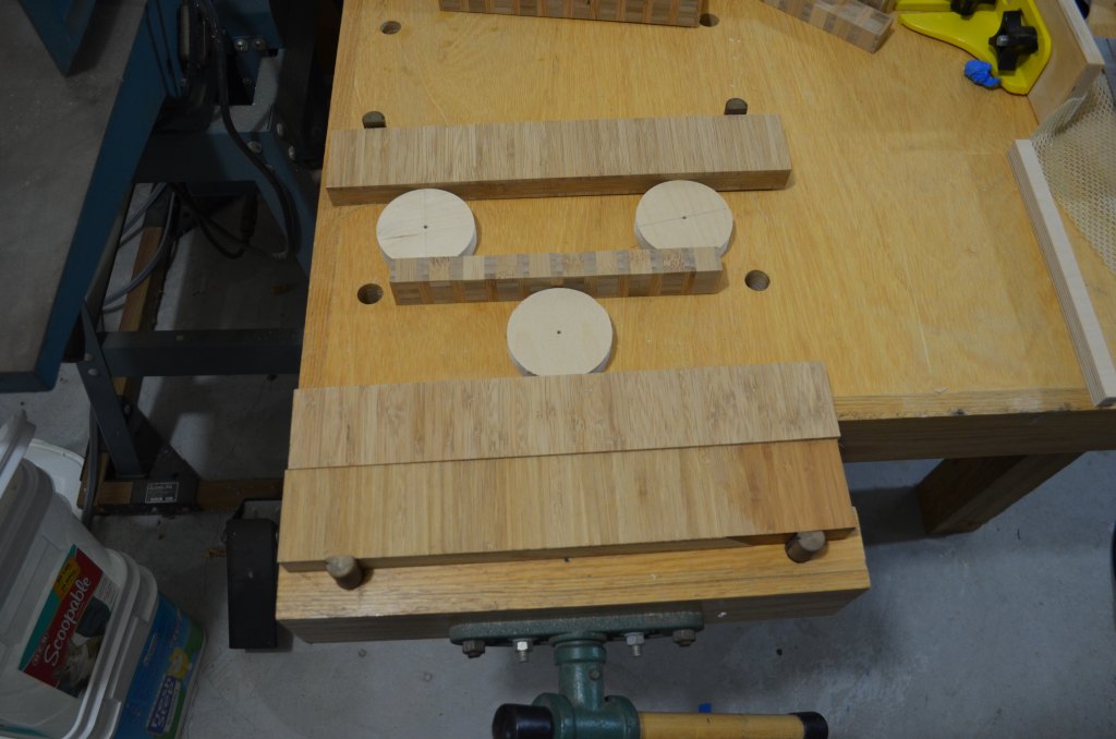

                                                    • 571
                                                    I recently glued a stack of 1 inch LBL for my top using Titebond III for the adhesive. I had excess scrap when I cut them to size, so I did a quick test this evening. I wanted to see if my glue line, the LBL glue line or the bamboo itself would give first. Take my results with a grain of salt...it took me like 10 minutes. I performed force tests in two orientations. In both cases the bamboo itself failed. I believe the bamboo is very strong bending parallel to the grain...not so much perpendicular to it. That is why the three cross layer bamboo ply is so strong. Stacking may not be so much.
                                                    My bamboo stack top
                                                    Test set up with work table clamp to apply bending force
                                                    First test piece break
                                                    First test piece detail
                                                    Second test piece rotated 90 deg to test different grain orientation
                                                      • 2129
                                                      Nice Scott .... How long did you let it sit between glue up and testing?
                                                        • 571
                                                        Steve, these were glued back in October. This is what I cut off the tops when I was cutting to size.
                                                          • 2129
                                                          I would say that's plenty of cure time

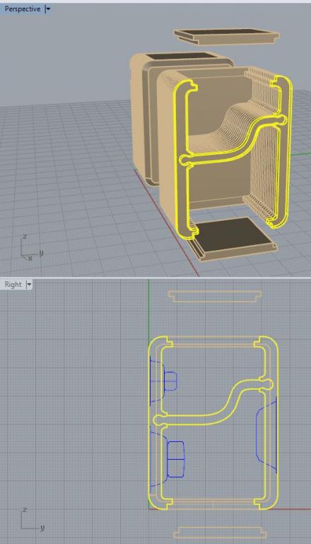

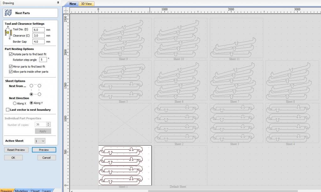

                                                            • 698
                                                            I'm using this project also as a chance to learn CAD software (Rhino 5 mainly).
                                                            Just toying with different ideas. One would be to only make the front, back and shelf as a glue sandwich and top and bottom as solid pieces (thickness of 2 boards).
                                                            This could potentially save quite nr. of boards... but not sure how easy it would be to assemble or will it be structurally as good.
                                                              • 2129
                                                              Interesting idea Ergo ..... I can certainly see where that would save on wood. Though I bet that would be rather interesting to try and glue up, especially keeping things aligned. Can't really say about structurally, though anywhere you have extra joints, there could be a potential failure point. Might be worth trying the idea with mdf or something else cheap to validate the concept.

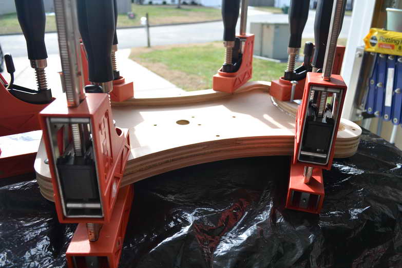

                                                                                      Glue Time
                                                                                      Well since this has become a hot side topic ....... Weather was nice today, mid 60's and sunny, so I opened up the garage door and played. I did two different tests with the Titebond Polyurethane Liquid Glue.
                                                                                      First test was going over kill on the glue. Over kill, in this case was nothing more than applying glue to both surfaces of the parts, instructions recommend just one surface.
                                                                                      These pictures show squeeze out right after clamping when glue is wet.
                                                                                        • 2129
                                                                                        Waited an hour for glue to set. Instructions recommend 45 minutes, which I suspect is at 70 degrees.
                                                                                        First two pictures are of final squeeze out.
                                                                                        5 seconds with a putty knife .... this stuff cleans up just as advertised.
                                                                                        A few additional minutes of scrapping and squeeze out is gone. This is certainly the easiest glue I've used to remove excess.
                                                                                          • 2129
                                                                                          Second test ..... I only applied glue to one surface and then clamped.
                                                                                          Again, initial squeeze out, less than the first test but still all the way around the parts.
                                                                                          After an hour of drying .....
                                                                                          After cleaning off the squeeze out ....
                                                                                          Of note, this was done with maple plywood, not bamboo. These were from the initial test pieces that were cut earlier. Glue applied with a foam roller.
                                                                                          Stress tests will follow in a day or so.
