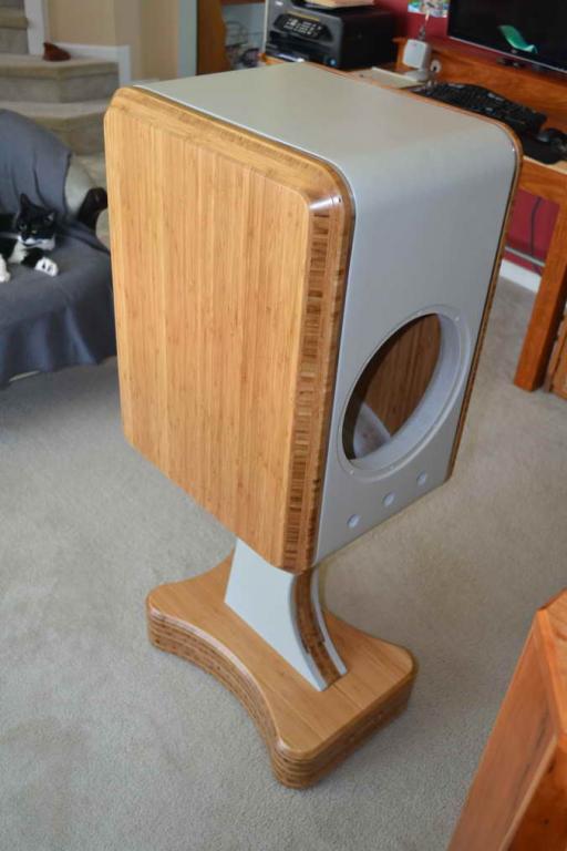

    #766
    Originally posted by Carl V
    looking great.... I see that interior bevel now.
    Another question what is the hump for on the
    bottom of the enclosure?
    Jon stated the "official" reason ....... but off the book, it was a quick and dirty way to adjust the volume of the lower driver area. I just moved that around while watching the volume in Sketchup until I got what I wanted. Easier than redoing the entire cabinet. It also gives you that non - parallel side thing everyone likes.

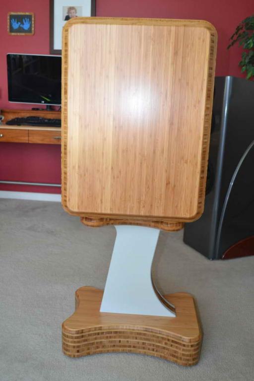

          • 2141
          #769

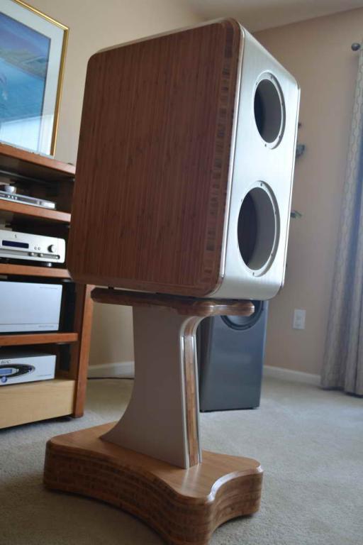

          First One Done
          Well the first cabinet is done ....... here are a few shots of it on the stand.
            • 698
            #770
            Very nice and I'm sure they'll get even nicer looking with the drive units in them. Great work - finish line in sight now

              #771
              Beautiful work Steve! Also love the grey speakers behind, I think I've read that thread but I'm reminded how masterful your craftmanship is!

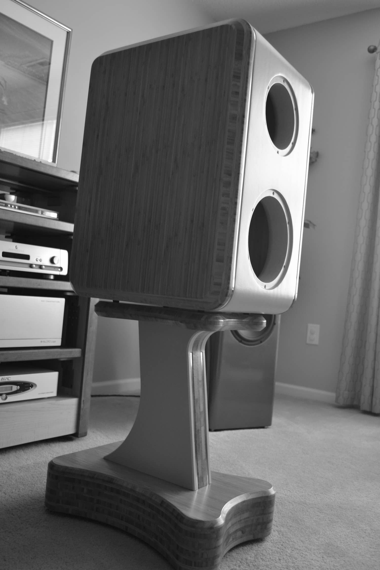

                  #773
                  I like the black and white version Steve sent me...
                  This is a shrunk down version for the forum...

                    Thanks guys ...... Carl here is the link to the grey's in the background.
                      #775
                      Holy Moly. That black and white image looks amazing!
                        • 571
                        #776
                        The black and white photo looks like it's straight out of Stereophile...:T
                          • 2141
                          #777
                          Thanks on the photo guys ....... even a hack photographer like me can get a decent shot once in a while.:B
                            • 16198
                            #778
                            Definitely! Uh, other than the missing drivers... But you know, you almost don't notice that!

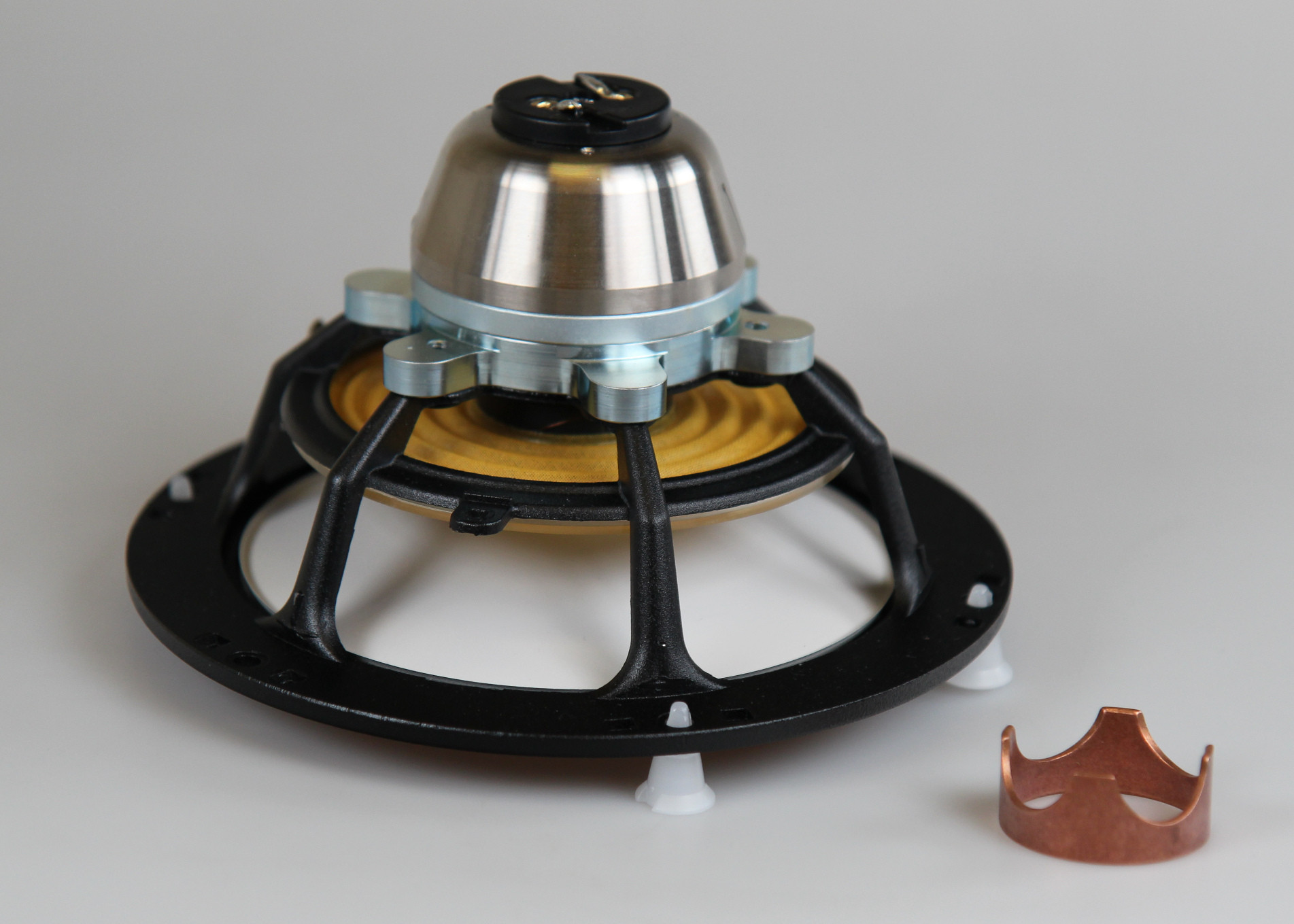

                                C18EN002 at Solen Audio
                                Yesterday I found something interesting on Solen... not yet on Madisound. The latter is dropping daily in my estimation as they are tardy to make products available compared with their Canadian competitor. Maybe they need a little of that "Make America Great Again" feeling.
                                Interesting- especially as the data on the data sheet looks to be essentially and actually identical to that on the C18EN001. Perhaps a quality or yield issue with the older version of the driver?
                                Anyway, it's a relief to see this...
                                It's also showing up at some European dealers here and there...
                                  • 571
                                  #781
                                  That is a relief Jon...It would be a shame to see this driver disappear with all the work you and Steve have put in. Not to mention it's a one of a kind driver for the diy community.
                                  Interesting...it's not even on the Seas site either yet.
                                  Review of the old and new datasheets may elude to the issues/differences. It you look at the first two sentences, the C18EN001 describes the cones as mainly magnesium where the C18EN002 describes them as aluminum/magnesium.

                                          Seas has officially introduced the new version of the C18EN coax.
                                          http://seas.no/index.php?option=com_content&view=article&id=527:n ew_kin_coax&catid=41:news&Itemid=194
                                            • 16198
                                            #786
                                            Thanks for the heads up, good to see the official word and data sheet. I'll have to spend some time soon comparing this to the original, and of course I'll have to order a pair- on the surface, it sounds more like a reliability update than a performance modification, but I'd better comb the data sheet carefully before making any kind of judgement. Of course, knowing how data sheets are often created, even if there are minor differences in acoustical performance, they may have just used the old data graphs.
                                            What I do see right away is the difference in the magnet mounting- the thick plate with multiple fingers bolted to the frame is "new", although the original frame had provision for this mounting... my engineer's suspicion is that the earliest version had this, then they eliminated it to reduce the back wave shadowing and cost, but possibly ran into mechanical stability issues over temperature range and went back to this mounting. I suspect there is no material difference in the measured response under normal conditions, unless they've also gone and tweaked the cone and surround.
                                            We shall see...
                                            I have a busy agenda for today already, or I'd be looking into this right away.

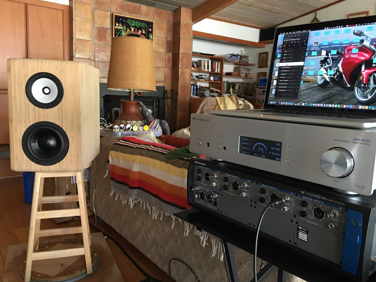

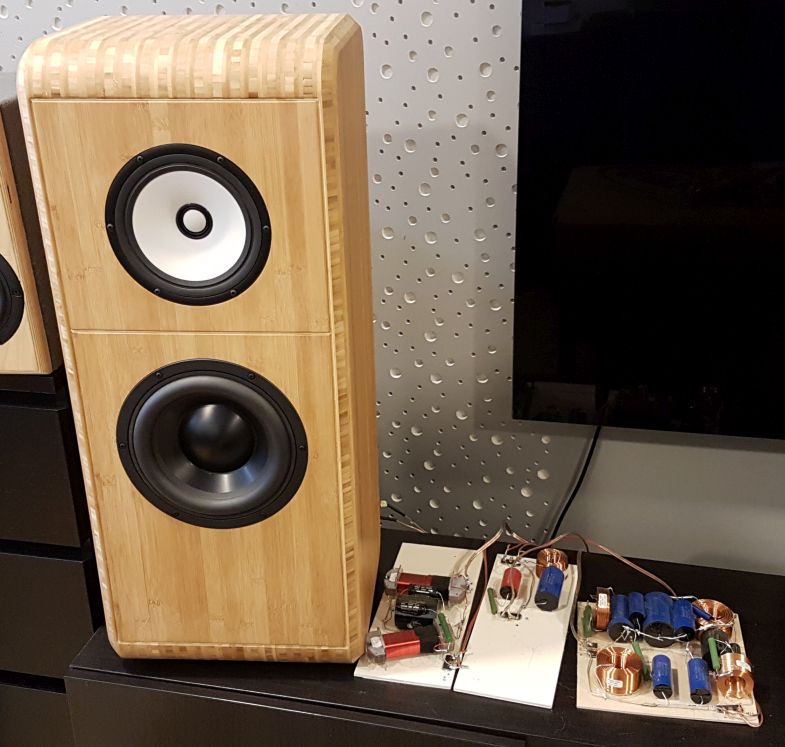

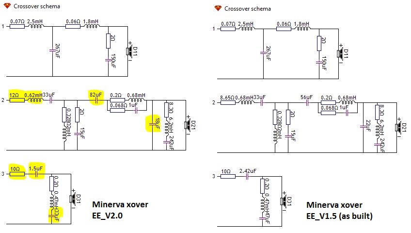

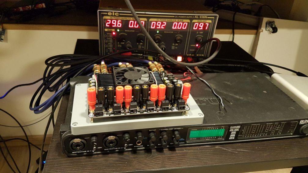

                                                  I've done some progress (and listening too). Meanwhile I got the PE packages via my workmates with the coils as well as a 6ch class-d amp. Latter is to enable 2x 3way xover simulations with LspCAD and multi channel soundcard. So I first set it up and listened to the V1.5 xover versus the new "system voicing curve" based V2.0 xover. This convinced me that I do like the effect it has on the system, so I went ahead a rebuilt the physical xover to match the V2.0 version.
                                                  As a side note - there is a huge difference between the class-D amps and for a true long listening I would not recommend this PE amp. But for quick trials and getting a feel of the balance of the sound etc. it does work. Later switching to the NAD C390DD amp was soo much better sounding.
                                                    • 698
                                                    #790
                                                    Jon, you had a link to a method of comparing the coils under different current. Would you have that at hand. I can't find that anymore... I could try to compare the Jantzen C-Coil to the ERSE ones.

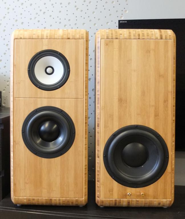

                                                            I've finally got my act together and finished the Minerva_EE-s. The Xovers are now inside the box and nice terminals replace the wire mess coming out of the box and a component piles next to them. My wife unit appreciated that step a lot
                                                            Now on to the next projects - ie Ardents from speakers front.
ID:	862756Click image for larger version
ID:	862757Click image for larger version

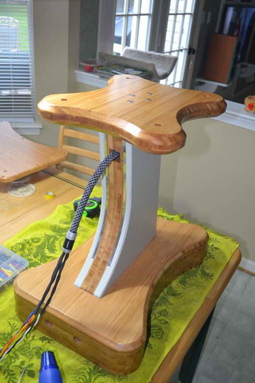

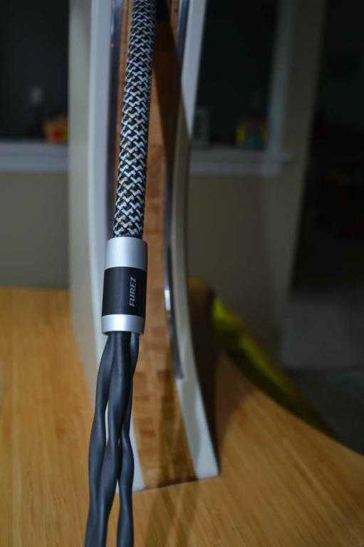

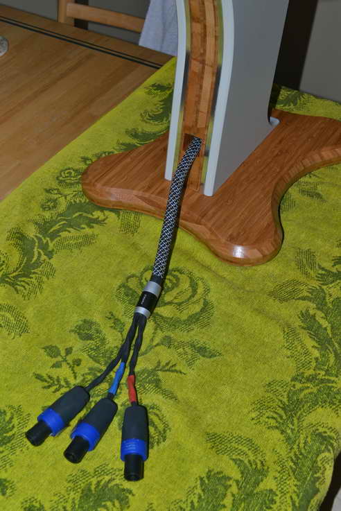

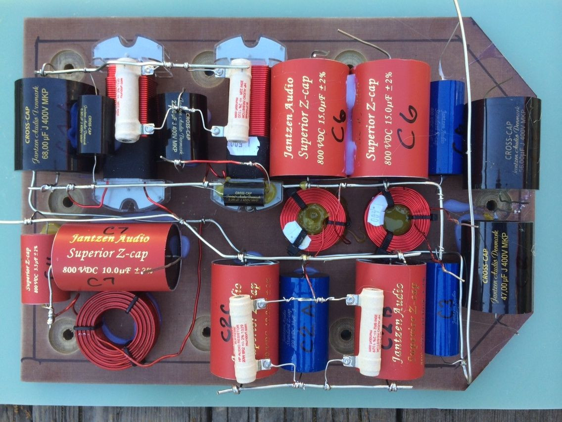

                                                                  #797

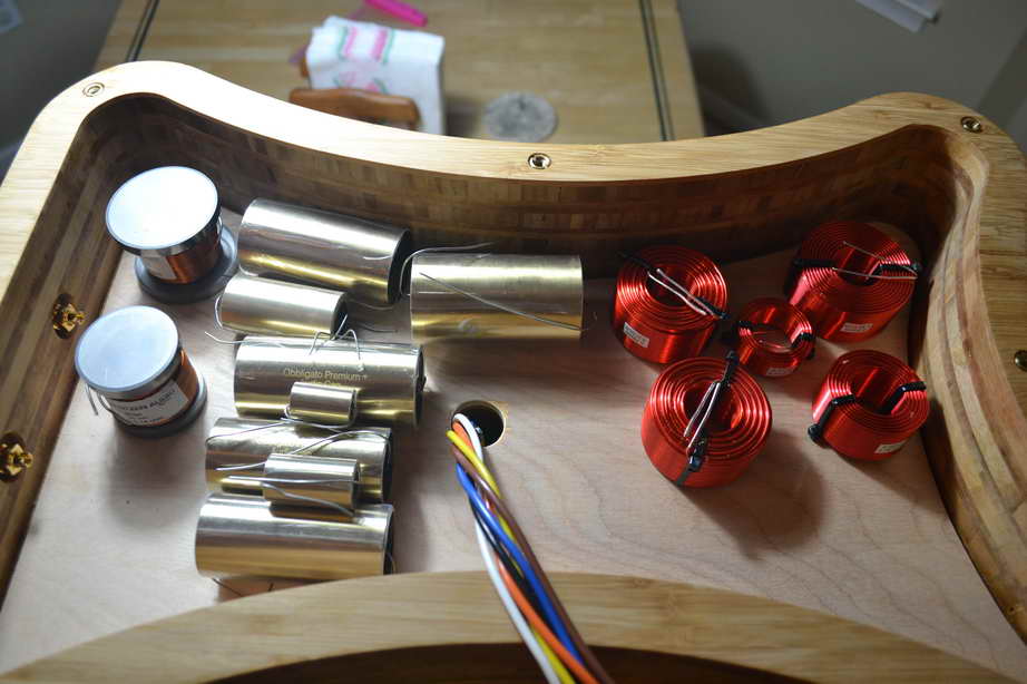

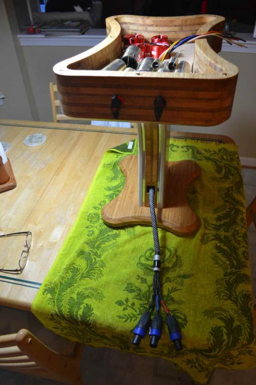

                                                                  Not forgotten ....
                                                                  Just to let you know, some progress is still being made, all be it slow!
                                                                  Crossover work is underway as well as wiring harnesses from the stands to the cabinets.
                                                                  At this point I have about 2/3 of the crossover components on hand. A few more caps and the resistors have yet to be purchased. Placement is of course is random at this point.
                                                                  • cochinada
                                                                    • May 2014
                                                                    • 661
                                                                    #798
                                                                    That wiring alone is by itself a work of art! ;x(

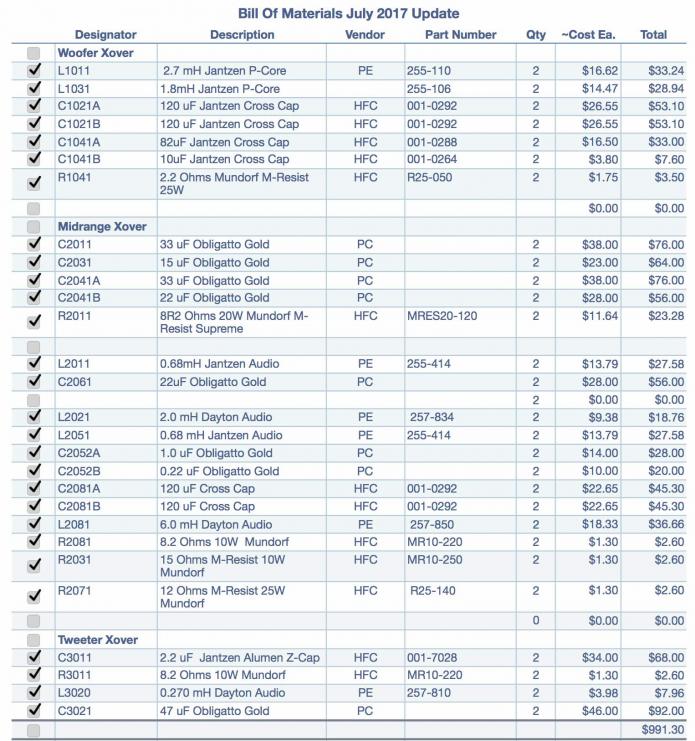

                                                                        And that'a why Steve has been a key member of "Team Minereva" all along...
                                                                        For reference, here's the updated crossover BOM as we've been purchasing for the crossover:
Name:	BOM-Minerva July 2017.pdf (1 page).jpg

                                                                          #801
                                                                          Boy oh boy! That's a very complex crossover, specially the midrange section. 8O
                                                                          Joaquim

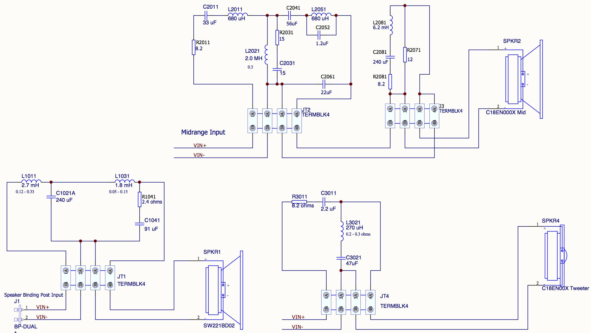

                                                                              Hey, it's not all that bad... problem is, there are issues to be worked!
                                                                              This is the design layout crossover in Altium Designer- note that there are necessary impedance conjugate networks and load stabilization too- and the overall LPAD is implemented in a different way that works and makes for a nice input impedance and better network values.
                                                                              Everyone is welcome to do their own take on it, of course- I can provide FRD and ZMA files.

                                                                              Its come a little ways since the earliest tests...

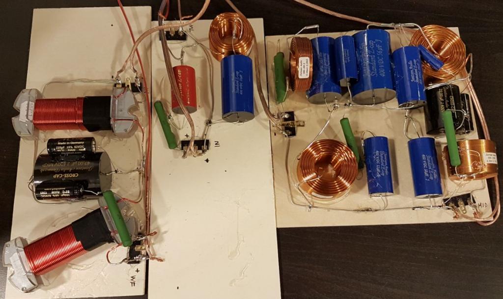

                                                                                  10 lbs of .... in a 5 lbs bag!

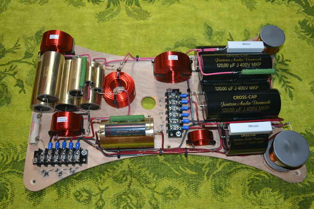

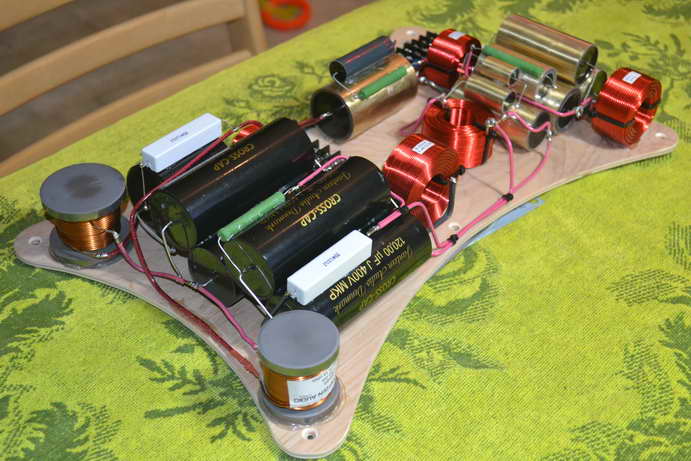

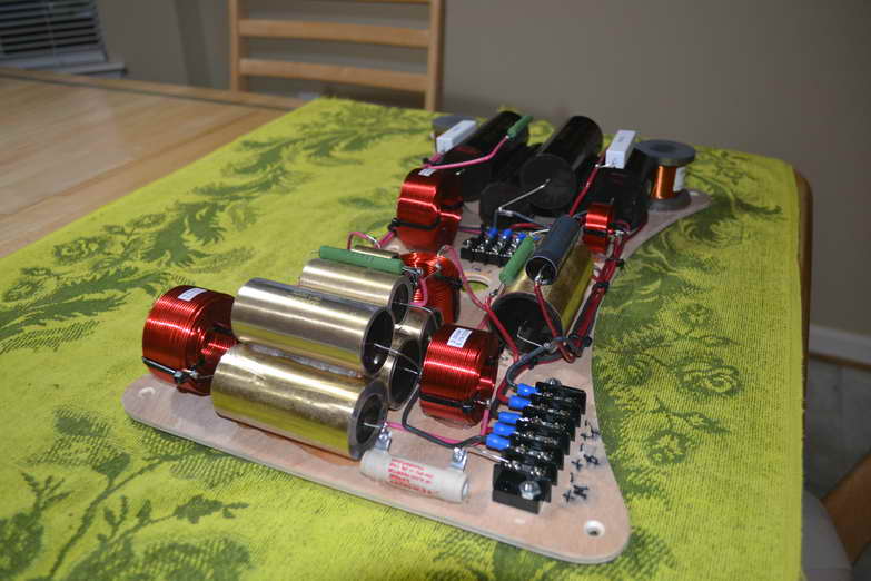

                                                                                  First crossover board is done, assuming I put everything in the right place that is. This is a great exercise if you like jigsaw puzzles! Second board should go a little faster now that I know everything will actually fit.
                                                                                    • 698
                                                                                    #806
                                                                                    Very nice! Not a lot of real estate left over so I imagine it took some head scratching to achieve this.
                                                                                      #807
                                                                                      Yep, that's a Jon Marsh crossover.
                                                                                        • 2141
                                                                                        #808
                                                                                        As well you know ..... but the man does it the right way!

                                                                                          #809
                                                                                          Thanks Ergo. Yep, lot's of head scratching and shuffling of parts.

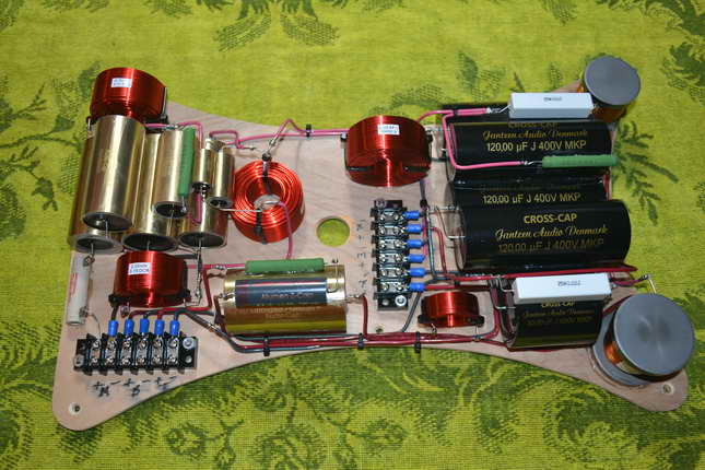

                                                                                            • 16198
                                                                                            #810
                                                                                            Strictly speaking, this is a skilled Steve Manning packaging of a Jonmarsh crossover!
                                                                                            And lest one be too harsh, it looks a lot roomier and more relaxed than my Ardent crossover's that fit in their tiny base!

                                                                                            The Ardent's had higher crossover points for the woofer to midrange- by nearly an octave, and didn't need some of the elliptic style networks that the Minerva does to make the drivers play nice together, especially the midrange! Or those big 120uF capacitors!
