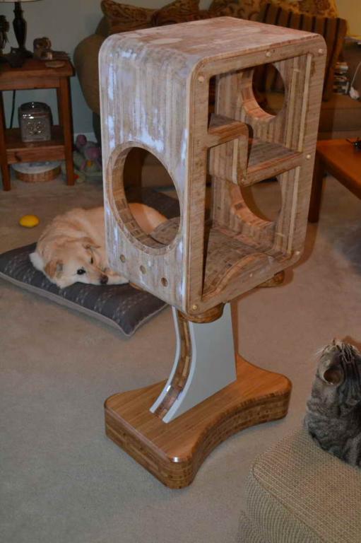

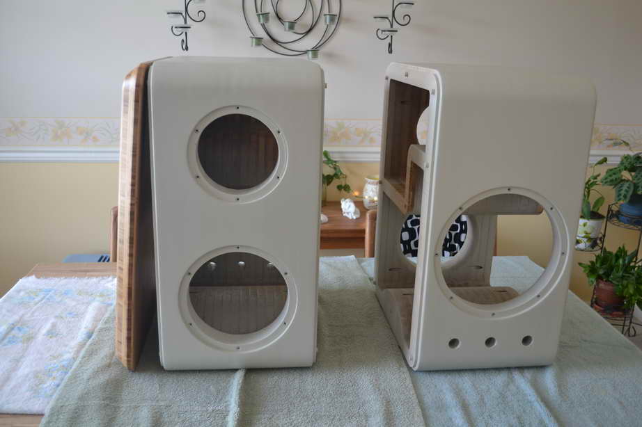

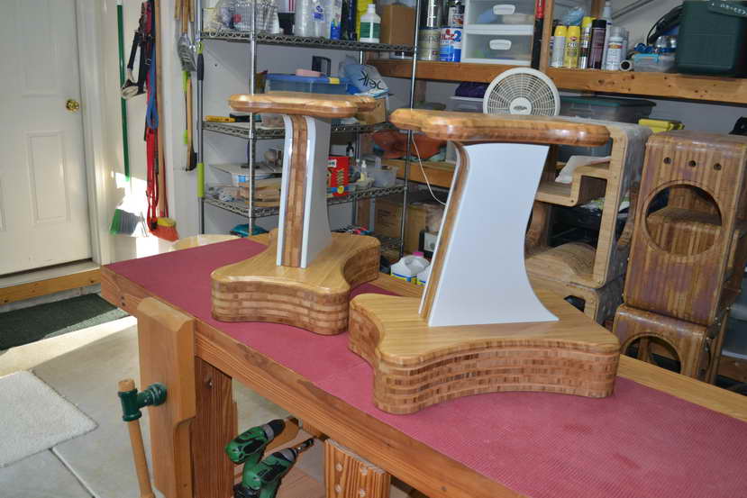

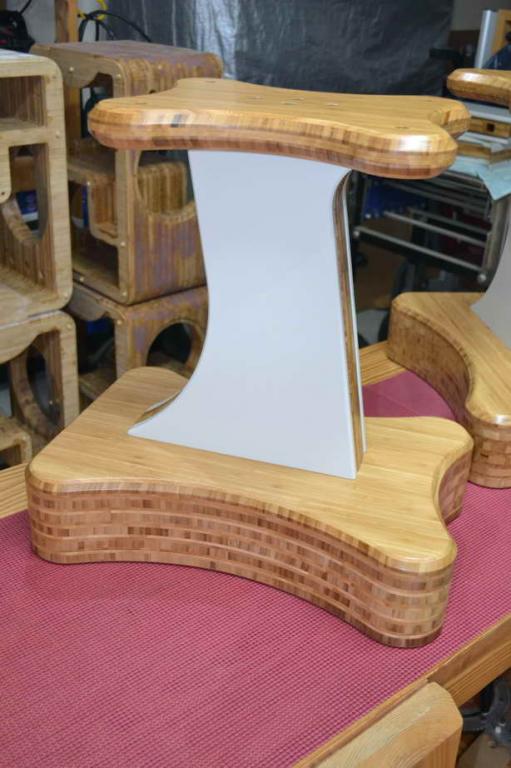

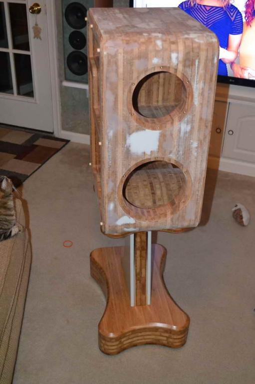

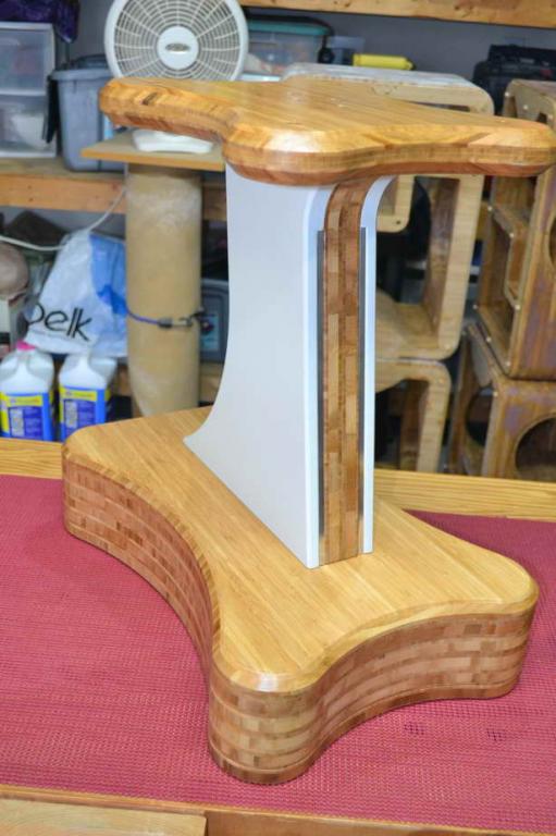

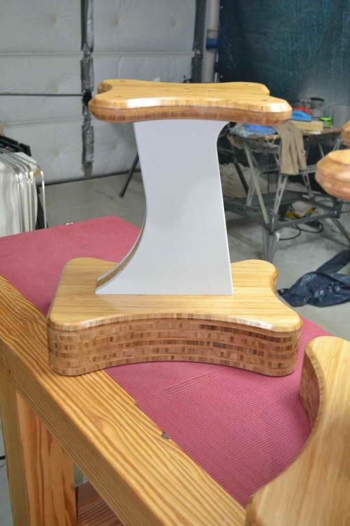

        Stands are done ...... Finished up the stands today, here's a few pics before they go to UPS tomorrow .....

          Wow. Just wow. You guys really take the duct tape out of DIY. Those are the best looking stands I've seen, ever. Beautiful concept and execution. :T
            • 1612
            #725
            Exceptional workmanship - as I have said before, the Force is strong in this one.
              • 2128
              #726
              Crap I forgot the duct tape ..... they'll never work! Thanks Lee, appreciate the kind words.

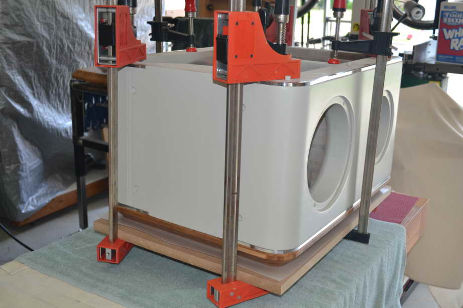

                Figured I'd better do a quick check to see if the stands would hold up the cabinets before I sent them out.
                Of course the Imperial inspections were present .....
                Even without the sides attached yet, I think the scale of the stand and cabinet work pretty well. Guess that CAD stuff works!

                  Gee, the stands ARE a bit prettier than the cabinets... but signs of things to come!
                  Is that the pup in the background that had the big Vet visit recently?
                      Yep, that's her ..... she did not really enjoy that experience at all. She is still a little off yet, but she'll get there.

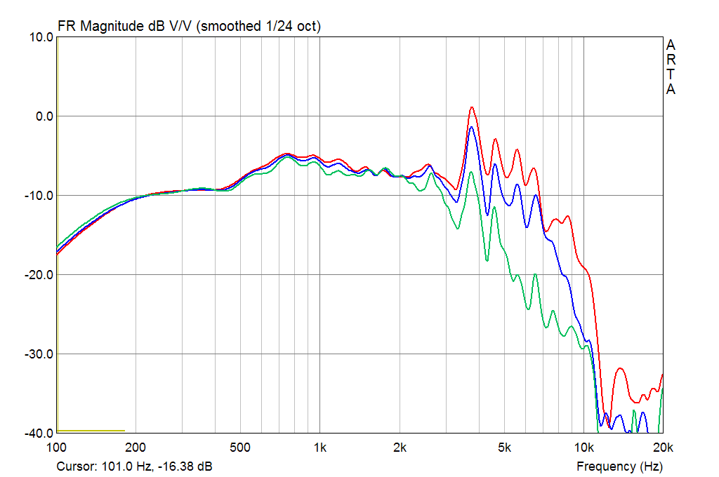

                                      First, I think an alternate design with the MR18REX is quite feasible- it's in my queue to test, have the enclosure setup for it (which currently holds a C18EN001). Second, what we're hearing is that there seems to be an update for the C18EN001 in the pipeline. It's always a question as to how long that will take, and what they are addressing, and what this means for the crossover design.
                                        FWIW, here's a 3rd party measurement of the MR18REX (FR, Imp, THD, Waterfall).
                                        Tweeter performance look far from stellar... but that might just be me misreading measurements. The 50dB scale make it look terrible!

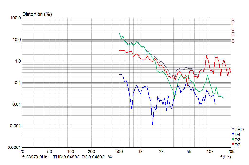

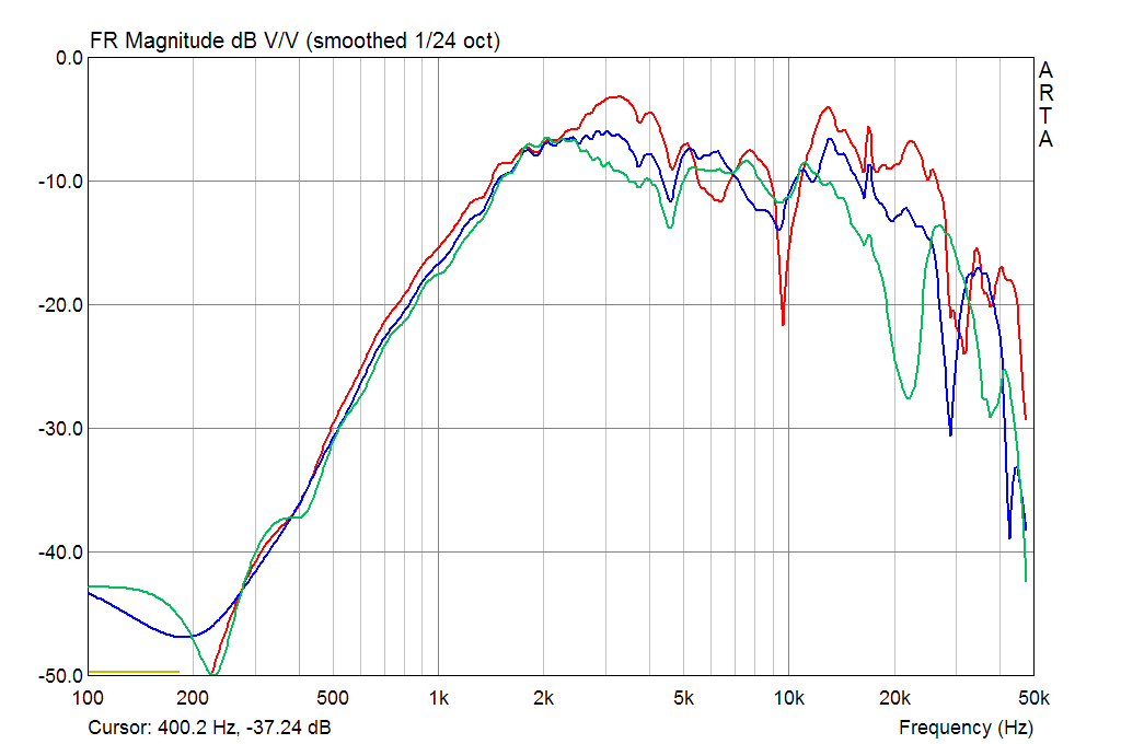

                                          Thanks for the link- these results show why the MR18REX won't be easy to work with, anymore than the C18EN is-
                                          The tweeter distortion profile shows you really don't want to go much below 3kHz and you want to roll it off hard...
                                          The response does look more variable with different measurement axis than the C18EN... he is only using 1/24 octave filtering.
                                          The woofer may be even more difficult to work with than the C18EN-
                                          It has some serious peaks to deal with just above 3 kHz- off hand my strategy would be to nail the first one with a notch filter, and as with the C18EN, use an LR6 network for a fast transition band changeover.
                                          Otherwise, I have to think the measurement is a bit compromised below 500 or 600 Hz= the baffle has a lot of impact, so I'd reserve judgement until doing my own tests.
                                          Thanks again for the link.
                                          The thing that people will likely find a bit weird, is that I suspect the coincident source and time alignment will mitigate some of the other issues if they're handled properly, and this still has the potential to make a very pleasing system.
                                          We'll just have to see how that turns out... who knows, maybe this weekend or even tomorrow night I can measure this myself. Need to get some last measurements out of the way and then tear down and store for a few weeks due to other things in progress.

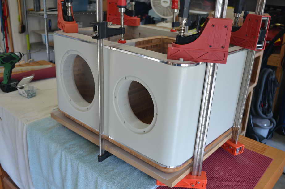

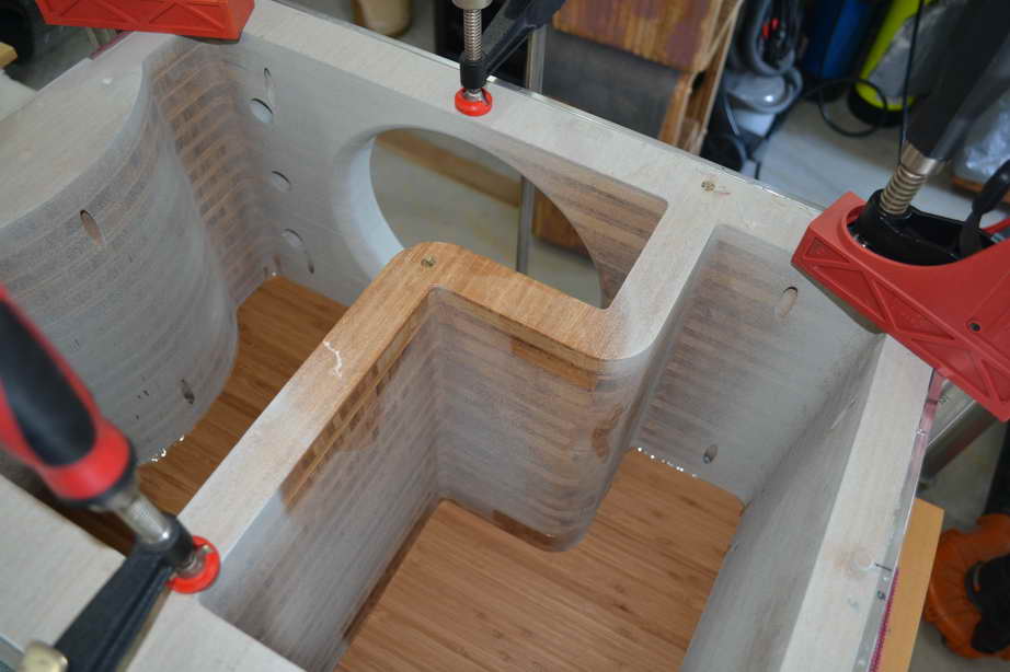

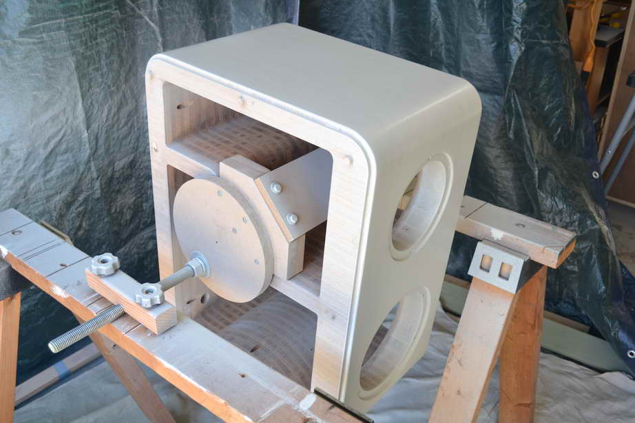

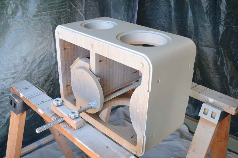

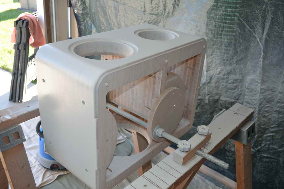

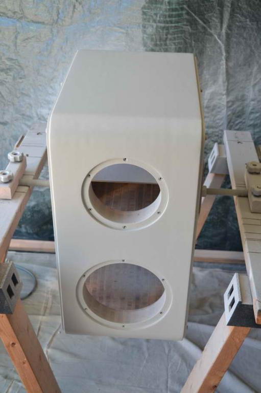

                                                  Brought out the rotisserie jig and started spraying the first cabinet center section. So far it's working pretty well for spraying and sanding between coats of finish. Discovered translam would not be the best approach for that high gloss look though. Even after lots of sanding and filling you can still see the joints a little ...... Scott I think that satin finish will help a little in this case for those imperfections ...... Of course this is lacquer and not regular paint. I imagine a good coat of polyester gel coat as a sealer would level things out a lot better before the paint and clear coats.
                                                    • 571
                                                    #745
                                                    Great effort and progress Steve...keep churning away. :T

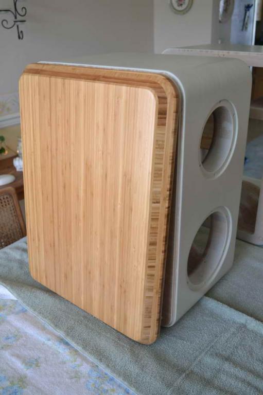

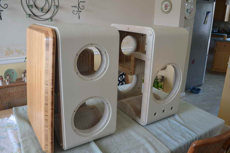

                                                                Since it's been a little since the last update due to family issues and a trip to the Pacific Northwest to visit family .......
                                                                The first set of cabinets finished with spraying .......
                                                                The parts will sit in the ac for a bit and then will get the aluminum trim installed and then final glue up. Then it's on the UPS truck for California.

                                                                  Very righteous, Steve! I really like how this has turned out since inverting what was painted and what is wood finish! That and all the incredibly detailed and meticulous work you've put in. :T
                                                                  All part of the CV if we manage to pull in the other job. A lot of work done on that today...

                                                                            Thanks Carl ..... did not go with scalloping, but did put a healthy round over on the backside of the driver holes ..... there's a picture somewhere in the thread of that.

                                                                              This is designed for the C18EN001, which has a very small neo magnet assembly, with lots of rear window. Not at all like the MR18REX, for example, with the conventional ceramic magnet. That would take more care with a thick front panel.

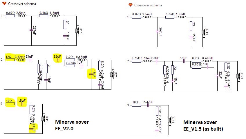

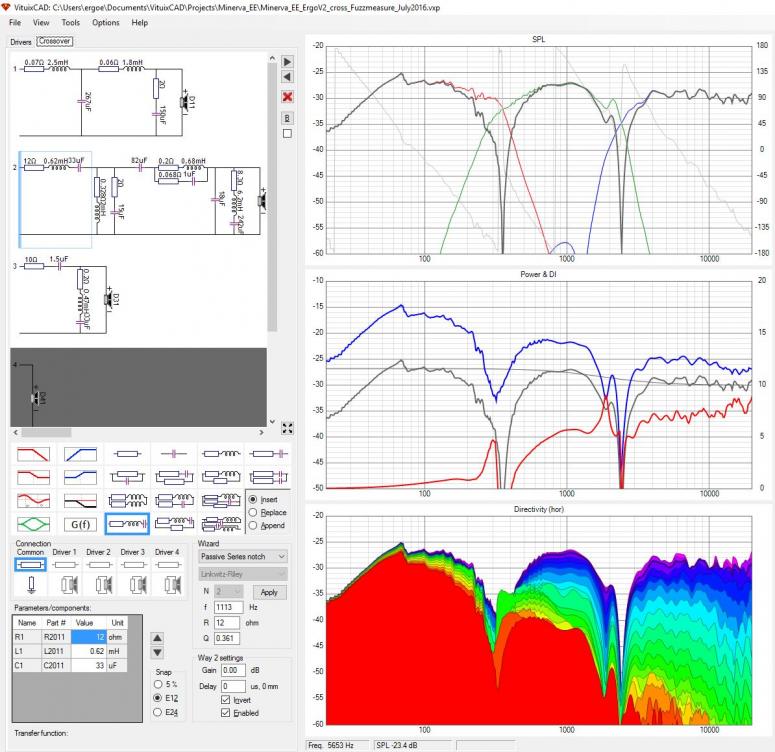

                                                                                Being on vacation from a day job still leaves only a little bits of time in between of various honey do's and supervising the new fence build etc.
                                                                                I have done some progress though. I did remeasure the Minervas last week (using Fuzzmeasure). I think I got things done carefully enough for horizontal 0 ...180 deg measurements and making sure the phase is accurate for all files etc.
                                                                                I also followed Kimmo's instructions (in finnish) here for creating the better off axis simulations for the low end of mid and woofer.
                                                                                Based on this I've modelled a new revision of the xover I plan to try. I attempted to add "Jon's voicing EQ" into the curve shape too, so will be interesting if it'll work out. More work to be done tomorrow to figure out the part list needed to make these changes.
                                                                                More images in Flickr
ID:	862053Click image for larger version
ID:	862054Click image for larger version

                                                                                      Sides going on ........ have the trim installed on the first cabinet. Spent a fair bit of time removing epoxy squeeze out during that exercise. I have now moved on to installing the first side. Fortunately the humidity has dropped since this morning, so the heat index is now only 104 instead of 108 that it was earlier, so a little less sweating going on. Of course adding a double layer of lbl to the side of the cabinet kind of balances things out with a little more grunting involved in moving the cabinet around. These things are going to be heavy "little" beasts when their done.
                                                                                        • 16069
                                                                                        #763
                                                                                        Hello from Palo Alto and Stanford-
                                                                                        Looking very good Steve- your report of the temperature makes me cringe, because I know how high the humidity gets there, compared to CA- and we only had a paltry 98 yesterday...
                                                                                        • Carl V
                                                                                          • 269
                                                                                          #764
                                                                                          looking great.... I see that interior bevel now.
                                                                                          Another question what is the hump for on the
                                                                                          bottom of the enclosure?
                                                                                            • 16069
                                                                                            #765
                                                                                            That's where we install a special space time modulator that provides an inverse FFT of the music spectrum direct to your brain, but aimed at subliminal induction to stimulate the pleasure centers without you being consciously aware of it. Yeah, it's kind of cheating, and probably violates some FDA rules or something, with regards to wireless medical devices, but it's all good fun....
