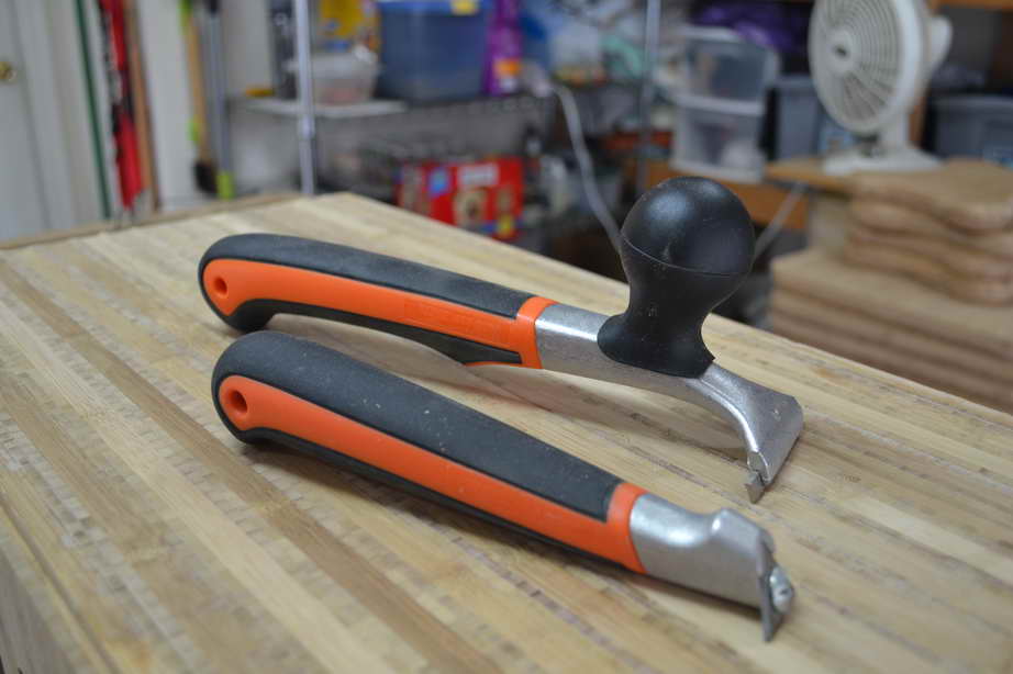

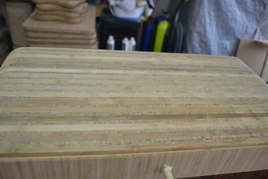

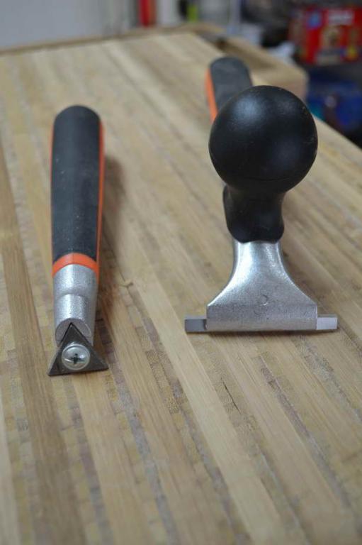

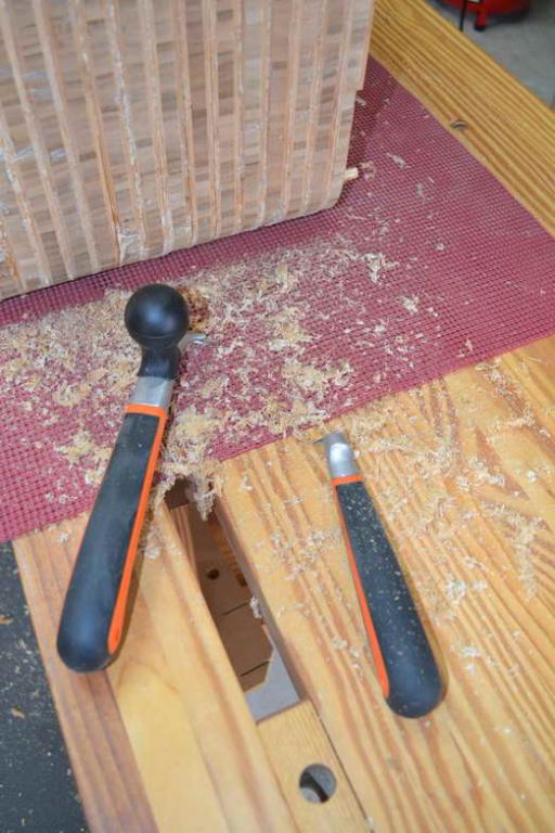

    Got a new toy today ...... I ordered a new scraper, I know big whup !!! In this case yes, especially if it makes your life easier. I already had a small version that has been very helpful and the new big brother is even more so.
    They are Swiss made products, the company is Bahco. The smaller in the foreground (the old one) takes various shaped blades all of which are carbide, so they stay sharp for a good while. The best deal was the new guy was only $20.
    After a few minutes of work and you can see the results ...... this is the second cabinet by the way.

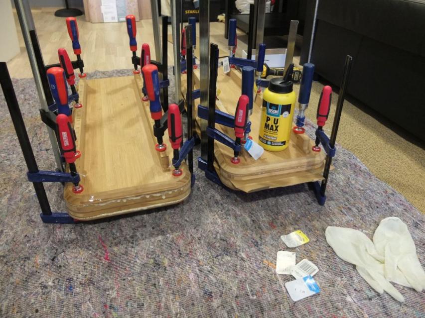

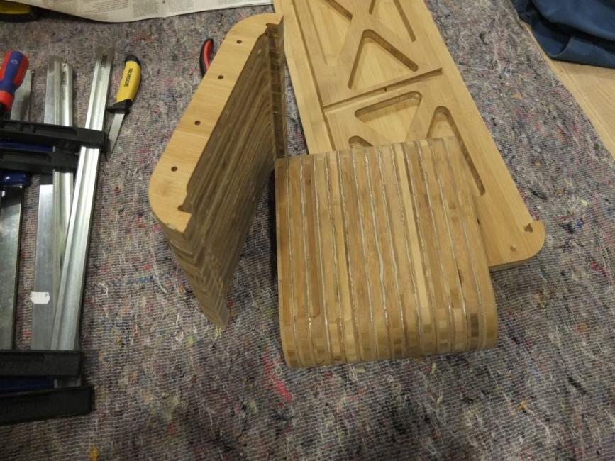

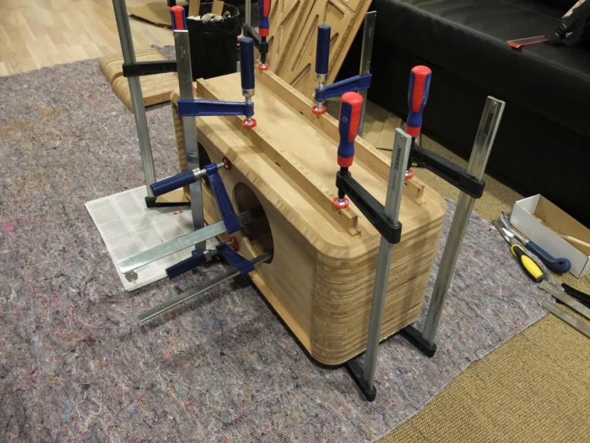

            Glue-up process started ...
            Will continue tomorrow with all the top and bottom layers. Or then all of the panels. Will decide in the morning....
            This stuff does slowly creep out between the cracks, so leaving the inner front and back panels for later might mean lots of scratching to get the grooves clear again to slide in the panels. As there are lots of pieces I would need to be quite quick about it I guess if I do attempt to do them all at once.
            Anyhow - there is an old Estonian saying that "Morning is smarter than evening" - so I'll follow that guidance of the elders.
              • 2141
              #321
              And so your fun begins ...... I'm in the process of gluing up cabinet 3 at the moment, taking a cure time break. I'm finding that I can't glue as many layers as I would like, due to having to get all the dowels to line up, slide the pieces together, etc. before the glue starts setting up. With your cabinet being a different design now, it will be interesting to see how yours goes together. Looking good so far.

                    • 698
                    #324
                    I went for 2 step process. 1st the top/bottom layers and then all the rest. Box 1 is now 'under pressure' and Box 2 will follow late today or tomorrow.
                    After that I'll of course see how much sanding is needed and I can also take measurements for cutting the outer front and back panels.

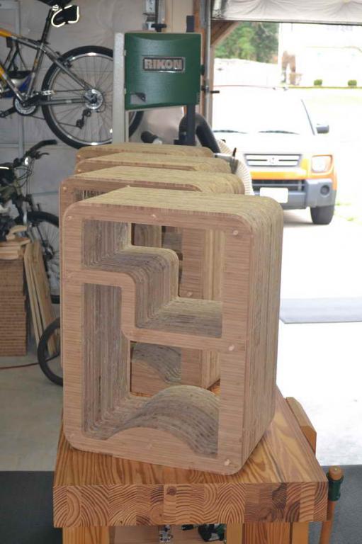

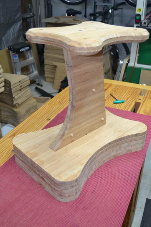

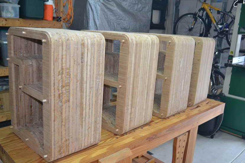

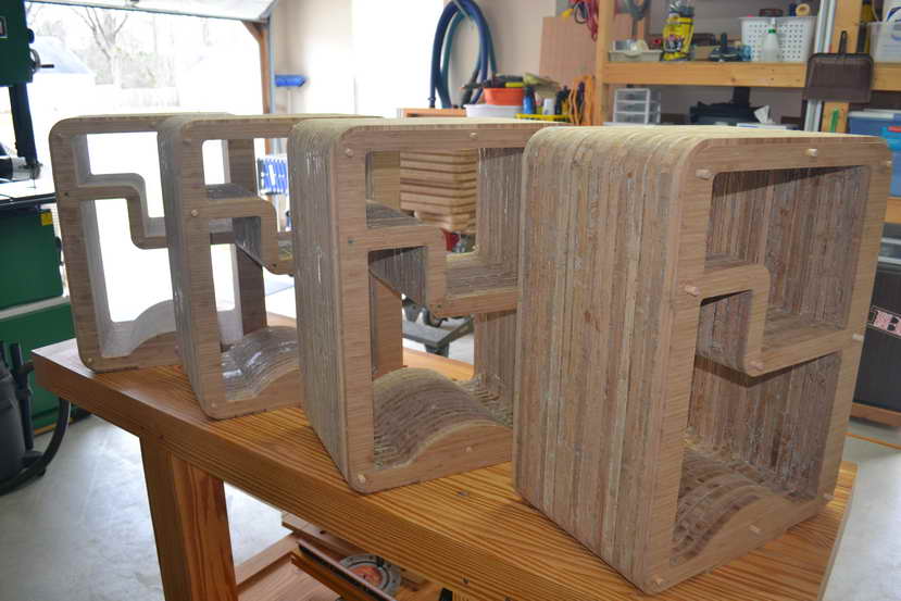

                        Work Bench Load Test ......
                        Figured I'd give the work bench a little workout ...... all four cabinets are now glued up.

                          Looking good Steve- how much do you think this part of the cabinet weighs?
                            • 2141
                            #328
                            My guess is 50 - 55 lbs ..... a quick crunch of the volume says they should be a bit over 56 lbs.

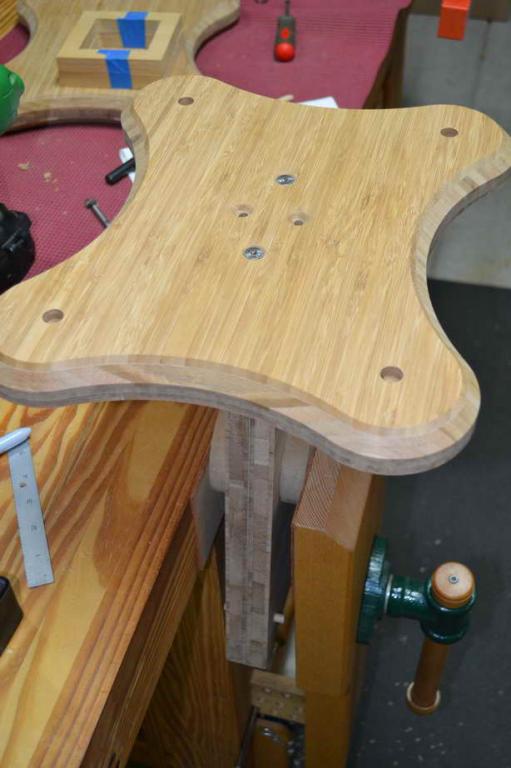

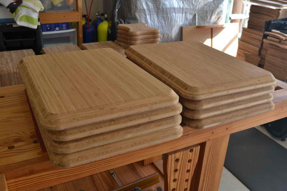

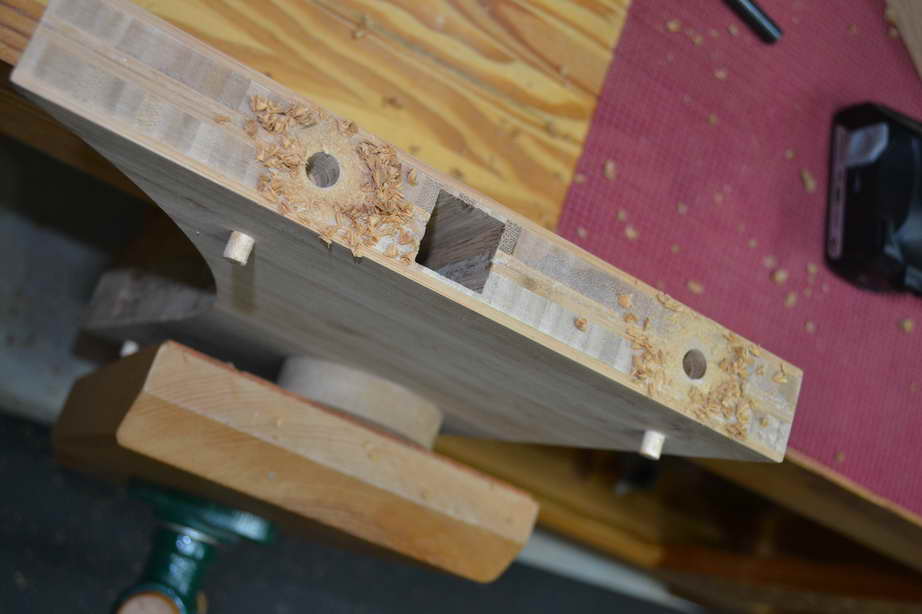

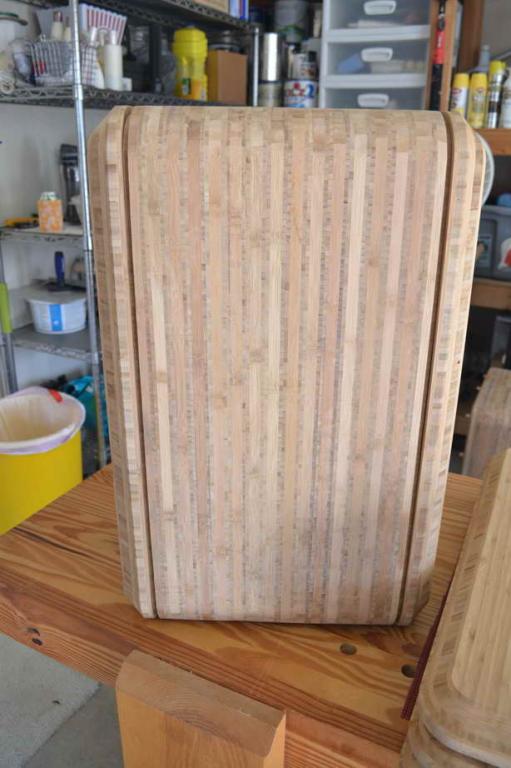

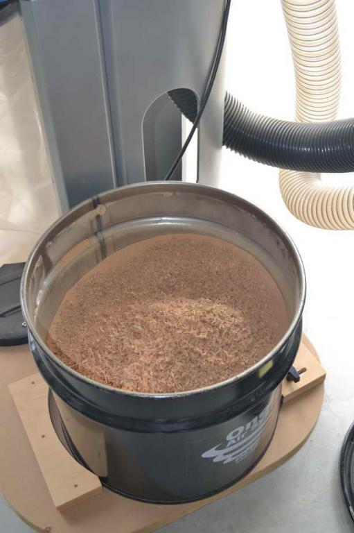

                              New Router Bit
                              Well the new chamfer bit from Whiteside arrived ....... big difference in performance over the other one.
                              Did a nice job with filling the dust collector bin, which is 17 gallons in size. This is all from the chamfers.

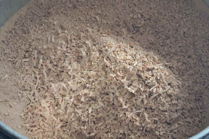

                              Nice large chips indicating a sharp bit.
                              All sides ready to go as far as machining at this point.
                              A better feel for what it will look like on the cabinets.
                              Jon ...FYI, these will add another 30 lbs (per pair) to the cabinet weight, so we're at ~85 lbs at this point.

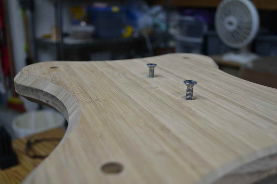

                                        #334
                                        I'm currently building a Paulk style bench (the stowability was a big plus due to limited work space), but a Roubo is on my list for down the road.

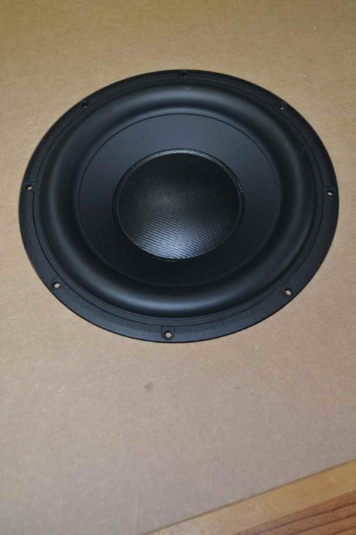

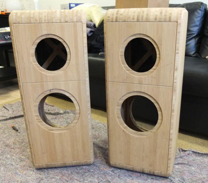

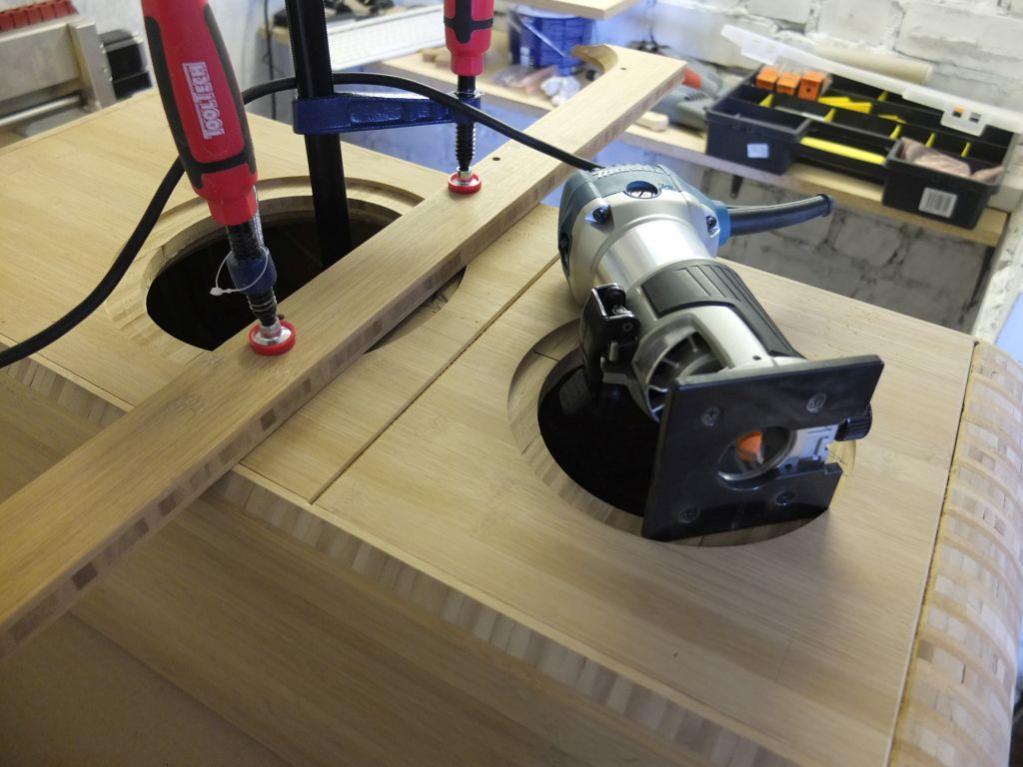

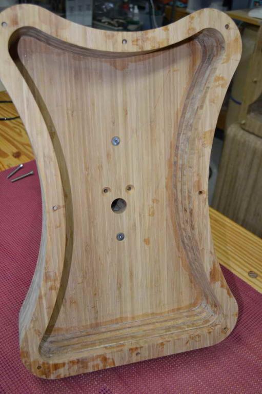

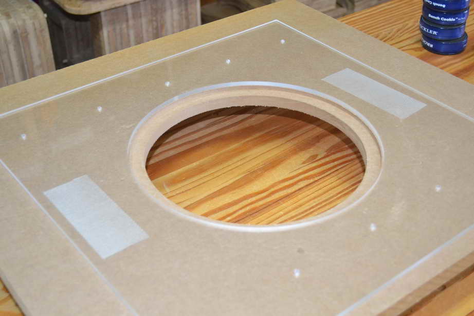

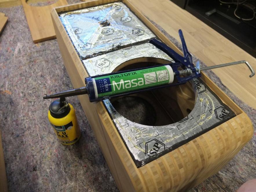

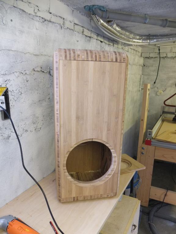

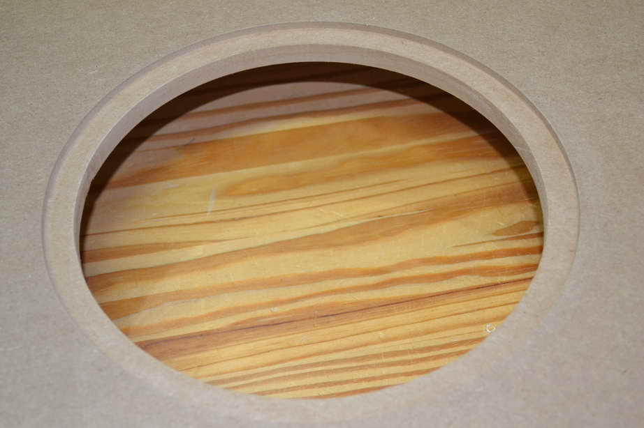

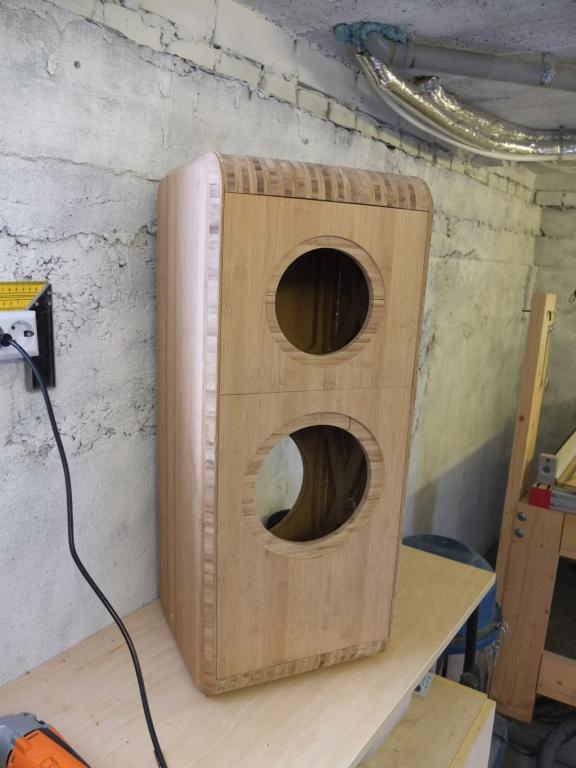

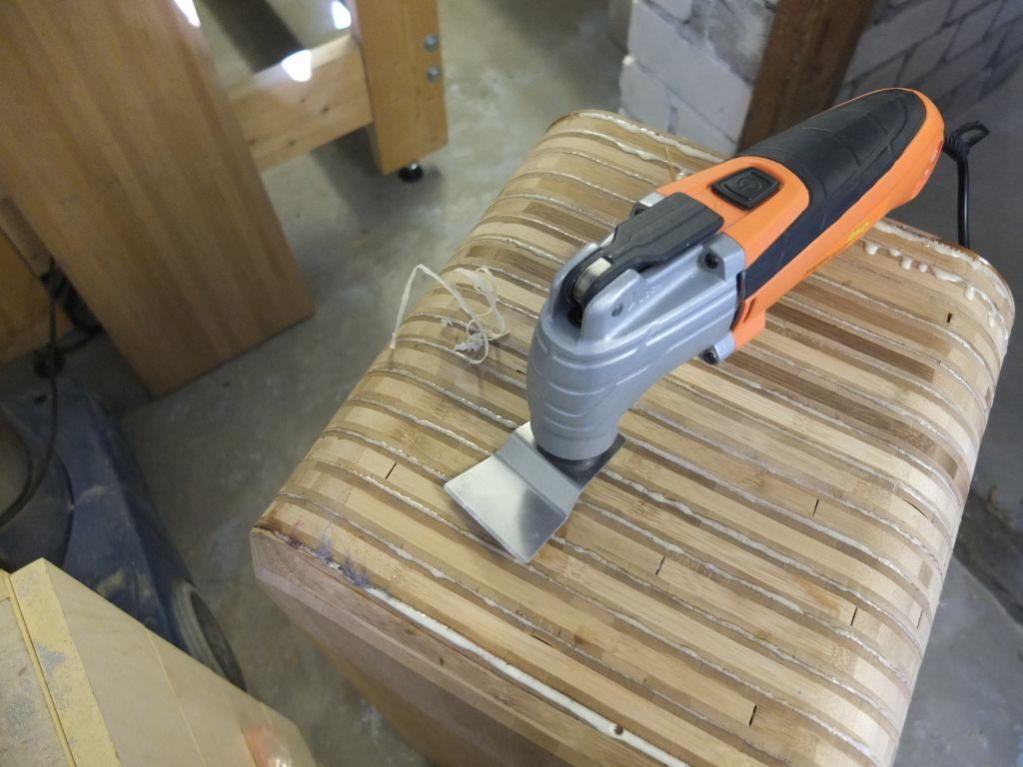

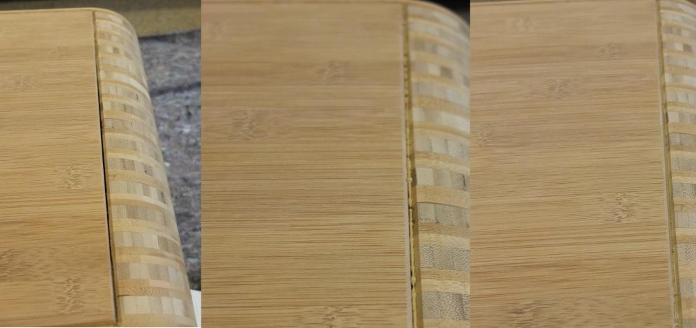

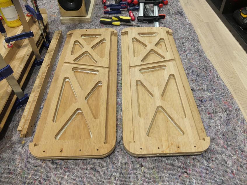

                                                                I've had some progress too.
                                                                First - Bauhaus after week of mulling about it gave me a 30% discount on 4 worst boards that I asked to be replaced. They claimed that as the main surfaces have no issues the problems with lamination in mid layers is "normal". Well I did take the opportunity and bought the new boards for next projects as I had replaced the ones I needed already a week ago to get some progress and not wait for them. Now I have some extra stock fro that 'next project' Don't quite know yet what that'll be.
                                                                I cut the front and back panels out today. One of the huge plusses of CNC is that one can keep the stock on machine and then dry fit the speaker units. This way making 0.1-0.2mm extra runs for flange pocket can result in a super nice fit.
                                                                I also ended up using the 'multi tool' with a knife blade to remove the excess glue before sanding. Worked nicely and did a cleaner job than the manual scraper that I also tried.

                                                                  • 698
                                                                  #347

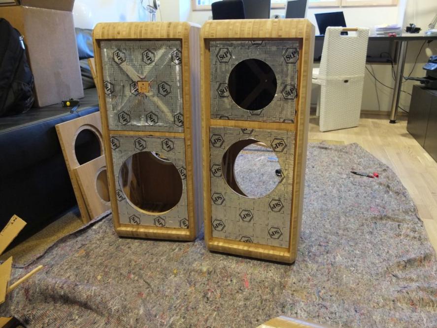

                                                                  Also did most of the sanding.
                                                                  Added the 1.5mm buitumen layer between panels and glued the front and back panels.
                                                                  So getting closer to the next step... internal wiring and damping material is waiting for a turn already. Measurement round is not far off....
ID:	861473Click image for larger version
ID:	861474Click image for larger version
ID:	861475Click image for larger version

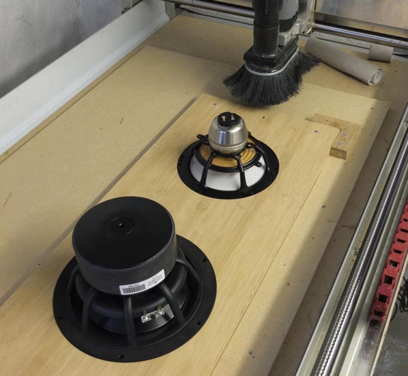

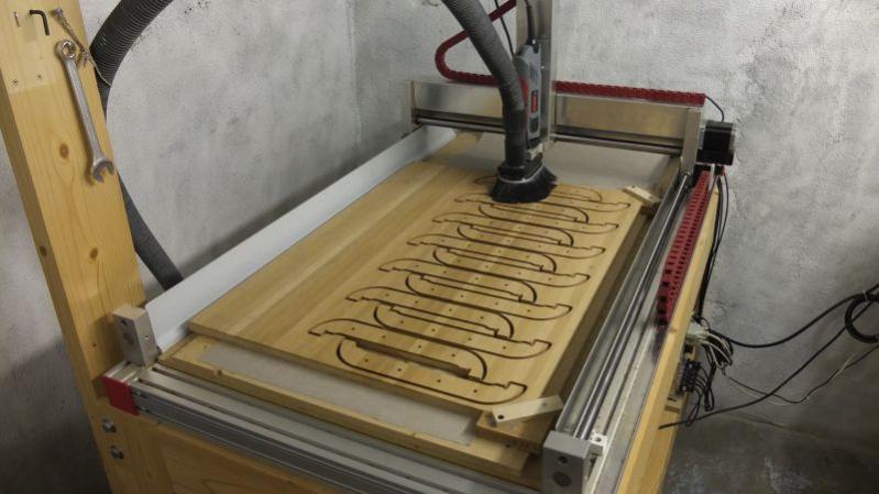

                                                                      Machine is from CNC-Step in germany
                                                                      High-Z S-1000T CNC Router with ball screws and stable frame construction for more accuracy and speed. Milling wood, plastic and metal with best results.
                                                                      Software flow is
                                                                      RhinoCAD 3D -> Vectric VCarve Pro does the CAM function -> and then WinPC-NC drives the machine.
                                                                      I also have a 'Filou NC12 für WinPC-NC' as a CAM. Using that for other than wood projects (like the waveguide/tweeter milling for Modula MT-s )
                                                                      I did have some 'financial help' buying the machine, but that's a longer story.
                                                                      I added few photos of some other interesting milling done here
                                                                      Explore this photo album by ergo22 on Flickr!
                                                                        • 16198
                                                                        #350
                                                                        Very nice progress, and a very nice setup for your CNC! I would say I'm jealous, but even if someone gave me one, I have no where to put it right now! Looking very good.
                                                                        I hope to be back in the saddle and getting the first of the 2nd stage prototype cabinets for acoustical test done soon, but this will be affected by subsequent treatment steps, so may be delayed a bit- we'll see, hopefully I can get a bit of work snuck in here and there.

                                                                          Nice progress Ergo ..... looks like your multi-tool did a nice job on removing the glue for you, (did not think of trying that trick) looks like your glue might be a little more pliable than the stuff I'm using.

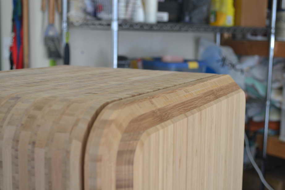

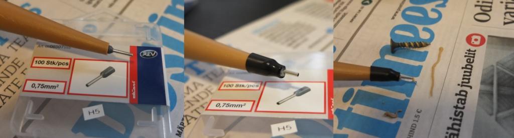

                                                                            I did some more good progress today. Cut the V grooves around the front and back panels.
                                                                            Then made a bit of mix and match of electronics parts --> tools for woodworking. Managed to make the tip of the wood filler applicator fine enough and I'm very happy how things turned out.
                                                                            Now only last fine sanding to do and then the final finishing... I know that I'm gonna leave the bamboo shade as is, so have to find some lacquer that'll protect it well. Problem is that I do have a spray gun but no place with enough room. It turned cold outside again and some 2 inches of snow today. So the official calendar 'start of spring' does not really hold up in north.

                                                                                Did some tests with one of the router templates over the weekend, unfortunately the guide bushing came loose and took a little abuse from the router bit. Carbide one .... brass zero. New bushing on order along with a tension spring for the bushing.

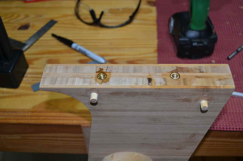

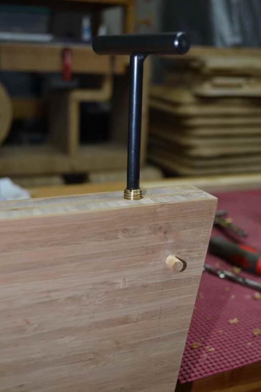

                                                                                  With cutting driver holes off the table, I moved on to playing with some of the many brass inserts that will be installed.
                                                                                  These were on the stand ......
                                                                                  Though I don't think it was necessary, I added some CA glue to keep things in place.
                                                                                  Top bolted in place ....

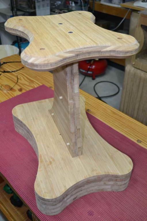

                                                                                    Bottom and top of the stand attached with 1/4 - 20 SS screws ....
                                                                                    Of note, only half the bolts/inserts have been installed. The vertical section of the stand will have two additional layers of lbl attached, one to each side after painting/finish has been applied and the remaining inserts will be installed then.
                                                                                      • 16198
                                                                                      #357
                                                                                      Looking very nice, Steve! It's fascinating to me to see the wood coming together and realizing the renders, in a manner of speaking.
                                                                                        • 698
                                                                                        #358
                                                                                        Good progress Steve. With much fever laminated parts and only 2 boxes I already saw how much effort it takes to glue and scratch and sand these. Making 2 pairs and stands is really a LOT of work.
                                                                                        I was thinking to myself number of times that ideal would have been to actually build 1 extra box... the practice one. On so many small jobs it would be nice to be able to practice first and then make the 'money cuts'.
                                                                                          • 16198
                                                                                          #359
                                                                                          Isn't this the truth! You can imagine the number of times I take deep breaths and think things through carefully to avoid yield loss, as I'm no where near the wood worker most of you guys are!
                                                                                            • 2141
                                                                                            #360
                                                                                            Your right Ergo, just because all the parts were cut for me, has not eliminated a very large amount of work to put this all together.
                                                                                            I'm with you there Jon ....... There is still a pucker factor that goes into some of this stuff. I always cut test samples for things like driver cutouts and what not. With this lbl I've been doing tests just to determine appropriate hole sizes for the threaded inserts, since this stuff is so hard the holes need to be larger. If something goes wrong with the driver cutouts, there is not really the option of making a new baffle, the entire cabinet is trash. 8O I try not to think in those terms .... those deep breaths you were talking about turn into hyperventilating.
