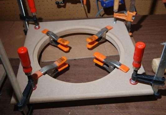

                Basic assembly is straight forward, though of course, aided and abetted if you have an assortment of clamps. More clamps is always a good thing...
                Click image for larger version  Name:	photo-2_zps7vp2hiwc.jpg Views:	1 Size:	47.8 KB ID:	941685

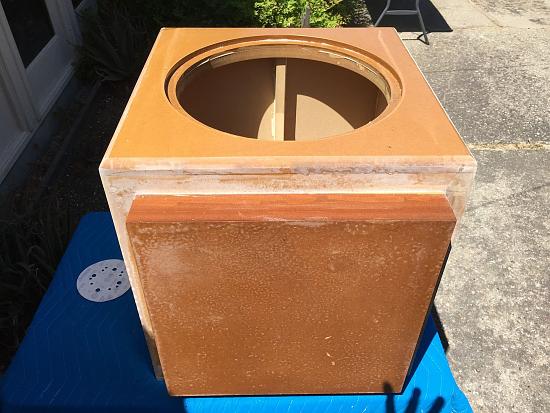

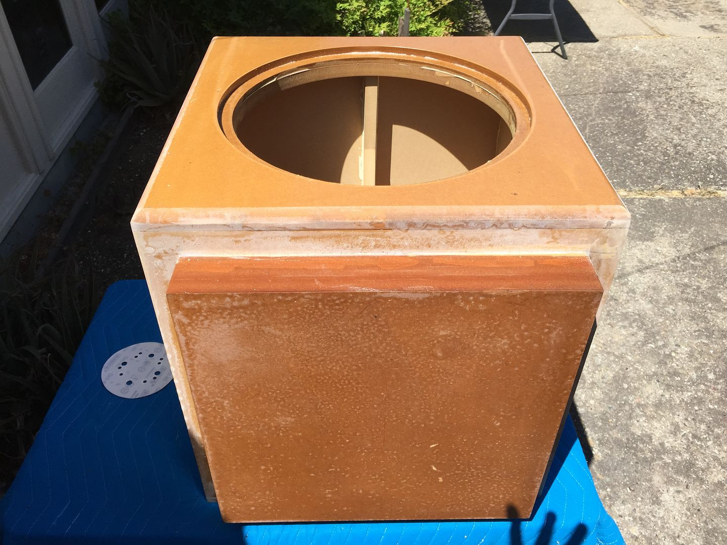

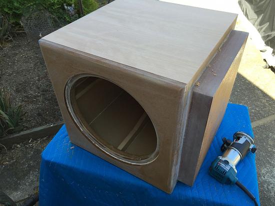

                I put together a base made of a few layers of MDF, and of course, epoxy coated the whole cabinet with a couple of layers in preparation for the veneering.
                Click image for larger version  Name:	IMG_2069_zpsmqm5usfz.jpg Views:	1 Size:	395.8 KB ID:	941686

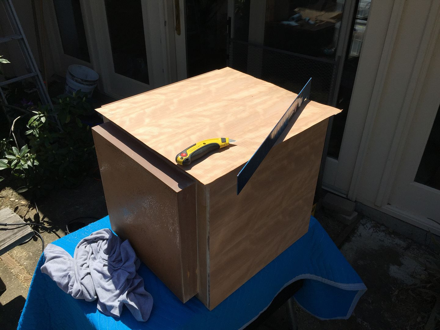

                Sanding it smooth is a bit of a time consuming process- the epoxy coat is both for the PSA backed veneer to adhere to, and is a good surface for the paint for the front panel and base.

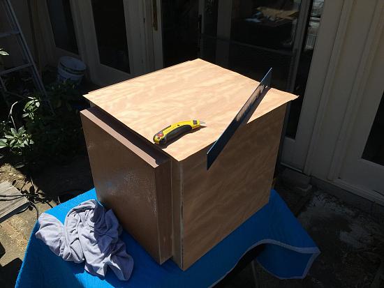

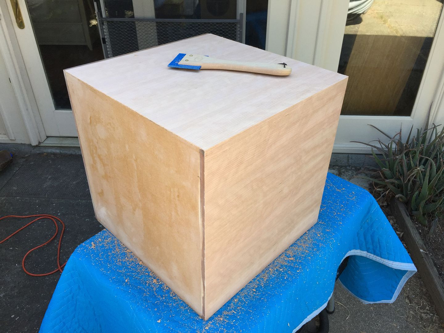

                The weather was nice and warm outside yesterday, though raw cherry shouldn't be in the sun very long, so I finished those steps after moving into the shade.
                Click image for larger version  Name:	IMG_2070_zpsf2al330a.jpg Views:	1 Size:	289.1 KB ID:	941687

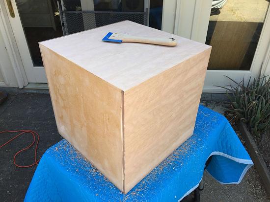

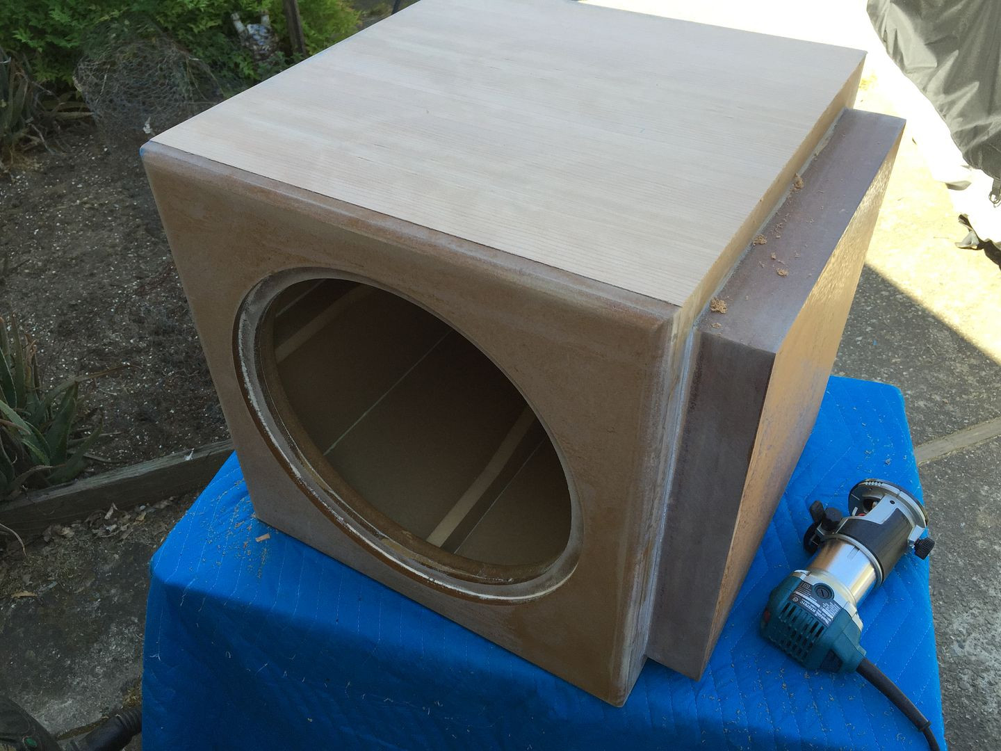

                I could tell I was on a lucky streak yesterday because I even found my veneering scraping tool, and quickly, though I was prepared to make a home made one from an oak board.
                Click image for larger version  Name:	IMG_2076_zpszemvv54b.jpg Views:	1 Size:	379.7 KB ID:	941688
                Click image for larger version  Name:	IMG_2075_zpsqqds3gpa.jpg Views:	1 Size:	340.1 KB ID:	941689
