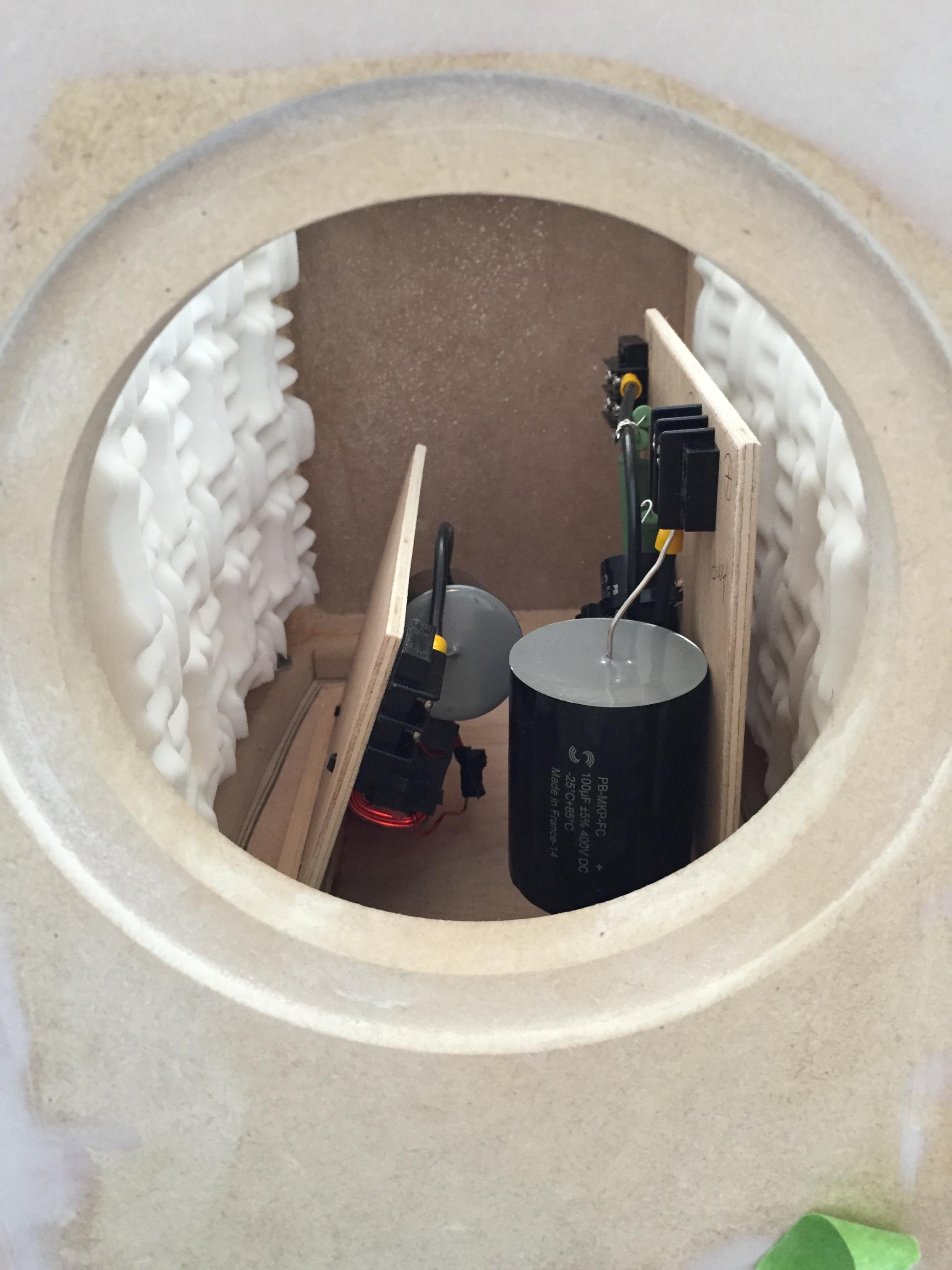

                      The good news is, the crossovers fit like a charm. The crossovers are sitting in their slot right now, once secured they would be upright (not leaning to the side).
                      Click image for larger version  Name:	hX4IbaJ.jpg Views:	48 Size:	417.3 KB ID:	928946

                                                                                          • deewan
                                                                                            • Feb 2009
                                                                                            • 290
                                                                                            The tower bases are complete. Speaker spikes and all wiring installed. Still waiting for the final paint.
