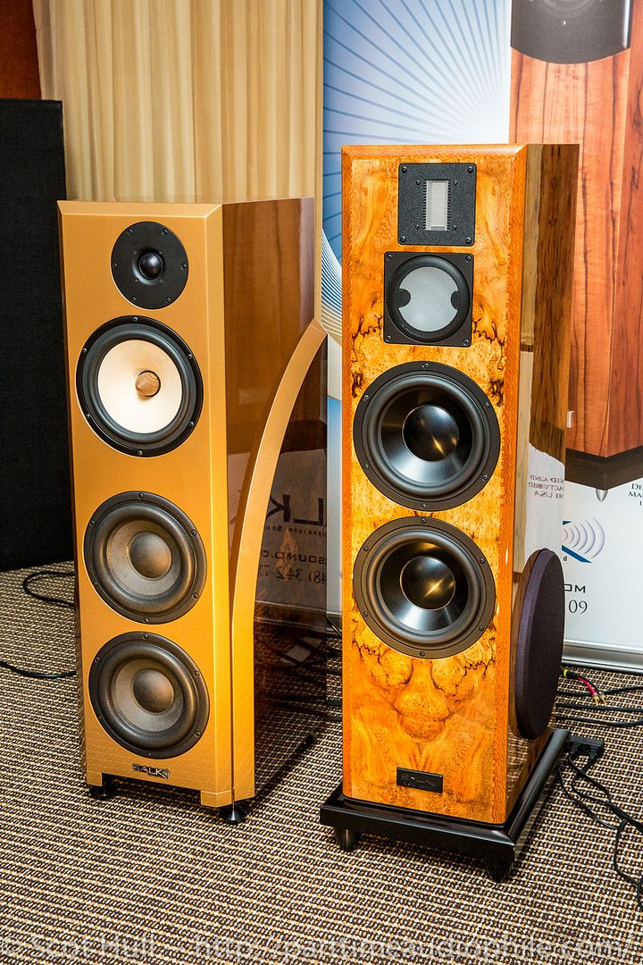

                                From the development of the Salk Soundscape, their top of the line model:
                                The midrange was a bit more challenging. We started by purchasing samples of ALL of the finest high-end midrange drivers we could get our hands on. We even had some custom built to see if we could improve upon those that were currently available. We tested them, one by one, for accuracy, power handling, dispersion and a other variables.We narrowed down the possibilities and set out to design cabinets to test the remaining drivers as full-blown prototypes we could A/B against one another. It took an entire year of working with multiple midrange drivers until we settled on an Accuton midrange. In the end, no other driver came close.
                                The one they're using is the C79.
                                  #1186
                                  We heard some of the Salk offerings at this year's Capital Audiofest.
                                  Review from Scot (aka the Part Time Audiophile)
                                  I will add my personal impressions simply by stating that proper implementation is vital regardless of the components.
                                  Their under- $3k offerings had the most value, according to this old curmudgeon's ears.

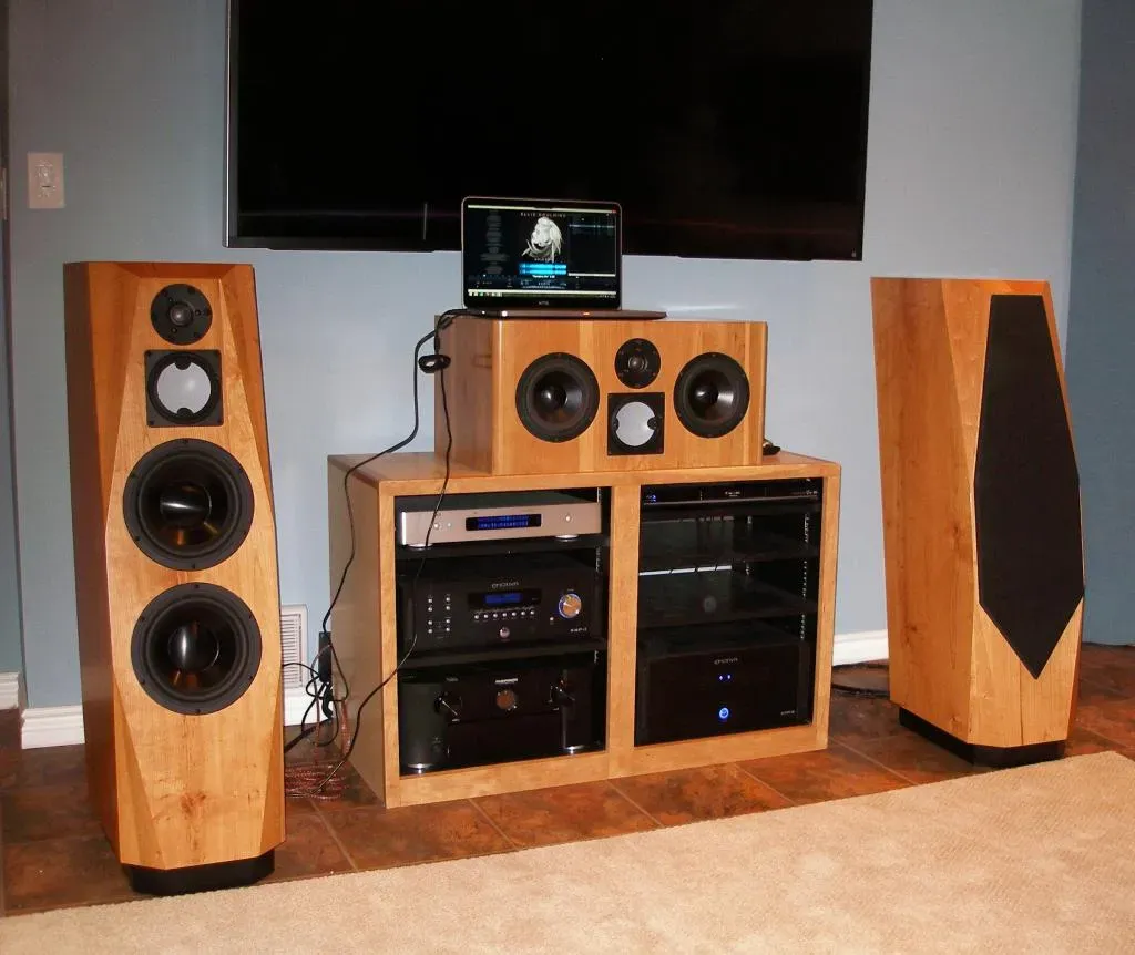

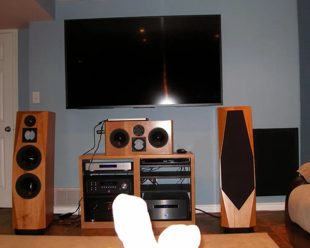

                                      Hope all had a great Christmas and will have a great new year. A little sad to start for me as I just put my daughter on a plane to NY to start her new job. Jon thats a funny comment on Charlie Brown's Christmas, we play that every year at dinner. I'm working on getting some gated measurements for you to check.ops: Ya I think the C90 is great. :T Wayne you can always just spend on the tweet and upgrade the mid later, I'm happy I scraped pennies for the full meal deal!
                                      Had a rough time with getting a working new tv though, sourced a Sam 75" 7150 at Black Friday prices and it came with a horrible back lit pic even with a calibration. I sent it back and that's the last SAM I buy cause my old one 800 series crapped just after warranty, had to change all the caps in the power supply after it wouldn't start (they put 10v caps in the 12v power supply). Then dead pic line started on one side. I was to nervous so traded for a Can 70" Sony 840B, same the US 850B, the contrast isn't as good as the SAM but the color and black levels are great and this one came perfect. Not much to do on a Sony they come pretty close right out of the box. I was relieved as a lot of net reports said the first 2014 batch of 850B came with banding issues but I guess Sony figured it out. Lots of EQing to do still but having fun.
                                      Carpet back in place and for movies they sound great tucked close. I added some gliders on the base so a little push out and they are ready for music.
                                      Click image for larger version  Name:	jan001.webp Views:	13 Size:	60.5 KB ID:	934589
                                      So this is my happy feet pic. :B
                                      Click image for larger version  Name:	jan003.webp Views:	13 Size:	35.6 KB ID:	934590
                                      Last edited by theSven; 25 June 2023, 19:39 Sunday. Reason: Remove broken image link

                                        Man, that new Soundscape 8 with the OEM RAAL tweeter and the C79 mid sure looks like the dual 8's are Wavecor woofers!

                                          Yeah Jon I saw that and thought that Salk obviously got the idea from this thread. Wouldn't be the first time and certainly wouldn't be a bad idea either.

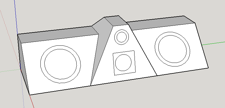

                                            If you designed a center channel like the one shown on the pictures, and ensured that:
                                            - the width of the tweeter section is the same as on the floor standing
                                            - the volume available for all the drivers are the same as on the floor standing
                                            Would it then be possible (give a good result) if you were to follow this design and use the same drivers and crossover as for the floor standing?
Name:	center speaker.png
                                                            [ATTACH=CONFIG]23763[/ATTACH]
                                                            You know I can handle to be told that this is a shitty idea as well?
                                                            Just tought that if you kept the baffel layout for tweeter and mid, as well as the internal layout, you might get a center edition with the same sound character and still reuse all the crossover work from the mains...
                                                            Of course the drawing is just a sketch to share the idea - not an actual design.

                                                              I thought someone would have chimed in on that sooner, TEK. My gut tells me that the plane of the woofers is too close to the tweeter/mid face for the facets to really have good effects. Looks cool, though. I think you would be just as well off angling the baffle back the same as the mains and adjusting the crossover from there. Tweeter response would be closer to IB response and baffle step would be different. I'm toying around with a center that is a small mid-tweeter box faceted like the mains sitting on a faceted box laying sideways with at least one woofer or maybe a single woofer stubby version. I have the luxury of a wall mounted TV and equipment rack off to the side.
                                                                #1201
                                                                I'm not sure anyone would need 2-8 3/4" sub woofers in a center channel. If it's a large room and you want a lot a dynamics (gun fire) then maybe 4-7" drivers. My old center had 2 RS225's and it was still crossed at 60hrz. My new one with the 2-7" Wavecors doesn't seam to give anything up on dynamics.
                                                                  It's not shitty. I started sketching up something similar but based on this guy on it's side using the same drivers in Dar47s centre.
                                                                  This is probably a 2-3 years away for me unless a certain energy commodity rebounds unexpectedly soon.

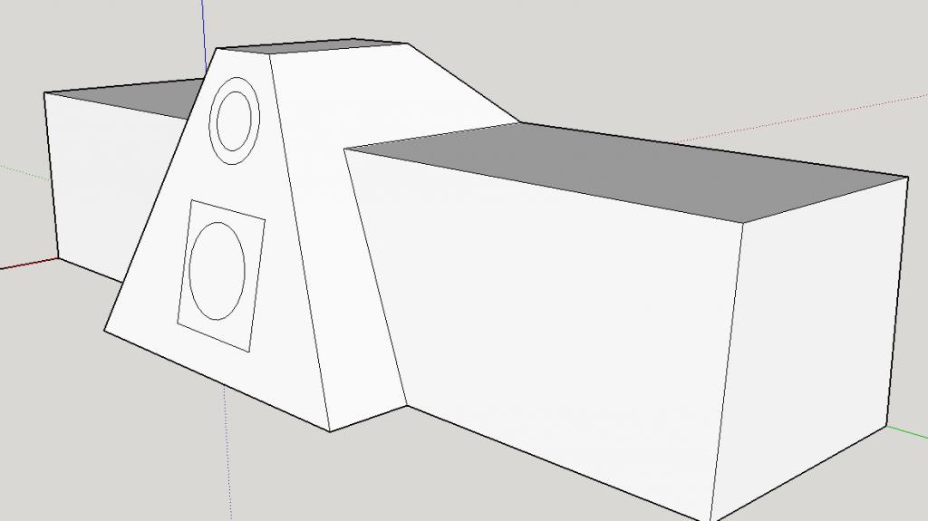

                                                                    I'm thinking that I have no knowledge about building crossovers, so if I was able to use the same crossover as for the mains, that would be very nice.
                                                                    When it comes to the "need" for 2-8 3/4" sub woofers in a center channel, that's more about economy.
                                                                    Pro (if possible to use same crossover):
                                                                    - same drivers as mains, so you are sure you get the same sound signature
                                                                    - easy to buy the crossover parts at the same time as for the mains
                                                                    - easy to build the crossover the same time as for the mains
                                                                    - should give extremely good center channel sound...
                                                                    Cons:
                                                                    - might cost more then if you use smaller drivers
                                                                    - might not give the wanted result due to different baffel layout
                                                                    - might need a higher quality amp than with smaller drivers
                                                                    - harder do build (than for example Dar47'ens)
                                                                    - smaller drivers would probably allow for a smaller form factor (if that is an issue - I do not think it will be for my part)
                                                                    - a center channel is likely to be closer to the back wall than the mains, and should maybe bee considered in the crossover design - witch it will not be with this solution
                                                                    This might be another solution, but I think it would be hard to get the same volume as for the mains with a solution like this, so it might require smaller drivers. And therefore a new crossover...
Name:	ardent center draft II.png
                                                                    Or this
Name:	ardent center draft III.jpg

                                                                    But I think that the basic question is: Is it possible/realistic to design a (laying) center channel that can reuse the drivers and crossover of the mains and give a good result - or would you in any case have to have a different crossover for the center?
                                                                      • 16088
                                                                      #1204
                                                                      IF the mid is crossover high enough that the BSC region is avoided (not quite the case here, but close), it can be done. This would probably work OK, given the crossover points of the cabinet- but the only way to know for sure is to measure. Worst case you might get away fine with just reducing the value of one or more of the series caps.
                                                                      If you have measurement capability and can generate FRD files in the cabinet you build, I can verify the crossover .

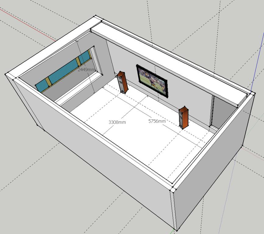

                                                                        PS. This is the room these speakers would live in... I'm in progress of figuring out the acoustic solutions and also trying to get the axis right and apply some ceiling absorption for the first reflection spots.

                                                                          With the room setup you're showing, you're going probably be listening in quasi-near field. Usually for a long rectangular room if the situation permits I'd recommend setting up along the length of the room, using the Cardas room setup guide as a starting point, and fine tuning as desired. Another concept that helps with room positioning is a reciprocity test- put one speaker in your planned listening position, then listen or measure at a variety of proposed speaker positions, picking the one with the smoothest response.

                                                                                          Seems to be a need for dimensioned drawings with some construction notes, so I'll try and get that done this week. Not sure if Jon has the time to create all this. Here is my final xover that I built. Probably the most expensive but I sure like it. I had to substitute 1 resister in the tweeter section because my choice was out of stock but this was my intent.
