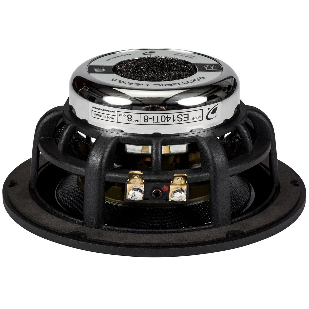

              Ordered replacement caps for the woofer circuits (68uF Jantzen Cross cap) and some more caps for tweak experimentation for the midrange and tweeter-- hope they're here soon, and hope this weather cools off a bit! though the latter may not be likely for a while- sometimes September is our hottest month!
              Also drooling a little over the new Esoteric midwoofers from Dayton Audio- will have to look into these, if they are really FMEA and Kippel optimized. I have some weird ideas, and maybe it's time to revisit the Saint-Saens concept. I mean, I haven't bought or cut any LBL bamboo in quite a while... :W

                      Found some good phenolic pieces online for possible front baffles for these Esoteric drivers- need to keep them thin, what with the frame constraints, especially if I try the 5.5". Just some experimental thoughts- need to upgrade some of GF's HT speakers so I can enjoy movies more. Have an idea for a corner loaded line array, too, which would make her happy in that room.
