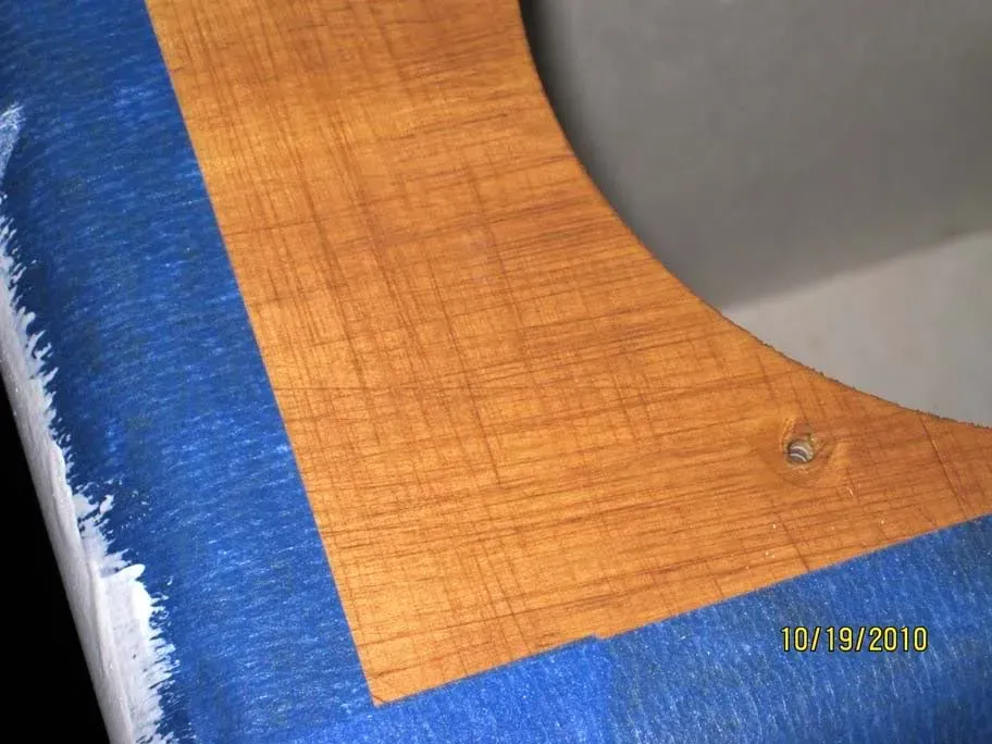

      First, I stained the front baffle. I used a wood conditioner to keep it from getting blotchy, which addressed to problem of the patches. The wood and the patches blended in seamlessly. Unfortunately, the conditioner didn't help with this:
      Those scratches were not visible on the wood before staining, but they sure are now! I sanded all of the baffles down to 220 grit, and they were perfectly smooth before I applied the stain - so I have no idea what I did wrong. I'll like to think I could sand them all down and re-stain them to get rid of the scratches, but I don't know what I would do differently this time. :cry:
      So, with limited time before the get together, I figured the baffles would do for now and I should get to work on the rest of the cabinets. So I taped off the baffles (which you can see above), sanded everything smooth, and got out the primer.

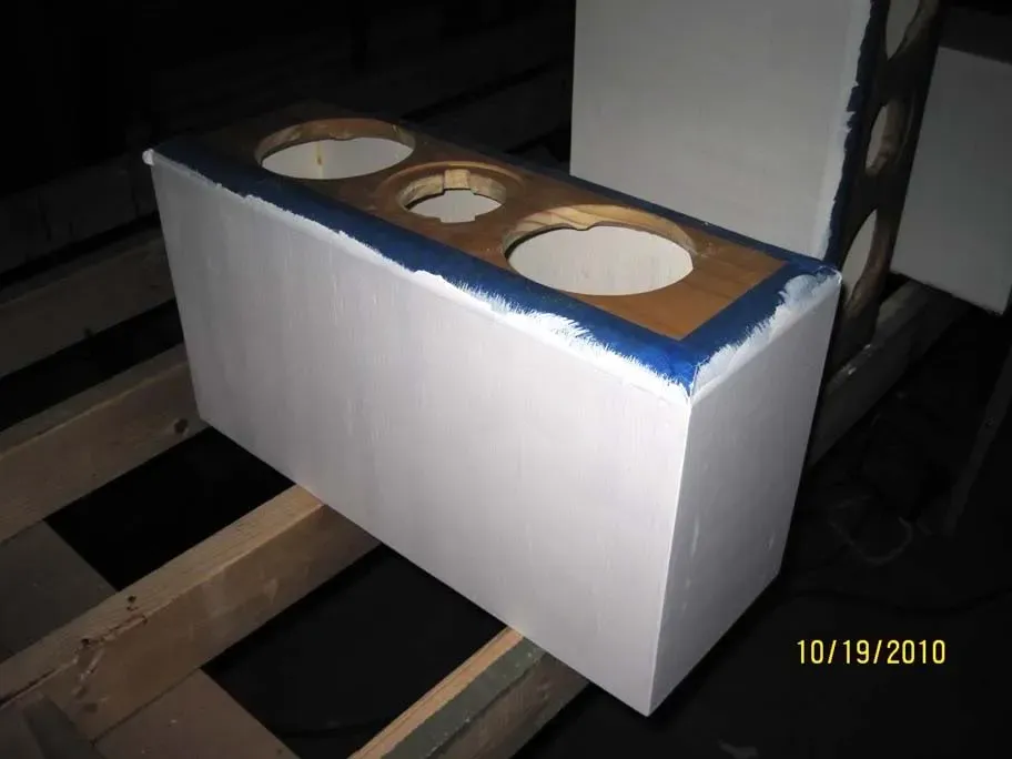

      The primer I had was all gunked up, so I ran out quickly to get some more. The fumes from the stain were pretty bad, so when I saw a low-odor no-VOC primer I grabbed it. Unfortunately, this stuff acted more like paint then primer, and raised the grain all over my cabs.
      The picture isn't great, but you can see the spotted areas. They looked much worse in person. While this stuff raised the grain like paint, it sanded down like primer - my sandpaper was all gunked up almost from the first swipe. It took about three times as long to sand down the primer then it did to sand down the cabinets originally.
      Then I had a brain fart - I grabbed the paint instead of the primer. ops:
      The only excuse I have is that it was 1 AM and I had been smelling the fumes from the stain all day. Lame, I know.
      The primer was bad, but when that paint hit the wood where the primer had been sanded away, I swelled up like you wouldn't believe. I didn't take a picture, just look at the one above and image it twice as bad.
      To add to my misery, the paint went on Sunday night. I have not been able to get back to work on them yet, and I have plans for the next two nights. And did I mention that the crossovers are not completely done yet? oke:

          About the unexpected scratches--you need a Random Orbital Sander.
          Also, two things can really help you see the fine details of the wood surface--Reading Glasses with some magnification and good lighting.
          All these might sound obvious and I apologize if you tried them all already, but I'm just telling you what I do.
          It helps if you inspect your workpiece at different angles, or move the light at different angles.
          These things can help you avoid repeating the same mistake.
          They work for me.
          Hope this helps.

            Three things:
            1. I don't own a random orbit sander
            2. The lighting in my basement build area sucks! :gah:
            3. I don't need reading glasses, I can see the bottom of my beer glass just fine thank you! :lol:
            So, yea, it is my fault. And never hesitate to point out the obvious, since you can never assume that everyone will know something that is obvious to you. I have a palm sander which should be able to clean them up, but I need to dig it out of the clutter that is my "tool storage area".
            Fixing the lighting issue in my work area is on my to-do list, but the task keeps getting pushed down as other 'stuff' comes up. I have tried some temporary measures, but they just get in the way. Maybe I'll keep the baffles as-is as incentive to get the job done. Yea, that's it - it is not a mistake, it's incentive to get the lighting fixed in my basement!

              Another tip. Lightly dampen the surface with a wet cloth...gives you an idea of how the wood will take stain and will show those types of surface imperfections.
              -Brent

                To add to what Brent said, lightly dampening the surface will raise the grain.
                This is a great trick.
                You can deliberately raise the grain this way, then lightly sand it with some 220.
                This should prevent grain-raising while applying your topcoat.
                Your palm sander can do the job, it will just take longer.
                We're all pulling for you, man. You can still get this done to perfection in time.
                Sleep is overrated, anyway.

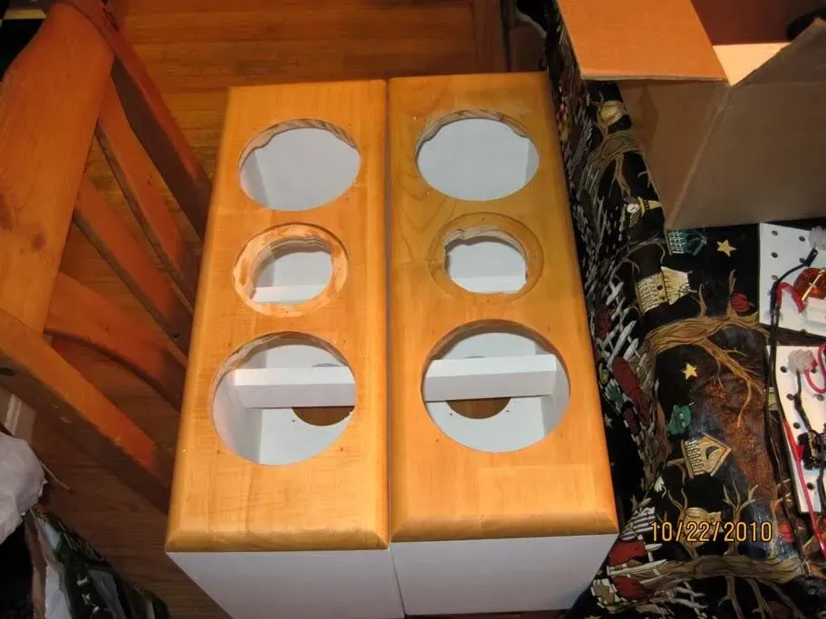

                  Here was the situation at 10:30pm...

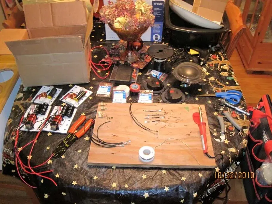

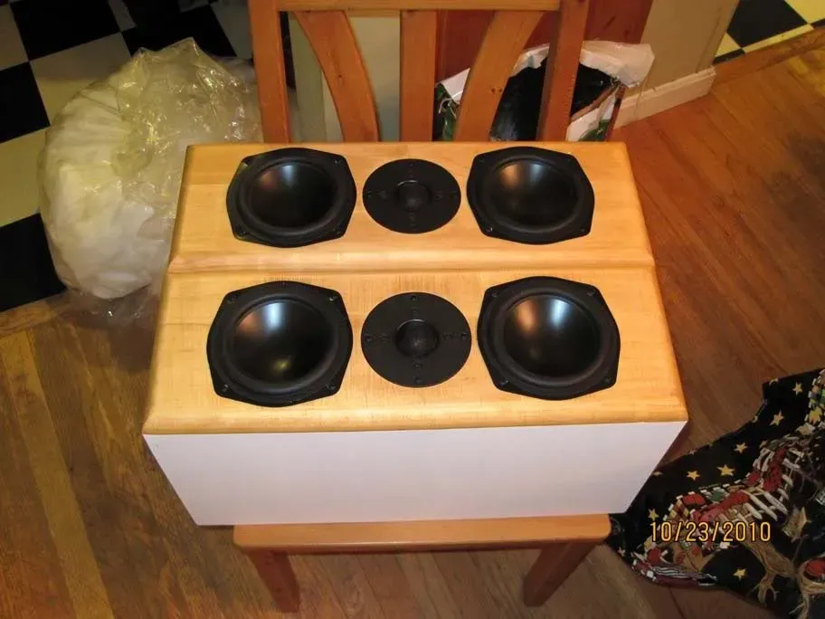

                  Normally I wouldn't be taking pictures since I would be trying to finish ASAP, but my soldering iron died at 9:30pm. :M
                  A quick trip to the local Walmart got me a cheap replacement, and I had a few moments while I waited for it to heat up. But it worked, and between it and the sugar rush from all the candy I got today, I finished wiring everything up. So, without further stalling, here they are as of 1:30 AM:
                  Mind you, the baffles are stained but don't have any topcoat; the cabinets are primed but still need sanding and filling; I had to take a WAG at the amount of stuffing, and the crossovers are wired up like a Christmas tree (so, don't give me to many bumps, Captain). No way they will see power before the trip down to Boston, but they will be there!

                          Well, believe it or not, they played great! :E All the connections seem to be OK. They got a thumbs up from a few people at the event, but I was so relieved that they worked I couldn't concentrate on any critical listening. ops:
                          I'll get them back into my basement and start working on the cabinets again later this week. I spent Sunday just catching up on things, and of course the wife has a long to-do list waiting for me now that the GTG is over. I'll post updates when appropriate.
