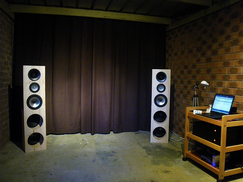

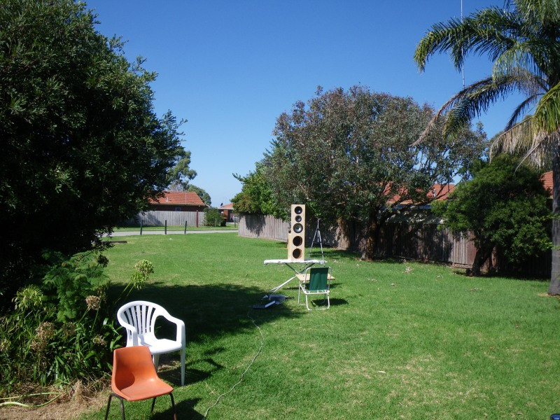

    So please let me share this one. This build is an attempt to refine my live system, the S12 which I have been enjoying so much. They do many things right despite their obvious limitations. They are 3-way active system using analog crossovers. I had many attempts before, some are more ridiculous than others :lol:
    The S14 build will try to address cone breakup which I can hear/feel with certain material. The M-T xo point is 1.5khz is not low enough to avoid L21's 4.5khz resonance. There are 2 ways to address this problem: use more expensive drivers, or the cheaper option: insert a smaller mid in between. My wallet has veto power
    So the general idea is to have an active 4-way design with target acoustic response @1m as follows:

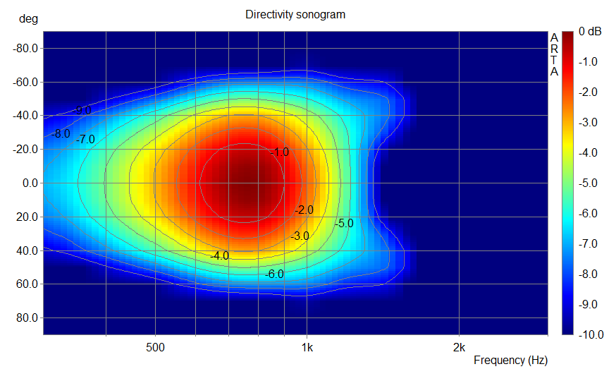

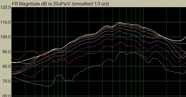

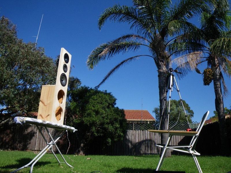

            I have measurements of L21 somewhere. The safe xo point in terms of distortion is below 800hz (F5 at 900hz-ish). More problematic is the polar response deviations between the drivers.
            Today I played around with a 3" FR (TangBand) and crossed it at 750hz to L21. While the L21 is relieved from breakup, the 3" is not attenuated enough to avoid the dipole peak at 500hz. Hence I moved the notch filter before the mid and tweeter. It works somewhat but not as smooth as single mid alone up to around 1.5khz.
            This is my old measurement of L21 on OB, taken outside with no gating. It's perfect up to 1.5khz. Crossing lower at 700, then transition to the smaller mid... which due to their better dispersion caused irregular response at around 1khz.
            No free lunch it seems

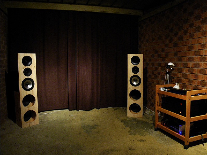

                This project is up on a slow start, but doesn't mean I haven't done anything . At the moment I'm studying the 5" P13 and why I thought there was something missing about it in my previous build .
                It turned out that there is a massive suckout at 160hz when this driver is used in OB. I've investigated whether it was due to floor reflection -- but not. Very interesting.
                I've now completed that version with 2nd order xo at 300hz and 2.1khz. It is superior compared to the seas metal cone in terms of sound cleanliness and somewhat made me think if I should continue with the 4-way and their complexity (but I will : ). I'm not a great believer in minimum component count philosophy, but I must say it felt great when the op-amps are reduced to half.

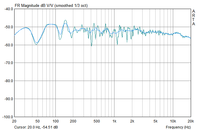

                  • Ray_D
                    • 164
                    Readable Black Background Graphs
                    5th Element
                    These are the first black background graphs that I could comfortably read. Please explain what you did so others who present these graphs can make theirs like yours. I have long been frustrated by these graphs lack of legibility. Also, a description of measurement conditions is helpful, like SPL/drive voltage and mic distance.
                    Ray
                    Edit: I see you did specify drive voltage.
                    Last edited by Ray_D; 29 September 2010, 15:22 Wednesday. Reason: I see you did specify drive voltage.

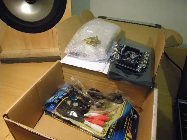

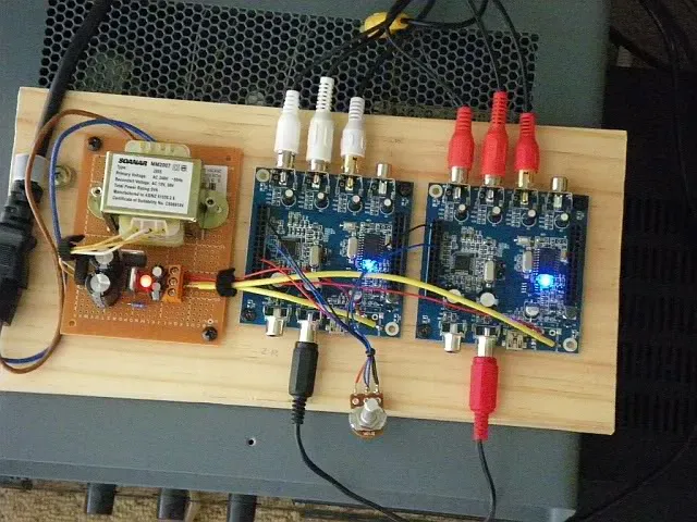

                      The boards have arrived!
                      Now we're cooking
                      Very nice package. They even includes RCA cables, USB cables, and even board mounts. The boards are even smaller than I imagined.... very nice 8)

                        XO is alive!
                        The DSP xo is up and running. I replicated the analog xo's transfer function of my current dipoles within 15 minutes or so and the result is exactly the same! Too easy 8O
                        I threw in much music the whole night to find a fault with DSP.... nothing! No distortion, no coloration.... amazing. :T
                        Implementing new design is too simple. I replicated SL's "DSS" filter within 5 minutes. Throw away your "flat" loudspeakers, I think he is right again
                              The only thing I can think of is the resolution of the graphs. I have noticed that Jed uses the same black background style graphs, taken directly from STEPS. This is exactly what I do, but whereas he seems to resize the graphs painfully small, I make them large enough that you can actually read the axis and see the traces clearly.
                              If space/bandwidth is a concern, I am sure you could save them as a gif with minimal loss of clarity.

                                Originally posted by Ray_D
                                5th Element
                                I believe it is the "Use thick pen" option in ARTA which avoids those thin lines, that easily get lost with resizing of diagrams.
                                Rudolf
                                dipolplus.de
                                  I had thought of that, but they are turned on by default, at least they were for me, and I cannot fathom why anyone would want to turn them off.

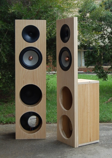

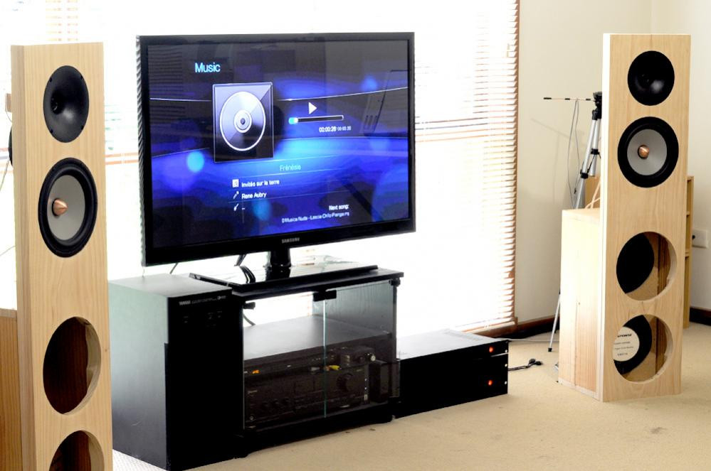

                                    Little progress ...
                                    After much procastination :Z the design changed to this
                                    Tweeter: Vifa DQ25
                                    Mid: Fountek FW146 (originally wanted ZA14 but out of stock...)
                                    Woofer: Seas L21RNXP
                                    Sub: Jaycar 10"
                                    The subs are inverted w-frame (like Orion 4) and space is available for future upgrade to better sub like 830452 or Dayton Refs.
                                    Most worrying is the small 5" mid on 30cm baffle due to polar response transition. But the ideal solution (which is buying 8" Seas W22) is too expensive for me.
                                    The tweeters are domes, due to dead-end result after much trying with waveguides.
                                    All the materials are on hand and simply just need to wait for a warmer day 8O

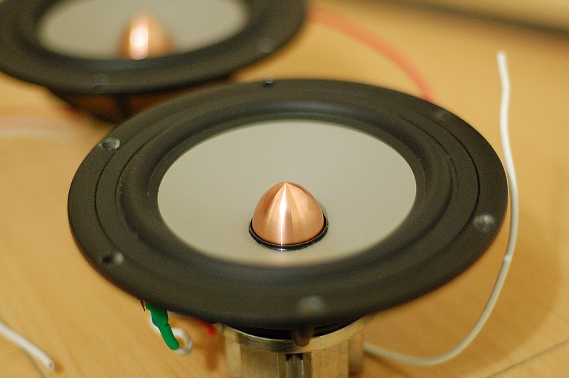

                                                  I've been 'distracted' yet again after acquiring a pair of discounted W22. Some progress were also made on the subject of tweeter directivity.
                                                  Definitely much better natural sounding than plain dome tweeters, no "splattering" of HF energy to the sides and the small dimension meant that I was able to mount a back-to-back waveguide.

                                                  So the 4-way may utilise the waveguide as well, I just first need to find out how DQ25 behaves when loaded. Definitely the throat transition is not as smooth as DX25 which I am currently using.

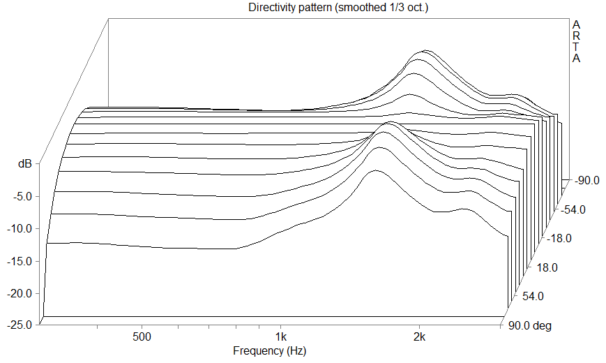

                                                    5&quot; driver on 30cm Baffle
                                                    Both distortion and frequency response of a small driver would be better than an 8". But what happens acoustically if the 5" driver is mounted as dipole on
                                                    that 30cm baffle?
                                                    Crossed at 1.5khz, here we see the first dipole null at 1khz.
                                                    For 8" driver on the same baffle, it would be around 2khz.

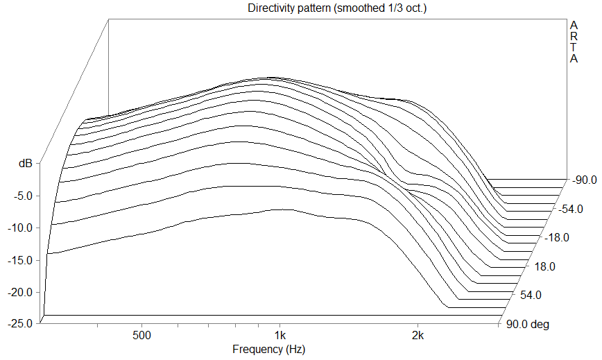

                                                    If the response is equalised to flat at 0deg, as all dipoles should, then
                                                    the response would be like this. We see "dipole bloom" which will
                                                    energise the room more at the relevant off-axis angle.
                                                    Normalised graph
                                                    Certainly this is an undesirable effect when I intend to crossover to Tweeter
                                                    at 1.5khz or 2khz. The baffle will need to be narrower on this midrange
                                                    section but then I'm not sold on the looks h:
                                                    A tradeoff to ponder as expected.

                                                        It is done 8O ... took me 2 days in blistering 38°C too
                                                        They are so clear and effortless as small mids should. I think they sound better than W22 which convinced me that 8" should not be pushed that high.
                                                        From 1m:
                                                        In any case I will post long term listening ...

                                                                    Originally posted by krips
                                                                    Does that minidsp allow you to completely taylor the FR to your liking? Or is there a limit to the amount of PEQ parameters you can set? Looks great
                                                                    Yes, the MiniDSP is used to do normal stuff like slopes, notch, etc. and more! Like Linkwitz transform. It still amazes me how spoilt we are nowadays :T
                                                                    Further I will implement cascaded filter. This is taking DSP to another level on par with correctly implemented Analog.

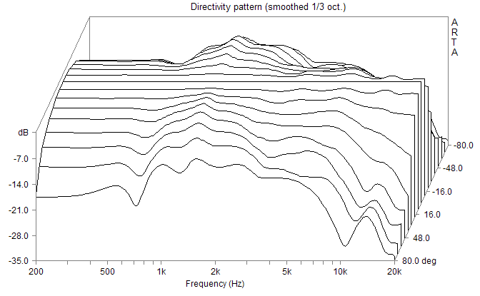

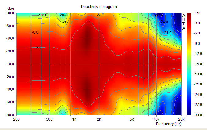

                                                                                  Indoor measurement taken. I'm not going outside in this weather
                                                                                  Both are normalised to inspect the directivity aspect. Clearly we see the small mid started to bloom as well as the loss of small horn's directivity. Yet it is quite ok with a 10deg shift through 1khz-2.5khz region. It then transition smoothly to forward radiating.

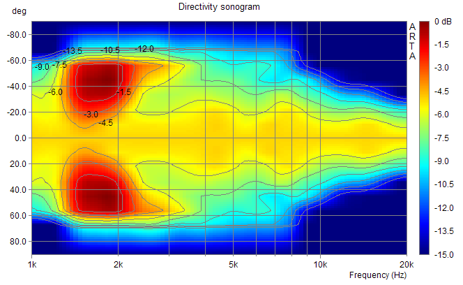

                                                                                  As comparison, this is a polar plot when the dipole uses dome tweeter.

                                                                                    Finally a good day to do outside measurement. Here I only care about the midrange frequency response of the dipole as it could not be done indoor. My previously indoor guestimate measurement was off by 150hz.
                                                                                    I'm lucky to have quite a spacious frontyard away from reflections. But I need to find a way to lift the speakers higher. The ironing board would only give me 1.8m.

                                                                                    • bbggg
                                                                                      • Jul 2008
                                                                                      • 24
                                                                                      You could try a foldout ladder, or maybe hang it round a tree branch (obviously not the palm tree).

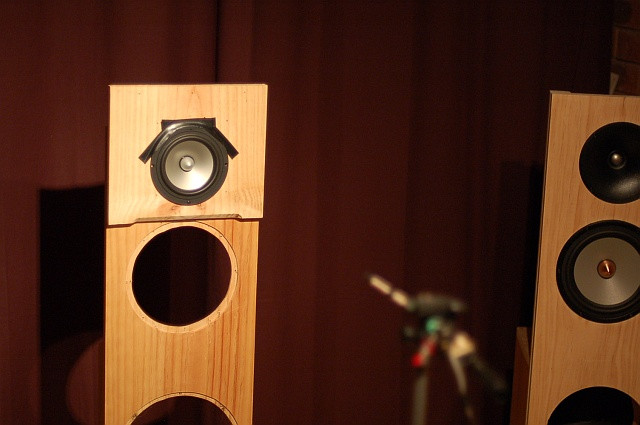

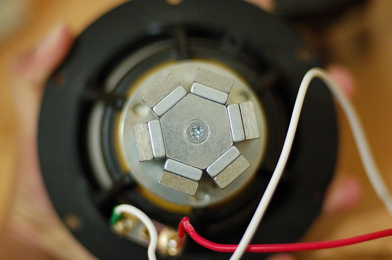

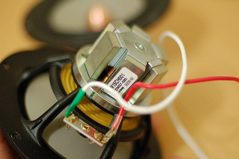

                                                                                        These just came in !
                                                                                        And they will be inserted on these

                                                                                          This is the latest iteration of this concept. S19/M for Seas Magnesium.
                                                                                          I am now convinced that 3-way is not optimal. For rigid drivers at least...
