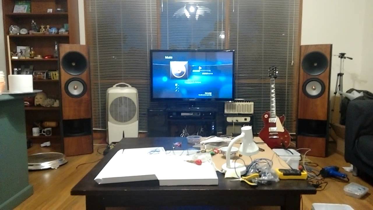

      This is the latest iteration of this concept. S19/M for Seas Magnesium.
      I am now convinced that 3-way is not optimal. For rigid drivers at least...

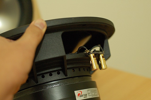

                                        Some progress on this build.
                                        First due to special price and high aussie dollar I was able to get 4 of these 10" Dayton subs.

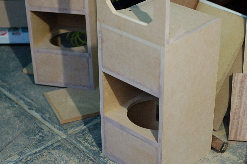

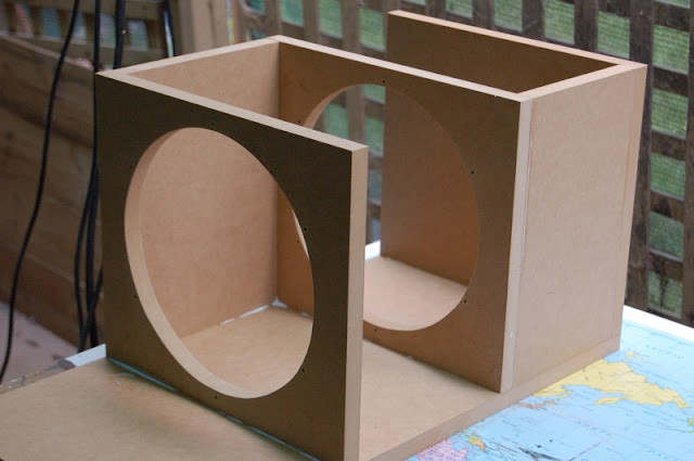

                                        They are massive and heavy and I am a bit skeptical putting them on an H-Baffle. The vibrations would be crazy!
                                        So a W-baffle is in progress !
                                        Compared to building H-baffle, the effort is considerably more difficult. There is no way doing it just by using screws, so all needed to be glued.

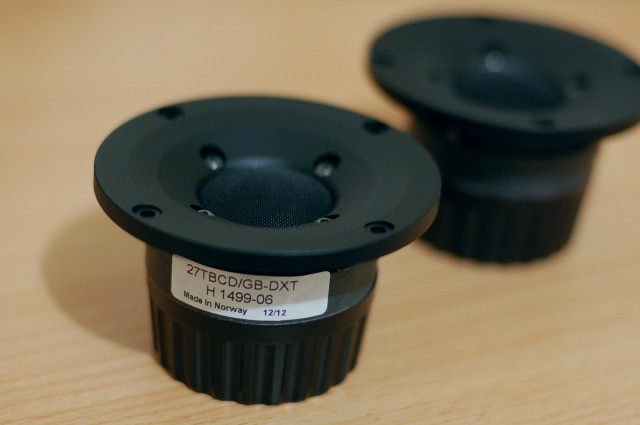

                                        Also, recently I acquired Seas DXT. I quite like them as they tick all the box:
                                        - Metal cone
                                        - no phase shield
                                        - low distortion
                                        - some directivity

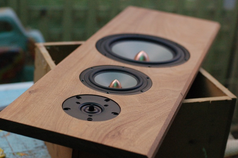

                                            It also takes the XT25, another favourite tweeter of mine. Perfect fit except different depth.

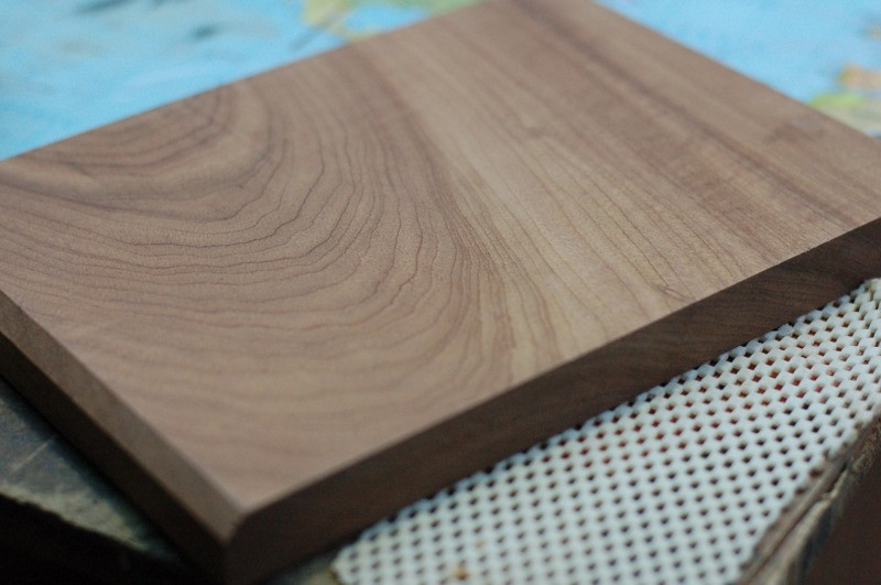

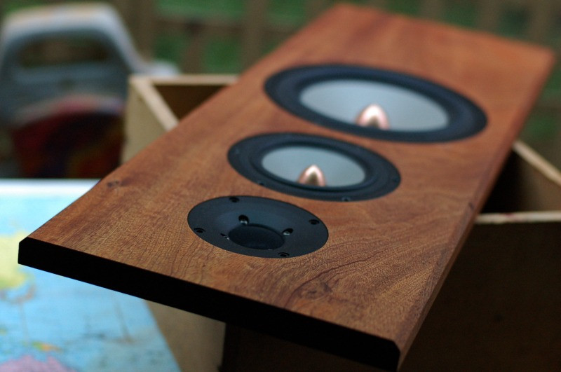

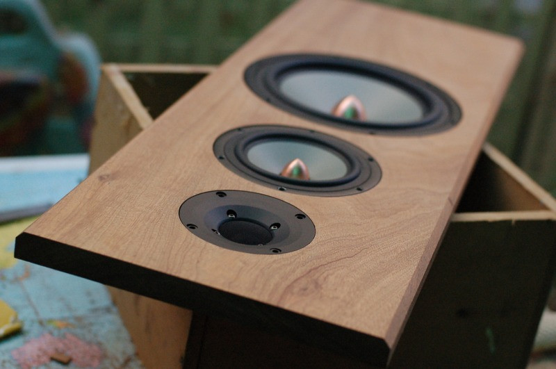

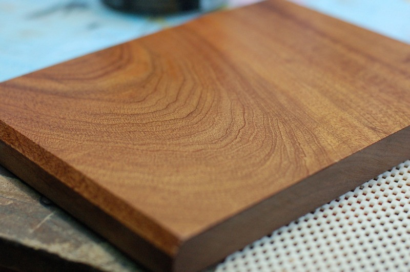

                                            I've tested the mahogany wood stain
                                            Raw:
                                            One coat of Tung Oil. Really like it!

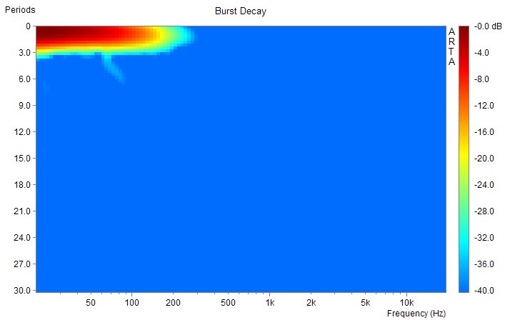

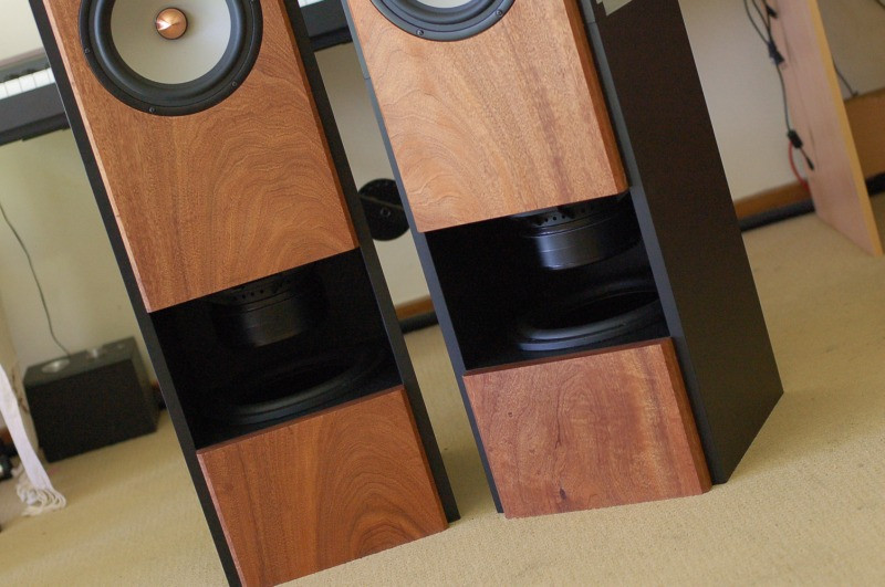

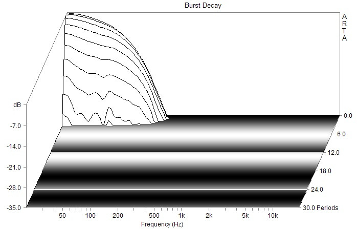

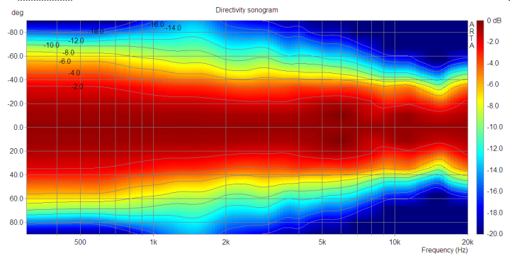

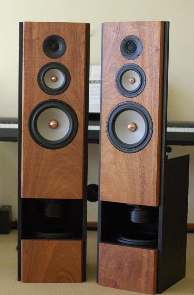

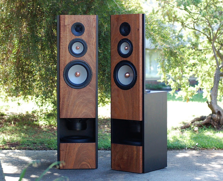

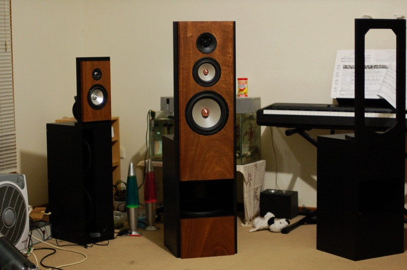

                                                                I've completed the speakers now.
                                                                Mostly pleased with the W-frame woofers. They really work, I can see the woofers pumping violently on some materials but the cabinets do not vibrate !! Magic.
                                                                Very clean even crossed at 120hz.
                                                                As usual waiting for a really nice warm day for outdoor measurements and xo fine tuning. But otherwise Spring is here and I'm looking forward for dust-free summer and plenty of motorbike !!

                                                                  The burst decay is looking really good. Also, thanks for writing the "5-Steps OB design" article. I helped me dial in the EQ from my OB speaker better since previously I had only been using indoor measurements and it wasn't as accurate and I noticed a marked improvement in the midrange sound.

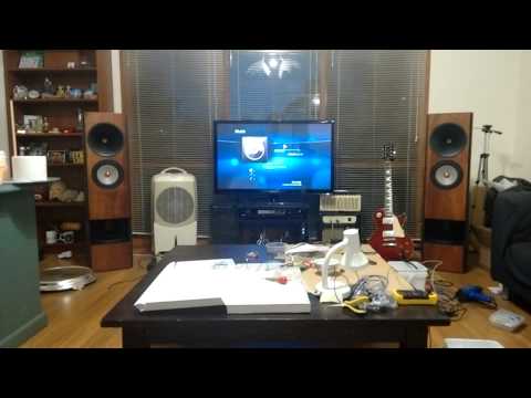

                                                                        Well it seems that these are my last loudspeakers after all. Have not built anything since! Except for the 'R16' which was for a research client.
                                                                        A video on how it sounds... somewhat
                                                                        edit: I'll post the dimensions tomorrow! Sorry for the much late replies!
                                                                        gainphile.blogspot.com

                                                                          Why did you change to the XT25 tweeter?
                                                                            Originally posted by Jonasz
                                                                            Nice speakers!
                                                                            That's exactly what I was thinking.
                                                                            • gainphile
                                                                              • Apr 2009
                                                                              • 107
                                                                              The highly-technical reason was because I only have a pair of DXT :P. I keep moving from single to dual back to back tweeters, in this case I have 2 pairs of XT25.
                                                                              I can say, though I really like the sublime smoothness of XT25 on the higher frequencies. But DXT is very clean around 1.5khz.
                                                                              Here's another video of the XT25 on acoustic guitar:
                                                                                Ah you have them back to back, that makes a lot more sense! I do love the way the XT25 sounds though so I can see why you're using it.

                                                                                      Originally posted by EdL
                                                                                      Very Fine Work...I would benefit from the dimensions for the W-frame as well. :W
                                                                                      Ok, so I went to the cold outside to get measuring tape
                                                                                      W x H x D = 31cm x 59cm x 31cm. The width of the slot is 19cm.
                                                                                      It's one of those builds which I cut as I go, to fit the subwoofers. Not sure what 'ripole' is in the previous thread but they are definitely dipoles. Like those of Linkwitz Phoenix, only smaller and vertical.
                                                                                      • gainphile
                                                                                        • Apr 2009
                                                                                        • 107
                                                                                        Yes, they 'conveniently' beam too which is appropriate for the dipole application. Although not as smooth directivity-wise as compared to the DXT.

                                                                                          Originally posted by davewantsmoore
                                                                                          Snap. I was going to ask the same q. It has a big-ish step in the coverage pattern (1->2khz) ... but depending on what the 'research' is I guess that might not matter
                                                                                          The goal was not very glorious... someone asked me to build the earlier 'S16' prototype. I thought they were crude and ugly hence the refined 'R16'.
                                                                                          The acoustic requirements was smooth & constant directivity. Hence transition from dipole to omni being near-perfect, with a caveat: forward directional only.
                                                                                          Like this:
                                                                                          I have a video :W
                                                                                          The cabinet changes caused deviations from the prototype but I think it's 'good enough'
                                                                                          Now, I have a mixed feeling about rear firing tweeter. For education perhaps I could build one with DXT as rear-firing and keeping the horn+D220Ti as forward.
                                                                                            Probably sounds better too? Haven't heard the DXT but the similar H1212 have a very annoying sound to me that I can't put the finger on. The RS28 wich I compared it to have a very relaxed sound comparatively, as do the XT25.
