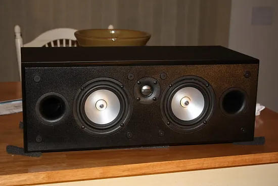

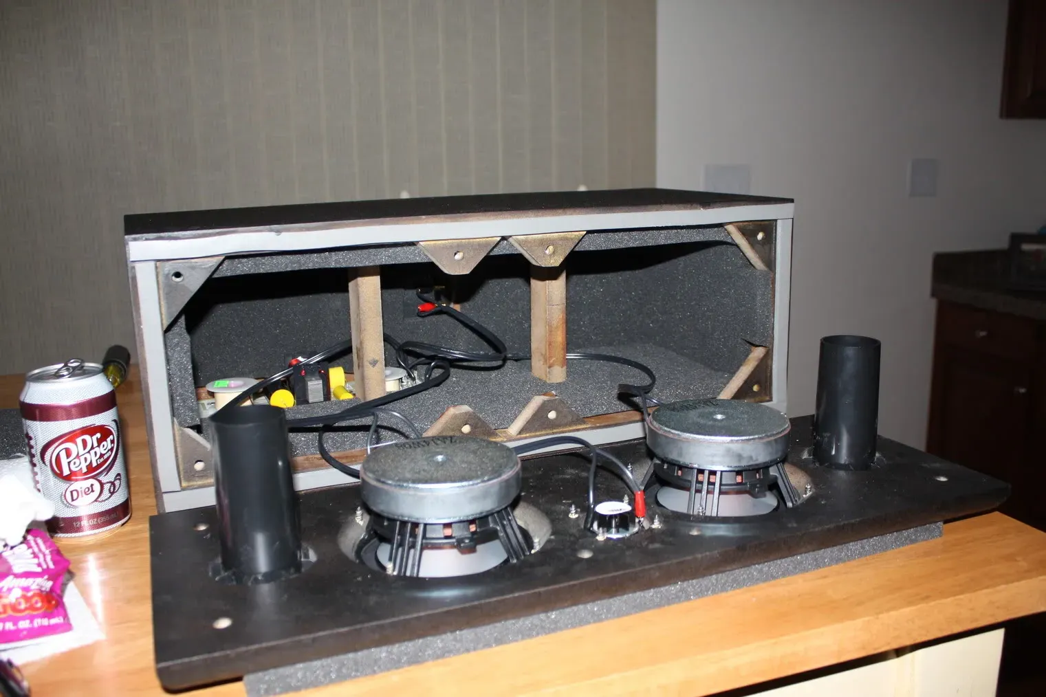

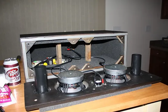

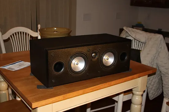

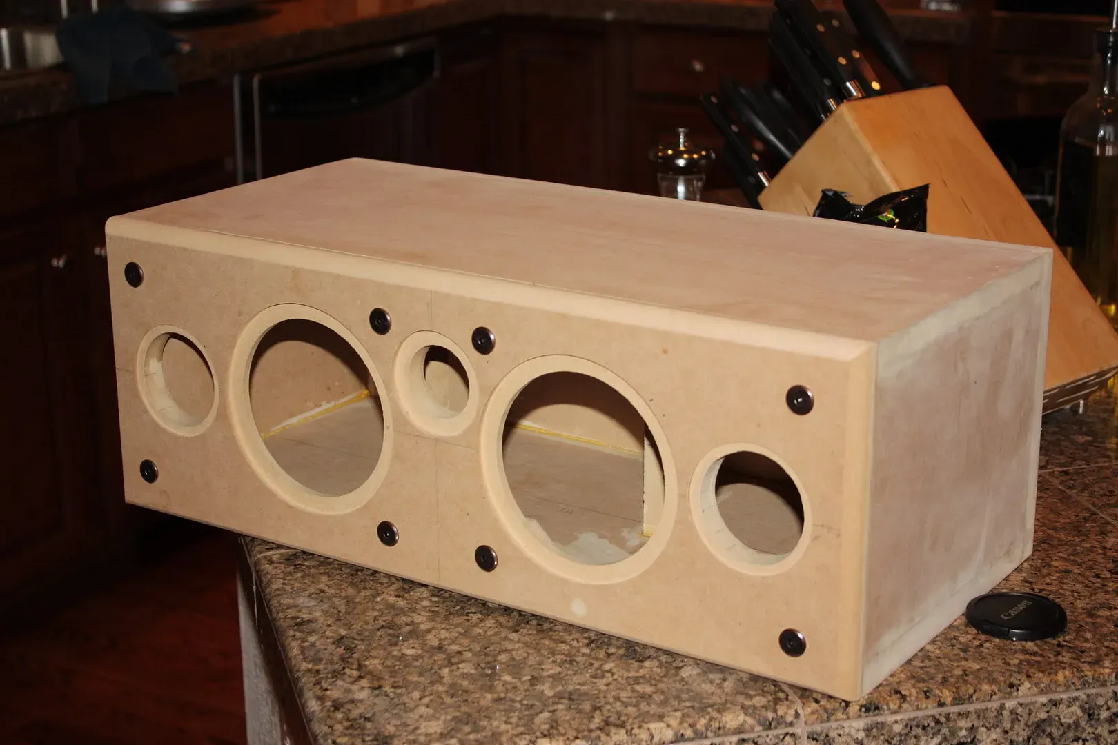

      The pictures don't do them justice, it is eerie looking at them in person cause they are so shiny it's kind of a mirror effect like you are looking through them.
      I also added some aluminum trim around the outer edge of each zaph driver, made it look a lot nicer. Polishing was done by sanding up to 2000 grit paper and then using an electric auto buffer and a Pinnacle 4 part scratch and swirl removing kit. They were then waxed with Wolfgang synthetic auto paint sealer. And I know, my listening room is cluttered, however I am in college and nothing can be done about it for now.
      edit: I forgot to mention that these are crossed with an 8" subwoofer.
      Raw mdf:
      Primed:
      Painted:
      All three:
      A few more photos can be found here:

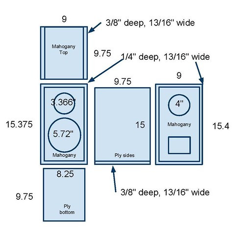

              ok... here's my plan for my panels:
              And my first cut at the steps to build plus some questions. Let me know if you have any edits.
              1. Cut ply pieces plus top mahogany piece first. Dado sides and top.
              2. Assemble the shell and glue
              3. Measure for the front and back mahogany pieces next to make sure. Cut and dado, cut holes and counter sink. (Do I cut the hole to the outer dimension minus the router bit diameter I need?)
              4. Cut strut pieces and glue in place
              5. Measure for holes in the baffle and then drill
              6. Transfer holes into strut pieces and drill through holes
              7. Install tnuts and seal
              8. Install cross members
              9. Install crossover
              10. Wire speakers, crossover, td cup
              11. Test speakers
              12. Install foam
              13. Glue rear panel (probably need to trim and round over at this point)
              14. Install drivers
              15. Install front baffle
              Last edited by theSven; 07 August 2023, 15:05 Monday. Reason: Update image location

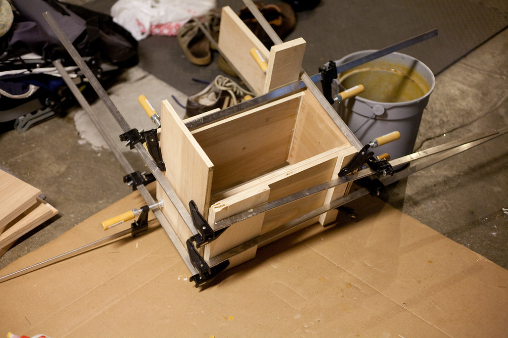

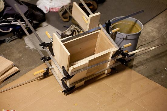

                                    Hey folks,
                                    I got my kit from Madisound yesterday. Quick question though. I understand how to wire to the speakers themselves. But there are two inputs indicated labelled high pass and low pass respectively. I think I use both in parallel... is that right? It's just the high pass and low pass labelling confused me. (Also, the kit comes with a biwire cup which makes me think I should wire in parallel.)
                                    Otherwise, I got some work done on the cabinets... the panels are all cut and rabbeted. Just have to get the holes cut for the drivers and cup, glue them in, and round over the edges. Should be close this weekend!
                                    Oh... One more question. Any problems using scrap rectangular cross section pieces for the stiffening members? The design calls for round dowels, but I thought I might as well use the scrap that I have lying around vs buying round dowels.
                                    EDIT: picture of progress so far:

                                      I got my Zaph kit yesterday also...
                                      Yes, wire the high pass and low pass in parallel.
                                      Yes, square scrap wood is fine for bracing.

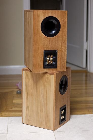

                                        • chupalt
                                          • Jan 2010
                                          • 10

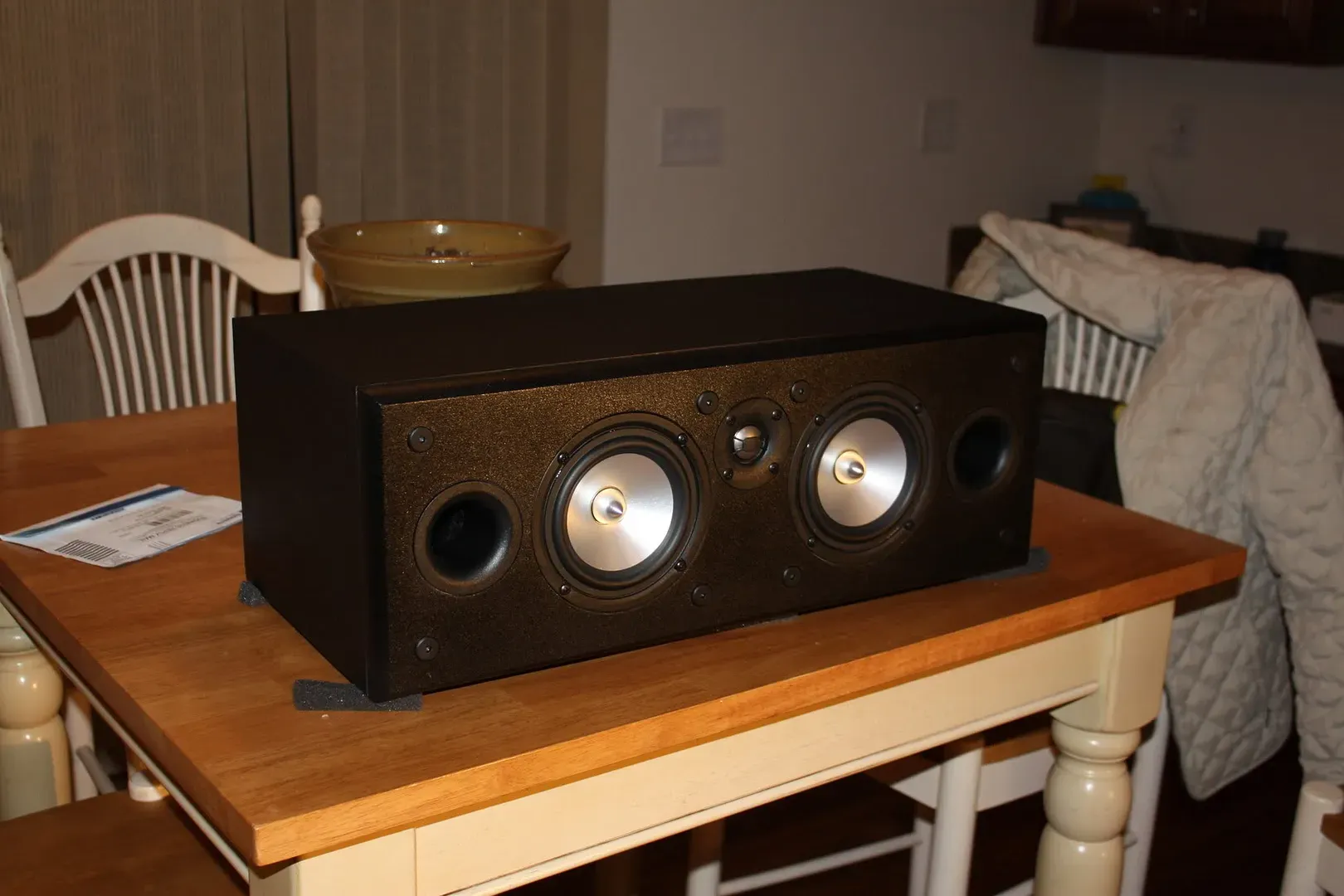

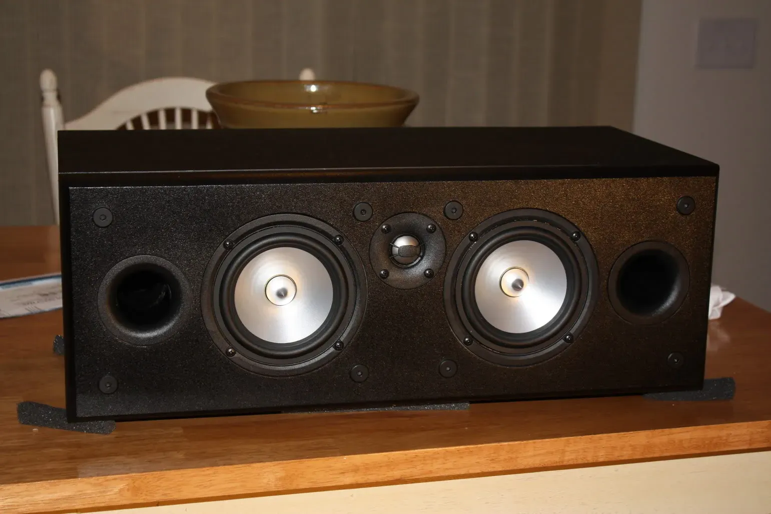

                                          Not trying to thread hijack...
                                          I finished my ZA5.3c this week and subsequently ordered a pair of ZA5.3 MTM for fronts.
                                          I have some pictures in my photo-bucket account. The finish isn't super fancy, but I'm happy with how it turned out.
                                          Click image for larger version  Name:	Speakers007.webp Views:	0 Size:	89.5 KB ID:	947098
                                          Click image for larger version  Name:	Speakers011.webp Views:	0 Size:	115.2 KB ID:	947099
                                          Click image for larger version  Name:	Speakers013.webp Views:	0 Size:	78.2 KB ID:	947100
                                          Click image for larger version  Name:	Speakers017.webp Views:	0 Size:	98.9 KB ID:	947101

                                            chupalt - looks pretty good! what was your finishing process? I might do MDF next time... this plywood/mahogany thing was kinda pricey.

                                              chupalt - those look great.
                                              oneplustwo- yes, I ordered the Zaph ZA MTM kit. I'll be picking up some hardwood for the baffles today or tomorrow. I'll be posting updates to my thread Zaph ZA in a Steel Tube after I get the wood.
                                              • chupalt
                                                • Jan 2010
                                                • 10
                                                oneplustwo - I decided to go simple and follow the method that zaph recommends for the baffles in his design mantras section.
                                                I applied 3 or 4 coats of sanding sealer, followed by 3 or 4 coats of rustoleum textured black paint, followed by a clear coat to make the dust easier to wipe off.
                                                They look surprisingly good in person and it was really simple to apply.

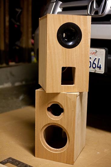

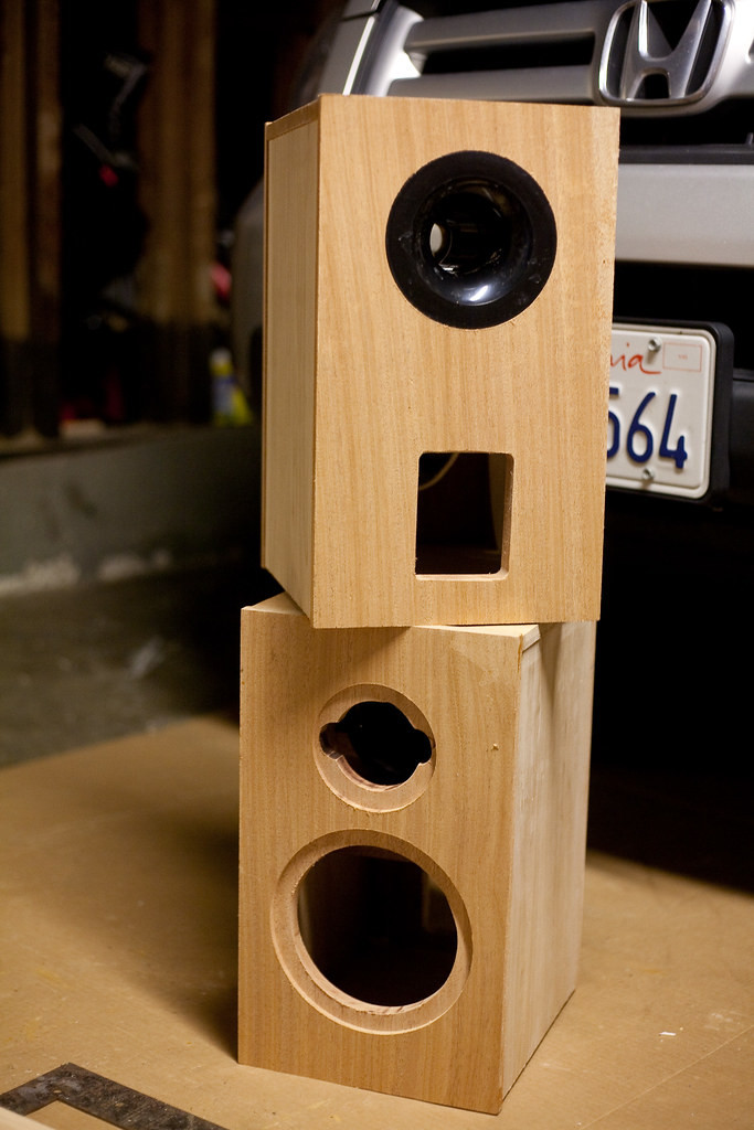

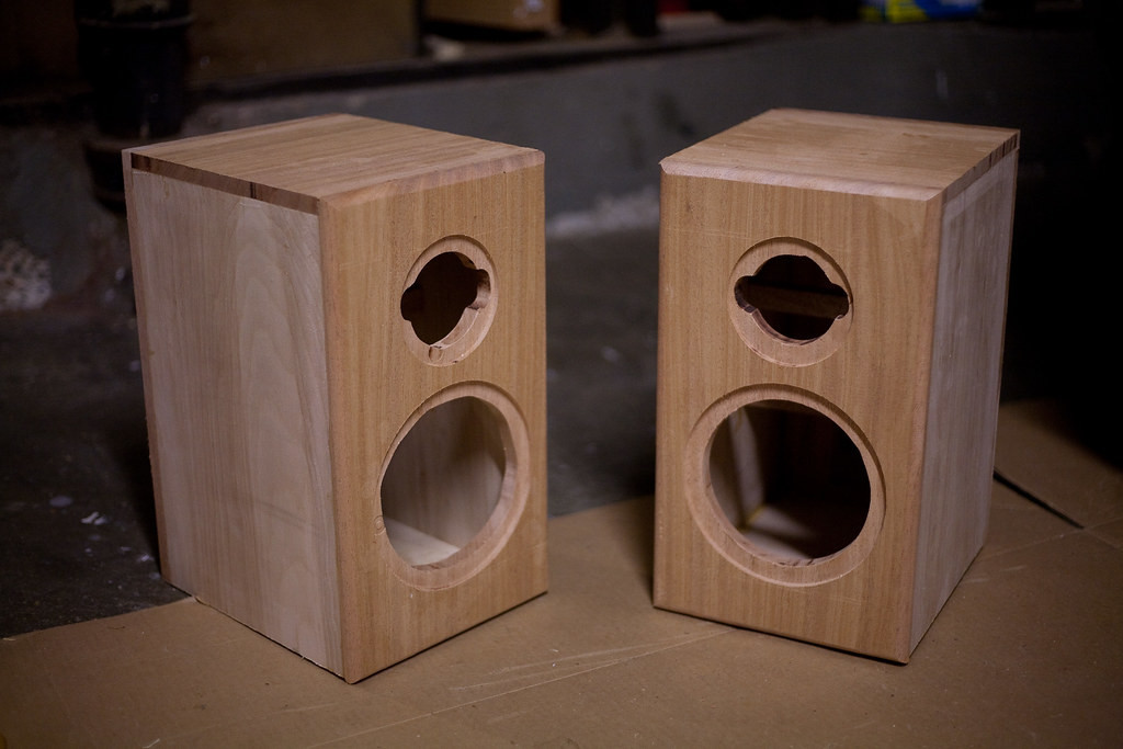

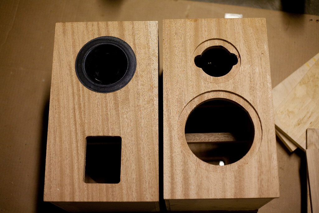

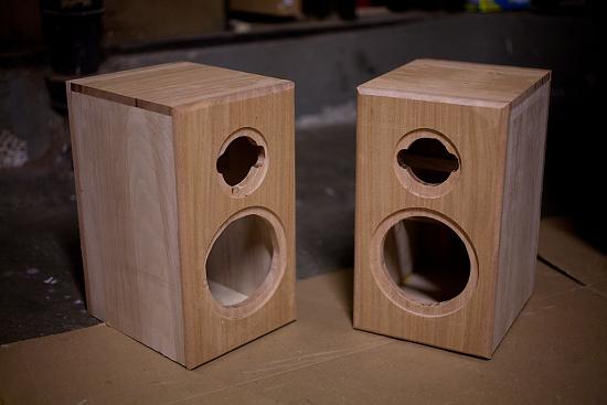

                                                  Got a little bit more done today. Made a couple small mistakes though.
                                                  1. I should have rabbeted the baffles vertically to insure flat surfaces to mate to the cases (my table saw is kinda so-so.) As it is, my glue job may have some small gaps. I'll have to take a look after I trim and roundover to see if there are indeed gaps and if so, fill in with some sawdust/wood glue.
                                                  2. My initial countersink for the woofers was a tiny bit too small. About 0.10" or so. I didn't realize this on the first one until after I cut out the thru hole. I was able to sort of kluge together the little circle I cut out back in place so I could use the jig again with some backyard engineering so that worked out ok I think.
                                                  3. I probably should have made the countersinks a little deeper. I haven't tried it yet, but I'm not sure I'm going to be able to get the drivers in flush after I put the gasket in. I figure I could always add more gasket to build up to flush if necessary.
                                                  Well, hopefully tomorrow I can get them trimmed and rounded over. Then sanded and tung oiled.

                                                  • evilskillit
                                                    • 468
                                                    Looking very good for a first speaker. As you are finding out tho, firsts are a learning experience. I'm eventually going to build new cabinets for my first project, transplant the crossover and drivers and throw the old cabinets away The Microbes deserve better. But we all have to start somewhere, and you're starting off a lot better than I did.
                                                      I've done all three of those on almost every project.
                                                      I wouldn't worry too much yet about your recesses being too shallow. The foam gasket will compress down to paper thin over time.

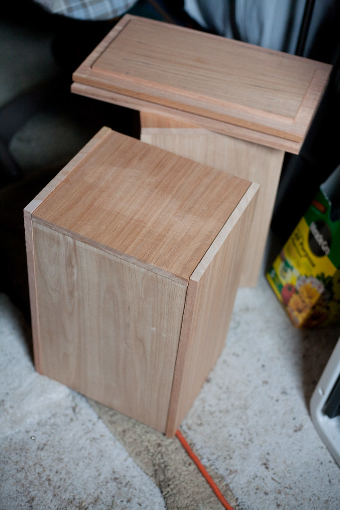

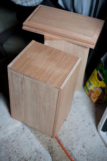

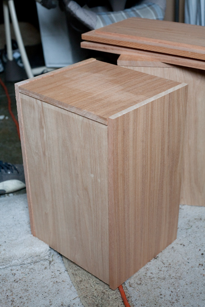

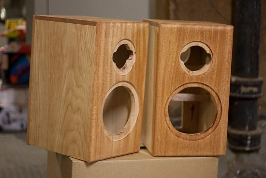

                                                          Got the edges trimmed and the front baffles rounded over. Probably repair any problems, sand, and tung oil tomorrow.
                                                          Last edited by theSven; 07 August 2023, 15:10 Monday. Reason: Update image location

                                                            I guess you answered your roundover question.
                                                            Usually, it is just the sides to ease veneering. My Khans are painted and have the top rounded over.
                                                            As for internal wiring, I've never worried about it. I have lots of slack so that I can pull the drivers in and out easily. JonMarsh goes to some extremes with wire ties to take the weight of the wire off the tab.

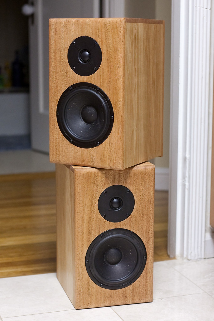

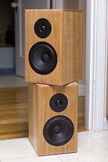

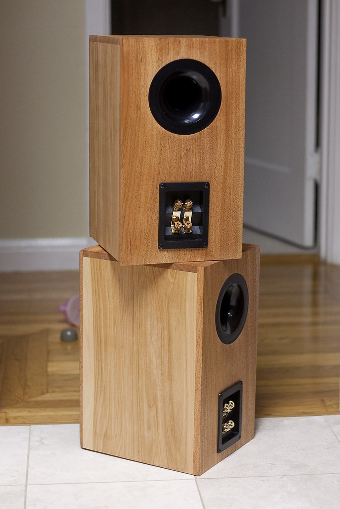

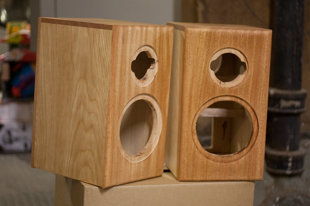

                                                              Ok... got the sanding and tung oil done. I'm pretty happy with the finish. The Mahogany turned out about as I expected. The birch turned out a little bit darker than I thought it would be.
                                                              I also got the foam in. double layer on top, single layer on sides. I think Zaph said double layer on the back too, but there seems to be so little interior space and so little area with the cup and the vent tube... another layer seemed like a bit much. So far, I just have one layer. Is that ok?
                                                              I have the wires soldered to the crossovers too. Just have to connect to the drivers for a test before mounting everything inside! Very excited!

                                                                  I got them done tonight! I ended up doubling up the rear foam. Not sure if I got the right amount of acoustistuff in there, but I think it's probably close.
                                                                  I plugged them in and they sound pretty good. Still need to get them set up properly and figure out what I'm going to do about stands. They seem a bit... I dunno, veiled? Kinda like my Sennheiser HD650 headphones sounded before I got them broken in and got good amplification. I guess I have to break these in too. Once that happens, I'll have a more thorough review. I also hope to have my DIY class A amp done soon too so that should help.
                                                                  Anyone here going to the Norcal meet? Would it be worth bringing these if I can make the trip?

                                                                    Wow, lookin good. Hrm, you might just try playing them at a bit higher volume and see how they sound too. They have full BSC so they may be a touch less sensitive than whatever you had before. If that is the case at the same point on the dial that you're used to listening they might be a bit quieter which might make them sound a bit subdued. Also I'm sure they just need a bit of breaking in. They look fantastic tho, I'm sure they will make you happy for a long time.
                                                                    • Dean100
                                                                      • Jan 2007
                                                                      • 140
                                                                      Nice work. Those are beautiful! :T
                                                                      • numberoneoppa
                                                                        • 535
                                                                        Oh, wow, those look very nice. Well done!
                                                                        -Josh
                                                                          Very nice.
                                                                          If after they've broken in a bit, if they still sound veiled try taking out a little of the Acousticstuff. Not saying you got too much or too little, but tastes vary and stuff. Placement will also have a big effect on the sound as noted above. So make sure you get that right. Parts also have tolerances.
                                                                          • oneplustwo
                                                                            • Jan 2010
                                                                            • 666
                                                                            Thanks for the comments! I think they look pretty decent if I don't get too close and see the little mistakes that probably I would be able to see at first glance.
                                                                            I think they may be a little less sensitive than my current speakers. Also, I didn't finish them till about midnight so I couldn't really crank them up. I'll continue to break them in and get them setup better today sometime.
                                                                            Question about feet... if I put these on speaker stands, do they need spiked feet? Or just rubber feet? No feet? Not sure what the thinking is on that.
