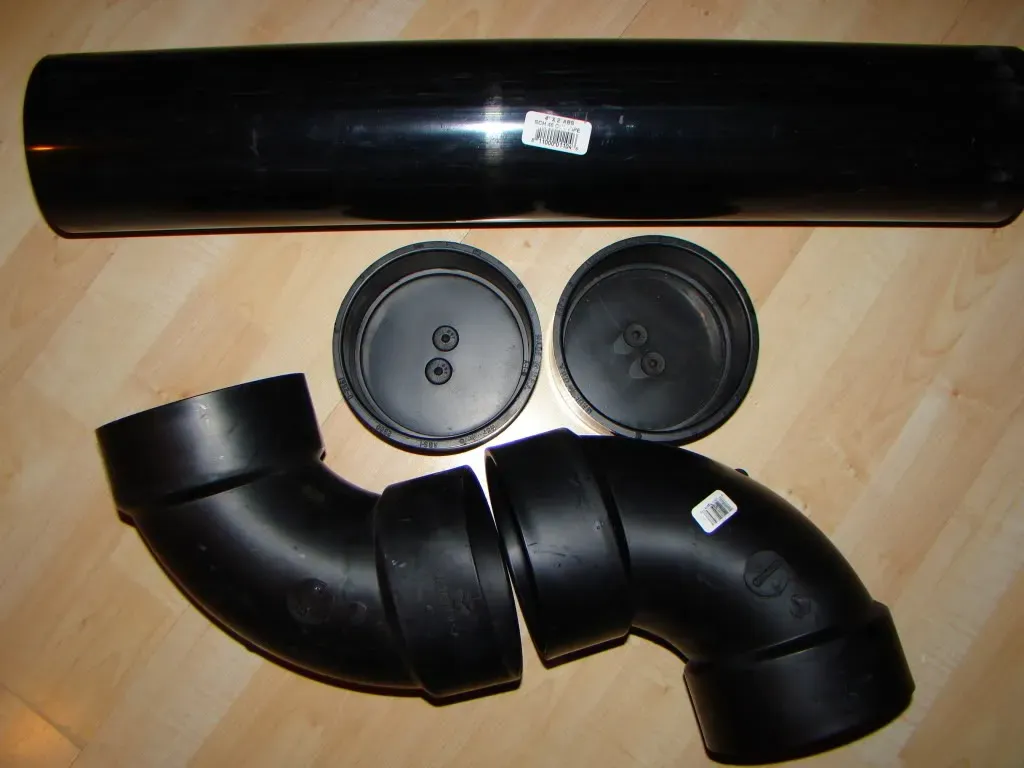

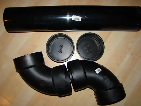

          So I stopped by Homedepot today to check out their pvc pipe section. I picked up 1 4" x 2' of pvc, 2 4" caps, and 2 4" 90 deg elbow. The elbow measured ~11.5" long. with 1.93 ft^3 w 4" elbow bend would put me around 35hz. If I just use the straight pipe w/9" would put me at 38 hz. I would hope I'll be happy at 38hz.
          Curt, would I need to flare both ends of the sub or just flare the outside?

            Ok, so I got the pipe cut to 10", and not sure if i want the port on the back panel or the front panel yet. Any one have pics of the port on the front?

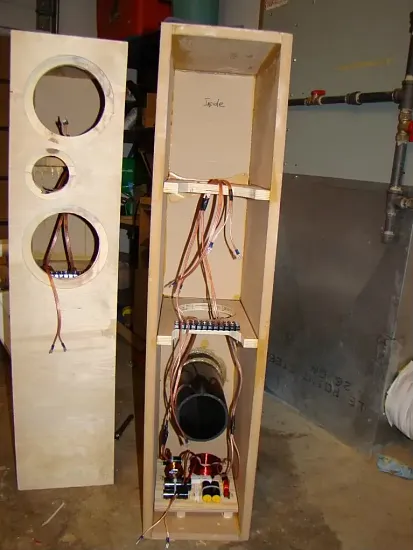

              Built one crossover last night, all bracing installed to cabinet, and my camera went out of battery.. :-)

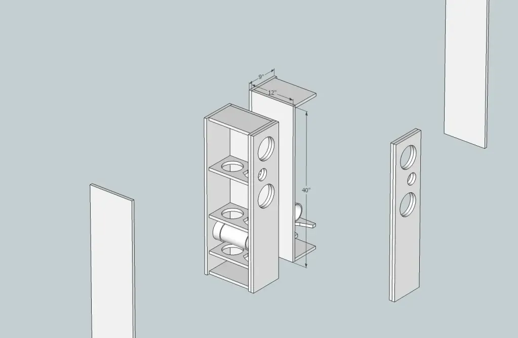

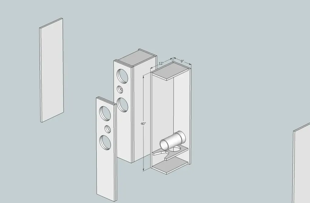

                        Actually I was looking for general schematics (or drawings) for the Nat P towers in general but after doing a page by page search I ended up finding one. Looks like the height of the towers is about 42" standard? I think I am going to build the version with the bottom port and then build them up via stand base/legs as rule of thumb (I thought is that Tweeter height should be at ear level) and the 42" would put them at about chin level for both me and the wife...Thanks for the help though and I may take you up on that .cam file in the future ;x(
                        • bbcmp1979
                          • Dec 2009
                          • 173
                          Greg, the baffle drawing is on https://www.htguide.com/forum/showth...t=13969&page=1 . I kept the same baffle width, i raised my towers to 40" high and 12" deep. I would of course have to build a set of stands to raise it a bit after they are completed. Here are two sketchups I just made

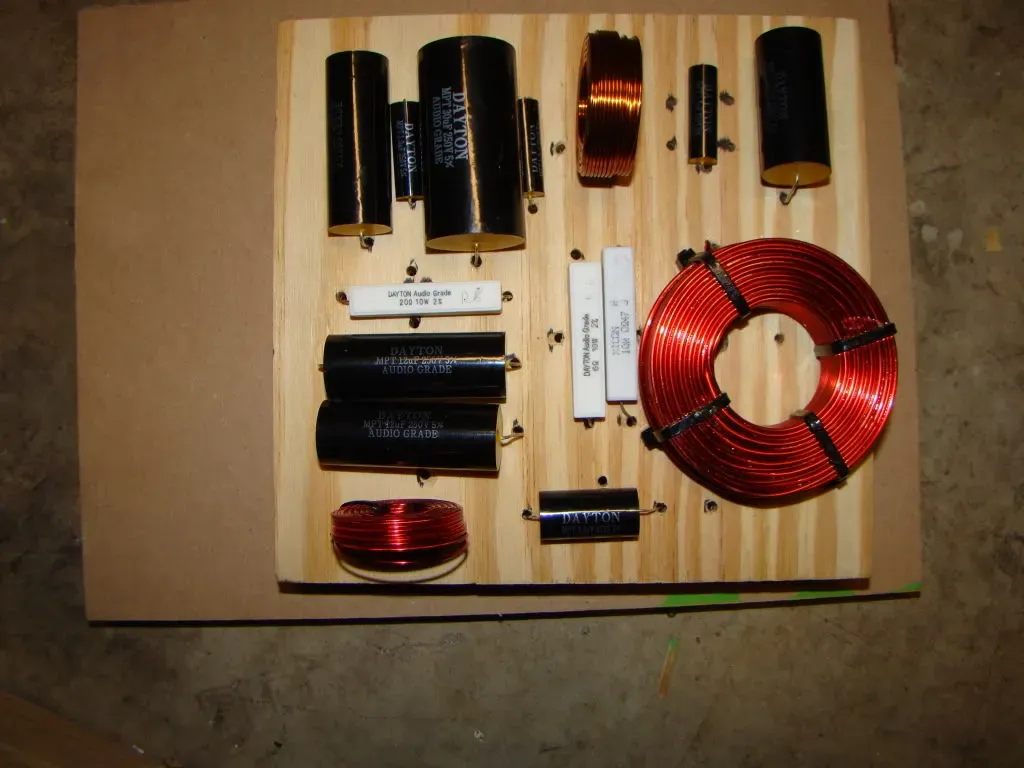

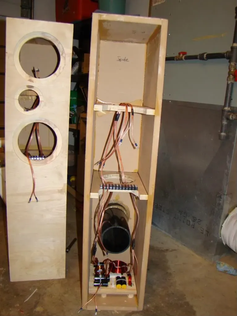

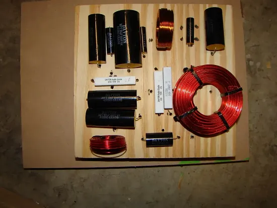

                          could some one please check to see if the inductors are ok?
                            The inductor placement looks good.
                            IMHO, wiring the crossover on the underside looks good, but it makes it harder to mount on the side of the box.
                                    Click image for larger version  Name:	DSC00928.webp Views:	0 Size:	52.0 KB ID:	942994
                                    Looks good. What are your plans for the stands?

                                            Crossover mounted and wires routed (sorta). Should have moved the port up higher so I can have a removable crossover.

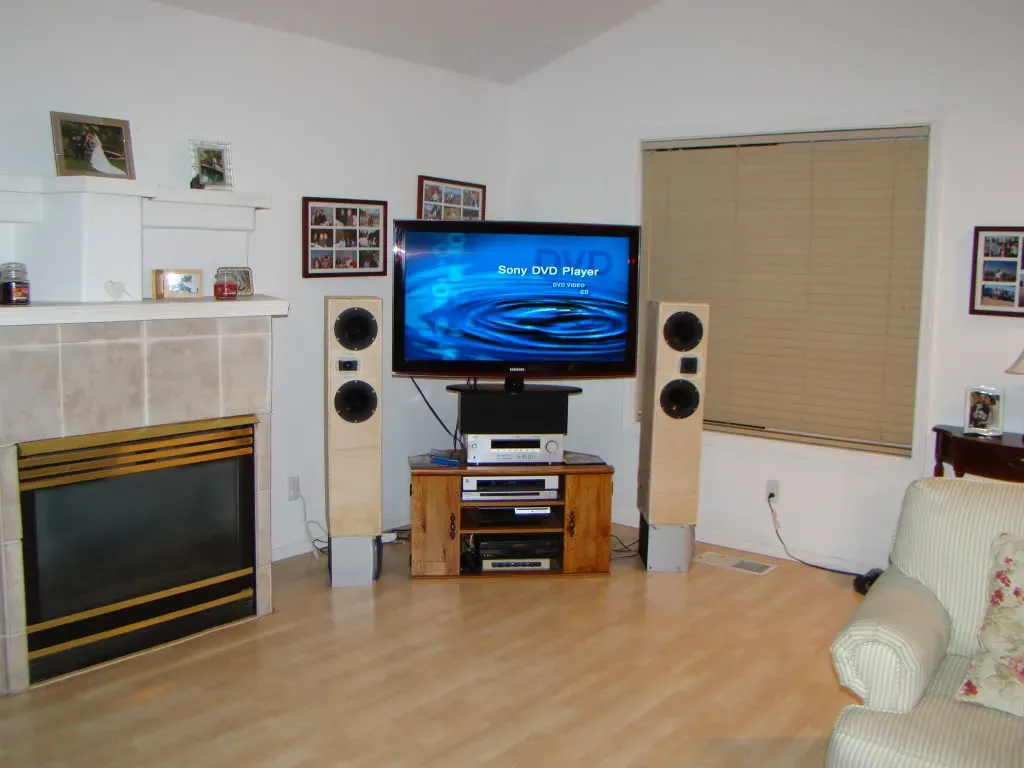

                                                        • bbcmp1979
                                                          • Dec 2009
                                                          • 173

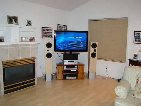

                                                          I took a pic of the natalie sitting in the living room. Need some finishing touches... Now If I can find a painter.

                                                          • evilskillit
                                                            • 468
                                                            Looks pretty sharp. Will come together nicely with some paint.
                                                            The tape over the tweeter flanges really threw me off. At first I thought those were just 2 random tweeters slapped into the cabinet, then I looked at your parts pictures, and closer ant the built pictures and figured it out.
                                                            • numberoneoppa
                                                              • 535
                                                              Haha, yeah, what's with the tape? Took me a second to figure out what the heck you were doing, too. Anyways, they look great. Is it me or did you not even bother blowing off the dust before bringing them into the house? Yes, excitement can get the best of us sometimes.

                                                                I'm using the hurricane nuts for Rs180 and screws for the tweets. The tape hold the tweets temporarily for testing. I don't want to install and remove screws too many time on the tweets. They won't bite after a few removals.
                                                                • numberoneoppa
                                                                  • 535
                                                                  Oh, I see. I used t-nuts with hex-cap bolts for my tweeters. I don't think I'll ever used screws just for the issue that you pointed out.
                                                                  So... how do they sound? Hopefully better than those plastic speakers that you're using as stands in the background. :P

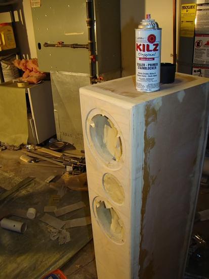

                                                                          I started primering one of the natalie last night. Ohh, the long treaded process of primer, sand, primer, sand, primer, sand, more primer, and sand.....
                                                                          I did 3 coats of primer already, hopefully just one more coat to smooth it out a little bit more and I can start the next cabinet.

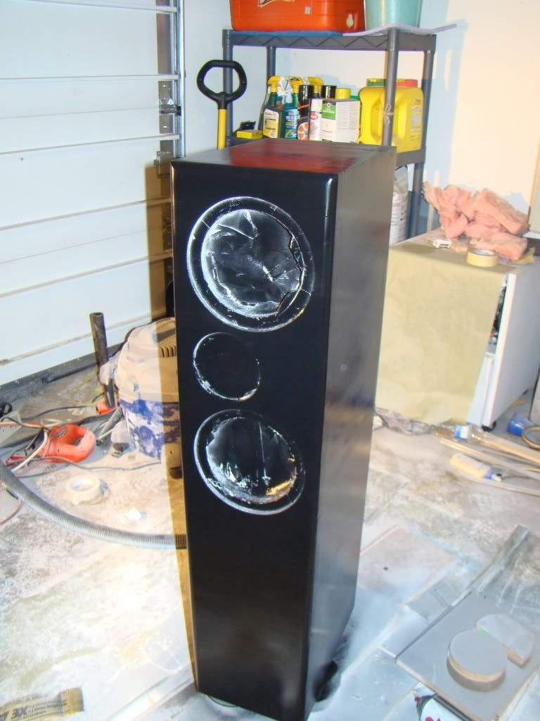

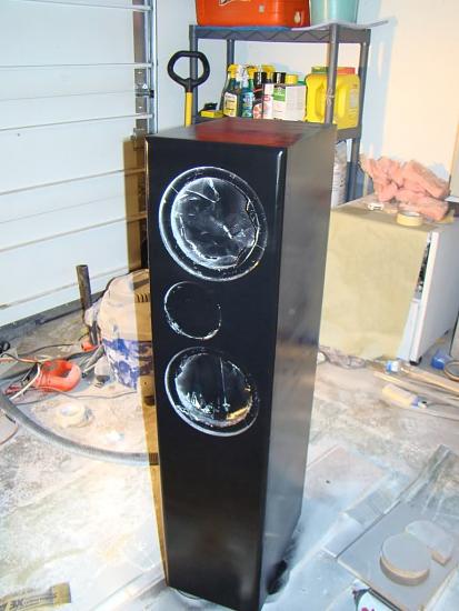

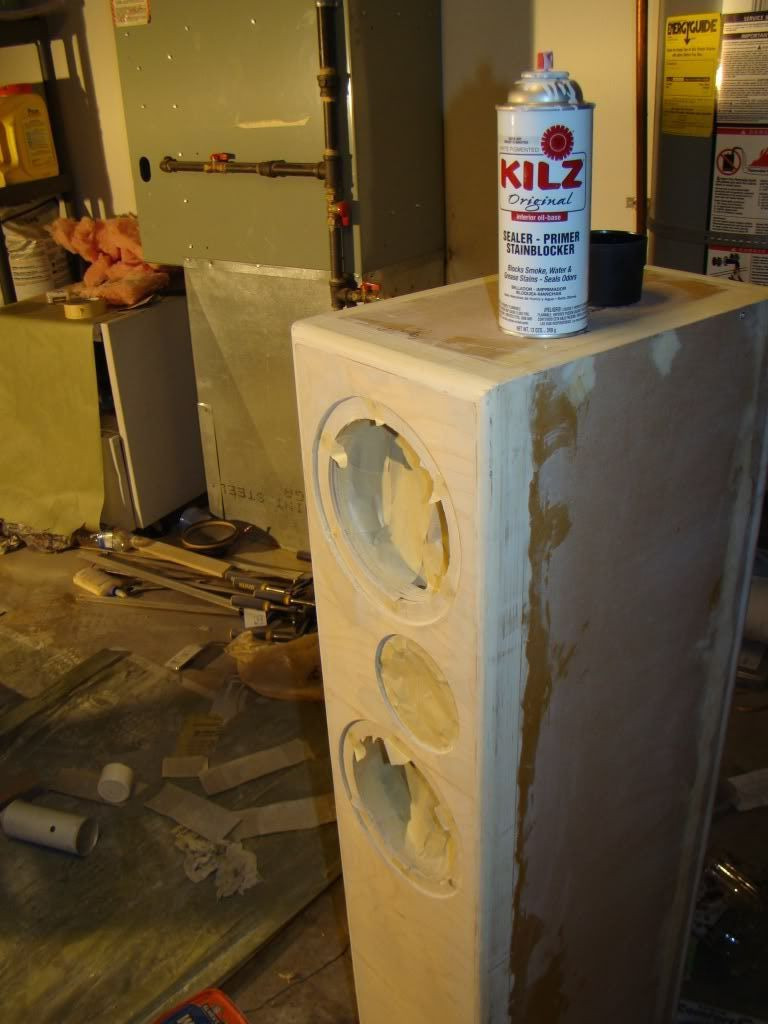

                                                                                      • bbcmp1979
                                                                                        • Dec 2009
                                                                                        • 173
                                                                                        lease do not mind the dusty floor. This is after 4 coats of primer and sanding in between coats.
                                                                                        After 3 coats of Semigloss black, it might be too glossy sitting next to the TV. I might have to repaint it with flat black. I have a buddy coming over tomorrow so there probably won't be any work done to it til saturday (sanding the first 3 coats).
                                                                                        Second one almost ready for primer.

                                                                                          Hard to tell from the pics but they're looking pretty good to me. How long do you wait before sanding with that particular spray primer? Do you wet or dry sand?
                                                                                          -Josh
                                                                                          • bbcmp1979
                                                                                            • Dec 2009
                                                                                            • 173
                                                                                            about 30 minutes then I applied another coat. I was going to use a paint brush but that would probably make it look really rough. I had a bad experience with paint brush a few years back.
