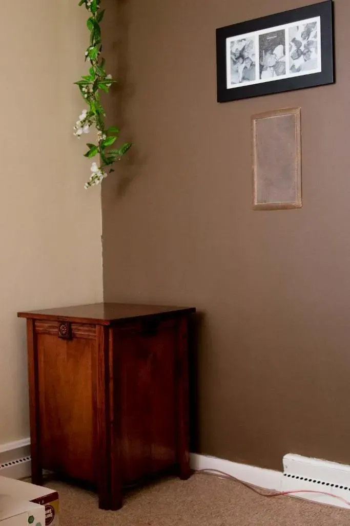

                    I too doubt that any tweeter could get the ideal response in the 15-20khz range... I am using a .75" dome vs a 1" dome. This should help top end dispersion somewhat. I am guessing that the environment will change the wave considerably. The two 4 ohm tweeters will be wired in series with a variable l-pad in the middle.
                    WHen I build, I will measure. I have a couple of different test environments that could produce measurements for your question.

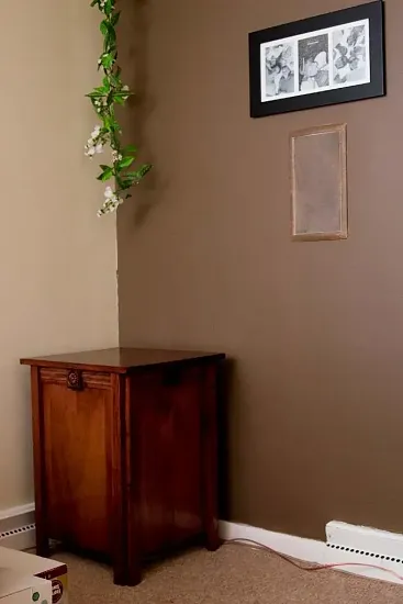

                    1. Basement = concrete floor, 3 walls have exposed insulation with a 2'x4'x1.5' pack of rockwool 60. It is quite dead.
                    2. Living room. 14',24',8' All walls are painted plaster. The room no longer has sound panels...

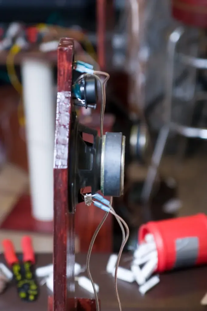

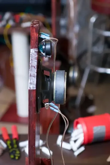

                        You may need to explain the tweeter depth settings to me.

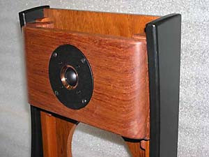

                        I am planning on mounting the rear tweeter on a separate .5" board with a .5" standoff between the main baffle and the rear tweeter board.
                        My design will be similar to the Orion++
                        Click image for larger version  Name:	RearTweeter.jpg Views:	0 Size:	23.1 KB ID:	947410

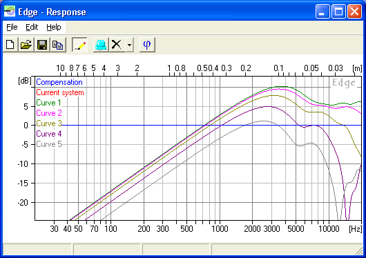

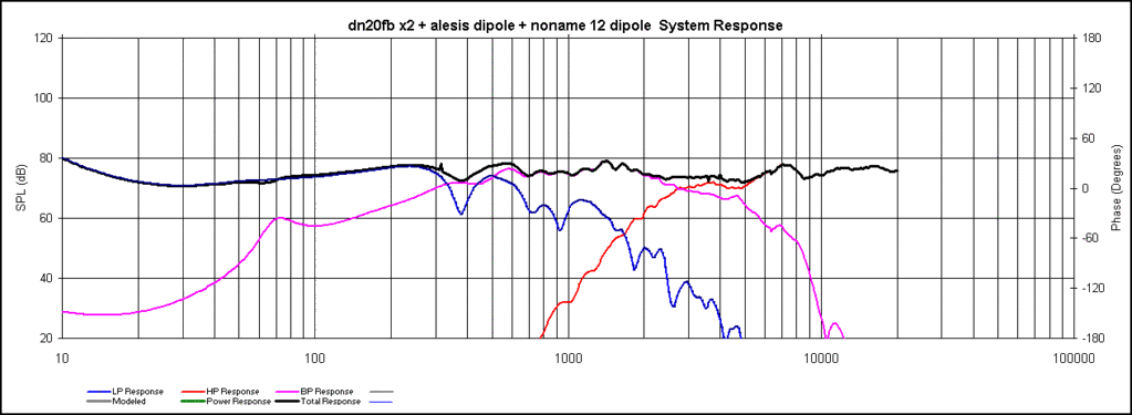

                              Would you care to comment/speculate on using a CD waveguide on the (front) tweeter? Assuming perfect drivers/design, could this be used to create a front radiation pattern that approaches your ideal simulation? The rear radiation would be completely blown, of course, but it seems to me that the front 180 degrees should have an even polar response up to a higher frequency (essentially, where the response narrows beyond the waveguide angle), above which it should fall with increasing off-axis angle.
                              Is it more important to keep the off-axis curves flat? Or to prevent them from crossing each other?

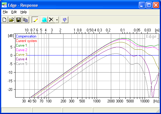

                                FWIW, here's what The Edge predicts for a B&G Neo3 hanging in space -- no baffle other than the metal frame. 0, 15, 30, 45, 60 approximated by dragging the mic to the side. It looks pretty usable to me.
                                Last edited by theSven; 12 August 2023, 10:18 Saturday. Reason: Update image location
                                • AJINFLA
                                  • 682
                                  The front is more like 1/2 a sphere, not just 2D 180 degrees. It is possible to get uniform horizontal response with a multi driver WG setup but due to piston source directionality, non-ideal unless you use narrow bandwidths and carefully shaped baffles.

                                    • Rudolf
                                      • 97
                                      Dennis,
                                      you caught me in the act. ops: The Neo3 looks pretty useable to me too. I did not realise it has such a good ratio of radiating area to "baffle" size. May be I was to fixed to ribbons when I claimed that planars would be bad OB tweeters. Thanks for correcting me.

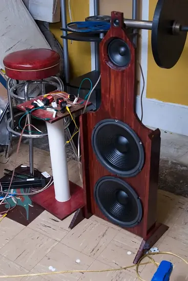

                                            Project update:
                                            I just purchased the Jasper Jig. The cutting went very smoothly. Pictures to come soon.
                                            I restructured the top part of the baffle so the tweeter area is 2" wide and about 3" tall.

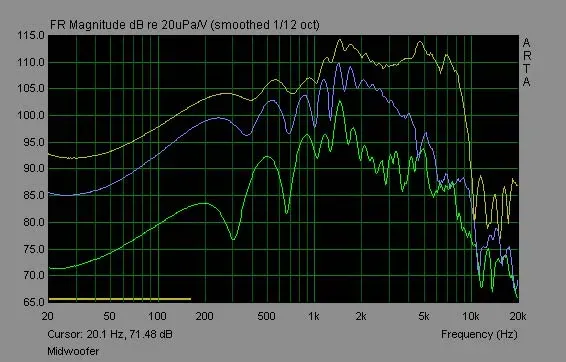

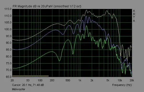

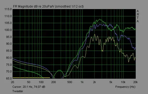

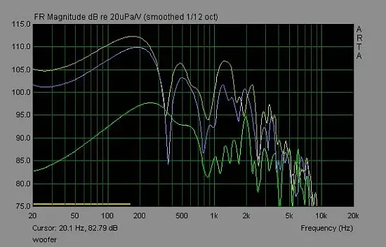

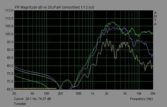

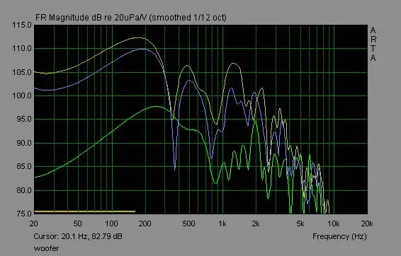

                                                  Here are a few graphs. o, 45, 90 degrees for each unfiltered component.
                                                  Last edited by theSven; 12 August 2023, 10:19 Saturday. Reason: Update image location

                                                  • Rudolf
                                                    • 97
                                                    Brian,
                                                    those graphs look really good to me. I am sure you could take the system as it is (with added crossovers of course) and have a nice dipole speaker.
                                                    Just two places where you could get even better:
                                                    First: Every cm you can cut off the tweeter baffle or back-to back distance will improve the tweeter graph further. But I don´t know at all if it will make a difference for the ear at all. When equalising the tweeter response I would concentrate on the 15° angle, definitely not on 0°.
                                                    Second: The 90° response of the midwoofer indicates that you have a 1.5 kHz peak at the rear response. I had very good results fighting such a peak by changing the driver mounting position on the baffle. I see that you haven´t chamfered the midwoofer hole yet. Possibly this might cure the peak already. If not, you may try more radical approaches.
                                                    The following graphs should illustrate what I mean. All measurements at 30 cm distance from the dust cap. First a 3" fullrange driver in free air:
                                                    You can see that the 0° and 180° response are quite different.
                                                    Next the driver is mounted in the conventional way on a 15 cm wide baffle:
                                                    You see what happened.
                                                    Only when I mounted the driver to the back of a baffle, the 180° response became acceptable:
                                                    I don´t think that the same cure is applicable to all drivers, but you´ve got the picture.

                                                    • brianpowers27
                                                      • Feb 2009
                                                      • 221
                                                      What does the front of the baffle look like? Did you chamfer the opening?
                                                      I will have to rethink the tweeter mounting. I have already broke one tweeter from bending the terminals. The terminals stick straight out... I need to find a low profile connection.
                                                      Also, what do you mean when you say this?
                                                      When equalizing the tweeter response I would concentrate on the 15° angle, definitely not on 0°.

                                                          • Rudolf
                                                            • 97
                                                            Above measurement was on a thin (3 mm) masonite baffle. Mounting the driver on a 16 mm thick baffle from the backside and chamfering the opening 45° took off the 2 kHz peak too:

                                                              • Rudolf
                                                                • 97
                                                                So in theory I would be equalizing just the tweeter this way, while attempting to design the xo for the other parts based upon on axis measurements.
                                                                Yes. Thats the beauty of the narrow baffle approach: As long as you stay below the first dipole peak, most dips and peaks in the response will be at fixed frequencies, regardless of off-axis angle. If you EQ on axis, it will help to EQ off-axis too.
                                                                Only if you have to EQ above the first dipole peak, dips and peaks will change their frequency depending on off-axis angle. You see it in your tweeter response above 4 kHz. Equalising for 0° will make the response at 45° worse and vice versa.

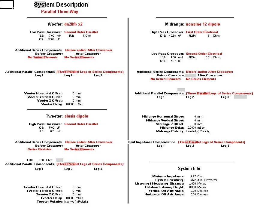

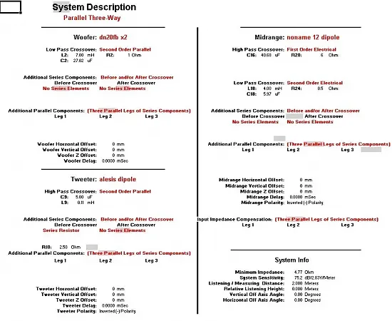

                                                                  I just ordered a 1" cutting surface chamfer bit. I will have to wait until this bit comes in before doing any more measuring. I plan on trying the rear mounting for the mid and chamfering the front as pictured in Rudolf's post.
                                                                  I ran some basic simulations on Sunday. I had to pad the mid and tweet a good bit to match with the woofer. I also found that a BSC circuit helped to get solid response in the low end.
                                                                  I am likely to build the final project with .75" pine boards. I found 16" boards for a resonable price. I have a nice cherry finish that I have been using lately. It is the same one in the following picture.
                                                                  Last edited by theSven; 12 August 2023, 10:20 Saturday. Reason: Update image location

                                                                    I am listening to the maiden flight of the finished cabs. So far the simulation is working out well. More details to come. :T
                                                                    --My Speaker building pages http://sites.google.com/site/brianpowers27speakers/
                                                                    --Get yourself on this forum member map! This can help everyone find fellow DIYers in the area.
                                                                    --The Speaker DIY resource Database
                                                                    • brianpowers27
                                                                      • Feb 2009
                                                                      • 221

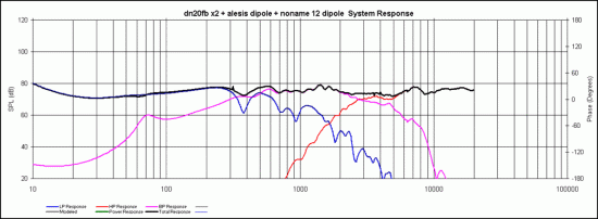

                                                                      More data...
                                                                      Last edited by theSven; 12 August 2023, 10:21 Saturday. Reason: Update image location
                                                                      • brianpowers27
                                                                        • Feb 2009
                                                                        • 221
                                                                        I have gone through a few xo modifications. THe most notable problem was the bass boom between 100-300hz. I remedied this by altering the midrange rolloff and I am awaiting a 3.6mh coil for the woofer.
                                                                        Note: I am going to need to alter the baffle/wings/feet in order to reduce a few of the buzzes I hear. Part of the buzz comes from the wires slapping against the cabinet. Part comes from the driver frame buzzing against the chassis. Part comes from the speaker minutely "walking accross the floor". I will likely add foamies underneath the legs and gasket tape between the baffle and the drivers. I may even consider somehow adding mass between the baffle and the floor... (Hmmm.)

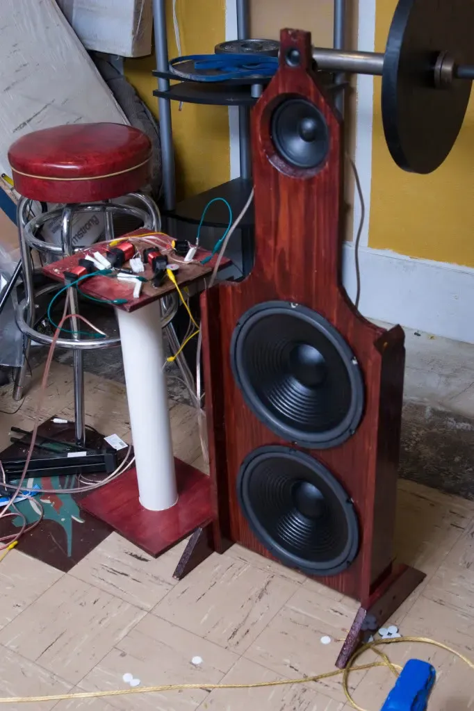

                                                                          The pics I promised...
