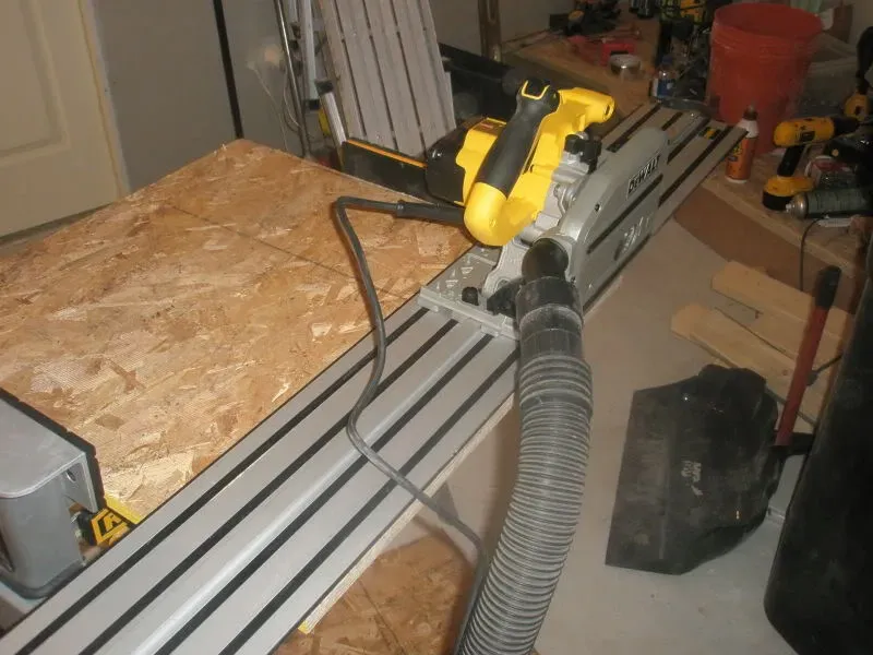

                                                            I use this guy to square up the first piece then good to go with the table saw. Not that this project mattered if it was square square but really does make nice cuts and bevels
                                                            long track
                                                            Short track
