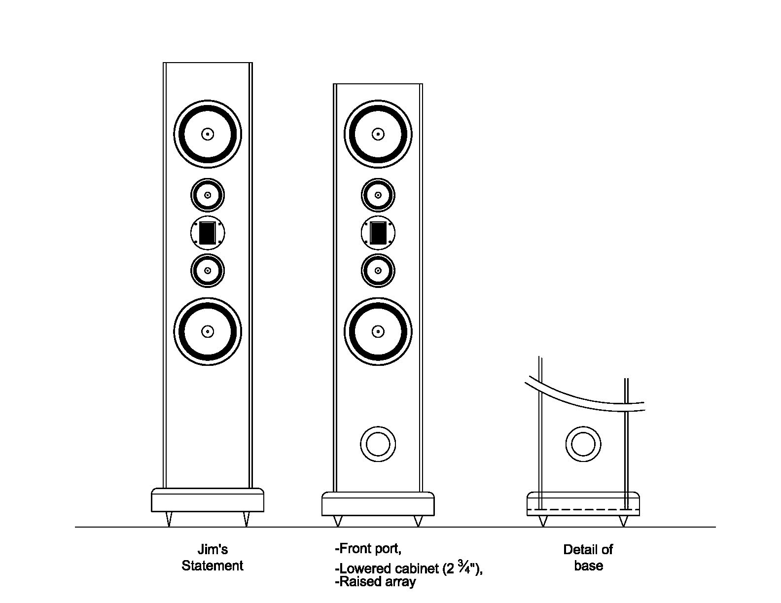

                        I have attached a jpg to illustrate the cabinet changes I propose to make. Nothing radical have a look and tell me what you think. The port can go front or back but I don't know if port noise would be a factor in front. The cabinet is lowered 2.75" (significant) but still 55" in length. The cabinet rests on a single sheet of mdf (or other mat'l) with the feet directly beneath. The upper base section is faux and TBD. The array was moved up to maintain the tweeter height at 38".
                        John...

                          Looks fine. I would suggest a rear port. :T

                            Great! I will begin by making a new layout to correspond with the new position of the array and a rear port. I can't see putting saw to wood until the temp changes a bit. We're expecting a deep freeze later this week and the garage ("shop") is not heated. Hopefully before the end of Jan I'll be able to start cutting.

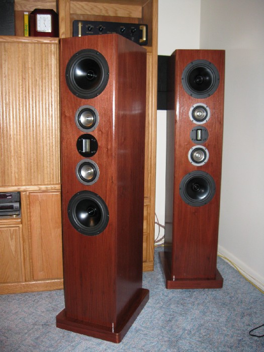

                                                                            Statement Build Finished!
                                                                            Hello All,
                                                                            I have finished building the Statement loud speakers this weekend!
                                                                            You can see most of the pictures I took posted at: https://www.htguide.com/forum/specia...tatement-build
                                                                            Overall the build went reasonably well with the typical unexpected hitches which one learns as he goes. I think they look great. They are burning in as I write and I will post my initial reaction and setup issues in short order. I just wanted to get this out here tonight before the busy week begins. If any one has any questions don't hesitate to ask. Enjoy the pictures, I hope the link works.
                                                                            John...
                                                                            Click image for larger version  Name:	IMG_0193_A.jpg Views:	291 Size:	91.8 KB ID:	852406
                                                                            Last edited by theSven; 28 April 2024, 08:52 Sunday. Reason: Update image location and url

                                                                              Hi John,
                                                                              Beautiful! Extremely well done! :T
                                                                              I'm looking forward to your listening impressions once they're burned in.

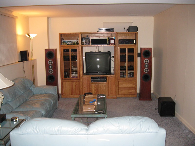

                                                                                  Listening impressions so far
                                                                                  Jim- Thank you for the complements! I am very happy with the final results of the build, the speakers make a real presence in the family room.
                                                                                  DeathMonk- thank you for the kind words.
                                                                                  I have been listening during the burn in and I must say they deliver a big sound. The drivers seem well integrated with well balanced coverage throughout the spectrum. The burn in time is about 15 hrs now and the sound has been improving as the run time increases. I am not much of an audio reviewer but I will give you my listening impression so far.
                                                                                  The bass is very good and goes deep, no hole here! Creates a very good foundation, like a wall coming straight at you. All low frequency instruments are very well reproduced with great definition and separation. A very real presence and true reproduction of the instruments, I'm very impressed and happy with the base performance.
                                                                                  I have never listened to ribbons before and I think these do a good job and with low distortion even at high levels. They seem more laid back then the domes I am use to but project more three dimensional. The mid range and high end are very well balanced and don’t smear the music. Instruments and vocals come across with ease and good separation. Good source material comes across great.
                                                                                  The speakers image well especially with certain tracks but I feel the sound in the middle could be a little wider overall. The stage to some degree seems somewhat further back or moderately narrow in the middle and is projected on the sides (with great clarity I might add). I feel some tweaking may be in order, either placement or component. In addition I feel it could use a little more "air" in the upper-mid to high range. The characteristic that may be defined as liveliness, unveiled, uninhibited sense. I think the moderately narrow middle and air may be related, so what ever improves one may improve both. Having said all this I will say overall they are really nice to listen to and I am enjoying all over again listening to my cd collection.
                                                                                  I think the design is great and that these speakers will respond to system changes no matter how small. I have some thoughts about tweaks but I feel I would be shooting in the dark. I welcome any feed back, questions or suggestions.
                                                                                  Regards,
                                                                                  John…
                                                                                  Last edited by theSven; 28 April 2024, 08:53 Sunday. Reason: Update image location

                                                                                    • Curt C
                                                                                      • 792
                                                                                      Very nicely done, John!
                                                                                      I see by your attached pic that some of your midrange issues may be due to the close proximity of the speakers to the front and side walls. Pulling them into the room a bit further, and toeing them in some may help. The right speaker in particular is likely being compromised by the proximity of the wall and entertainment center.
                                                                                      Curt's Speaker Design Works

                                                                                          Hi John,
                                                                                          Your Statements look great!
                                                                                          No surprise that I agree with Curt. I've attached a picture of my pair of Mini's in my living room that has a similar placement situation to yours, in that, I have an entertainment center between the Mini's with little clearance in the center. I experience a similar sound to what you're describing from them because of placement. When I take them downstairs to my listening room, they image like crazy. They simply have to have some room to breathe with the open back transmission line design.
                                                                                          Please disregard the "bunny" decorations gracing my Mini's. My wife is chief decorator in charge on this level of our house.
Name:	IMG_0766 DPP_NW Resized.jpg
