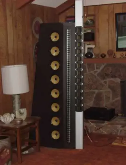

        Jeez! You guys act like this is something new around here. Has no one ever seen a 4 way floor to ceiling Acoustat, RD75, Leaf Tweeter, IB rig before? Any of you?
        Or one of these?
              Or one of these?
              Click image for larger version  Name:	SingleBlackDipole.webp Views:	0 Size:	14.8 KB ID:	936981
              Hmm. I've seen, built, heard, enjoyed and then sold something a wee bit larger than that. LOL
              Ahh! Good Times.
              Looks good chuck.
              Mike
              Call me "MIKE"

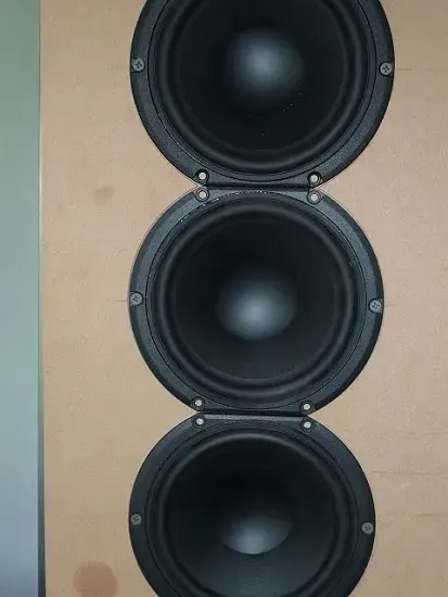

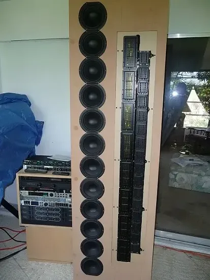

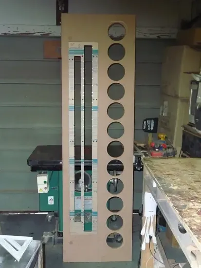

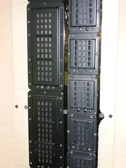

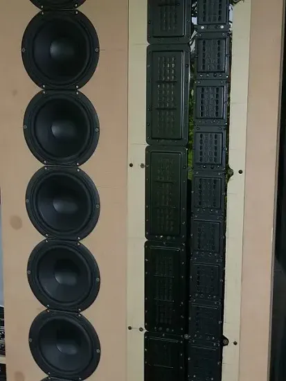

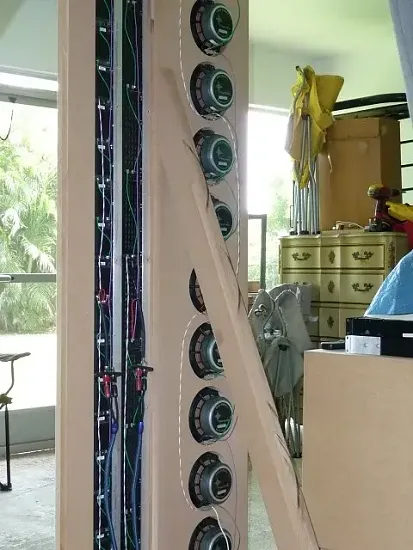

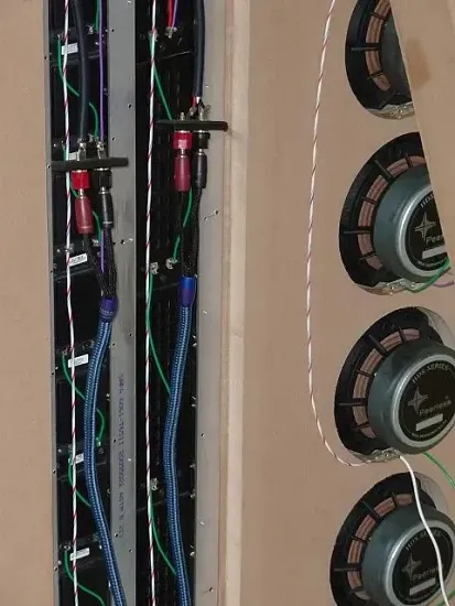

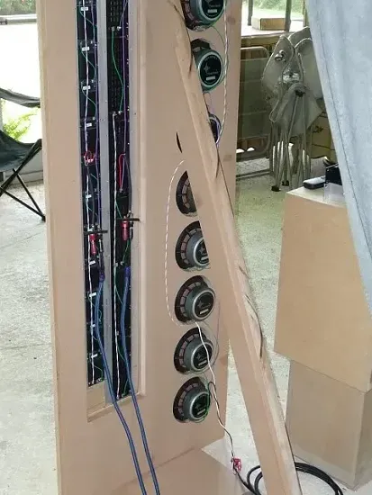

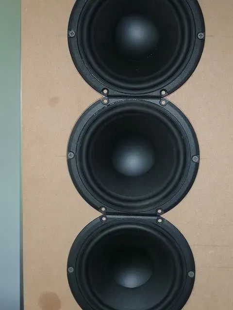

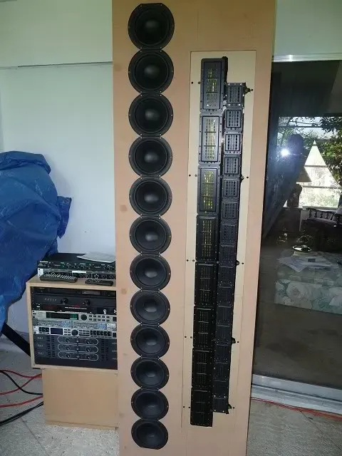

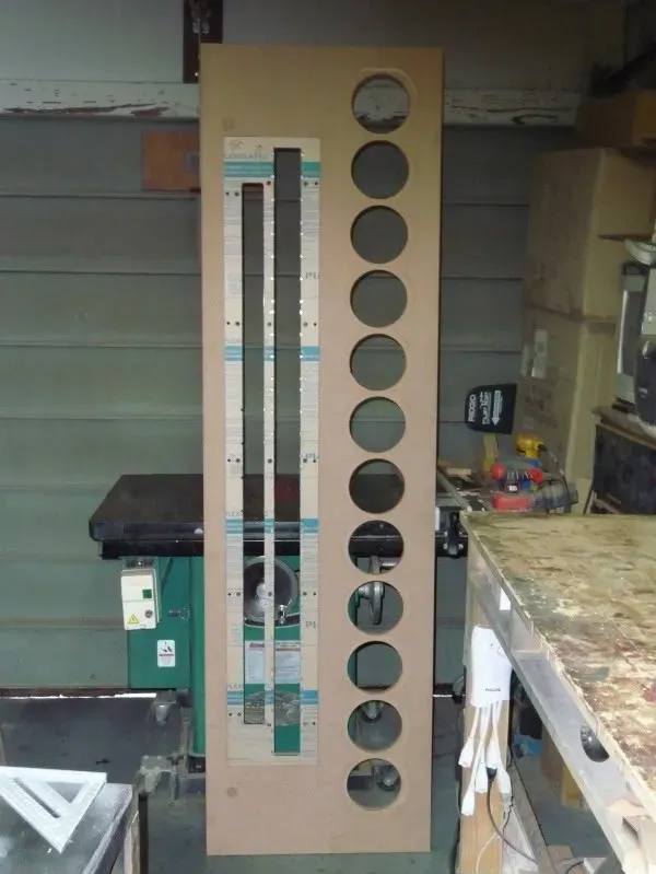

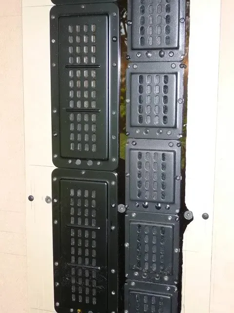

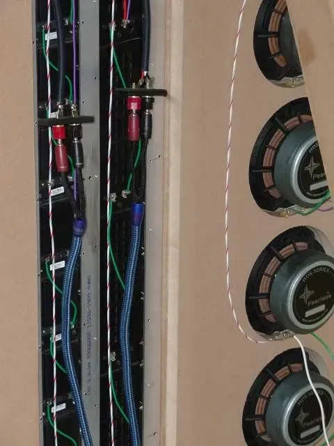

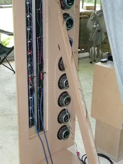

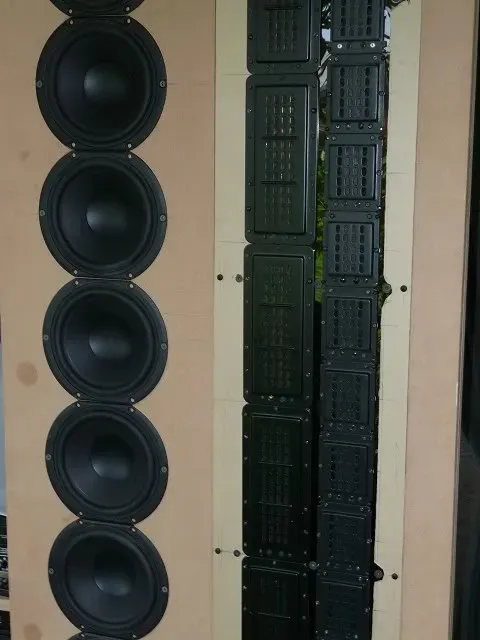

                Here is the weekend update. I got all of the routing done on the laminated MDF body and came up with the beginnings of a method to make this guy stand up straight. Lots of pictures.
                I have not used more than 2 screws per woofer, I haven't put the aluminum bars in to stiffen the panel up yet, I haven't done a roundover on the backs of the woofers, and most of all, I didn't put the scallops in yet (Jon)!
                But what I gained from this almost complete mock up was the ability to hear 2 of these behemoths in the room in stereo! Put you hearts at ease. The imaging and soundstaging is great. Off axis response is quite good. Now all of this is done with my poor old ears so take that into account because I have not taken any measurements at all. Just listened to them. So far, it seems, they can only get better.
                Note the spacing between the woofers. Krutke would be proud!

                Closeup of the Neo's.

                Yes, that is a 40 pound steel plate laying there.

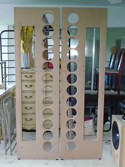

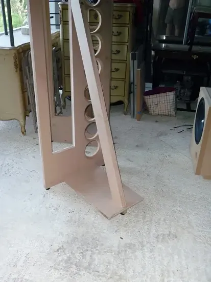

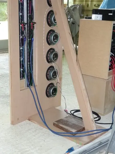

                                                                  Need to get this back on the first page before I lose track of it. I am almost finished constructing the second mirror image baffle. Waiting on 15 10-32 X 3/8" flat head screws.
                                                                  Once I get the drivers screwed in place I will have two complete baffles with drivers mounted and ready for bracing and bases. I am going to laminate 2 pieces of 1 X 4 red oak for a single rear diagonal brace going from 5 feet up the baffle to the rear of the base which will be 24 inches deep. Once I laminate the oak I am going to route a channel down the piece that will hold the cables that feed the arrays. The brace will bolt into the array with flat head 1/4-20 bolts and hurricane nuts. The base will be sort of pentagonal and bolt onto the rear of the baffle at approx. floor height. This will allow me to break down the array into 4 pieces for transportation or moving it. Base, brace, baffle with woofers, and plexiglass mid/hi section.
                                                                  Just getting the baflles ready is only part of this procedure. Constructing the base and the brace will allow me to stand these guys up and listen to them while I sort out crossover issues and such. And at some point I will tear them down again and make them look pretty with a nice finish.

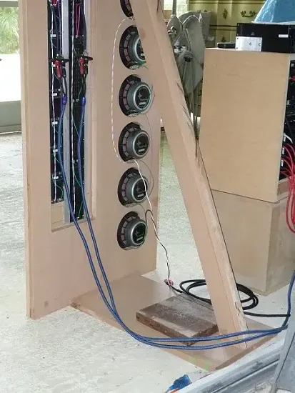

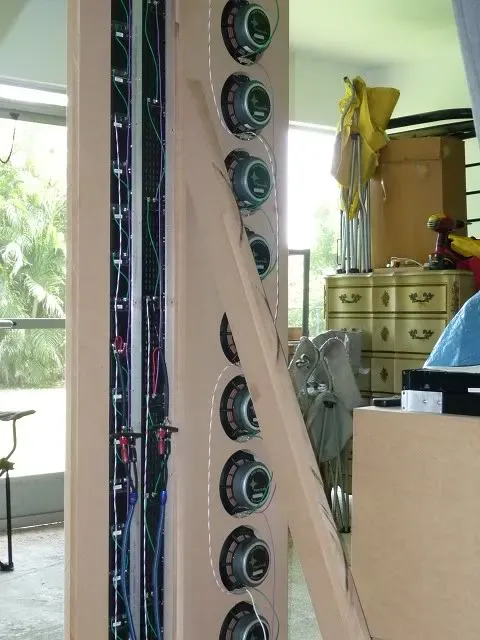

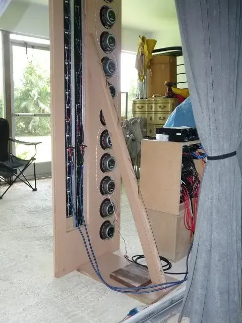

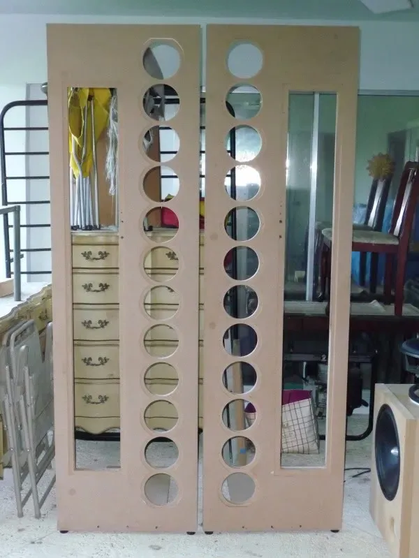

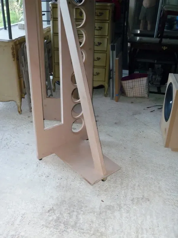

                                                                                    Here you go. Another weekend update. I have completed both frames and the method of supporting them upright. They are built and ready to load the drivers into.
                                                                                    I have both plexiglas panels finished and wired and ready to bolt in. I also have the wiring harness for one set of woofers ready to go. Tomorrow I will get the other set of woofers wired up and ready, then install everything, turn 'em on, and listen for a while.
                                                                                    Note that no attempts to make them stylish, pretty, or any other looks enhancing techniques have taken place yet. I am only at the stage where I now have a pair that I can A/B against the other, test and measure different xover configurations, and move them about fairly easily. The real work is yet to come.
