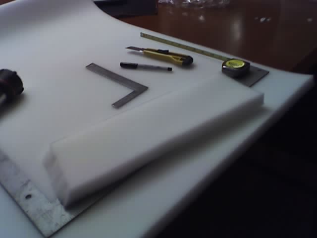

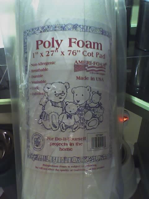

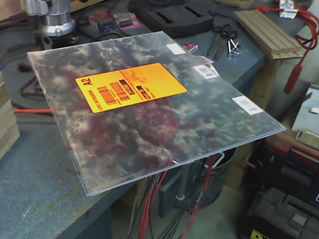

            #365

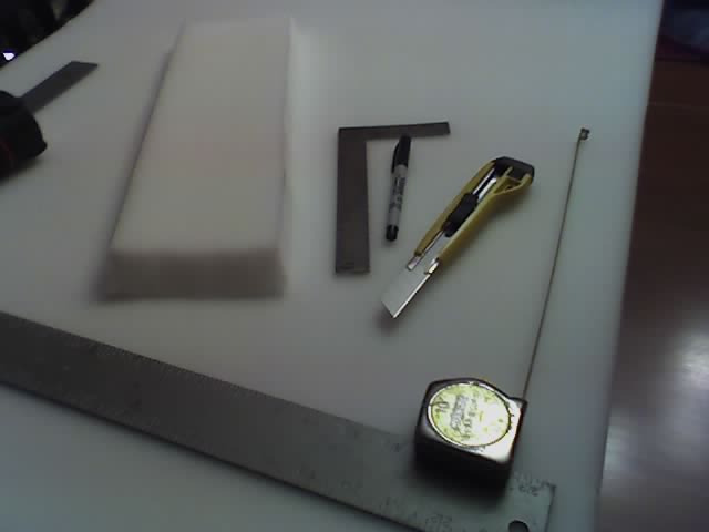

            Some more good progress last night...
            I got the second speaker all sanded down and it looks great...
            I also stopped by Hobby Lobby and bought the foam for the midrange tunnels...
            Attached is a picture of it... They had 12" x 12" x 1" sheets... But, by the time I would have bought enough to line the tunnels it was only like $2 more to buy a whole role of it...
            Since I have so much extra now, I am definitely going to experiment with dying the foam black... We'll see... :P
            Mark

              #366
              Hi Mark,
              I wouldn't paint it but black dye should work. I don't think Foam by Mail sells flat 1" foam which works the best and is what Curt used to develop the crossovers. Hobby Lobby is your best source. That's where I bought mine.
              Foam by mail has some flat 1" flat charcoal foam.
              With charcoal foam, you get a great appearance and performance. It is versatile, and can be used in a variety of applications including packing, padding, and more.
              specs;
              Explore our comprehensive foam data sheets with detailed specifications and technical information for our wide range of foam products at Foam Factory.
              This is what I used for the mids, hope it's the right stuff 8O

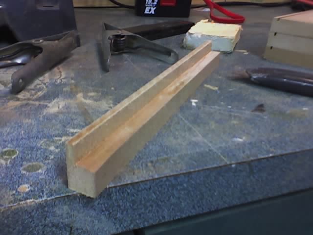

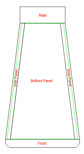

                    #369
                    Hey guys,

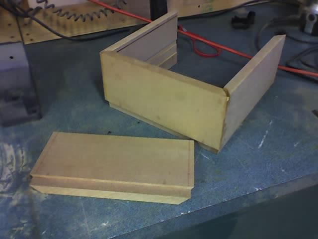

                    A little more sanding was done last night... Just a little more tonight and I think we will be good...
                    Also, I think I have finalized a speaker foot idea...
                    It is not very different than my first idea, but I really wanted something that will make the speakers look like they are "floating"...
                    Picture one shows the new proposed size/shape of the foot (bright green)... Notice it stops at the edge of the rear curve and the front baffle and overlaps the side walls... The angled sides of the foot would be approximately 1/8" inch from the edge of the side walls... This will match the 1/8" rabbet I have routed around the rear curve and front baffle...
                    This should also give plenty of support to the side walls (if they need it - since some people said they did and others said they did not)...
                    Picture two shows a side view of what the foot would look like... It will be made from 3/4" MDF...
                    I think for now I am just going to use some screws to attach it... That way I can remove it and change it around a bit if I desire to in the future...
                    I'll make and attach these tonight...
                    A buddy of mine is going to come over on Saturday to haul these things up stairs and do some listening... :B
                    Mark

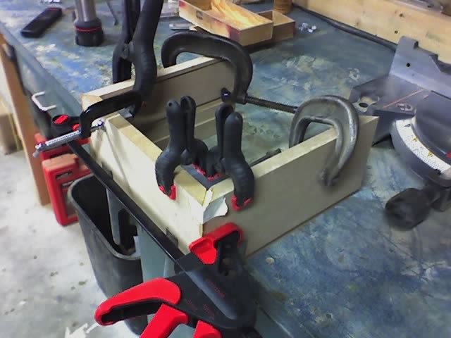

                      #370
                      Well, with my wife's help we were able to get the speakers completely puttied and sanded down earlier tonight... They turned out really well... There are a few little places that aren't perfect but I am pretty sure I will be the one one to notice the few things...
                      I have the holes in the midrange tunnels for the speaker wire all siliconed up...
                      And, I attached the feet to the speakers...
                      My buddy is coming over early tomorrow morning to help me carry them upstairs and connect them to the amp and crossovers...
                      I will install the actual drivers and midrange foam once we have all the dust wiped off of them and they are upstairs...
                      Then hopefully sit back, relax, listen and enjoy!!! :B
                      I'll post results and pictures tomorrow...
                      Mark

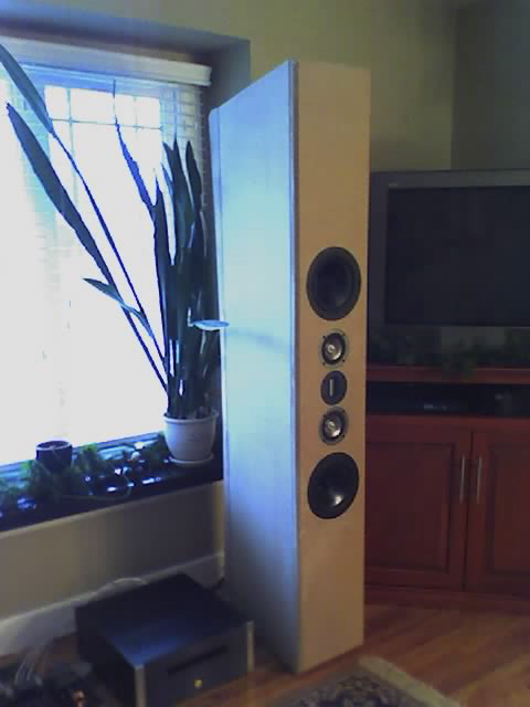

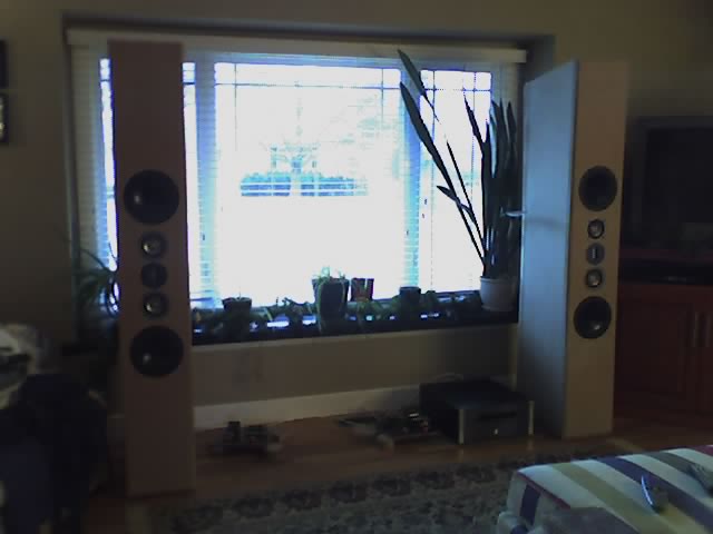

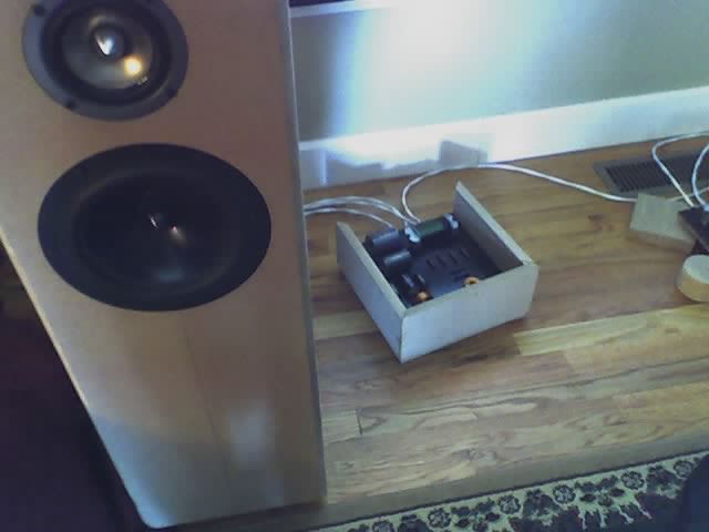

                          #372

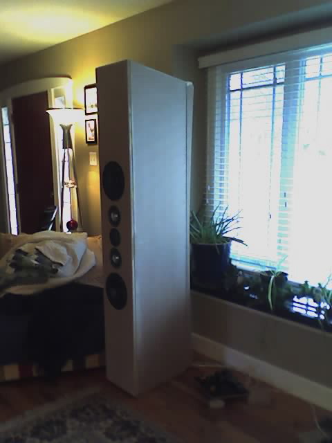

                          We have music!!!
                          :B :T :B :T :B :T :B :T :B :T :B :T :B

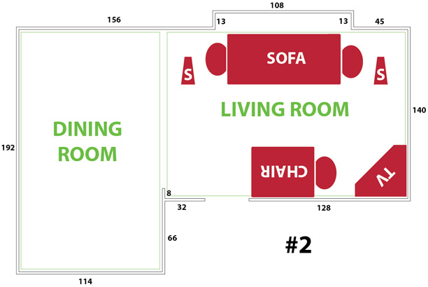

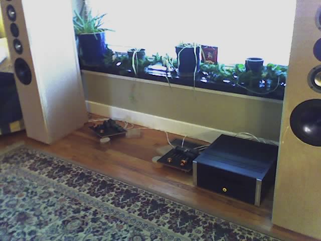

                          Current setup:
                          Source is the OPPO 980-H which is connected directly to the Emotiva XPA-2 amplifier which is then connected to the external crossovers and then to the respective speakers... All wiring is Bluejean 12 gauge...
                          I have the speakers about 6" from the actual wall... But, we have a box bay window with is approximately 12"-16" deep... So, the midrange chambers are about 18"-24" from a vertical surface... The box bay window has wood blinds and plants within it... See pictures for details...
                          First impressions and one issue:
                          One issue that I have is last night I applied silicone to the wire holes that go through the midrange chambers... Oddly, it is still not dry and is actually quit sticky still... This is very weird because it is a relatively new tube of silicone (GE Silicone II)... So, I have not places the foam into the midrange chambers yet...
                          So, I know the music I am hearing now is no where near the quality it should be...
                          That being said, even in their "crippled" state these things sound simply amazing...
                          Things that I am quite impressed with are:
                          1 - The ability to pick out where singers and instruments are...
                          2 - The 3-dimensional sound stage and the depth of the sound stage are incredible...
                          3 - This is the first time that I have ever been able to close my eyes and simply forget that there are speakers in the room... It is quite the experience if you have never heard these quality of speakers before...
                          4 - The bass is super tight and super low... The tweeters are crystal clear...
                          Things that I am going to enhance:
                          1 - I gotta figure out what is going on with the silicone so that I can properly put the foam into place...
                          2 - I think I am going to remove the woofers and trim a little bit off the insulation off the side walls close tot he front baffle... I think it might slightly be "muffling" the woofers...
                          My big concern is the midrange foam... Again, I have no clue why the silicone is not drying and I want to get that foam in there so that I can listen to these things the way they were meant to be...
                          Right now without the foam there is this "lacking" quality to the overall sound experience... The overall sound and stage are incredible but the midrange (and therefore the entire experience) just doesn't seem to be "alive"...
                          Again, if they sound this good without the foam I simply cannot imagine what they will sound like once I get that installed...
                          Attached are some various photos of the setup... As you can see the next steps are finishing and boxes for the crossovers...
                          If anybody has any setup critiques or suggestions or advise on any improvement (if any) I would greatly appreciate it...
                          Thanks guys...
                          I will keep updating on the progress...
                          Mark

                            #373
                            WOW!
                            Mark, you have a GREAT wife!
                            -David

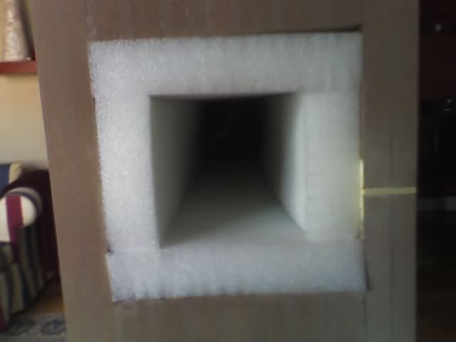

                                    #377
                                    Well, the "bad" silicone came off nicely and the liquid nail is drying perfectly...

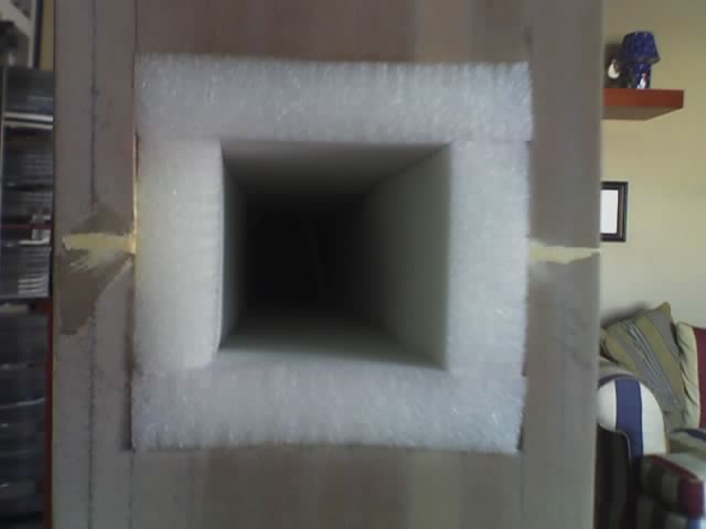

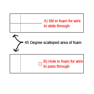

                                    I want it to dry a little more before I install the foam for the mid tunnels...
                                    Quick question; probably over thinking this, but:
                                    When I go to cut the foam for the lining of the midrange tunnels I am wondering how to get it around the wires that go through the wall of the mid tunnel for the midrange drivers...
                                    Should I (A) cut a slit down the middle of the foam to slide the speaker wire through??? Or, (B) cut a hole in the foam for the speaker wire to pass through??? Or, (C) does it really not matter???
                                    Thanks guys!!!
                                    Mark
                                      #378
                                      Thanks guys!!!
                                      Mark
                                      Hi Mark,
                                      Either way will be fine. I usually just guide the wires to the corner and run them down the "V" where the side and bottom meet and then bring them back to the middle near the driver to attach to the driver terminals.
                                      Also, some thoughts on set up. I'd suggest you play with positioning. Based on your pictures, the mids are shooting straight back to the glass (extremely reflective) and the sound is being "cupped" by the window well. If you can, try moving the speakers so they're further apart with the back of the speaker about 18" from a flat wall so the sound can be reflected from both sides of the speaker rather than being directed to the center between the speakers. I hope that makes sense.
                                      Also, let them play for several hours. They'll sound different and better after 20 hours than they do when you first fire them up for some reason. I usually just let them play all day before really spending any time listening.
                                      What are using for reference CD's? Be aware, there are very, very few well recorded rock CD's. Old rock is horrible and newer stuff isn't much better. However, there are many great jazz, blues, gospel and folk CD's that provide the "wow" realism that a good system provides. That said, I have the Oppo 980 and its a good player. Not great but good. I recently added a Pacific Valve Lite Audio DAC 62 to my system and it now has that "wow" experience every time with good recordings. In other words, different electronics will make a difference as you build your system. You have a great amp and an excellent DVD player that can also be used as a great transport.
                                      HTH

                                          Well, I got the foam installed in the midrange tunnels last night...
                                          Attached are a couple pictures showing how I cut it and the tools I used...
                                          I ended up pulling the 45 degree end back from the drivers about 2 inches... I might try pulling it back another inch or so to see if it changes the sound significantly...
                                          I cut two pieces of foam at 5 1/8" wide (top and bottom) and two at 3 1/8" wide (sides) for each tunnel... This worked perfectly to create just enough friction to hold the foam in place...
                                          The change in audio quality is simply amazing once the foam was in place... Again, even my wife could hear an audible difference...
                                          Mark

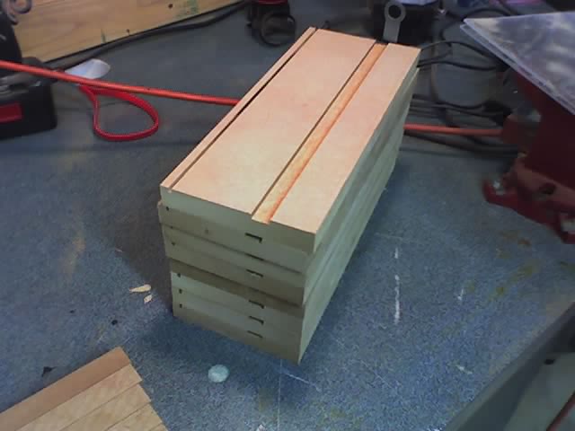

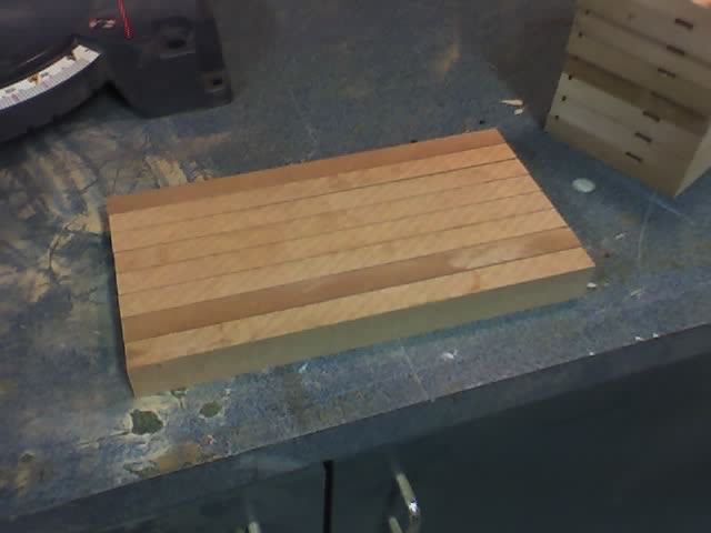

                                                          Made some progress on the crossover boxes...
                                                          Attached are some pictures of the parts I will be using:
                                                          Photo one shows the sides that I cut... The thin rabbet is fr the plexi to slide into and the thick rabbet is for the base of the crossover network to slide into...
                                                          Photo two shows the plexi I bought...
                                                          And, photo three shows the strips that will make up the "feet" of the crossover boxes... The speakers have a 3/4" piece of MDF as a foot that is slightly recessed from the edge of the speaker... These small pieces will end up being 3/4" high and also be recessed from the edge of the crossover boxes to match the speakers...
                                                          The feet will be black, the inside will be black and the outside will be veneered with the leftovers from the speakers (when I get that far)...
                                                          More soon,
                                                          Mark

                                                                Hey guys,
                                                                Well, the wife and I were out of town for about 4 days for the Holidays... Went up to Chicago for a mini vacation...
                                                                Now that I am back I have been working on the crossover boxes and tweaking the speakers...
                                                                Attached are two progress photos of the crossover speakers...
                                                                The first shows the rabbet I cut in the "feet" of the crossover boxes... The second picture shows how I glued and clamped the feet to the sides of the crossover boxes...
                                                                Once I paint the foot area black and the sides will be veneered and stained they will match the speakers...
                                                                Once the glue dries, I will miter the corners and begin assembly...
                                                                Mark

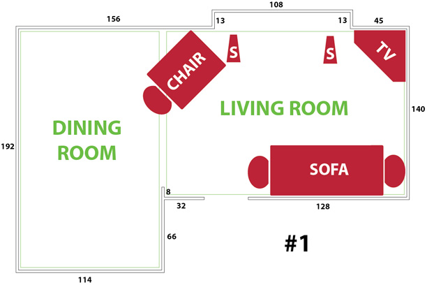

                                                                  I have also been playing around with the layout of the room...
                                                                  As Jim was mentioning the speakers are not in the most prime position... And, as the wife has mentioned they are kind of sitting out in the middle of the room...
                                                                  So, picture Home shows the current room layout... Numbers are inches and everything is extremely close to scale...
                                                                  As Jim has mentioned the speakers are being "tunneled" by the box bay... And, the right speaker seems slightly louder than the left speaker... I am assuming this is happening due to the right speaker bouncing off the wood corner entertainment center and the left speaker being absorbed by the very squooshy chair... The speakers are also relatively close together with only roughly 60" in between them now...
                                                                  Also, with the current setup (#1) there is really no good place to sit and be perfectly positioned in the center of the speakers... The very far left of the coach works but you are still about 4-6" inches off center sitting to the far left on the couch...
                                                                  My best re-arrangement of the room is picture #2...
                                                                  Here the furniture would basically be flip-flopped... The couch would go in front of the box bay and the speakers would be pushed apart at roughly 130" in between them...
                                                                  Hopefully they would be much more "balanced" this way with solid walls behind them and more similar acoustics next to them... The only thing I would worry about in the new setup (#2) would be the right speaker would be close to a side wall and the left speaker would be far away from any side wall... The ovals are end tables...
                                                                  The new setup (#2) would also allow the chair to be moved and be the primary "listening" position - nice and centered between the speakers...
                                                                  I would assume all these changes would make the speakers sound better and the listening experience more pleasant... Not that it isn't now... :P
                                                                  Doing this move will be no small task due to having to reposition some shelves on the walls and re-running the cable outlet...
                                                                  So, before I do all of that for naught, I was hoping I could get some thumbs up or thumbs down on the proposed new layout (#2)... Or, some suggestions on simply tweaking the current layout (#1)...

                                                                  1 - Better acoustical balance of speakers (currently right speaker sounds slightly louder than left)
                                                                  2 - Better physical positioning of speakers (in conjunction with objective one)
                                                                  3 - Better listening experience (in conjunction with objectives one and two)
                                                                  Thanks guys!!!
                                                                  And, I hope everyone had a good and safe holiday!!!
                                                                  Mark

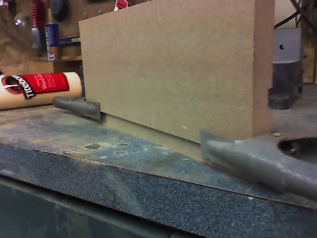

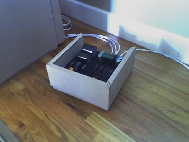

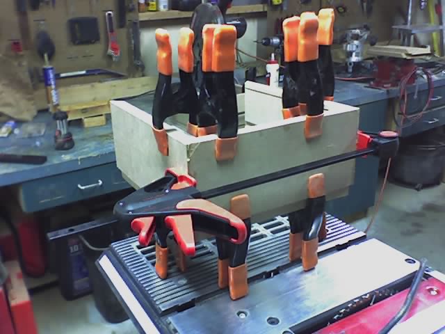

                                                                    More progress on the crossover boxes...
                                                                    These pictures show the three sides glued and clamped together...
                                                                    The fourth (not pictured) side - which will be the back of the box - will have the binding posts on it and will be removable in case I need to fix/change any of the crossover components in the future...
                                                                    I have a few ideas I am going to play around with on how I am going to secure the fourth side to the others...
                                                                    On the second picture you can kind of see how the foot of the box looks when sitting...
                                                                    Mark

                                                                      #394
                                                                      Hi Mark,
                                                                      Listening layout #2 looks much better than #1. Ideal is nothing in between them but that's not practical in many/most living rooms.

                                                                                Hi Mark,
                                                                                Spreading the speakers apart is going to help a lot. I don't think the wall will be a big issue as long as you can get about 18" or more away from it. More is better on the side.
                                                                                However, we all have to live with in the limitations of our rooms.

                                                                                      On another note, some more good progress was made on Sunday...
                                                                                      The crossover box shells glued together wonderfully... The attached pictures show the crossover bases slid into the shells just to see how everything would work...
                                                                                      There are still a few finishing touches to put on them: Layout binding posts, route decorative profile, design securing mechanism for back wall, etc... But so far so good...
                                                                                      I also rearranged the entire living room yesterday... Talk about a job...
                                                                                      There were a few points of contention between the wife and I :P , but in the end I think we both came up with a layout that is pleasing and also does wonderfully with the speakers...
                                                                                      Noticeable differences in the speakers:
                                                                                      1 - The sound stage is MUCH wider now and the sound is MUCH more wrapping and enveloping...
                                                                                      2 - The right speaker no longer sounds louder than the left... Voices are typically dead center now...
                                                                                      3 - You REALLY get the full three-dimensionality of the sound with a good recording... Close your eyes and you could swear you were at a live show...
                                                                                      Now that the speakers are not in front of the box bay, I had to bring them out a little further to get the minimum 18" away from the wall... This was a big point of contention between me and my wife; but with a little room treatment and whatnot I think we are both happy... I have a floor lamp diagonal from one of the speakers and it offers a very cool lighting effect with the lights low and listening to the speakers... The rear curve is really accentuated by the low light and I can only imagine what they will look like once they are painted and stained... I am sure my wife will be more pleased once they are painted and stained as well...
                                                                                      Also, on a side note, now that the speakers and amp are in different spots my Bluejean cable is too short for the left speakers... I was going to go to Lowes to just get some cheap temp speaker wire for the time being... But, to my surprise their speaker wire was $0.62 per foot... Geeze... Bluejean was only a couple cents more...
                                                                                      So, I just spliced two strands together for the time being and I am going to order some more Bluejean speaker wire and also get some Bluejean RCA cables as well... Right now I am just using standard RCA cables that came with my Duet and DVD player... ops:
                                                                                      More soon!!!
                                                                                      Mark

                                                                                        can you show a pic of how the foam looks like in the rear for the mids?
                                                                                        again, very nice job... ;x(

                                                                                            Here you go DeuceLee...
                                                                                            Here are two pictures showing the foam in the midrange tunnels from the back of the speakers...
                                                                                            Check out posts 365, 377, and 380 that specifically go over the midrange tunnel foam install...
                                                                                            Again, good luck on your build...
                                                                                            Mark
