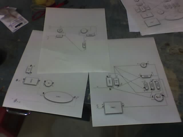

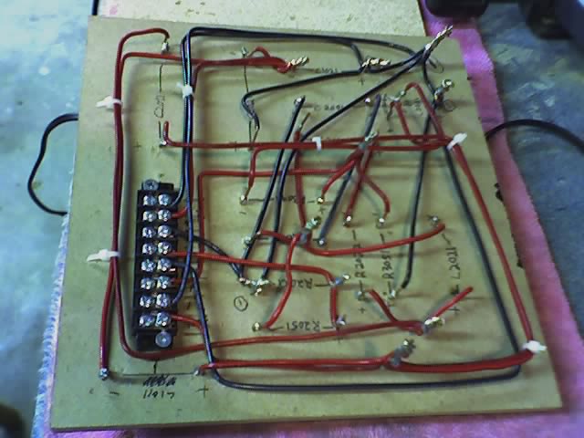

        I have asked Curt to double-check my crossover layouts and once that is signed off, I will begin soldering...

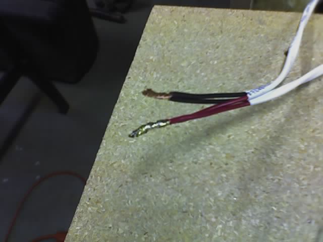

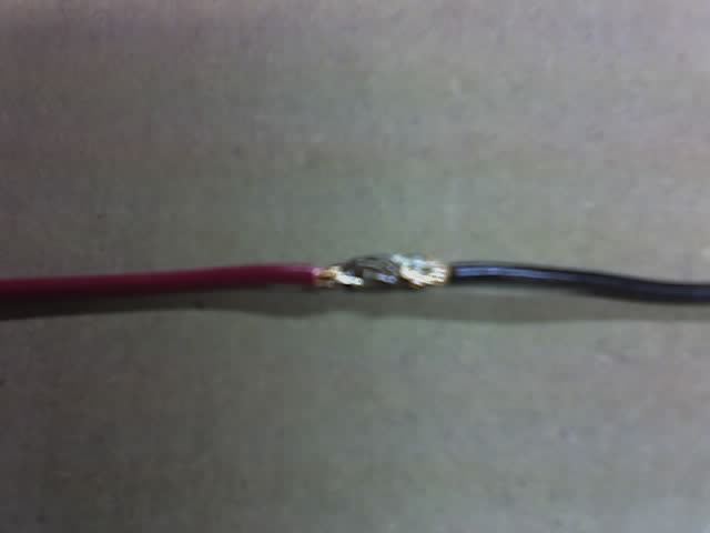

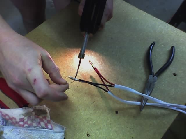

          Soldering Question
          Hey guys,
          I am in the process of soldering the speaker wire together to splice it for the split between the two woofer and the two midrange drivers...
          I have never soldered wires together before... Only copper pipe... :P
          So, I am practicing on some scrap wire...
          How does this splice look???
          This is what I did:
          1 - Stripped the wire back
          2 - Fanned out the individual strands
          3 - Twisted them together
          4 - Tinned the soldering iron (seemed I had to tin the soldering iron multiple times throughout the entire process - is this normal???)
          5 - Set the wire splice on top of the solder iron tip
          6 - Waited for the wire to get hot (the wire actually got really hot almost too hot to hold - is this normal???)
          7 - Applied solder to the wire on the opposite side of the wire in relation to the soldering iron
          8 - Let the solder be sucked into the wire strands
          If anybody is reading this at this time and has any knowledge on this subject matter I would really appreciate some tips/tricks or affirmation of what I am doing...
          Sorry the pictures are a bit blurry - it is the best my phone will do close up... :roll:
          Thanks!!!
          Mark

            • 16120
            #320
            Strip more and then wrap them tightly around each other. Lets see if I can find a picture...
            Ah found the nicest image
            This is how I've always done it.
            • mlammert
              • Dec 2007
              • 373
              #321
              Dougie, thanks for the quick photo... I appreciate it...
              I am letting this go for tonight... I am getting way too frustrated and don't want to mess anything up...
              I understand what the photo is showing but that is really hard to do with two and three strands of 12-gauge wire...
              Some of my finger tips are bleeding... 8O
              My buddy's Dad is an old school electrical engineer; so he offered to come over tomorrow night and show me how to solder...
              I think I might have the hang of it but I have a feeling I am making it way harder than it needs to be... But, maybe not... I don't know...
              So so close to the end...
              Mark

                  • Ray Collins
                    • 257
                    #324
                    The primary sequence for a good solder joint is to heat the joint and add the solder to it, i.e. , the hot joint melts the solder. You are on the right procedural track. Do not disturb the joint until it seizes (cools a little) or you will have a cold joint which will appear grainy. It is a very simple skill to acquire. Finally, only add enough solder to flow the joint; if you add too much the excess will roll up on the tip of the iron. I learned to solder when I was 10 years old working(piddeling) in the shop of one of my dad's furniture and appliance stores. Simple, very simple skill...
                    Ray
                    BENJAMIN FRANKLIN
                      • 3815
                      #325
                      Just make sure you have a good physical connection. You should be able to lightly tug on it before you solder it.

                      • Curt C
                        • 792
                        #326
                        The crossover layouts look correct...
                        The stuffing looks fine...
                        The enclosures look great...
                        You have been given sage soldering advice...
                        You are cleared for takeoff. :B

                            Chuck makes a valid point on the connection; It does not need to be a "wire splice" but should stay in place on its on. As he said, it should withstand a slight tug. You will laugh when you find how simple it really is.

                            • mlammert
                              • Dec 2007
                              • 373
                              #329

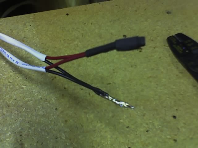

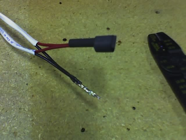

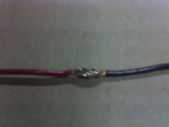

                              Awesome progress has been made Wednesday night and Thursday morning!!! Happy Turkey Day everybody!!!
                              As everyone said, soldering is a piece of cake... To quote Ray above, yes I did laugh out loud... :lol: My buddy's Dad came over Wednesday night and gave me a soldering 101 lesson and it was awesome... After a few test joints I was soldering like a champ... :B

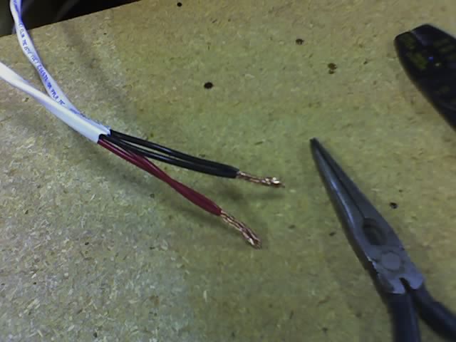

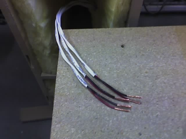

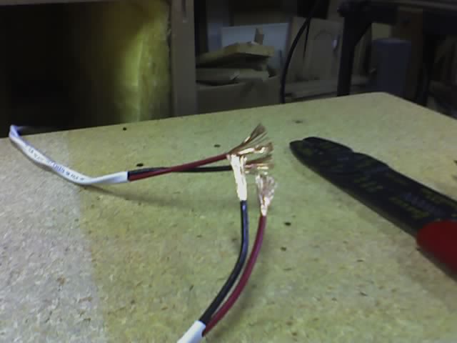

                              The following pictures show the steps I took to solder the speaker wires together... I figured I would document this for other solder nubies such as myself...
                              Picture one shows the speaker wire ends coming out of the cabinets...
                              Picture two shows trimming back the cover and then I stripped about 3/4"-1" of insulation off the wires...
                              Picture three shows how I fanned out the individual braids of the wire...
                              Picture four shows the end result of laying the fanned out braids on top of each other and then twisting them all together... This was easy to do with my fingers for joining two wires... When I had to join three I used a pair of needle nose pliers to aid in the twisting...
                              Picture five shows a completed and successful solder connection... Their should be no copper wire showing and all the strands of wire should have a nice coating of solder on them... You should still be able to see the individual strands but all should have a nice coat on them...
                              Continued...

                              • mlammert
                                • Dec 2007
                                • 373
                                #330

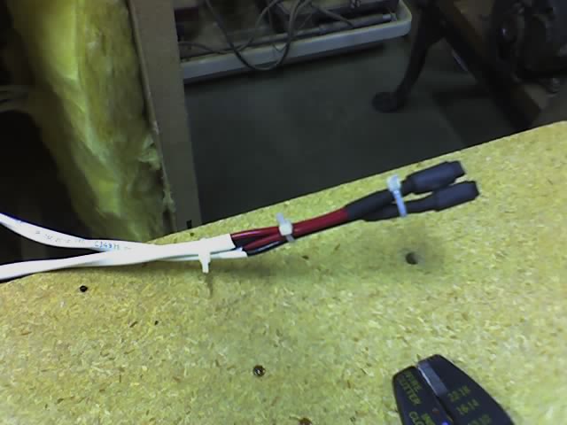

                                The first two pictures show me in action soldering...
                                When doing this, unwrap about 2 feet of solder from the spool and let it just hang over the side of your bench or table so you are not fighting to unwind it while soldering the joints...
                                I was using a 140w soldering gun and it took about 10-15 seconds for it to heat the twisted wire enough to start melting the solder... THIS WAS THE KEY... I was getting frustrated at my first attempts the other day primarily due to the fact that I was using a 45w soldering iron... The 140w soldering gun made all the difference in the world...
                                I took the approach of placing the tip of the soldering gun under the twisted wire and then touched the solder to the top of the twisted wire... When everything is hot enough the solder will literally be sucked into the strands of the wire... It is actually quite cool and amazing if this is your first time doing this... 8)
                                You will need about 1 1/2 feet of the solder to thoroughly saturate the twisted wire... Especially on the three wire bundles...
                                Let the connection cool and check the under side of it to be sure the solder flowed all the way through it... If not, just flip it over and repeat the process on the other side... Obviously you will not need as much solder this time around...
                                The last three pictures show the process I used to heat shrink and then tie wrap the connections...
                                My buddy's dad showed me the trick of taking the normal size heat shrink and covering the solder connection... Cut it long and then folder over the end and then place a short piece of the next size up of heat shrink over the fold... This produces a nice tidy package...
                                I then used three tie wraps to bundle everything together... This made the wire extremely stiff and there is no tension or tugging on the wire or connections...
                                Nice...

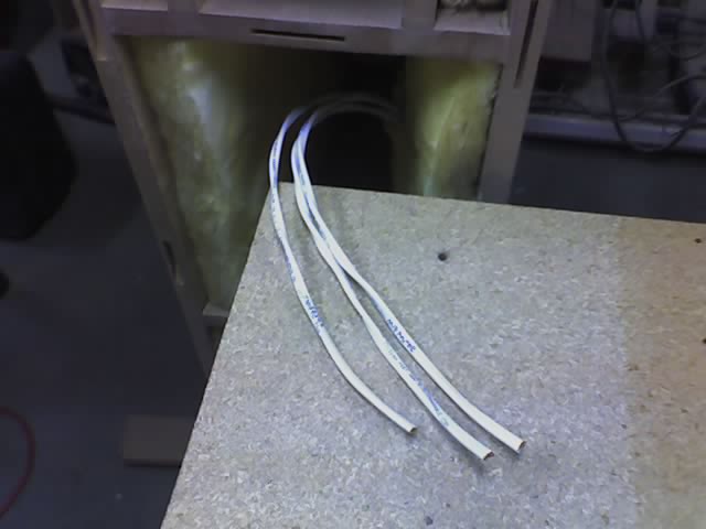

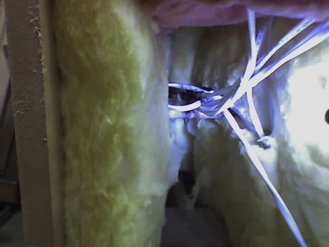

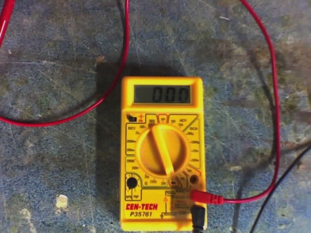

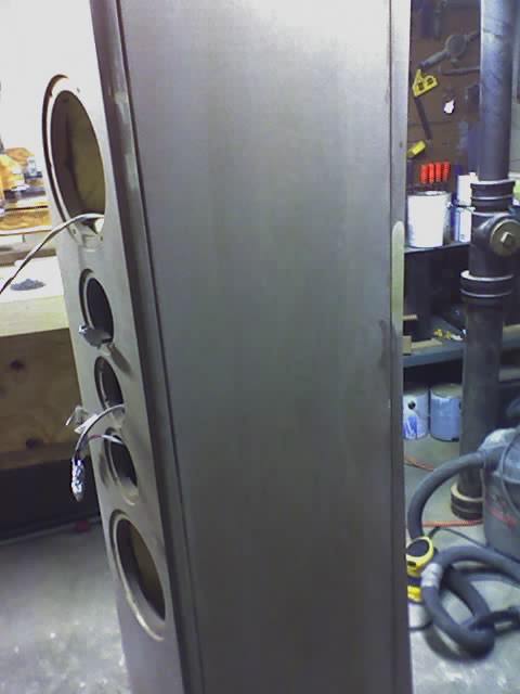

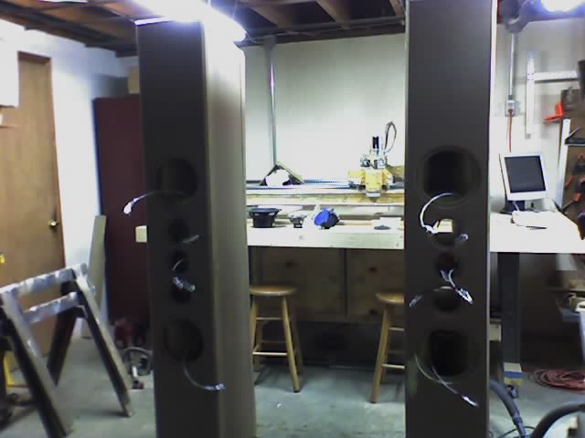

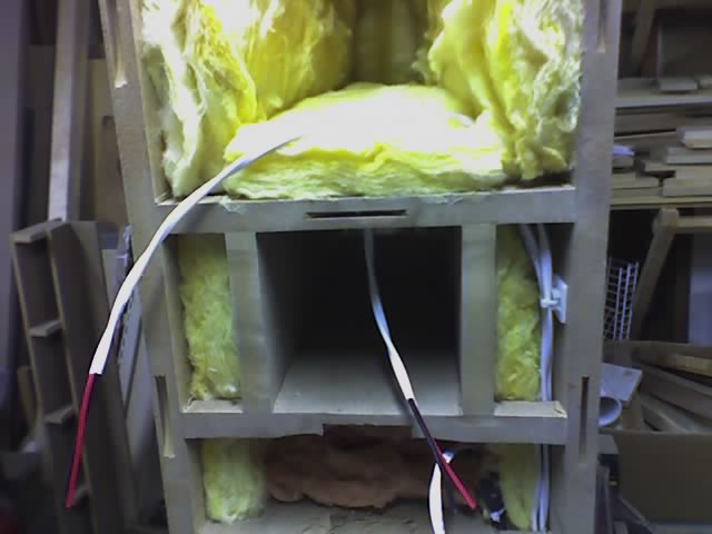

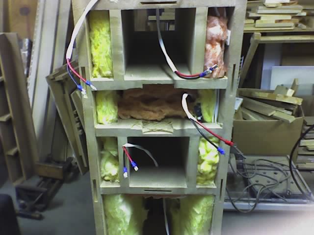

                                  Once all the wires were soldered together I then started routing and securing the wires to the inside of the cabinets...
                                  Pictures one and two show how I routed the tweeter and upper midrange and upper woofer wires through the small cavities on the sides of the midrange enclosures... Probably not necessary but I used wrap hold downs to secure the wires to the walls...
                                  Picture three shows all the wires routed and the end terminals connected...
                                  Picture four shows how I used a large zip tie to secure all the soldered bundles to one of the vented braces... This worked really good in securing and eliminating any tugging on any of the wires...
                                  Finally, I used my meter to check the continuity of each wire... I touched one probe to one of the binding posts and the other probe to one of the speaker connectors and made sure the meter read zero... I did this for the positive and negative of each speaker terminal...
                                  Remember, the midrange speakers are wired in reverse... Positive input goes to negative speaker terminal... Negative input goes to positive speaker terminal...
                                  Next - glue up!!! :B

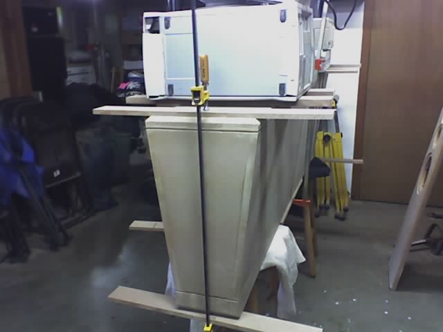

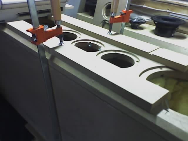

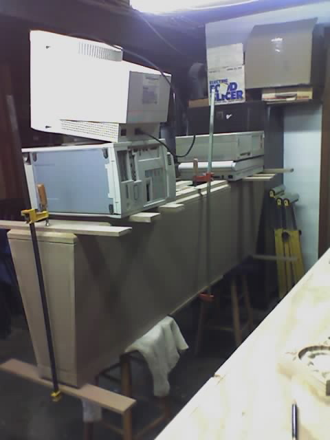

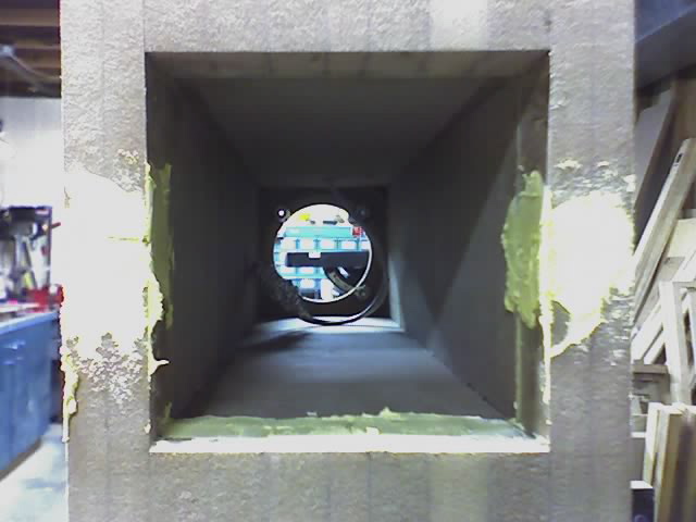

                                    With both cabinets correctly wired, I went ahead and glued the baffle to the first speaker...
                                    I only have enough clamps for one glue up at a time...
                                    The first three pictures show various shots of the baffle being glued...
                                    I used two generous beads of liquid nail around the perimeter of the speaker body and the perimeter of the midrange cabinets... I put a generous single bead along all the other bracing...
                                    I clamped them down and also used some various computer equipment to weigh down the other areas of the speaker...
                                    There was plenty of liquid nail squeeze out on the outside and inside... I wiped up on the outside and also used a small flat head screw driver to scrape the squeeze out out of the 1/8" rabbet...
                                    Oh, I also wrapped the speaker connectors with tin foil just in case so that no liquid nail squeeze out would gum them up...
                                    I threw in the last picture to show how before taking off the connectors for the tweeters I marked on the label which terminal was positive and negative...
                                    A wonderful wonderful start to Thanksgiving!!! :B
                                    Enjoy it and be safe in your travels everyone!!!

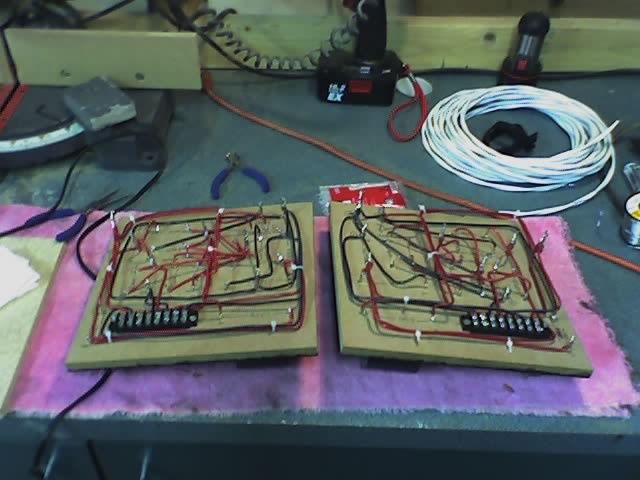

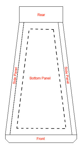

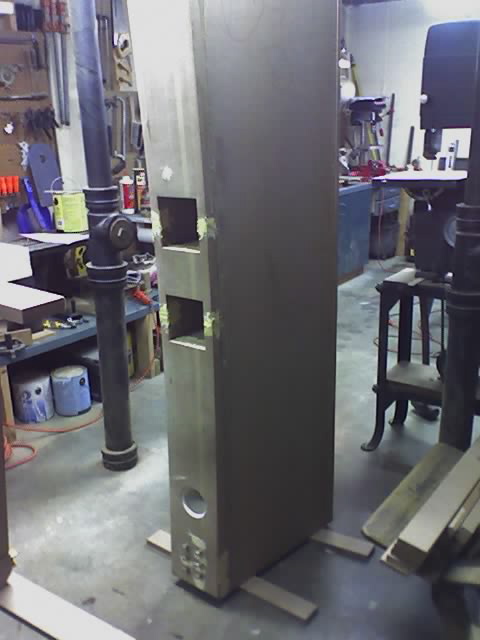

                                        Hey guys,
                                        Hope everyone had an excellent and safe Thanksgiving!!!
                                        The first speaker glued up perfect... :B

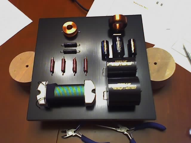

                                        I also have my crossover boards laid out and am ready to start soldering as soon as I run out and get some supplies...

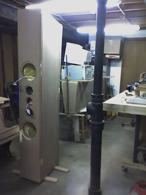

                                        Quick question on possibly mounting a "foot" to the bottom of the speakers...
                                        The attached picture shows the outline of the bottom of my speakers... You can see how the back, front, and sides are all butt jointed to the bottom panel of the speaker...
                                        The dotted line is the proposed area where I was thinking of attaching some sort of foot or feet to the bottom of the speakers...
                                        My question is -- since the bottom panel is simply butt joined to the sides and rear and front -- if I secure the feet to the bottom panel won't all the weight of the entire speaker be relying on the those few butt joints??? Or, am I not seeing the big picture???
                                        I have a vision of the weight of the speaker "popping" the bottom butt joints and crashing down around the bottom panel and feet... 8O
                                        Thanks guys!!!
                                        Next speaker glue up on its way...
                                        Mark

                                        • Curt C
                                          • 792
                                          #335
                                          A lefty, huh? No wonder your cab design is so aesthetically pleasing. :T
                                          -Right brain dominant and all that... :B
                                          A well glued butt joint (at least with conventional wood glue) will be stronger than the surrounding MDF, so I wouldn't sweat it. I'd also be tempted to use 3 spikes pushed to the outside edges so it will be self centering...
                                          Curt's Speaker Design Works
                                            #336
                                            Did you use liquid nails on those joints? If so, I wouldn't trust it. That stuff's really weak compared to yellow glue which should be fine. You could use some screws to beef it up if necessary.
                                            • David_D
                                              • 197
                                              #337
                                              Hi Mark,
                                              I do like the idea of a foot to encompass the side edges. Also, if gives you yet another oportunity for some artistic freedom.

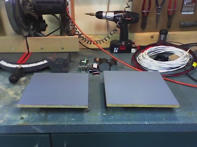

                                                  Starting to work on the crossovers and finishing the speakers...
                                                  First pictures shows the paint I bought... KILZ oil-based primer that has been tinted dark gray for black paint... Rust-oleum oil-based flat black... And, Minwax oil-based gloss polyurethane...
                                                  Second picture shows the two bases I cut to mount the crossover components to... These are currently being primed and will eventually be gloss black just like the speakers...
                                                  Unfortunately, I have to wait till these parts are dry and finished before I can actually begin work on the crossovers...
                                                  Picture three shows a close up of the holes I drilled through the base... These holes mirror each other... I originally laid out all the components in an eye-pleasing fashion... Then, I aligned all of them and made sure everything was equidistant and all that good stuff... Each hole I drilled is approximately 1/4" from the end of the component... So, I will bend the component wires so that they go down through the holes... I will hot glue the components to the top of the board and then solder all the connections to the back...
                                                  More to come...
                                                  EDIT: FROM MY PERSONAL EXPERIENCE DO NOT FOLLOW THESE STEPS WITH THESE PRODUCTS! YOU WILL GET BAD RESULTS! REFER TO POSTS 342 AND 343 FOR PRODUCTS AND STEPS THAT PRODUCE EXCELLENT RESULTS! - MARK 11/30/08
                                                  Mark

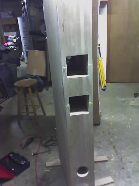

                                                    Since I am going to have a little while to work on the crossovers while I literally wait for paint to dry, I am going to work on the prep work of the speakers for finishing...
                                                    These pictures show the first completely glued up speaker... It turned out very very nice!!!
                                                    You can see the areas where I have applied Durham's wood putty on some of the areas that needed a little help...
                                                    Now I am literally waiting for paint AND wood putty to dry... Ha ha...
                                                    I should have painted the crossover board long ago... But, oh well... Live and learn, right...
                                                    The last pictures is a shot down the mid tunnel... It is so simple but also oh so gratifying to see the midrange cutout perfectly centered in the mid tunnel...

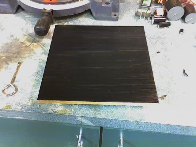

                                                          So far so good on my "new" finishing method...
                                                          Picture one shows the new group of products I am using to finish the speakers...
                                                          We have (1) latex-based ZINSSER primer that has been dyed dark gray, (2) is Rust-oleum's American Accents latex-based flat black paint and (3) Minwax's water-based semi-gloss Polycrylic...
                                                          Note: You will recall in my prior posts I was using KILZ that was tinted... When I went to a different Lowe's today the guy there told me that you are NOT suppose to tint KILZ and said that ZINSSER was tintable... The ZINSSER can did indeed state it was tintable and the KILZ can said nothing of the sort... I don't know if that had anything to do with my prior undesirable results...
                                                          I have always been a big fan of Rust-oleum's American Accents paint...

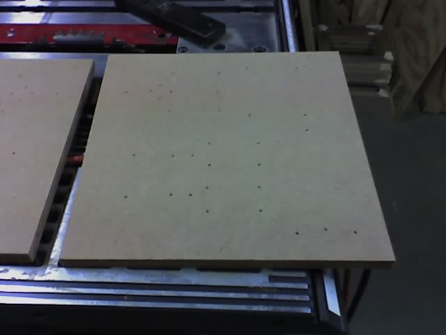

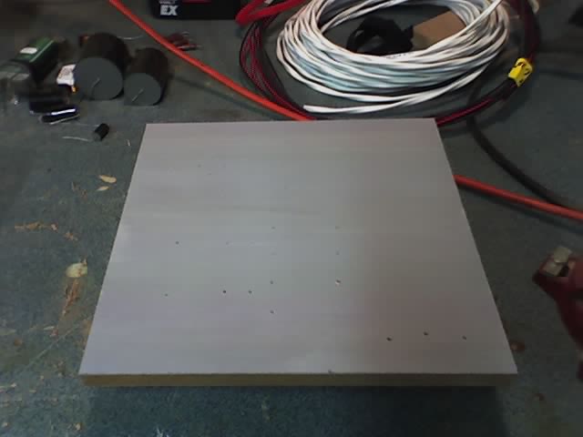

                                                          Picture two shows the 1/4" MDF crossover base with all the holes drilled in it...
                                                          Picture three shows the crossover base primed... Only a one hour dry/recoat time... Nice...
                                                          Picture four shows the crossover base with the first coat of black paint on it...
                                                          Between pictures three and four I lightly sanded the dry primer and it came out awesome!!! Again, I used 220 grit sand paper and it was glass smooth after that...
                                                          Now, lots of people will tell you that you cannot sand latex-based paints and whatnot... I am by no means an expert painter... I actually hate painting... But, I have sanded latex-based paint hundreds of times in the past...
                                                          You (1) have to be sure that it is fully dry according to the product label... And, (2) you have to sand it lightly... When you do it properly the sanded off paint will kind of ball up like when you rub peeling skin from a sun burn... Very small little balls...
                                                          Wipe that down with a dry shop towel and it feels like a mirror... Very soft and smooth...
                                                          I did this exact same process when I refinished our kitchen cabinets and they turned out beautifully... I really don't know why I just didn't do this from the beginning... Oh well... Who knows... :P
                                                          Mark

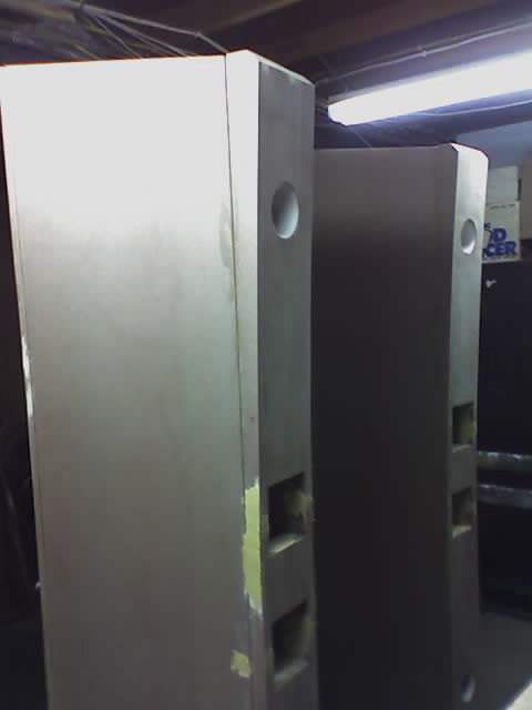

                                                            Quick update on the speaker bodies...
                                                            Both speakers are now completely built!!! :B
                                                            Here are just two quick photos I snapped of them...
                                                            I am starting to sand down the Durham's and glue/liquid nail squeeze out...
                                                            Needed to apply a bit more Durham's in some areas...
                                                            I got a little sander happy and made a small divot in one area... I am probably the only person that would have ever known but I have the Durham's and I have the time since I am now once again literally waiting for paint to dry... :P
                                                            They look very nice... I am very proud up to this point...
                                                            Hopefully, if all goes well with the painting of the crossover base, I should be able to start soldering tomorrow night and prepping the speakers for paint by mid week... :B
                                                            More soon!!!
                                                            Mark

                                                                  More on the finishing of the crossover bases:
                                                                  Yesterday I applied a total of 2 coats of primer, 3 coats of black paint, and 3 coats of polyurethane...
                                                                  I waited the 1 hour indicated dry time between the coats of primer and black paint and the 2 hour indicated dry time between the coats of polyurethane...
                                                                  Between each coat of primer and black paint I sanded down with 220 grit sponge... I did NOT sand the paint between the first coat of polyurethane...
                                                                  I also sanded between each coat of polyurethane with 220 grit sponge... I did NOT sand the last coat of poly...
                                                                  Remember, this is all latex/water-based products (primer, paint, and poly)...
                                                                  The end result is a super shiny and super smooth finish...
                                                                  You can see some slight "ridges" if you hold the crossover base just right in just the right light... But, you cannot feel them...
                                                                  I am not too worried about this since these will be covered in crossover components and they will be in a box covered with plexi...
                                                                  However, when I go to paint the speakers and apply the poly to the speakers I am going to do a few things different:

                                                                        #350

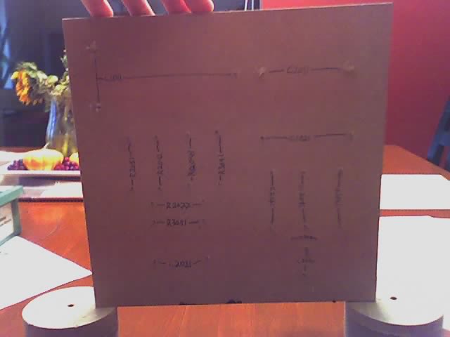

                                                                        Hey guys,
                                                                        Here are two photos of my current crossover progress...
                                                                        I have the bases completely painted and poly applied and the components hot glued onto them...
                                                                        Picture one shows the components attached...
                                                                        Picture two shows how on the back I labeled each component based off of the original crossover schematic from Curt's web site...
                                                                        Next, I just got to start soldering!!!
                                                                        More soon...
                                                                        Mark

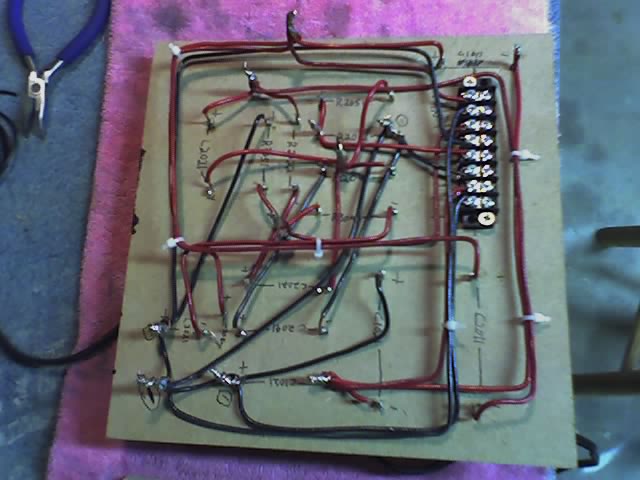

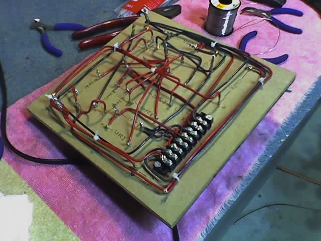

                                                                              Great progress on Saturday...
                                                                              Well, it took me the better part of the day but I got the first crossover soldered together...
                                                                              I used solid 14 gauge copper wire for all the crossover wiring... It took a lot more wire than I thought it would have...
                                                                              I just followed my printout and would mark an "x" next to each end of a component on my sketch until everything was soldered together...
                                                                              As I went along I would check continuity every once in a while to be sure my solder joints were good... That checked out good...
                                                                              I quadruple checked my work as I went so I hope to God I did this correctly... :P
                                                                              Attached are two pictures of the finalized backside of the crossover...
                                                                              Question:
                                                                              Are there any tests that I can perform with my meter to check and be sure things are wired correctly???
                                                                              Thanks guys!!!
                                                                              I am also going to put some heat shrink on the big bundle of twisted wires where I joined multiple connections together...
                                                                              Hopefully tomorrow I can get the second crossover soldered and maybe do a test listen or something... :B
                                                                              Mark

                                                                                • 373
                                                                                #354

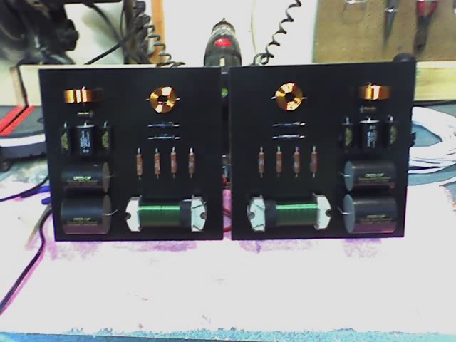

                                                                                Well I got the second crossover soldered up today...
                                                                                Photo one shows the back side of the second crossover...
                                                                                Photo two and three show the two crossovers side by side...
                                                                                And, photo four shows the schematic printouts I used while soldering...
                                                                                Just to kind of give a play by play of how I soldered everything:
                                                                                1 - I first laid out a main POSITIVE IN run and connected all the first components for each crossover section (tweeter, mid, and woofer)...
                                                                                2 - I then soldered all the components for each crossover section... Again, it is kind of hard to see in photo four, but I would mark an "x" next to each connection as I soldered the components together...
                                                                                3 - When making the final NEGATIVE IN solder joint I would leave a loose pig tail hanging off the NEGATIVE IN of each crossover section (tweeter, mid, and woofer)...
                                                                                4 - Then when all the components were soldered I joined the loose pig tails and made a final run from the pig tails to the NEGATIVE IN on the terminal block...
                                                                                MISCELLANEOUS NOTES
                                                                                1 - I did not reverse the POSITIVE and NEGATIVE of the midrange in the crossover layout since I am doing this at the speaker connection in the cabinet...
                                                                                2 - I made sure to not hold the soldering gun on any of the connections for longer than 3-5 seconds while soldering to avoid damaging the components...
                                                                                3 - I made sure there was a strong physical connection between the wire and the component before soldering... I did this by either twisting the wires around each other... Or, if there was not a lot of wire or room I would create two little hooks/loops in each wire and join them like chain and then mash them tight with a needle nose pliers... Worked great...
                                                                                As I said in my first crossover post, I am 99.999% sure everything is wired correctly...
                                                                                However, again, if anyone knows of a test I can do with my meter to check anything, that would be greatly appreciated...
                                                                                NEXT STEPS
                                                                                I am going to do all the prep work for paint and stain in the shop since that will be quit messy... That should only take me a night or two...
                                                                                Then, once that is done the speakers will be hauled up stairs for a first listening!!! :B
                                                                                The speakers will be painted and stained in place... it is warmer up stairs and much less dusty and a more controlled environment...
                                                                                Thanks guys!!!
                                                                                Mark

                                                                                      Well, I got a good deal of sanding done tonight... I am 98% happy with the speaker that had the most Durham's putty on it... Man that stuff is tough to sand smooth... :P
                                                                                      Attached are four pictures showing various angles of the finished speaker...
                                                                                      I used a file to run along the inside of the 1/8" rabbets and that worked really good to clean them up... I used a combination of my orbital sander and various sanding sponges and files to sand down the rest of the Durham's and dried liquid nail that squeezed out...

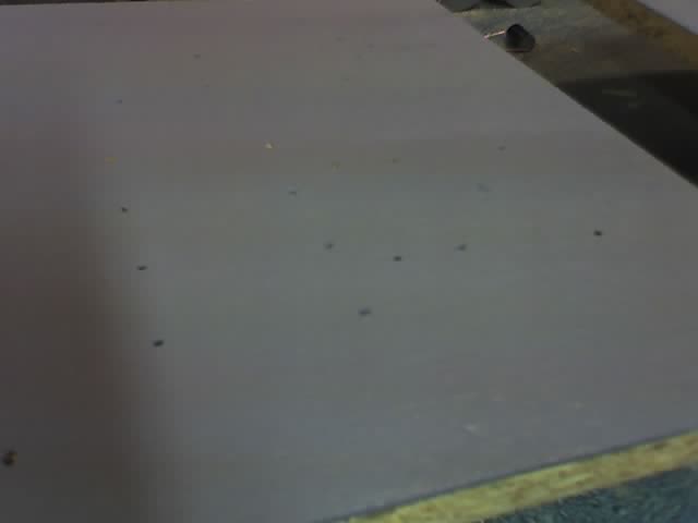

                                                                                      The only part that I really couldn't sand smooth was where I applied Durham's to the inside of the midrange chambers (you can see it in photo two)... I got it pretty darn smooth; but I figured the foam is going to cover that up anyway... :P
                                                                                      So, if I can get the other speaker sanded tomorrow night (it doesn't have nearly as much Durham's on it) and do a few little touch-ups on the first one, I think I will be bringing them up on Wednesday for a test listen... :B
                                                                                      More to come!!!
                                                                                      Mark

                                                                                        • 16120
                                                                                        #358
                                                                                        Things sure are massive....
                                                                                        • mlammert
                                                                                          • Dec 2007
                                                                                          • 373
                                                                                          #359
                                                                                          Eh, they are not that massive... I am just glad they don't look like big monkey coffins...
