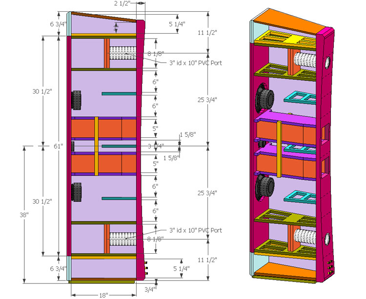

    Excellent, thanks Curt...
    I really appreciate you and everyone else's help so far on my build...
    I am never going to get use to this estimating stuff... I totally get what you mean... But, I am just not use to estimating like that when it comes to wood working... Ha ha... :P
    I have attached a pretty darn final design of the speakers... If anybody has an last minute comments/questions/suggestions, please let me know...
    Really the only change is that this now shows the dual vertical supports for the ports and added some binding posts to the bottom of the back... I also made several "internal" changes to the Google SketchUp file so that I can use it to make my cut list...
    Looks like I am making a trip to Lowes to buy some MDF this weekend!!!
    Thanks guys and talk to you soon!!!
    Mark

      Hi Mark,
      Just a tip. My HD & Lowes carry different brands of MDF. I can't remember which is which but, one was softer than the other. The softer brand made a "hairier" "endgrain". (for lack of better words) It was a real PITA to finish. The hairier stuff would soak in practically anything I threw at it. Take a jack knife with you and scrape the edge. I think the softer stuff looked redder than the harder stuff.
      BTW:
      Sorry if I missed this but, don't you want a 3/4" Roundover for the vertical baffle edges?
      -David

            • JonP
              • 692
              Originally posted by mlammert
              Hey everyone,
              3) I added a small vented brace in the center of the speaker behind the tweeter for more bracing in the middle... Thanks David...
              4) I added additional "stub outs" on the sides of the midrange braces that attach to the sides of the speaker for more bracing in the middle... Thanks David...
              After reading the post that Dan pointed out... And, Curt's feedback on the port's "symmetrical acoustic loading" and stuffing in the narrow cavity, I am not as worried about any "odd resonances" caused by the narrow midrange enclosure gaps... However, I would still appreciate some feedback on that from people more knowledgeable than me...
              Mark
              Oooooh, pretty colors!! :W
              I noticed the central unbraced area as well, the "tabs" and center brace should do a good job of fixing it.
              I've heard of long, tall cabinets sometimes having a distinct top to bottom resonance mode. Zaph was mentioning this somewhere on his site, IIRC...
              I wanted to ask the wise ones if cramming some stuffing in the top and bottom sections behind the yellow (maybe green too?) braces and ends might be an idea? Or, at least try in construction to make that area accessable to putting some in/taking some out later if need be.
              Not trying to buy trouble for Mark, this might not be a big issue, but it stirred a thought. And, if the window brace holes get made big enough for a hand to get in there thru a driver hole... then there's room for later experimentation...
              On the MDF quality comments... I went to a local woodworking supply place, vs the local HW stores, and there is a difference! Heavier, harder and denser, worth going out of your way for.
              I'd add a Shellac sealer to the suggestions. Zinnser's Seal Coat, cut it by half with alcohol from the paint store. Soaks in well, and dries very fast, because it's alcohol based. Couple of coats, as much as it will drink, and it makes a hard, non absorbing, easy sanding surface. You're not adding water to the MDF, too...
              Sounds like you're going to have fun this weekend... :T
              • Curt C
                • 792
                Fortunately the mid tunnels break this up into essentially two 2' tall cabs, so standing waves will not be an issue in the woofer passband.
                Certainly some damping material in the top and bottom sections, will be advantageous. Otherwise, I'd suggest keeping in line with Jim's recommendations for the Statements.

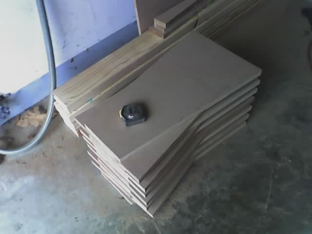

                                  Hey guys,
                                  Well, I picked up the MDF this weekend from Lowes... I got 5 sheets of 3/4" and 1 sheet of 1/2"...
                                  Man that stuff is heavy and cumbersome...
                                  Thanks to David for the tip on the different quality of MDF... He was right on and I made sure to get the "nice" stuff...

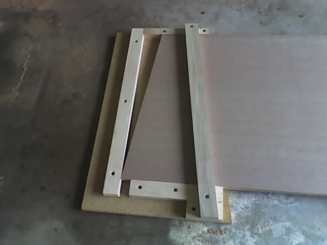

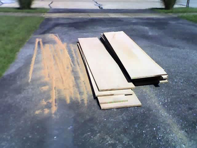

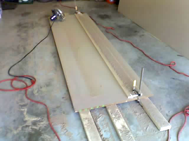

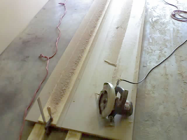

                                                                First Progress Report
                                                                Hey guys,
                                                                Well, I was able to make some progress this holiday weekend!!!
                                                                What was accomplished:
                                                                1) Took all the 4x8 sheets of MDF and ripped them down to appropriately wide strips for all the various parts of the speaker... 4 sides for the speakers... 5 18" wide strips for all the braces... 2 oversized strips for the front baffles... Miscellaneous scrap strips for miscellaneous pieces and back curves...
                                                                2) Got the angled cuts for the sides of the speaker cut perfectly... Yeah!!!
                                                                3) Now everything is cut down so that it easy to manage with the tablesaw and jigs...
                                                                What is next:
                                                                1) Build a jig to cut the 26 internal braces... Jig will allow all 26 braces to be cut repeatedly and accurately...
                                                                What I learned:
                                                                1) "Smooth cutting" saw blades for plywood and OSB do NOT like MDF... It was only $8 but was a complete waste and messed up two of my cuts... Thankfully they were salvageable... Use just a normal general purpose rip cut blade and it will cut through MDF like a hot knife through butter...
                                                                2) I cut the 4x8 sheets of MDF by laying them down on four 2x4s on the ground and using a skill saw... Worked excellently... However, if your driveway is not perfectly flat do not do cut there... I had to move the setup into the garage where the floor was super flat... Much better...
                                                                3) For $3 an angle finding gauge is awesome for any sort of angle reproducing job...
                                                                4) I listened to you guys and covered everything up... But, I must stress, MDF is nasty stuff and the dust will get everywhere... Wear goggles and masks and cover whatever you can up with tarps and whatnot...
                                                                5) Measure 4 times and cut once... Especially when you are dealing with any odd angles like I had to for the front and back edges of the speaker sides... I am very proud that we did not mess up one single cut (except for the two that the original blade screwed up - not really our fault)... I attribute this to taking our time and thinking things through...
                                                                Attached are just some miscellaneous photos I snapped with my camera phone while we were cutting wood... Not really anything special but good progress was made...
                                                                Thanks again guys and more to come!!!
                                                                Mark

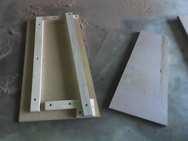

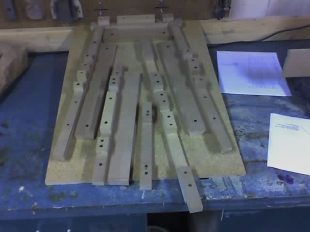

                                                                            Hi all,
                                                                            Great progress was made this weekend...
                                                                            I designed and created a jig to aid in the cutting of all the internal braces... Since all the internal braces (solid, vented, and half) are all based off the same shape, I created a jig that would allow me to make the same angled cut over and over again with high accuracy...
                                                                            You can see the jig in photo one...
                                                                            The previous weekend I cut the 4x8 sheets of MDF into a couple 18" wide strips... So, all I had to do was slide the 18" strip into the jig, cut the angle, flip the strip, cut the angle, so on and so forth...
                                                                            I need like 26 braces for the 2 speakers so I just cut like 30 of them in case a couple get messed up...
                                                                            I was able to cut all the braces in about an hour using the jig... And, the best part is that they are pretty perfect...
                                                                            Next steps will be to cut out the holes in the braces for the vents... That is probably going to take quite a while... I hate jig saws... Yuck... :P
                                                                            More later,
                                                                            Mark

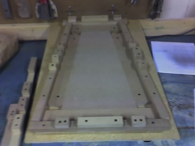

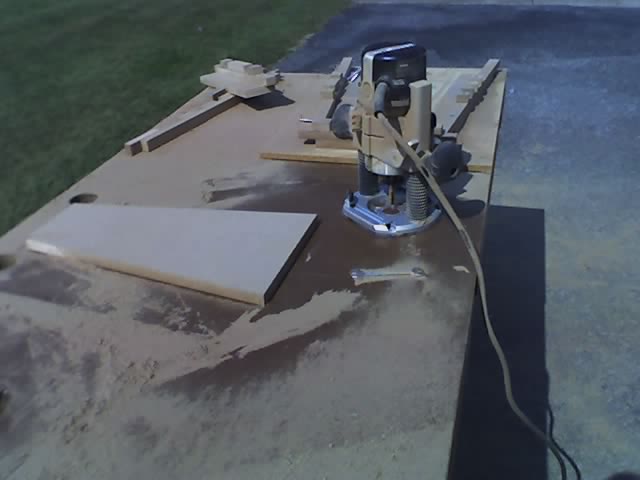

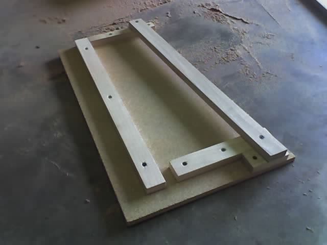

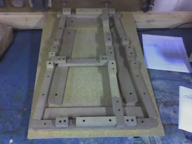

                                                                              Hey guys,
                                                                              Another weekend of progress...
                                                                              To circumvent my distaste of jig saws, I decided to build a jig...
                                                                              In the attached pictures you can see the jig I built to cut the various holes in all the vented braces... There are a lot of whole and half vented braces so I figured making a jig that the plunge router can be used with would be the most efficient method...
                                                                              The braces slide into the jig from the bottom and then are "locked" in with a bottom brace and clamps... There are then two positionable cross members; one vertical and one horizontal... These can be locked into various slots to cut out all the different holes and shapes needed for the various vented braces...
                                                                              Since I want to cut all the MDF outside I wasn't able to test this due to all the rain this weekend... But, bearing any unforeseen issues, I am quite confidant this should work good...
                                                                              Once all the braces are cut I should be ready to assemble the shell of the cabinets...
                                                                              Due to the angled sides of the speakers; I think I am going to assemble the sides of the cabinet to the cross braces and mid enclosures first... Then attach the back and then the front baffle last... At least that is my thinking for the time being... I think that will give me the easiest access for stuffing and working with the ports and running wire...
                                                                              More later...
                                                                              Thanks guys,
                                                                              Mark

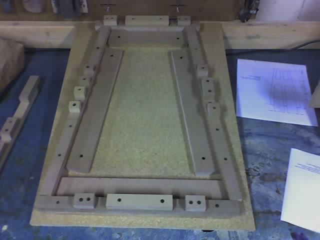

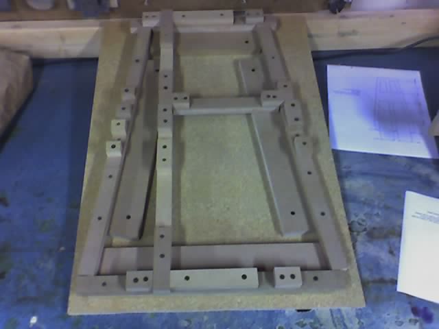

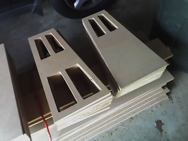

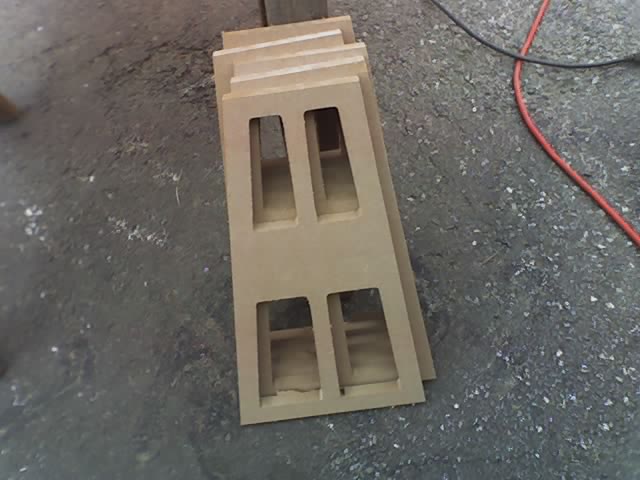

                                                                                    Much progress has been made recently...
                                                                                    Attached are some pictures of all the vented braces that I have cut out...
                                                                                    Good lord there was a lot of dust... 8O
                                                                                    I have the full vented braces cut out and the half vented braces cut out...
                                                                                    Next I will begin to assemble the midrange chambers...
                                                                                    More later,
                                                                                    Mark
