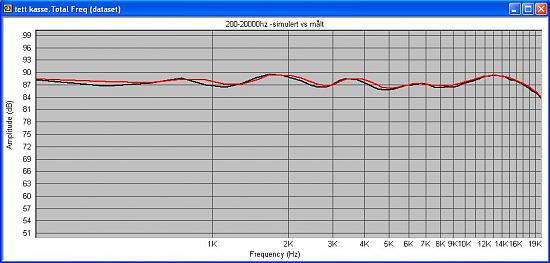

    With new measurement, onaxis to mid, a mug of tea and a lot of sigarettes, the times was come (ones again) to make some new crossovers.

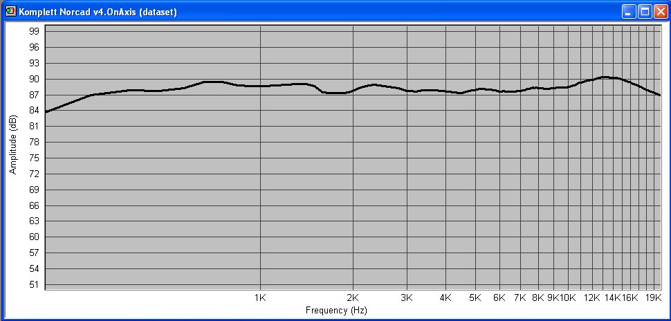

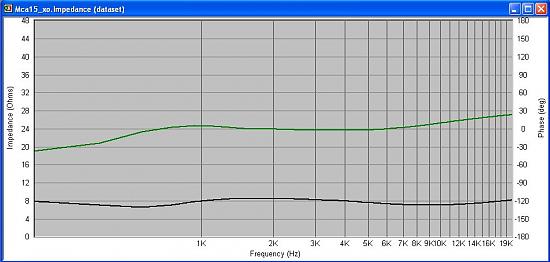

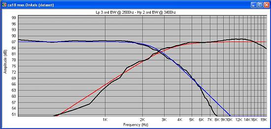

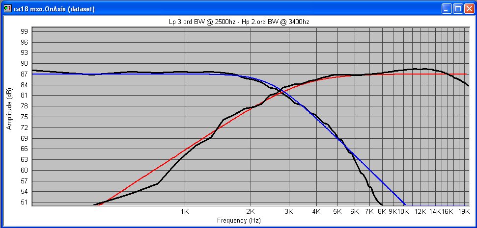

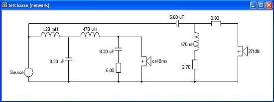

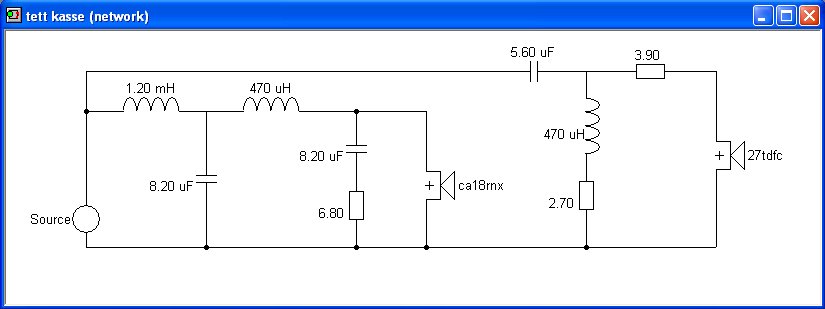

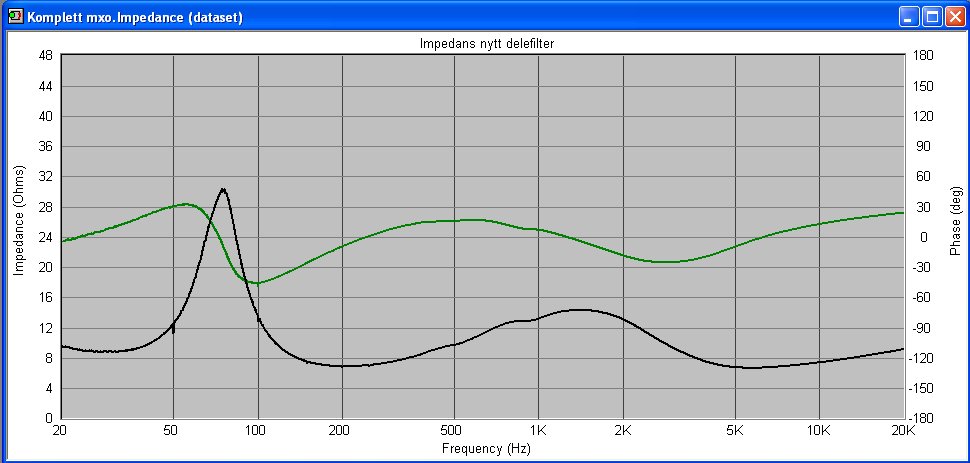

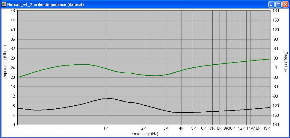

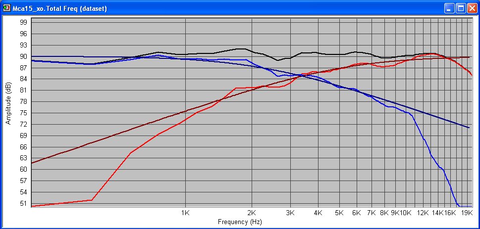

    After a couple og hours fighting with Speaker Workshop, I came up with this:
    And I can tell you right away, this sounds good!
    (But not great )

      Hi norcad,
      Can you tell what part of the spectrum doesn't sound great? According to Zaph's HD sweep, the CA18 (presume you are still using that for the mid?) has a 3rd order HD peak around 1.5KHz.
      Are you listening to a stereo pair or just the one speaker in mono?
      Have you tried a lower crossover point? My excursion modeling shows the CA26 / L26 will give up before a Seas 27TDFC does at around 1.6KHz. A lower point will help off axis too.
      Could you please also post phase response for each driver? Although your on-axis looks nice and flat maybe phase starts deviating from target BW above or below XO.
      Last but not least, since you have designed a removable back panel, if you have some scrap, try putting a scrap piece in half to form the CA26 enclosure and running the Mid OB. I know this might cause more problems than it solves, but that would eliminate any backwave issues through the CA18.
      And one more thought... have you done any HD testing in SW?
      Cheers,
      David.

        Thank you for your reply Dave!
        I actually have a hard time explaining what that doesnt sound great.
        In english its imposible!
        I always start with one speaker, and after constructing a new network, I always listen in mono to check the overall frequency response first, before connecting the second speaker.
        I did try xo points down to 1,8khz before I increased the size of the midenclosure and without this new baffle. But I'm not sure if I agree with you that a lower point will help the off axis response. A small tweeter playing down in frequency, will have a "poor" power response IMO.
        This I dont understand, could you please explain?
        Are you talking about minimum phase? If so, I dont have it. The measurements is taken from 1m, onaxis to the mid for both drivers, without moving the mic. Im sure you know how the phaseplot looks like then?
        I have tried the CA18 OB, without the woofer connected. As you said it made more problems so I didnt try it any further.
        And once again; can you explain HD testing?

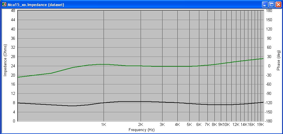

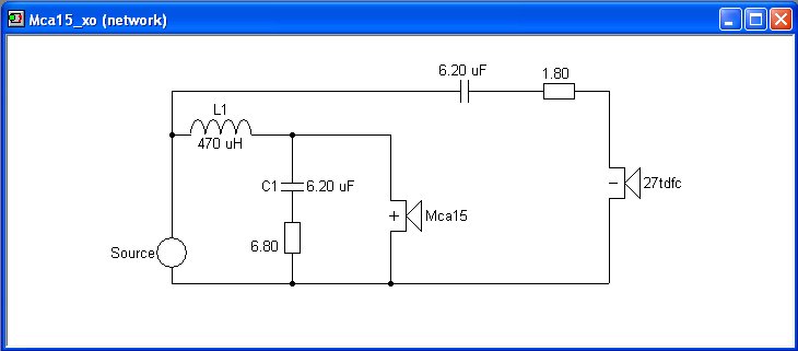

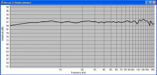

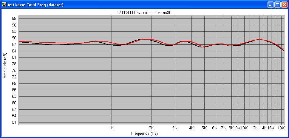

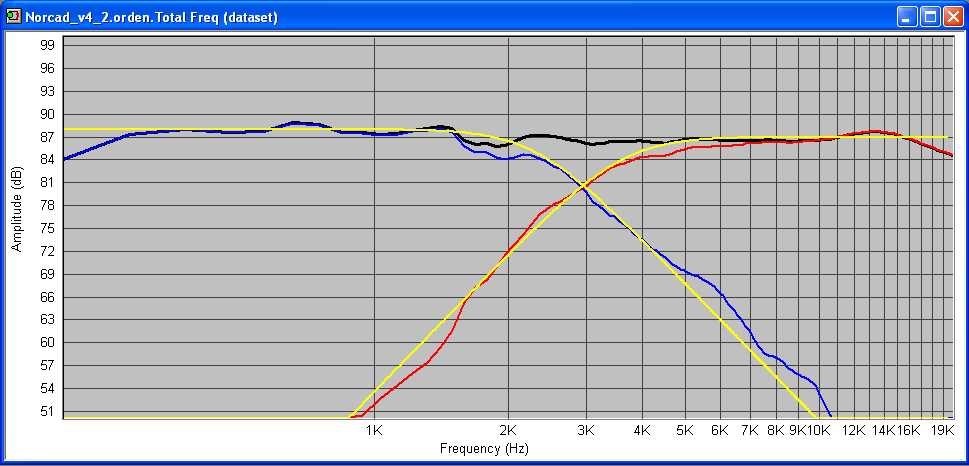

                          Time to move on....

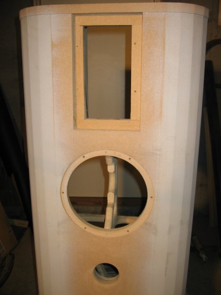

                          An adapter ring of Lexan was made, and the MCA15RCY took the job as mid, instead of CA18RNX.
                          New measurements was taken, and ones again I sat down trying to build a proper xo.
                          I tried both 2. and 3. order, but didnt get the phasetracking right.
                          After a little study of the phase plot, I was surprised!
                          And when I simulated a first order BW, I was even more surprised!

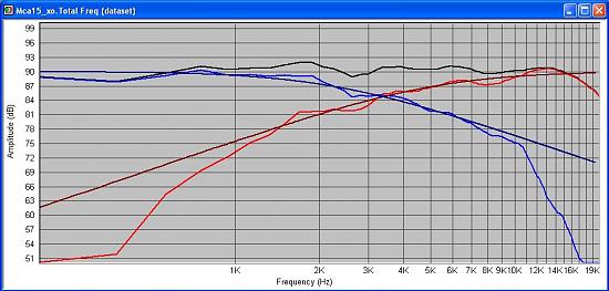

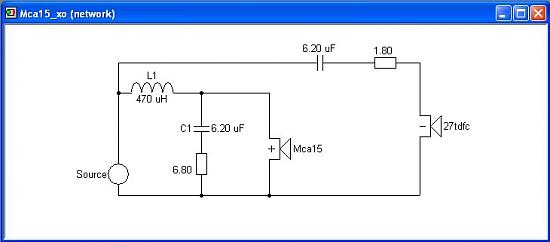

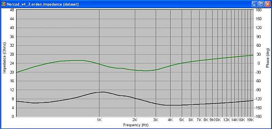

                          Just look at this plots:
                          • norcad
                            • Jun 2008
                            • 84

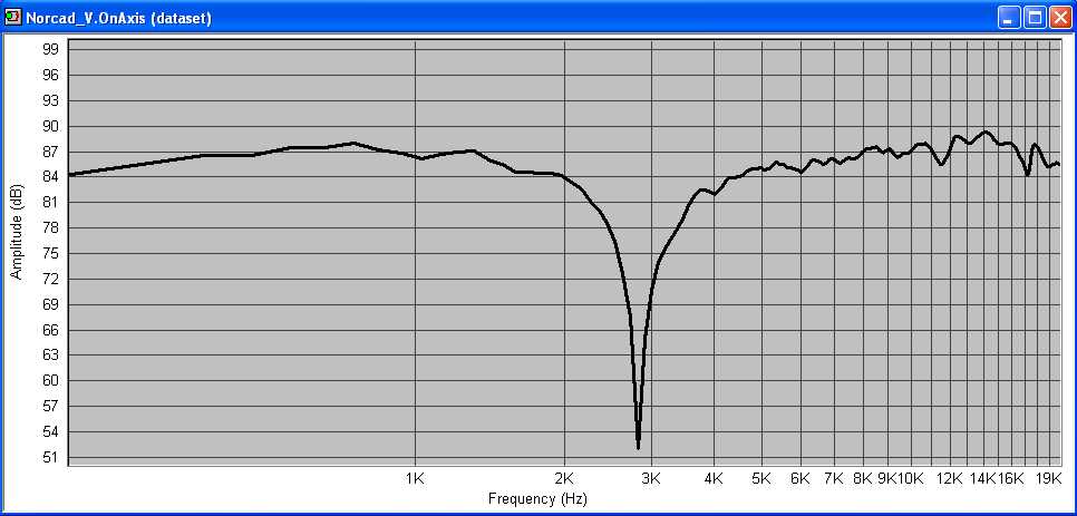

                            Some comments:
                            - The Mca15rcy has a nearly incredible flat FR, better than several fullrange drivers.
                            - First order network isnt my first choice, but this was a surprise that I want to investigate a little further.
                            - The impedanse and electric phase is just perfect.
                            - The sensitivity is pretty good.
                            - The systems FR isnt that perfect As you can see, it has a step in FR from 1,8 to 2,6khz. Measured with Arta, who has a better resolution, its even bigger, and it is on both mid and tweet. This s diffraction from the frame.
                            - The FR also has to much output in the 3 to 6khz region.
                            - Its not theoretical correct first order. The drivers are 6dB down at the xo point, with 0 degr phase between drivers. That makes the power respons a little different, but I'm not sure if its a bad thing.
                            The conclusion? Lets rebuild the baffle once again!

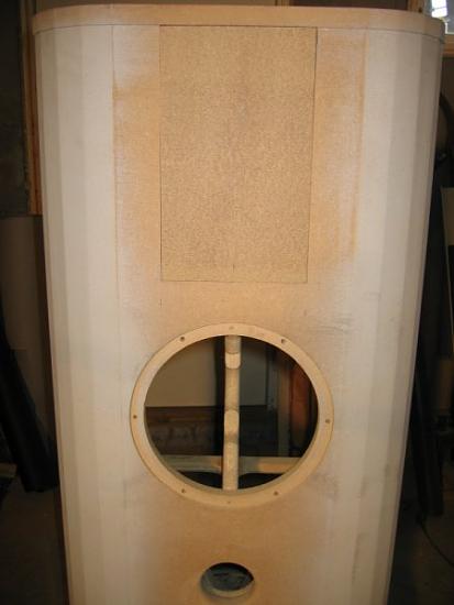

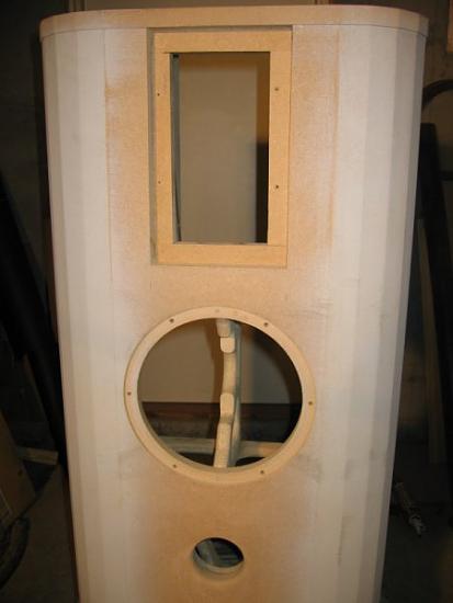

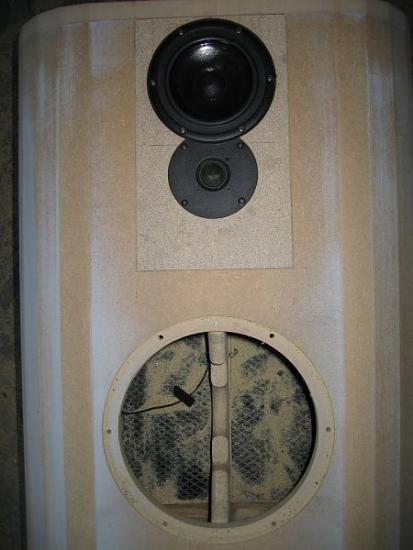

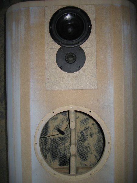

                              The extra (new!) baffle was removed, and a big hole was cut in the front baffle.

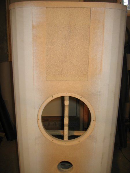

                              A new piece of chipboard(?) was glued into the baffle
                              And after a lot of dust............
                              The midrange is now Seas MCA15RCY, and the tweeter is 27TFFC, just because this has a little higher sensitivity than the 27TDFC.

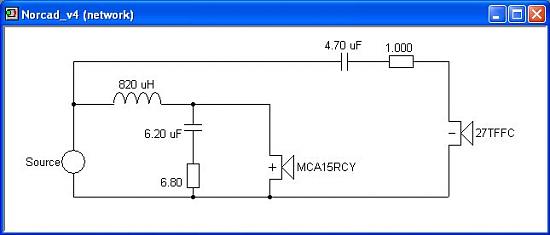

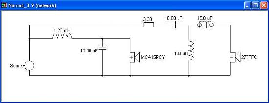

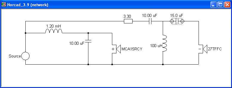

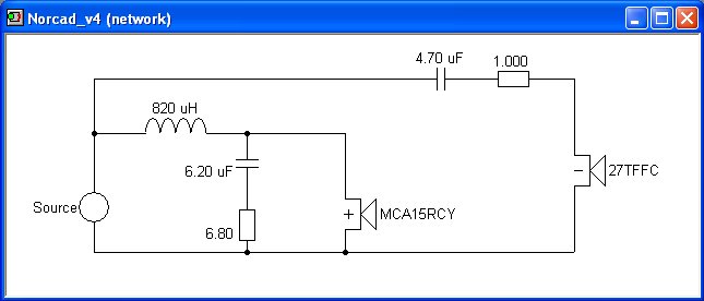

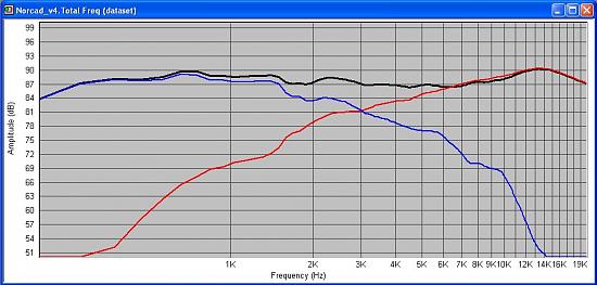

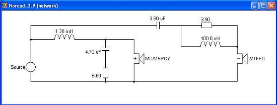

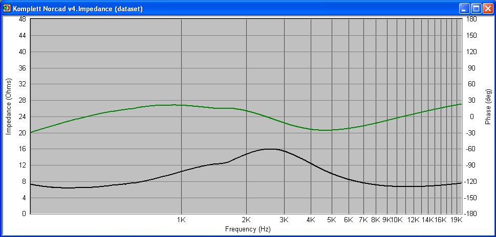

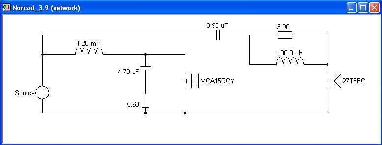

                                Several measurements later, and with a heavy filled mid enclosure, I came up with this crossover:

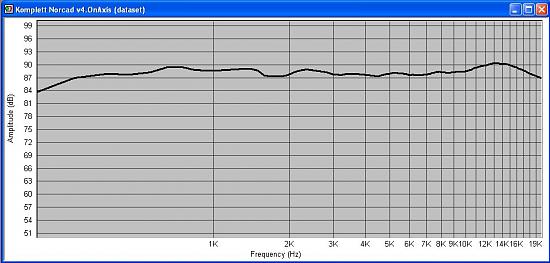

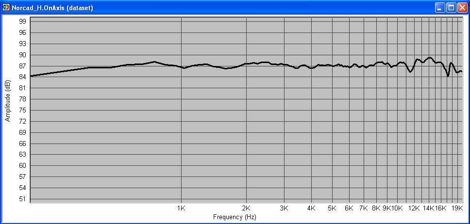

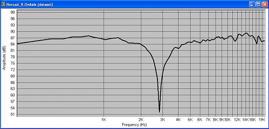

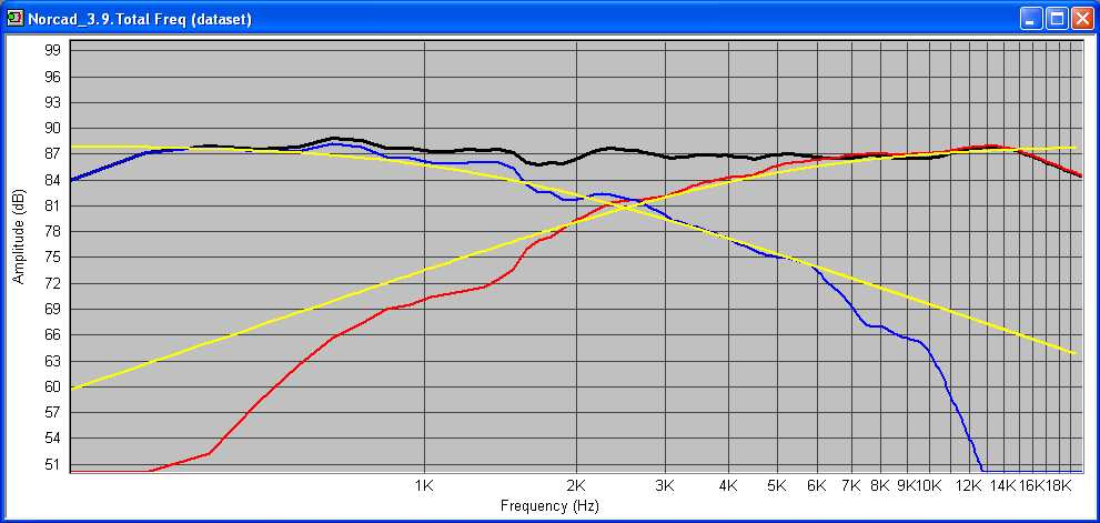

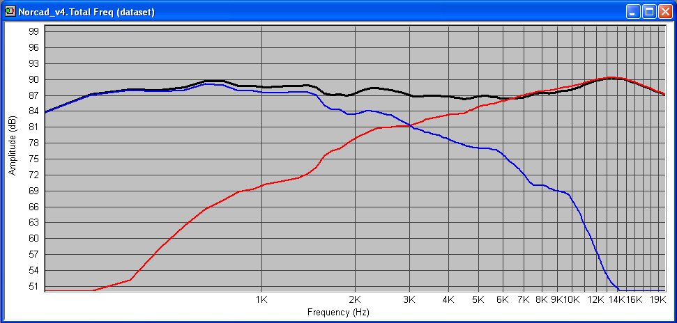

                                And the measured FR looks like this:

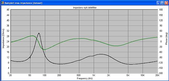

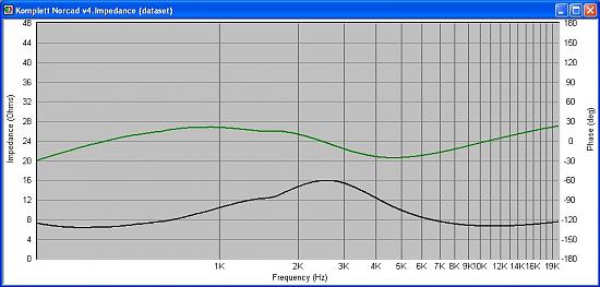

                                The impedance and phase:

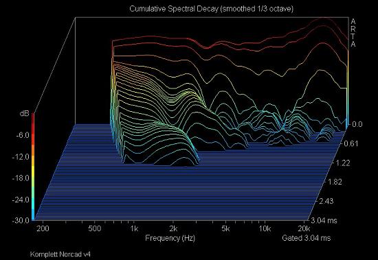

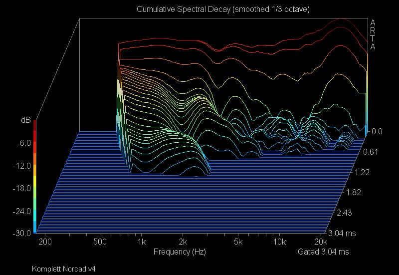

                                And finally, the CSD plot:
                                  Originally posted by norcad
                                  Several measurments later, and with a heavy filled mid enclosure, I came up with this crossover:
                                  First off the XO contains way to many components...
                                  Plots look pretty good..... :T
                                  How does it sound?
                                  • norcad
                                    • Jun 2008
                                    • 84
                                    How does it sound?
                                    Yeah, it will be very expensive with all this components, but good sound costs, right?
                                    With this xo its sounds a little better than good! It sounds great until I play (very) loud, then its a little harch, and the ears get tired after a while.
                                    After a while, I replaced the 4,7uF cond. with 3,9uF, and now my ears like it even better.
                                    Here you can see how its dampening the 3 to 6khz area a little more:

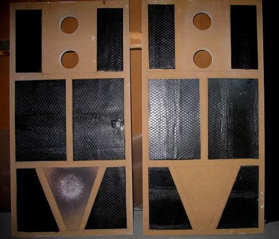

                                        • norcad
                                          • Jun 2008
                                          • 84

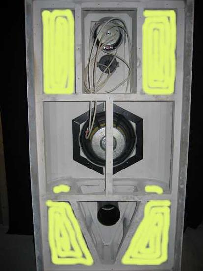

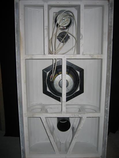

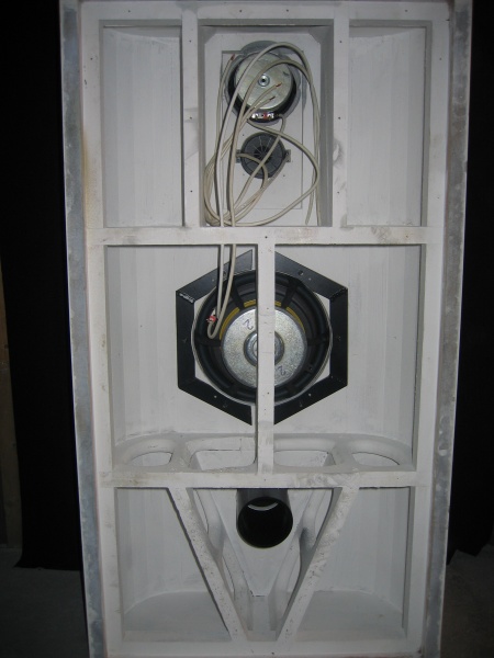

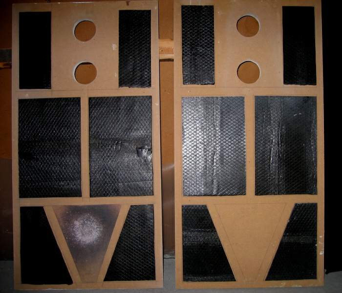

                                          Finally! The speakers are now finished. (I hope) After a lot of "boiling" paint, and me trying to use a paint brush for the first time 8O . I finally was able to get a result that could stay in my living room. I also did some tweaking to get the sound that I wanted. And now I am pretty close to the goal I think.
                                          Lets start with the inside, where you can see the bracing, mid-enclosure, vent and the drivers in place

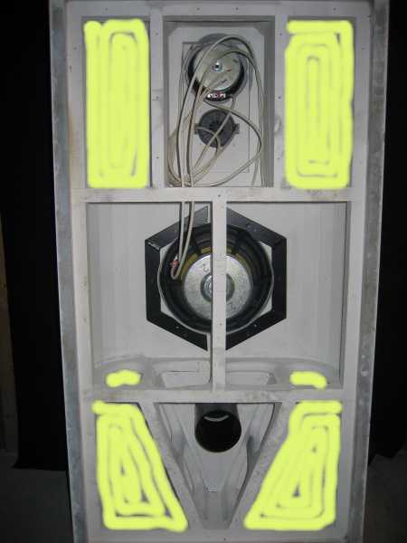

                                          I did several attempts with different dampening material, where to put it, and how much. I ended up with a lot! The mid-enclosure got 5cm thick "house insulation" on both sides, bottom and the back plate. On the back plate, right behind the bass driver I also put 5cm. And on both side of the mid enclosure, and both side of the BR tube, I filled it up. I forgot to take pictures, but you can see what I try to explain here:
                                          The back plate also got 5mm bitumen, like this:

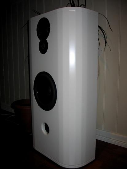

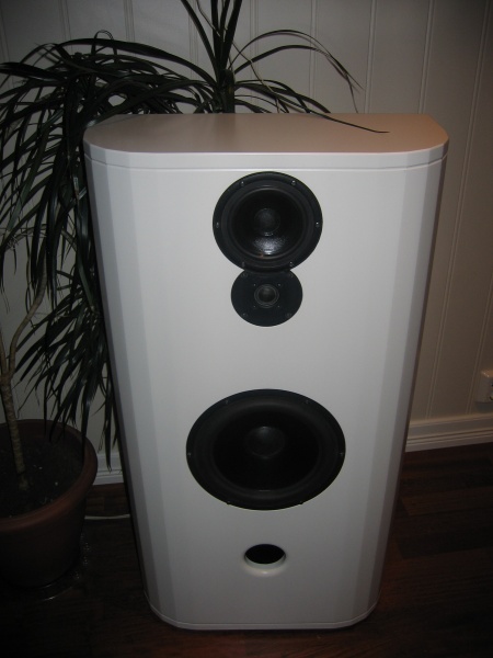

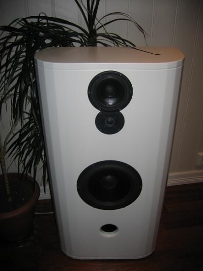

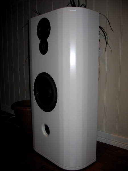

                                          And finally, after the paintjob was done, it looks like this:

                                            Very nice looking speaker there Norcad. Congrats.

                                              With everything in place, I took some new measurements, and did a little adjustment on the 1.order network. I was trying to get the flattest on axis frequency response, and so close to first order roll off as possible, without using to many components.
                                              The xo ended like this:
                                              A bigger inductor on the mid will give a lower sensitivity, and the little inductor on the tweet takes down the peak around 14-15khz
                                              Measured FR at one meter, with 4mS gating:
                                              This did sound good, and I played music with it a couple of days. But as before it wasnt to good when I played really load. And that is what I often do!
                                              So once again I sat down and tried to simulate a new xo!
                                              And after a while I finally did come up with something interesting.
                                              With only 6 components, (like the 1.order xo) Ive got a very good 3.order xo! 8O
                                              Measured on axis FR with 4mS gating:
                                              Reversed tweeter:

                                                And some final measurements:
                                                FR at one meter, 4mS gating without any smoothing:
                                                Impedance and electric phase:
                                                The XO and measurements are just mid and tweet, because I'm using an active xo between mid and bass. The lower xo point are about 340hz, and all the plots are 200-20,000hz
                                                Because of the wide baffle that pushes the baffle step down to the lower xo point, and the use of CA26RFX with a higher sensitivity, I don't need any BSC at all.
                                                The speakers are powered with two Denon POA-2800 stereo power amps, who pushes 200w@8ohm.
                                                The bass drivers handles the power very well, and with Fb at 28-29hz, I've got -3dB at 37hz. Even that the vent is a little on the small side (diam 75mm) I have never heard any whistling from it.
                                                After about a year of trial and error, I finally can sit down, relax and enjoy the music.
