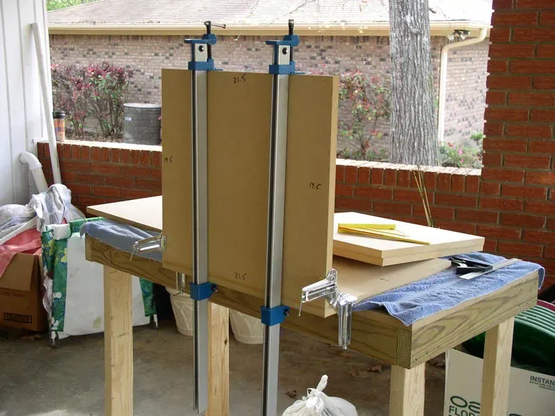

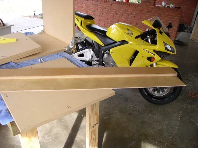

    First, I constructed a sawboard to help me cut the MDF panels to a manageable size. I am amazed at how accurate the thing is after you get accustomed to using it. I didn't even plug my table saw in today!

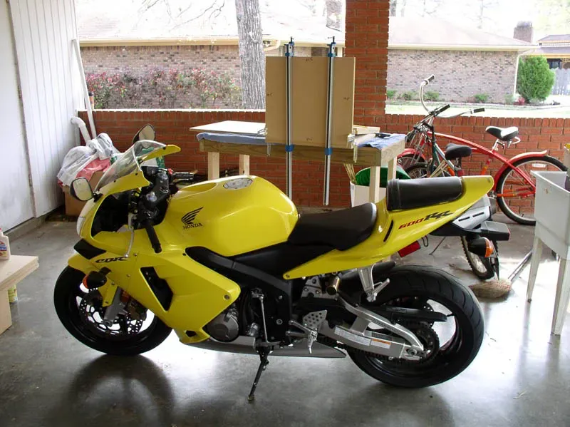

    I cut most of the pieces, the wall thickness will be 2x0.75 in. I cut enough to build most of the box except for the front (driver recess) and one top piece so I can put in the braces before buttoning her up.

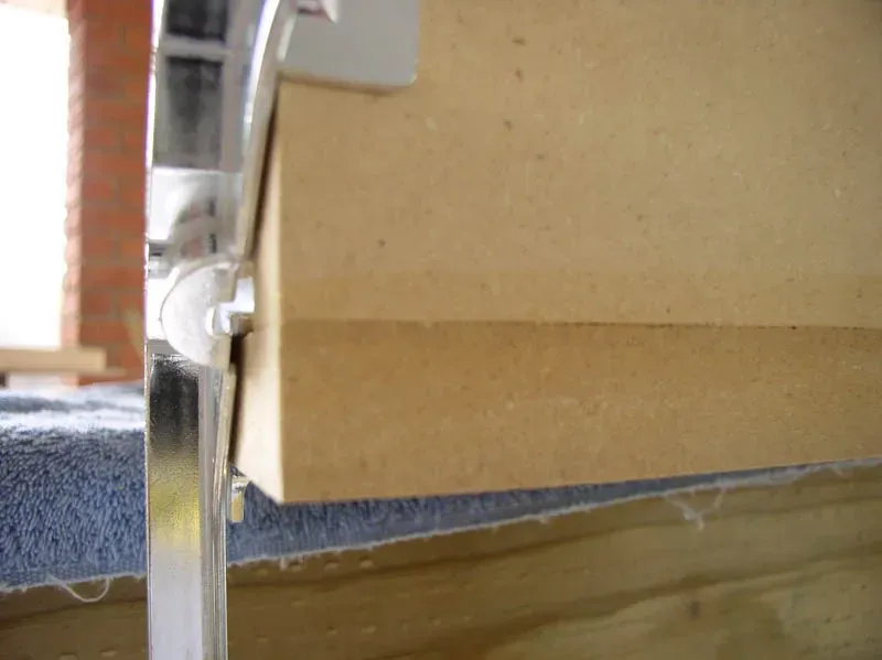

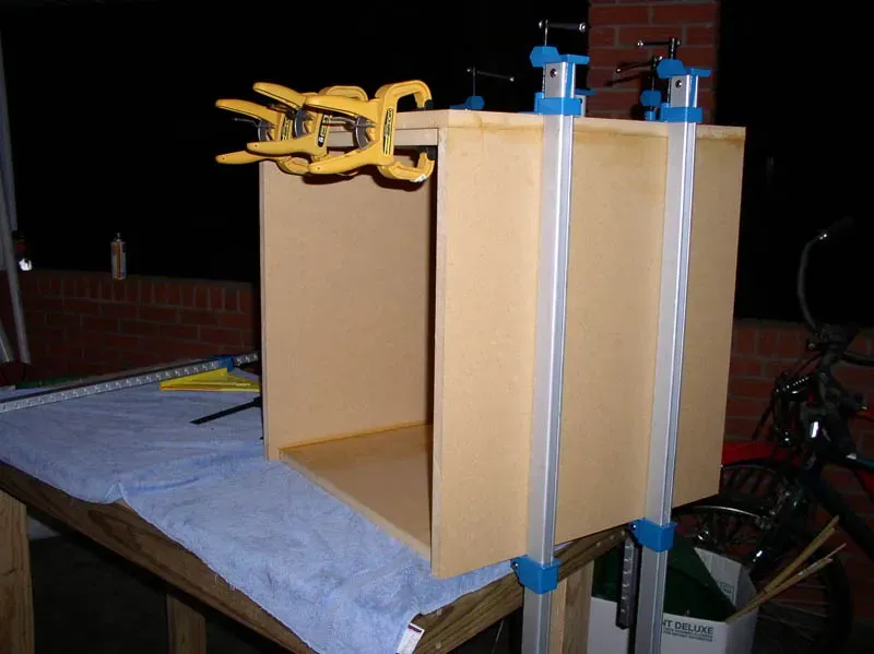

    Here's the first joint! I got some clamps off of eBay, they didn't turn out to be as nice as I'd hoped, but they were cheap. Seem to get the job done so far. Of course, I had my trusty corner clamps there for extra security.
    Here's a close-up of the joint - a little blurry (sorry). The joints are nearly perfect over the entire length or the piece, not bad for only using a circular saw.
    One more pic from a little ways away, death machine in the foreground :T
    I took about 2 hours to clean out the carport so I didn't get as far as I'd hoped. I'm going back out now to get another side or two going.
    More to come...
    Last edited by theSven; 02 August 2023, 19:28 Wednesday. Reason: Update image location

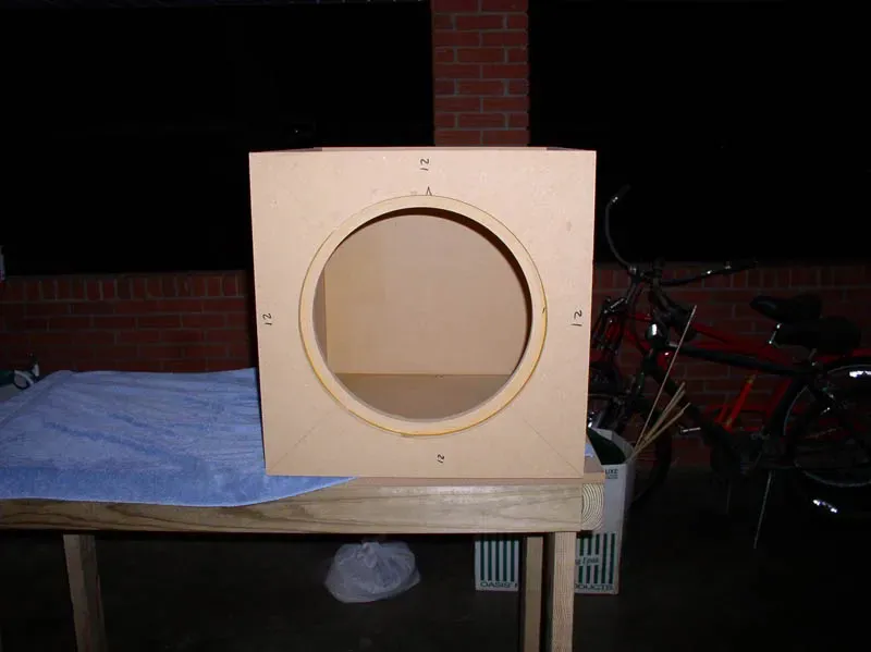

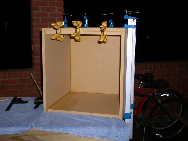

      I was able to get to most of the "outer" box tonight. Have to double up on 3 inner faces, rout the driver hole, glue in the window braces (2), and I'm basically good to go.

      • chasw98
        • 1360
        Excellent start, congratulations. You will want to move the crotch rocket out of the way when you start routing! (MDF in intakes? bad)
        • dyazdani
          • 7032
          Yeah, I always roll it out into the driveway while cutting/routing. I'm going to attempt the driver hole after work if I have time. I need to make a practice run first...

            I'm not sure, but I think the box is going to change the balance and handling when strapped on the back of the bike...:wink:
            • dyazdani
              • 7032
              The way it is going, the box will weigh as much as a person anyway. So it'll be like riding two-up. :lol:
              Danish

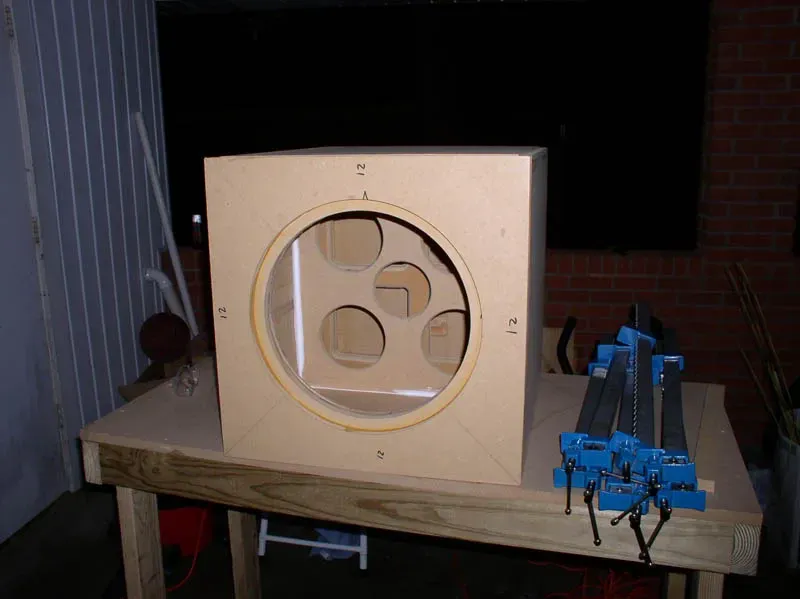

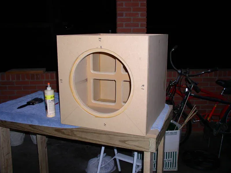

                Routed the holes for the driver and attached the baffle. I am going to add a layer of regular plywood on the inside to have a better medium for T-nuts.
                I have to double up a couple of walls, rout a patch for the binding posts, and add the two braces.
                Now it's finally taking a decent form...

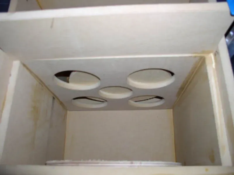

                    • dyazdani
                      • 7032

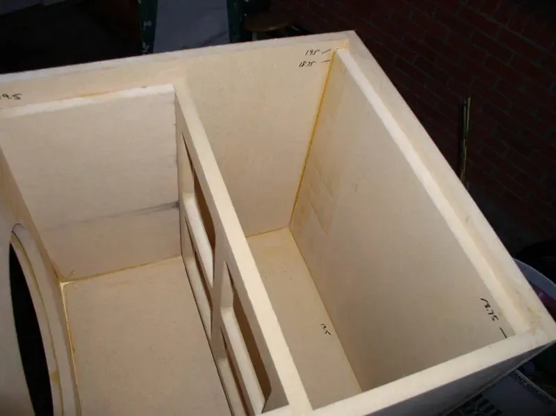

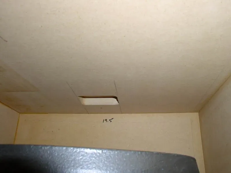

                      Not as much progress today as I'd hoped, took longer than expected. I cut the first window brace (man, that takes time). I also double up on part of the remaining walls, making a slot for the brace. I haven't glued in the brace yet, I still need to rout out a spot for the binding posts.
                      The roundover bit on the brace just about covered the world with dust :E

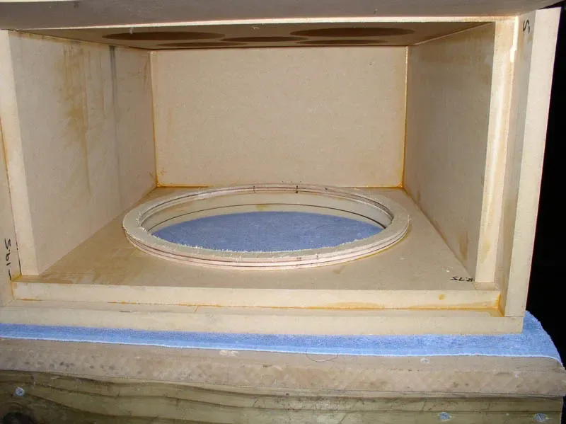

                      I'll put another brace about halfway between the one in the pic and the back wall. I would have liked to even them up, but I didn't feel like taking a chance and putting a brace in that surrounds the driver too closely.
                      I also started to make a plywood ring to put on the baffle. That will create a better surface to install some T-nuts.
                      Another shot...
                      Last edited by theSven; 02 August 2023, 19:31 Wednesday. Reason: Update image location

                                • dyazdani
                                  • 7032
                                  A little closer, got one brace installed, the other one is ready to go for tomorrow.
                                  Also routed a space for the binding posts, just cut through half the wall thickness so the posts have enough room.
                                  Finally, I cut a plywood ring for a little extra support behind the driver...
                                  Last edited by theSven; 02 August 2023, 19:32 Wednesday. Reason: Update image location

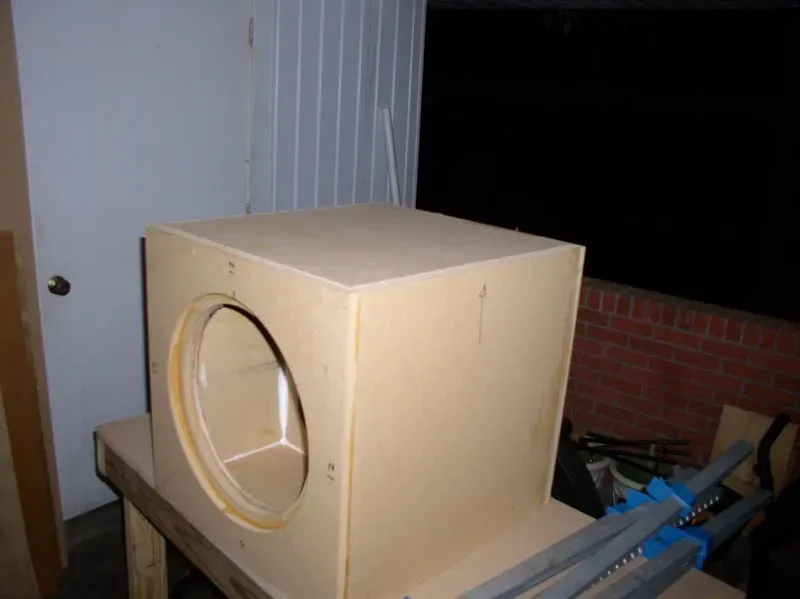

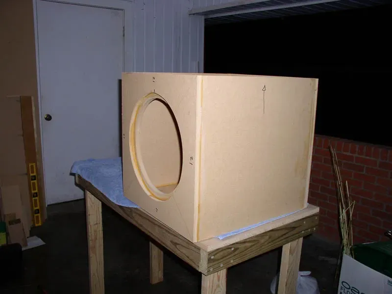

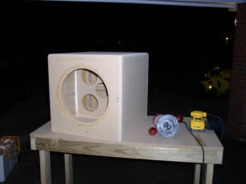

                                    I've got the box assembled and sealed up. I hope to start the Bondo phase tomorrow to smooth out all the edges.
                                    Last edited by theSven; 02 August 2023, 19:33 Wednesday. Reason: Update image location

                                      I started on the Bondo work, got one side done - have to go back and touch up a couple of areas where I went nuts with the router.
                                      Bondo reacts funny with the flush trim bit - covers everything with what looks like shredded white cheese :E

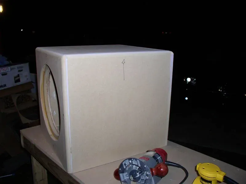

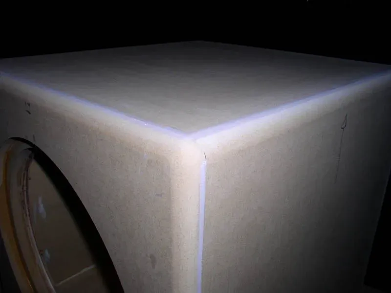

                                                                            I finished the last of the major Bondo work, pretty minor actually. I sanded everything smooth with my new DeWalt sander (does great BTW, thanks for the help).
                                                                            I've got a couple of small places to fill with Bondo where I slipped with the roundover bit (near the ends of a couple of sides). That should take about 10 minutes and then it's cleaning and finally apply some sanding sealer.
                                                                            Corner detail...
                                                                            Last edited by theSven; 02 August 2023, 19:35 Wednesday. Reason: Update image location

                                                                                  Originally posted by steve nn
                                                                                  Hey look at that!..it's really coming along. Nice job on the roundover.
                                                                                  Thanks, the roundover came out nice - except like I say for 2 small spots. I lost track of the router near the end of a couple of sides and it partially "fell off" and cut a little valley.
                                                                                  A dab of Bondo and some hand sanding cleared them up though, looks good as new now.
                                                                                  I'll apply some sanding sealer in the morning and then see what to do about painting. I get a sick feeling every time I see that $50 can of bed liner paint at WalMart. 8O

                                                                                      I take it on that close-up of the corner shot, that it's just left over dust on the top of the box?. Other wise i was going to ask what you sanded with?
                                                                                      On that note. what are you planning on finishing the box with?
                                                                                      As for the sanding sealer. put a good base coat on, Let it dry and do a quick ruff dry sand with 200 or so grit. then put a nice smooth coat on and do a very detailed wet-sand with 400-600. it makes a lot of mess. but keep a nice bucket of water around beside you with the sandpaper in it while you're sanding, keep dipping the sandpaper in the water to wash off the residue. in the end you'll get a nice glass like finish.

                                                                                        Originally posted by opt-e
                                                                                        I used woodfill to fill in any mistakes. Is Bondo better/easier to work with?
                                                                                        I like the final state of the Bondo better (durability, easy to sand, etc). Wood filler is easier to use though, no mixing or anything.
                                                                                        Danish
                                                                                        • dyazdani
                                                                                          • 7032
                                                                                          If you ean the "stripes" they are from the Bondo that I used to smooth out the edges. I used a palm sander to sand everything smooth.
                                                                                          I haven't decided yet - I was leaning toward the bed liner paint, but that $50 price tag has me thinking about alternatives.
