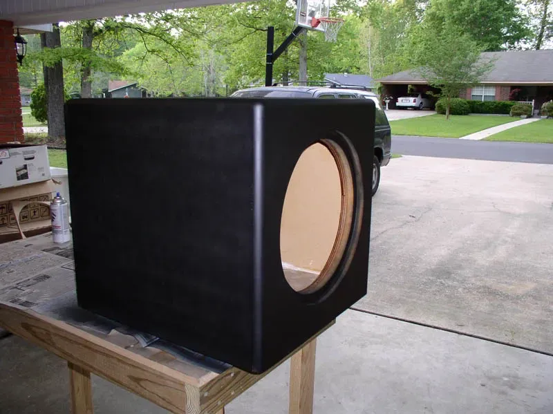

                    Lots of progress today - I sanded the raw MDF with 80, 150, and 220 grit paper. I then applied a coat of sanding sealer - smoothed out with 220 when it dried. I put another layer of sealer and wetsanded it with 400 grit. I wasn't exactly thrilled with the wetsanding (it left some of the dried dust/water residue) so I dry sanded very lightly with 400.
                    I applied one coat (took many light passes) of sandable primer. It looks pretty nice, I could probably live with it by just putting some clearcoat over the primer. I'll sand it down tomorrow and put on another coat.

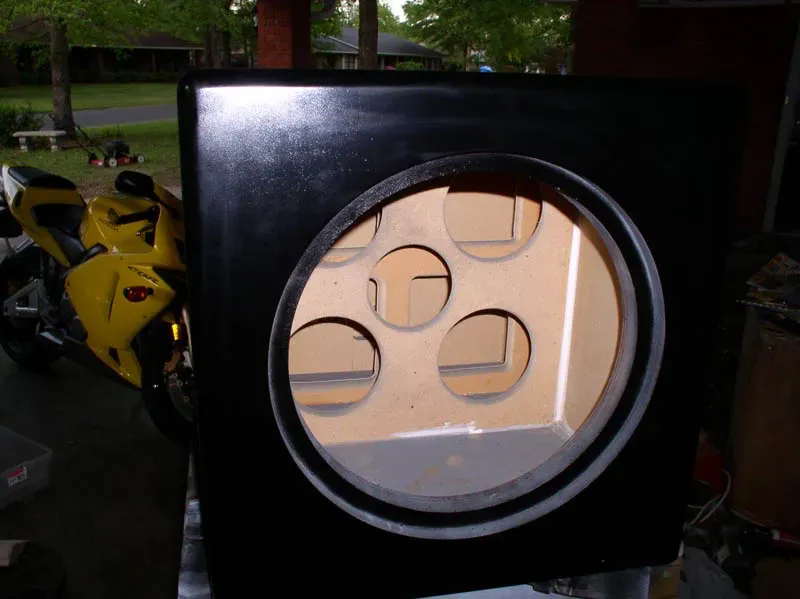

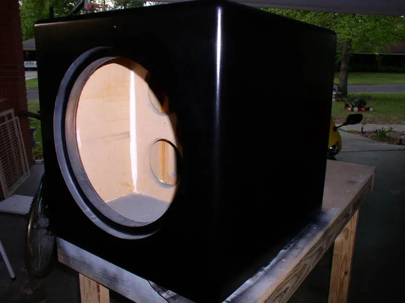

                                    Got one coat of black lacquer applied. It went on pretty easy. The baffle is VERY smooth, can't say the same for the rest, but it's still not bad for a first try.
                                    I'll probably sand the lacquer with very fine paper, say 1000 grit or so and then apply the 2nd coat. Finally, some clear lacquer to top it off and a bunch of polishing... :E

                                      Looking good - I'm assuming that bike is moved way back during spraying?

                                      • khellandros66
                                        • 49
                                        I would go one more coat and sand it down with 2500 grit, then apply the last coat and then buffer it.

                                          YES! I move our nice car out onto the street and roll my bike way out of the way near the front door. I don't want a peppery yellow bike...
                                          I don't know if they even have 2500 grit paper here. I'll have to go back to AZ, didn't see it the other day. I may need another can of lacquer in that case.
                                          Would you sand before putting on the clear topcoat? I'm worried about it dulling the finish or making it turn sort of gray.

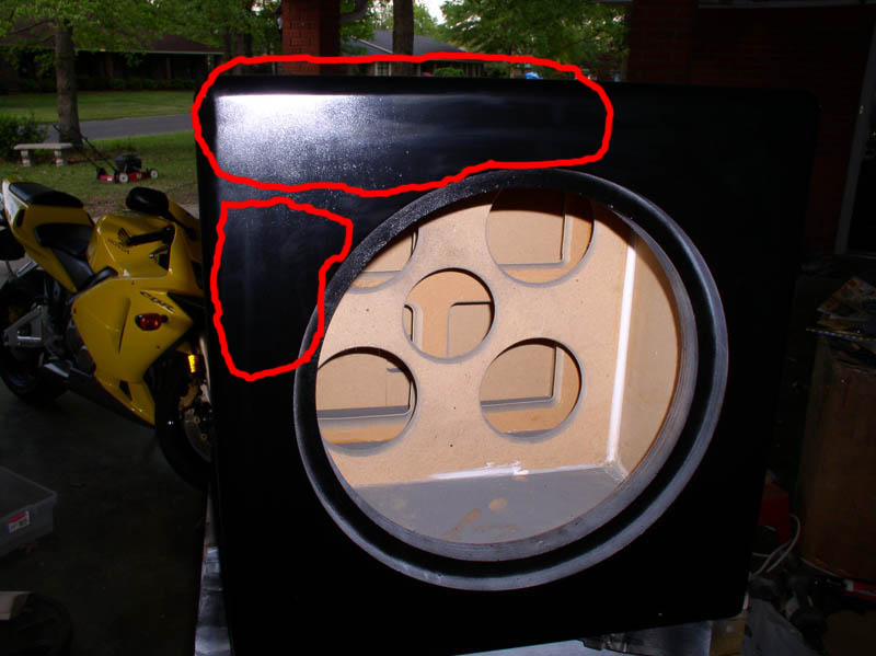

                                                  • khellandros66
                                                    • 49
                                                    I would put one more coat on, sand it with the 2500 grit, then put the last coat on and buff that to a piano gloss.
                                                    EDIT: in the phot the black seemed a little thin so that is why I recommend the above step. This will get you two more coats and eliminate any chance on thinning. 2500 grit is really fine so it won't take nearly as much off as the previous 1000 grit you used.
                                                    ~Bob
                                                    EDIT 2: I circled the areas where thinning appears, I know there is reflection from the flash but this helps bring out thin spots in the finish.

                                                      OK. I'll see if I can find 2500 grit... I haven't actually used the 1000 yet, that's just the finest I have.
                                                      I'll do one coat more, sand it with whatever the finest I can get 2000, 2500 maybe and then put on a final coat, buff it and apply a few coats of Deft (clear gloss lacquer) after a few days.

                                                                                          How many coats total are you at now?
                                                                                          Let's see... 3 primer, 5 black lacquer, and 2 clear lacquer (Deft). My arm is about to fall off from polishing...
                                                                                          Danish
                                                                                          • derekbannatyne
                                                                                            • 196
                                                                                            Wow now I'm glad I decided to use truck bed liner, but I'm sure that yours looks alot better.
