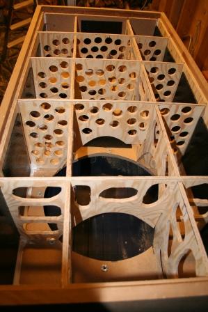

            Some data about the box:
            NN is what you see that the matrix is made of, dont know the english name. Stiff and light material
            Outer size: 120cm x 60cm x 37cm
            Bottom: 2cm MDF + 1cm NN + 1.2cm MDF
            Long sides: 2cm MDF + 1cm NN
            Short sides: 2cm MDF + 1.2cm MDF
            Matrix: 1cm NN
            Top: 2cm MDF (then 1cm air, then 1cm NN, then soft stuff to sit)
            Phase 1: Get the sub up and kicking
            Phase 2: Get the whole thing covered by leather and make seets on top of it
            Regards, Trond-Eirik

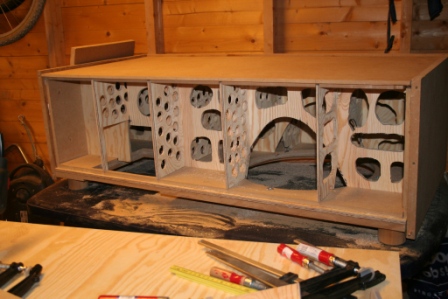

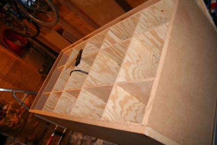

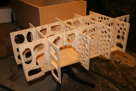

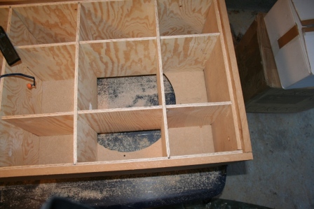

              How does air move between the sections of the matrix?
              Looks interesting.

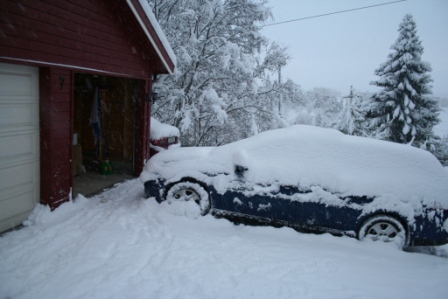

              And the last pic looks almost like it did at midnight when we got home after a trip to visit my grandparents. Had to shovel to get the car into the driveway past all the snowplow leavings.

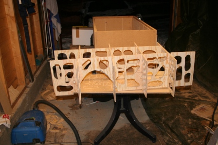

                Some more pics.

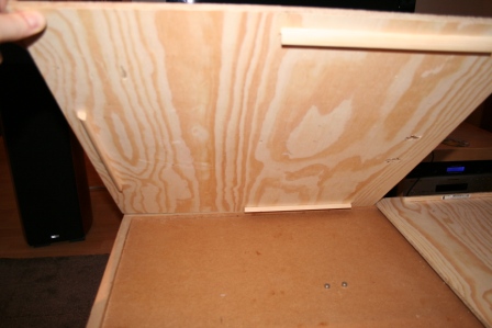

                Now the airflow between the cell of the matrix is handled.
                The inside box also show how the box has fitted tracks that the plates of the matrix is placed into.
                Tomorrow I will hopefully get started on adjusting the top plate as well as gluing the box together...
                I have to buy some stuff first, so it might be a bit optimistic, but we'll see.

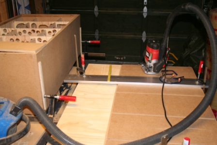

                  Don't let Brian Bunge catch you at that kind of hole making! :P
                  Lookin good.
                    Lookin good.
                    The nice thing about it is that no one is ever going to see those holes (except you folks of course)...
                    So I'm not to afraid about that :W
                    But sure, if I had had the proper tool to drill nice holes with, I would have used it. But I could either go out and by the tools, or get it done...
                    So I got i done! :twisted:

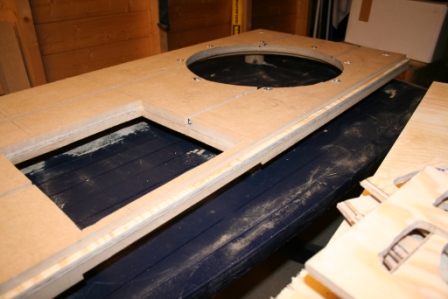

                          Some more work was done this evening.
                          "top beeing prepared 3.JPG":
                          Adjusting the top plate so that it fits and locks into the matrix. I testing it by fitting it onto the sub afterwards. It looked as a very nice and tight fit.
                          (Here you can also see my fabolus workbench :T )

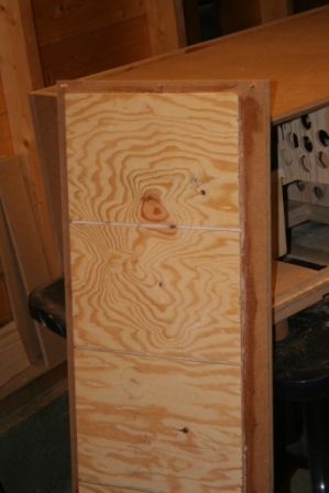

                          "sidewall 1.JPG"
                          Just a shot by the long sidewass sandwitch standing mounted

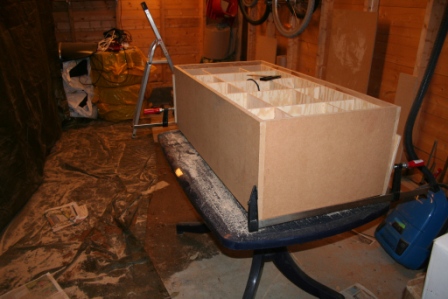

                          "cutout 2.JPG"
                          The box without a sidewall, almost like those fancy pictures beeing shown by the professionals :W

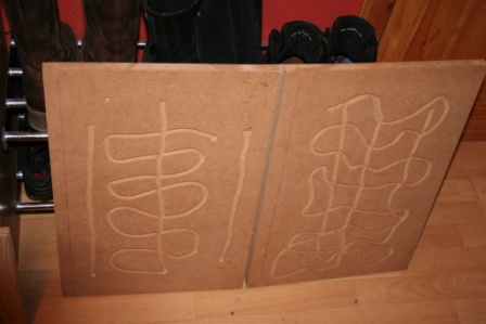

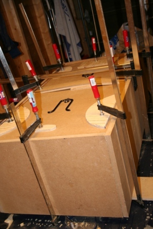

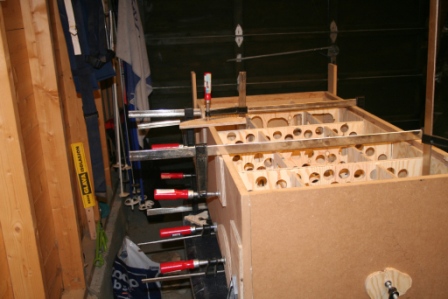

                          "glueing 1.JPG"
                          Finally starting to glueing this baby together...
                          The top will be added separatly after the initially filling is done.

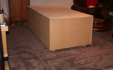

                                      OK, the work is in progress.
                                      Getting closer to the goal every day.
                                      Had a bit of a setback yesterday. The nicely fitted top plate was no longer so nicely fitted after I had glued the bottom, side walls and the matrix together.
                                      Probably the pressure by the clamp + the gluing made some stuff align differently then when I fitted the top.
                                      Got that sorted out and fixed yesterday, but did not get anything else done.

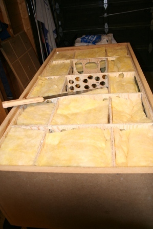

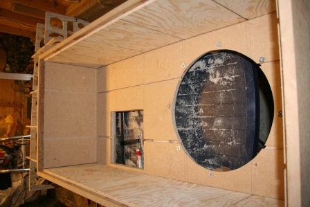

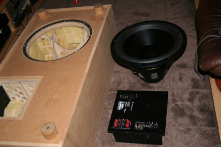

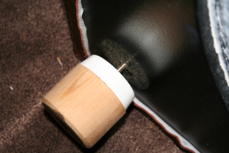

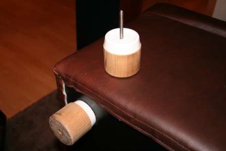

                                      Today I got the box filled, glued the top on and prepared the connectors for the top seat plates.
                                      The 3rd image shows the box ready to be filled. As you can see I have also added some extra damping to the sidewalls by adding some vibration absorbing plates. Based on the nock-nock test, it sounded like it actually did some kind of difference.
                                      I have also used filler and gone over the corners of the box to ensure that it's closed
                                      The 4th image is the box after I have filled it. It's not so fully filled as it looks. Some places there are only a bit fill, and then added a fill plate on top to get it divided out around the box.
                                      I think I have used approx 2.5kilo of fill in the box.
                                      The 1st image show the top after it has been glued onto the box.
                                      The 2nd image shows one part of the connector to the seat plate.
                                      I'm not able to describe how it will work here, so I'll post a describing image when it's connected and working.

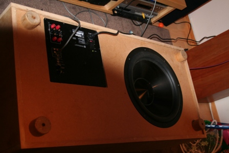

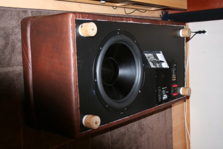

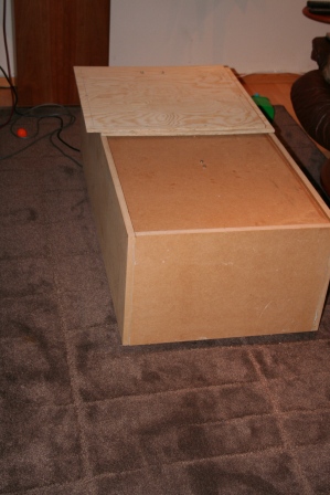

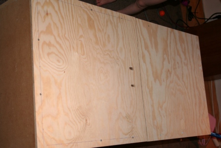

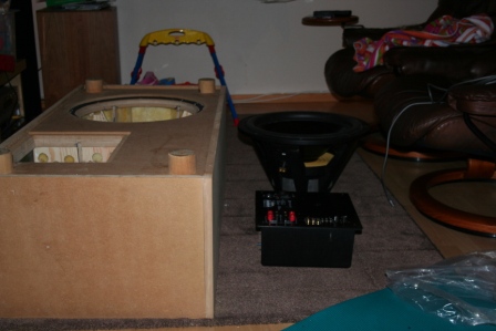

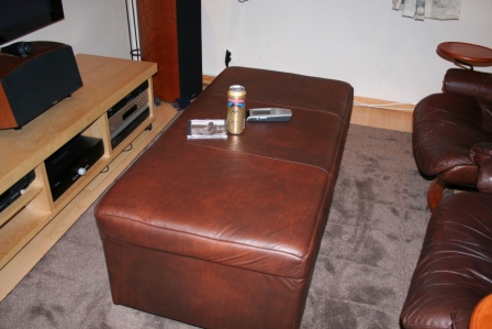

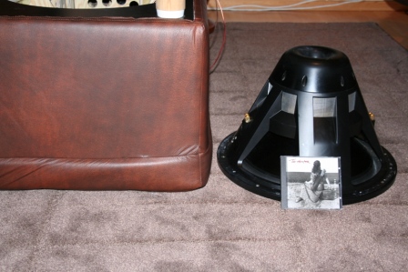

                                        OK, then, finally some more progress.
                                        A few days went by before I got the rest done, but now it's finally assembled
                                        I had to give up opon the top mounting method. I was unable to get a good result. For now I will just have two detachable hatches on top of the sub, as the 4th and 5th image shows.
                                        The hatch "fitting" is a temporary solution. I need something a lot better.
                                        There are two issues going on.
                                        1) Making the hatch fit nicly on top of the sub.
                                        2) Make the hach strong enough and "flat" enought. There seems to be some twisting in the wood.
                                        Any ideas for how this is best done is welcome
                                        So, to the more important part, the SOUND...
                                        NB: based on first/early impression, and I have yet not tuned the filling!
                                        Whoooh... this is something else then my old Rel Storm III! :B
                                        It adds a real fundation to the music and improves the listening expericen a lot! It's a totally different experience than with my previous sub.
                                        When it comes to movies ;x(
                                        It's almost unbelivable. It adds so mutch to movies that was'nt there before that it's incredable. Sometimes I'm a bit afraid that it will tare down my house :E It's really improtant that it's blended in nicly and that it's volume is not to loud, as it's really able to corrupt the sound if the sound level is not correctly matched.
                                        I had no problem getting them to blend nicly with my front speakers
                                        (B&W 803)
                                        I also EQ'ed them to go flat down to 15HZ with no problem.
                                        At the same time I discovered that there seems to be a issue in my system between DD tracks and DTS/Stereo tracks. When playing off DD tracks I get way to mutch bass output. It's not the case when I'm playing DTS tracks.
                                        I have tested this by switching between DTS and DD and there is a huge difference in the bass level. Mutch more than what is resonable due to different mixing.
Name:	Element and amp 2.JPG
Name:	Element and amp inserted.JPG
Name:	top hatch.JPG
                                        Last edited by theSven; 27 May 2023, 09:22 Saturday. Reason: Update image location
                                          After some more testing I find that there is a couple of other issues I'll have to look into.
                                          It might seems like the sound is being compressed at high levels. There's less sound and more rumbling. I think this is due to to low distance between the floor and the sub.
                                          The feets currently on is only 5cm, and was used as a temporary solution.
                                          At the same time I have a 1cm edge between the bottom of the sub, making only 4cm room between the floor and the sub.
                                          I think that having that 1cm edge is a mistake and that it have to go.
                                          What do you folks think?
                                          A issue that is a bit more difficult to do something about is the fact that even if it "looks like a thank", I do have quite a bit of vibration in the sub.
                                          On some volume there is no problem feeling that the box vibrates.
                                          However, there is also no problem feeling that my whole living room is vibrating, so that might not be an issue 8O
                                          What is others experience on that?
                                          Do you actually get your boxes to not vibrate at all, or is that a practical impossible mission when working with 18" elements and 1000W amp`s? :T
                                            In use
Name:	full, with hatch.JPG
Name:	full, hatch off.JPG
                                              • 16142
                                              When you have a large flat baffle for the bass that close to the floor, it produces some slot loading effects which will alter the freuqency response. This can work to your benefit to counter roll off on the top due to VC impedance, but it would have to be "tuned" carefully. If you have measurement capability, I'd look at the frequency response say, about 6" from the edge of the cabinet and floor boundary on one side. Getting the sub as flat as possible in the upper range will help integration with your mains. Additionally, having too little space between baffle and floor may be impacting the LF output in the same way too small a port does- too high a volume velocity, which changes the effective radiation resistance seen by the cone as a function of playback level.
                                              Something to think about.
                                              Yes, when you have something this massive in "full song", it would be hard to expect no cabinet vibration unless you have a push-push balanced configuration with drivers mounted in opposite directions, and a very, very stout cabinet. Consider, for every action there is an equal and opposite reaction.
                                              ~Jon
                                                Congratulations....... :T
                                                If you think the sub is being compressed by the floor, turn the sub on it's side. If the output changes considerably you have your answer.
                                                The other option is that is maybe overdamped (too much fiberglass)
                                                • Bent
                                                  • Sep 2003
                                                  • 1573
                                                  Is the vibration a result of the cab flexing, or is the sub trying to "walk" - Thomas' recomendation to rotate the sub onto it's side will show if that is the case as well.
                                                  (hey, I just realized, I think that's what he meant...)
                                                    Thanks a lot for the input!
                                                    I have actually already tested putting it on the side.
                                                    (when it all comes to all, I do not have the spacing that you recommended in earlier discussions, so I kindof expected this to be an issue)
                                                    To my suprise, the change in effect was a bit less than what I had expected, but I have not done mutch testing so far. So it might be that it's overdamped as well. I'll do some more testing in the days to come, both regarding both issues.
                                                    I think I will try to get it a bit more over the floor anyway as that was the plan from the start.
                                                    And I'll problably get rid of the 1cm edged on the bottom anyway as well. The gap between the floor and the sub is no issue anyway, the only thing I now have to worry about is the total height of the box.
                                                      It does not feels like it's "flexing", it's more a "shake" than flex kindof feeling.
                                                      But I'll think about that as well the next time I'll but it onto the side.
                                                      Hmm, BTW, as the floor is vibrating, so will the sub as long as it's not decoubled from the floor in any way. And I do not have any vibration damping feets...
                                                      But I also think that Jon has a point, there is a lot of power and energi around so it might not be practical avoidable.
                                                      (my next version will be using dual elements in oposite directions :twisted: )
                                                      But then I would probalbly have to reinforce my house first...
                                                        I herby officially joining the "I hate T-nuts club"! :evil:
                                                        Someone should start to manufacture some T-shirts with that text 8)
                                                        I was taking out the driver yesterday, and one of the T-Nuts was not possible to get loose. I had to drill out the head of the screw to get it loose. And as I have used high quality screws, that was easier said than done!
                                                        Well-well, now I have for sure learned it:
                                                        1) Always glue the T-Nuts in place!
                                                        2) Be SURE that you hit correctly when scruwing into them
                                                        Enough said about that.
                                                        Yesterday I finally got around to remove the edges around the bottom, remove some filling and make the feets a bit longer.
                                                        First impression is that it helped a lot. The sound is more defined and I do not get the impression that it's "compressed". I think all effords helped, but I think that the main issue was that I was overdamping the box.
                                                        (I removed 2 full plastic bags of stuffing) ops:
                                                        In the time to come I will do some more testing to check out the effect of adding or removing daming material.
                                                        Just before I did this I watched the last of the LOTR movies. Phu!
                                                        This baby is giving out massage as well as sound :T
                                                        And after the last modifications, I think it's REALLY starting to deliver the goods when it comes to music as well :T
                                                        It's really a gift to have this sub in my setup.
                                                        Now I just have to get some speed on that leather.
                                                        But hay, no one has ever said this was a fast project :W

                                                            The fot of the sub has "built in" vibration dampers. The weight of the sub + loosly tightned screws should cause the whole sub to be connected to the floor only trough these vibration dampers.
                                                            (designed for washing machines)
                                                            Doing it this way makes it mutch easier to move the sub around without having to worry about the dampers falling off.

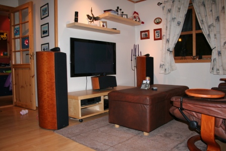

                                                              Some more pictures from my setup:
                                                              There is NO WAY I would have been allowed to have a box of this size here if I had not been able to design it so that it's kindof merges in with the rest of the room/funitures.
                                                              Even my wife likes it :T
                                                              Preparing for some serious testing!
                                                              The new family member in all it's glory!
                                                              The complete setup, image 1
                                                              The complete setup, image 2
                                                              Whoo, would I have loved to have a couple of meters more between the speakers and the listening position :roll: But you just have to make the best out of what you got! 8)
                                                              Last edited by theSven; 27 May 2023, 08:37 Saturday. Reason: Update image location
                                                                Trond-Eirik, that looks absolutely beautiful. Nice job combining the sub function with a good-looking piece of furniture.
                                                                  Wow, very impressive. I would have never thought about covering a sub in leather, but that looks great! How much did having the leather done run you?
                                                                  BTW, this would make another great addition to the DIY Subwoofer Showcase.
                                                                    • 16142
                                                                    Click image for larger version  Name:	IMG_0644.JPG Views:	3922 Size:	58.4 KB ID:	845057
                                                                    Click image for larger version  Name:	IMG_0645.JPG Views:	46766 Size:	69.7 KB ID:	845058
                                                                    Click image for larger version  Name:	IMG_0646.JPG Views:	4616 Size:	74.0 KB ID:	845059
                                                                    Click image for larger version  Name:	IMG_0647.JPG Views:	3819 Size:	67.7 KB ID:	845060
                                                                    Isn't THAT the truth!?! Thanks for sharing the pictures- hope it helps some others out of a "tight situation"!
                                                                    Pretty impressive, actually, hiding it right out in plain sight!
                                                                    ~Jon
                                                                      Way to much ops:
                                                                      But now in the end, who keep track :
                                                                      The leather used is the exact same as used on the chairs, and is bought from Ekornes (trough a regular funiture shop). The problem with this is that to be sure you have good enough areas on the leather, you have to buy twice as mutch as you need :roll:
                                                                      In addition I'm no good with laether, so I had to have someone else to do the work. The foam used under the lether as well as on top to make it comfortable to sit on is also quite expensive.
                                                                      The total cost of the leather, the foam and the work runs up to approx $600.
                                                                      However, I do have quite a bit of leather left for other, smaller projects
                                                                      If you could use another type of leather it would have been cheaper.
                                                                      But I do not think that I would have been able to have this done below $300 to $400.
                                                                        Wow, that is a lot for the leather, but I think it really is worth it. I've learned that I can't put a price on my wife's happyness - whatever it costs!
                                                                        Really, it looks great, and here you would pay almost that much for high quality leather ottoman at a furniture store.
                                                                          The price for the Ekornes dobbeltpallet with the same leather is approx $900.
                                                                          If I were to do this again I would have tought very, very, very long and hard about bying that and modify it instead. Or bying it and just move the leather over to a new box.
                                                                          I did check prices up front, however I did not know that I had to calculate 6 m2 of leather instead of 3.5 m2 as I tought.
                                                                          My initial estimate did also not include the cost of the extra materials needed. Like sitting foam on top and padding all the way around.
                                                                          I blow my budged bigtime...
                                                                          But, what the heck, the wife is happy :T
                                                                          That's DIY :rofl:
