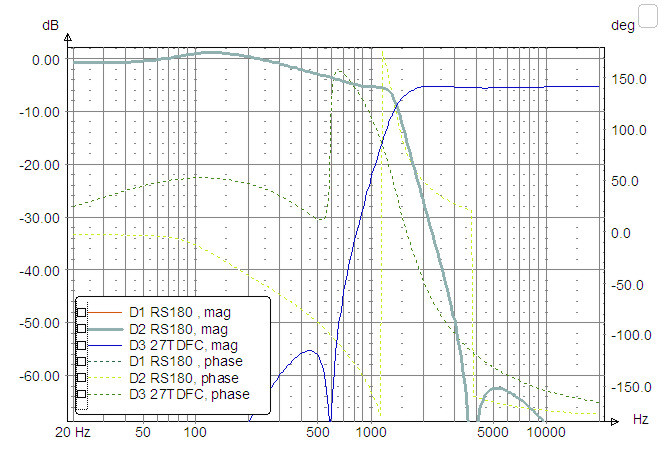

                  (BTW, could I implement a cauer-elliptic in the available digitals? I haven't heard anything to indicate I can).
                  This is something that I've been wondering as well, and also wondering if there was any point to it. Currently(I'm using a Behringer DCX2496) I'm using 8th order L-R between the XT25 and M8A. Would there be any point in going to a 4th order L-R and adding a notch to emulate the caur filter? If so, how deep would the notch have to be, and what is the Q? The DCX has maximum -15dB for the notch filter, but I think I could overlay more than one on top of each other. The question for me is, what would be the benefit of doing so, if any?

                      8th LR has been reported by many to sound pretty poor - and there's the group delay issues (or perhaps that's WHY they sound worse).
                      CE that emulates an 8th order has group delay much like a 4th LR.
                      I have a suspicion that 4th order + notch (or otherwise, a single point steep filter EQ combined with 4th order) might emulate a C-E filter, but the question is not really entirely whether you can get the graph to look the same, but whether the actual transfer function is the same. Though maybe that means the same thing as having the graph look the same. Beyond me at this point still.
                      Why not experiment?
                        Why not experiment?
                        I'd like to experiment with it. That's why I asked how deep the notch has to be, and what is the ideal Q. I guess we'll have to wait until Jon weighs in on this.

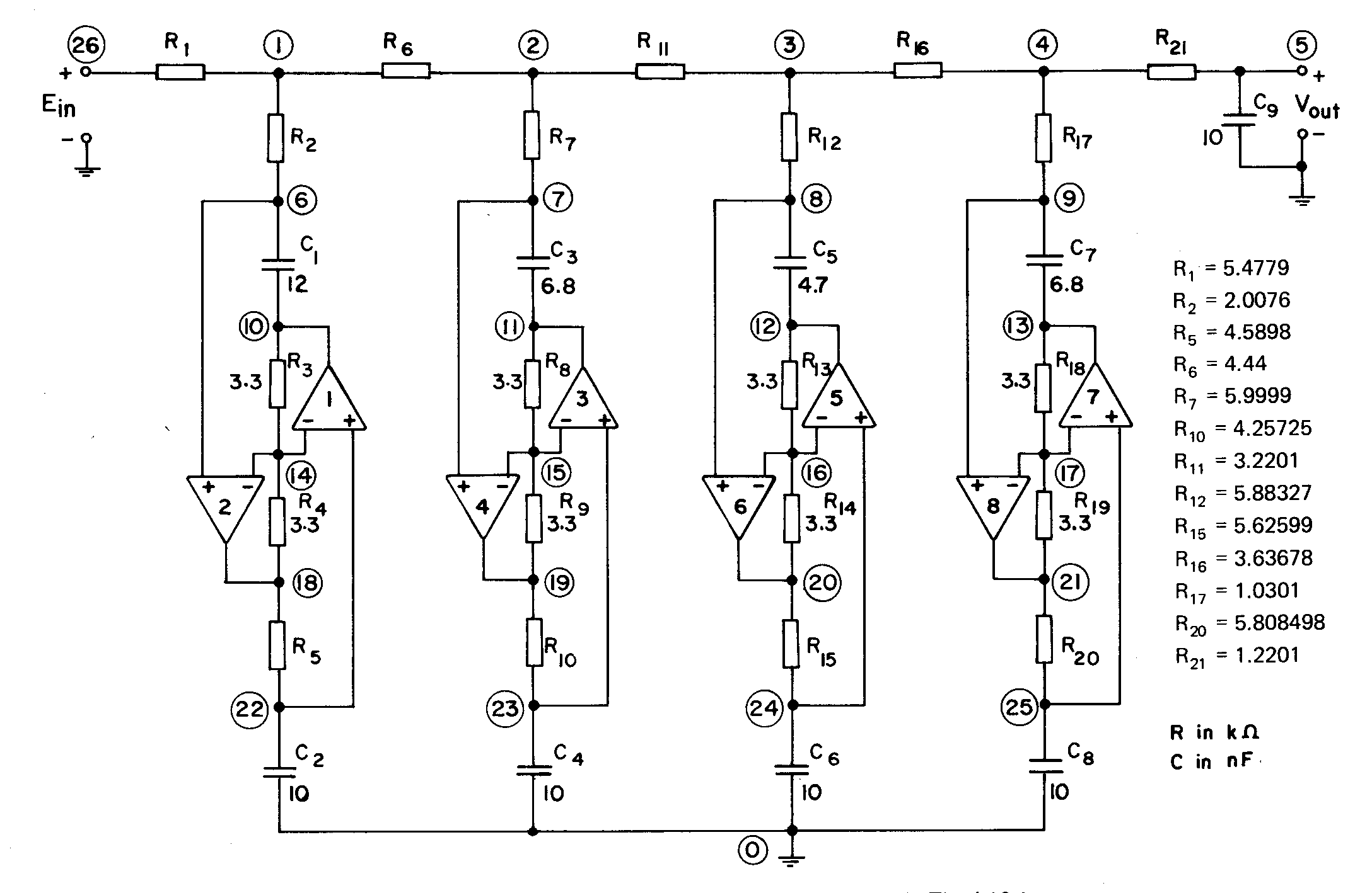

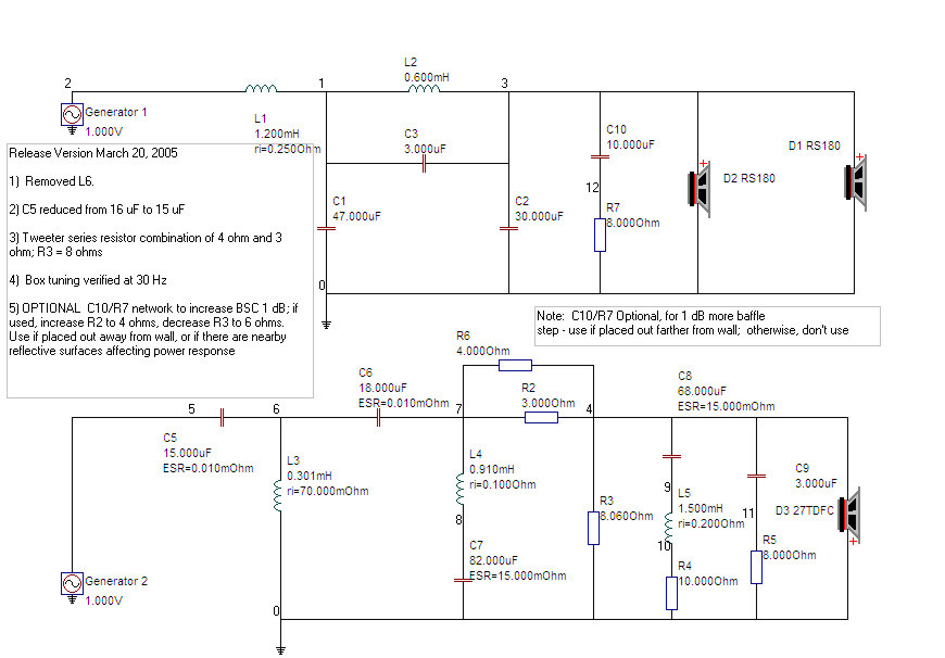

                                    (JPK) If I may, I think it would be beneficial to those who are interested in CE type filters if you obtained a copy of Thiele's paper, Loudspeaker Crossovers with Notched Responses. Thiele treats the subject in depth giving active and passive topologies and design tables for 6th order active and 4th order passive filters. The crossovers sum flat. Odd order filters reduce to Butterworth filters when the notch frequencies are moved far away form the crossover point. Ever order filters reduce the LR type.
                                    I've attached a figure of the passive 4th order type.
                                    While not the "best" digital crossover in the world I believe that both Sound Easy and LspCAD digital filters are capable of emulating these.
                                    Last edited by theSven; 02 April 2023, 14:56 Sunday. Reason: Update image location
                                    John k....

                                      Rons' on the right track there. The advantage to the CE implmentation of what is effectively an L-R 8 (48 dB/octave) is that the group delay and transient response is very similar to the LR4, not the LR8, with different phase characteristic, and IMO this sounds better... This is why I'm not keen on implementing a conventional digital filter approach, unless I can program it completely; i.e., emulate the cauer-elliptic which I use passively.
                                      Makes me kind of passive-agressive, doesn't it? :B
                                      ~Jon
                                      Jon, you can certainly program a 4th order L-R filter and a notch filter (as I said, up to -15dB any Q you want) to emulate the transfer function of the C-E filter. My question is, how deep must the notch be and what Q? Or is this dependant on the actual drivers rolloff, whatever is necessary to "force" the driver into an 8th order rolloff using a 4th order L-R and notch?
                                      DIY_newbie, the DCX output is in phase as much as it doesn't rotate phase 180 degrees on it's output unless you tell the unit to do so. However, as it emulates it's analog equivalent, there is inherent phase shift. Whatever phase shift would be present in a passive filter will be there in it's digital equivalent. As mentioned, some very expensive units don't do this (on the basis of using linear-phase FIR filters).
                                      JohnK, I'll leave it to others to delve into Theile's paper, I suspect the math will be over my head. Perhaps you'd be willing to give us a quick summary of the paper?

                                            John, Thiele's implementation is slightly different than Jon's although they probably get the same thing done. The highpass is the same. For the lowpass, Thiele uses an extra L is series with C2. Jon uses an extra C in series with L5. Jon's travelling on business so he probably won't be able to comment for a while.
                                            DIY_newbie, be careful about semantics when you read the response from tech support. Some people will say that the woofer and tweeter in an analog LR4 or LR8 crossover are "in phase." They are sort of right except the phase has rotated 360 degrees (LR4) or 720 degrees (LR8.) Kinda like if you spin around once or twice you're still facing the way you started but your motion isn't the same as the other guy who never moved.

                                              #112
                                              (JPK) In series with L5 or in parallel? Thiele gives a total of 7 different topologies for the 4th order crossover, 3 different LP configurations and 4 different HP. One of the LP configuration places a cap parallel to L5 instead of in the shunt element. Similarly, for the HP the cap can be removed from the shunt element and an inductor placed in parallel with C13 in my figure.
                                              To answer Ron's questions, Thiele basically develops the transfer functions for notched responses that sum flat from 3rd to 8th order. He introduces a parameter, K, which is equal to Fnhp/Fx for the HP and Fx/FnLP for the LP section where fx is the crossover frequency and Fn is the notch frequency in the hp or lp response. Thus he can shift the notch frequency at will. As k gets small (notches far from Fx) the even order responses reduce the LR filters and the odd numbered to Butterworth. With his formulation the filters are symmetric and have the same GD for the HP and LP sections. Like what Jon described, the GD for the 4th order notched response is very similar to the LR4. As I indicated in my initial post, Thiele provides design tables for the 4th order passive crossovers at 4 different values of k (0, 0.4472, 0.5, 0.5774) (k^2 = 0, 1/5, 1/4, 1/3). He also provided design tables for active implementation of a 6th order crossover at 3 different k values. In that case two stages of ordinary 2nd order Sallen & Key filters are cascaded with a 3rd 2nd order Sallen and Key type filter with a bridged T network to provide the notch.
                                              Is the paper worth $20? I guess it depends on your interest. I got it when it first came out in 2000 when it was still $5. I don't think it would be found in a library since is a preprint, at least my copy is. Perhaps it found its way into the journal.
                                              John k....
                                              Music and Design
                                                #113
                                                Oops, you are right, John. The cap is parallel to the coil. Here's the schematic and electrical transfer function for the Modula project. Jon should speak to this himself but I believe the design goals include LR8 initial acoustical rolloff and stopband ripple at least 40dB down because these filters have equal voltage ripple in the passband and stopband. Did Thiele address the ripple issue?

                                                  (JPK) Yes Thiele addresses the peaks. The k values he specified, 1/3, 1/4, 1/5 are for stop band peaks after the notch of -30, -35 and -40 dB in the 4th order alignment. Those seem to be the peak levels he targets throughout the paper, regardless of order. The phase after the notch is 180 degrees compared to the complimentary filter so, for example, if the peak above the notch in the LP is at -40dB, the HP section will have a peak of 1.01 or 0.086dB at the LP notch frequency. I also note that Jon's HP section LC shunt in the second leg where as Thiele's has the LC shunt in the first leg. Some of Thiele's other topologies are interesting since they involve coupled pairs of inductors.
                                                  FYI, the peaks are at -40dB for the plots I posted.
                                                  John k....

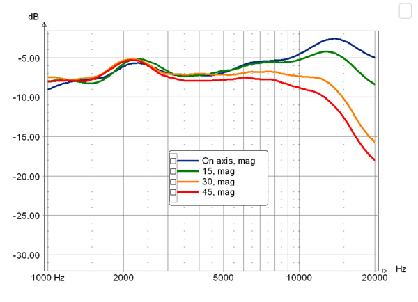

                                                                              The baffle size and layout was done with a disregard for esthetics and common (but possibly flawed) thinking that baffles must be narrow for visual appeal and/or stereo imaging.
                                                                              My theories (right or wrong) were that the baffle needs to be wide enough for the 2-15" drivers, and large enough for decent bass response from the 2-10" without excessive filtering/electronic manipulation. Once that size was established I used a couple of baffle simulation programs (the Edge and one other that I forget right now) to establish the driver locations with the best (smoothest) frequency response.
                                                                              The plot of the tweeter only measured in the finished baffle at various angles is shown below with 1/6th octave smoothing.

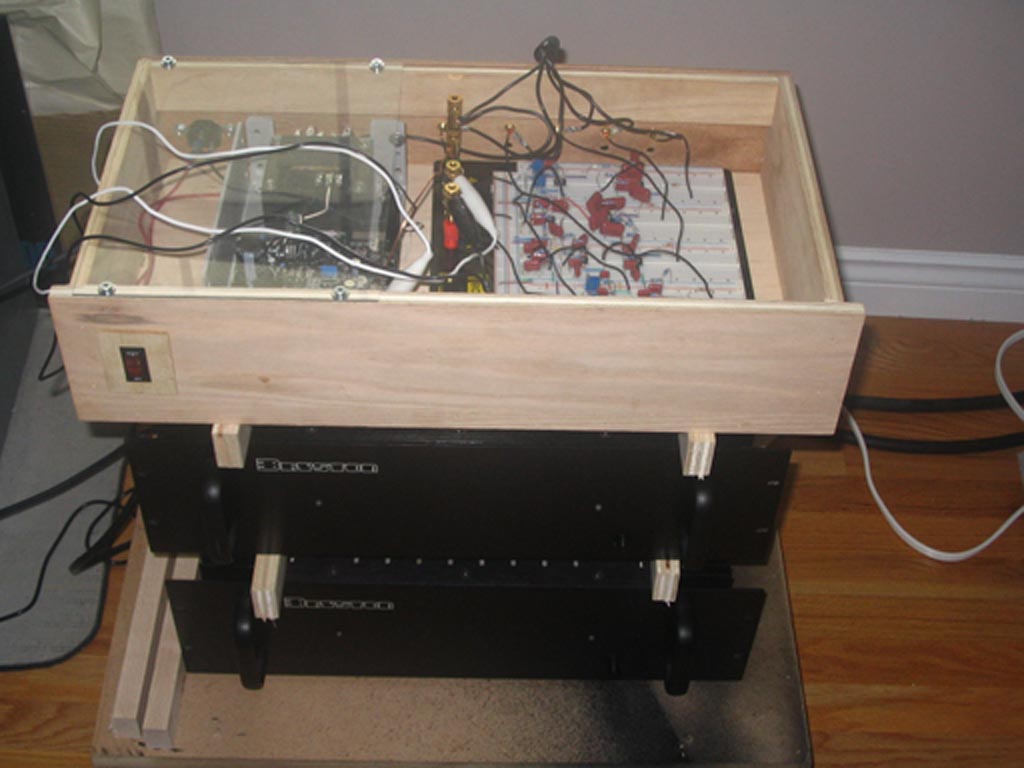

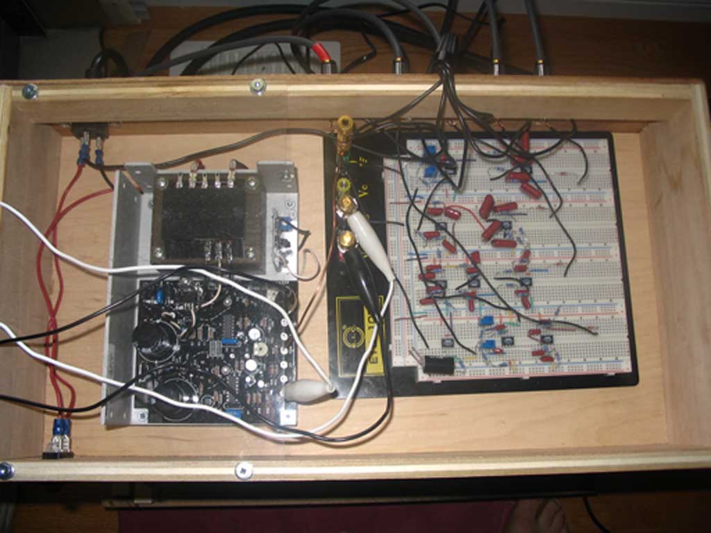

                                                                                          Making progress .. I've got a working crossover for one channel - so I can play music from one speaker. The crossover is, as you can see, slapped together in a quickly made wooden crate with a plexiglass cover over the power supply (120 volt power feeds - safety first) and alligator clip feeds - a thing of beauty it is not.
                                                                                          Anyway, it works, and splits the frequencies 4 ways to pretty well where they were modelled by LSPCad :T . I've got much more testing and tweaking to do, (killing resonance frequencies in the mid, tweaking tweeter crossover frequency, extending low end bass are first on the list) but it's fantastic to finally have a working prototype - it's been 9-10 months since I started thinking about these.
                                                                                          Initial impressions on the sound - superb, clean and powerful. Dipoles are occasionally accused of not having enough 'oomph' or 'slam' - I think the 15's and 10's to cover the lower end have taken care of that. A well-recorded guitar riff doesn't sound like a well-recorded guitar riff - it sounds like there's a stratocaster and guitar amp actually in the room.
                                                                                          arty: I think I'm going to like these ...
