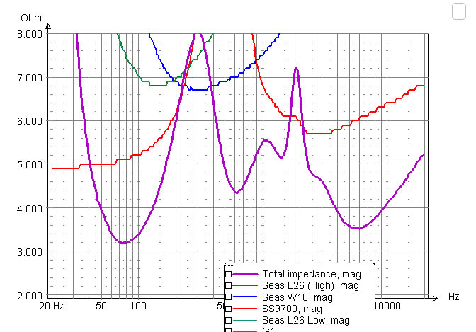

                            I did some more modelling today, and got a +4 ohm reasonably smooth impedance, except a dip below 100 Hz, which shouldn't matter, as I'll be cutting off below ~100Hz with an active filter to go to separately amplified 15" woofers.
                            I'm heading towards a hybrid, with a passive speaker containing 2-10", 6.5" and the tweeter. It appears this speaker could cross over to a sub at a typical 80Hz setting, but I'll be crossing higher as noted above.
                            I've got 2nd order crossovers at ~400Hz and a cauer elliptic at ~2000Hz. I started with a 4th order for the higher crossover, but added in the extra cauer components to beat the "Excel breakup mode ringing" into submission. :wink:

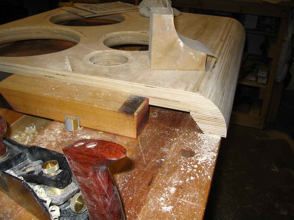

                            Since my initial speaker measurements I've modified the baffle (added segmented 4" radius curves each side) and given the speakers some run-in time. I'll need to do the measurements over complete and them I can start to finalize the crossovers.
                            Paul

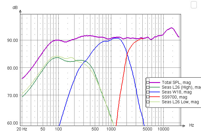

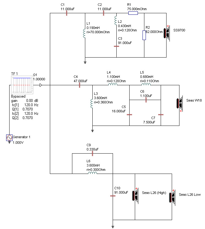

                                                I flush-mounted my tweeter and re-measured (okay, I surrounded the tweeter in cardboard) with much smoother, flatter results except above 10kHz. Then I did some modelling. This is what I have so far:
                                                Crossover Schematic:
Name:	Dipole crossover schematic.jpg

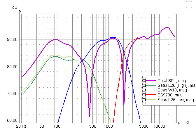

                                                Frequency Response:
Name:	Freq Response.jpg

                                                Impedance:
Name:	Dipole Impedance.jpg
                                                The low end (100 Hz) drops off a little early with a slight hump at 350Hz, but those were trade-offs to get in-phase response at the crossover.
                                                There are no impedance compensation adjustments. The resonance modes from the seas drivers are down 60dB, as is the response from the tweeter at its 500Hz resonance peak.
                                                I have a small cap in parallel with the woofer inductor which seems to work wonders on the woofers breakup resonance at 4-5kHz. This type of filter isn't from a book, but is sort of an adopted cauer elliptic type thing, which seems to work - is there any problem with using this cap here that I don't know about?
                                                Any comments, suggestions, etc on either my overall approach or details are much appreciated.
                                                Paul

                                                  It looks like you're making a lot of progress, Paul. That cap is in the right place for what you want to do- just like acrosso the second inductor in the Arvo midrange crossover, for example.
                                                  I think your crossover frequency for the W18's should be about perfect from a power handling viewpoint- the W18 is one of the few drivers with great ETC plots even up to 1.8 kHz.
                                                  Do you have the Pro version of LspCAD? Can you try emulating this through the PC sound card to give it a listen? Am I correct in assuming that the plots you show are for TF1 bypassed (not in circuit, effectively?) Would be interesting to see how the off axis stuff looks, say, out to 30 or 45 degrees at least.
                                                  If you keep steaming along at this rate, you'll get this finished before I do my current version of Arvos! Of course, it would help if I would stop changing drivers or configuration, wouldn't it?
                                                  Keep us posted!
                                                  ~Jon

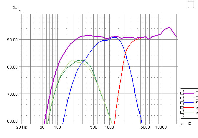

                                                    The reponses shown above are with the active filter bypassed - when the filter is on at 4th order 120Hz it looks like this:
Name:	Dipole with active 120Hz xover.jpg

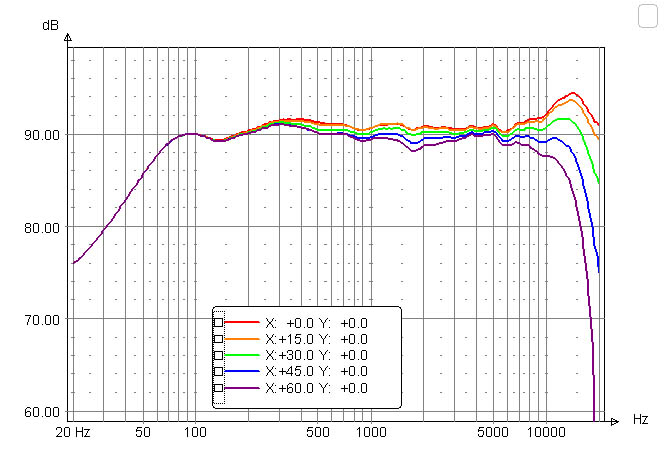

                                                    The off-axis response looks like so (per the LspCAD simple simulation):
Name:	Dipole Offaxis.jpg
                                                    I would like to try the simulator, but unfortunately I don't have the professional version of LspCAD, and the regular version only has two channel simulations.
                                                    Paul

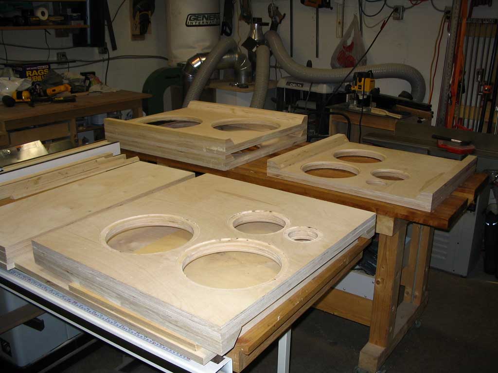

                                                            I've been making a little progress here and there. I've decided to hold off on ordering components until I can re-measure the drivers in the finished baffle.
                                                            The photo here is the partially completed baffles (2 top, 2 bottoms) with the drivers holes cut:
Name:	dipole baffles.jpg
                                                            The next major piece of work on the baffles is rounding over the edges at each side of the panel to an approximately 2.75" radius. This is being done by cutting away multiple sections for the curve on the table saw, followed by hand planing close to a penciled-in curve on the end of the panel, followed by sanding using a custom-made wooden sanding block shaped to the curve's radius.
                                                            The almost-finished curved edge, along with the plane and sanding block are in this photo:
Name:	dipole baffle roundover.jpg
                                                            Just a little dusty
                                                            For anyone who's noticed the overall width of these baffles and are wondering, yes I do have full wife approval to build speakers as high and wide as I want, as long as they're going in the basement. The rest of the house is subject to the usual rules of invisible sound systems
                                                            Paul

                                                                    Jon posted some interesting comments re active/passive filters in the Modula MTM sticky thread, and I thought I'd ask for clarification/comments here rather than derail the other thread.
                                                                    As a quick summary, this thread was started to document a 4-way with 2-15" crossing at ~120Hz to 2-10" crossing at ~400Hz to 1-6.5" crossing at ~2000Hz to the tweeter.
                                                                    What say the pros and semi-pros about active vs passive for the various crossovers for this 4-way beast I'm looking at? I keep thinking that the higher crossover can (should?) be passive, that the lower one must be active, and the middle one is .. not sure.
                                                                    Paul
                                                                      • 16203
                                                                      I think you've summarized it fairly well, Paul..., though at 400 Hz, I might be leaning more towards the "Let's go passive" ~ depends on how many amps you have around and want to run. How are you thinking about configuring the system?
                                                                      ThomasW's Arvos are passive on the midwoofer to tweeter, and active on the 12's to midwoofers, and IB to twelves. Flexible, but it's a lot of stuff hooked up. He's got it racked up down in the basement.
                                                                      To show what a bunch of Luddites team "Star Wars" is, Evil Twin plans only a single electronics crossover in the complete Saint-Saens system (between the dipole midwoofers on the panels, and dipole "sub" enclosures)- that's about as bad as doing the Arvo's fully passive, excepting a buffered inline EQ box. (BUF03 + passive network).
                                                                      For certain, going passive as low as I am requires some honking inductors- I've posted pictures of the NorthCreek AWG12 parts.... they're beautiful, but a big investment. In a enclosure style system, I'd be worried about messing up the Q- not so in this case.
                                                                      Also, these systems were kind of planned around the fact I have two PAIRS of Palladium monblocks, which put out a lot of voltage, and a lot of current, so sensitvity issues or crossover insertion losses don't much concern me (they clip at ~ 600 watts @ 8 ohms... might as well be infinity for home speakers like these). So having a net sensitivity of 83-84 dB is no big deal. Would be like having 150 watts with 90-92 dB/watt.
