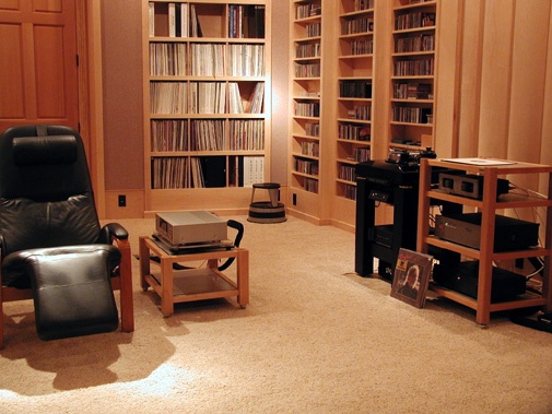

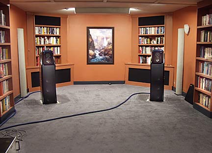

              About not using a rectangular room... well I've got to factor in the WAF, I must admit she took it pretty well when I first reveiled the room size demands for my HT room (which will be the biggest room in the house!).
              I want it to look as normal as possible, it will be part of the main living area. So no black walls, thick carpeting all round, floor risers and dedicated sound deflectors making it look like a studio, but using stuff like bookshelves and drapes in front of the windows.
              the finish should look a bit like one of the pics you posted (see attached file finish%203.jpg)
              But I havent looked at your design yet, so maybe I could incorporate some parts like avoiding 90 degrees corners, like in the 2nd picture (but not so big)
