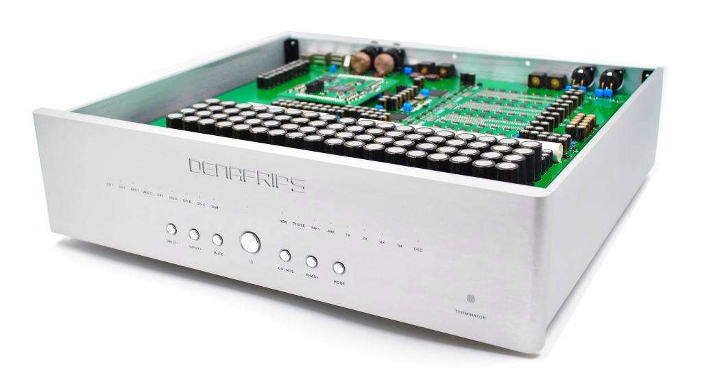

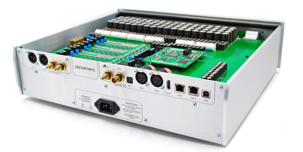

            That would be interesting to do some time, but I don't own one of these myself. I did just spring for another R2R ladder DAC, one with 26 bit PCM resolution and 6bit DSD, the DENAFRIPS Terminator, but I think with a name like that I'll have to talk ET into doing the measurements... I'm not sure I dare put it on the bench myself...

            With two AES/EBU inputs, and three different hardware configurations of I2S input (which has been bedeviling me lately- our company bought a Danish company that makes a one chip Class D amplifier product and of course they sent me the I2S input only version to test)

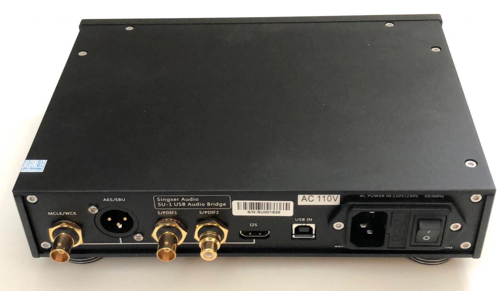

            But I have a Singxer SU-1 that should make testing the Terminator fairly interesting... it converts USB sources to SPDIF, AES/EBU, and I2S in HDMI using LVDS.
