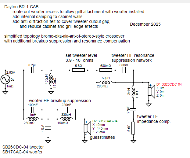

                            I've been playing around with these SB ceramic drivers in a Parts Express BR-1 cabinet, and found a retailer had their own 'improved' crossover for the pair, but without values publicly listed, but with their published impedance and reverse null measurements, alongside my preliminary measurements, I simulated something close and then added my own touches to knock down breakup/resonance in vituixcad... I don't have a high quality testing setup with a rotating speaker stand to verify and adjust, and am waiting for some parts deliveries, so it is still a work in progress...

                              I traced the impedance of SB17CAC35-04 and loaded in your filter. The notches need some re-evaluation, they're not targeting the breakup at all with centre frequenies at 16kHz and 18kHz. You want the notch to land around 8kHz range for this driver.
                              Try this:
                                Evil Twin commented
                                Editing a comment
                                I was wondering about that also, but was pretty busy yesterday, no time to stop look at it in detail. Good catch.
                              • eb15
                                eb15 commented
                                Editing a comment
                                Thank you for your look over. I went over things and yeah, that was just a quick hack to increase roll off with the parts on hand and reduce HF output from the woofer in the simulator, not specifically tuned to the measured resonances.. 0.68uF in parallel with 56ohm and the 0.33mH would give an approximation to the series notch filter (at approximately 10kHz ) used in the SB bromo kit crossover. (~10kHz is where the highest output spike shows in response) 1.2uF there would be close to your example network for around 8kHz.
