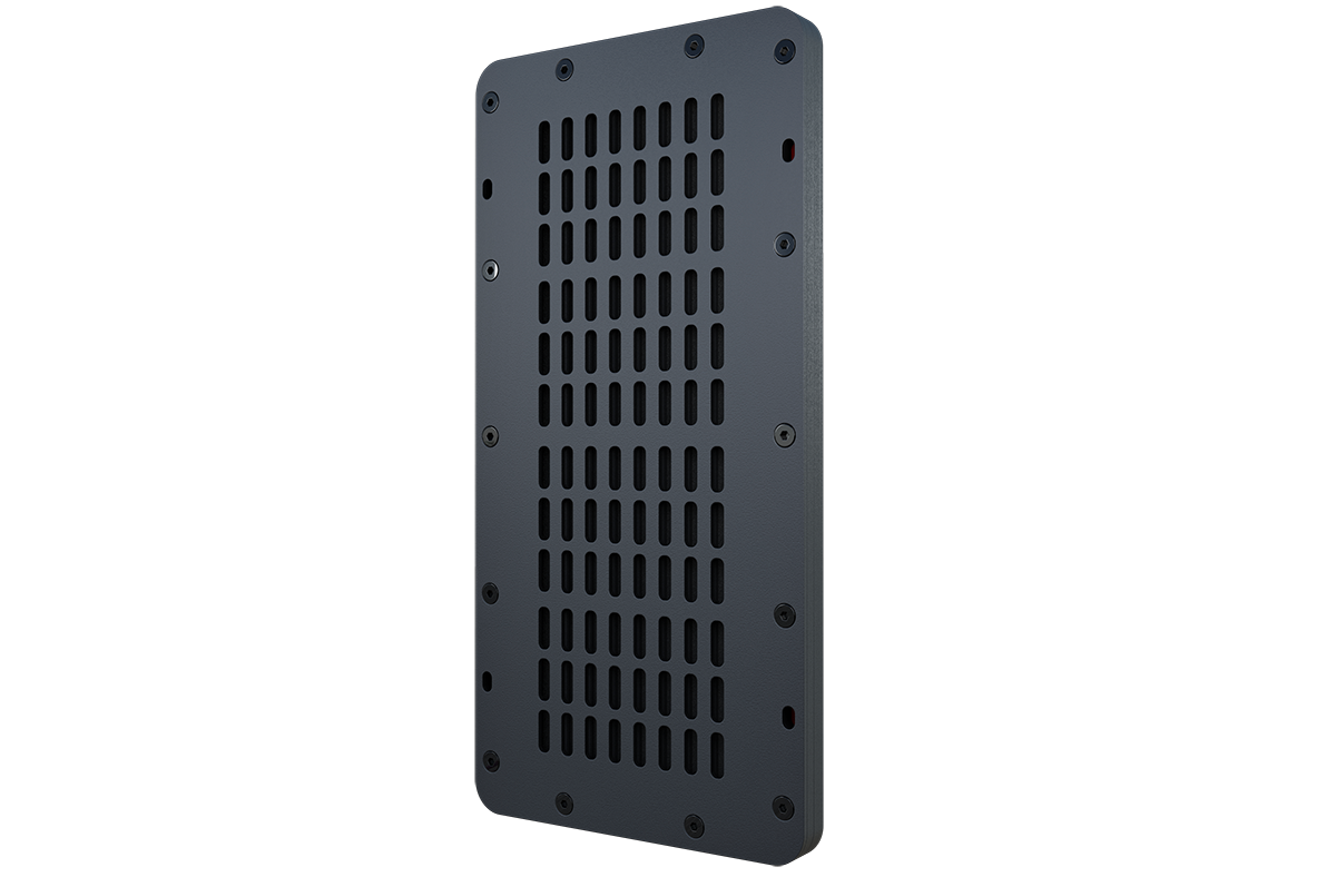

      The Radian LM10n is a wide band planar ribbon driverwith a recommended operating frequency band150Hz-20kHz. Its flat pattern of straight conductors isevenly distributed over a stretched polymer diaphragmand disposed in a symmetric magnetic structure.As a result, the inductive component of inputimpedance is eliminated a

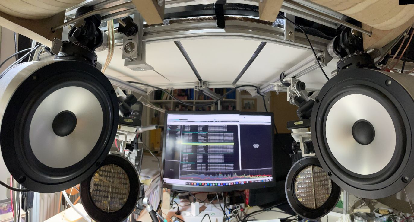

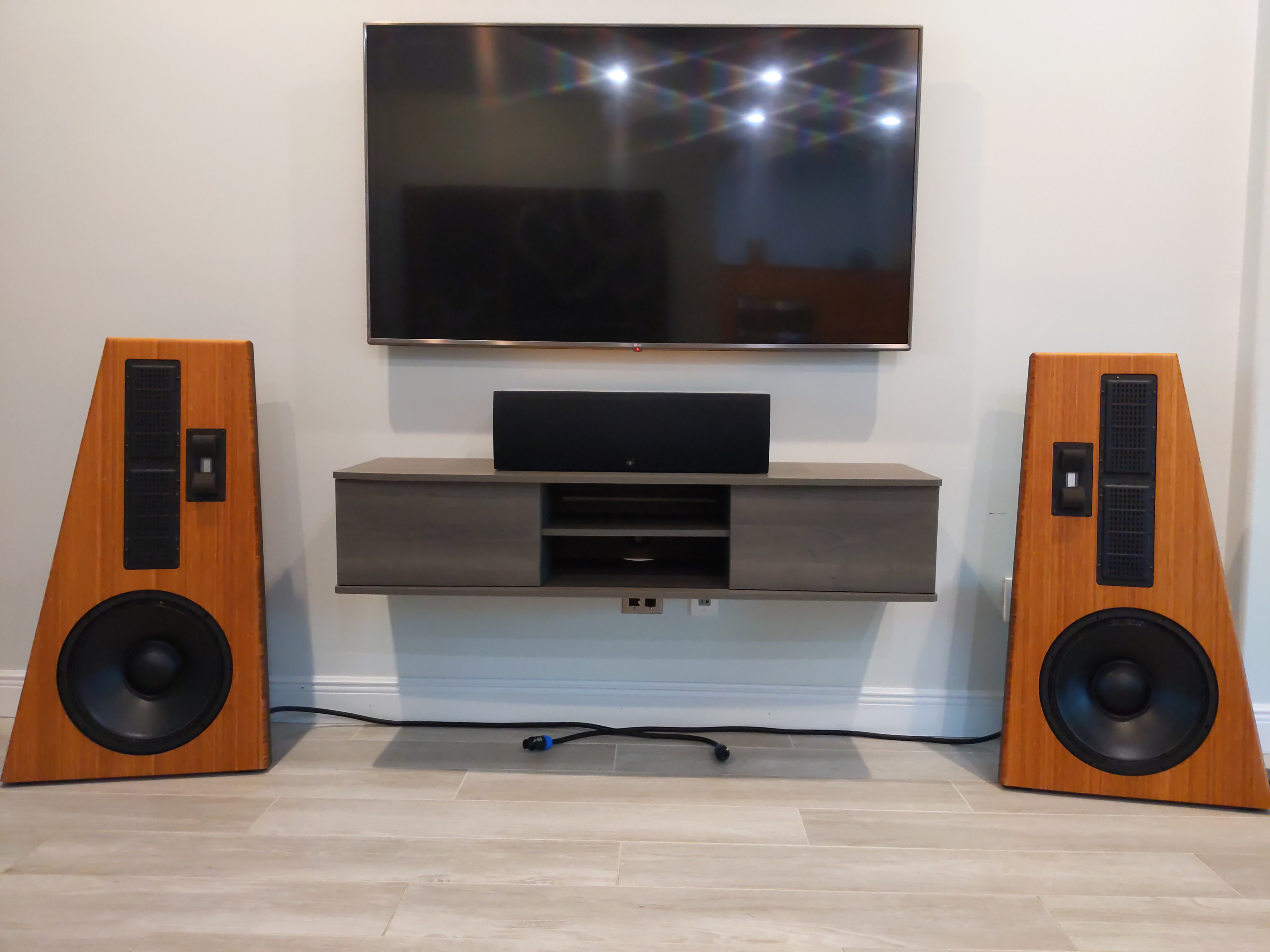

        Adding another photo of further inspiration from a fellow posting over at Audio Science Review. He harvested planar drivers from a set of headphones, added a midbass driver and then built small subs that are over top of his head.

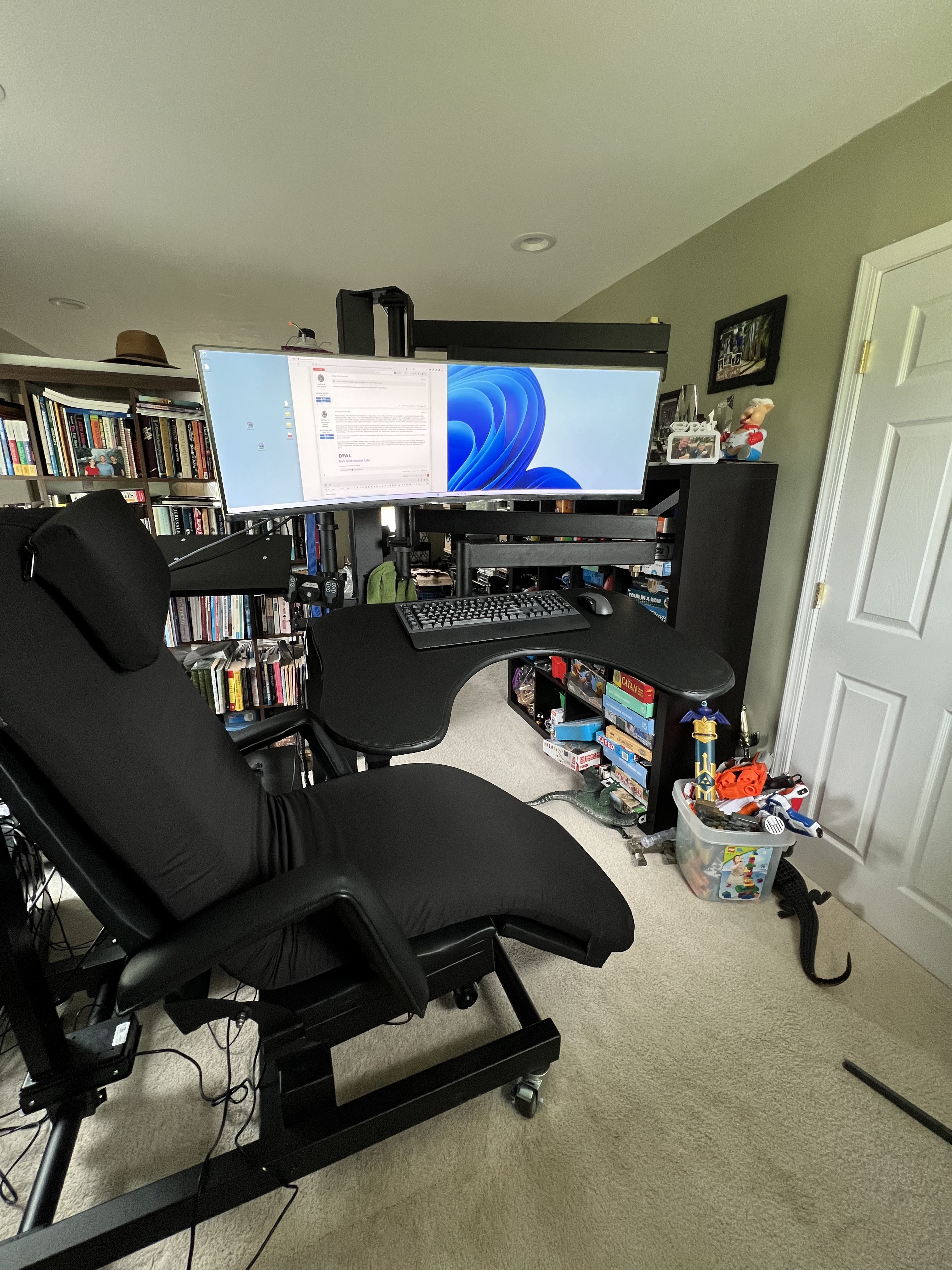

          Originally posted by gbegland
          After years and years of wanting to acquire a zero gravity recliner, I finally thought to check facebook marketplace. No way I was ever going to spend $2-3K for a new one. Long story short, I scored a perfectly new looking chair for $400. That's more my style!
          I've been a big advocate of zero gravity workstations since 2016. I use it for work, but having one for audio would be very interesting. I had a J-20 workstation and imported it from China as it was cheaper then buying from the US option. That lasted for 7 years and finally the chair wore out and I needed to upgrade.

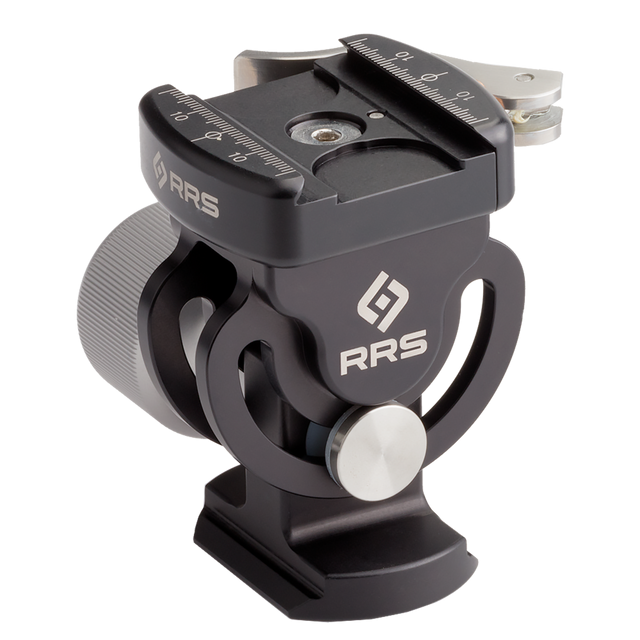

            Click image for larger version  Name:	UNFL-Back.jpg Views:	53 Size:	254.5 KB ID:	945426
            I was looking at this photo closer today and realized those are Really Right Stuff ballheads for a tripod! That is an uber expensive ballhead to use for mounting speakers like that 🤣. Its the monopod head mixed with some other part:
            gbegland, Do you have the link for where you got that photo? I'm curious to go read through that thread if he says what parts were used to assemble that chair setup.
              Here you go:

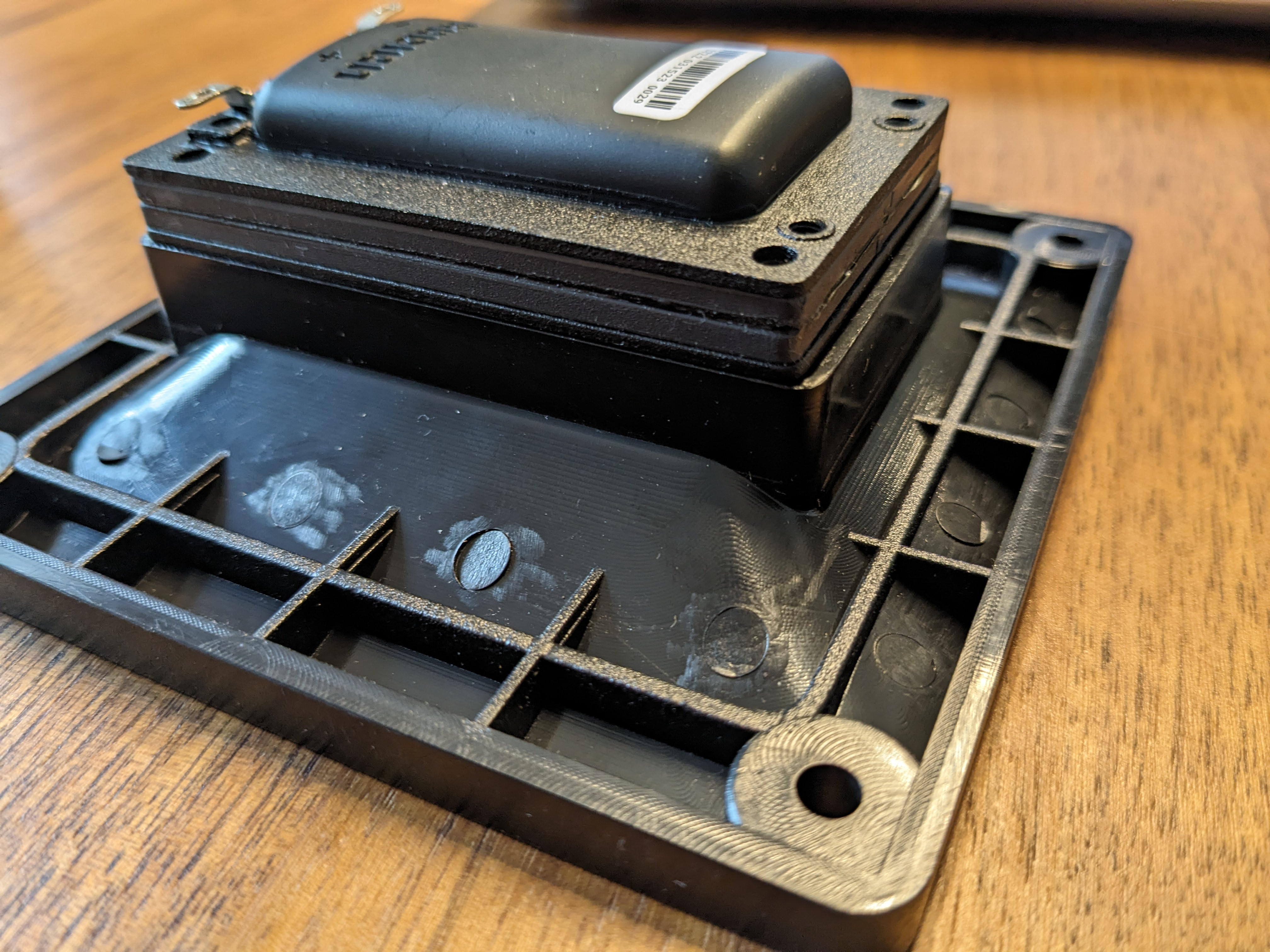

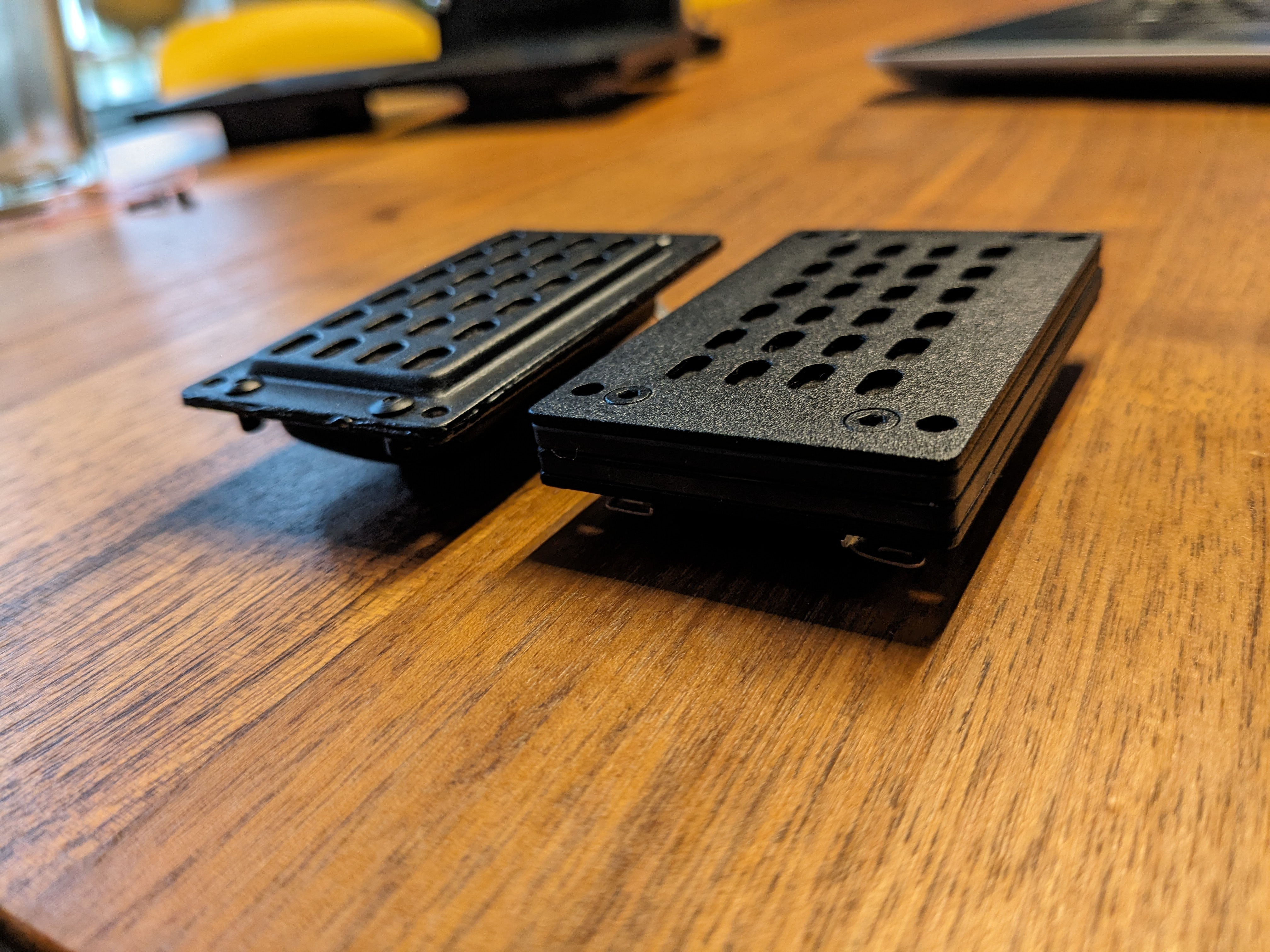

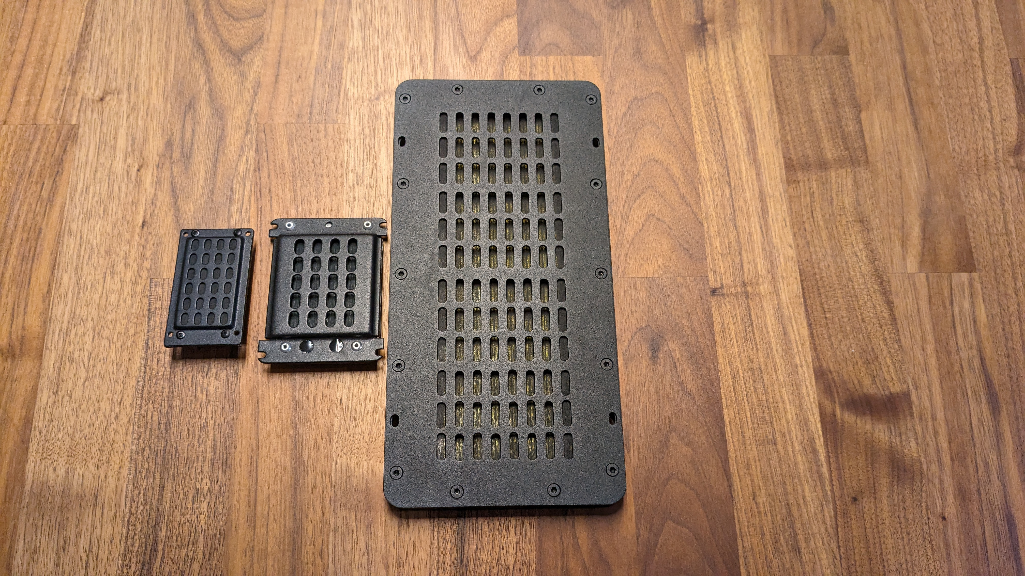

              Just a little update. All parts for V1 are here now. Woofer went in a different direction, but only becuase I got a deal I could not refuse. Measurements and listening tests will determine if they stay or I go to V2.
              Look at the comparison of a standard Neo3 next to the little Radian LT2. I think it looks like a nice combination for an all planar coaxial unit. As far as the woofer, it's a JBL Arena 12. Not your typical car audio woofer that's all show and no go. Features dual differential drive just like the higher end pro woofers and a rather light cone for this type of driver.​

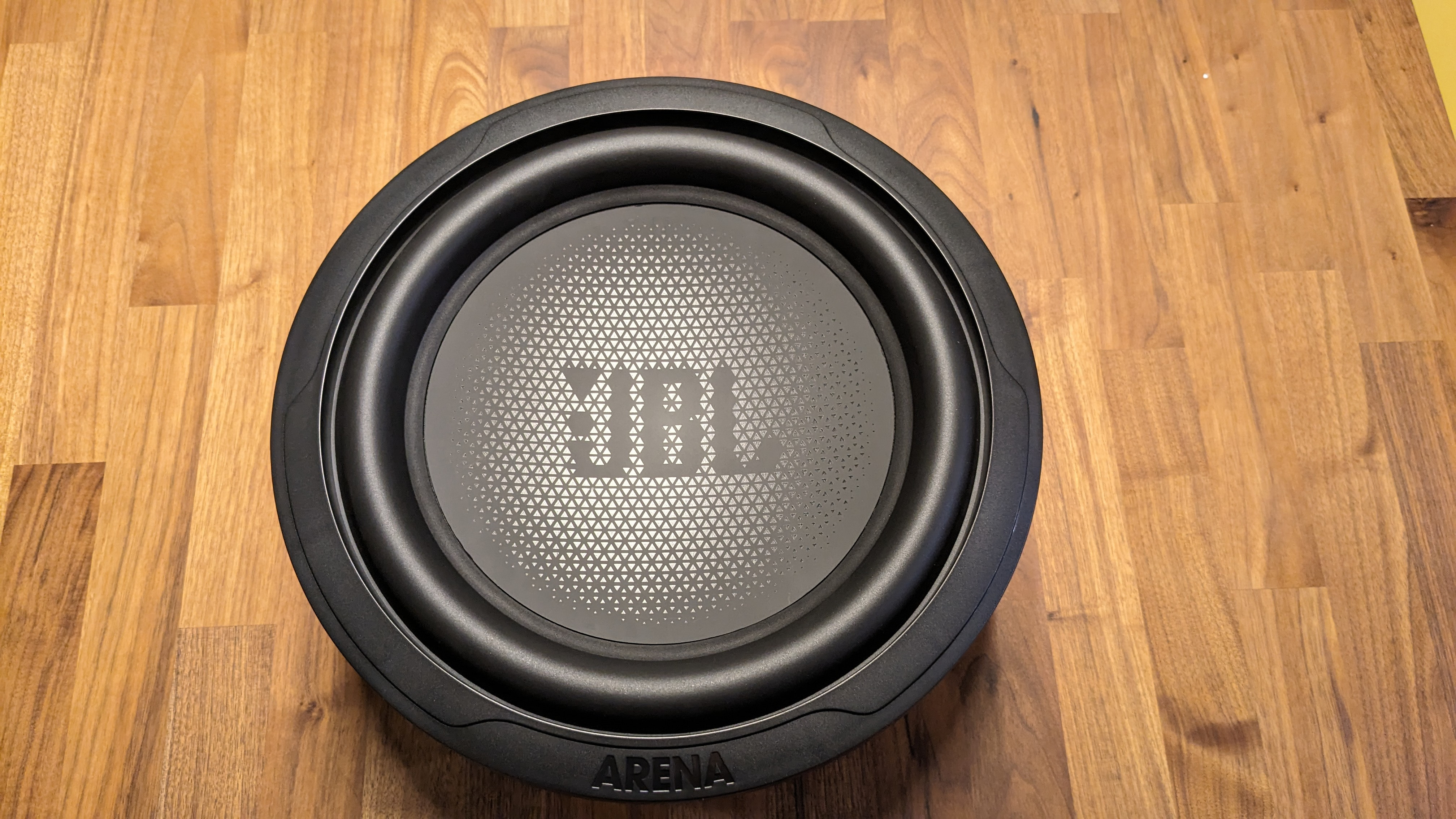

              • tktran
                • 703

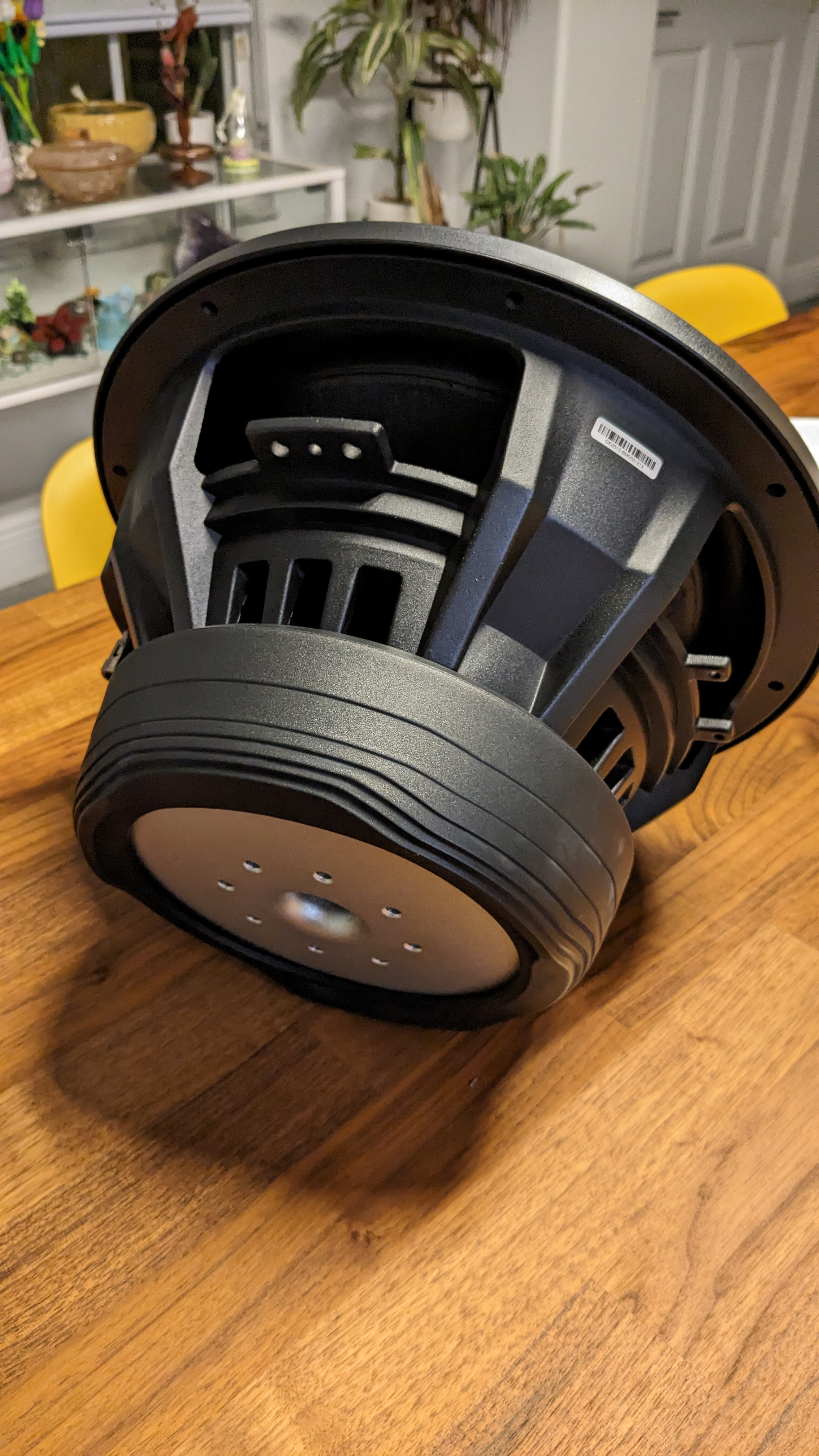

                That JBL woofer costs serious $$$ (MSRP $500). I actually wonder whether most of the R&D is in automotive audio... because those customers are happy to spend big bucks.
                Some years ago Data-bass.com tested a heap of 12" + subwoofers, and the TOTL models from the likes of Rockford Fosgate, etc had advanced technology than many home audio subs did not.
                Can you share a free air impedance sweep of that Arena 12?
                • gbegland
                  • 233
                  Yeah, retail pricing on those is a no go for sure. I got both for about half price of a single driver.

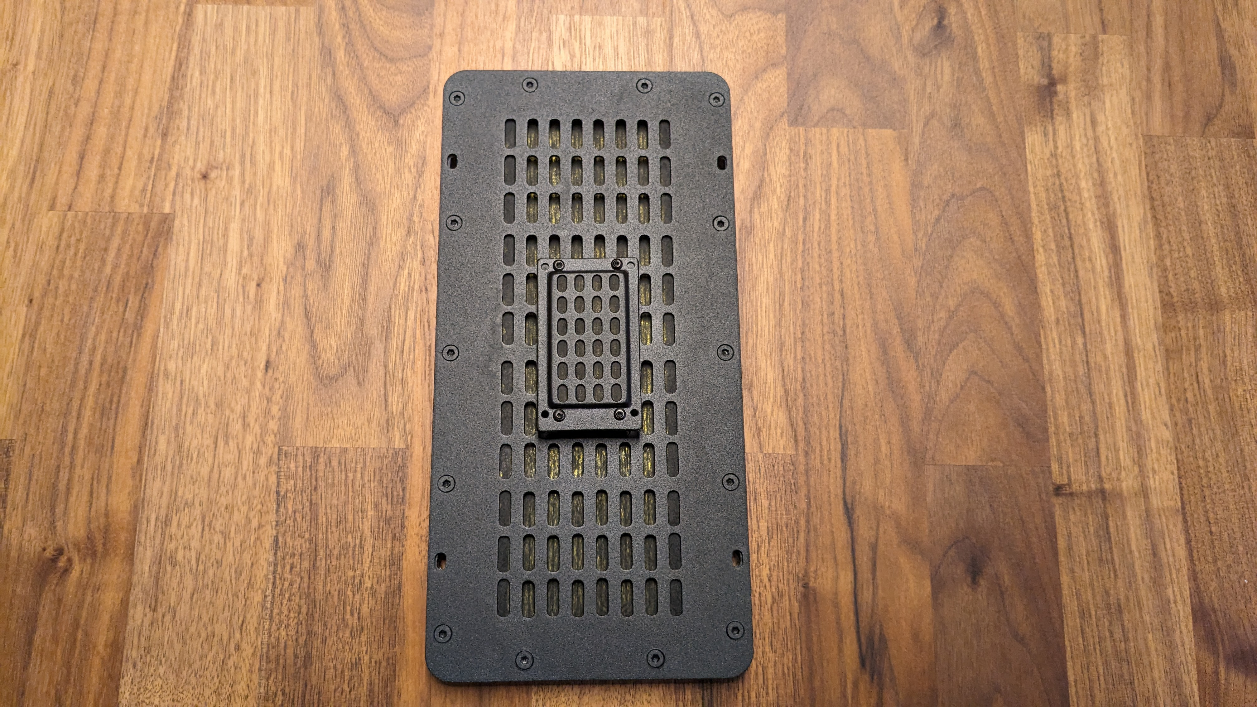

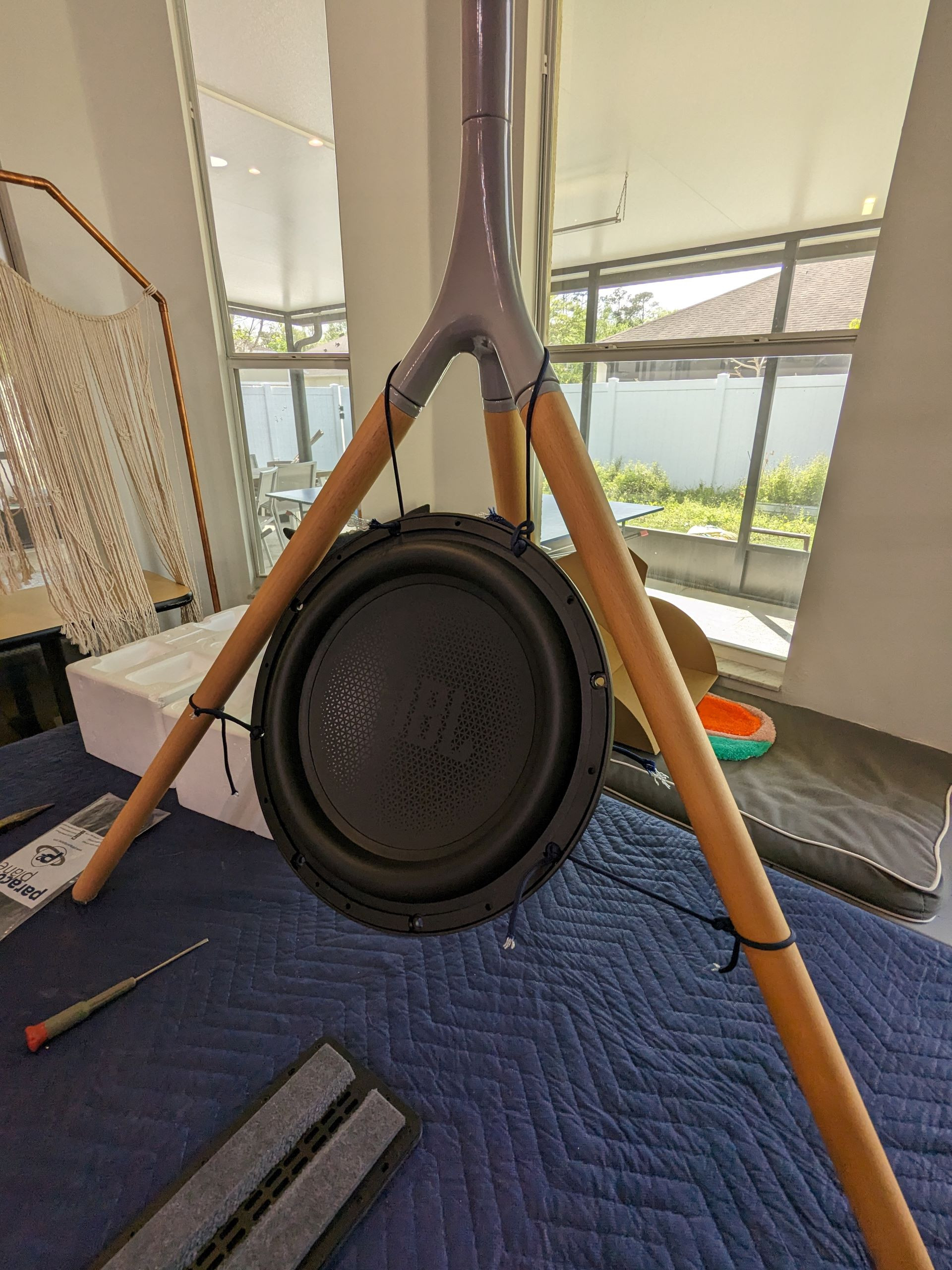

                      Finally getting back to working on this project. Click image for larger version

                            We've got sound. Proof of concept for signal flow and channel to driver wiring. No measurements yet, but some basic settings in the Hypex DSP based on manufacturer plots. That's the good news. The bad news is that the Adam Audio Sub 7's I ordered on a screaming clearance sale were both bad. One was completely DOA and the other had self noise even with no source plugged in. Not too sad, as I expected they would not be very good, but for the price, I thought they'd be good for some experimentation. Back to the JBL drivers for the low end.Click image for larger version  Name:	PXL_20240121_210607067.jpg Views:	0 Size:	2.72 MB ID:	950661

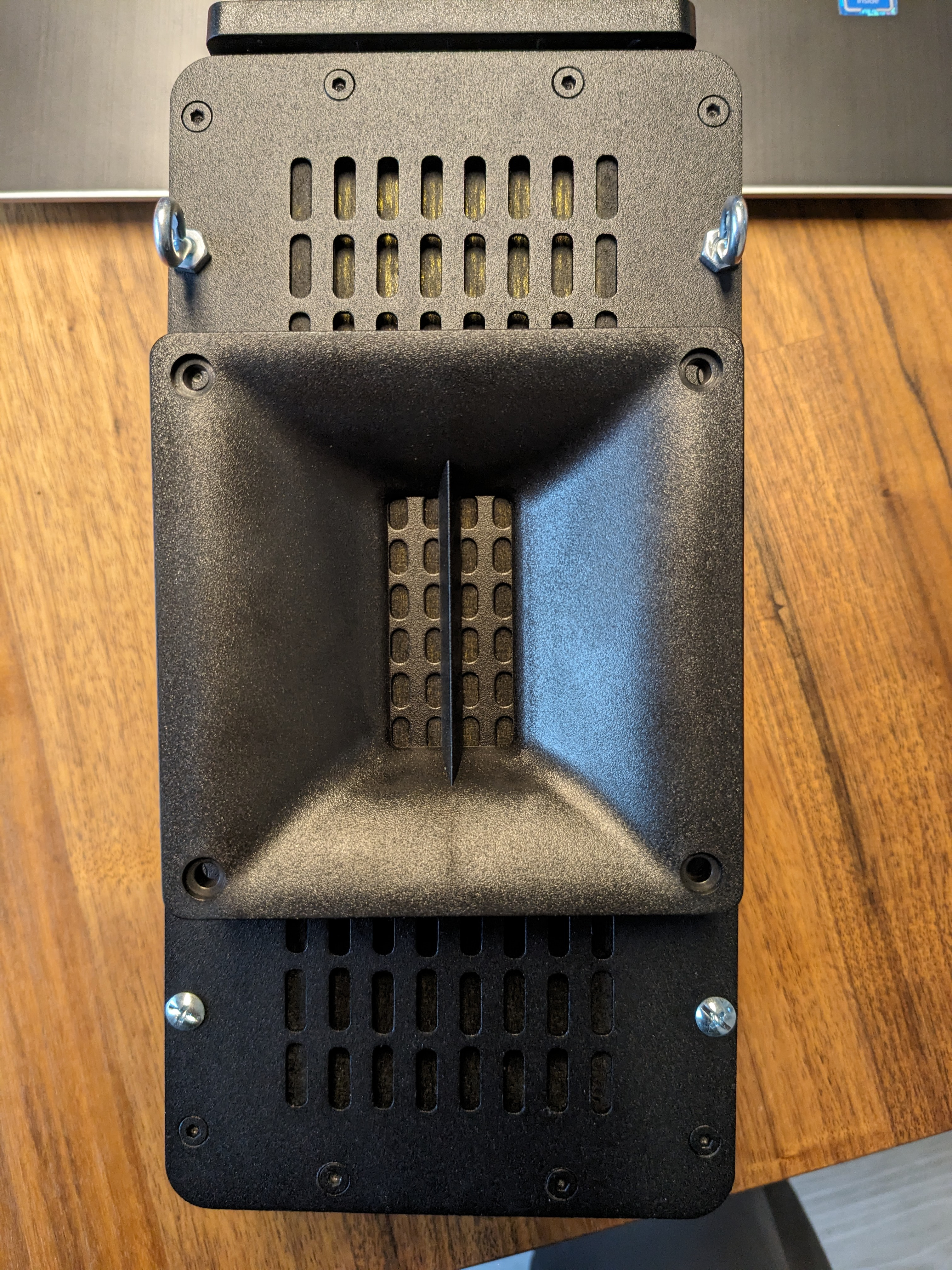

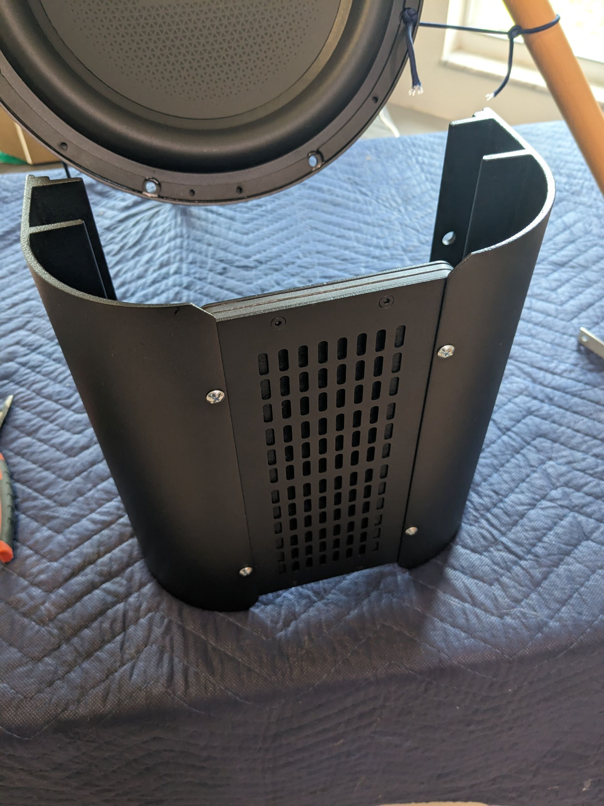

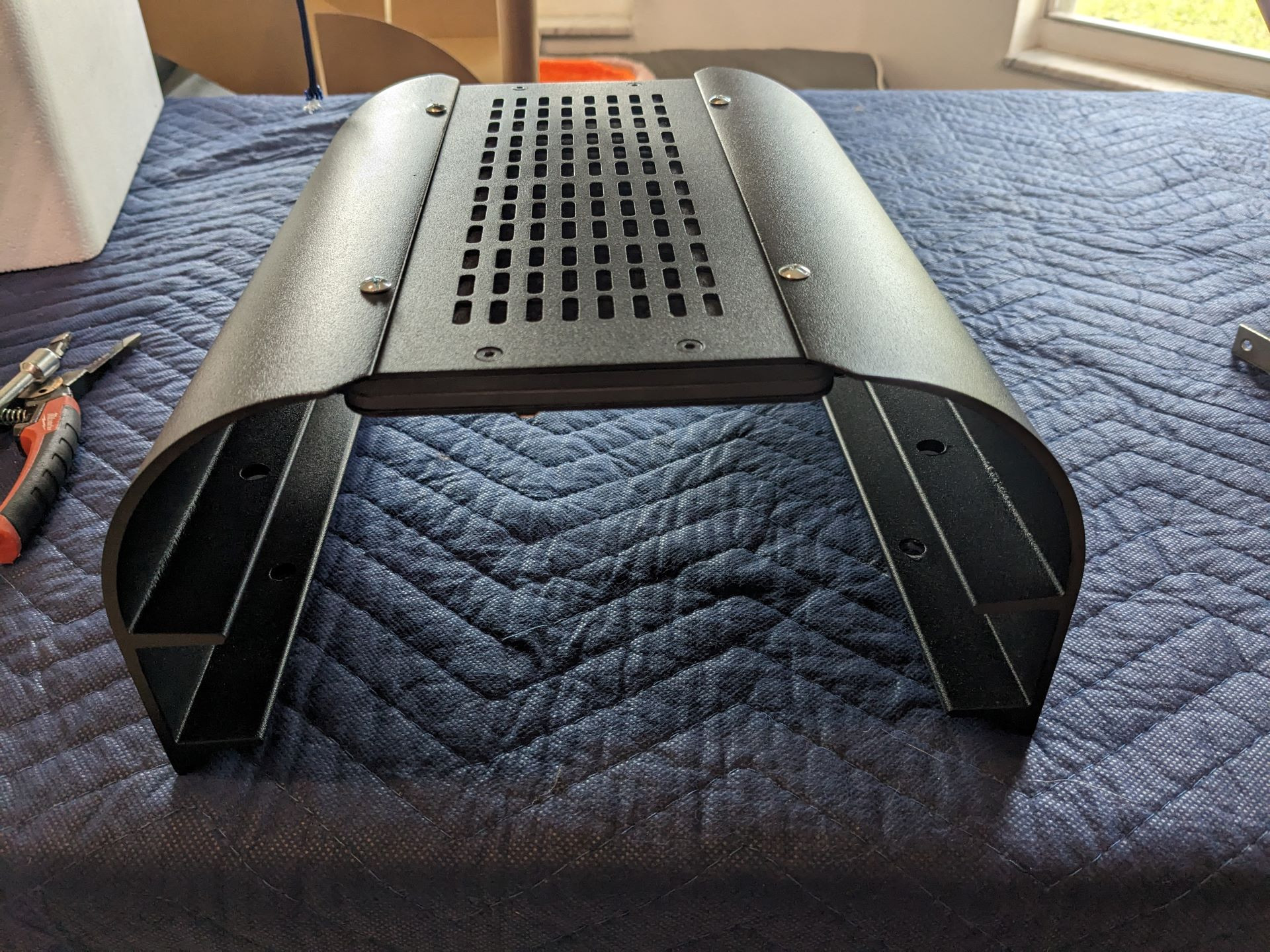

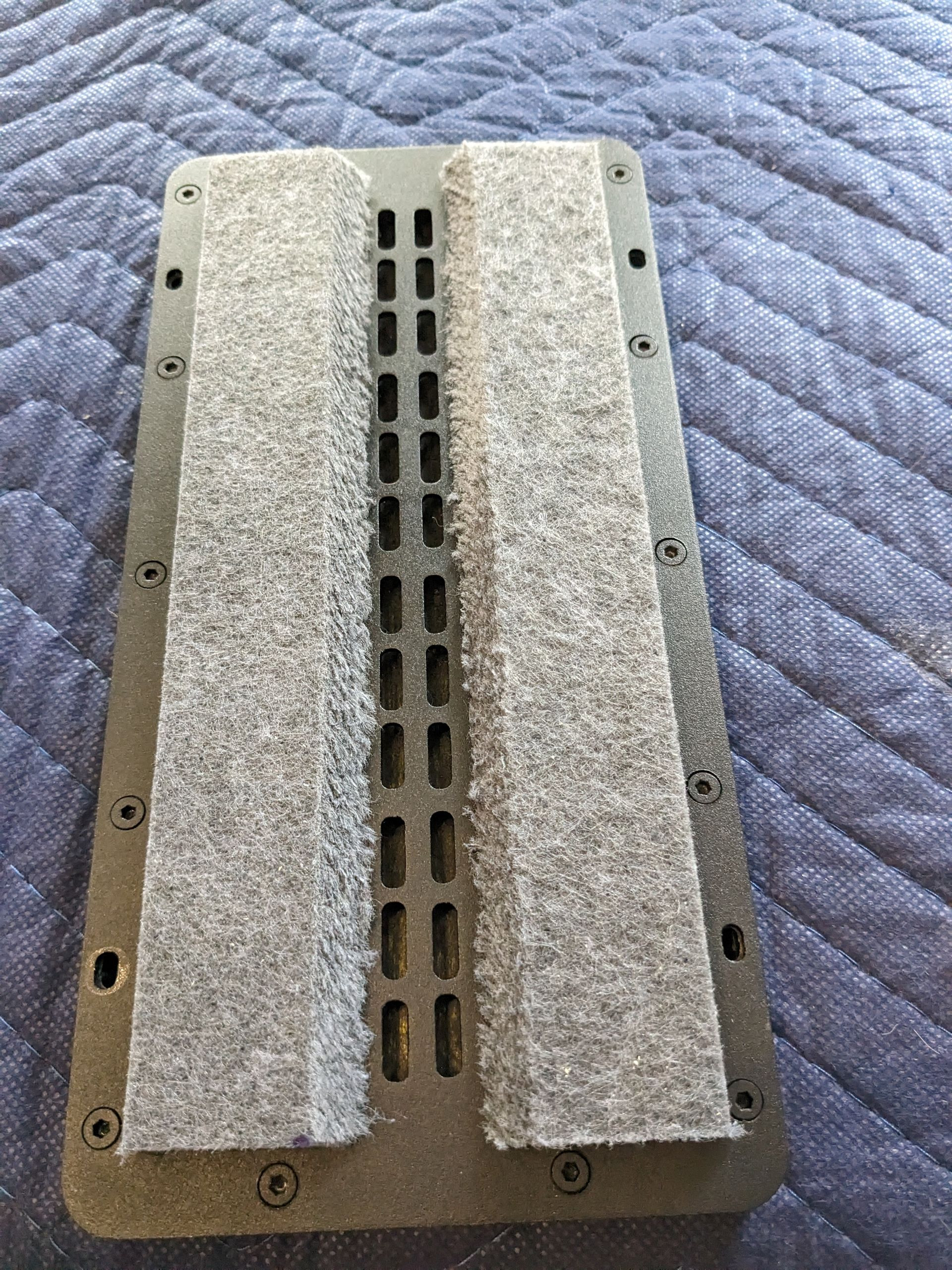

                              New LT2.2 tweeters arrived with what are supossed to be the matching waveguides. Unfortuantely, they do not actually fit the new tweeter, which got wider as compared to LT2. The LT2 DOES fit into the recess, as expected. Radian has been contacted with the mistake, so we'll see what they have to say about it. I was hoping these would both improve the top end response, and allow me to have a simple place to attach some sort of a bridge to hold it to the LM10n. I'm sure the naked tweeter would have had some diffraction issues and I hope the smooth, curved profile of the waveguide will impove this. Construction quality of the 2.2 has certainly improved and as such, is now in line with the construction methods of the larger drivers. No more glue joints or rivets.
                              Click image for larger version  Name:	PXL_20240217_185907336.jpg Views:	0 Size:	2.42 MB ID:	951279 Click image for larger version  Name:	PXL_20240217_184258494.jpg Views:	0 Size:	3.55 MB ID:	951281 Click image for larger version  Name:	PXL_20240217_175538408.jpg Views:	0 Size:	2.56 MB ID:	951283 Click image for larger version  Name:	PXL_20240217_181909035.jpg Views:	0 Size:	2.19 MB ID:	951285
                                • 1578
                                The waveguide seems like a nice idea, but it sure covers up a lot of the mid! Any concerns on that front?
                                • gbegland
                                  • 233
                                  For sure. The rear could be covered with acoustic felt and/or holes could be drilled out of the waveguide.....or both.

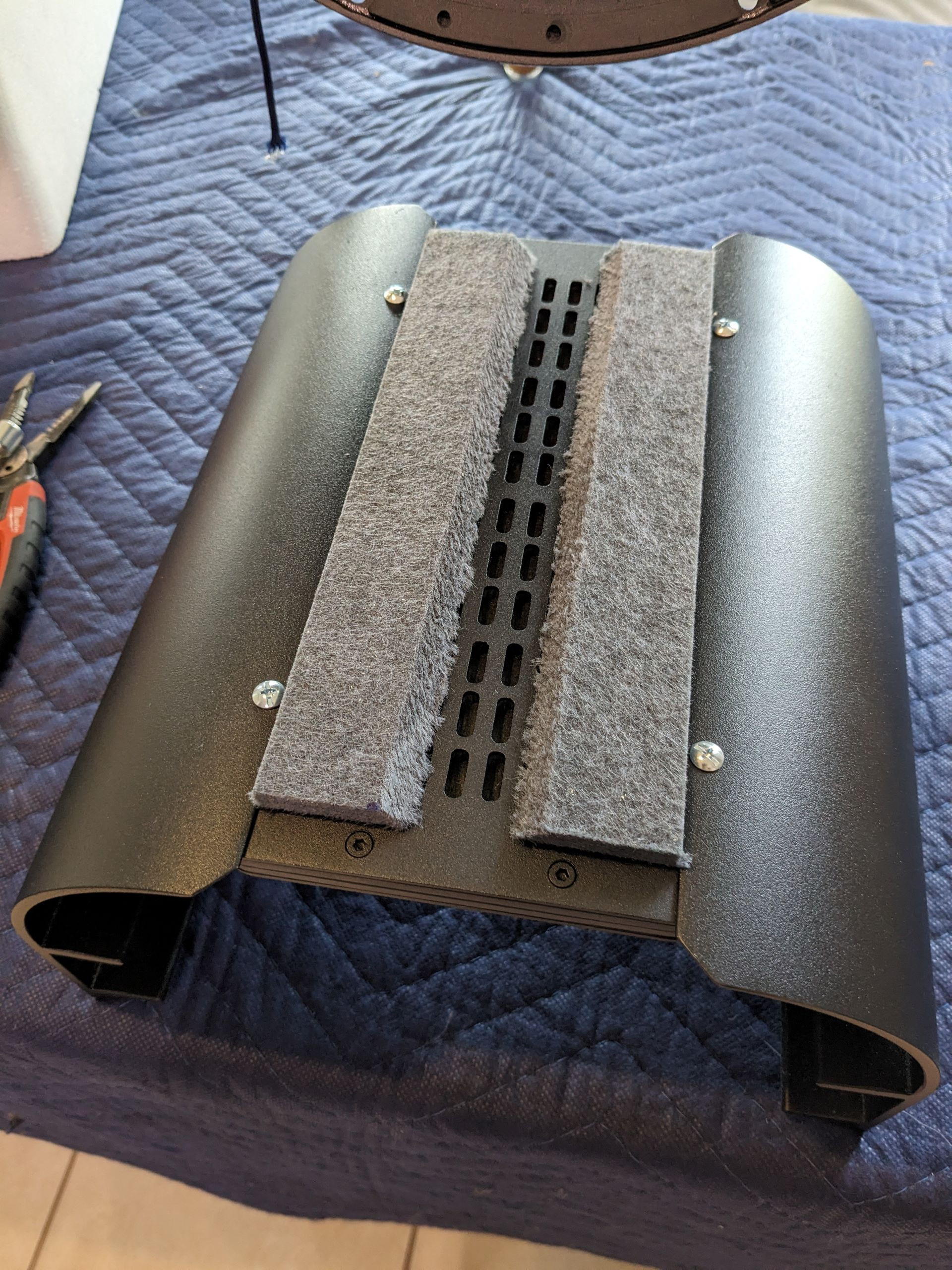

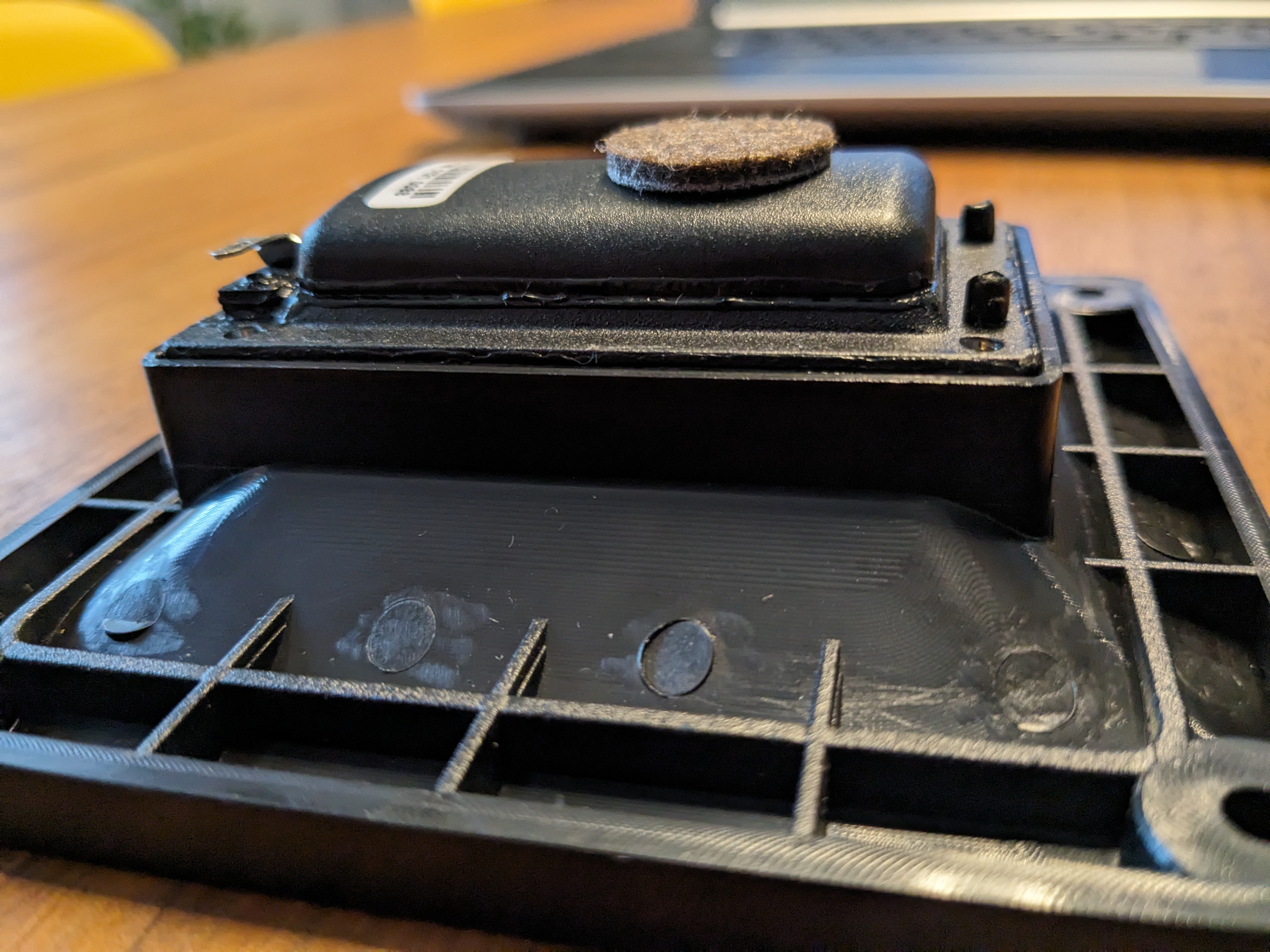

                                  • gbegland
                                    • 233
                                    Click image for larger version  Name:	PXL_20240317_192729825 small.jpg Views:	196 Size:	1.64 MB ID:	951587 Click image for larger version  Name:	PXL_20240317_202802588 small.jpg Views:	193 Size:	853.9 KB ID:	951588 Click image for larger version  Name:	PXL_20240317_202834841 small.jpg Views:	193 Size:	771.6 KB ID:	951589 Click image for larger version  Name:	PXL_20240317_202904323 small.jpg Views:	198 Size:	1.24 MB ID:	951590 Click image for larger version  Name:	PXL_20240317_192800798 small.jpg Views:	193 Size:	997.0 KB ID:	951591
                                    So many options. If the felt works out, perhaps I can skip the separate tweeter altogether. Simplification would be nice, but we'll see where this all leads eventually. I don't want to box myself into any specific solution just yet. Only enough time to play with parts today. Still no serious listening or maesurements.
