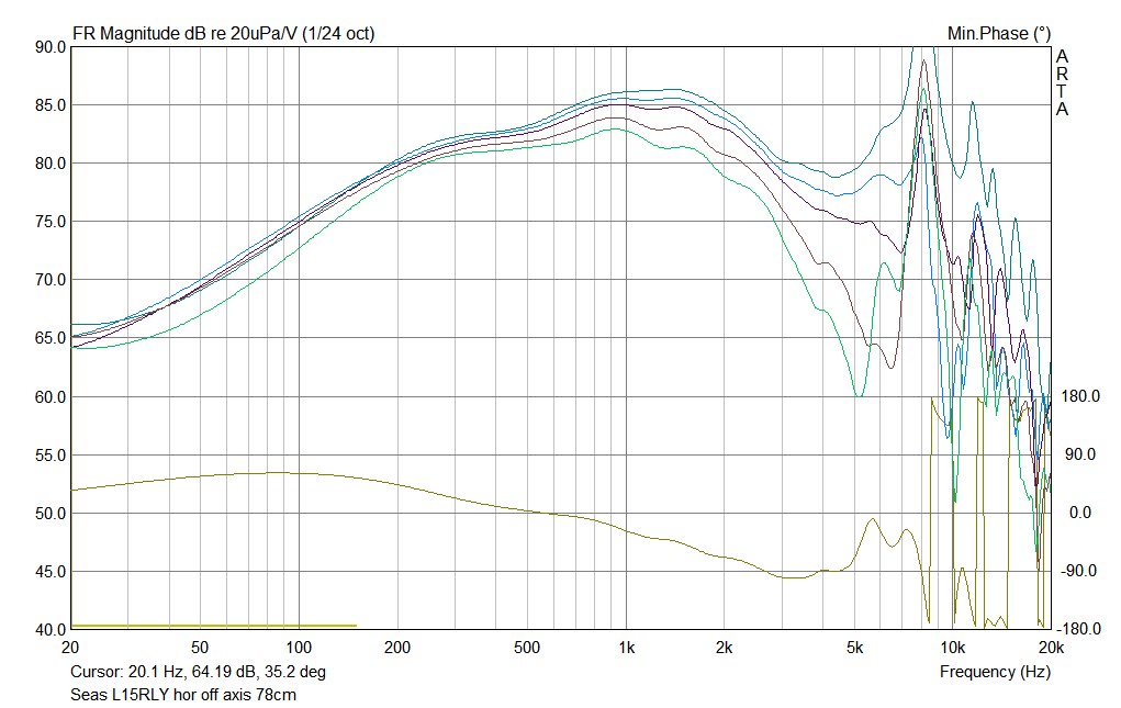

                    For perspective:
                    That's an L15RLY in a regular bookshelf speaker. 1/24 octave smoothing and hamming 50%. That's the level of smooth between 1 and 2kHz I would like to see.
                    I admit it's a compromise how much damping you want to use. And Tidal isn't the only company that seems wanting to avoid too much damping.
                    Lumen White's Silver Flame comes to mind...
                    I still find it irrititating, at this price point, and at this level of performance that is shown otherwise. I wonder if one would get any support from Accuton how to use these rather unusual midranges. They should have a recommended remedy in the sleeve, i would expect.
                    -Matt

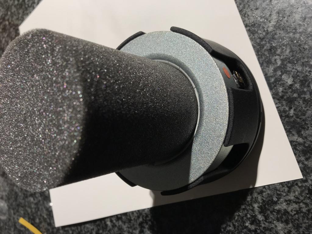

                    • Bukem
                      • Mar 2008
                      • 89
                      • Zvu
                        • Oct 2013
                        • 435
                        How does the impedance plot looks with that opening damped ?
                        Tesla; George Carlin;
                        • Matt M
                          • Jul 2014
                          • 86
                          Ahh, great: first-hand experience!
                          What is it more like: does it "kill the sound" or does it "clean it up"?

                                                          Originally posted by Juhazi
                                                          5th, I can't hear those interferences because of the meyhem of them. But they sound good far away! And I can't hear the side-nulling indoors either (unless closer than 1 ft), because my brains use so long IR gating!
                                                          Obviously you don't use very wide and deep wgs. Or you have rather high RT values, hard walls in your apartment. My RT30 is around 0.4, EDT 0.2-0.3 and living room is 3,5x6m, tilted wooden ceiling, gypsum board walls. But I have naturally heard synergys and 15" coaxes in different rooms, not at my home (never over my body)
                                                          Well if you stepped directly into an actual null you'd surely hear it, but as you said the overall chaos and room interaction covers it up. Yes I'm not talking about massive wave-guides like those. Just something in line with the KEFs. I use the B&W FST driver as my midrange, modified with the phase plug removed + small tweeter to turn it into a coaxial. This gives me a 15cm waveguide, it measures incredibly well, but obviously doesn't have as much pattern control as something that's 15" in diameter. Even this size is enough to make my ears happy vs naked domes.
                                                          I was more trying to say that I don't think the off axis response, of the KEFs you linked above, would sound uneven or vastly different wherever you are in your listening environment (obviously within reason). And yes, my room uses zero room treatment without any extravagant furnishings. There is a carpet and curtains though. The advantage of the wave-guides, though, is that they lessen the immediate impact from the room.
                                                          Last edited by theSven; 01 April 2023, 20:00 Saturday. Reason: Update image location

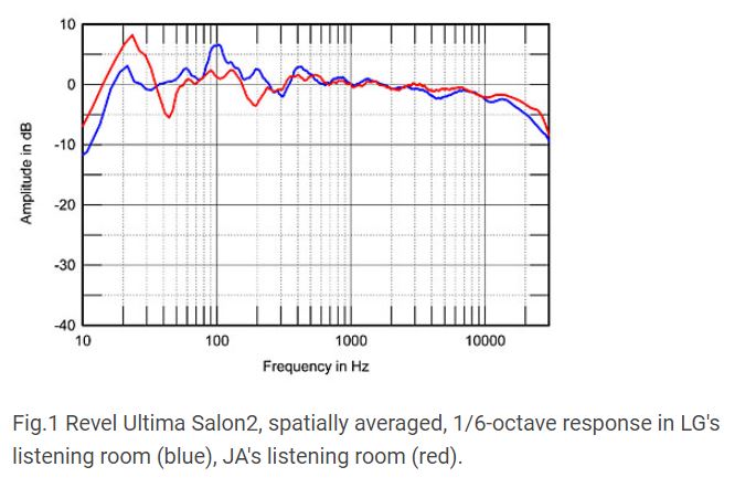

                                                                          • Kal Rubinson
                                                                            • 2109
                                                                            ^Nothig wrong with it, I quote myself:
                                                                            "Very good room response, but measured in a different room than the speakers that I linked earlier here."
                                                                            Please let me clarify that I know that Stereophile's directivity measurements are done with short gating and they are reliable. I have never questioned that. They often publish also room response, which is average of 120 measurements in either editor's or Atkinson's room. Room response has long gating and it sort of combines the listening window and total power response of the speaker and reflections in the room.
                                                                            Here are the responses from two rooms.
