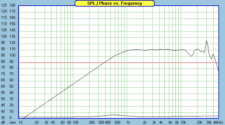

                            I still think your closest alternative is the Usher - which was likely made in the same factory. I think it would need some modest alteration to the crossover however, so probably not a true drop-in replacement. ops:
                            Note: the 28A apparently differed over time with production, with older versions having ferofluid like the Usher. Here are very similar measurements (conducted in a similar manner) with old 28A and the Usher:
                            Old 28A:
                            Usher:
                            The alteration in sensitivity looks mostly from differing Impedances - with a 5.3 ohm value in the crossover range for the Usher vs. the 4 ohms for the Dayton. The magnitude of the resonance and higher up in freq. for the Usher results in wider Impedance "swings".
