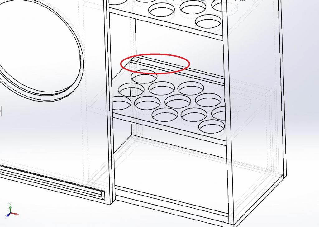

              Howdy Folks, Sorry to keep pestering you, but ignore the previous questions,
              Instead could you just tell me if doing the slot port as I have is fine or does the internal mouth of the port need to be flush with the interior walls?
              Doing it this way will make it much easier for me to make a plate that can seal the port. (Ignore the terrible bracing, It's late!)
              Thanks again

                Nothing wrong with that construction. It doesn't have to be flush with the walls. Nice looking cabinet drawing! Are you just going to put a plate of wood the size of the slot port opening in there to plug it?
                Also, don't apologize for any questions! Questions are good and can help you and any others who are thinking of asking the same thing!

                  Perfect Scott, Thanks. I wasn't sure if it would change the port length, though I assumed it would be negligible if it did.
                  Thats why I want it away from the wall a bit, I'm going to use an actuator or a motor with a plate to open and close the port with a switch. Kind of pointless really, the volume favours sealed and this is mainly for music but hey why not?
