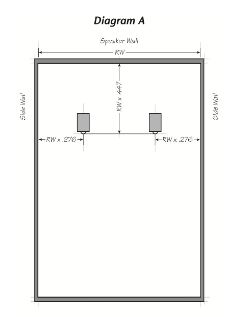

        Really, for effortless dynamics and deeper bass (assuming full range without a sub), take a look at CJD's three way project. Just remember that to extract the best performance and minimal coloration from a monopole type system, you need room placement that isn't very different from typical dipole recommendations - look at Avalon's and George Cardas' recommendations.
        Cardas Speaker Placement Guide

                                            I'm glad you started this thread, because I need a lot of the same advice. Just got set up in the new place, and my stereo is now in a space that's 1/4 the size of the old room. However, I now have a 'music room' (it was in the living room before), so I can think about room treatments. I would really appreciate some advice on moving a system to a smaller room. The room is also almost a square, which will be a problem too. Anyway, the two main questions in my mind right now are:
                                            * Dipoles and room placement and wall distance. The image that Evil Twin posted helps, and I'll read that article. My room isn't that rectangular though. Right now I have the speakers on the slightly longer wall, because that gives me more symmetrical walls on both sides (otherwise one speaker would have a window on the side and the other would have a closet). But in general, what should I be trying to do? The imaging/soundstage is too diffuse right now, which is probably because the reflected sound is going everywhere and is arriving too close in time to the direct sound, since the speakers are much closer to the walls. Will absorption/diffusion help? Behind and to the sides?
                                            * Right now only my midrange is dipole. I've been thinking of trying a dipole woofer for a while now. Will a smaller room and being closer to the walls make that easier or more difficult? The room is about 10'x11', so I shouldn't have too much trouble getting some bass, right? I left my big subwoofer in the garage, there's no way it's fitting in here.
                                            I'm wondering if I can get this to sound better than it did in the old place. If I can take care of the reflections, that should clean up the sound somewhat. Also, I wonder how 'making speakers disappear' is affected by moving to a smaller space. Does being closer to the speakers help or does it make it worse? I wonder if I could turn this into an almost-nearfield setup where the room's signature would be felt much less than before. But nearfield dipoles... will that work?
