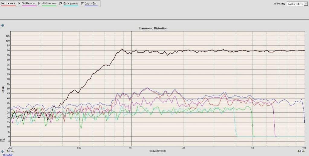

      The reason for my post was, when this driver 1st came out a few years ago, there was a lot of interest and testing. Everything looks very good but I wanted to see if anything had popped up in real world use that would be a show stopper. Off axis horizontal and vertical seem to be as good as or better than most domes and better vertical than most ribbons.
      Here's distortion test at 90 db so it should be close to 2.8 volts.
Name:	AST2560 Distortion 90db.jpg
      Solid low distortion performance above 2K.
      I'm looking for more to see if anything has popped up.

        This plot looks pretty solid from 2K and up, though the 5 dB/div and small division markers makes it look real flat at first glance. What kind of slope is one question.. These would probably work nicely in an MTM with a 3rd order slope. I've got some Motus woofers that might work well with these.
        Often there's just no substitute for listening to it... Though that assumes doing the design and voicing homework already!
