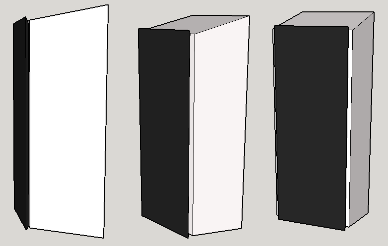

        I'm also planning on reducing the front baffle height a little, and instead add angels to top and bottom to ensure that the volume is quite unchanged.
        Also looking a bit to freshen up the look a bit. Maybe by just adding a front cover with a little special style - as shown below.
        Are these changes OK to do without affecting the sound characteristics to much?
