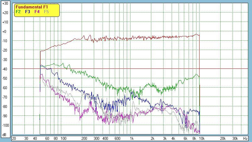

          I would suggest SS 10F/4424 http://www.scan-speak.dk/datasheet/pdf/10f-4424g00.pdf
          Have them in my Notes and they sound very nice, measures decent and doesn't cost a fortune.
          I only use these from 1kHz and up, so if you're crossing in the 300Hz range, I'm sure there's better choices.

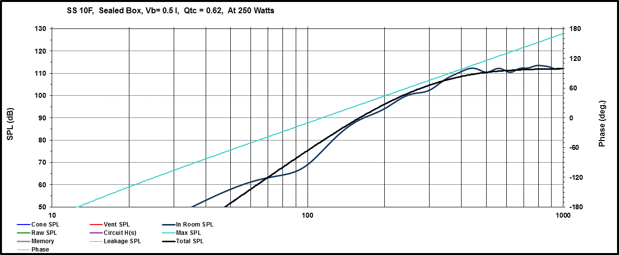

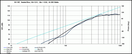

            The 10F is fine from 400hz and up.
