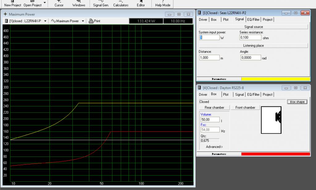

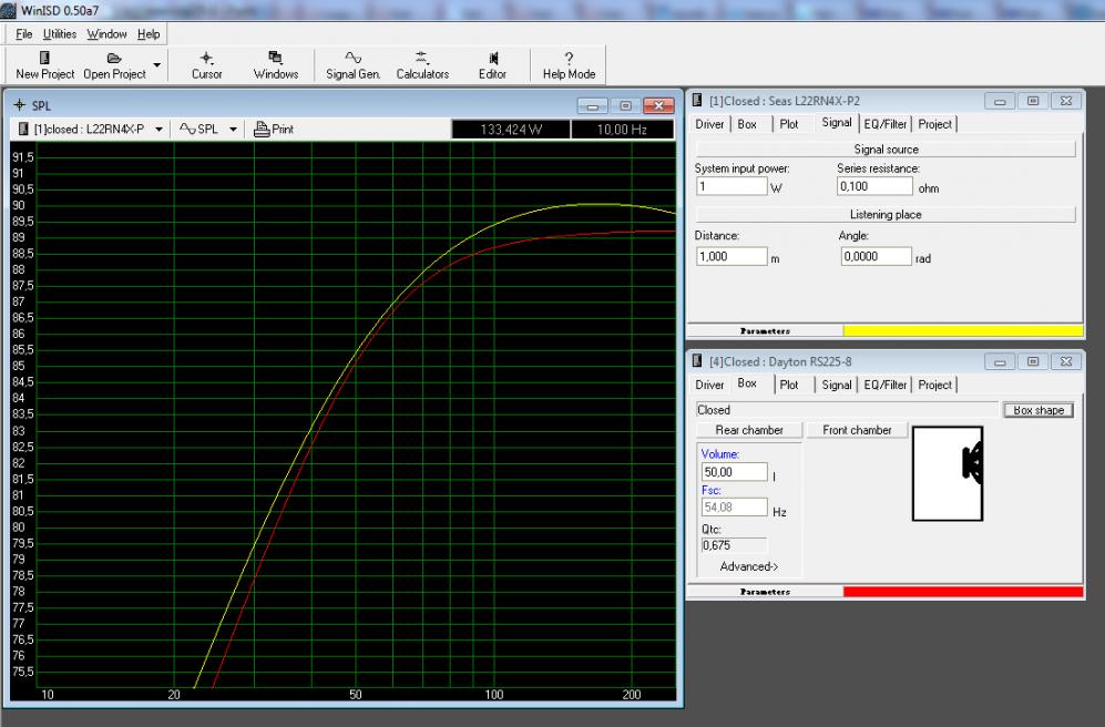

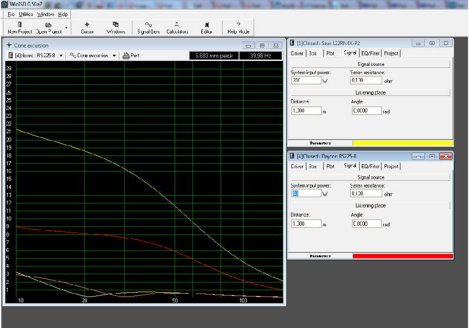

              I have been looking at Seas L22RN4X and theres also a pretty good match and i could have them on my doorstep within a couple days, ive compared them a little bit in WinISD, and i think these might fit good. They have a xmax of 14mm, and in the cabinet they would require 160w each to achieve xmax at 40hz, vs. the RS225 which reaches xmax at only 41w each at 40hz. They have almost 1db higher sensitivity but i dont think i will notice much of that. They will atleast fix the issue of over excursion i believe. They handle a little bit of more power also but not by much. 4 layer VC.
              Ive attached a couple files
              This one shows Xmax limits at 40hz
              This one shows Maximum power vs frequenzy. This shows that the seas can receive their max power from just above 30hz, while the rs225 can receive max power from just under 60hz

              This one shows Sensitivity. Pretty close but 1db higher in the 100-200hz area.

                  RS225s have 8mm of one way xmax for 16mm peak to peak. The SEAS drivers list theirs as a peak to peak figure of 14mm so in reality only have 7mm of one way xmax, 1mm less than the RS225s. Linear excursion might not be the issue, but if you broke them this time without the high pass in place then that could make sense. I simulated the RS225 in a large sealed box and with a 2nd order highpass in place you'd fry them way before you'd break them from smacking the coil into the back plate. Without the highpass you'd destroy things mechanically before they melted, especially at lower frequencies.
