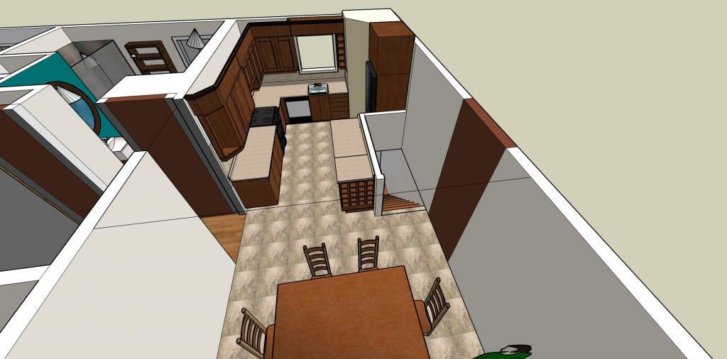

          My kitchen is on the first floor. There is no second floor and the roof is flat so no attic either. 3 of the 4 wall of the kitchen are exterior walls. The zone that I would like to have music is the kitchen area, the dining room is not that all important. I thought at the wall beside the stairs for an inwall configuration. Althought I'm not sure about how I could install a box inside the wall and insulate it to protect the speaker from weather. In the ceiling its pretty easy, there is at least 10" to 16" of space above the ceiling for insulation and a speaker enclosure.
          I could also put some speakers on shelf on that same wall section but that would not look so great
          here is a view of the current kitchen configuration
Name:	cuisine vue en angle 2.jpg
            Could you put speakers in the soffit above the cabinets?
              I was thinking the exact same thing.
              • warwolf7
                • Dec 2013
                • 5
                the kitchen on the picture might have tricked you because it's wrong. I did estimate the ceiling height in sketchup, so the ceiling is 3" lower in reality. The soffit, is 8" high in reality but we have to substract the o'gee... So that's leaving me a small 5", 5,5" area.
                But if there is option that could fit in, I would love to see them because I stood in the kitchen and look at the area. I guess it could work, it's not too high. I guess that the speaker would need to have an angle to avoid too much reflection on the ceiling
